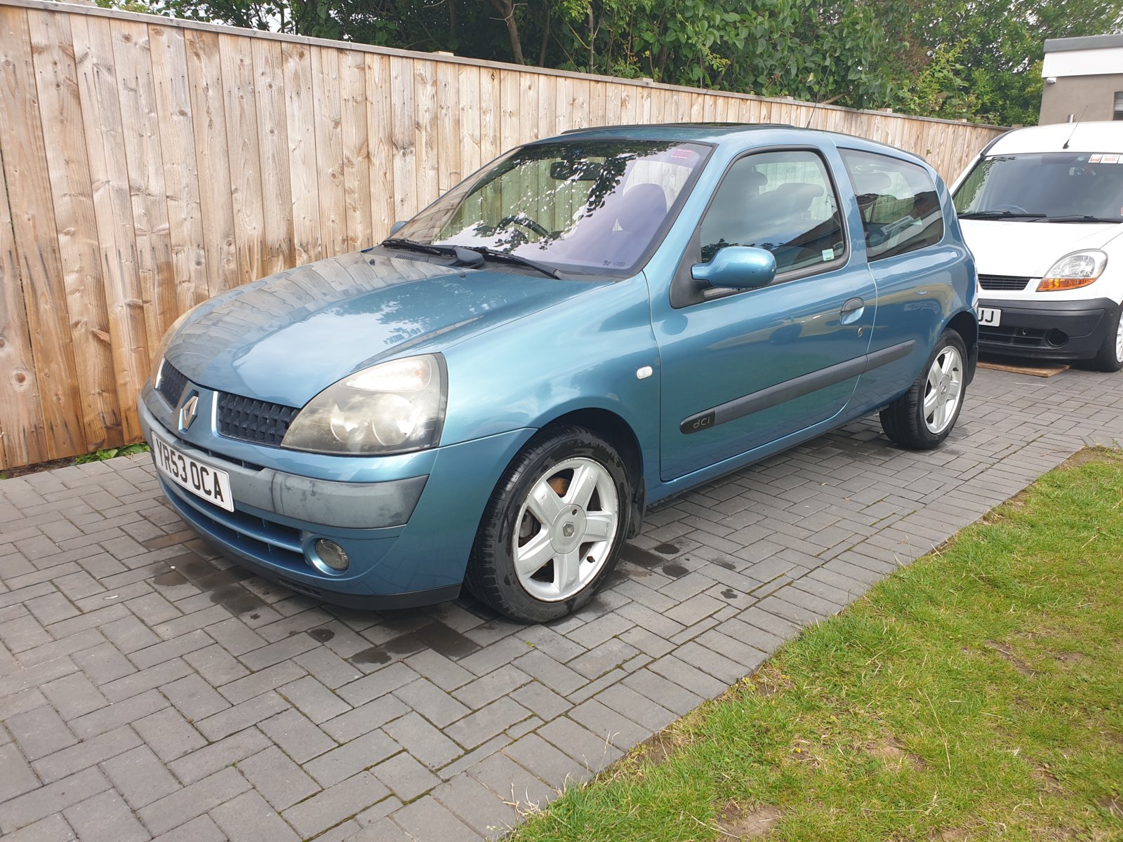

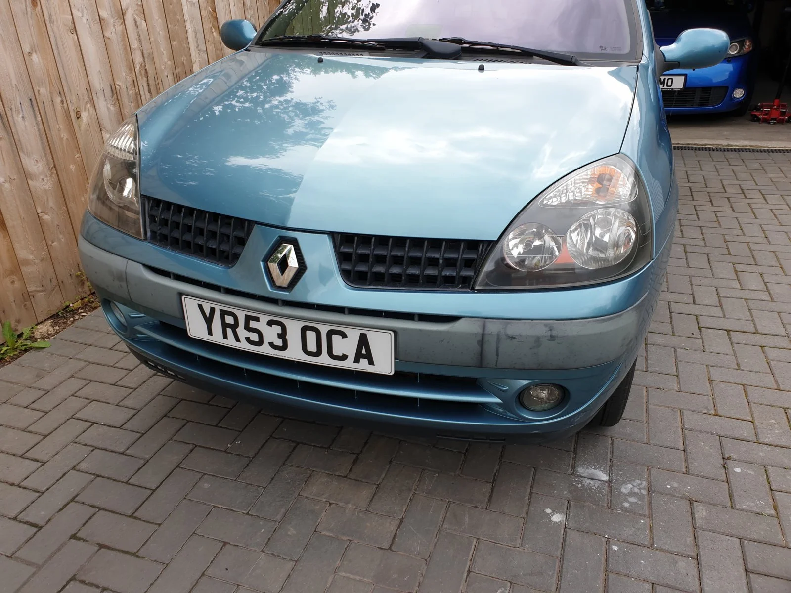

Quick update

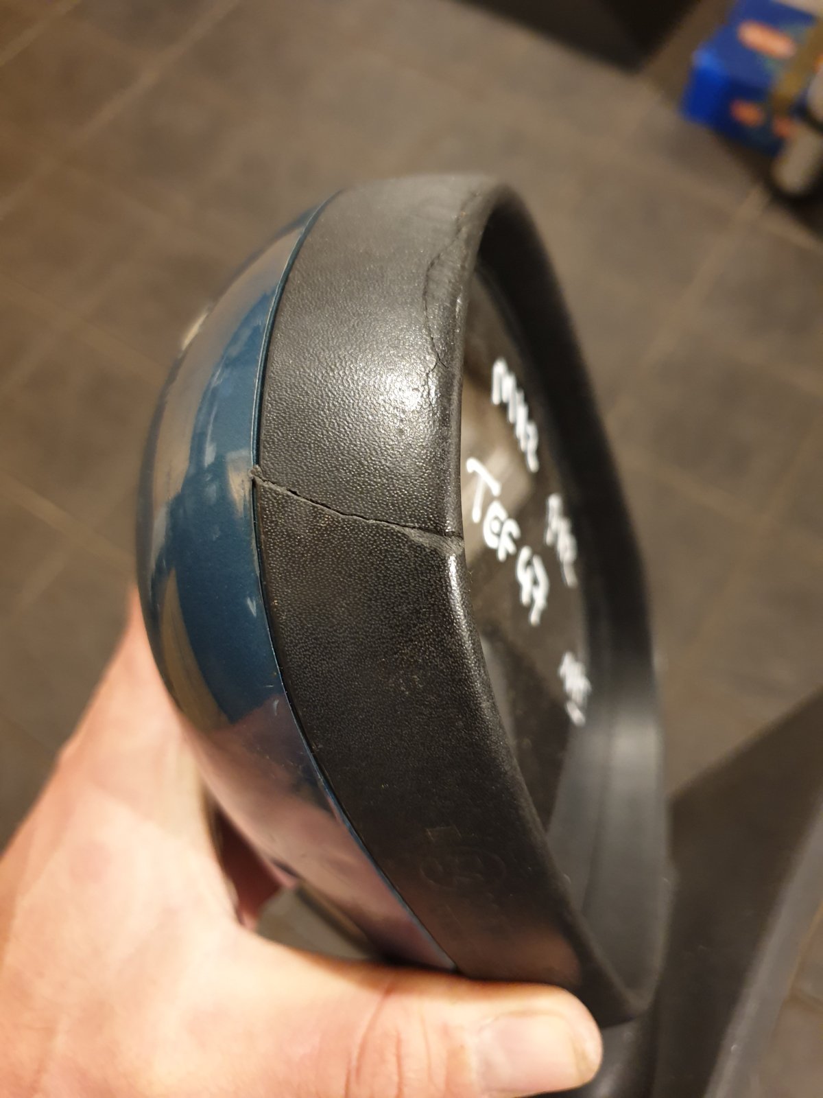

Blue dci had a black mirror on the N/S, ordered a cheap 2nd hand replacement off ebay. Bit dissapointed as they sent a shite one which clearly was not the one pictured as has no external temp sensor in and cracked. I never expect brand new when buying used parts, but some places will sell any old shite sadly. Anyway made a good one out of the pair and fitted

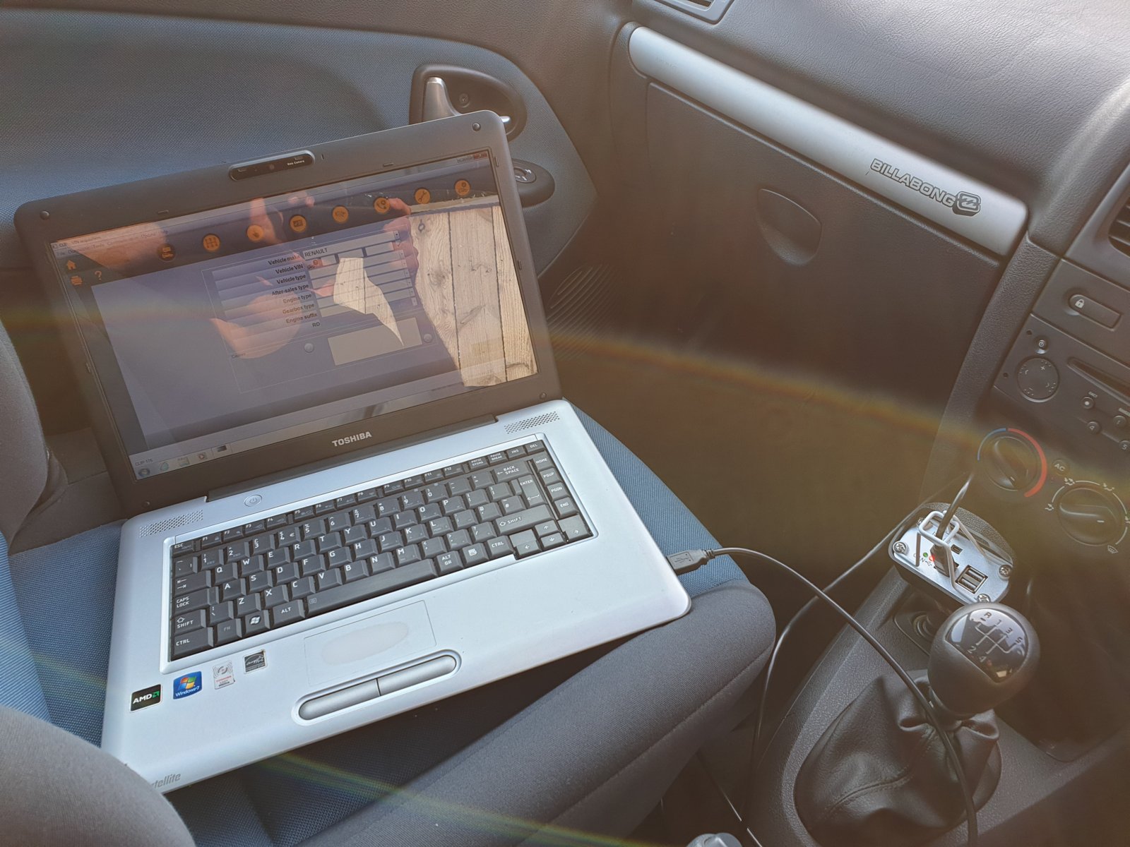

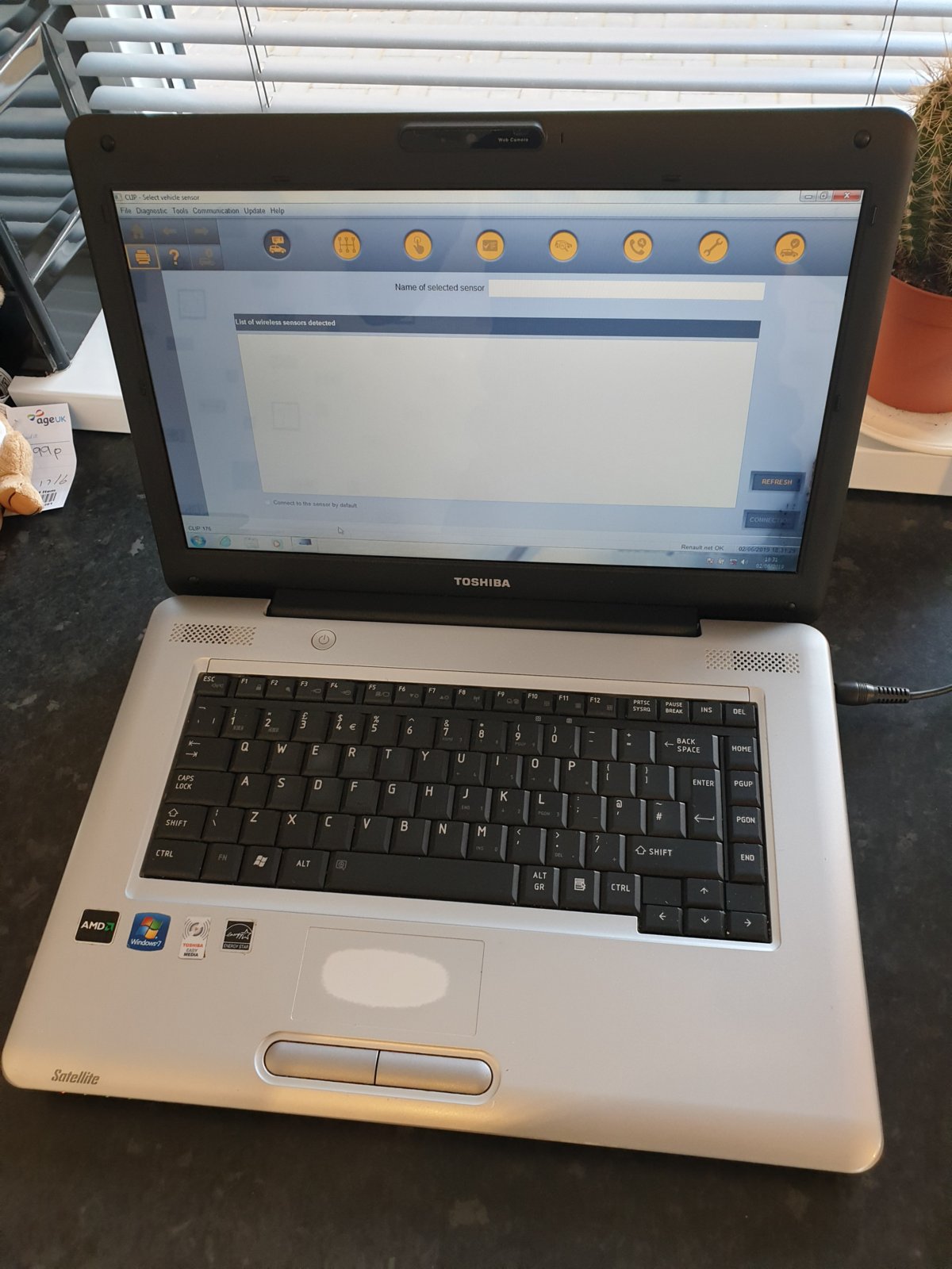

Also bought a cheap £50 toshiba laptop on windows 7 out of cash convertors on Sunday to replace my ancient xp laptop. Miles faster and installed a newer version of clip v176
Its a bit of a lazy starter from cold unless you cycle the heater plugs a few times, need to get the test meter on the heater plugs and see whats what.
Thanks for reading !

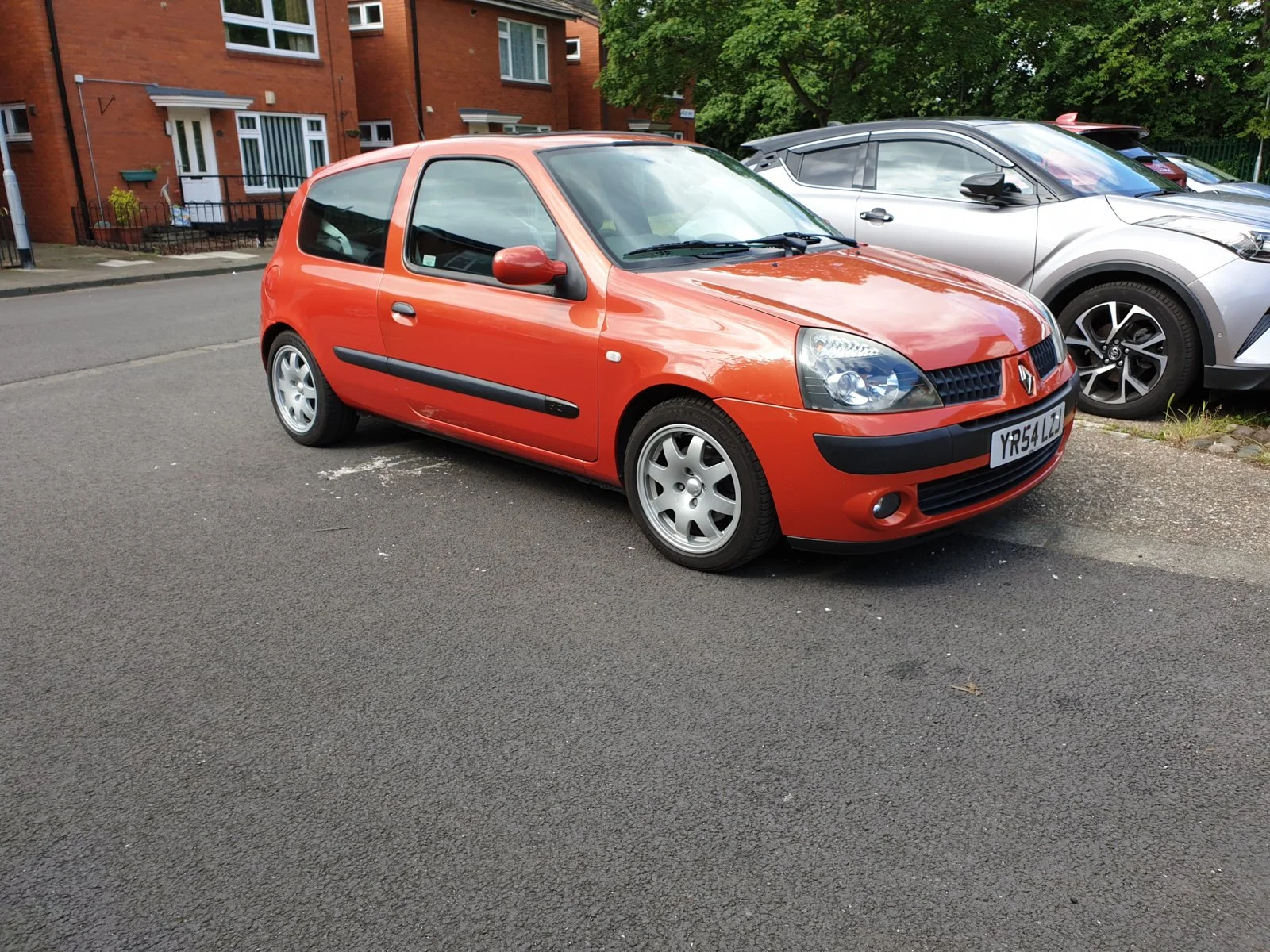

Update, Orange dci is running great touch wood, been doing loads of miles in it 500+ some weeks. 64mpg everywhere, quick reckon up and £200 profit on fuel this month which all goes back in the kitty for wear and tear & for when that expensive repair is needed.
Give it a wash last night as needed it badly, front wheels were absolutely black with brake dust. Random snaps when out and about at work, crap parking on both occasions :LOL:
Boot always full of gear for work

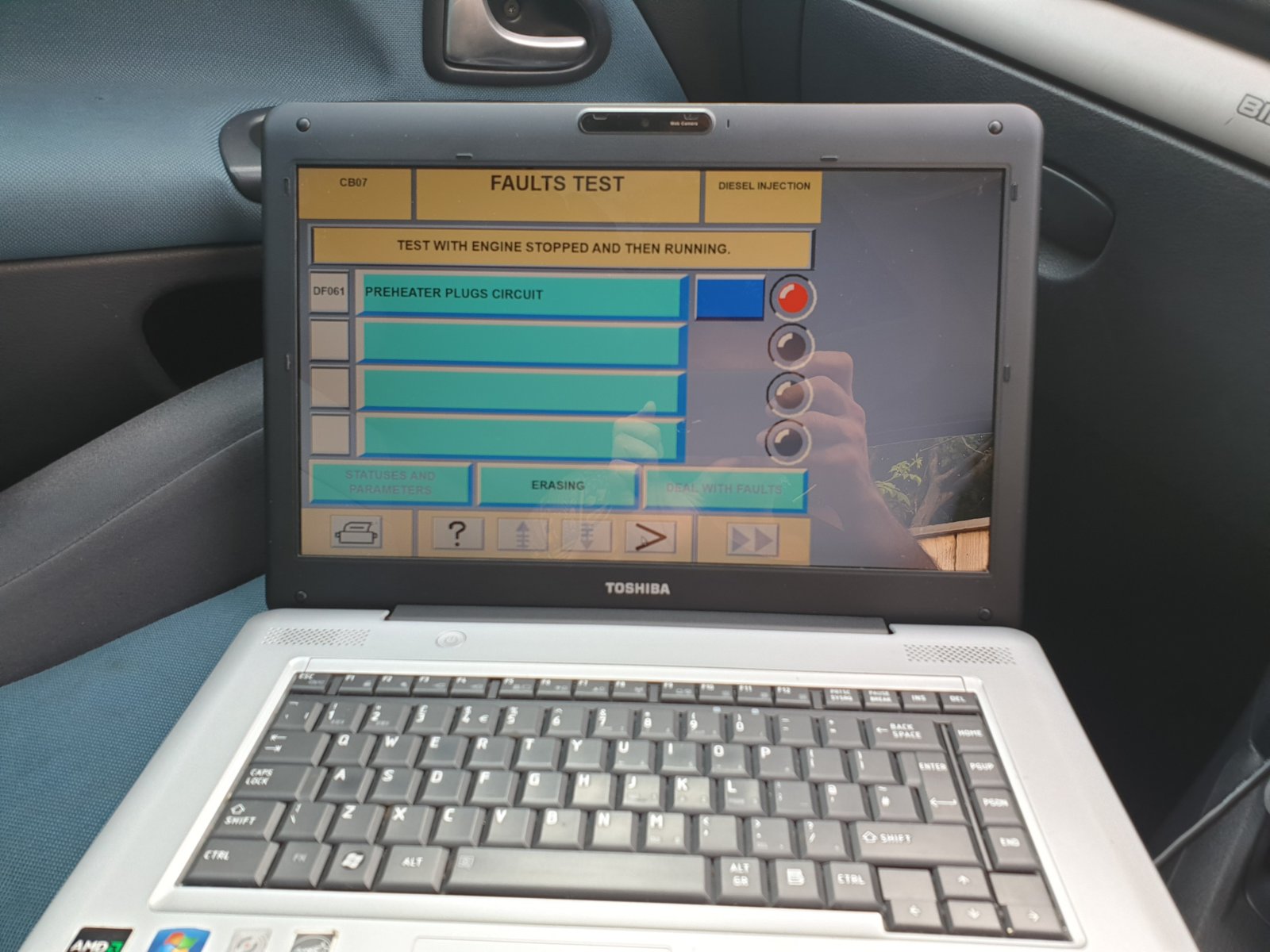

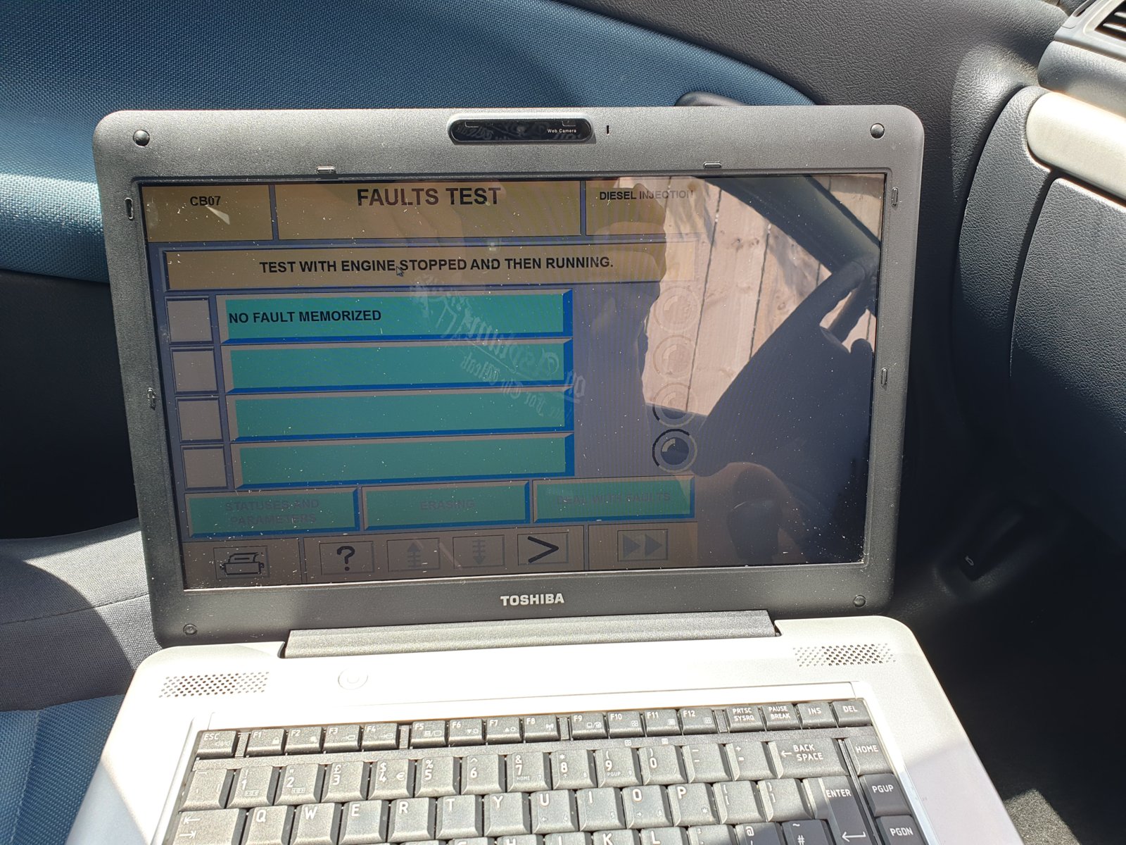

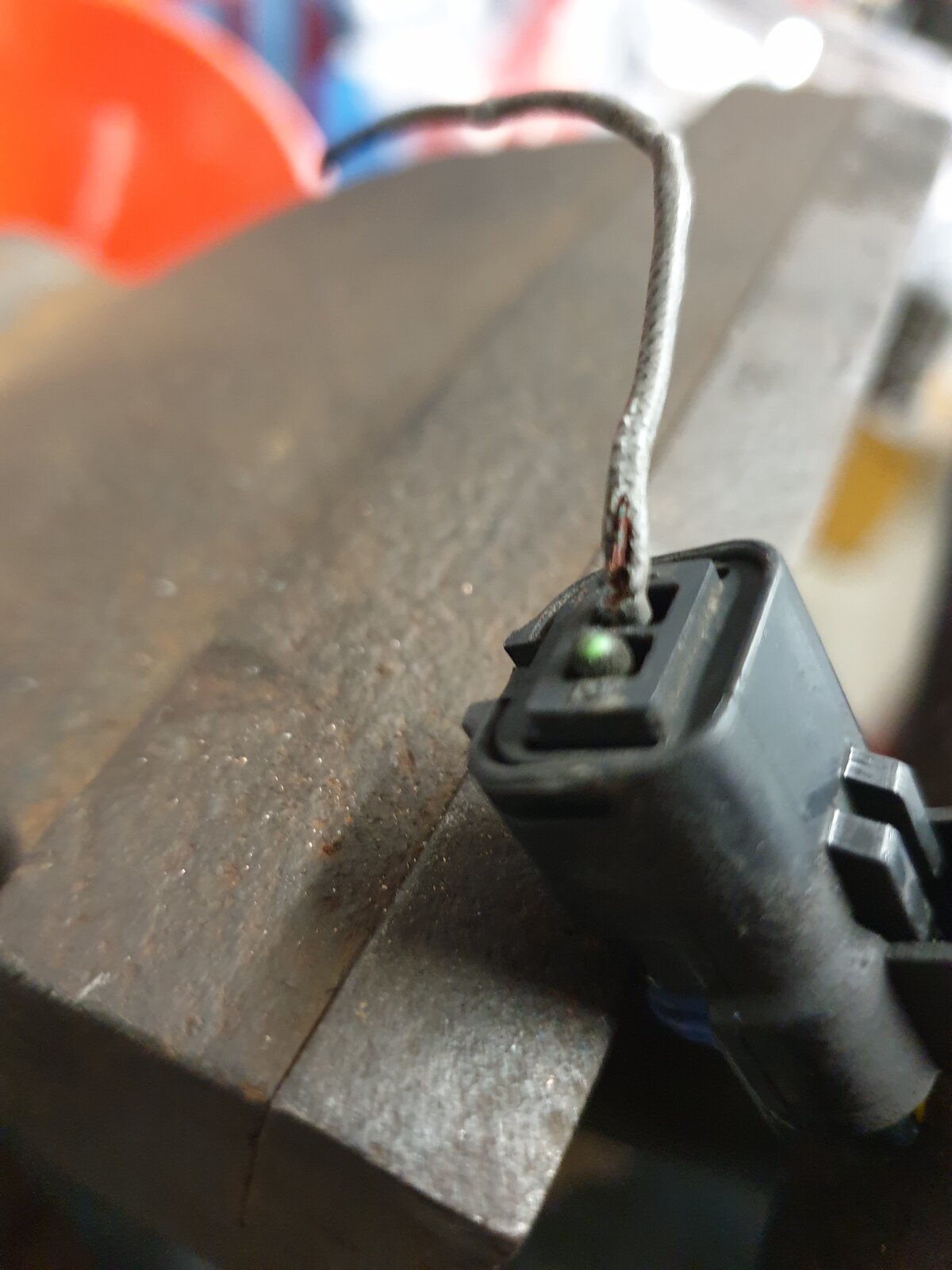

Checked glow plugs today, to see if they were any good, as this fault kept flagging up on clip.
Simple resistance check, number 1 was open circuit, the rest around 15ohms from memory. Because budget project/tight northener/pikey ? just stuck one glow plug in. I have changed tons of heater plugs on older diesels before but dread doing it on modern diesels due to higher chance of one snapping. Give it a good dose of plus gas, ran engine up to temp, nipped it, loosened it, worked it tight/loose a few times, came out ok then new one in, with a bit of copper slip on the threads just incase i keep it for a few years and have to revisit
Ran it up, started fine as usual as engine warm, no faults stored or returned.
Will see if this makes a difference to starting as it occasionally requires a little bit of cranking from stone cold/sat a few days, however 3 goes of ign, cycling the heater light/plugs and it fires up straight away. I get a feeling it will be a leakoff test soon to see how many injectors it needs, but will see.
Simple resistance check, number 1 was open circuit, the rest around 15ohms from memory. Because budget project/tight northener/pikey ? just stuck one glow plug in. I have changed tons of heater plugs on older diesels before but dread doing it on modern diesels due to higher chance of one snapping. Give it a good dose of plus gas, ran engine up to temp, nipped it, loosened it, worked it tight/loose a few times, came out ok then new one in, with a bit of copper slip on the threads just incase i keep it for a few years and have to revisitView attachment 1424588

Is the clip you're using an eBay job or genuine?
My clip is a full chip clone off ebay, works great. Just reprogrammed a megane 225 cup airbag ecu tonight with it, works great with new win 7 laptop.

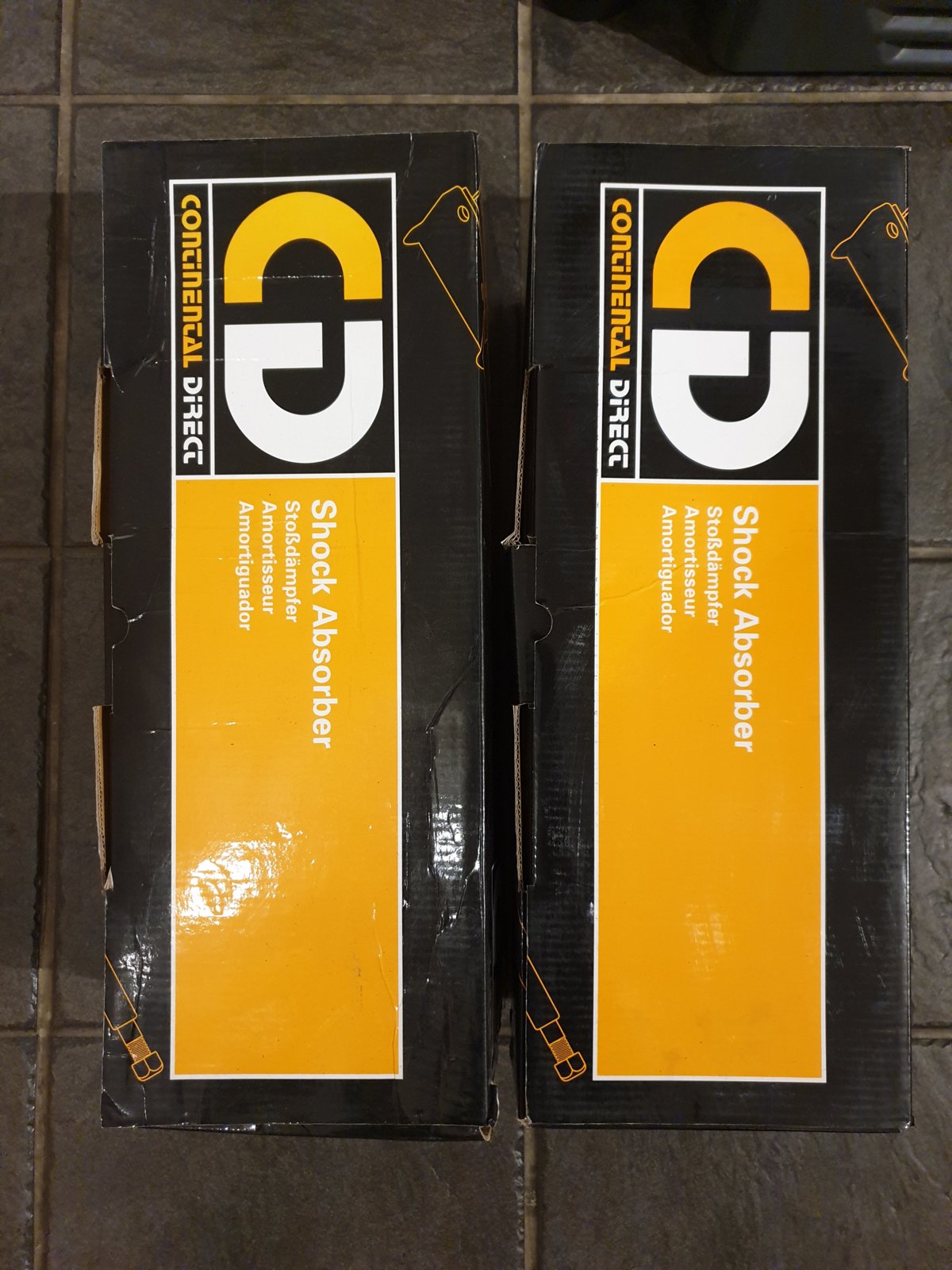

Which shocks did you get? I’m looking to order some ASAP, with springs. Full refresh is needed.
Ive bought some ebay cheapos continental direct is the brand, no idea if related to the tyres or not. £45 delivered for a pair, look ok cant be any worse than the current ones. Current drivers one is absolutely rotten, looks like the cup is ready to fail, and no damping whatsoever, but dry as a bone so mot pass lol.
I have sachs front dampers from euro on the orange dci, a bit more expensive but seem to be good with the eibachs and cup rear dampers.

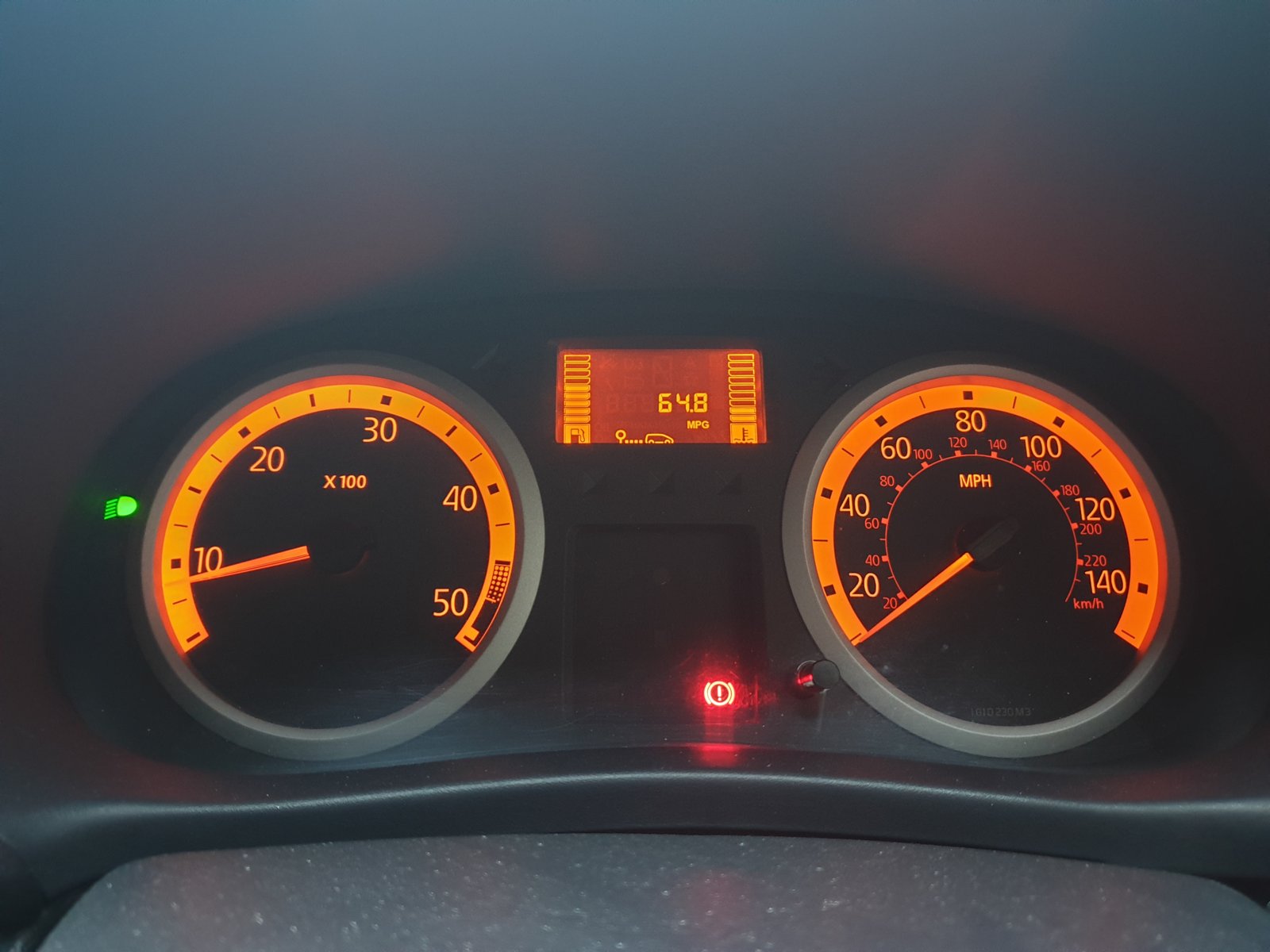

Oraage dci is running epic touch wood, flying along and 64.8mpg everywhere. Its done mega miles recently compared to last few months.

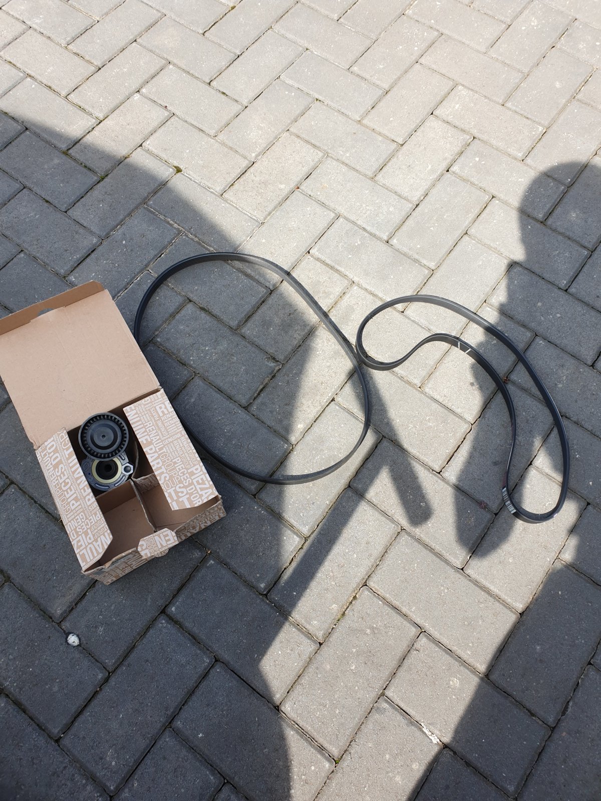

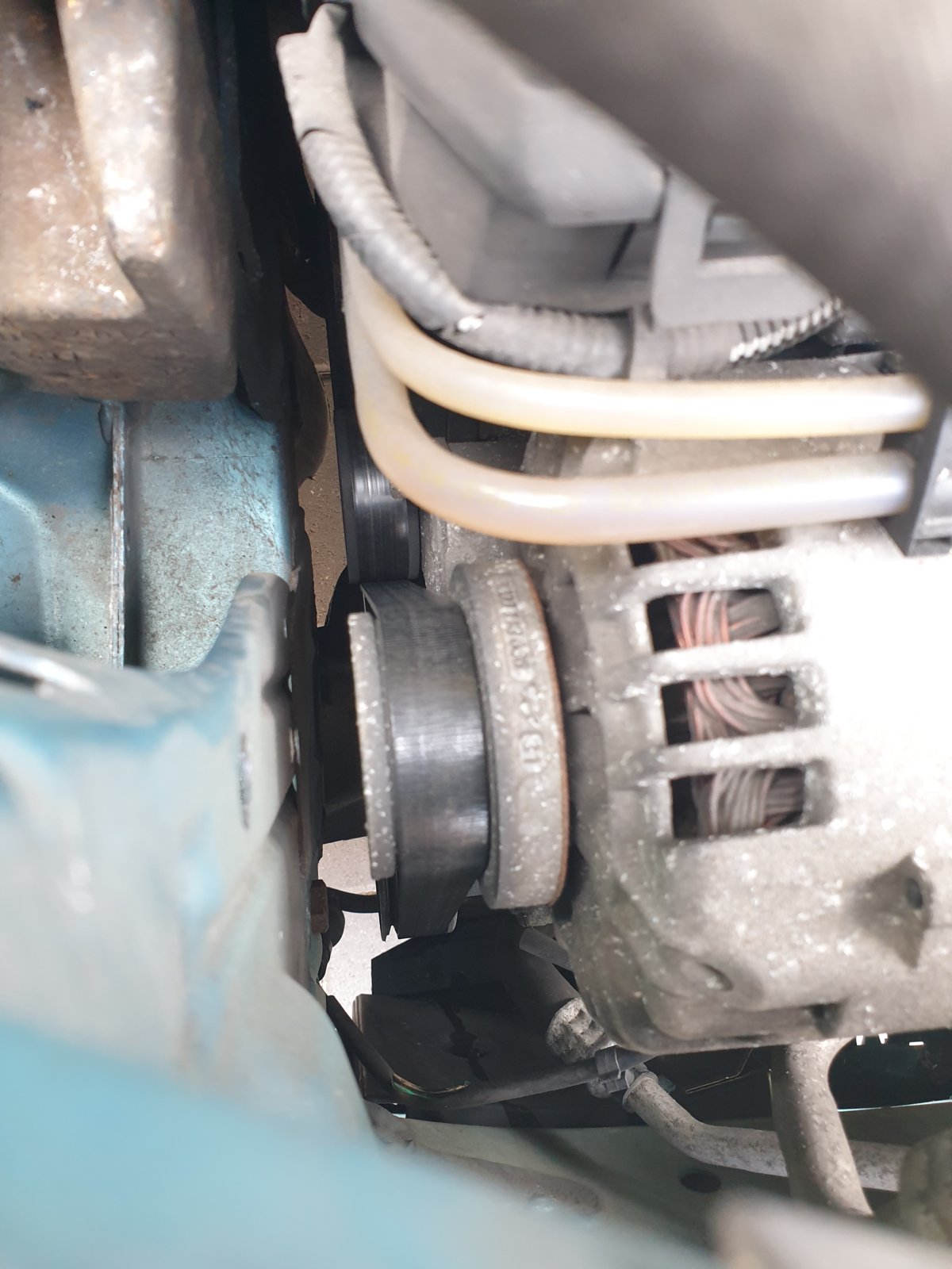

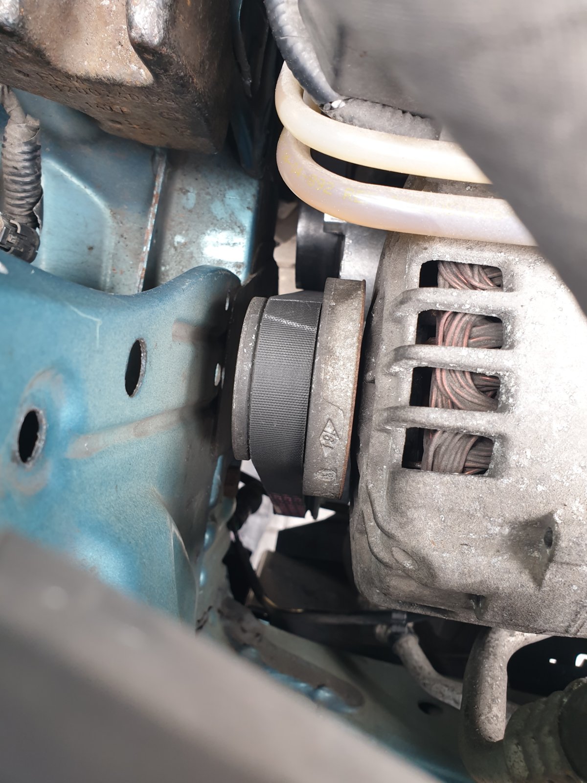

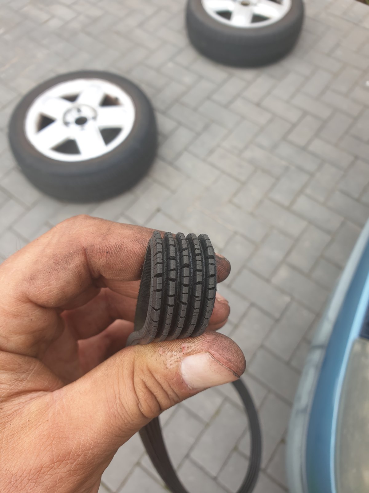

Started with changing the aux kit for a new genuine Renault kit, as was chirping on startup and some monkey had fitted the aux belt in the wrong groove on the ac compressor

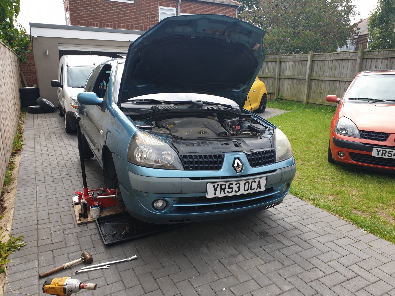

Assume position
Spot the problem
New belt and tensioner fitted correctly, easy job half hours work, no more chirping

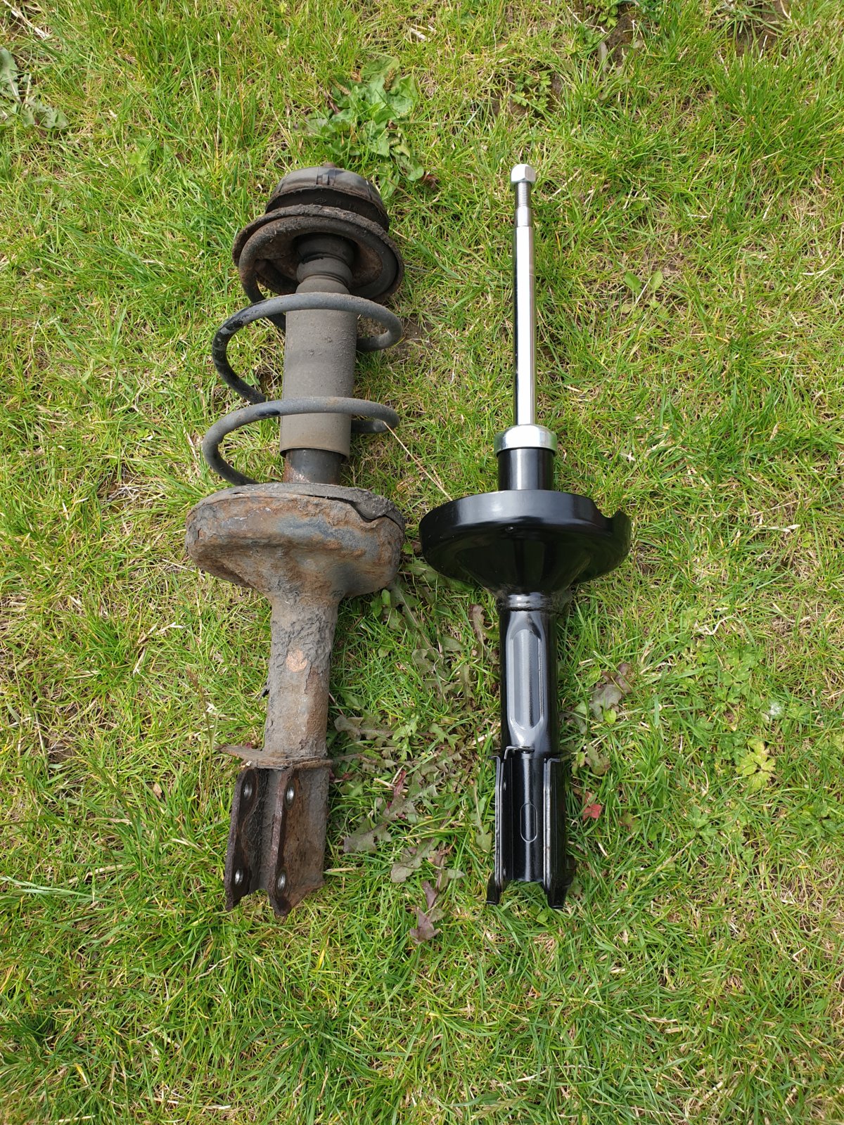

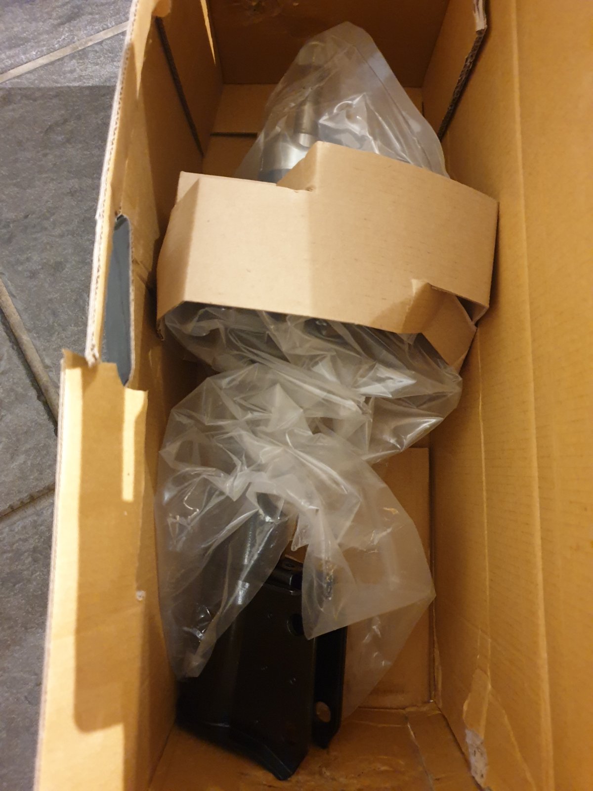

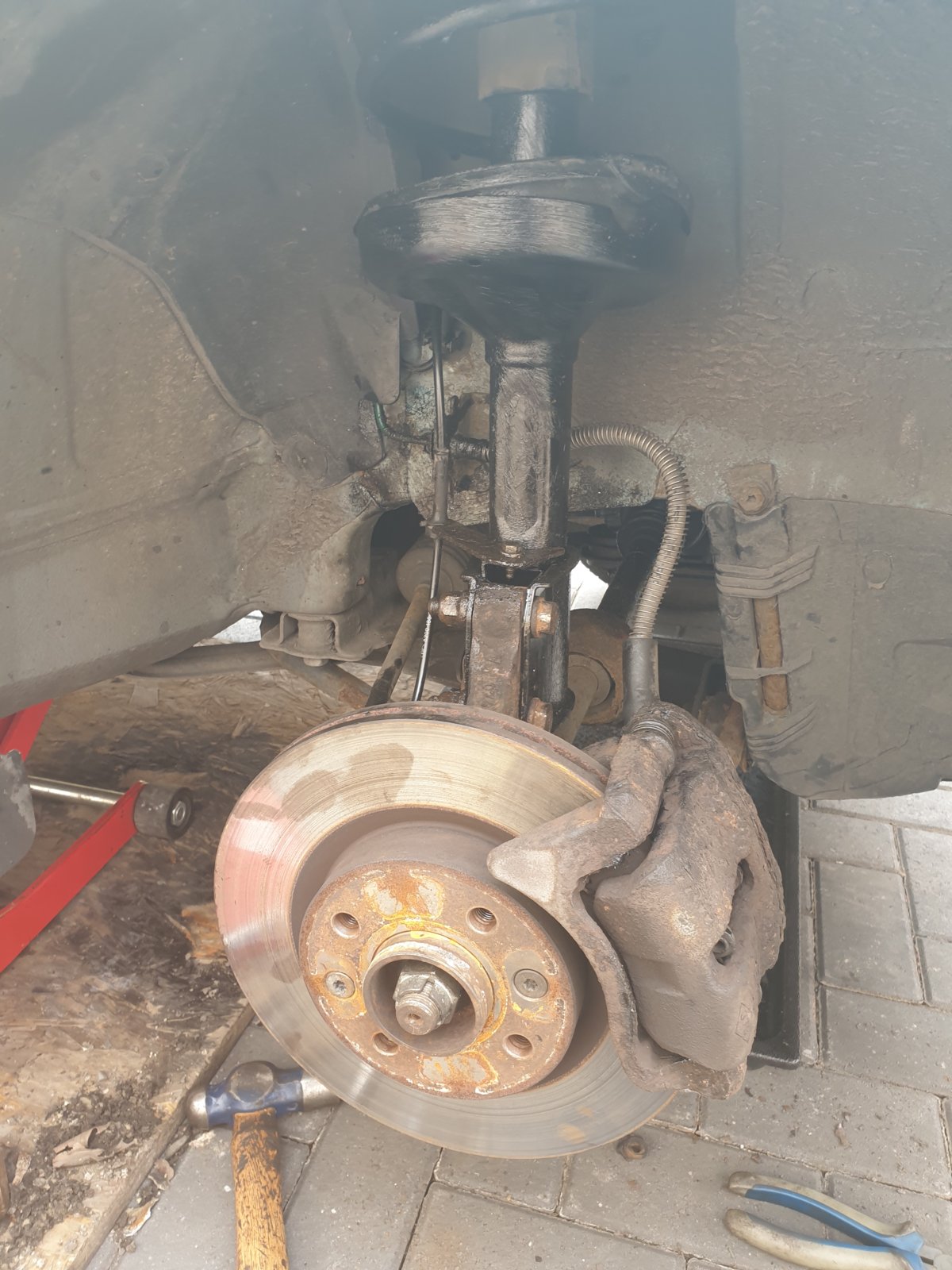

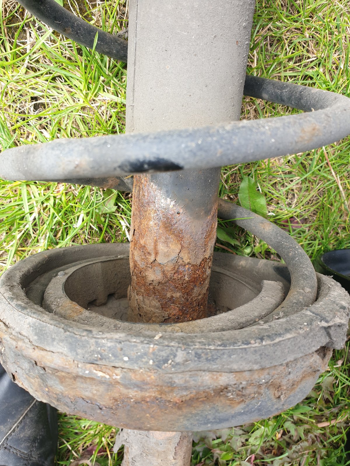

Fitted the new cheapo shocks, originals really rotten cup nearly went through on drivers.
Fitted

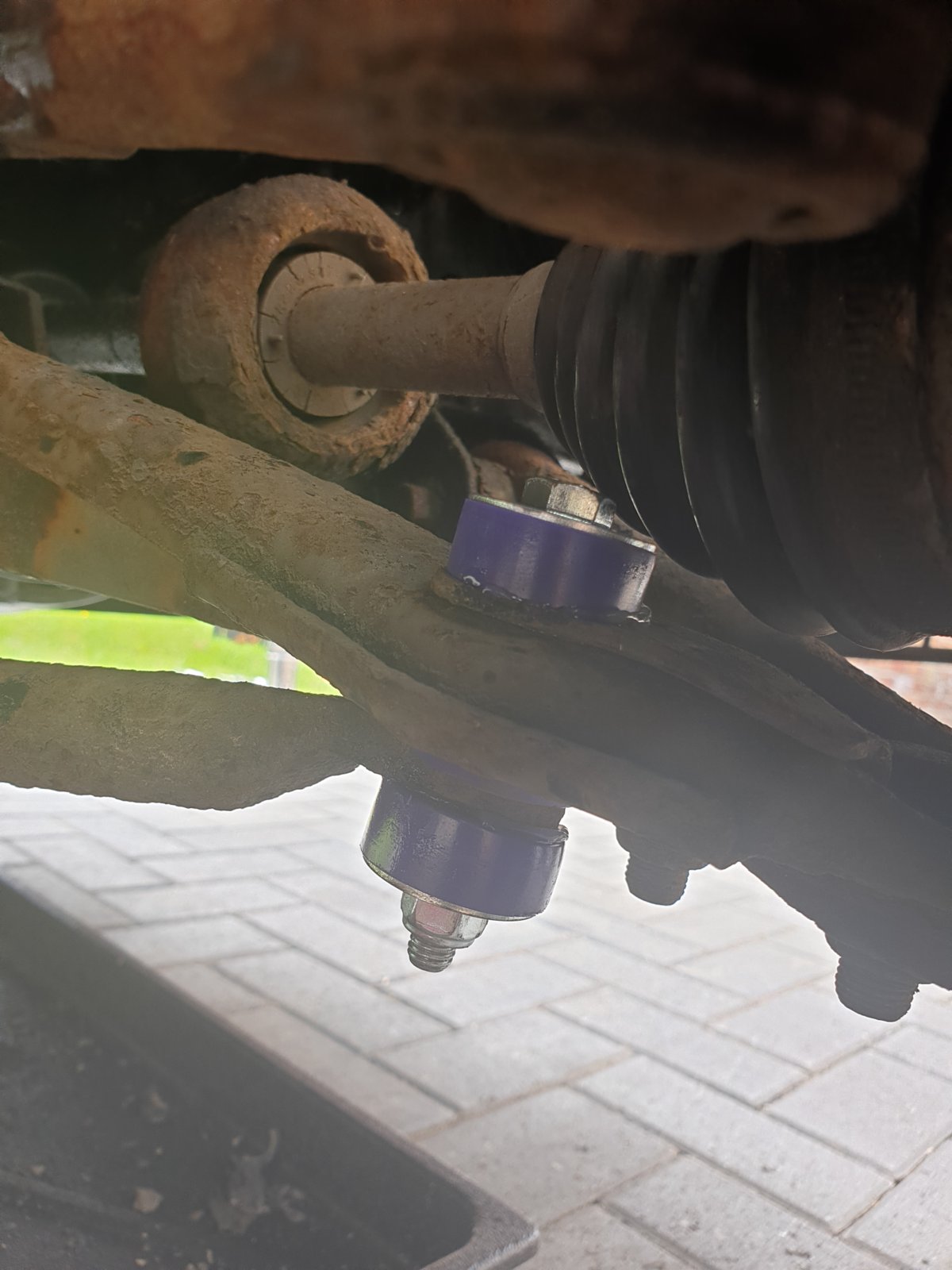

Powerflex poly arb outers

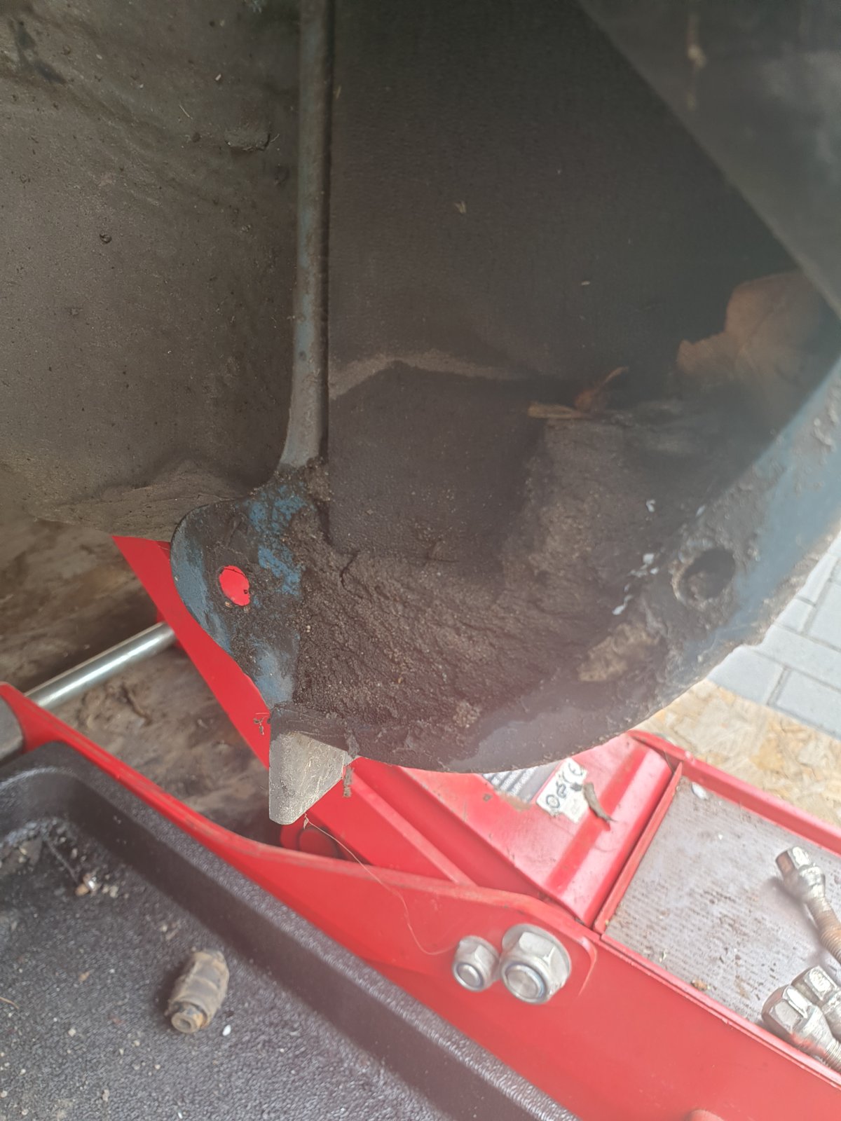

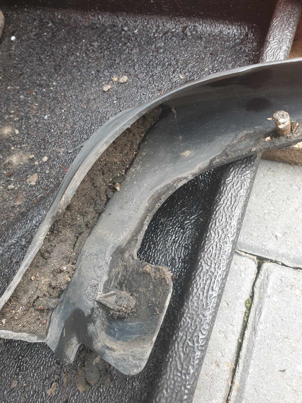

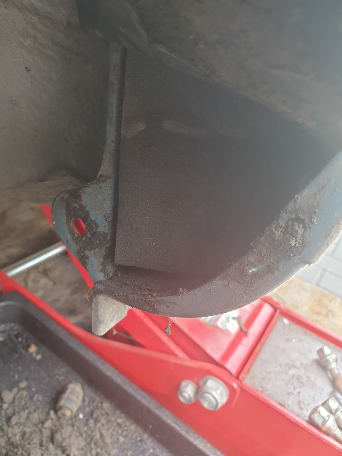

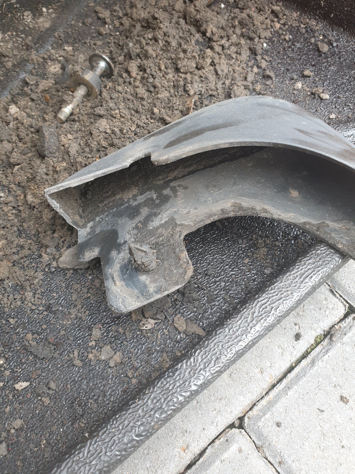

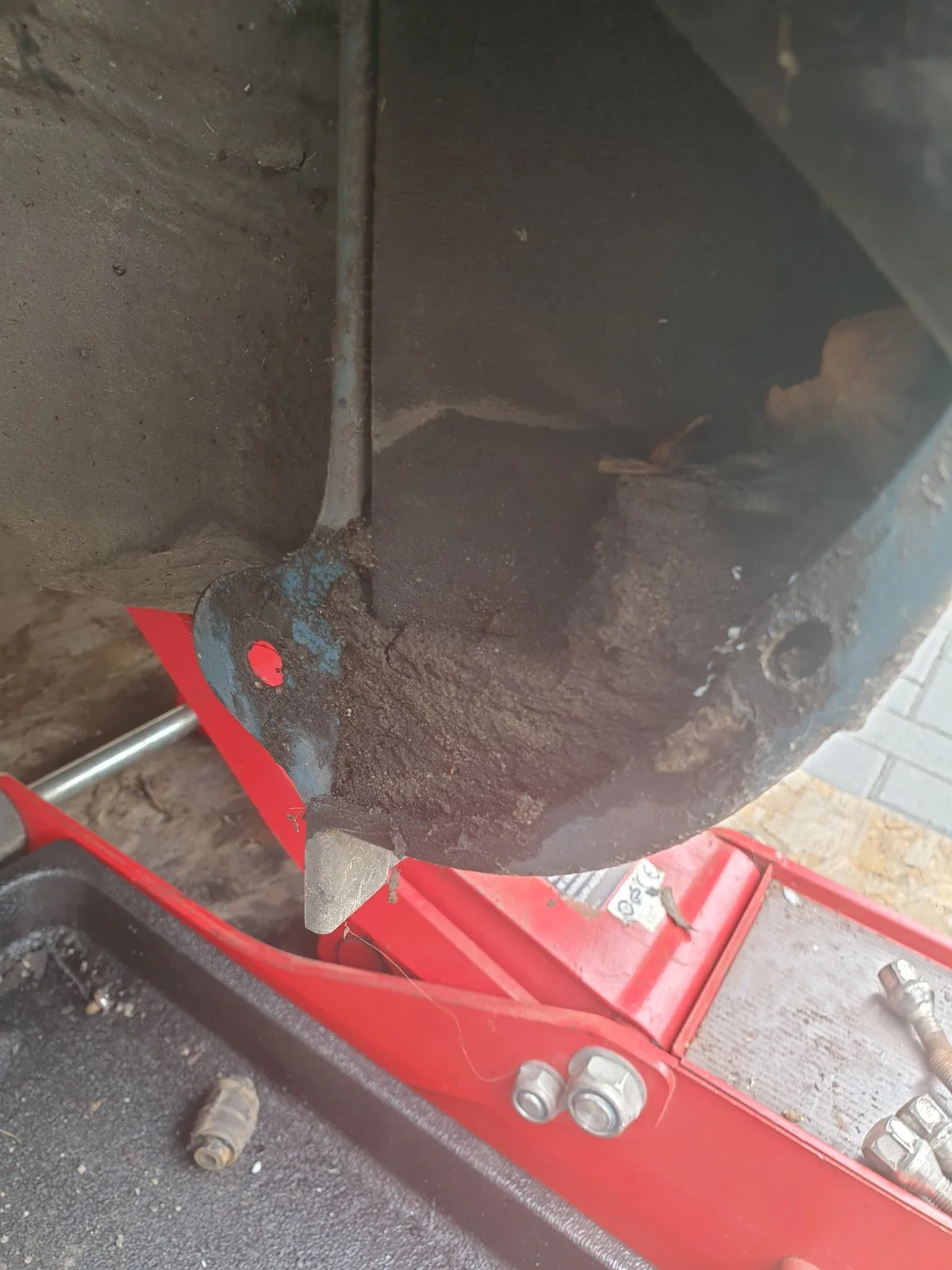

Cleaned arches whilst on jack, full of road muck, same with mudflaps
Probably never been cleaned
Quick wash, presentable enough for now

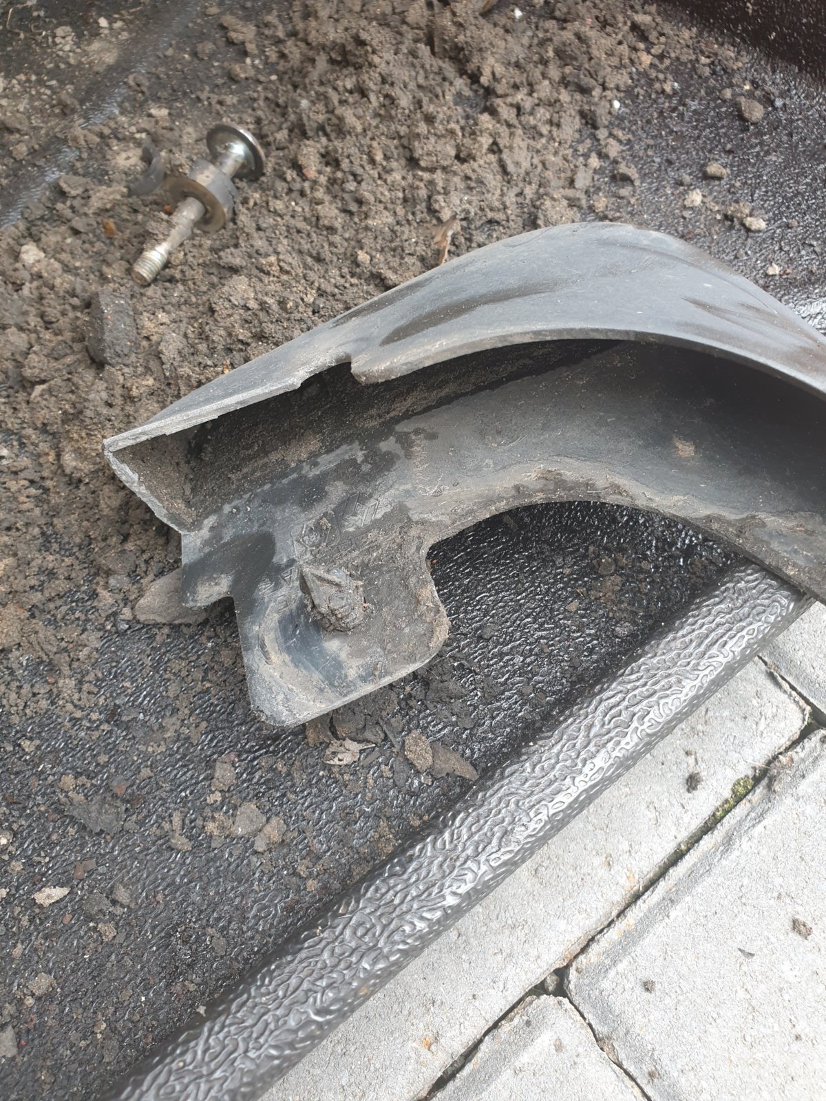

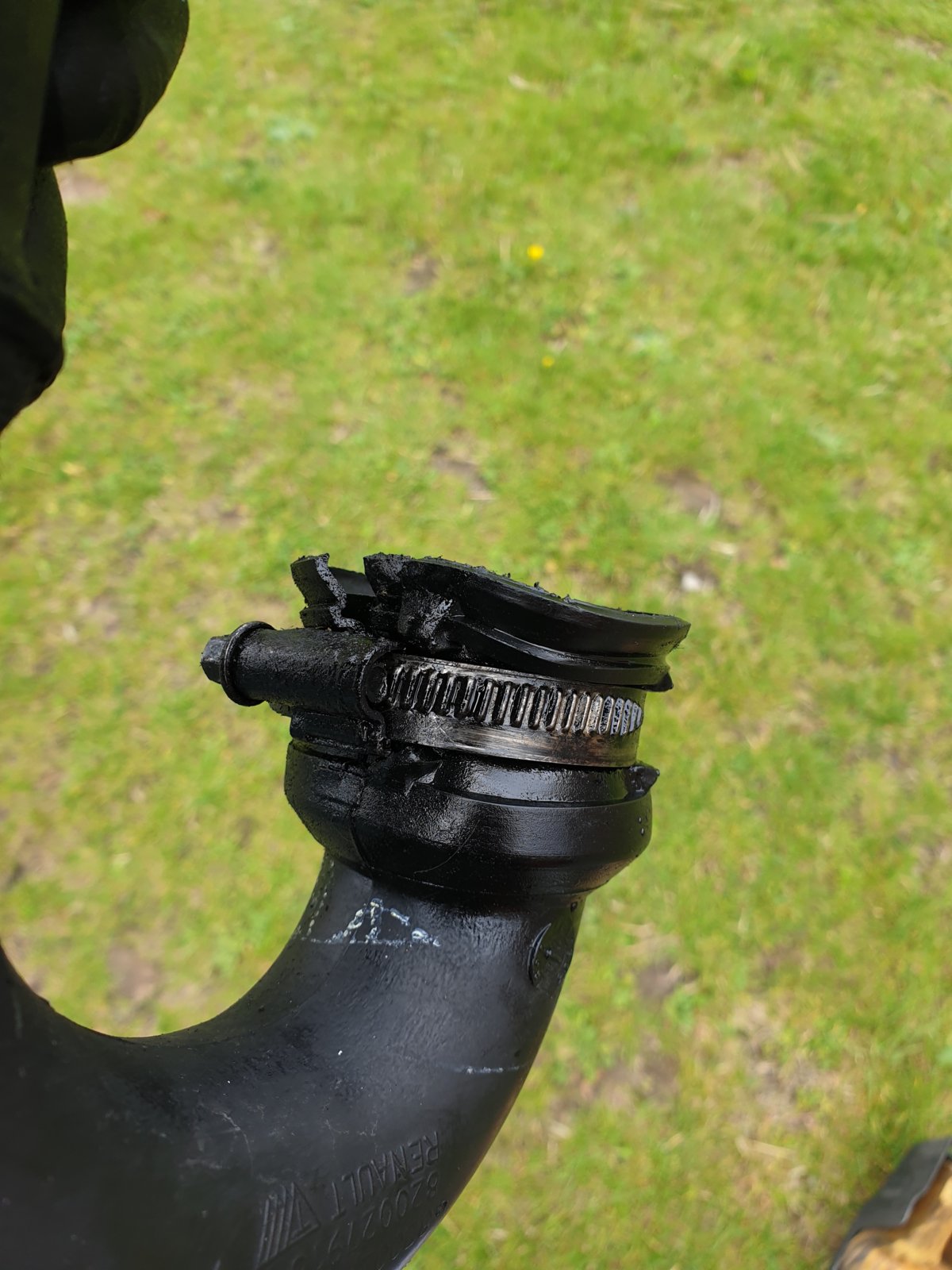

Took it for a test run and could smell oil and turbo whistle, investigated and found that the plastic boost hose is split both ends. Not sure if turbo is a bit smokey, will fit new hose and go from there.

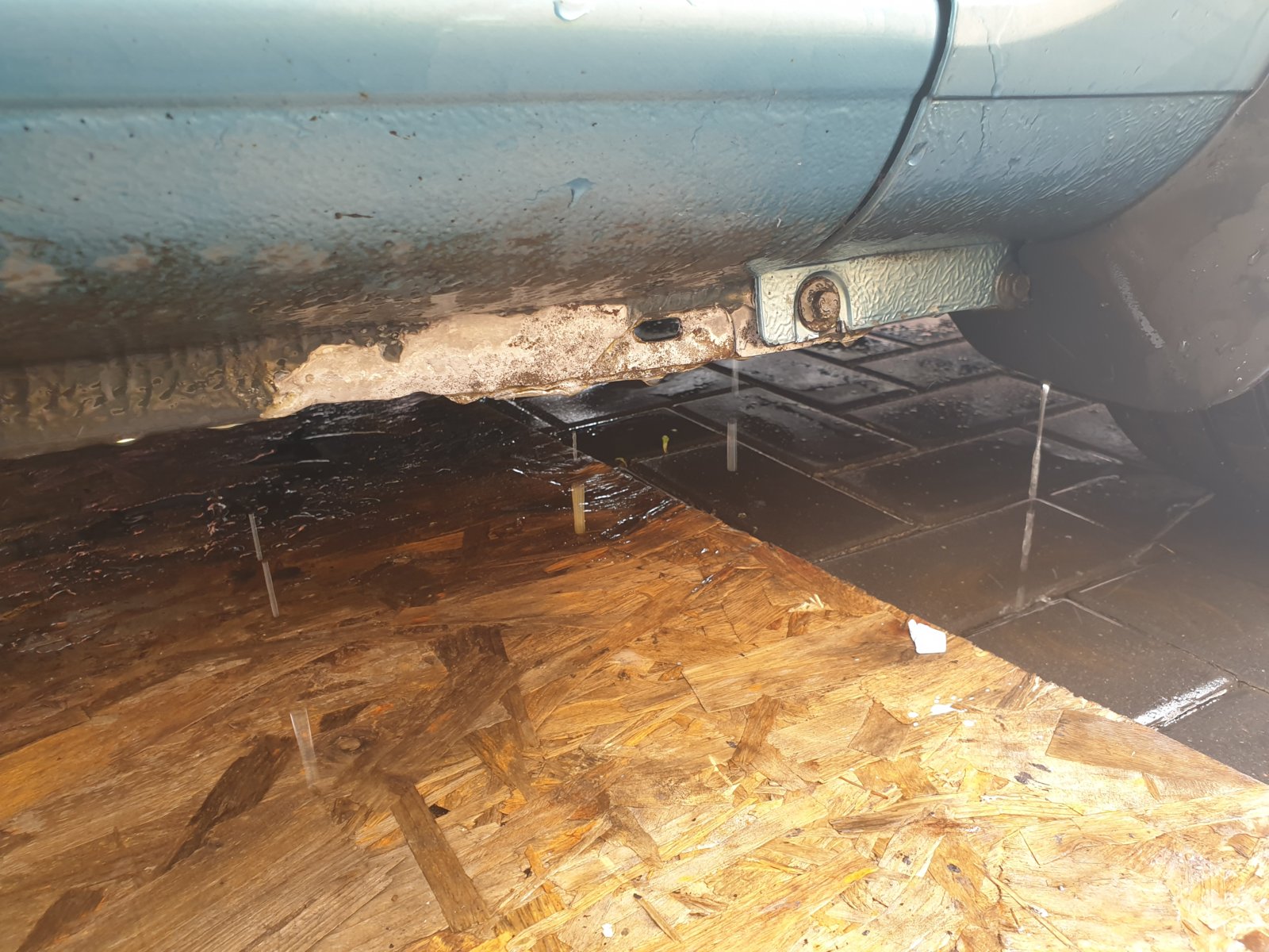

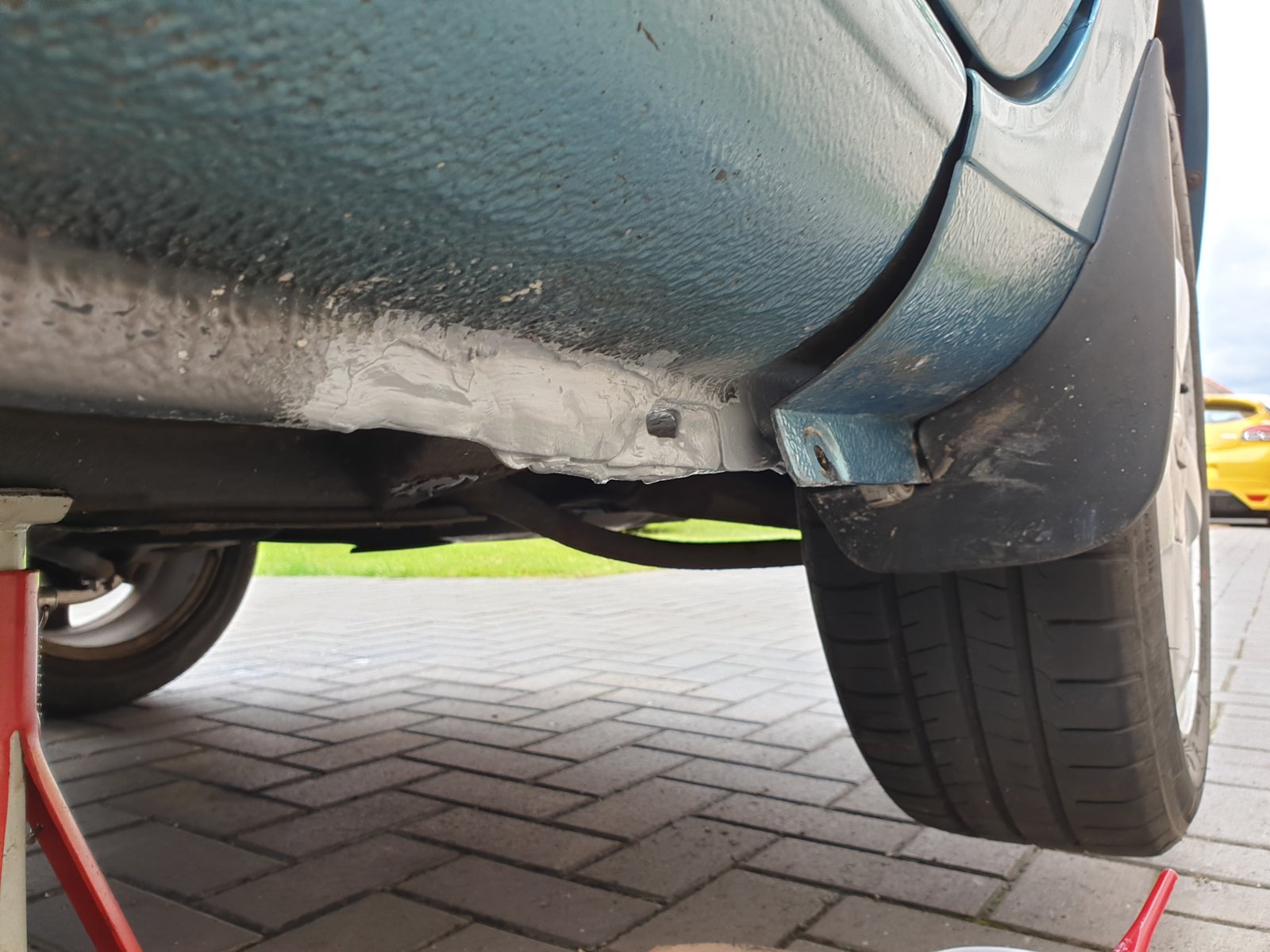

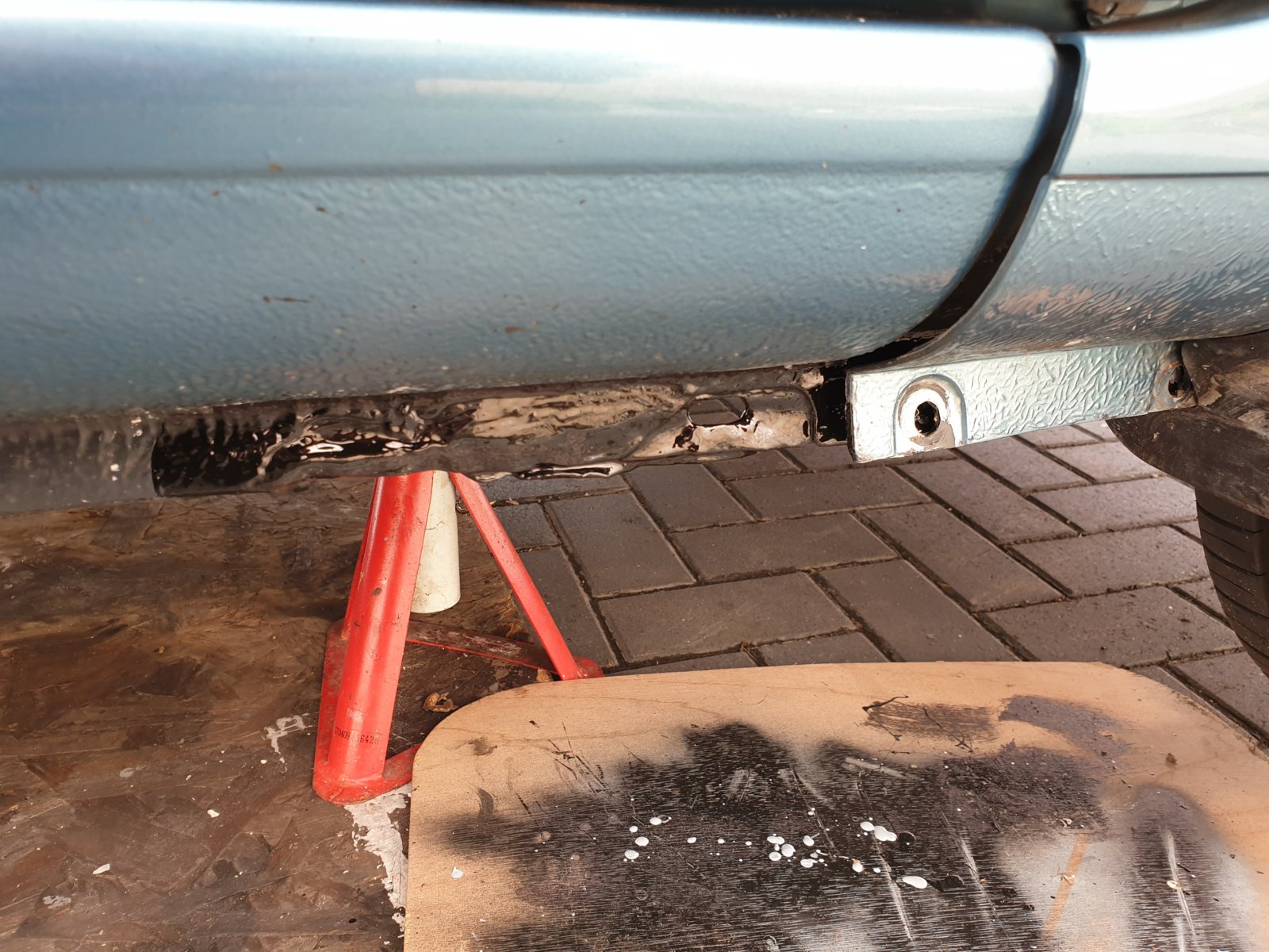

Some monkey had crushed the sill on drivers side, so hammer and grips to straighten. Was covered in surface rust, so coated with Bilt Hamber deox gel. Have applied more since and its come up great, will paint it through the week.
View attachment 1426881View attachment 1426877
View attachment 1426883View attachment 1426884

Some monkey had crushed the sill on drivers side, so hammer and grips to straighten. Was covered in surface rust, so coated with Bilt Hamber deox gel. Have applied more since and its come up great, will paint it through the week.View attachment 1426874

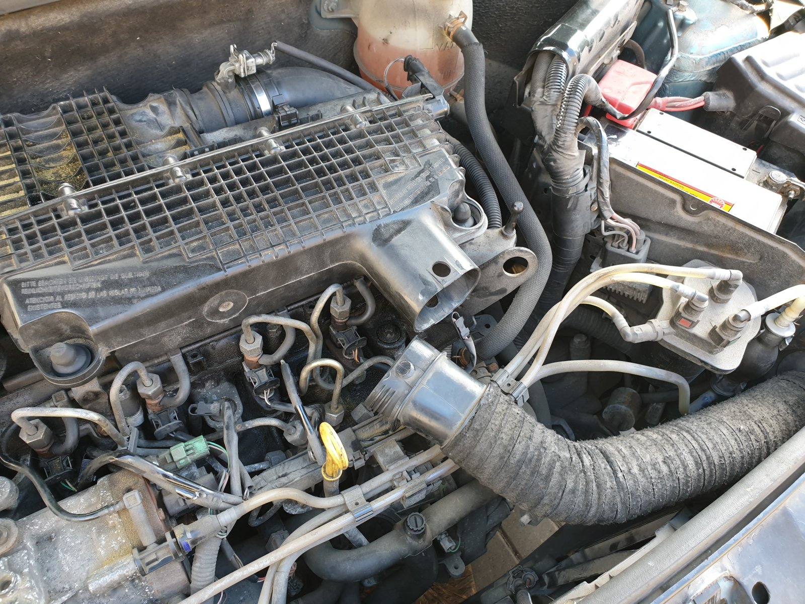

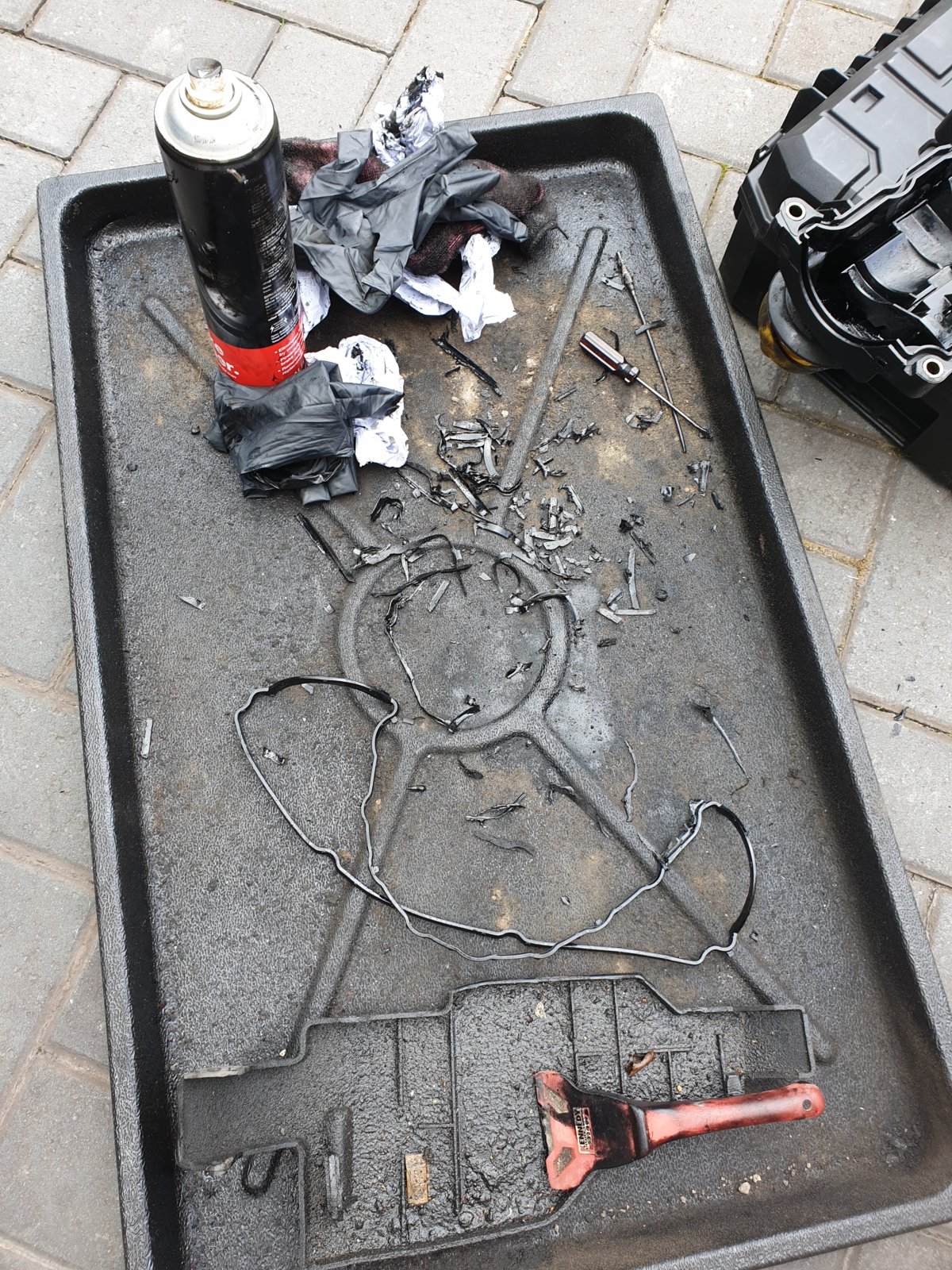

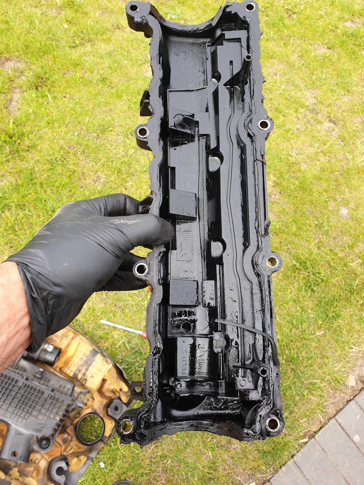

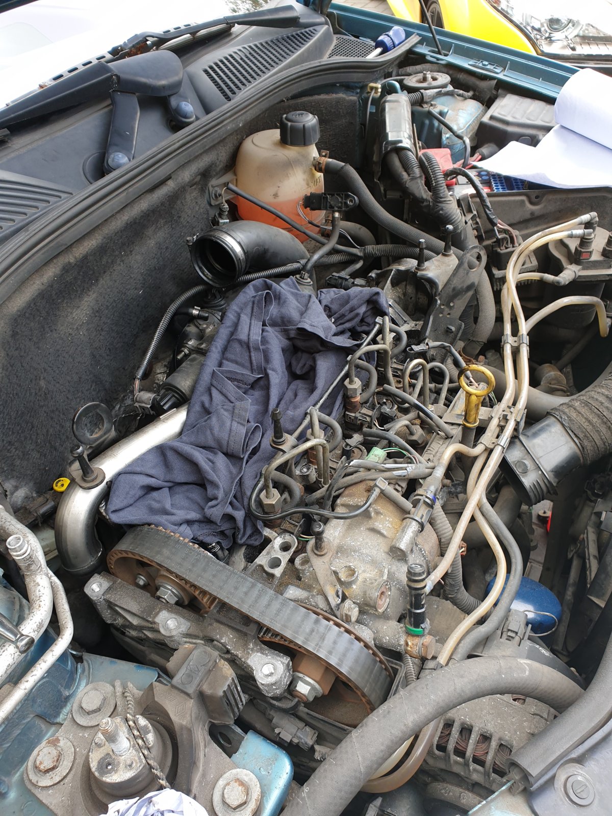

Whipped engine mount off to check timing belt. Its a dayco belt fitted, so has definitely been done in the past. Not keen on dayco belts so i almost ripped it off and done it but will leave it until another time.

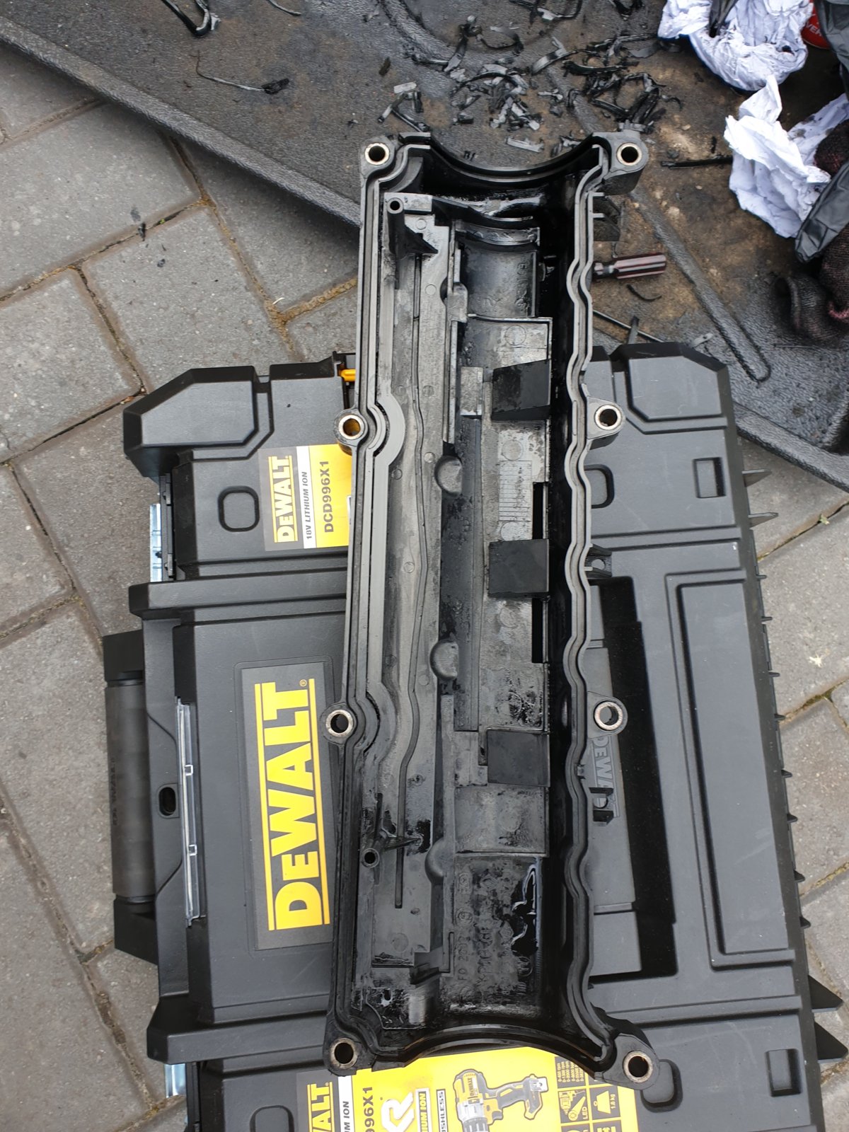

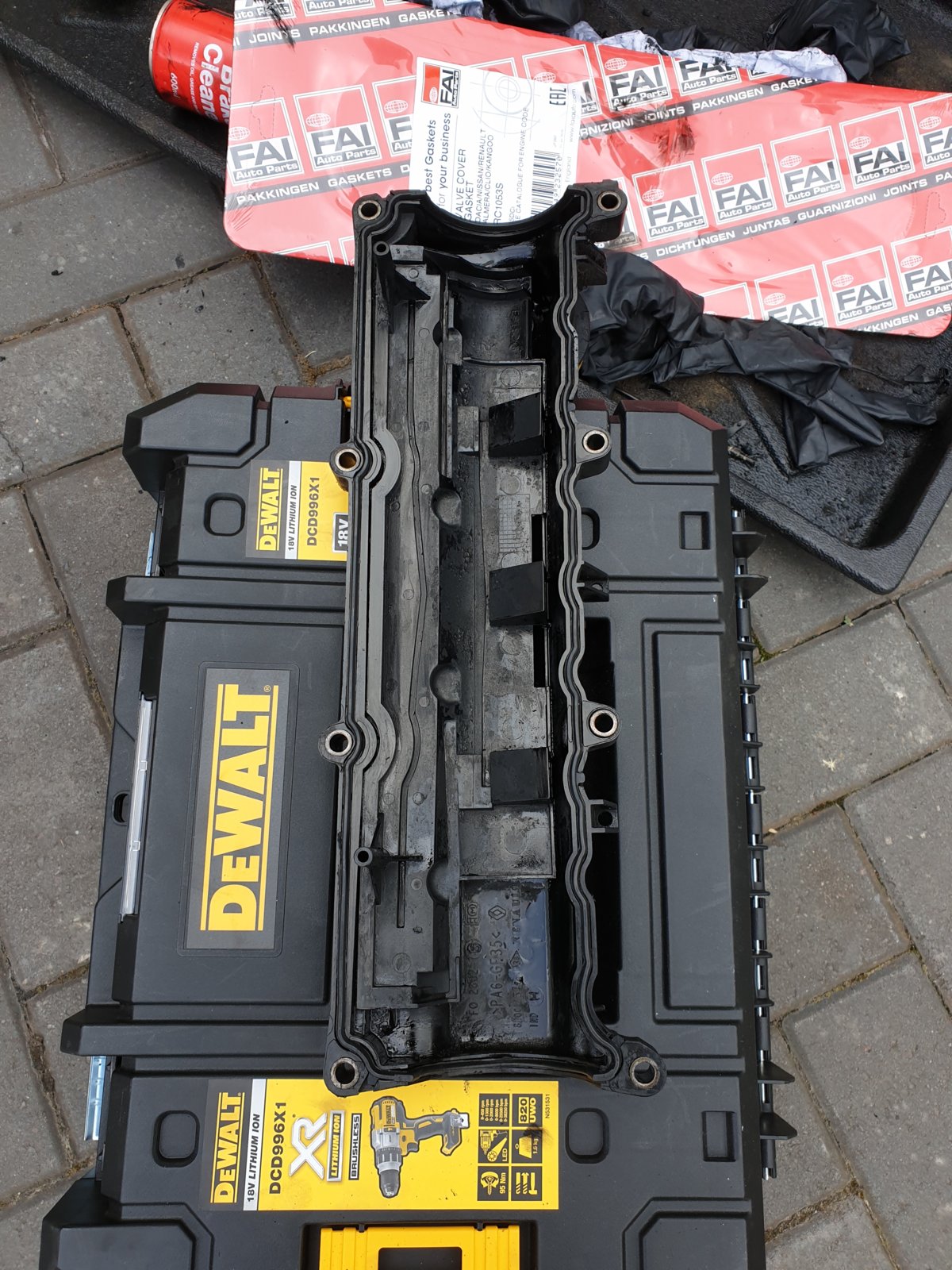

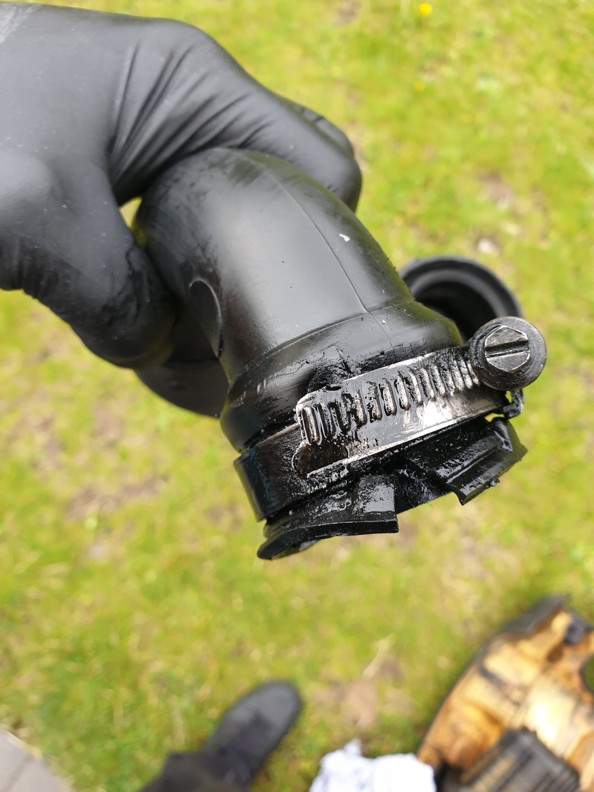

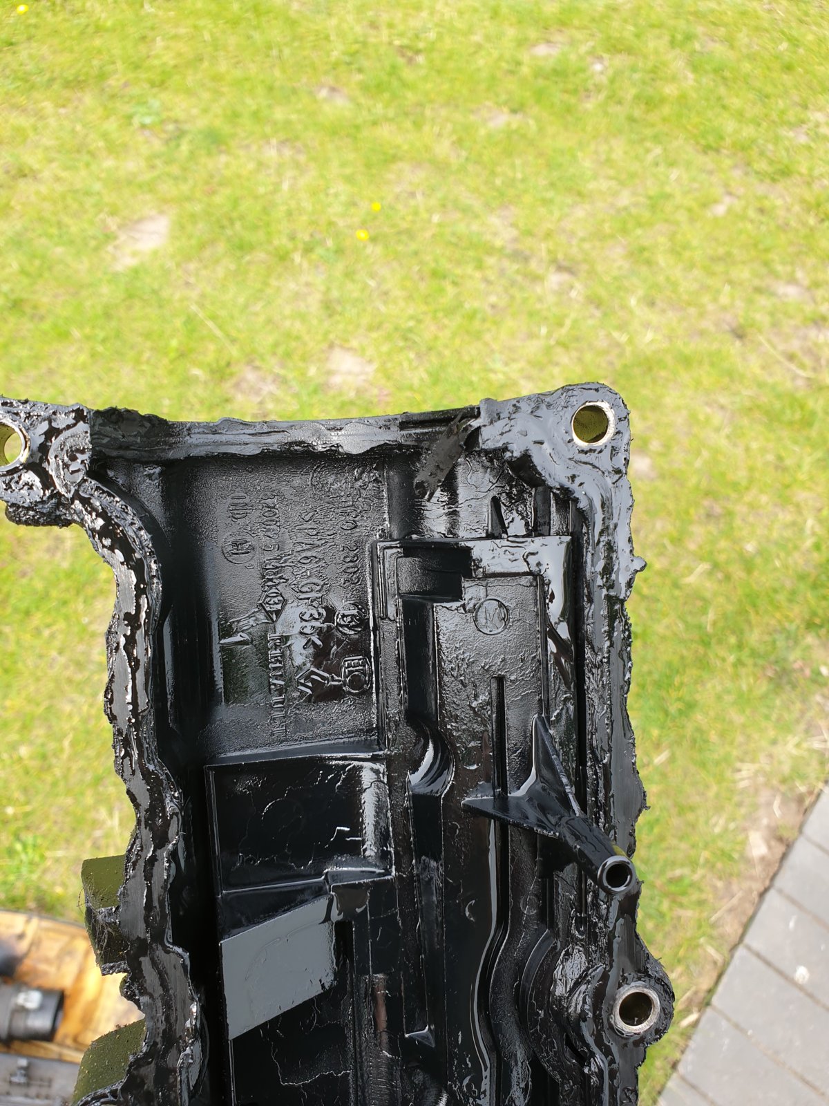

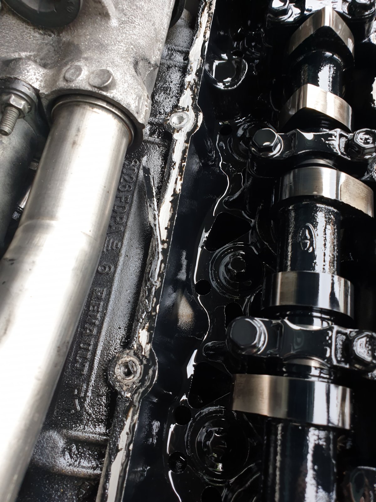

Main issue was rocker cover gasket and boost hose. Pulled it to bits in ten mins, as expected f**k loads of instant gasket, could not see the original gasket for sealant. Bodge job instead of replacing the £6 rubber gasket..id bet my bottom dollar this has been to the local bodgit and scarper garage, the mechanic hates anything french and just does a s**t job of any repair because hes useless.
Lovely job by whoever had done it.
30 mins of pain getting it off, and fitted a 2nd hand boost hose. See how this goes.

Started by getting some paint on the sill on the drivers side. Cleaned up nice after deox gel, shot some zinc primer over the top of the bare metal. Coat of BH epoxy masic over that
When that had gone off applied a coat of cheap gloss black metal paint over the top. Nothing flash needed, as its fully protected by the epoxy mastic already. Should last a few years longer now and a bit of muck will blend the paint in nicely.

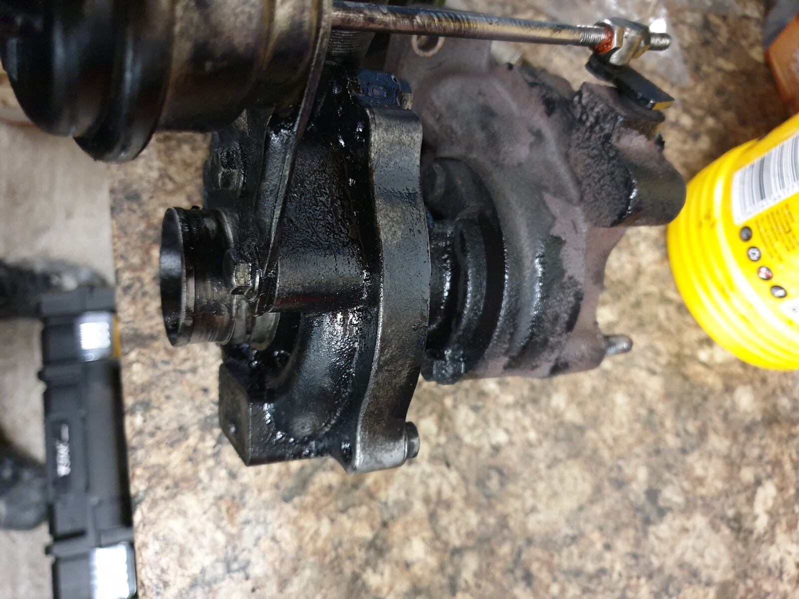

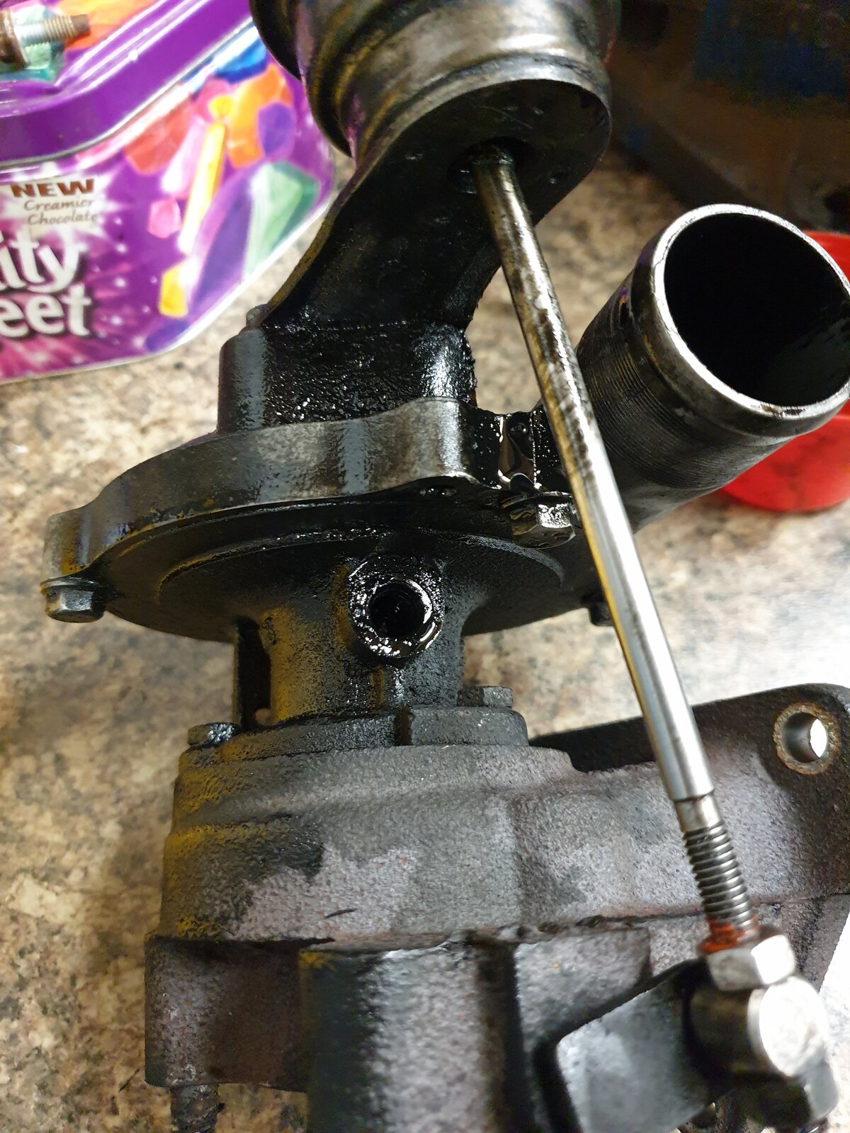

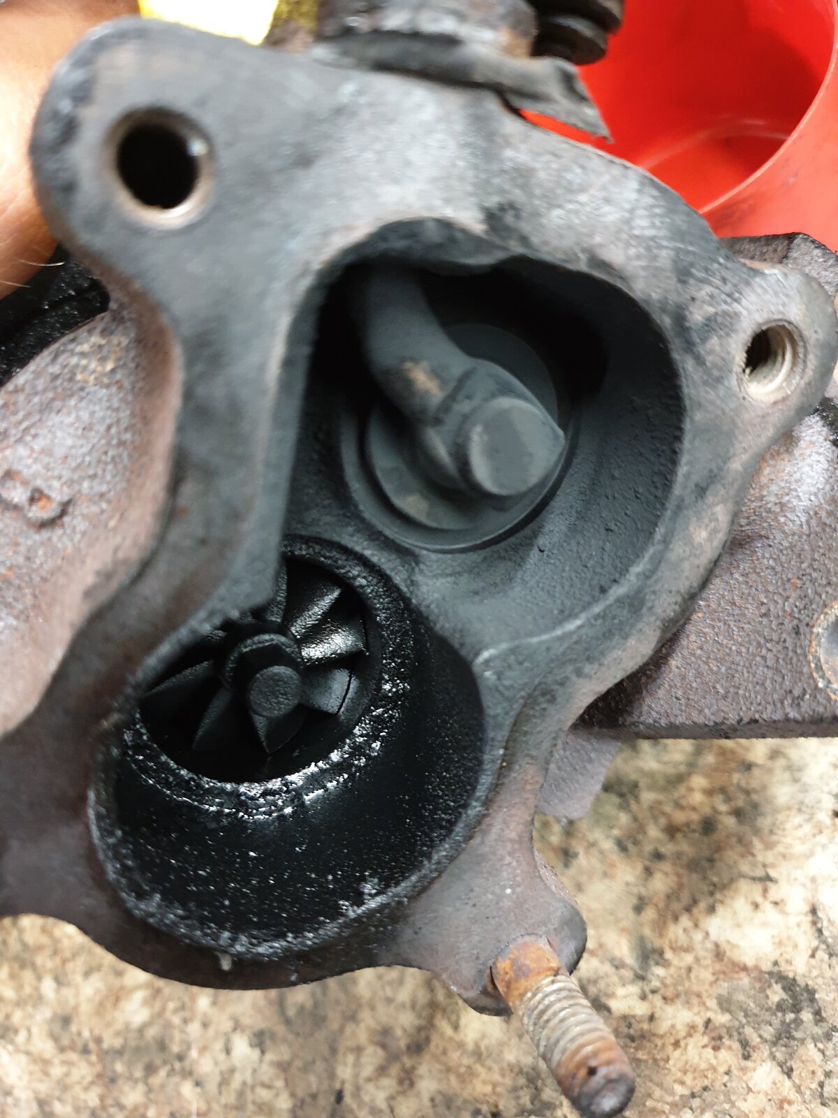

Stripped turbo off the blue dci, as i suspected it was about shot, and sounded like a siren on spool up.
Did not realise it was this knackered until removed, not many more miles left pissing oil all over. Replaced with the fresh one off the scrapper Kangoo

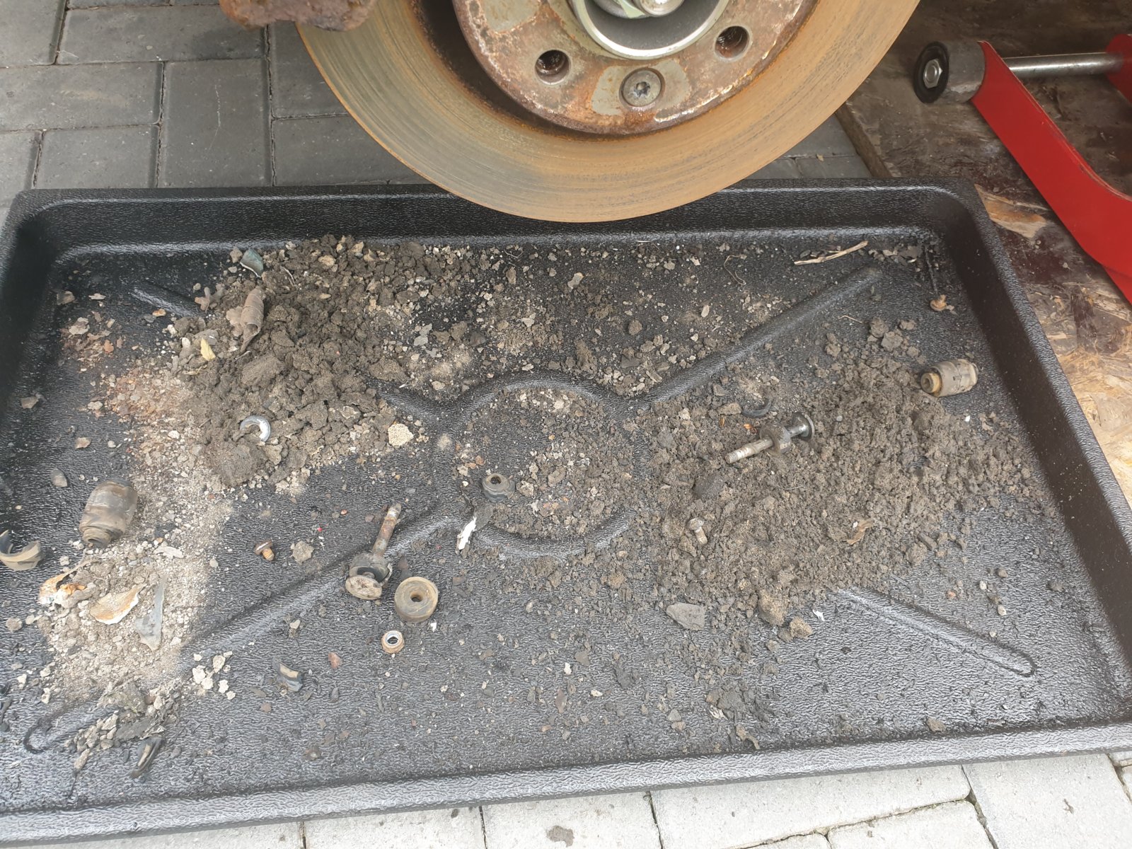

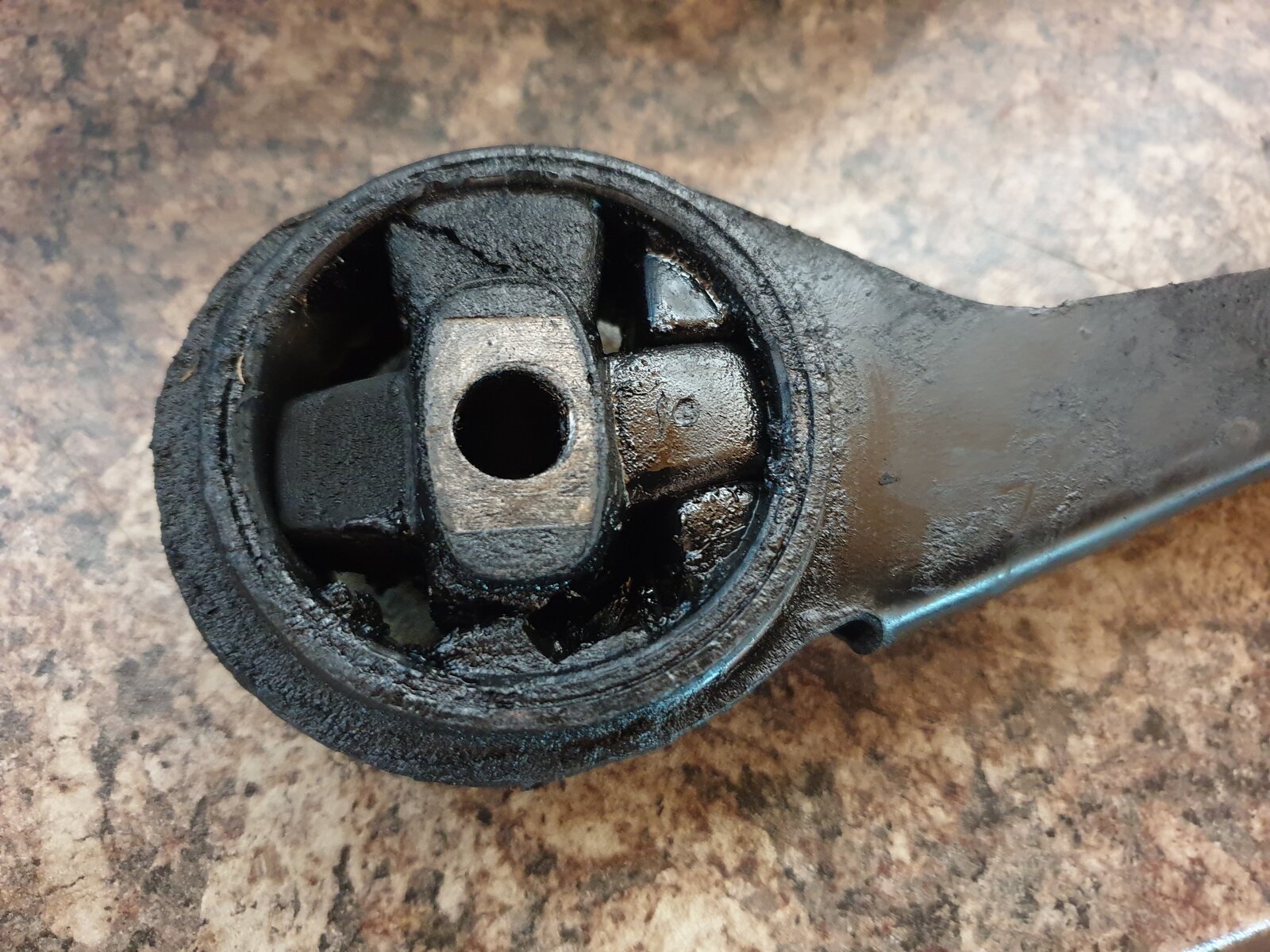

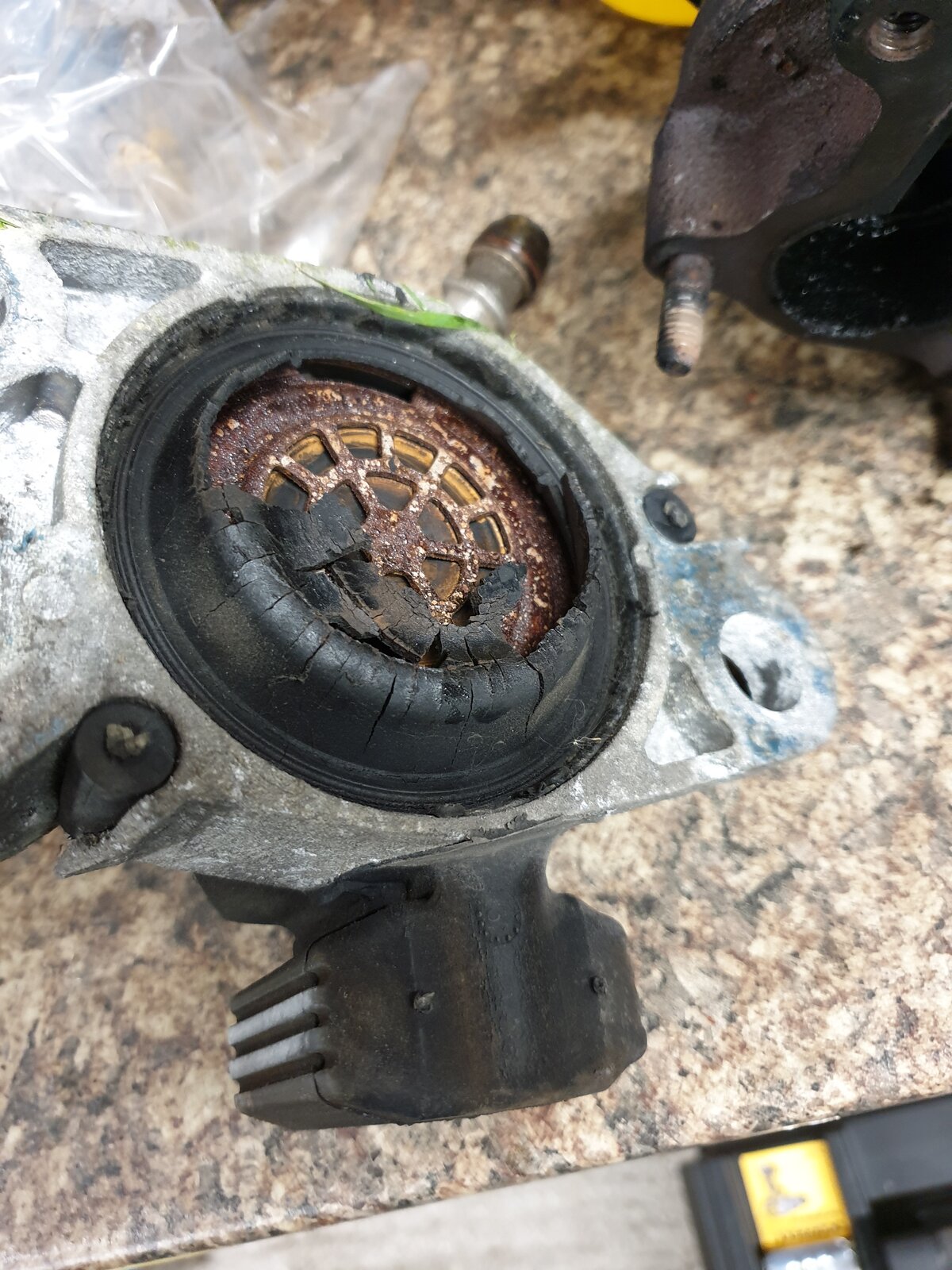

Last time i drove it, i kept hearing a deep knock when going over speedbumps. I highly suspected the top engine mount was knackered, so took it off to examine and the problem was fairly obvious as oil damped. Good 2nd hand engine mount fitted off the scrapper Kangoo
So with that all done, took it for a test drive and running a lot better, smoke free and knock gone. It had a resonation when accelerating hard, which i assumed was dead top engine mount, but was still there when replaced so inspected the dogbone mount and gearbox mount.
Dogbone was fitted backwards by some cowboy so the large bush was fouling the gear linkage on acceleration :cautious: and the bush was torn so replaced with a cheapo dogbone for now

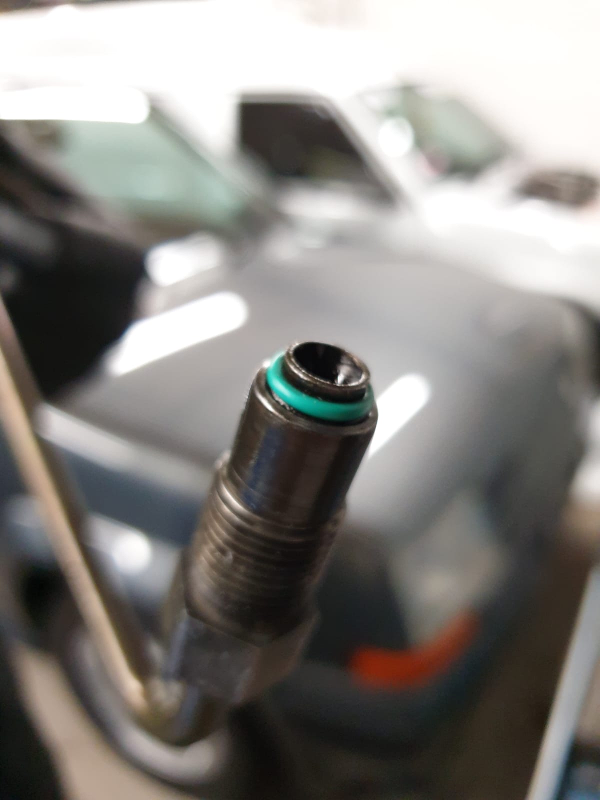

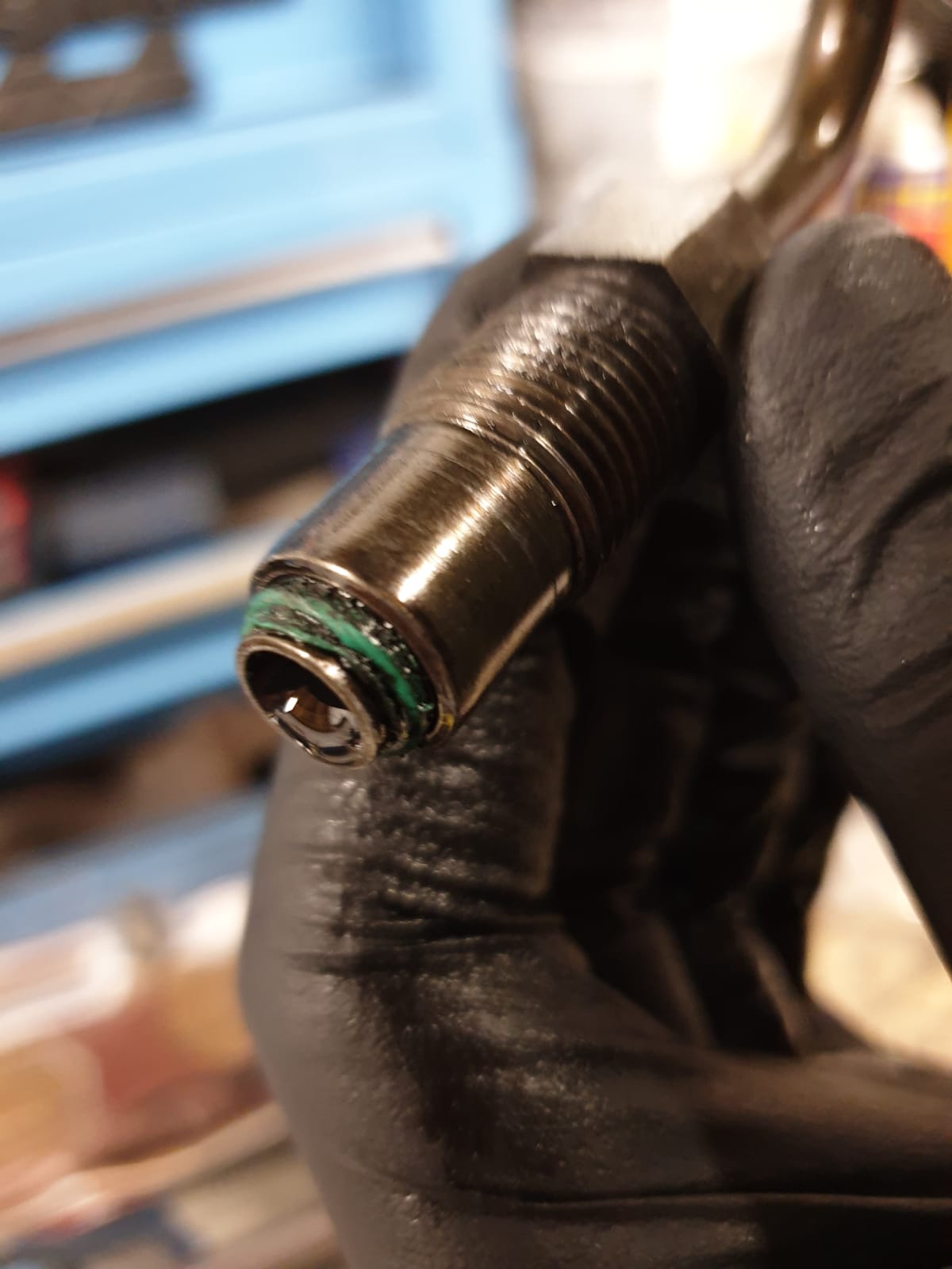

I also bought a pair of aftermarket lower arms and inner tie rods, fitted them and whilst up in the air noticed fresh oil. Looks like turbo oil feed has been off and o ring not replaced.
O ring replaced, and leak free. Had to take a brave pill and flog the fitting up a bit to stop it weeping though, not a great design imo!

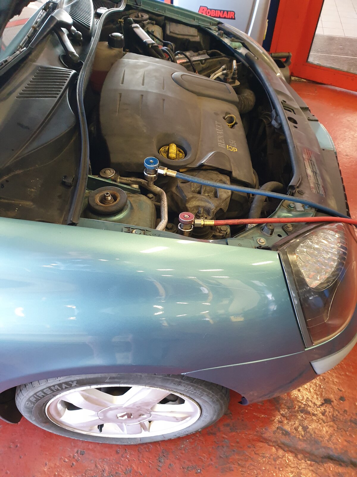

I mentioned the air con needed a leak check as no gas in it, he boshed it on and it seemed to hold a vacuum ok, so gassed it up.
Fired it up when done, and the ac compressor kicked straight in, and the aircon is ice cold, could not believe it. I thought the low speed rad fan had issues, but works fine. So been blasting about today with ice cold aircon in 29deg heat, bodywork is rough, but ice cold ac and drives absolutely sweet.

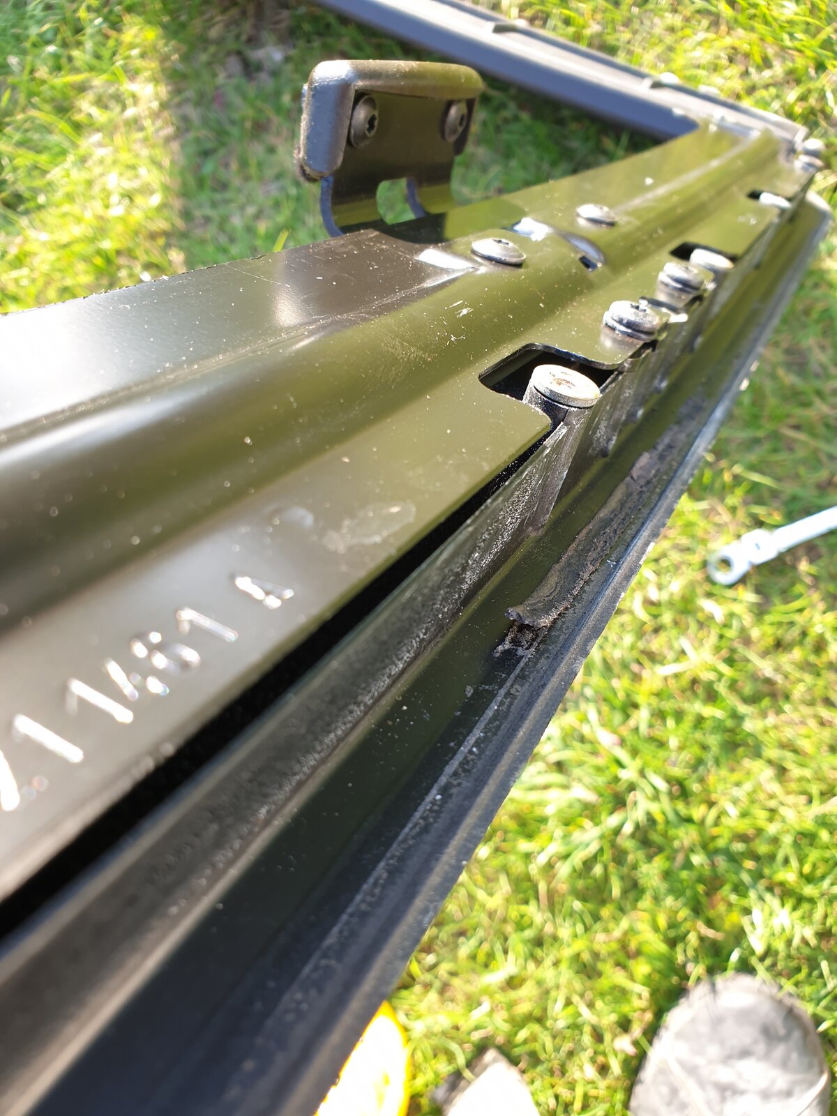

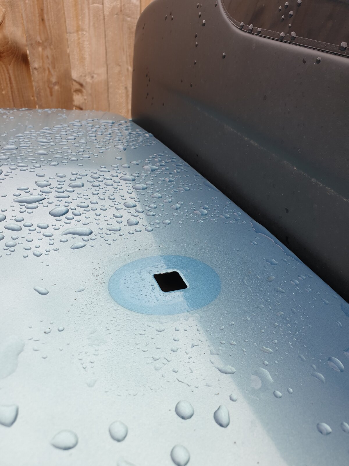

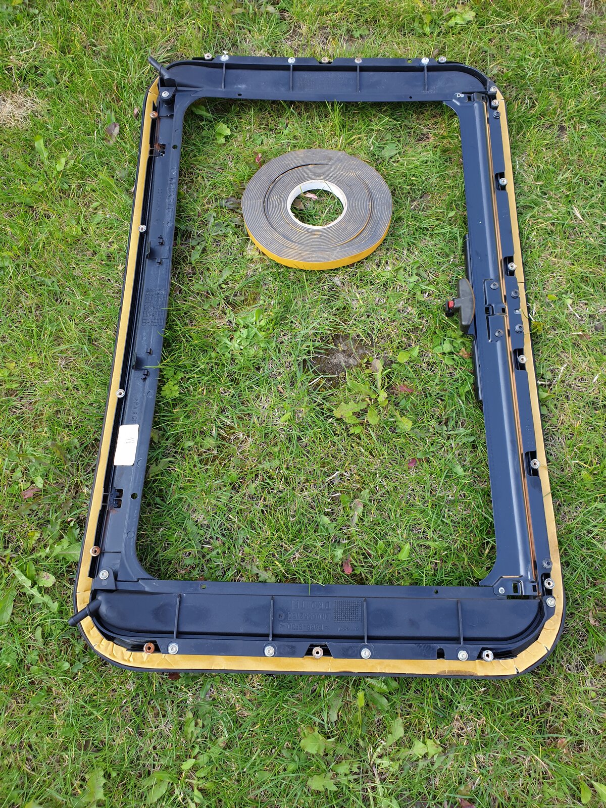

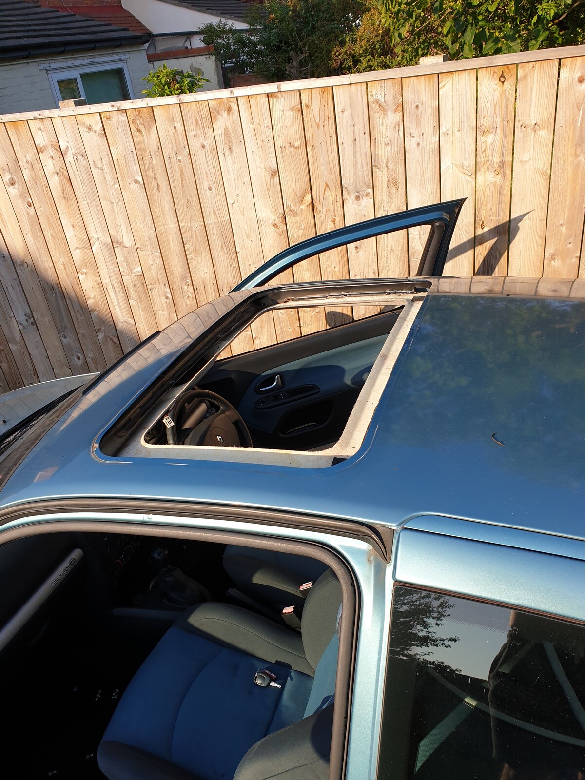

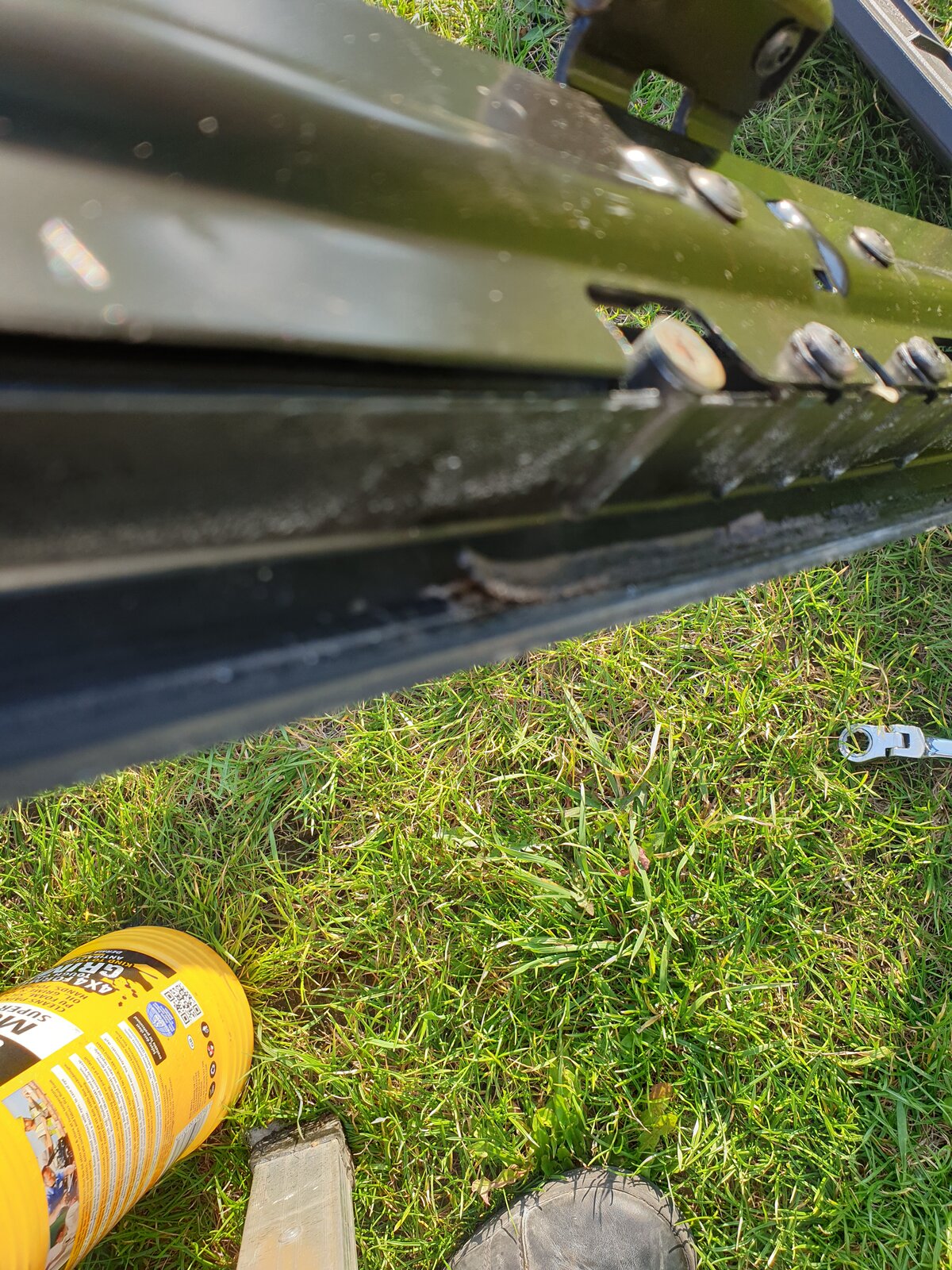

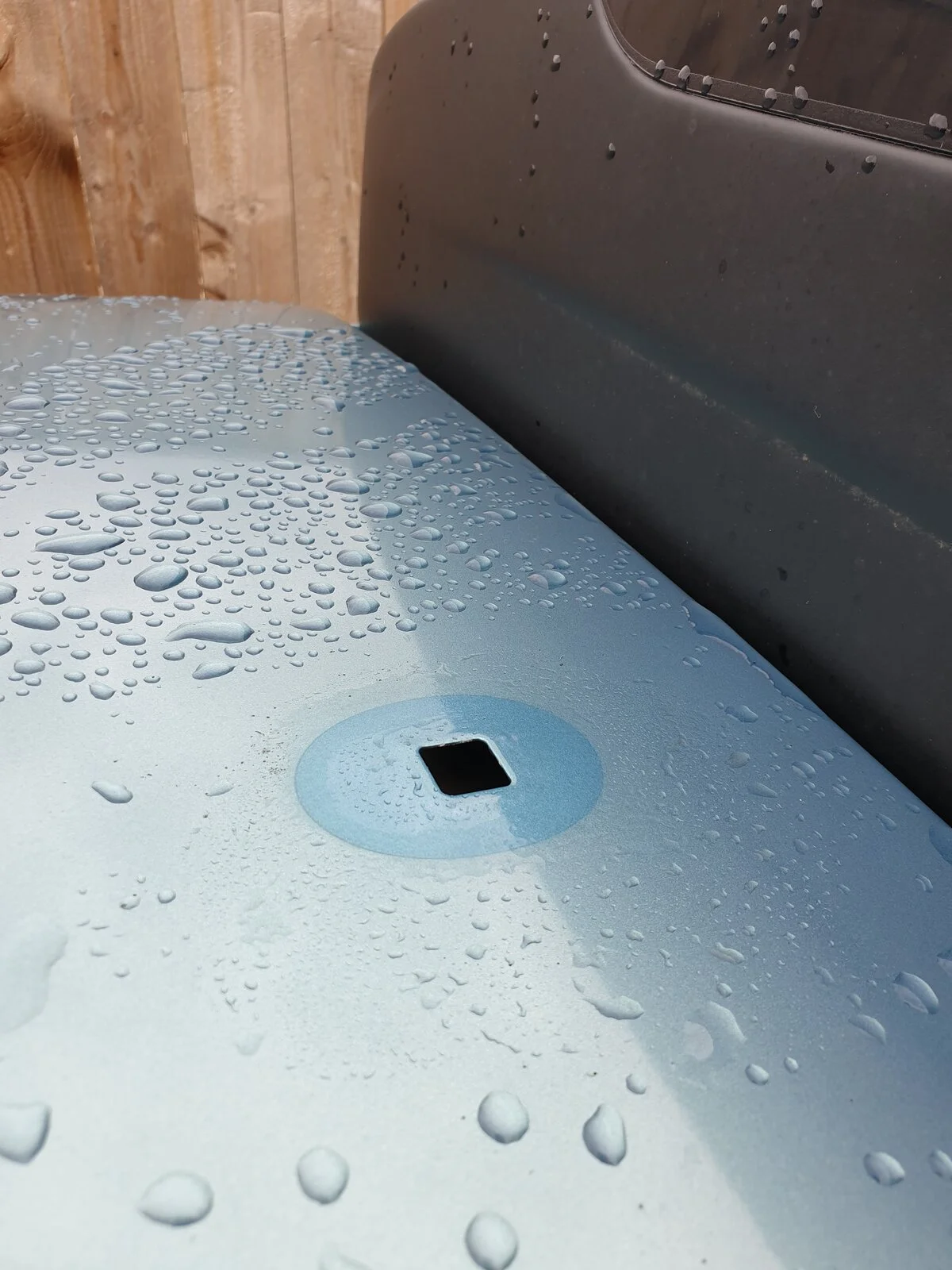

Resealed the sunroof frame, not seen any water come in but smelt a bit foisty like water had been getting in. Used 3mm glazing tape which i had in stock, done the same on the orange dci years ago and it worked great. Ready for the rainy season lol.

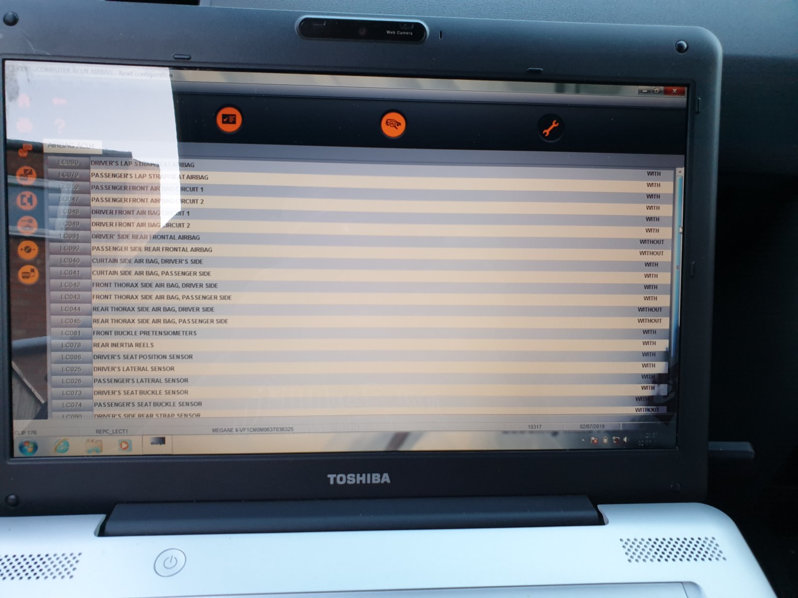

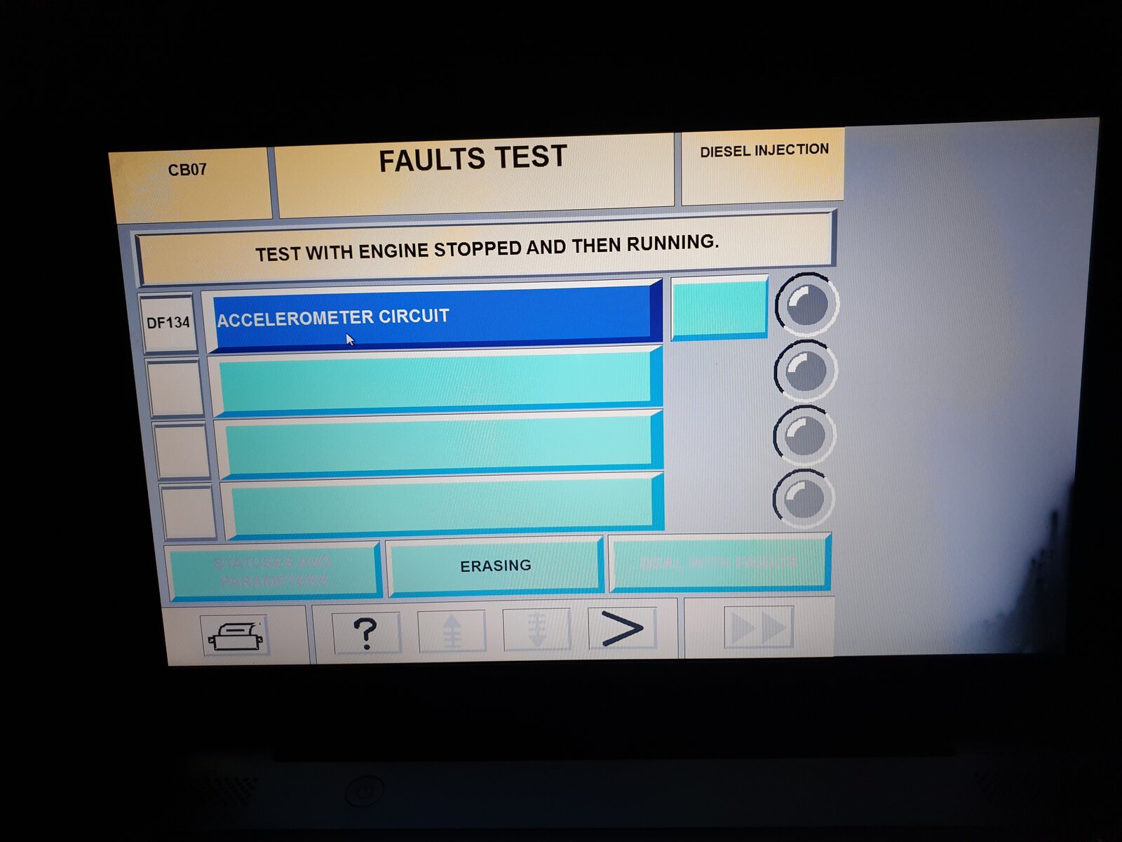

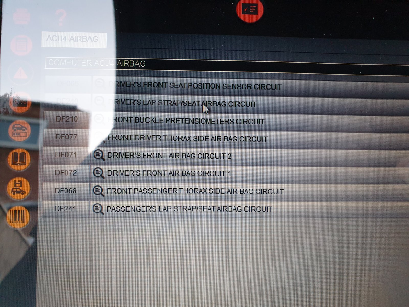

Had a scan with clip as the serv light was on due to passenger seat airbag wiring, easy fix nipped the connector prongs up. This fault has popped up on engine ecu, from what i gather its the equvalent of a knock sensor? Will ride it out for a bit and see what develops.
Apart from that nothing much to report, mpg is good, it was quite diesel knocky from cold which has improved 75% with some fancy forte injector cleaner, and good italian tuneup. The engine seemed a bit sluggish initially, but seems to be loosening up nicely now, not using oil or coolant.

What tape did you use for the sunroof ? Also are you using selant or just that tape .
Im not using my clio now . Just sat on the back of the drive so i need to sort mine for the winter !
Brigsy
  T.Turbo
Just tape on both of mine, its double glazing tape. I cant recall the thickness off the top of my head, it was what i used to use 15 years ago when i made timber double glazed windows up. Sticks like s**t to a blanket, done the orange clio 4 years ago and its still all good.

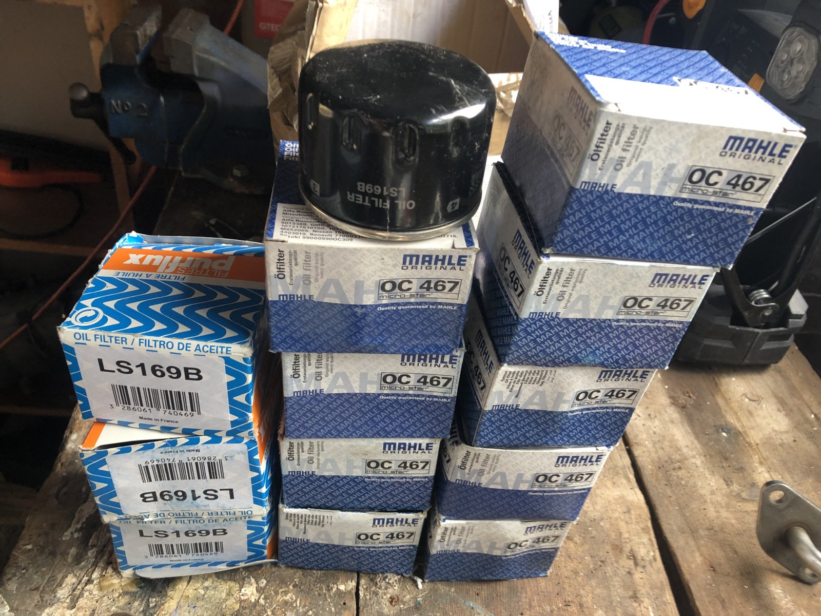

Changed oil and filter for Shell helix 5/40 as the engine sounded a bit noisy with the cheap euro shite in, sounds far better on idle with quality oil in. Noticed the alternator exciter wire had snapped so no batt light, but alternator charged fine without it? Soldered a new wire in and back to normal.
Also recently had issues starting, would fire up ok from cold, but pulling onto the front of the drive and restarting from cold would need several cranks and start up diesel knocky as feck.
Noticed tons of air in the fuel lines from fuel filter to hp pump when running. Changed diesel filter to a new delphi one, and it starts and runs 100x better, can only assume old filter was shot and letting air in at the fittings ? Been great for a month or so since.

Orange dci has had some loving too.
First of all, the drivers door had a big bit of cracked filler on the edge due to previous repair years ago. Been looking for another door for ages, but as most of the pov spec clios are hammered now nothing had come up worth buying, and getting the door painted would cost £££ due to the pearl, would need the qtr blending in so had ignored it.
Mrs was keeping an eye out for a breaker and found one in Durham. As the colour is fairly rare and only half hours drive, thought it was worth a look to see if any good. Got to the breakers yard and the heavens opened up, but got it off in under 10 mins, could not believe it so easy to remove.
Took a gamble as hard to tell if any good in the wet, but got it fitted and the match is bang on, and the door is dent free, cant even tell its had a replacement, the match is actually better than the original repaired door.

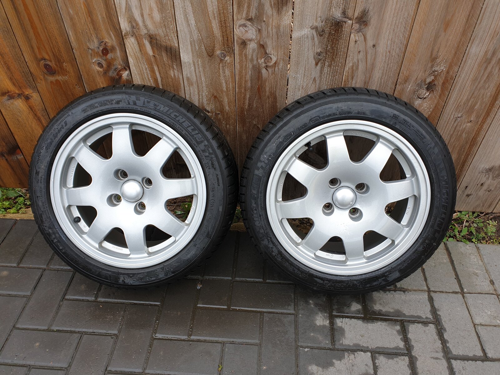

Changed front discs and pads, pagids and bosch discs, fresh shell helix oil and filter. Replaced diesel filter, again delphi filter which has improved the cold idle massively as it used to chug badly when cold.

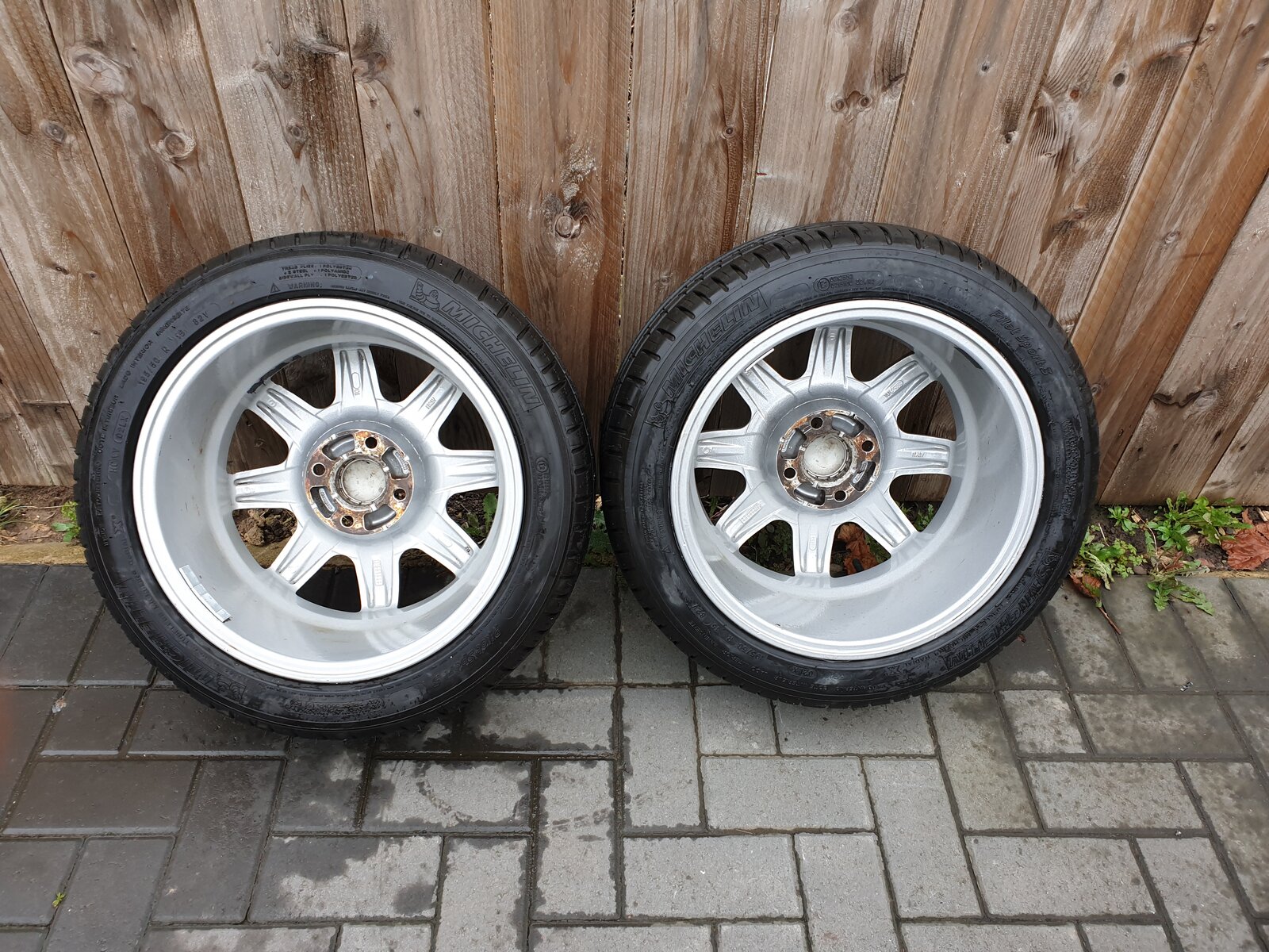

Also changed rear o/s wheel bearing for new skf, and fitted a pair of part worn pilotsports up front with 7mm on. Cleaned the wheels up inside and out, and then cleaned/sealed the car with gtechniq c2v3.
Only got 2 pics of the wheels, intended on getting some of the car looking fresh but it started pissing down as per usual
Anyway it should be ready to fly through its mot next month, and ready for its epic road trip at the weekend. Over and out for now, i promise more pics and less chatting s**t next update;):LOL:
