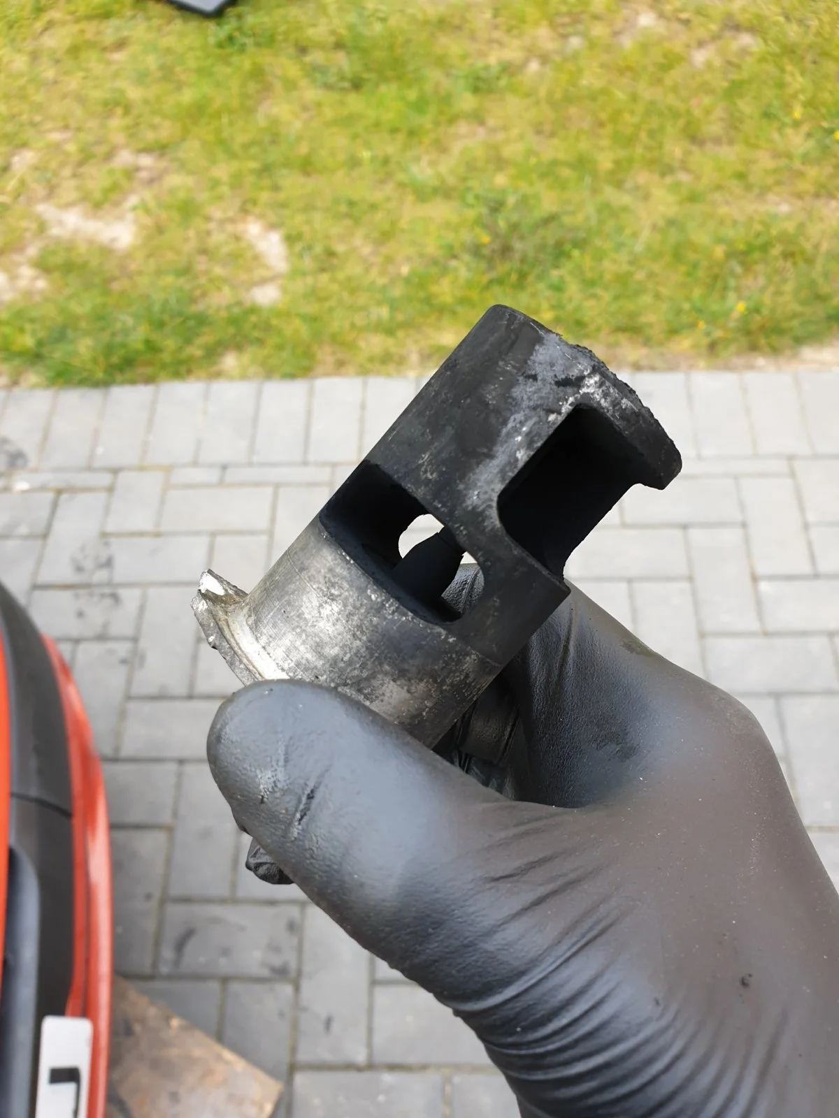

Good work Brigsy. I need one of those guns. Couldnt get a drop link bolt off today and bet one of those would crack it straight off.
They are a godsend on some jobs mate. Ive just sold the sealey one in the pic cheap as have upgraded to high torque dewalt impact wrench. I have another sealey one here that needs a battery if you want it for nowt.

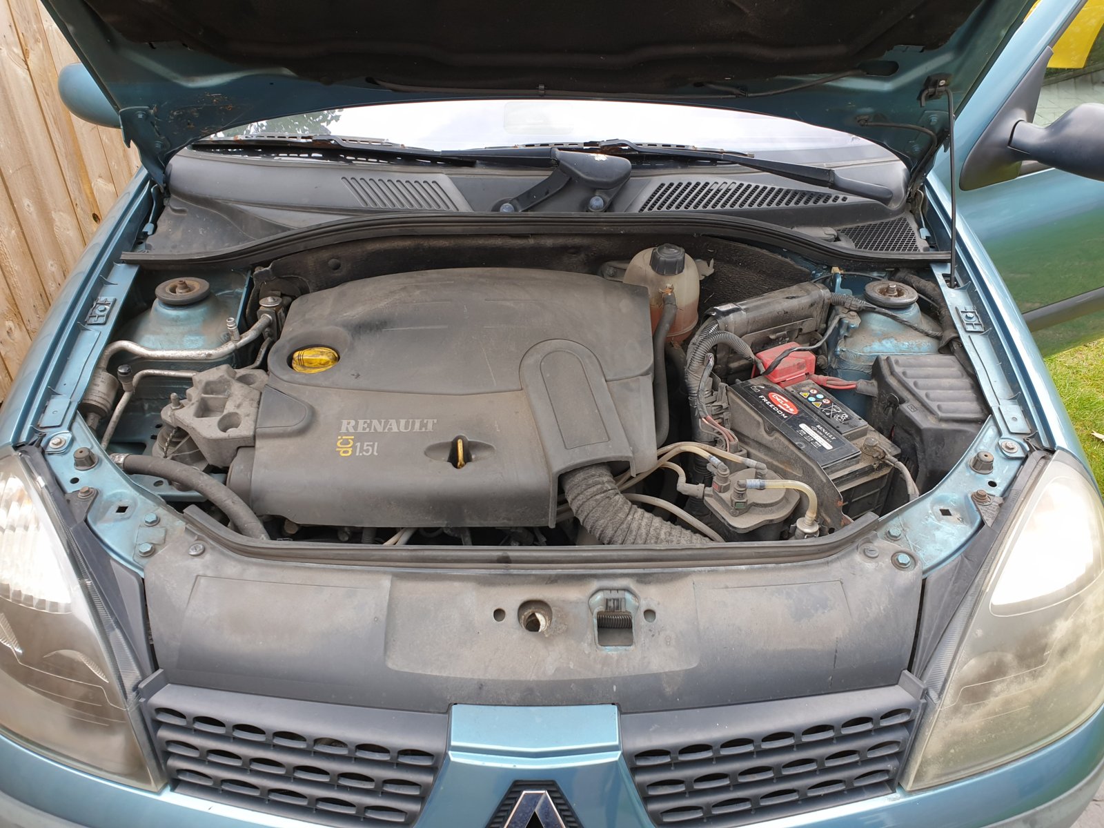

Changed the turbo on Monday for a used ebay £40 special. No pics as oily as feck diesel, compressor housing seal was on its way out and leaking oil onto the cat and into the boost hoses making it a bit smokey on boost, and siren noise on spool indicating out of balance. I fitted the turbo 25k ago and it was a gumtree £30 special so cant moan.
Easy job took a couple of hours, cleaned oil out of boost hoses and pcv whilst there. Performance has improved a little, faster spool, better mpg and no smoke. Ready for use for work on the 23rd April ! Its looking a bit unloved so going to hit it with the da on bank hol weekend weather allowing.

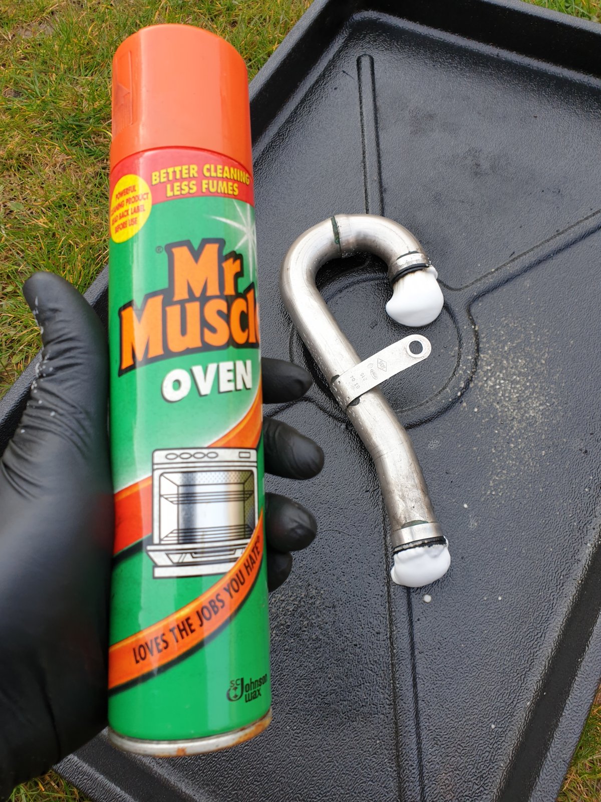

Noticed a fair bit of black smoke on turbo spoolup recently..initially i couldnt really be arsed looking into it, air filter is new and it was acceptable enough for 143k. Anyway got up early today and whipped egr and boost pipe off, not looked at either since cleaning both when i got the car.
Egr still clean, no oil just a bit of soot..prob because it gets a good flogging quite often lol
Boost hose well caked up with oil and s**t and quite restricted due to leaky compressor seal on old turbo, never thought to look when changing even though plastic boost hose was coated in oil which i cleaned up when changing turbo.
Dug out the oldskool Mr Muscle for the job, and a bit of brake cleaner to clean out and raked out inlet/egr body as far as i could get
Seems to be a lot cleaner on acceleration now and goes a little bit better. Adjusted the rear shoes whilst at it as pedal/handbrake was a bit long, the self adjusting mech is s**t on the drums and never works right even though it is free and not seized.

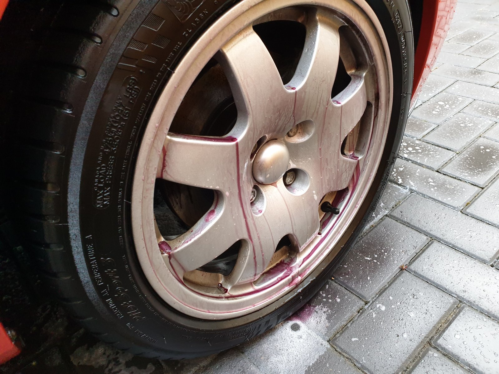

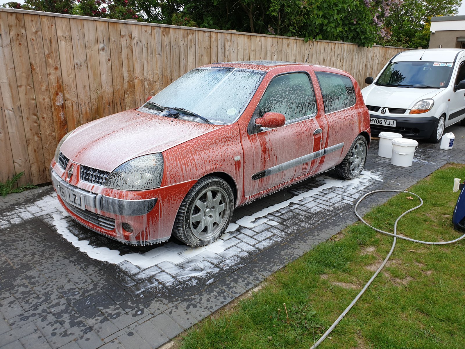

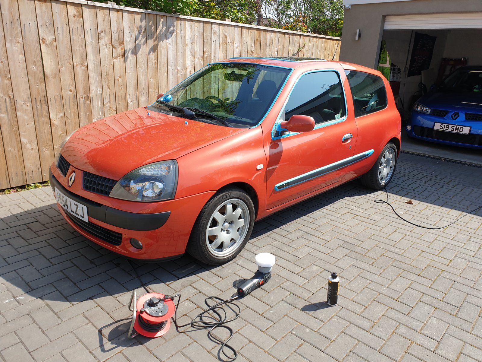

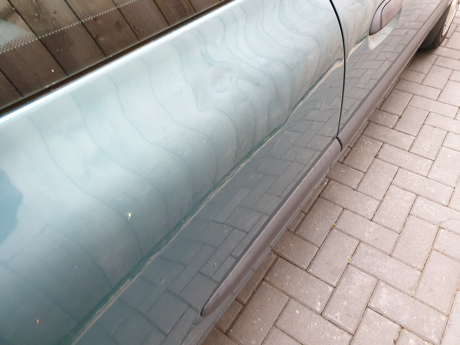

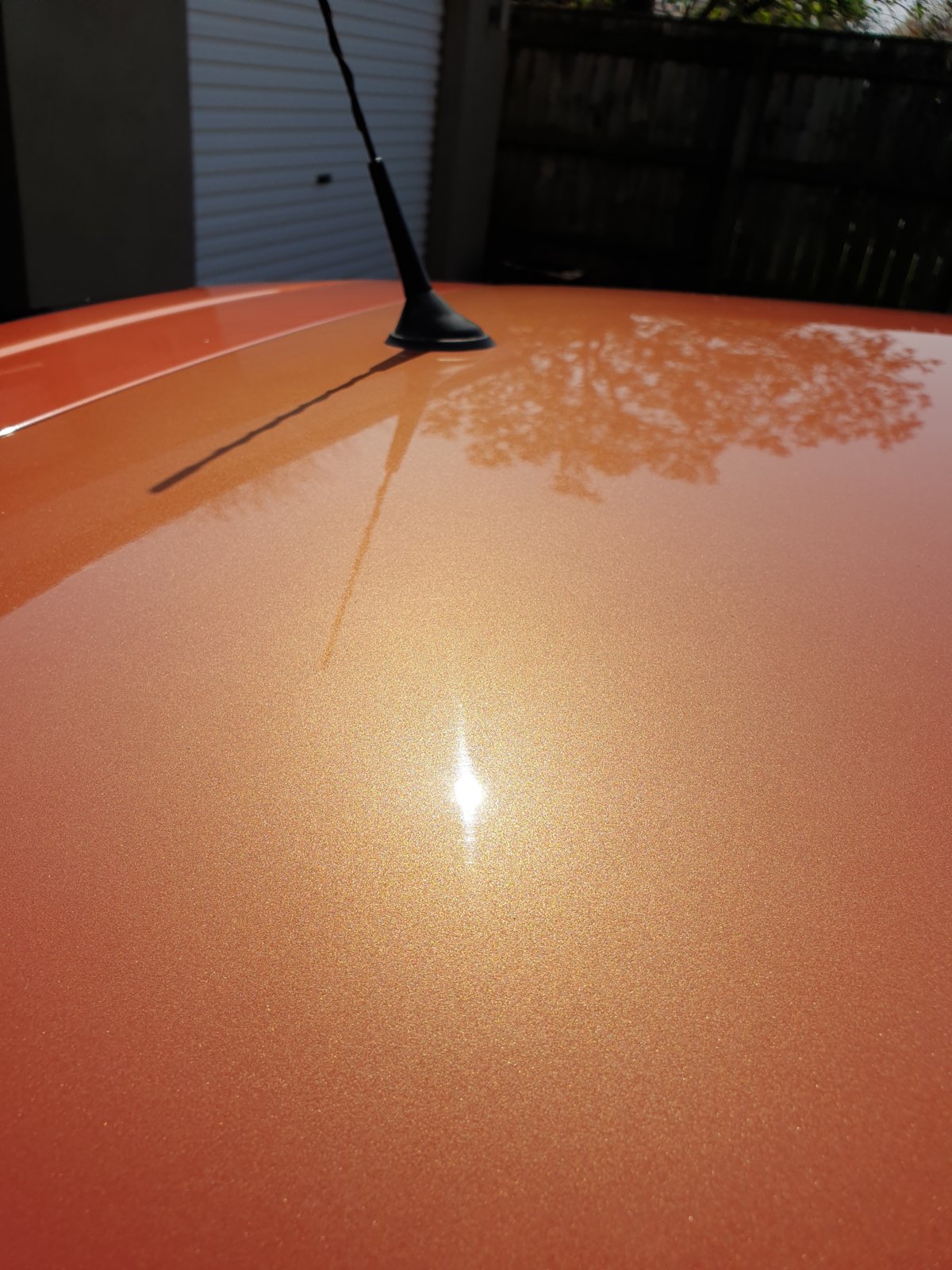

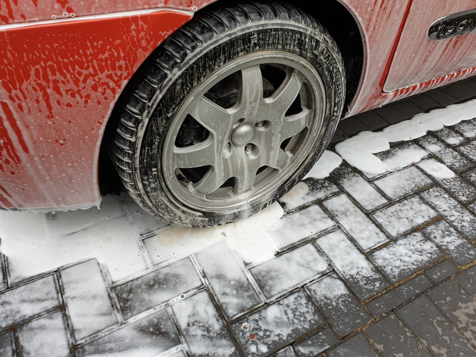

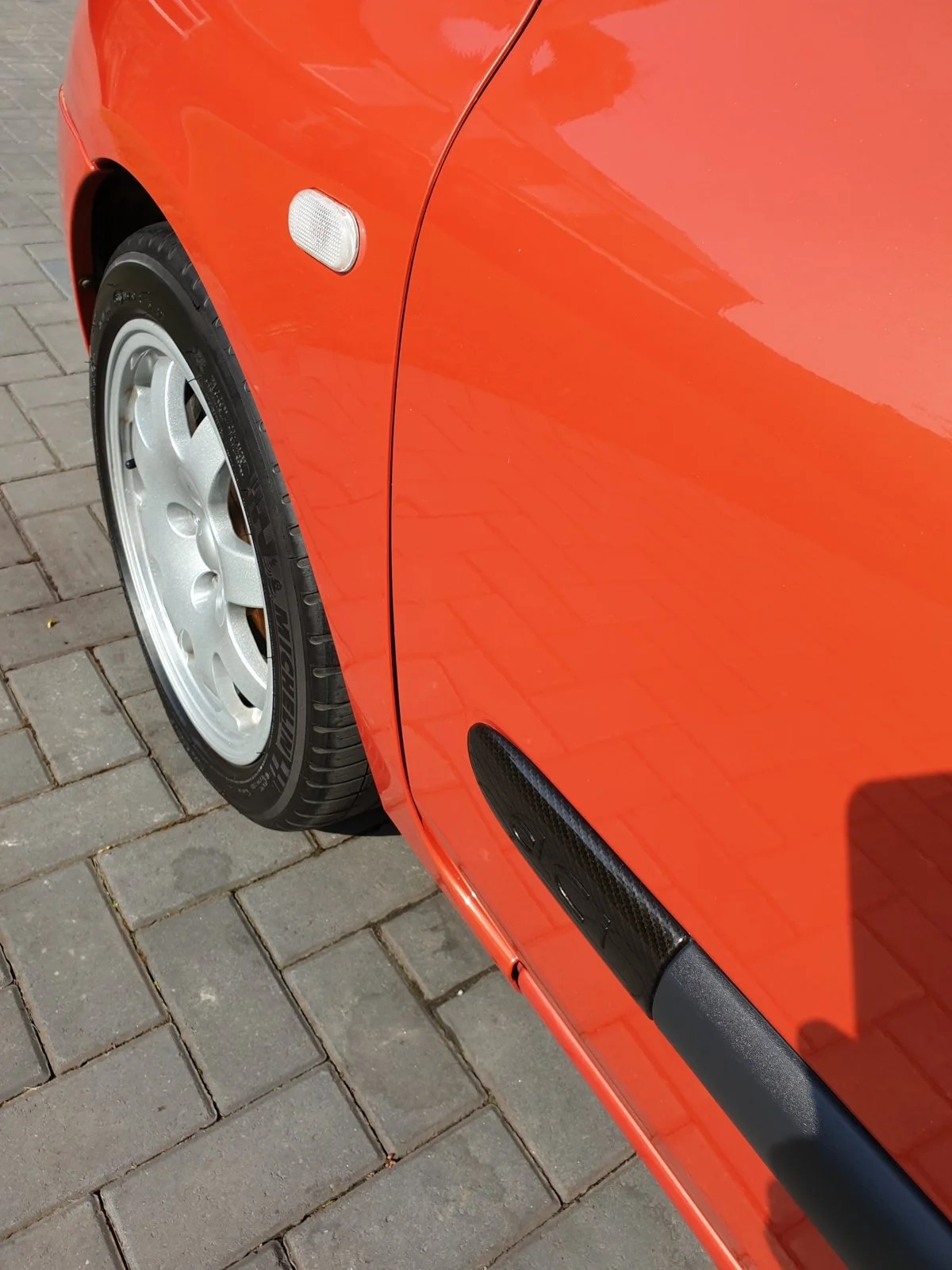

Had a spare day today so dug the d/a out and give the clio a once over.
Fallout remover early doors whilst temp was low, blasted off, snow, 2 bucket wash, dry. Clayed, taped up, quick correction with an orange hexlogic & CG V36.
This removed quite a few swirls and scratches, did not go too mad though as no paint depth gauge and just a quick once over as it is a 15 year old daily driver with 145k on, 75% of the swirls have gone though looks miles better. I think it would need a heavy cut with a wool pad to make it mint, for a novice im not attempting that.
It was a little bit marry after this, not too bad though so give it final polish with a white hexlogic and CG v38 which refined it nicely. Finished with a coat of Collinite 476s, applied it with the d/a and finishing pad which worked awesome and effortless, first time ive used it to apply wax. Trims gelled and tyres blacked, should stay looking nice for a while now.
In progress, taping skills need more work
Finished

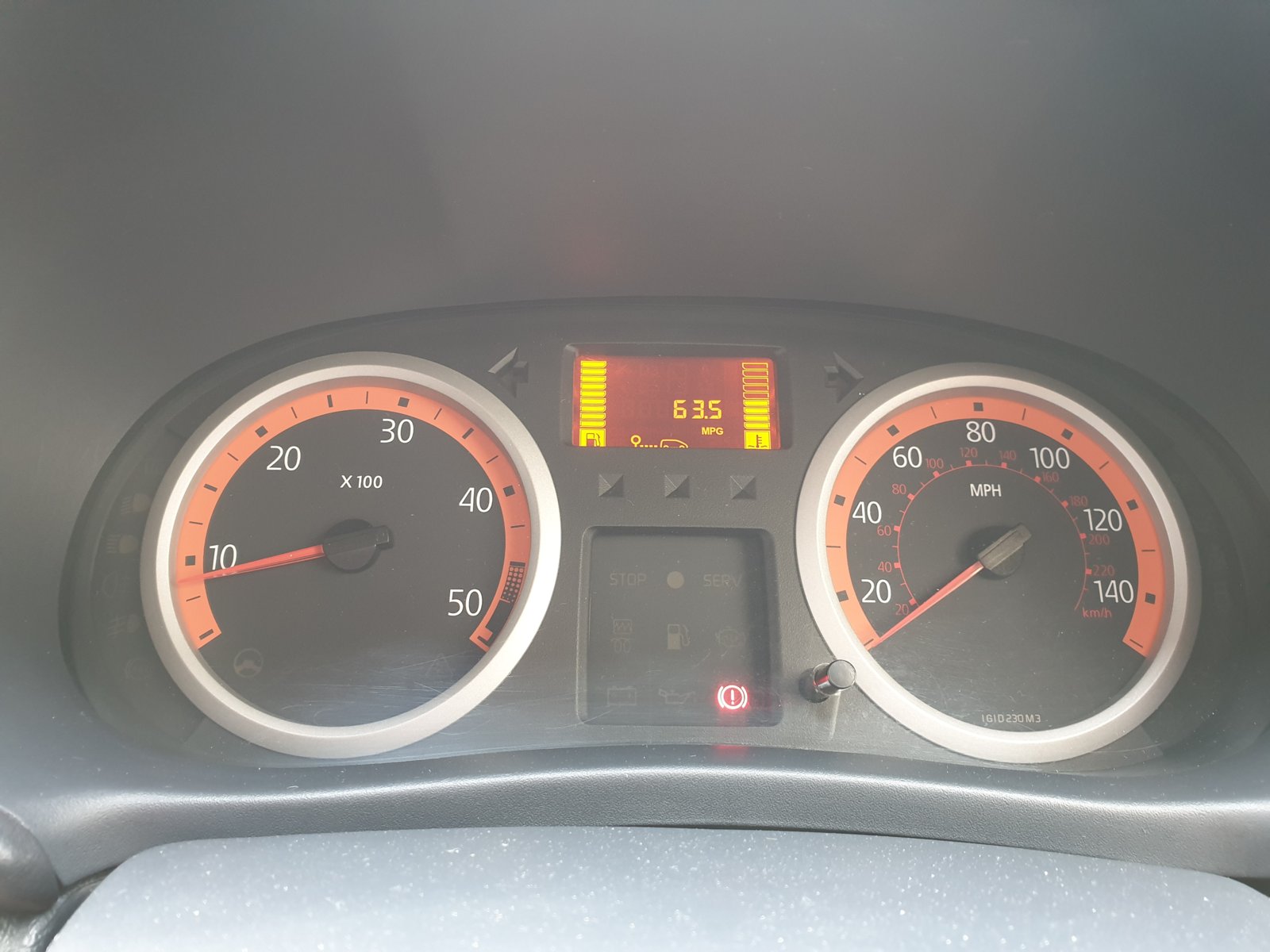

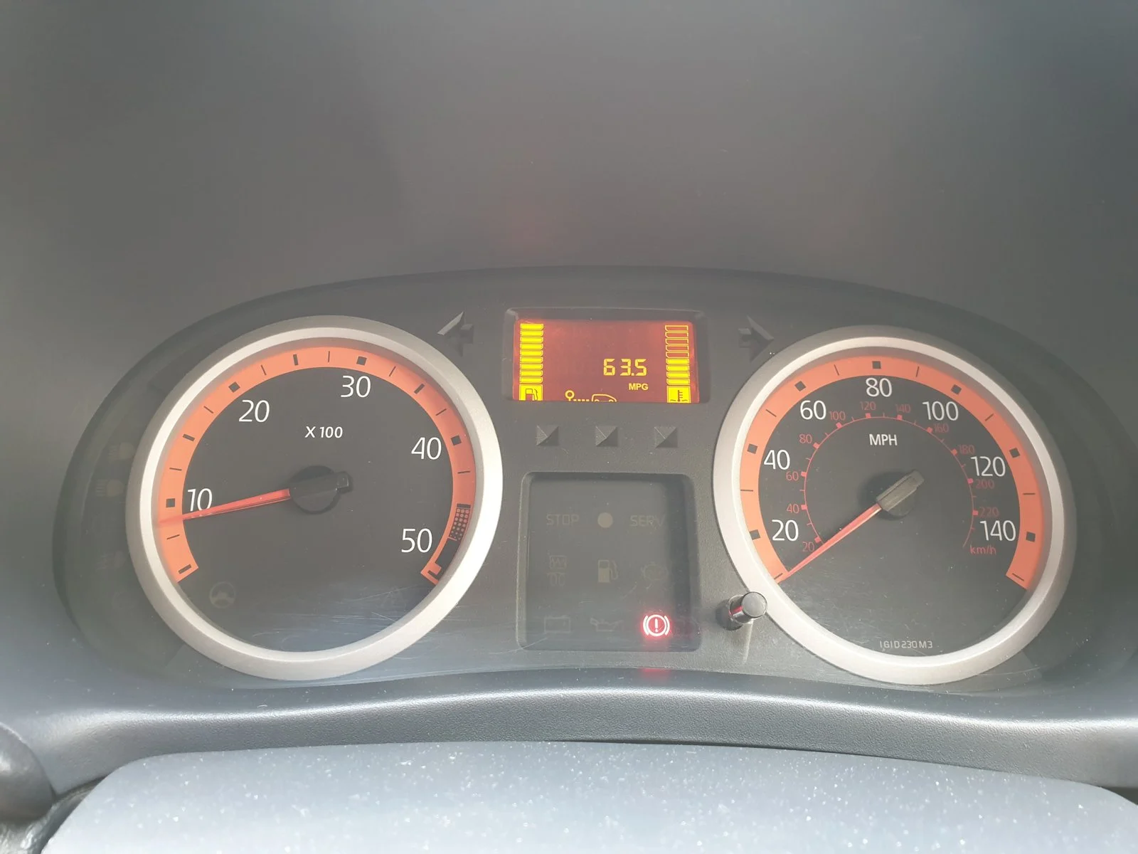

Mpg has been great this week as doing a few motorway miles, 63-64mpg all day. Filled up on payday, £57 of shell derv which showed 720 range, its dropped a bit due to a few miles in the pic. These 1.5dci's are epically cheap to run, and just making money all the time as 45p a mile for business use.

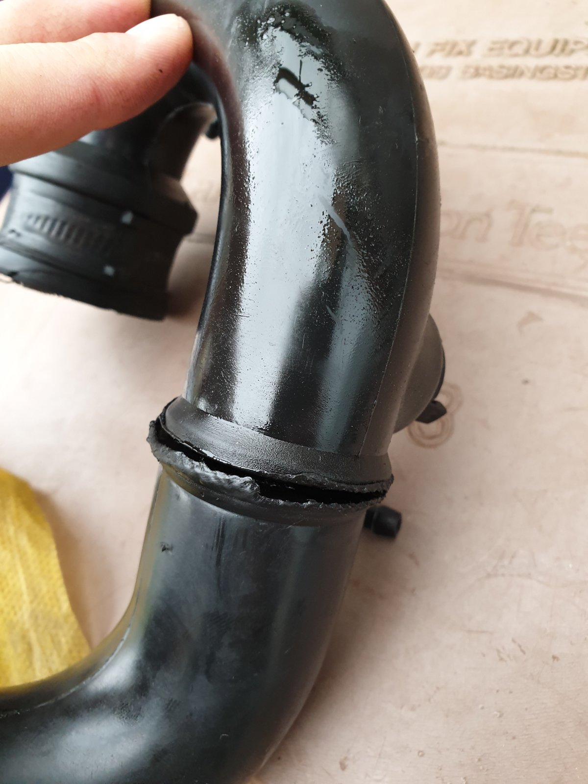

Had a small issue yesterday, booted it up a slip road and noticed power was down and sounded like a hairdryer under the bonnet..i was expecting the air temp sensor to have popped out but when looking the new boost hose has split at the joint. Cheap thin replica plastic shite ive asked for my money back, less than 500 miles of slow ish driving since fitting.
Have refitted the original hose which is a bit deformed but seems to be sealing ok this time round, its a b*****d of a job to get the oem hose on properly.

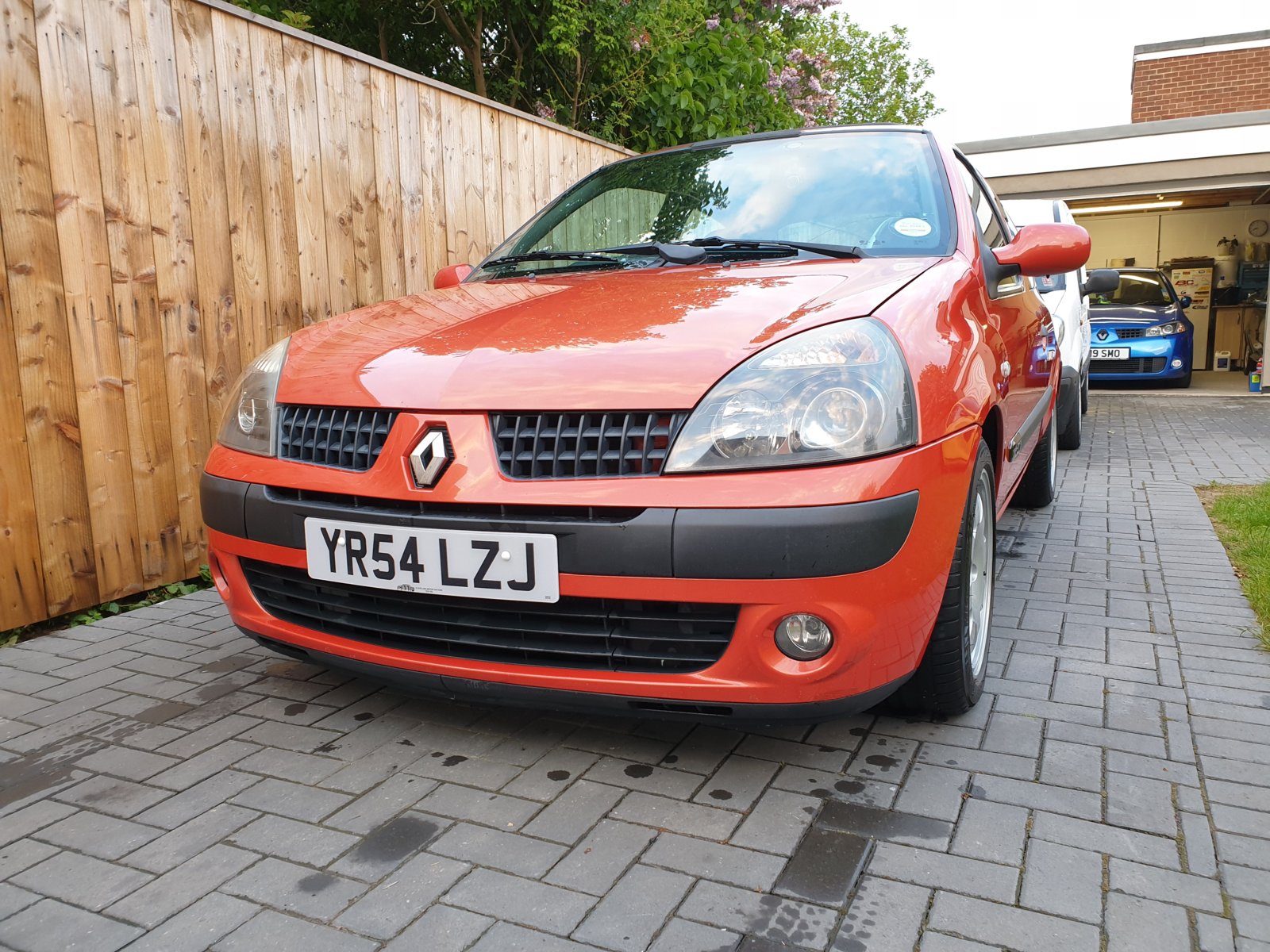

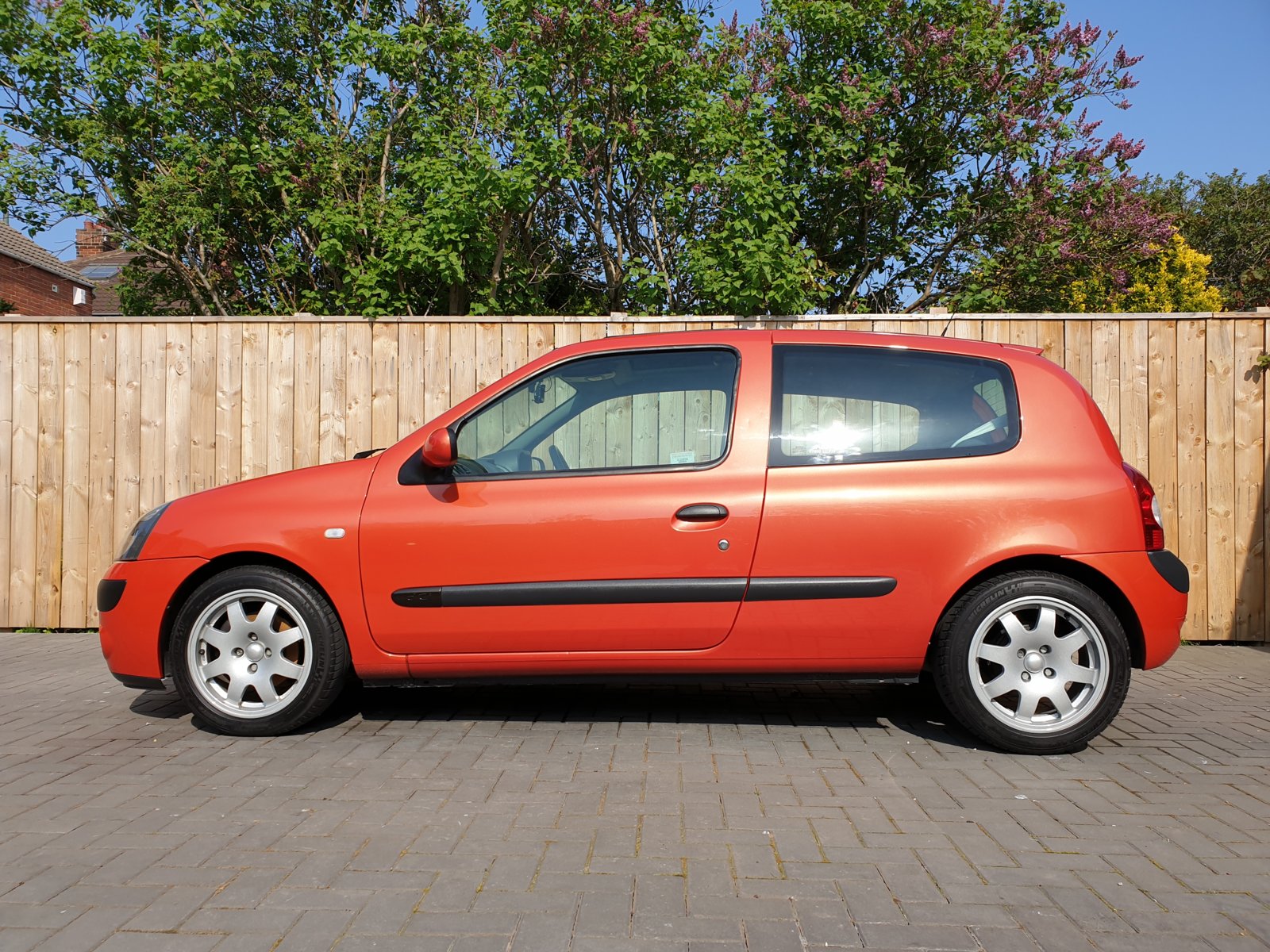

Dci's multiplying now. Been sniffing around for one for a couple of weeks just to hammer for work. Criteria was air con and preferably not much rust and less than 200k mileage. After looking around found a couple of low'ish mileage dci 100's but the sellers were absolute cranks.
I dont mind travelling for the right car but they would not take extra pics or give info saying "its emmaculate" or "just view it" when you can clearly see a bit of damage on pics took with a potatoe which show nothing. These were cars around the 1k mark or higher too which is top dollar for a mk2 dci. One of the feckers started giving the mrs some slaver when she asked for extra pics, he got the backlash off that haha. The daft thing is i only wanted pics of rear arches and would have given him an easy sale if it was decent at around 1k, so feck him his loss.
Anyway a spares or repairs dci65 came up in Mexborough which was only 80miles away..car sales place and the seller was decent on the phone, honest so went for a look. £395 tested until October 107k and a/c.
Goes down yesterday afternoon, gets to the place. Quick look round and condition is acceptable, a few bits needed but no biggie. Fired it up and starts no bother, airbox and engine cover rattling like feck but apart from that not bad. Rev it and loads of black smoke out of the exhaust.
Fella asks if i want a test drive so take it a few miles. Pull off the forecourt and its slow as f**k. Looked behind and comedy amounts of black smoke "rolling coal" would describe it well. I did think about turning back at this point but kept driving for the comedy factor to see if it would go bang. Revved it up to 4k in 2nd which it made slowly and totally fogged the road out behind me with dense black smoke. It was absolute gold, seller did not care we were all laughing. Coolant temp stayed ok but felt like no boost pressure at all even though the pipes were all on. Im my mind i had an idea it would either be blocked egr/inlet pipe, totally dead or seized turbo or injector. I did not worry too much about the injectors as engine was smooth and no hesitaition, even though it hardly made 50mph 3 up. Seller says previous owner had owned it since 2006 and just traded in as its been sluggish for ages lol.
So gets back to the car yard and stuck £250 offer in as chuckaway car and chuckaway money if it turned out to be total scrap. Seller says £300, i say £275 and then we settle at £290. Half a tank of diesel in and 300 miles on the range so if it makes it home itll be a free journey making the overall price slightly cheaper.

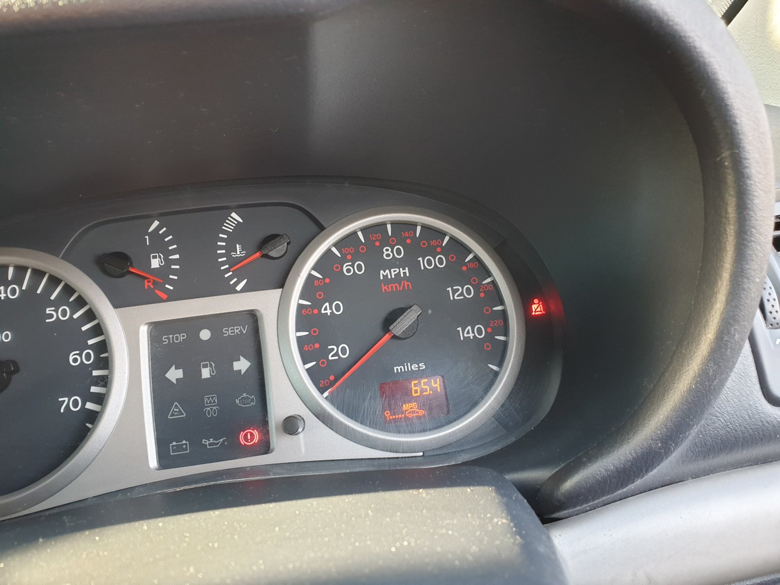

Quick insure on the Cuvva app for £8 and set off home. Its bellowing out s**t loads of black smoke on throttle but plodding along..good job i dont mind driving scrap cars. Got Radio one dance anthems on blasting away and turbo is whistling away from what sounds like a boost leak somewhere.
Get on the a1 and it makes 70mph eventually but wont go up the hills slowing down to 50mph. I notice the throttle pedal is really stiff so just start flogging it down full throttle and bellowing out black smoke everywhere, not caring if it goes bang or not as next place it will be going is the weigh in yard if it does ! Wound it up a bit 80ish, hold it there for a bit noticing that the engine is indeed picking up a bit of power and less smoke when we were near wetherby services. Start toeing it a bit on and off the throttle and its not running too bad but still quite smokey on throttle.
Stop on the a19 and bang a cheap obd bluetooth scanner on and torque app to check if it had any boost. Flog it out of the services and see 15lbs boost so we have boost pressure, and its actually going alright as the mrs is following in my orange dci and its on par power wise. Get near home and the smoke has really settled down, its quite acceptable just a but laggy. Can only assume it had never been given full throttle for ages and very coked up.

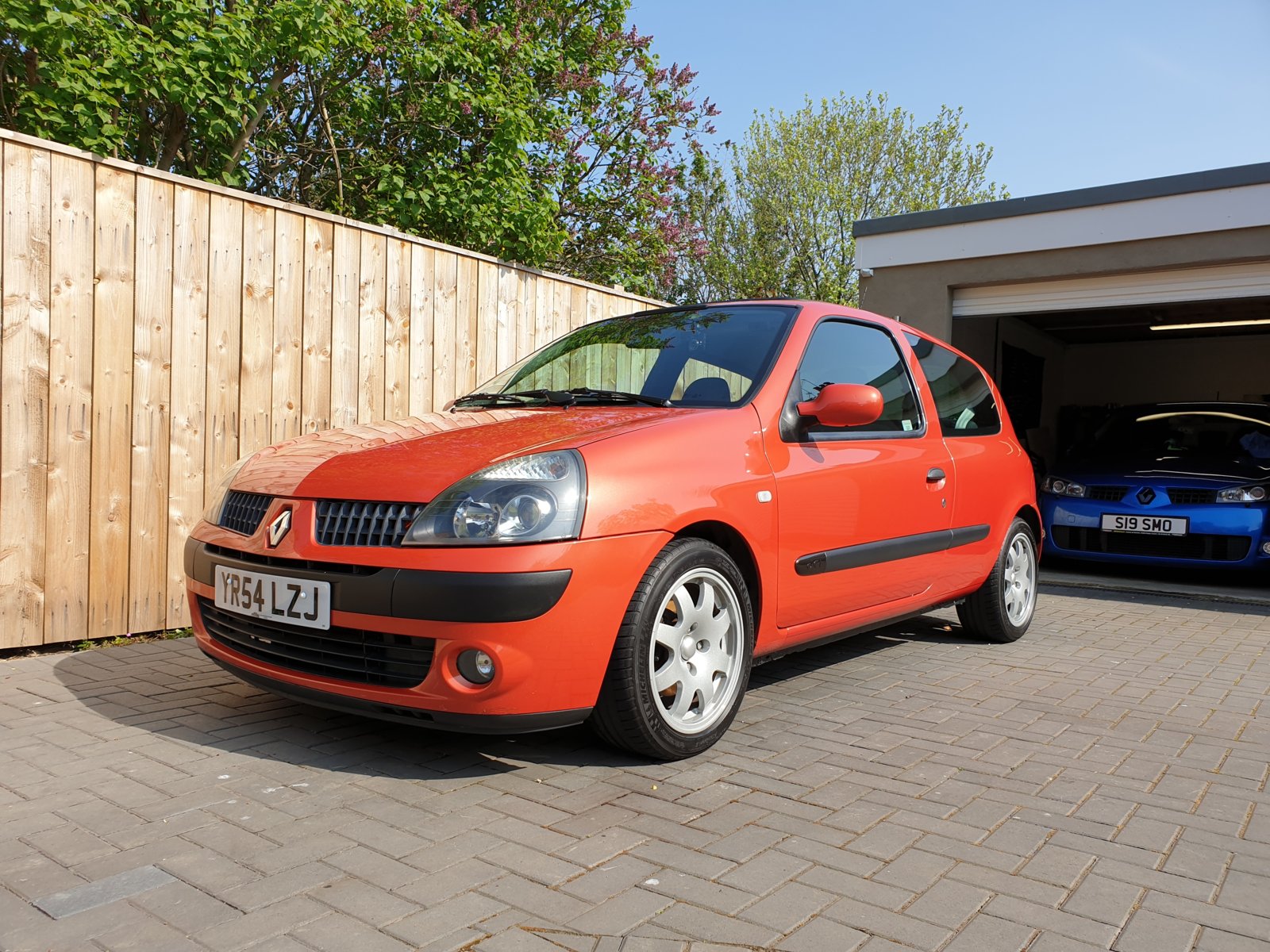

First pic with the orange dci
Brigsy
  T.Turbo

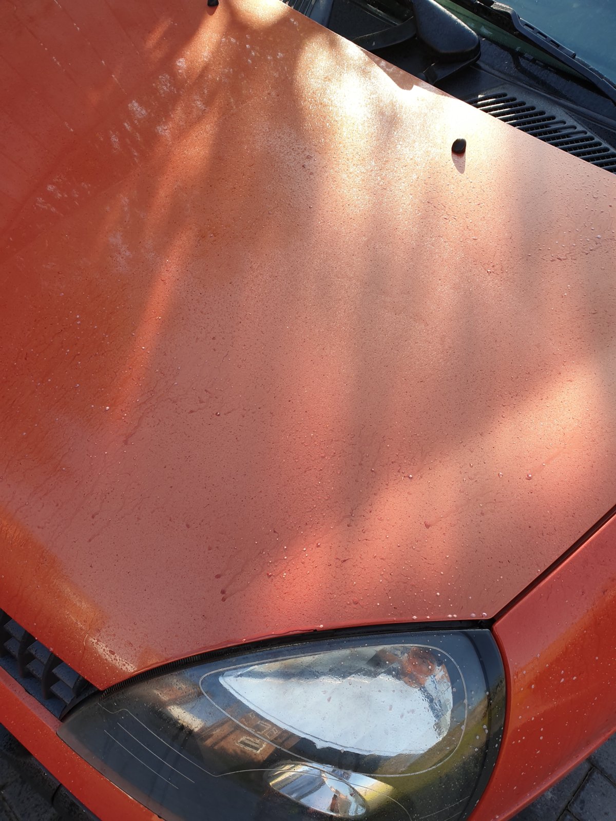

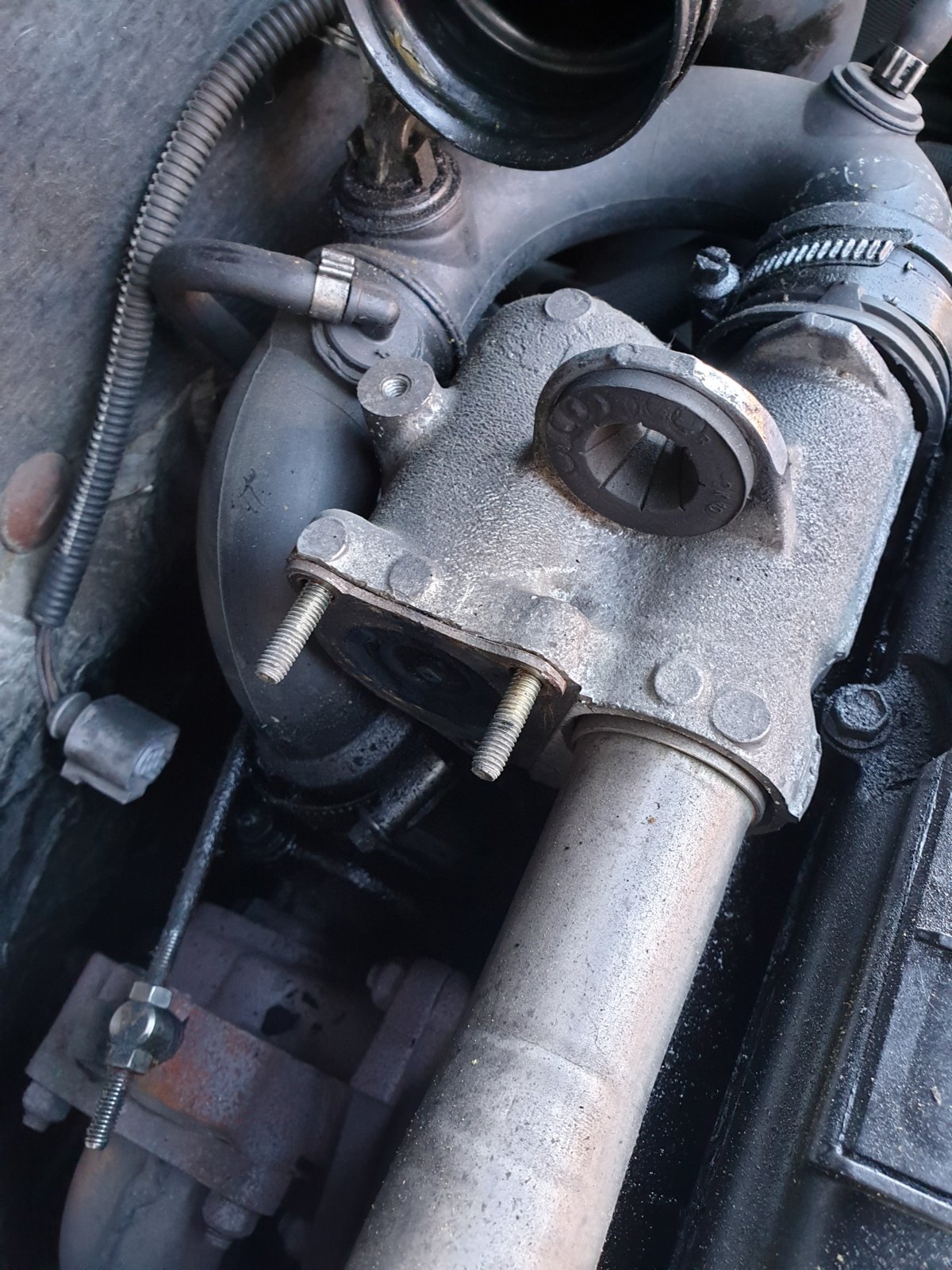

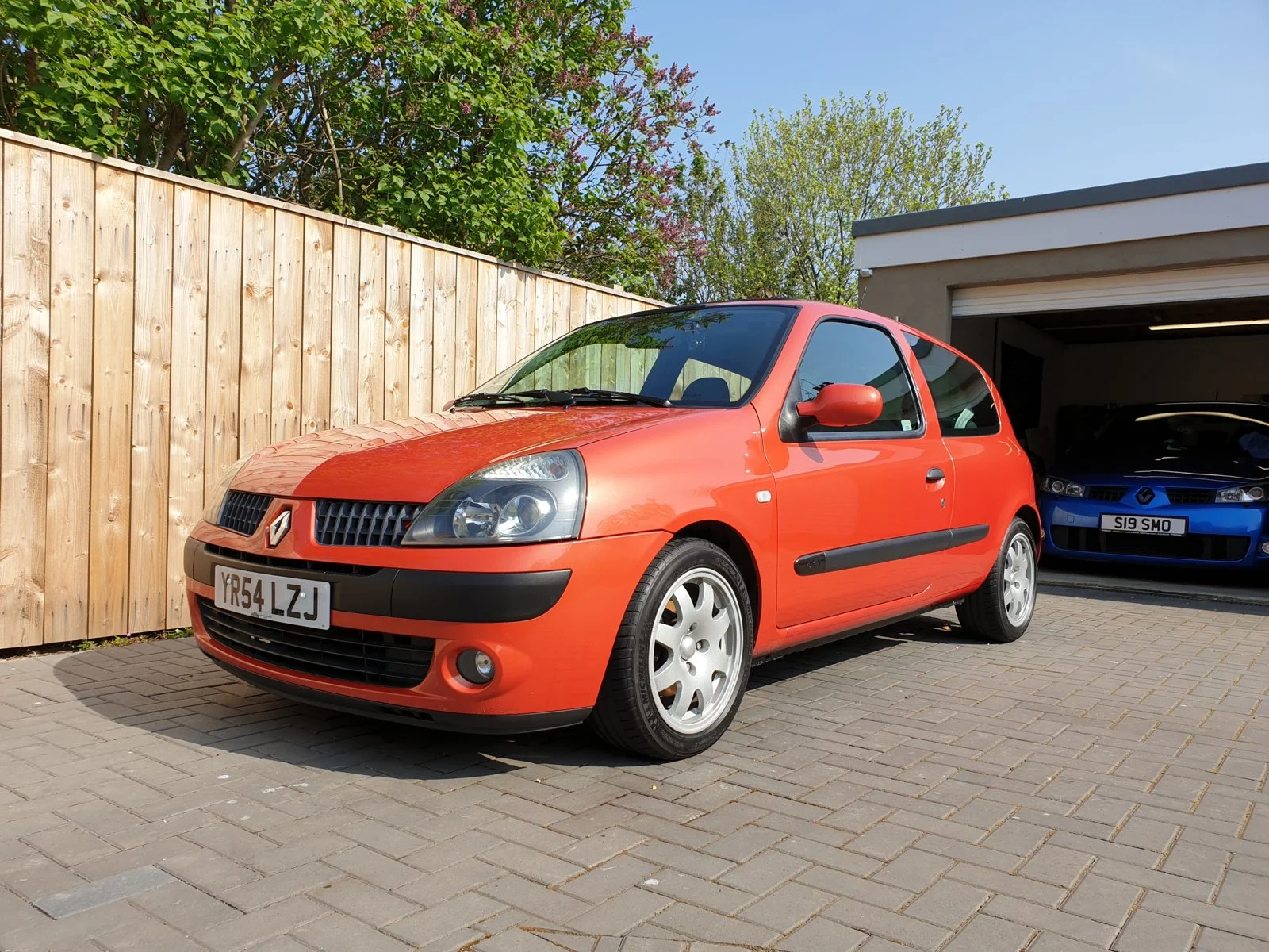

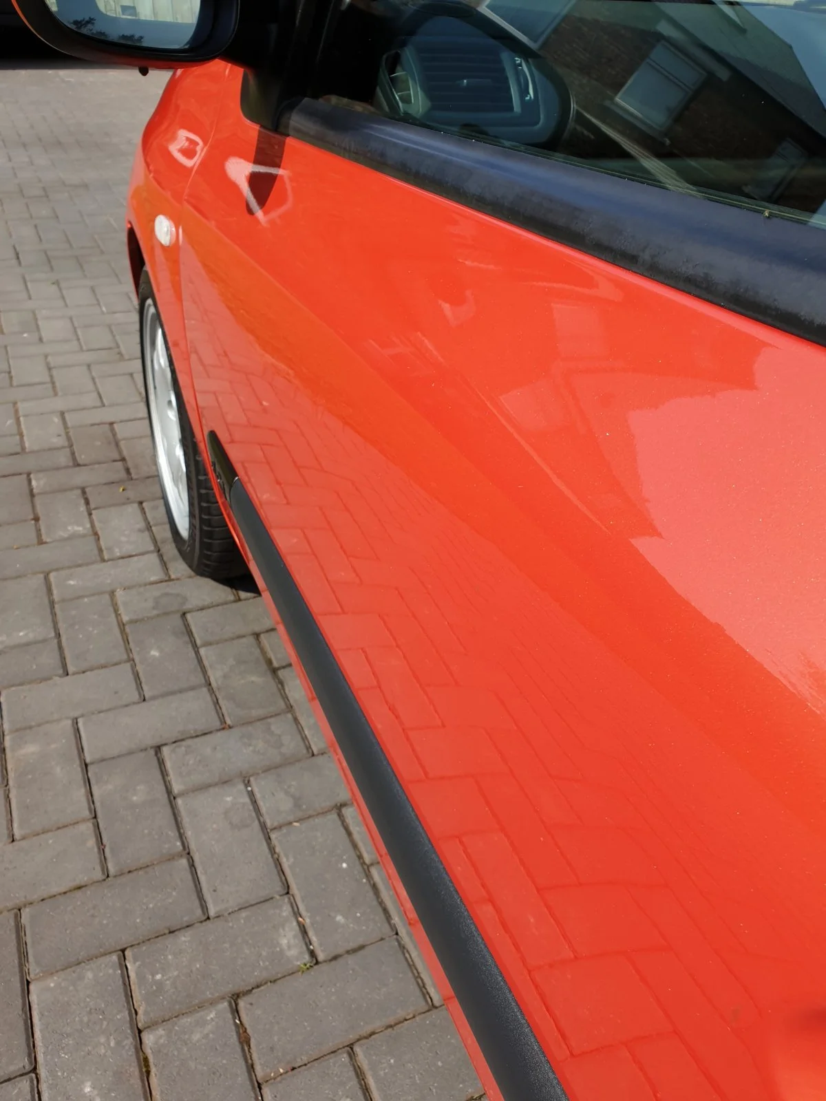

Got up today and nice dry weather so give it a once over as just abandoned it last night.

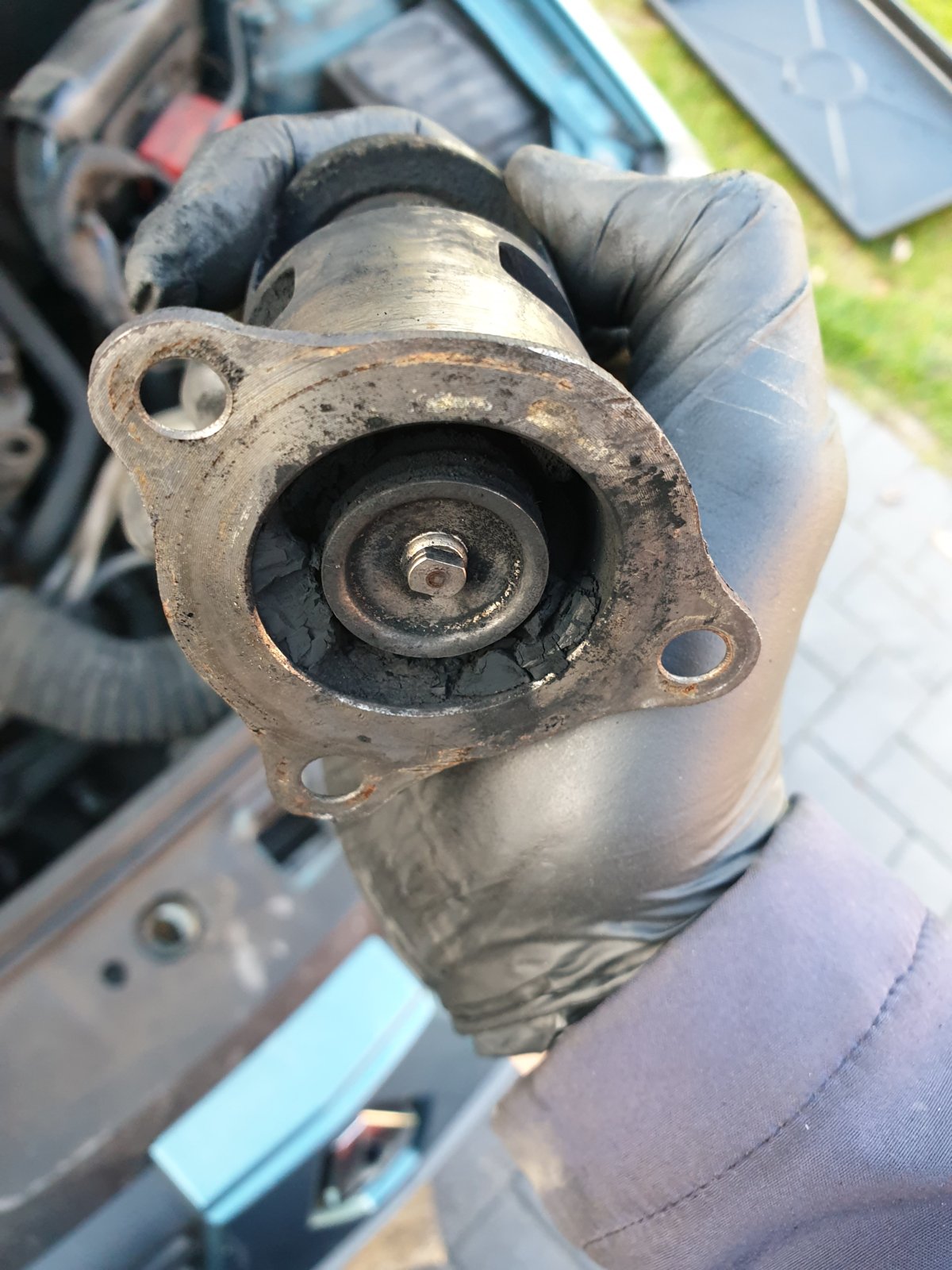

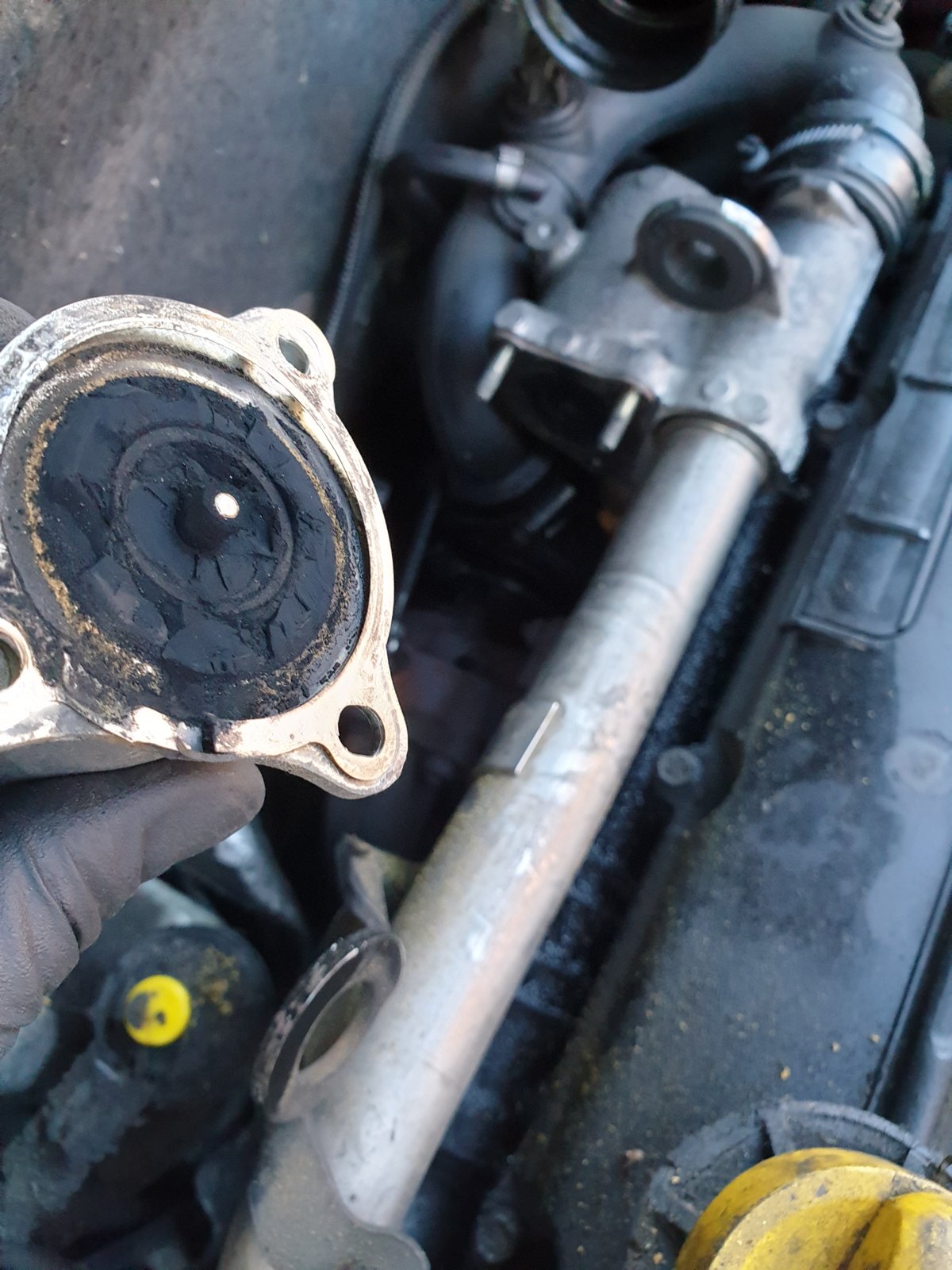

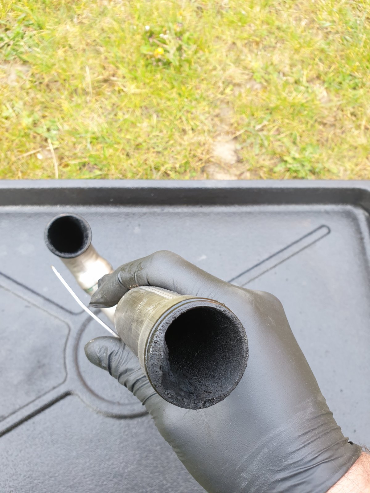

First thing was to pull egr and inlet pipe off, egr was indeed blocked up but blocked on the solenoid side wierdly ? A bit crusty around the penny but not too bad. Can see somebody has been there before albeit years ago as airbox mount is broken, which i repaired with a self tapper and silicone hose, and fit the lid properly as not even clipped in.
Inlet pipe is clean'ish, but full of exhaust soot can only assume egr has been stuck wide open at some point, poss yesterday before i flogged it 80miles home.
Puts it back together and it stumbles into life with a cloud of smoke but settles down to a nice quiet idle with fixed airbox. Bang clip on and scan for faults, nothing sinister and reset egr adaptives and cycle it a few times can hear it clicking away.
Me and the mrs both take it for a flog around the block, its like a new car no issues at all just normal dci a little bit of black smoke if you rev it hard but its getting cleaner all the time. Air filter is bad so a good service will probably sort it. Inside is cleaned as totally grotty.
Overall not a bad little thing, needs a couple of bits doing but drives great, looks to have new discs and pads up front, new drums on rear, no rust, everything is greased all hinges etc. Its been loved yet unloved its strange, but took a gamble and it will do.
Project van is a go'er ?

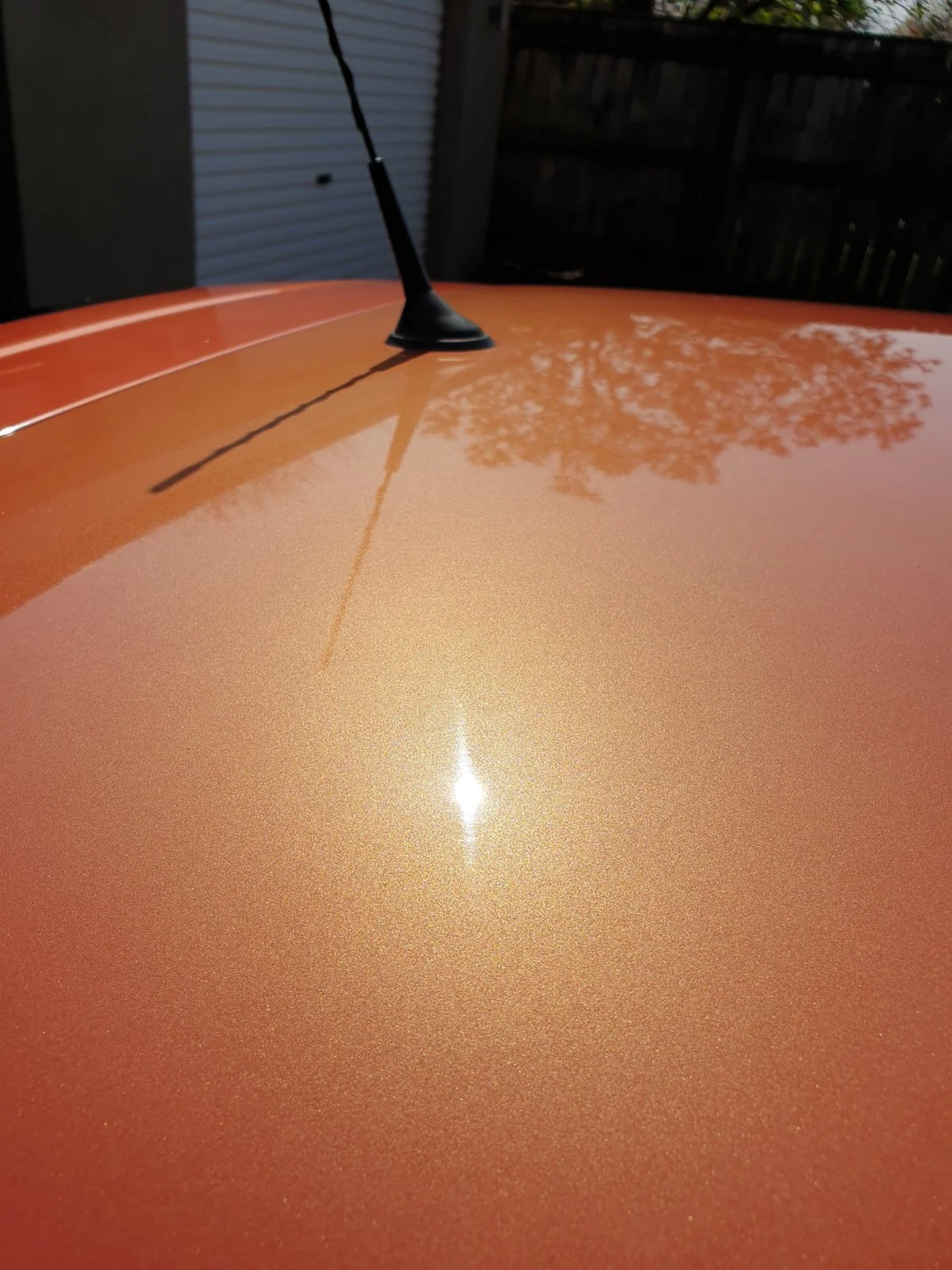

Give the orange dci a quick clean lastnight, first one since machine polish a few weeks ago. Was nice to go to work in a clean car today. Been using the BH Auto Foam and its epic, can see the muck running off when leaving it to dwell.

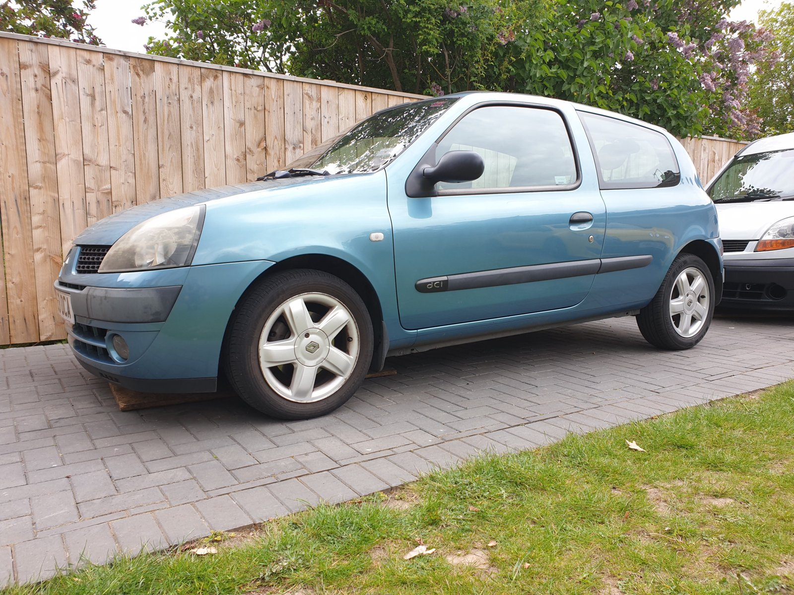

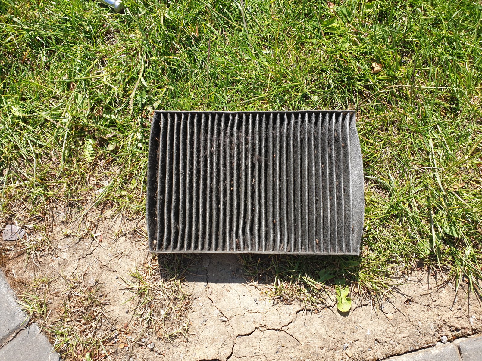

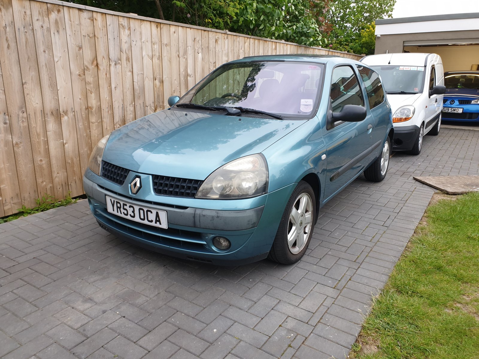

Give the Blue dci a basic service today. The oil looked like it had not been changed for a long time, filter had rust spots on the outside lol. Bought a cheap gallon of euro car parts special offer 5/40 fully synth to stick in for 500 mile or so then dump it for decent stuff, new purflux oil filter and fram air filter. Engine sounds great with fresh oil, nice and quiet, runs good. Can hear a bit of turbo whistle on boost so need to have a good check round to see if any boost leaks.
Also changed pollen filter as the blower was asthmatic at best, even worse than the usual crap clio blower. I think it was the original one
Reset trip earlier and epic mpg as usual, not had to put any diesel in yet still running about on what was in when bought. Overall seems to drive well, will need shocks up front soon and the crappy arb outer links doing but apart from that could use as is, cant argue for a cheapo car.
One thing ive noticed is the handling is pure barge compared to the orange dci, the eibach sportlines and pilotsports are epic for making progress day to day, this nearly fell over taking the corners at the same speed as the orange dci

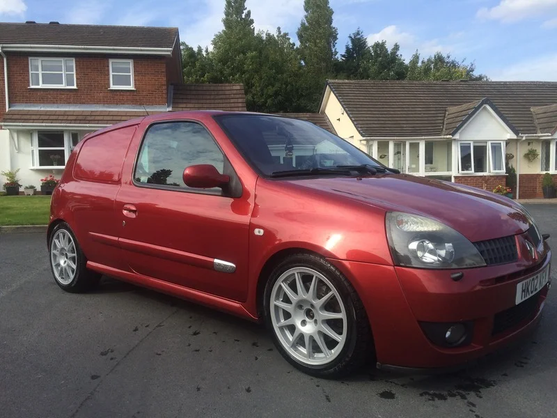

The flamer van looks awesome @MattRS182 id love to do a sport van but need the dci mpg.

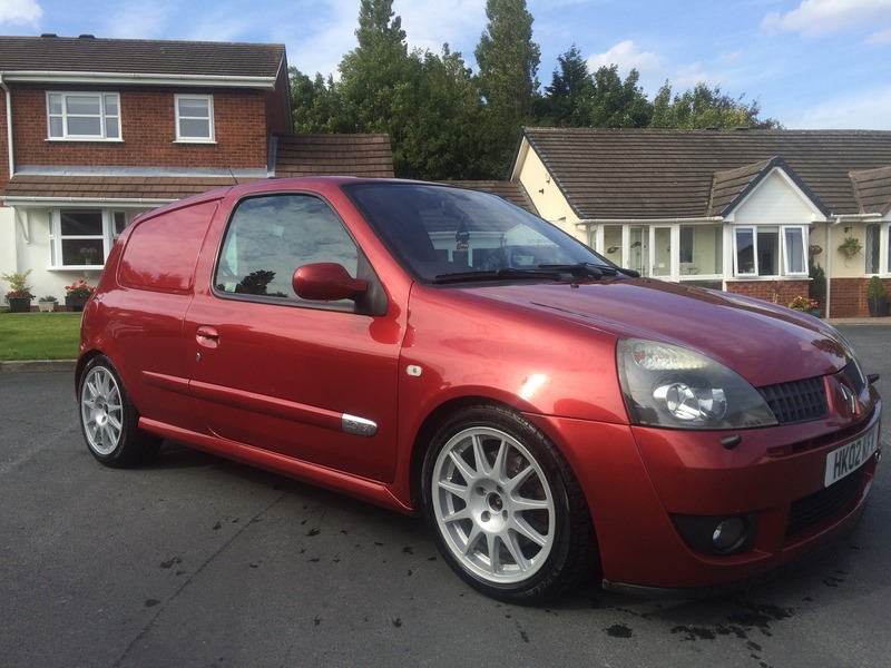

MattRS182
  #3 PH2 172 Flamer
Has anyone done a sport rep in this colour? This colour was same as my first ever clio (first car) Would look great as a 1*2

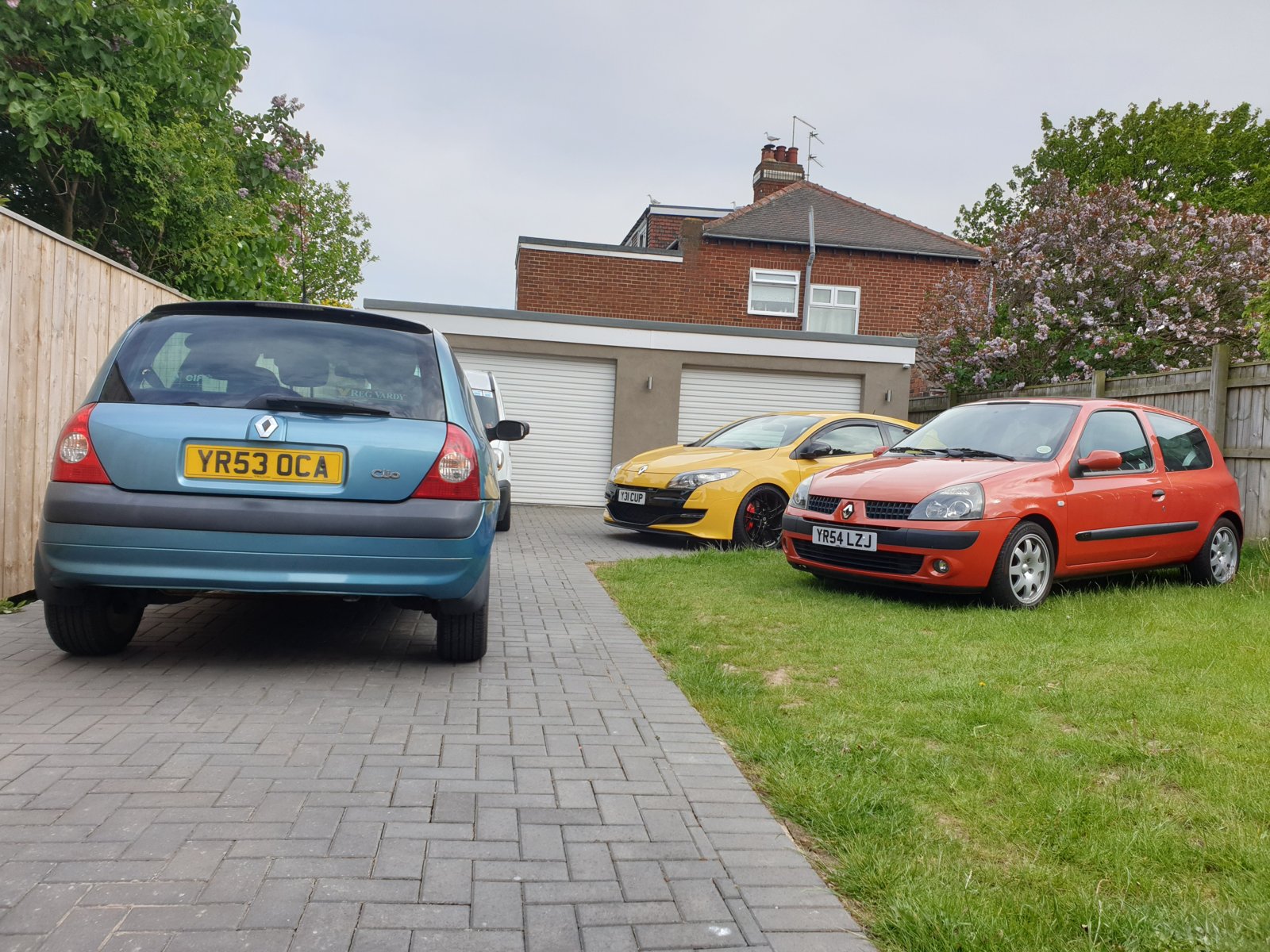

Mine moans at me when I have 3 Renaults on the drive. She gives me horrible looks as if I've just shat on the drive and started rolling around in it??
Its took a bit of graft but shes a Renault hoarder now. Wont let me have a beavertail recovery truck though still working on that :cautious::LOL:
