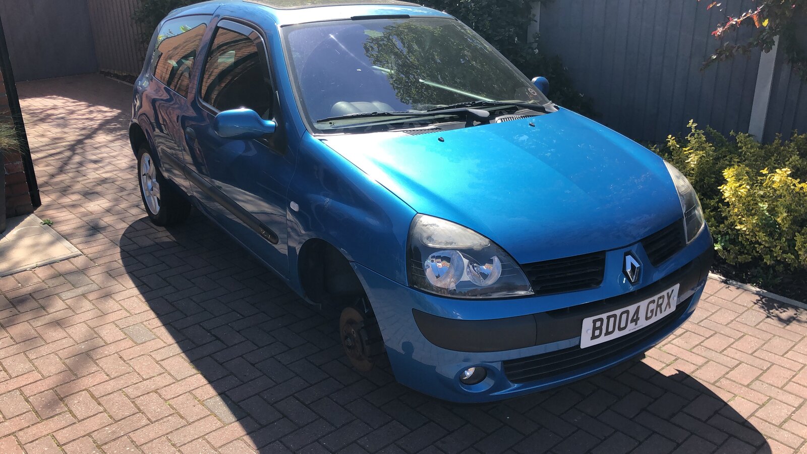

A bit of graft done this week
One of my mates bought a scrap Kangoo, the fuel system was shot so would only start with easi start, and bodywork rough as feck so was only going to the weigh in yard. Engine/turbo were decent as only done 80k, so stripped loads of bits off before it went, turbo, alternator, egr, engine mounts etc for free which was a bit of a result.
One way trip to the crusher now

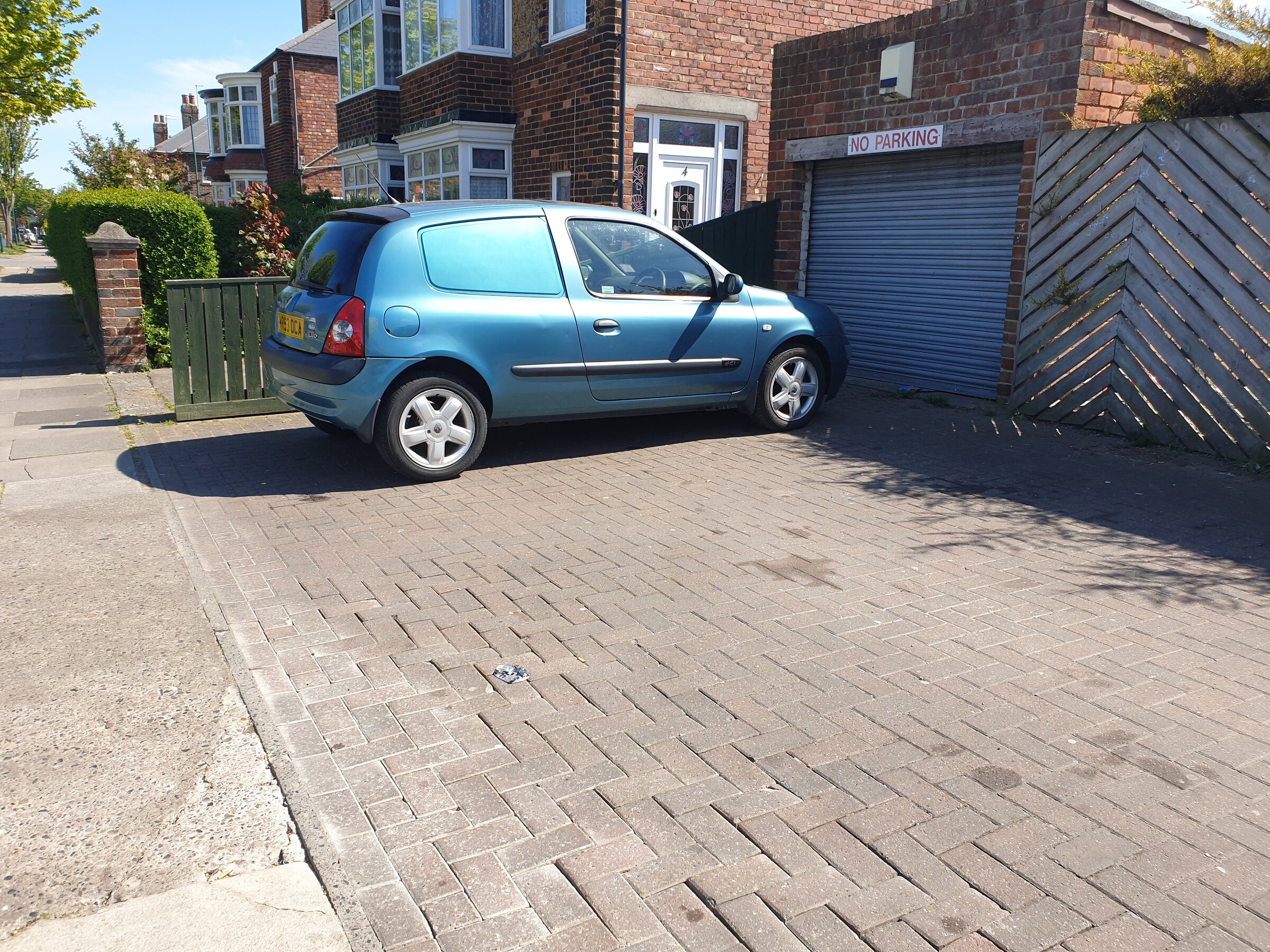

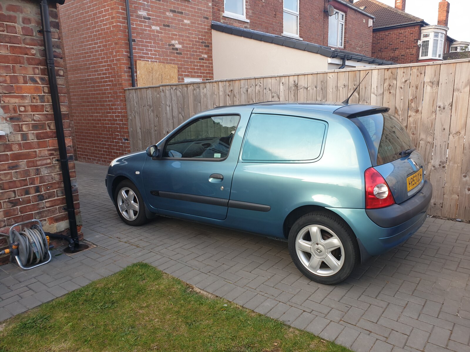

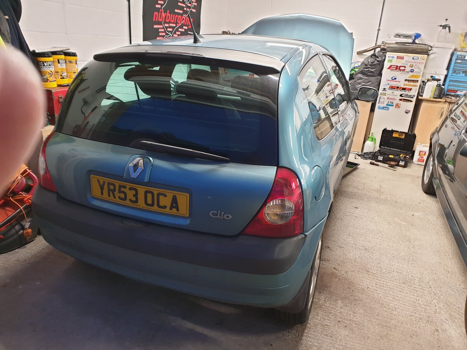

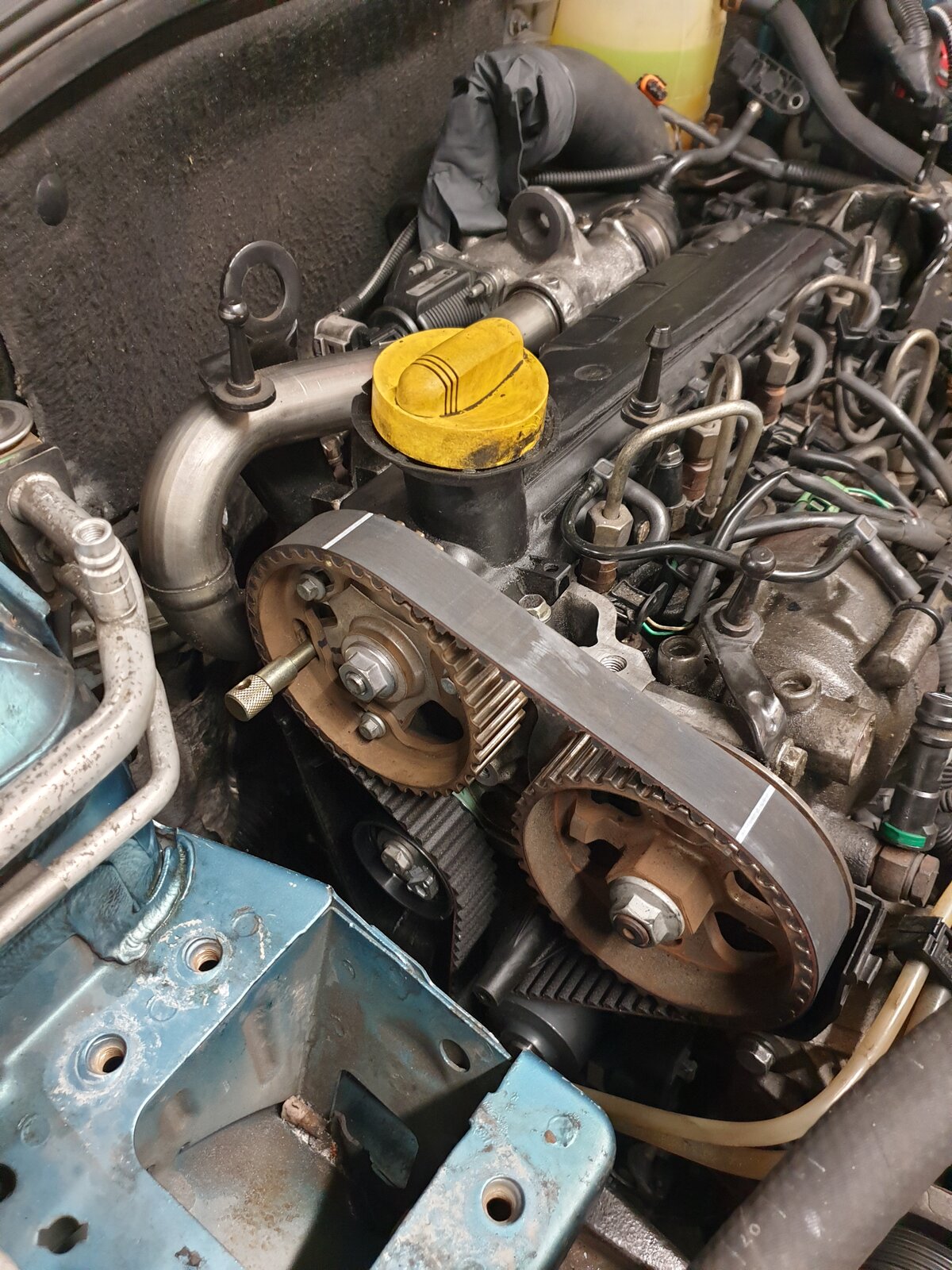

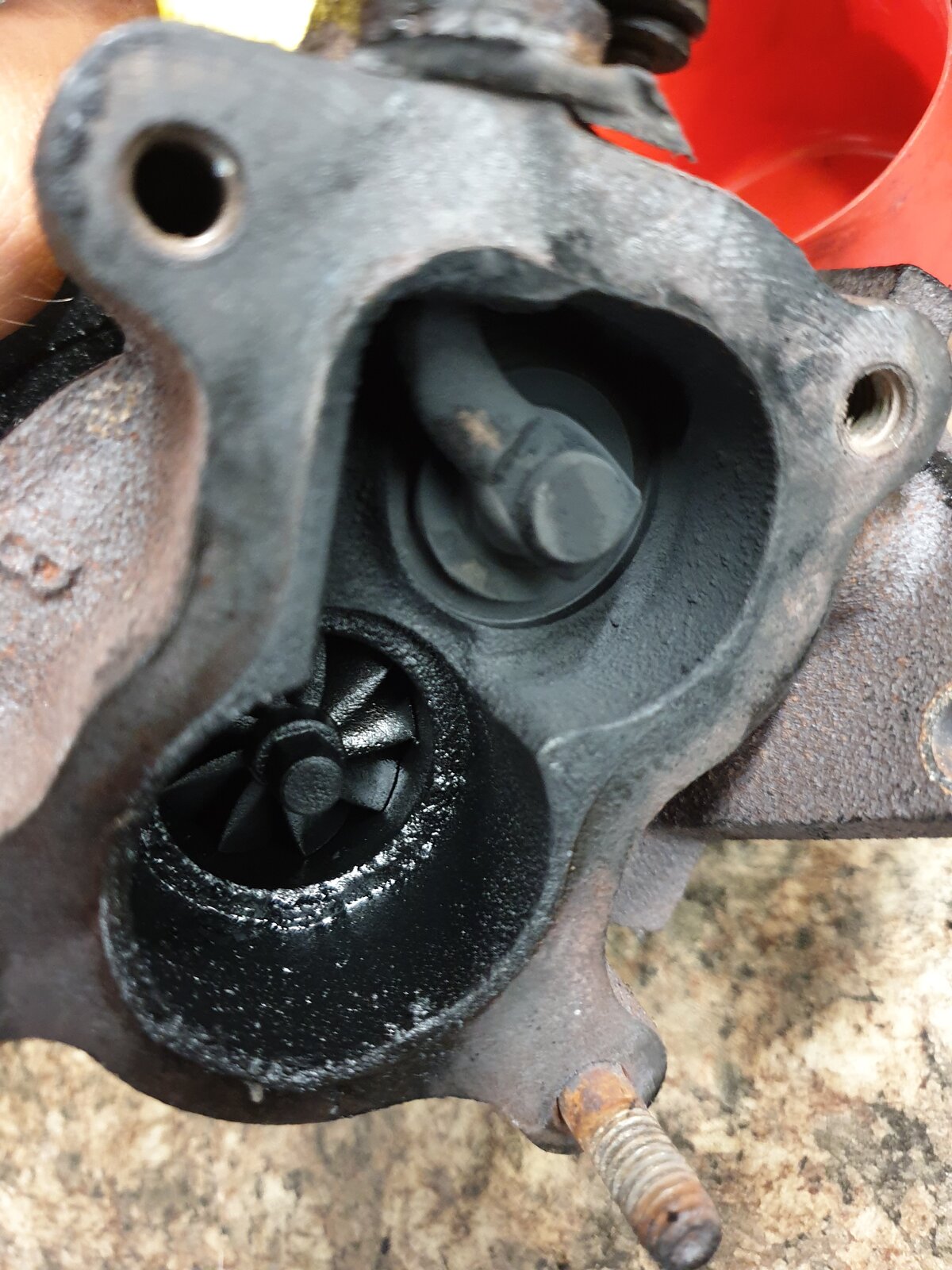

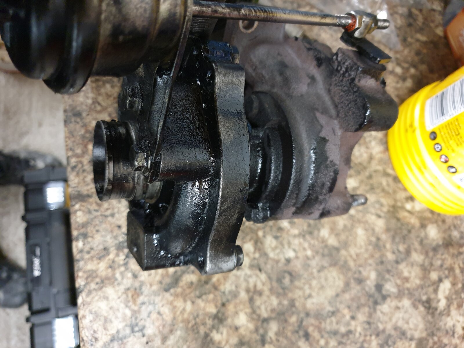

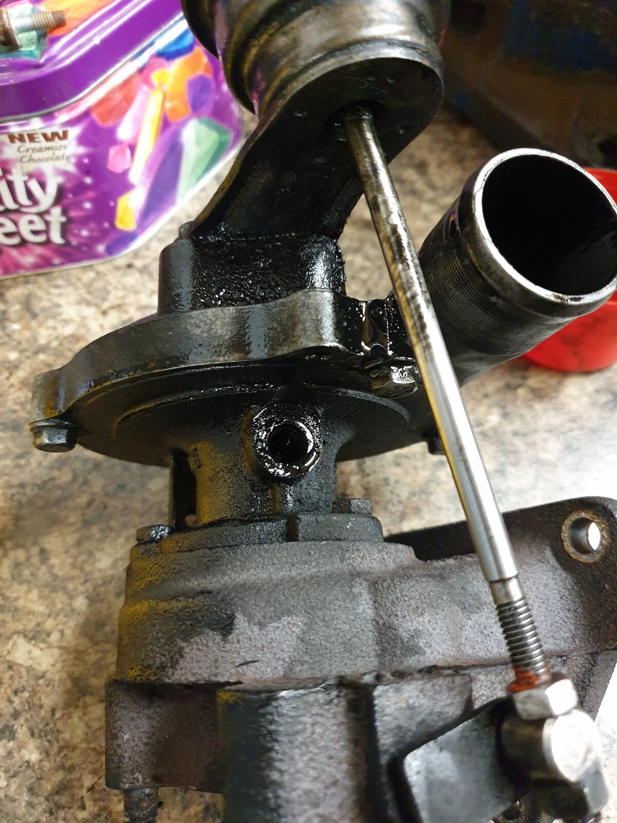

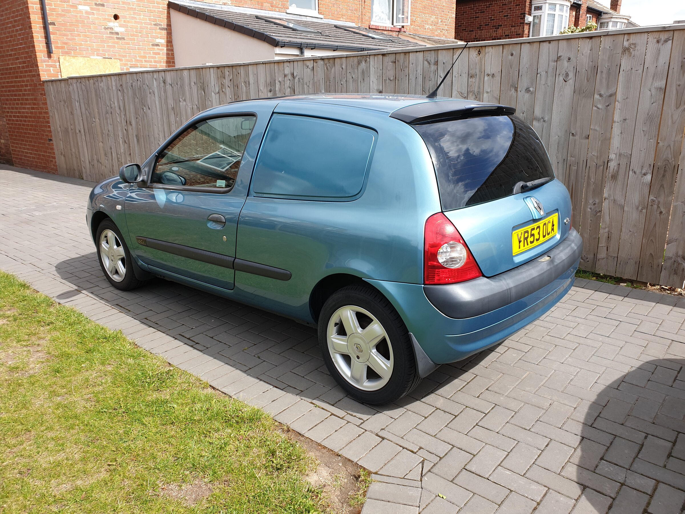

Stripped turbo off the blue dci, as i suspected it was about shot, and sounded like a siren on spool up.
Did not realise it was this knackered until removed, not many more miles left pissing oil all over. Replaced with the fresh one off the scrapper Kangoo

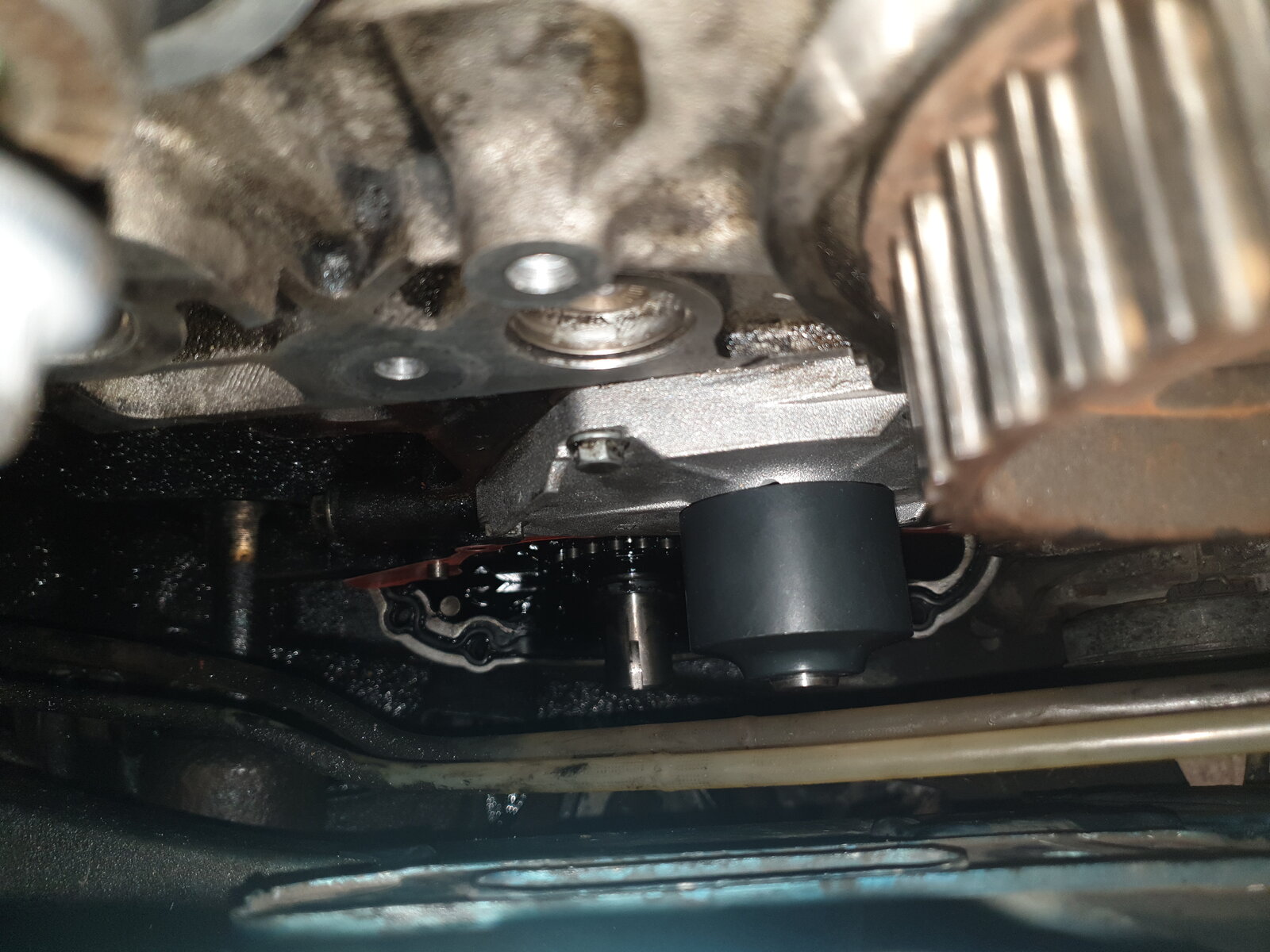

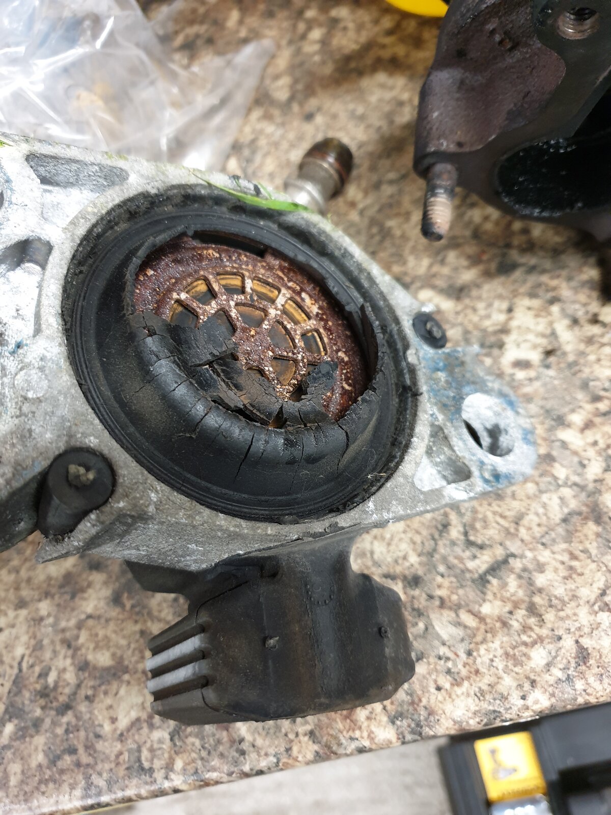

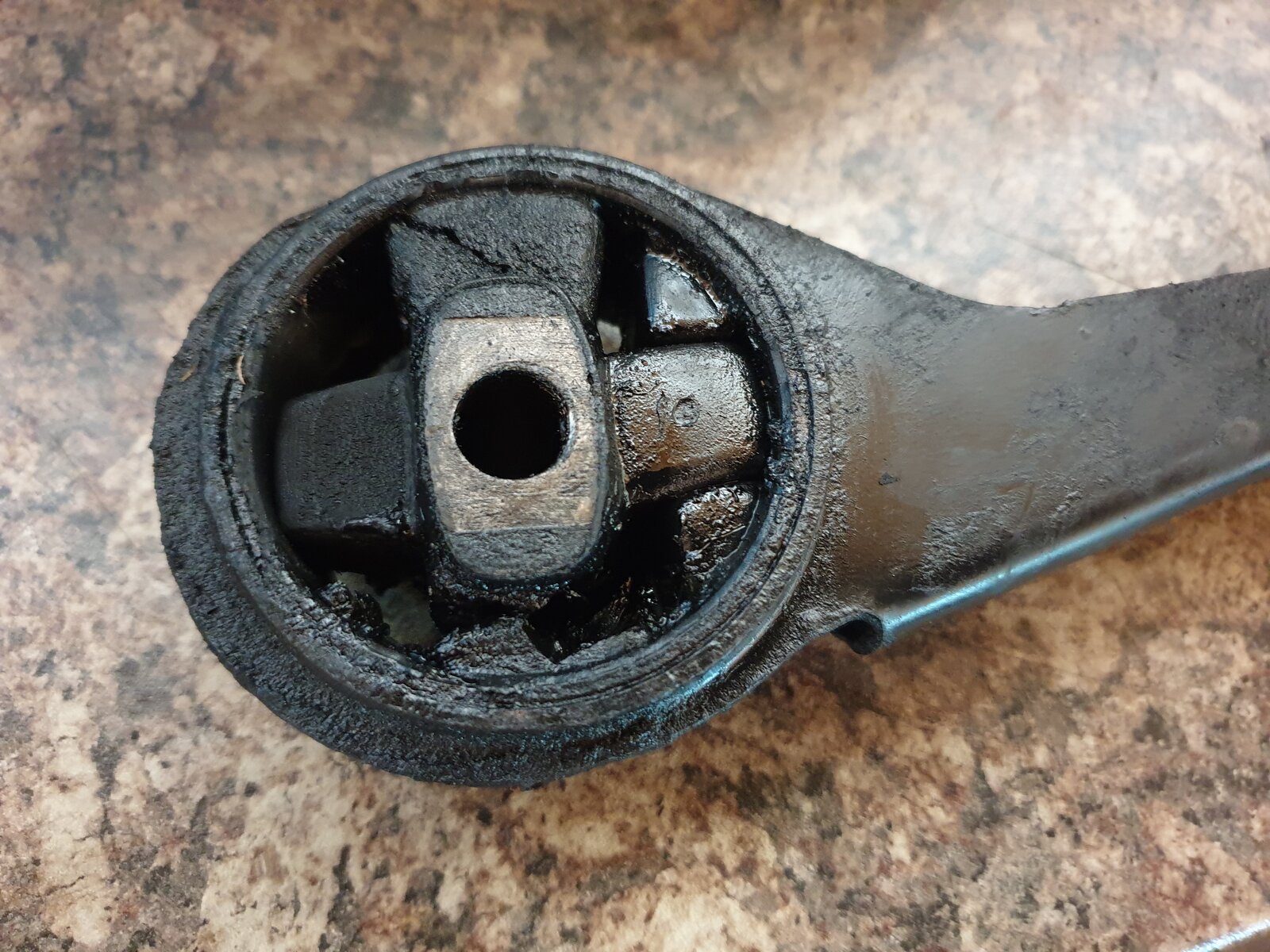

Last time i drove it, i kept hearing a deep knock when going over speedbumps. I highly suspected the top engine mount was knackered, so took it off to examine and the problem was fairly obvious as oil damped. Good 2nd hand engine mount fitted off the scrapper Kangoo
So with that all done, took it for a test drive and running a lot better, smoke free and knock gone. It had a resonation when accelerating hard, which i assumed was dead top engine mount, but was still there when replaced so inspected the dogbone mount and gearbox mount.
Dogbone was fitted backwards by some cowboy so the large bush was fouling the gear linkage on acceleration
and the bush was torn so replaced with a cheapo dogbone for now

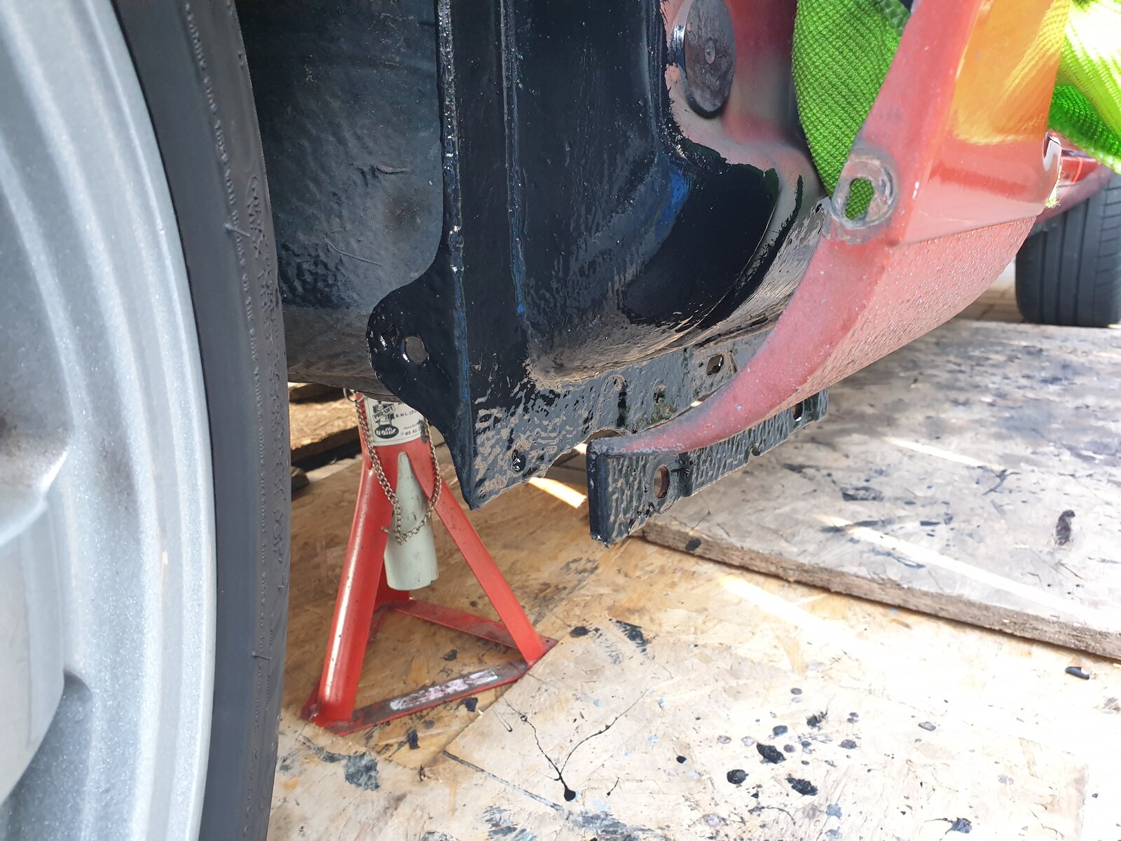

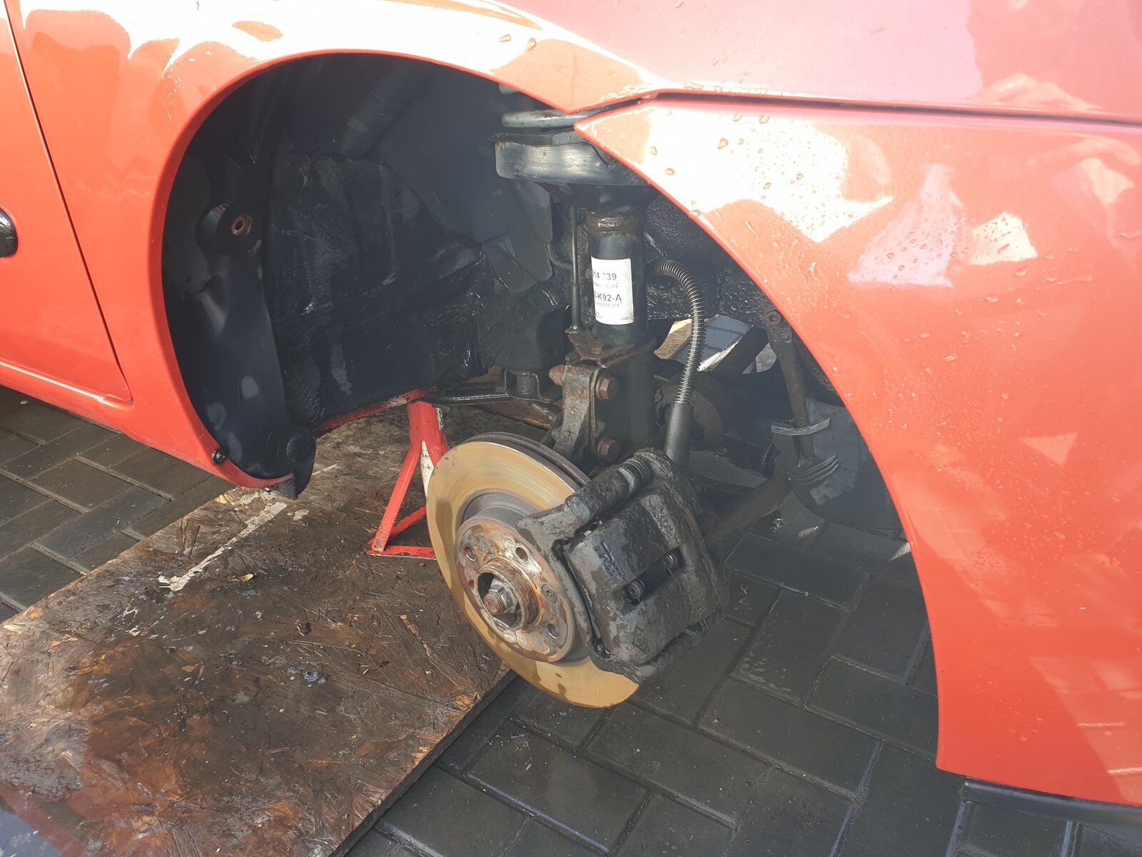

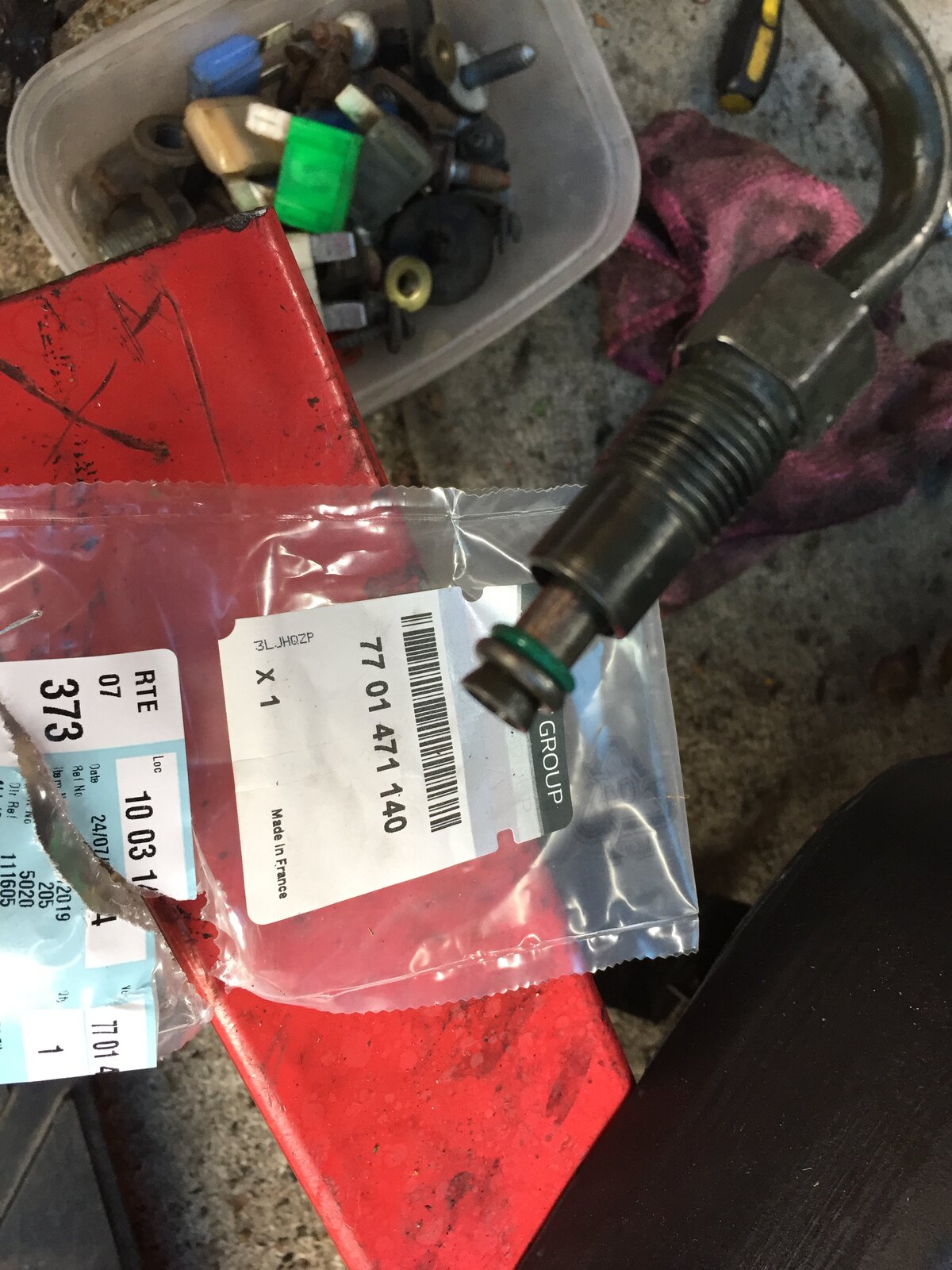

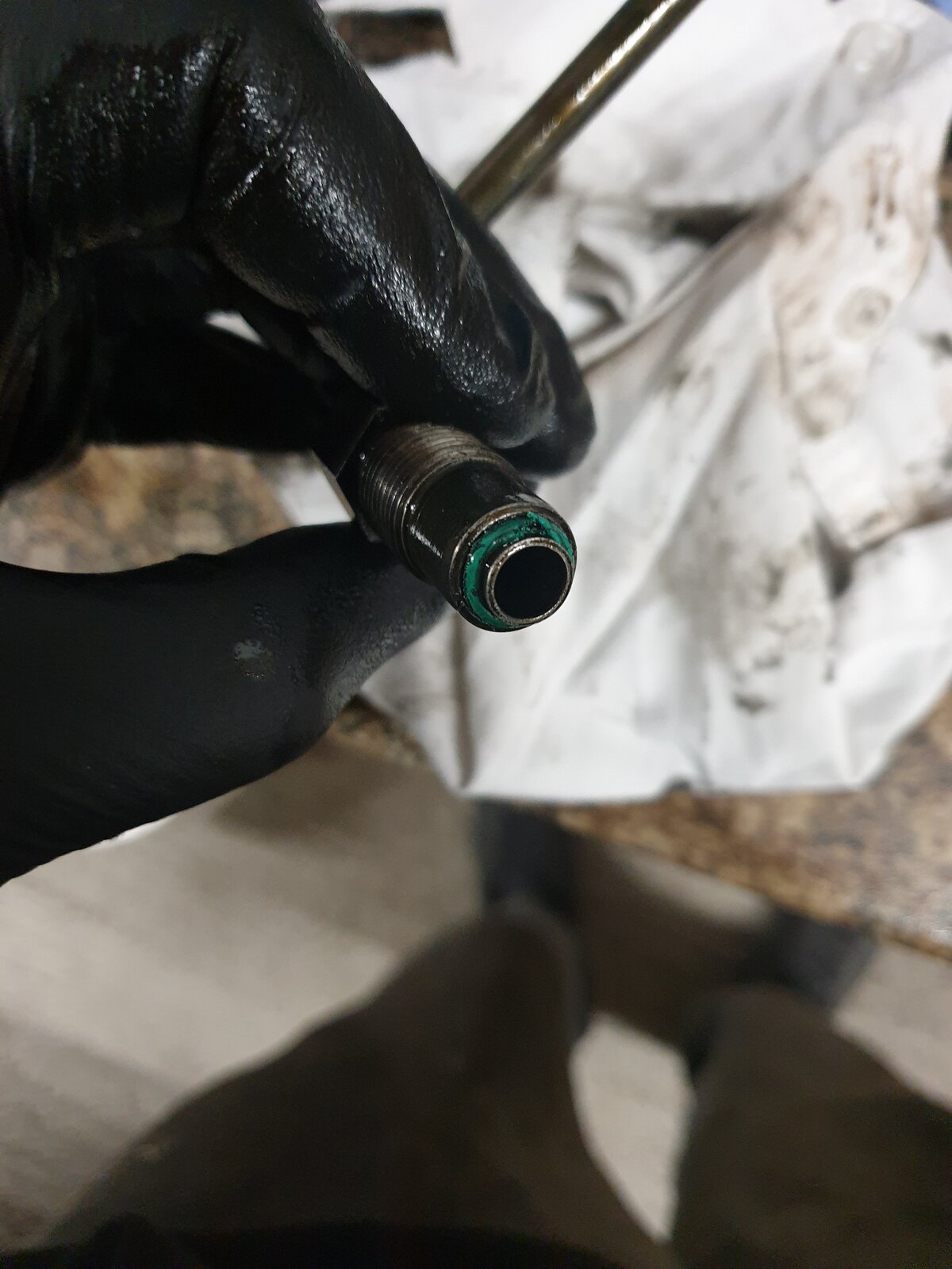

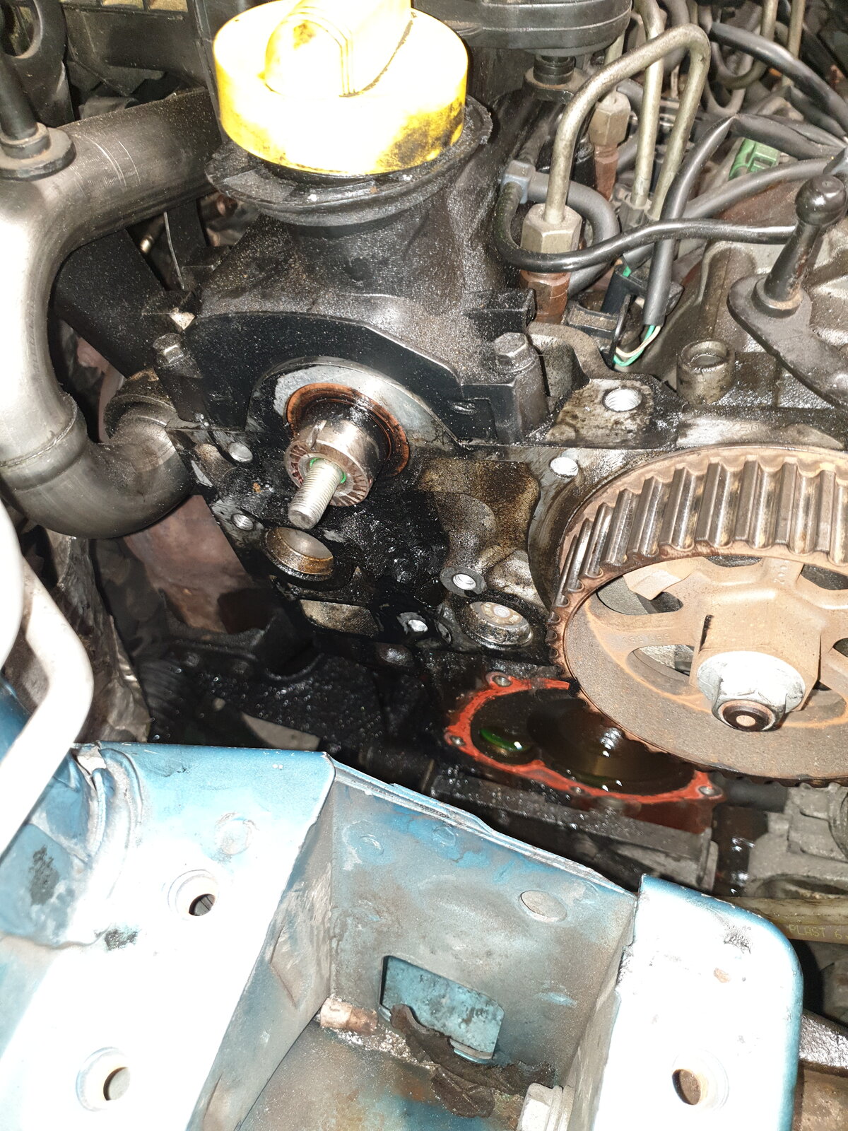

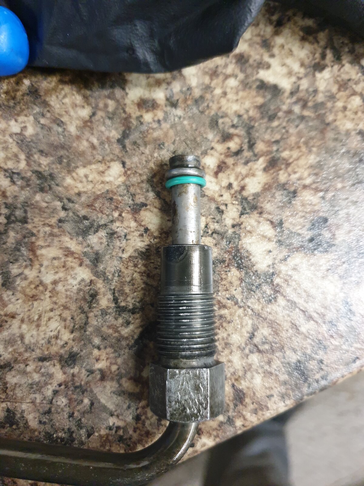

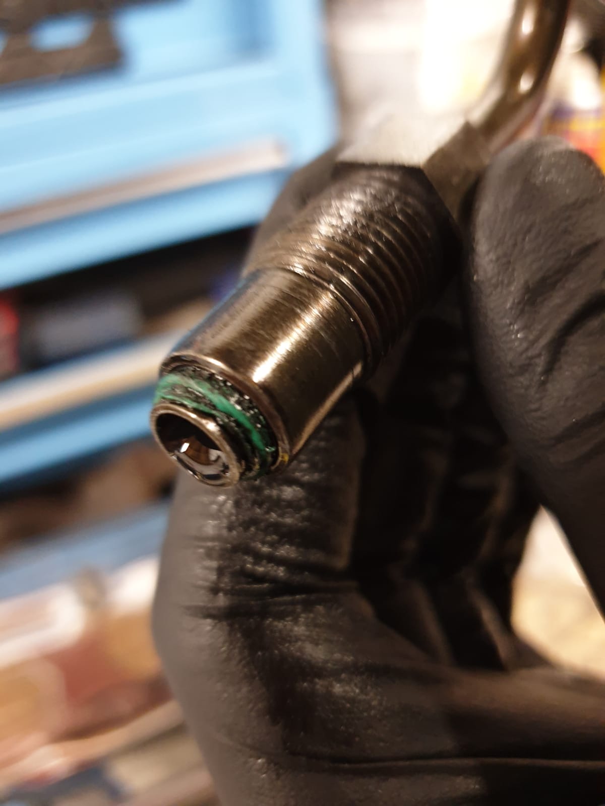

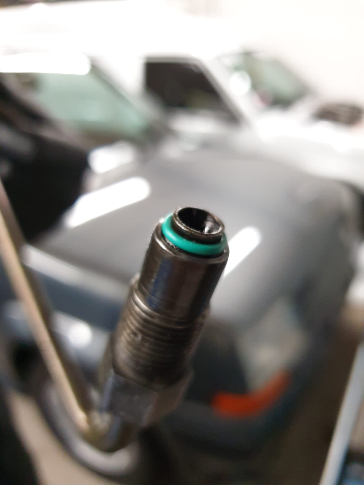

I also bought a pair of aftermarket lower arms and inner tie rods, fitted them and whilst up in the air noticed fresh oil. Looks like turbo oil feed has been off and o ring not replaced.
O ring replaced, and leak free. Had to take a brave pill and flog the fitting up a bit to stop it weeping though, not a great design imo!
Took it out for a test run this morning, had to get out early as they are resurfacing the road. It drives great now, tight and no suspension knocks, just needs the toe setting.
Went past the local garage my mate works in early doors, and they were just opening up so perfect time to get the geo set (trade price of course) but the fecking geo lift had broken so no chance until next week.

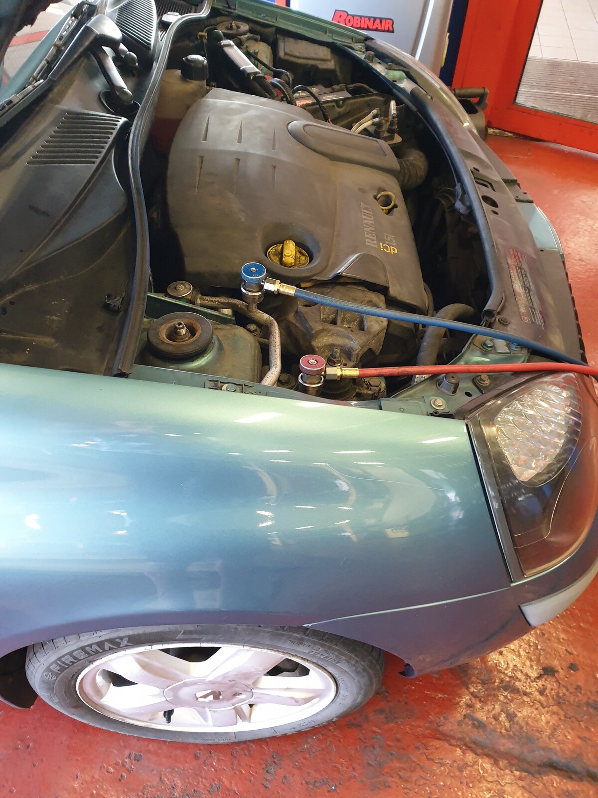

I mentioned the air con needed a leak check as no gas in it, he boshed it on and it seemed to hold a vacuum ok, so gassed it up.
Fired it up when done, and the ac compressor kicked straight in, and the aircon is ice cold, could not believe it. I thought the low speed rad fan had issues, but works fine. So been blasting about today with ice cold aircon in 29deg heat, bodywork is rough, but ice cold ac and drives absolutely sweet.
