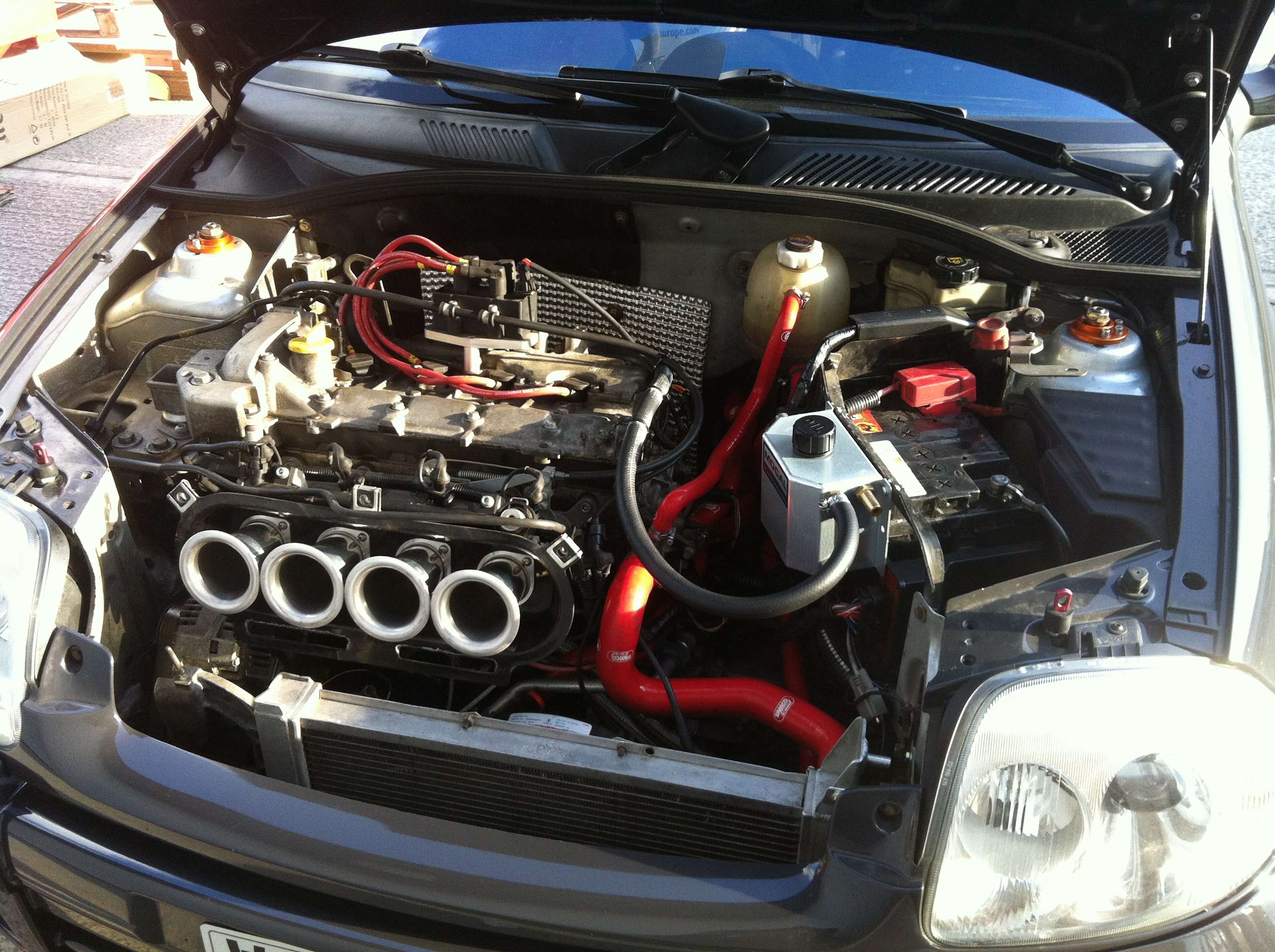

So leaving early morning a few weeks ago, I finally took the car up to Tour De Force to get the loom fitted and everything up to a good standard. There have been a few stumbling blocks unfortunately as is always the way with this car!
A rundown of what has been done whilst it’s been there:
  • Fitted replacement wiring loom ( Neil Ph-reebone’s) + M6 temp sensor
  • New throttle cable
  • R26 Injectors (newer blue ones)
  • ARP rod bolts
  • EC1 ECU + calibration
  • Mocal catch tank
  • B14 Bilstein suspension
  • Geometry and corner weighting
  • Powerflex ARB bushes
  • Powerflex wishbone bushes
  • New track rod ends
  • New ball joints
The radiator fan on the pro alloy rad has also packed up so Matt has ordered one in for tomorrow before any mapping takes place. Also there was a problem with the crank sensor from the old Omex loom which was causing an intermittent misfire at 6,000RPM, so that’s being chopped out for a standard Renault sensor. The car seems to keep coming up with ways to prolong its stay with them, I think it likes it there!!
All in all though I’m glad these things are cropping up now rather than later on. Looking forward to trying out the Bilsteins and fresh suspension.
  Evo 5 RS
Re: My Phase 1 ITB Daily Runner
Nope, I couldn't
And now I have!
Went up on the train this afternoon, got there at just gone 3. The numbers are in. 208BHP 178ftlbs.
And it drives/goes REALLY well :). Will put up some more info later and graph etc when it comes through (Matt's printer packed up).
After having an absolutely flawless drive back, I got back in it to start it up at the warehouse and it won't budge! Matt is sending me a starter solenoid as that's what he's pinning it on. So bit of a s**t ending to the day but overall it's an absolute brute now, really pleased with it

Nice one, good numbers, what's the spec of the engine (sorry if i've missed it somewhere :eek: )
Also gutted to hear about the starter motor, that's a b*tch to get too!
I know, typical! I can't believe it decided to go now.
It's Jenvey 48/90s and 428 cat cams on cup setup :).

Great results then, not far off the power mine is putting out with 421's, really isn't much in it :)

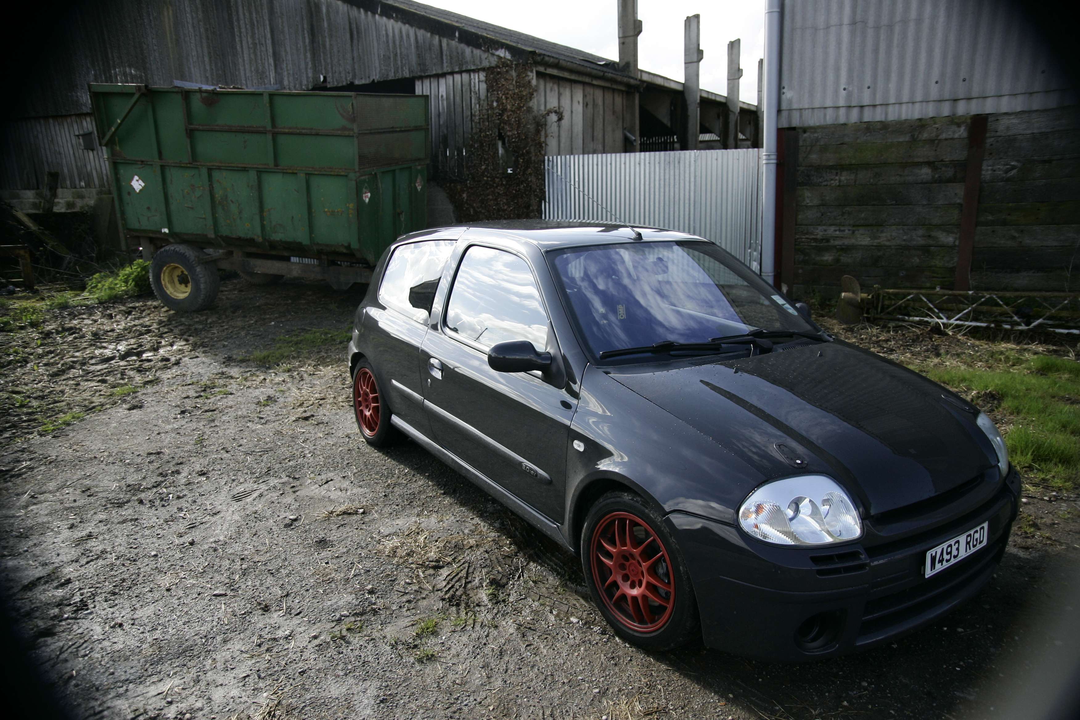

Just though id add that I have seen this car a few times now, last time was before all the bosywork, on the previous engine and it was nice then, but after seeing it yesterday it is just stunning.
The paint looks fantastic, and the wheels go with it so well, the work TDF/Fred have done is top notch, and looks near OEM.
A stunning car (Even though my head hits the roof :eek:) and first dibs if you ever sell it!
