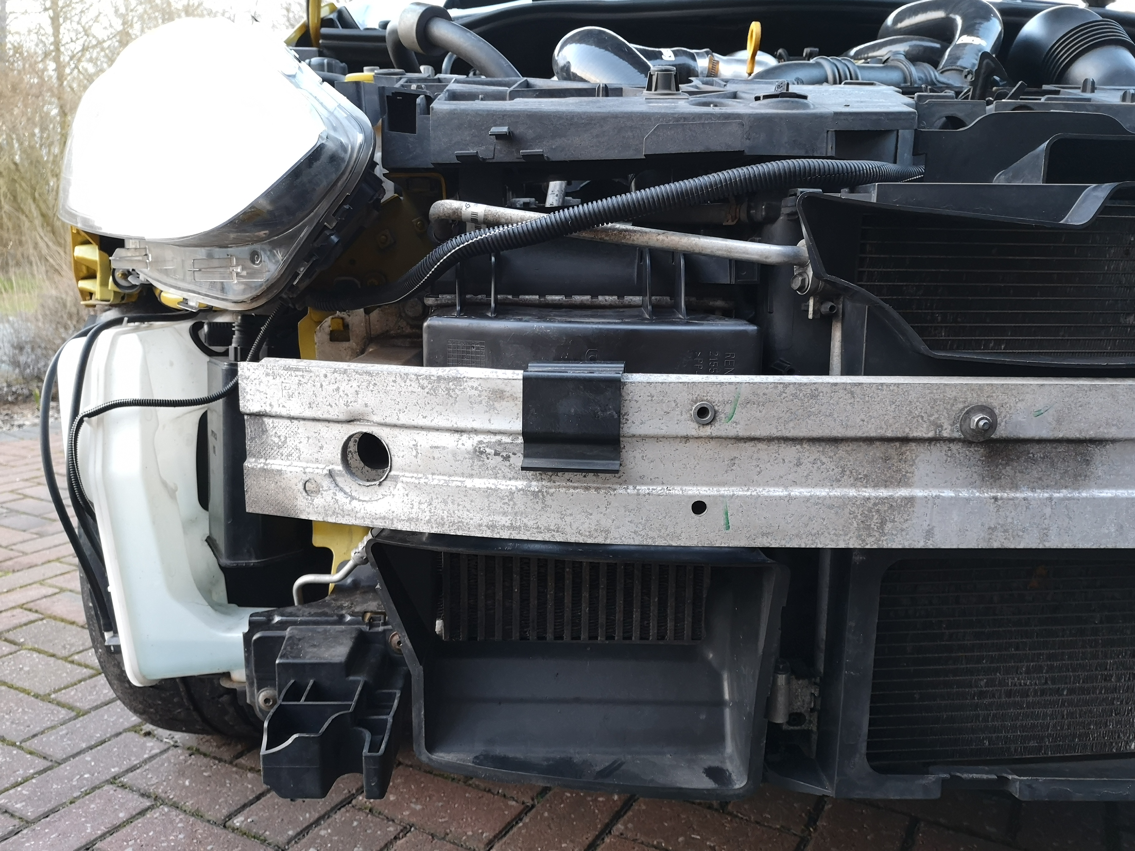

First things first - to bring it into this decade, I went straight to Stage X in Coventry to have the RS monitor and android auto installed. £200 and an hr later, all good and now could plug my phone in to use google maps, YT music etc. Plus I could keep an eye on coolant temp, oil temp, clutch temps, etc.

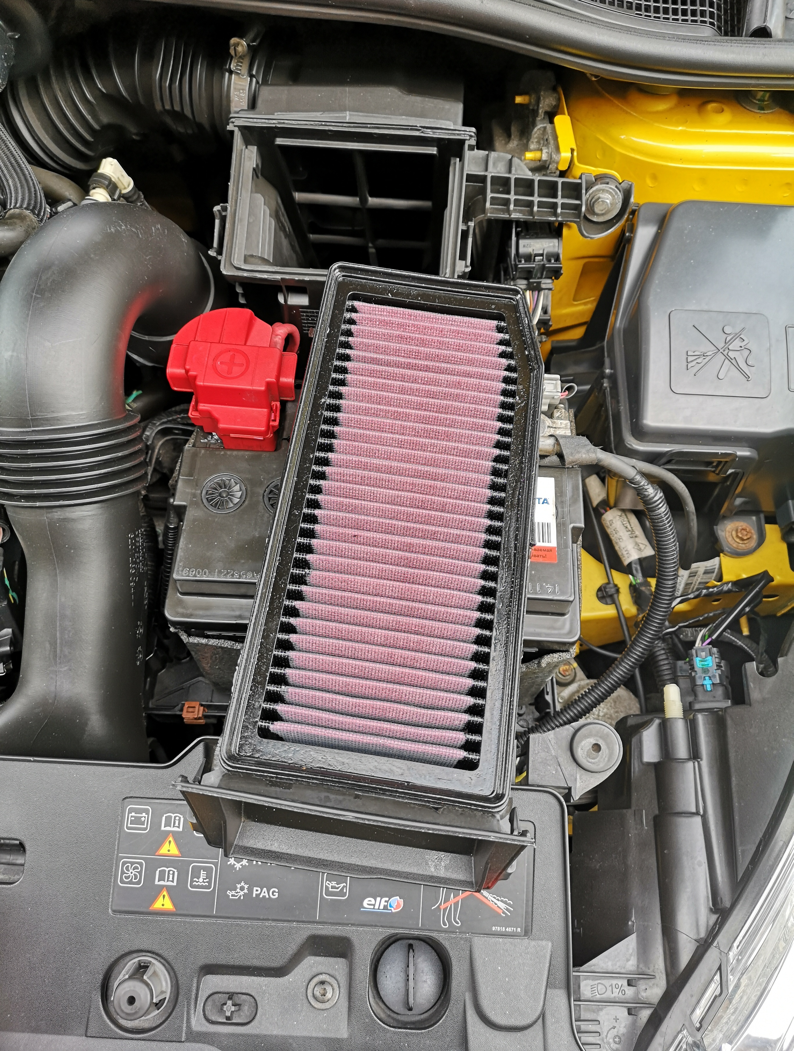

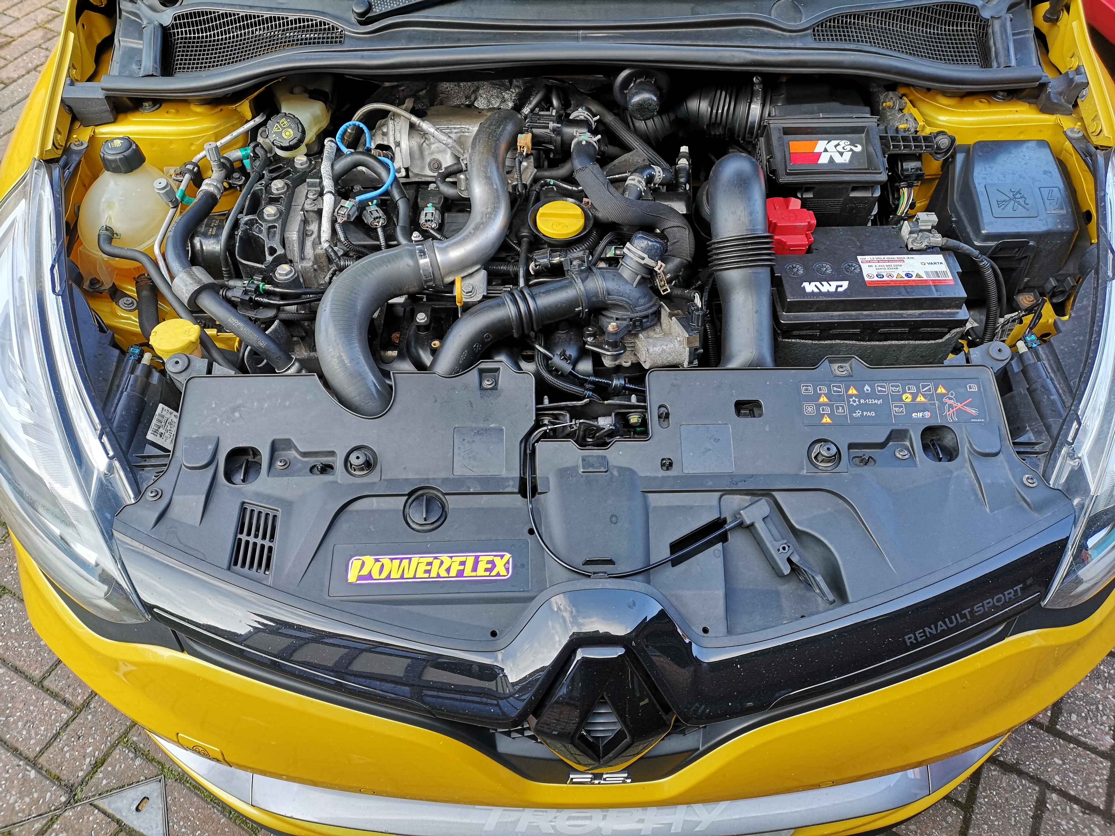

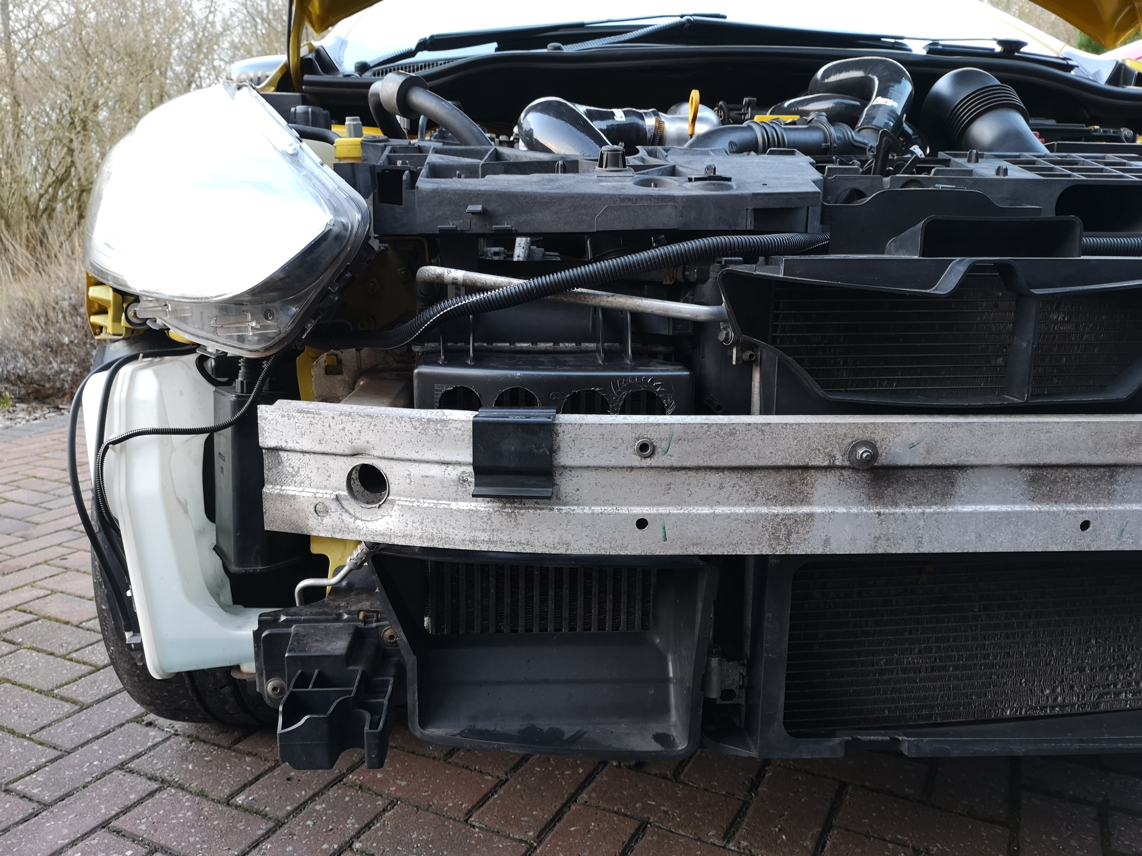

When I got it home, I started to give it a clean up and remove the ITG induction kit. Wasn't for me with all the whooshy noises, so stuck the OEM airbox back in and dropped a K&N panel filter in there instead.

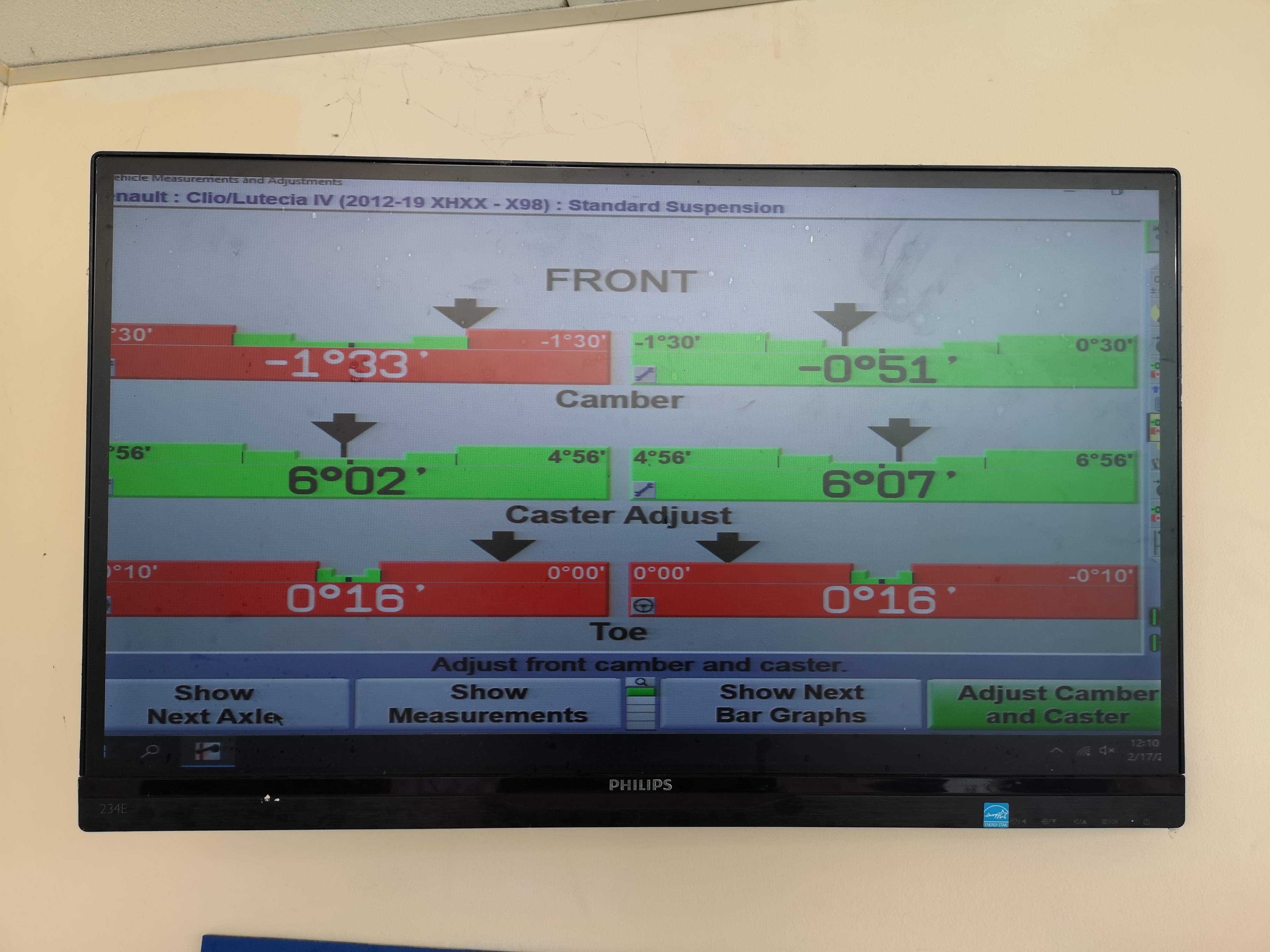

I had also noticed (and worried like I do) that there was an issue with the steering as the car pulled to the right on acceleration. Looking at the tyres, it seemed these may be the cuplrit. Driver's side had about 4mm whereas the passenger was on the limit (same on both axles). So swapped them around and it was sorted - phew. But for good measure I decided to put new rubber on all corners and a much more comfortable size (OEM are 205 40 18) in 225 40 18. Opted for a set of Continental premium contact 7s in 225 40 18 and they're a massive improvement in looks and comfort. They're a brilliant performing tyre too as I found out at Oulton.

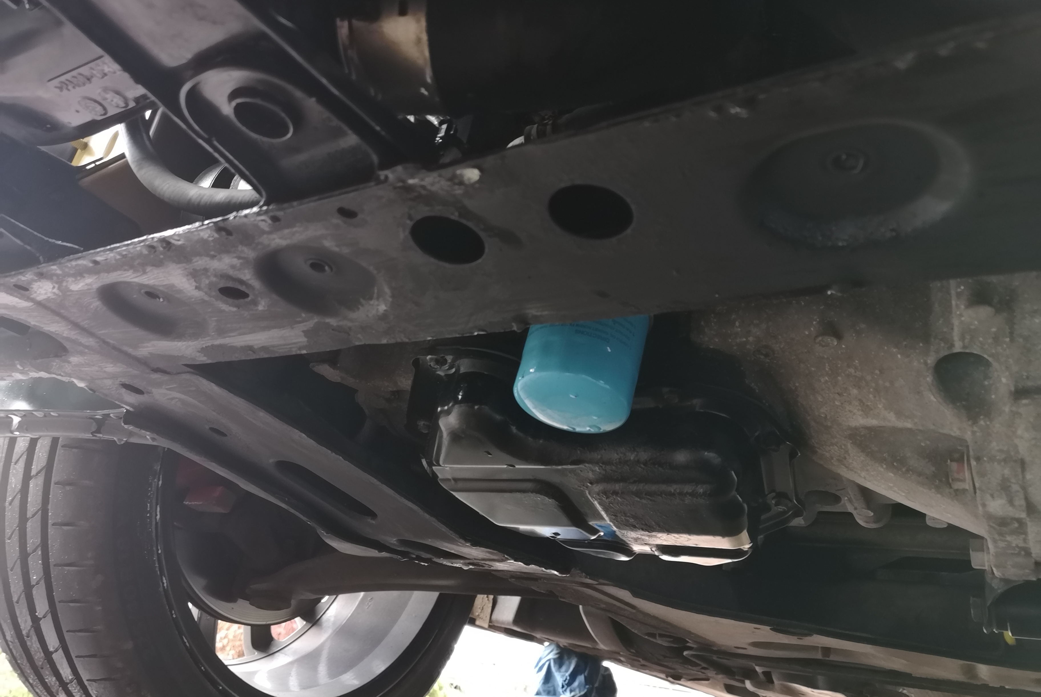

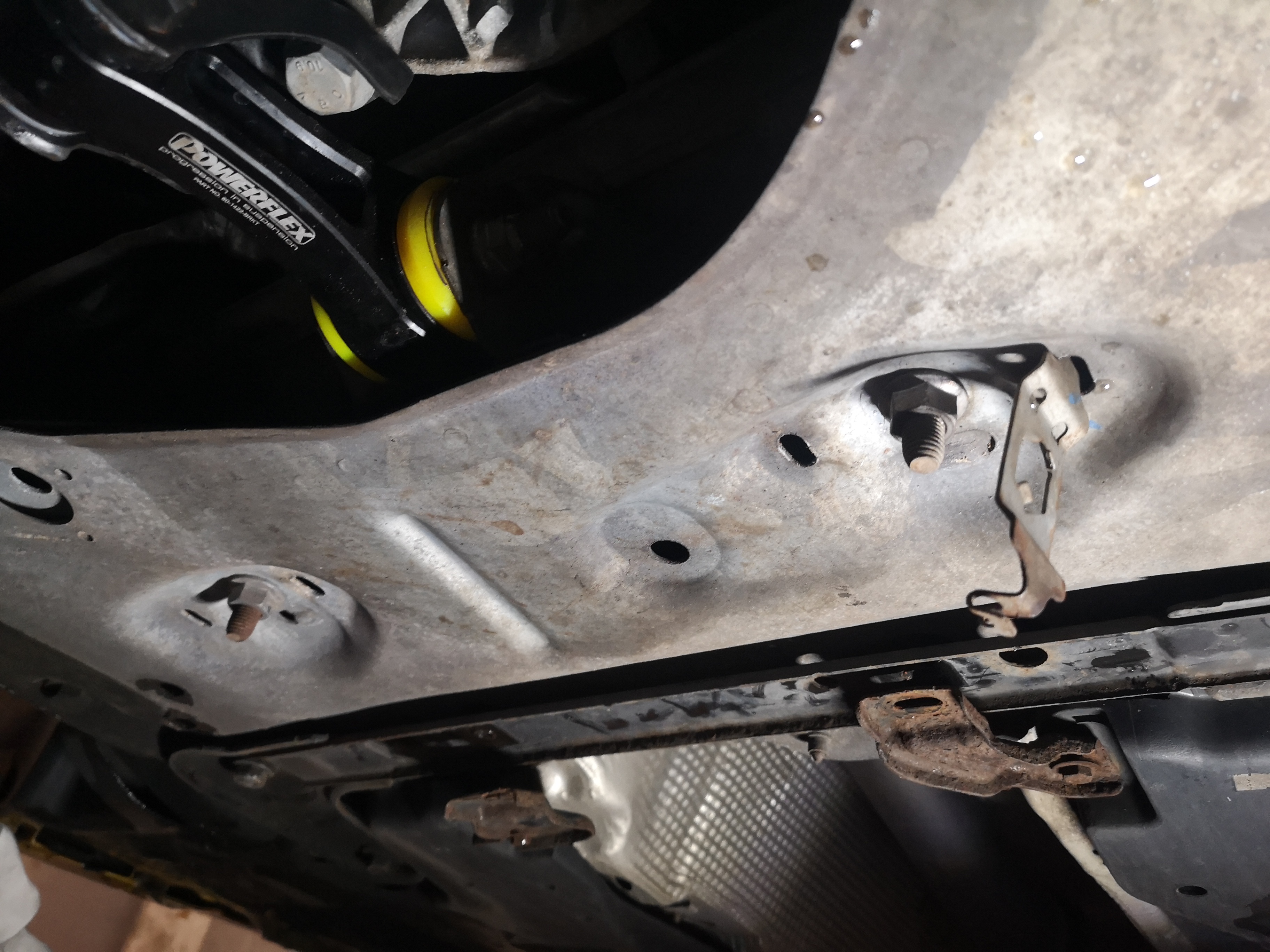

Had a clean up underneath too. Seems a common theme with renaults to have the front subframe/rad support dissolve away. So I cleaned up the front rad support with a wire brush attachment, some kurust rust converter and repainted it with some black paint I had in the garage.
The rear beam will need cleaning up in summer too, but it's only surface rust so no urgency. However there was an annoying rattle noise from the passenger side - turns out that one of the handbrake cable brackets had snapped and was clanging on the beam itself. So removed that for now, will sort properly when I tidy the rear beam.

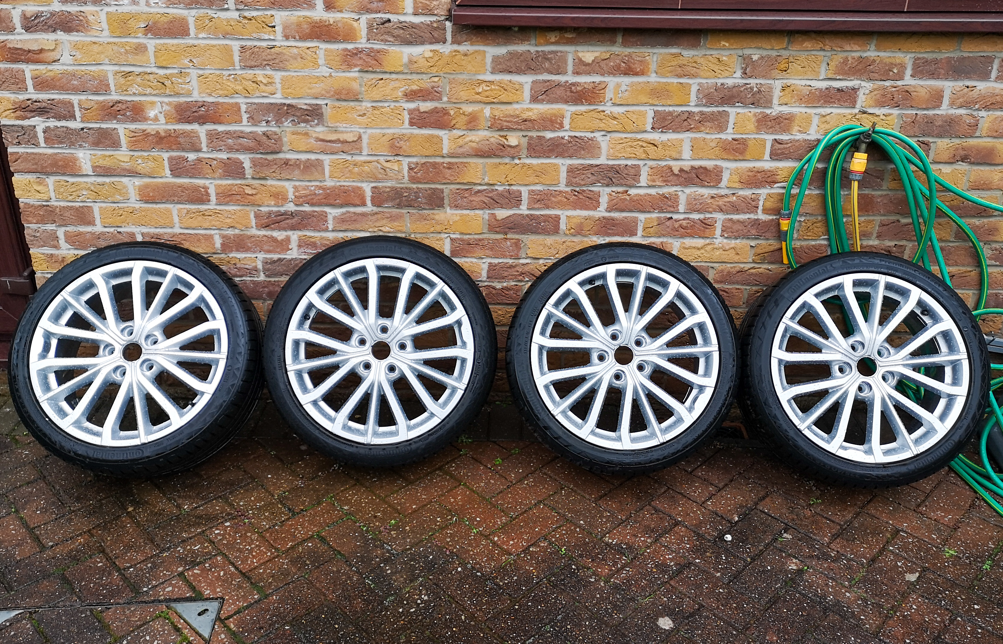

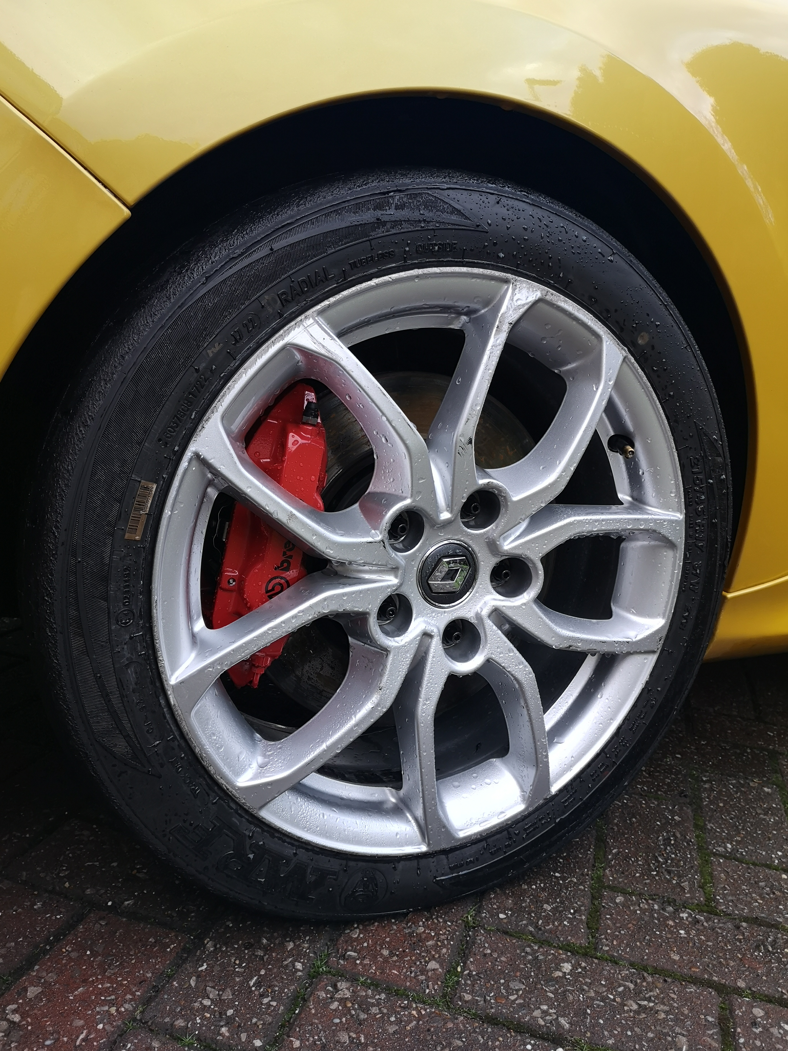

- Had the wheels redone in silver as I really don't like black wheels

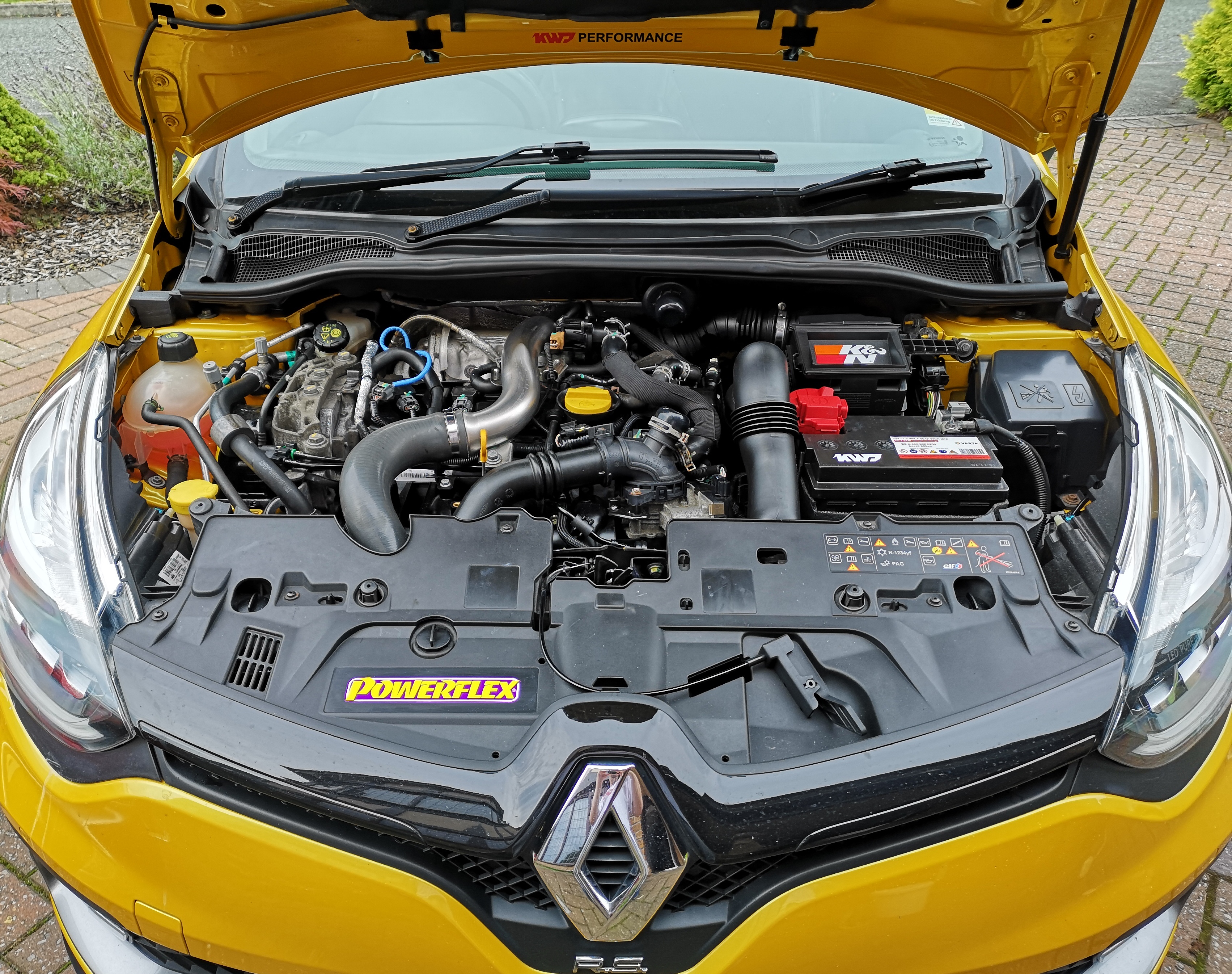

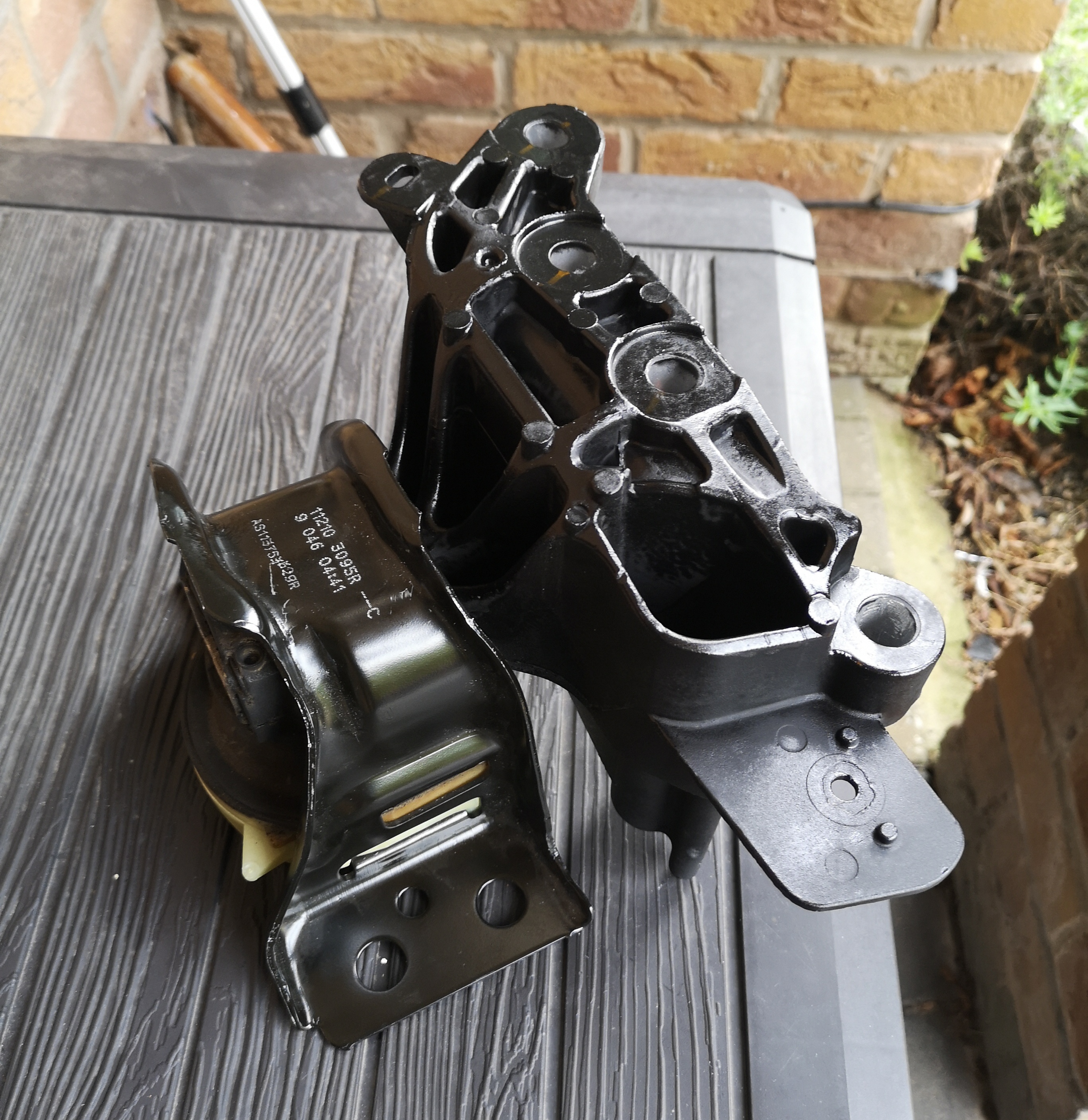

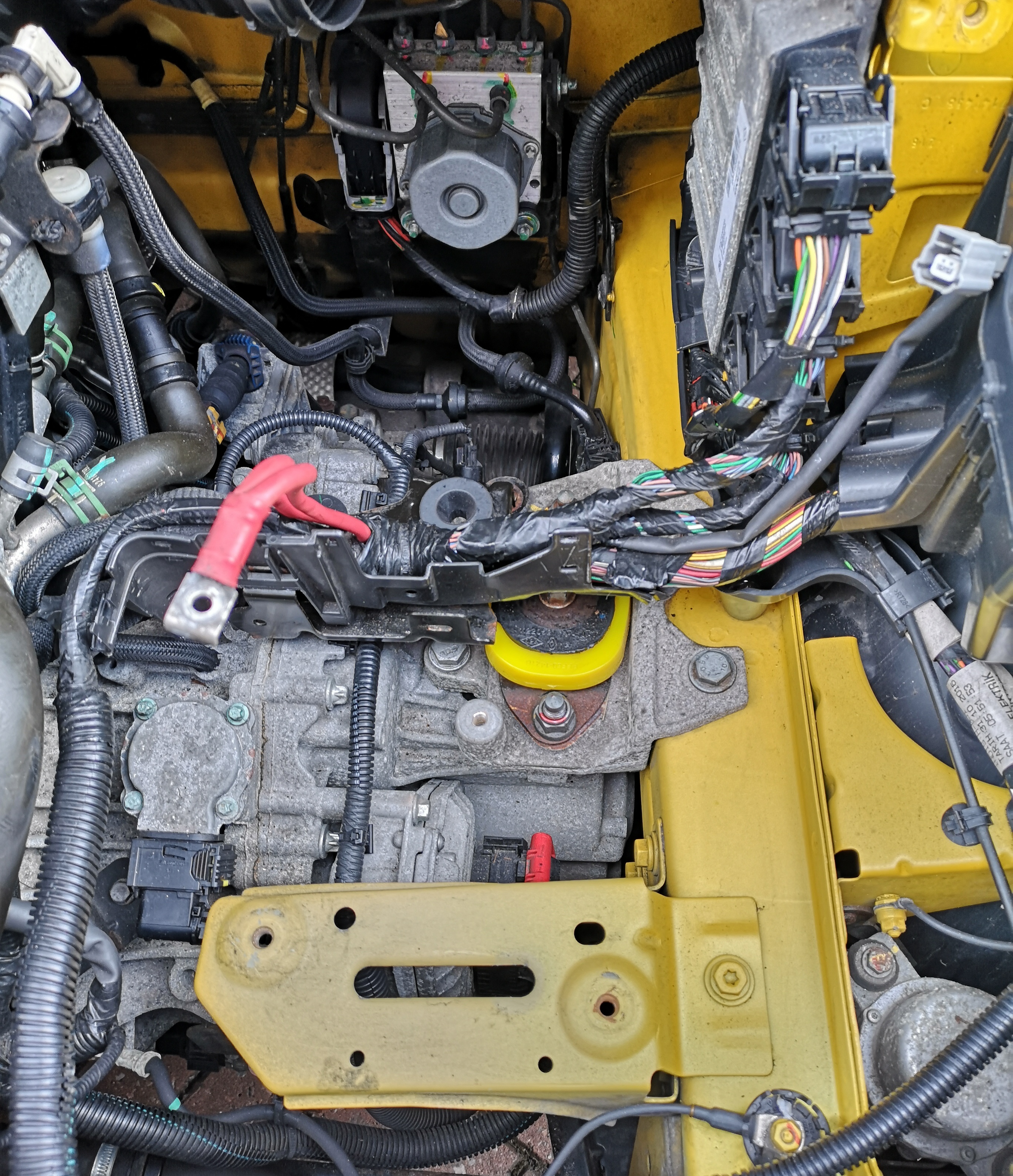

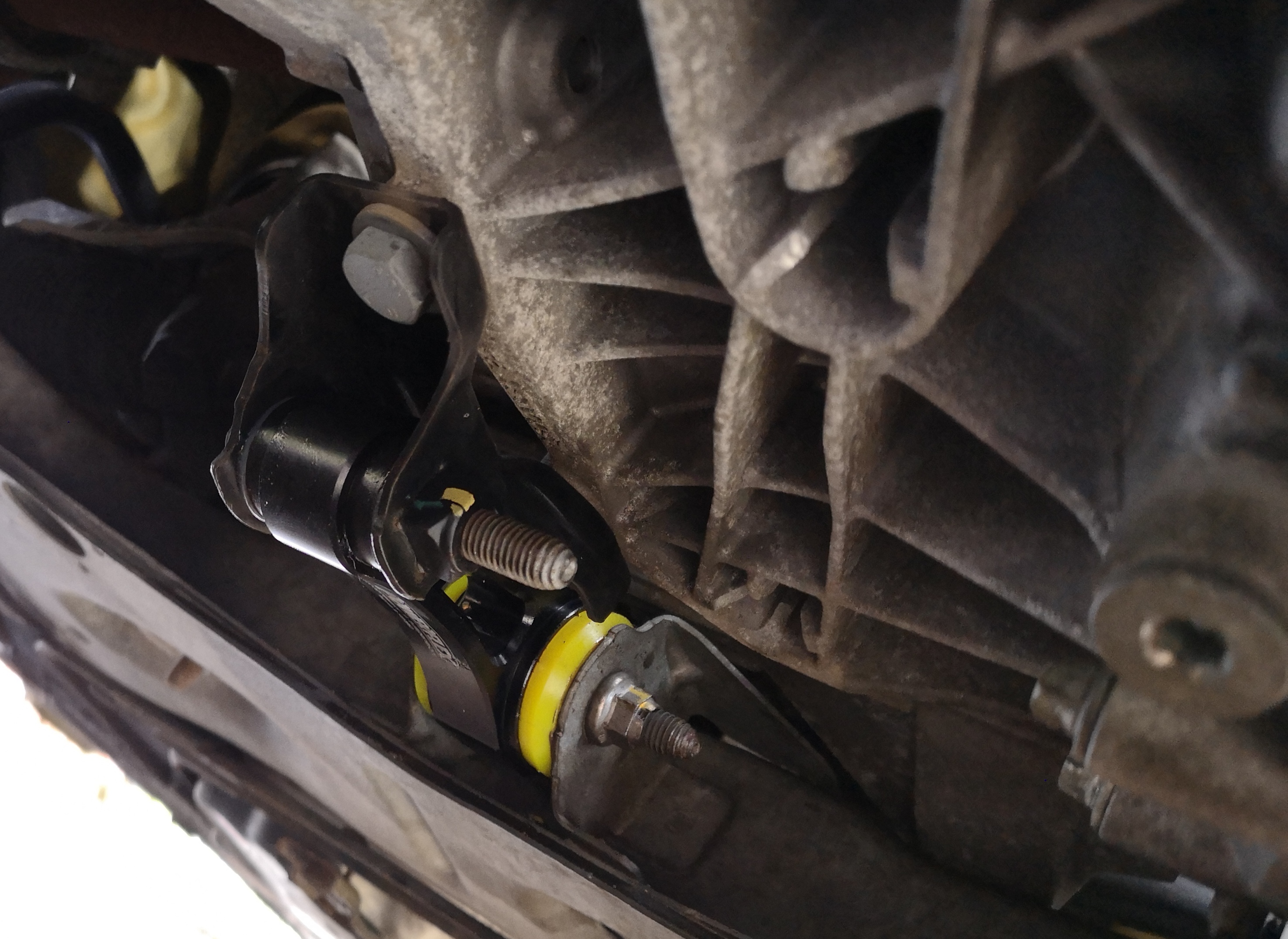

- Replaced the main upper engine mount for new (just to refresh)
- Fitted powerflex inserts to the gearbox and main engine mounts (yellow)
- Changed the lower dog bone for a complete Powerflex unit (yellow)

- Painted the front calipers (crap grey colour, will be getting done properly again)

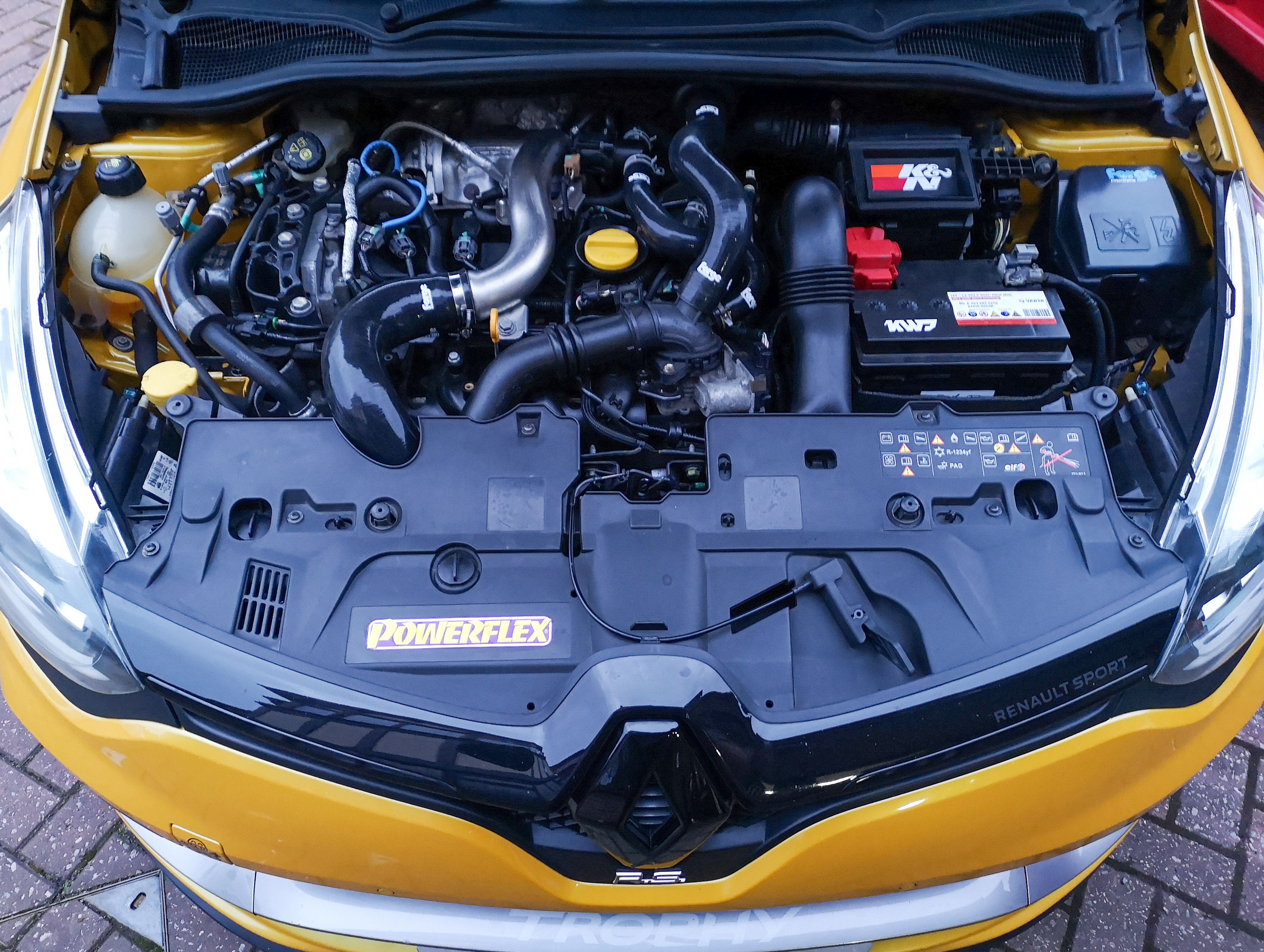

- Fit a Forge boost hose pipe kit I have in black
- Fit the Airtec aluminium cold side boost pipe (oem plastic ones tend to fail)
- Fit a yellow silicone intake elbow (KTEC one)

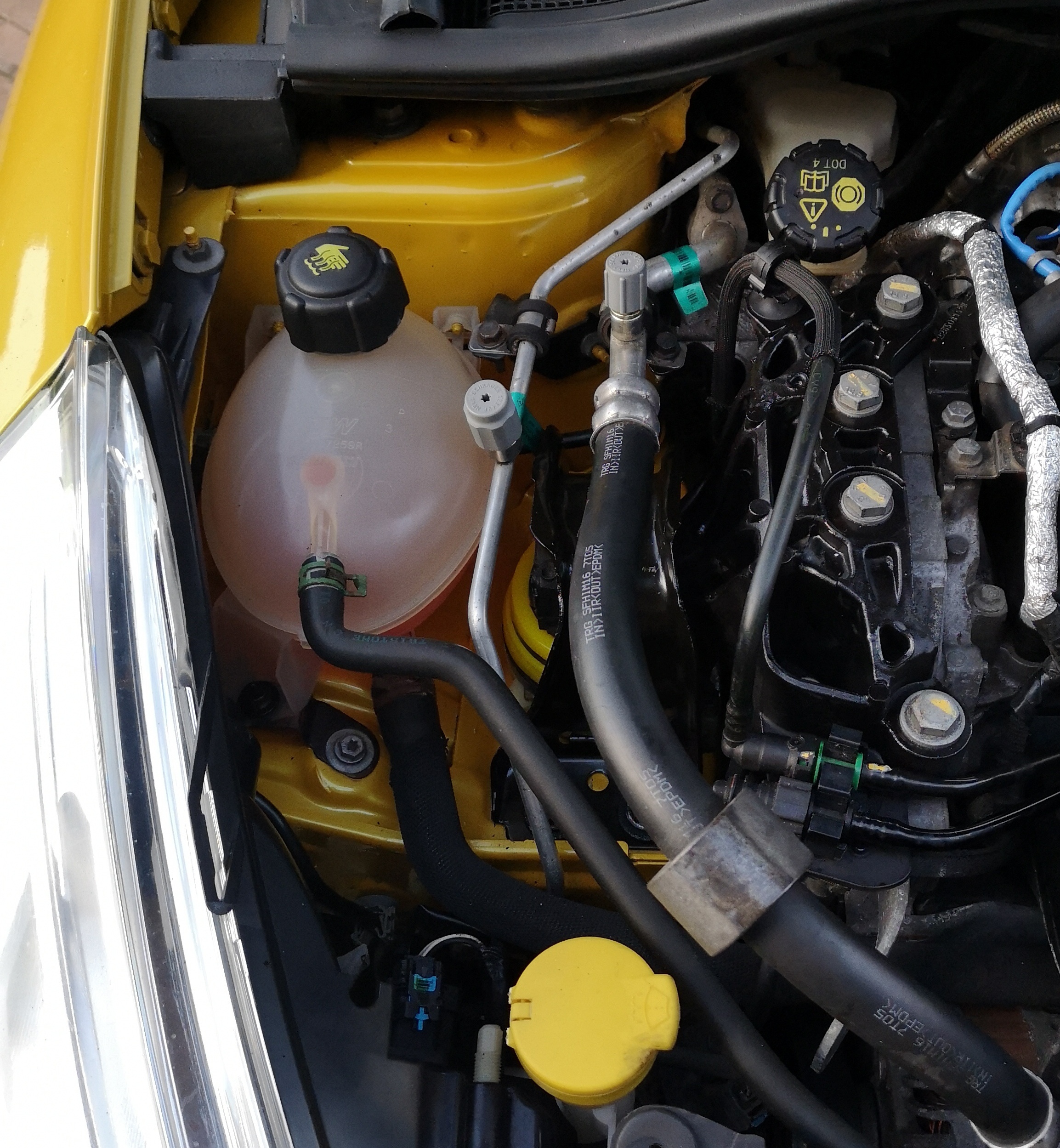

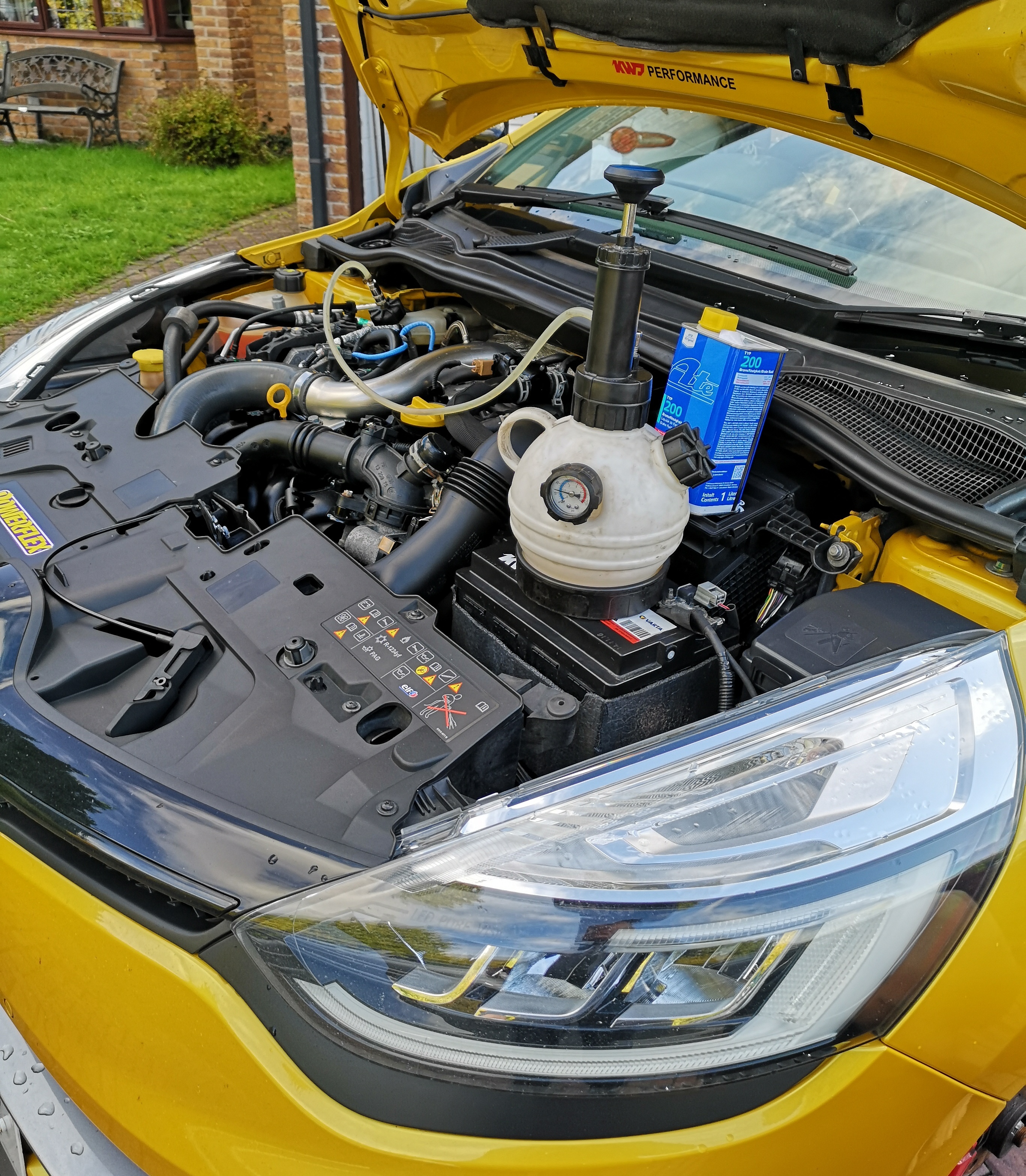

The AC issue:
As mentioned above, I noticed that the AC wasn't blowing cold air when I got it. And it was a hot day, so everything in the car was sticky :sick:
So first major thing to sort was that, for me (other than tyres). I can't live without working AC (and android auto/cruise control), even in winter. It gets all clammy in the car and I can't stand it.
Timeline of fix (hope this can help other users):
1. Week later, mobile guy comes out and regasses (R1234lyf gas too!). £60 which is way too cheap for R1234lyf and says compressor isn't kicking in so suspects compressor
2. AC specialist - very good bloke. Spent ages on the car and only charged for a regas (as bloke number one just added a little bit with an ECP recharge kit apparently). Said he'd checked everything, no leaks, holding gas, etc. Compressor was kicking in but it's a wiring issue as it's just not playing ball. Advises to go to an auto electrician. £120 gas charge
3. Booked in with highly recommended auto electrician nearby. But I got spooked when heard of massive labour rates and no idea of how long it might take to diagnose and repair. Cancelled that
4. Garage locally told me to try another garage that is good with electrics. Left it with them and they charged me £100 for their time saying they'd spent a couple hrs on it and switched the relays which was apparently now making the compressor work, but it still wasn't blowing cold. FFS
5. Got in touch with Magic Mick at Diamond. Went down, plugged it in. Weird error code. Needed further digging with Renault on the error code. Advised to order a valeo compressor and condenser from autodoc (£500). Booked back in for December. Mick spent god knows how many hours diagnosing with the help of Renauly UK. Long story short but it wasn't the compressor or condenser, it was a wiring fault. A + wire had rubbed and shorted out the AC control module under the dash. £60 used part ordered, fitted and WE HAVE WORKING AIRCON! Cheap parts but very labour intensive, so that was a big bill but it's done! He or Renault have never had that before (lucky me) so hopefully that learning can be passed on. Sent the compressor and condenser back to Autodoc and got money back for those, at least
I can now drive the car in comfort and don't feel all sticky and minging when driving it :)

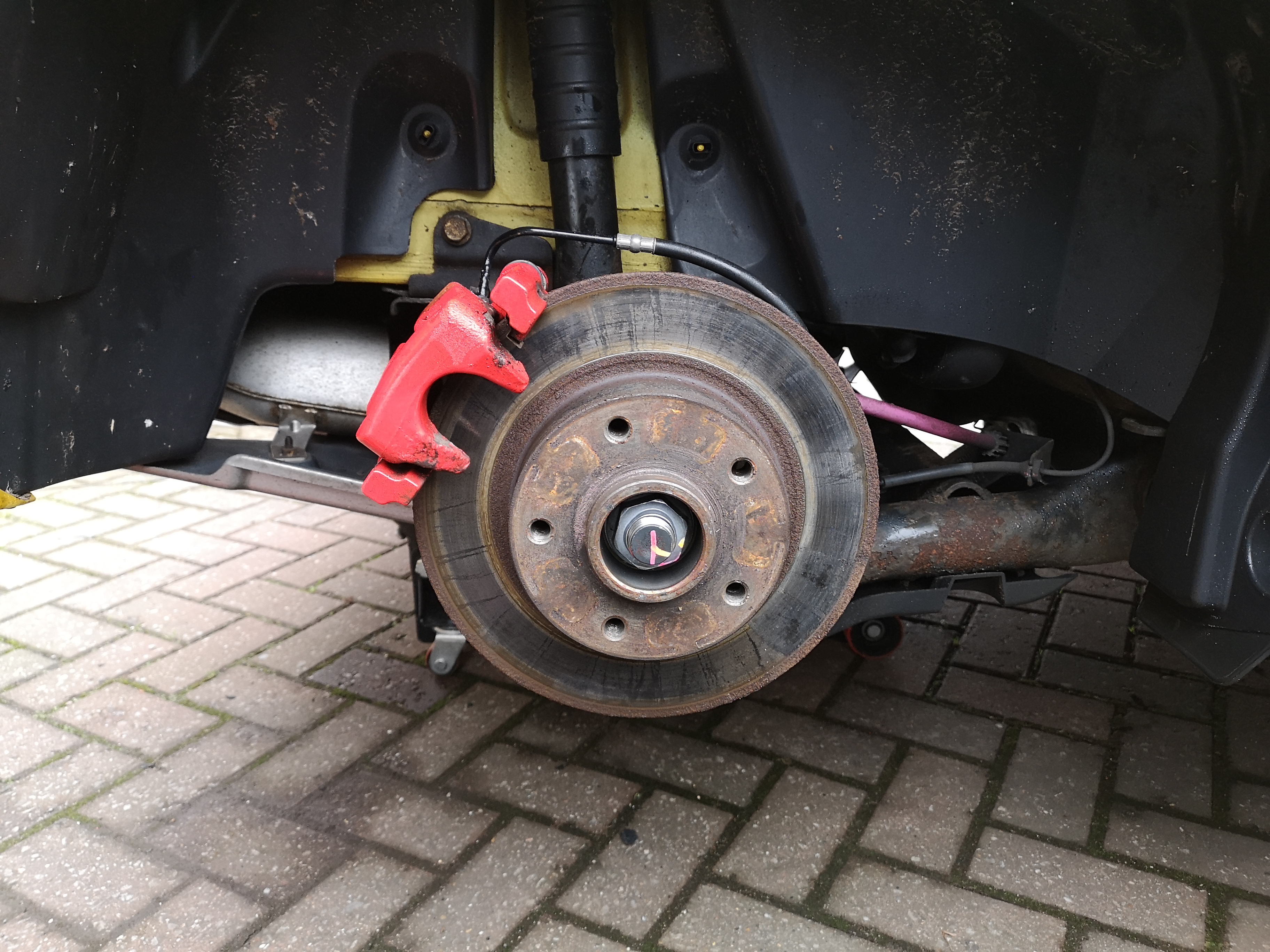

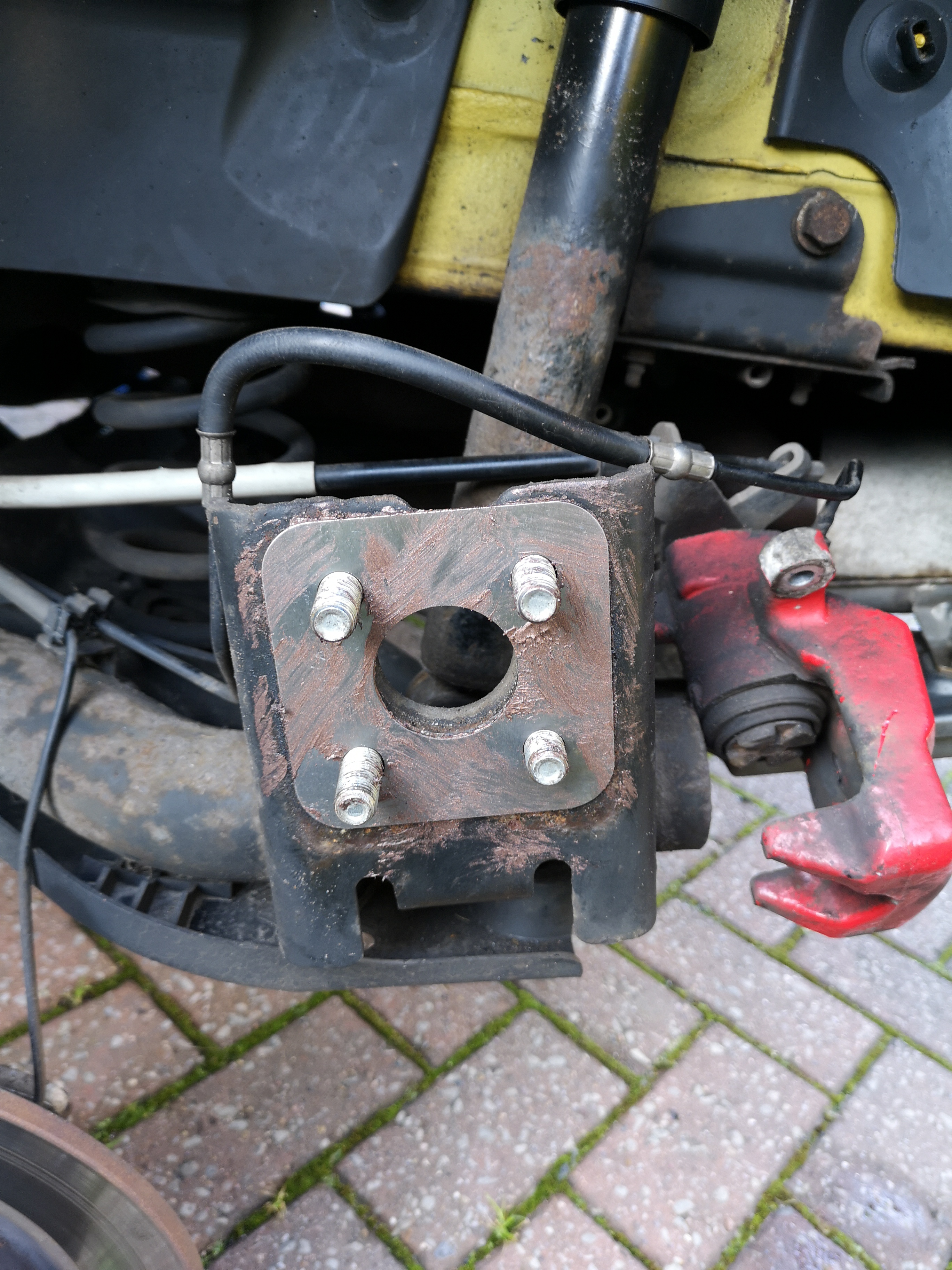

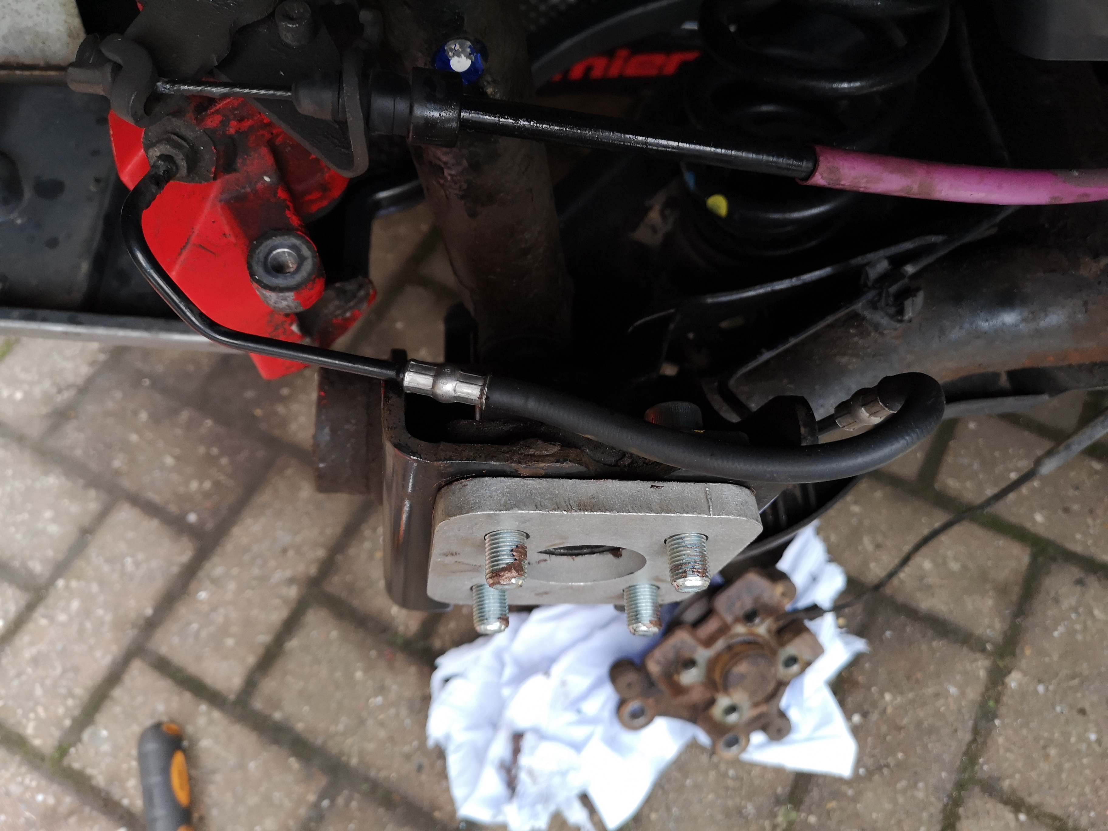

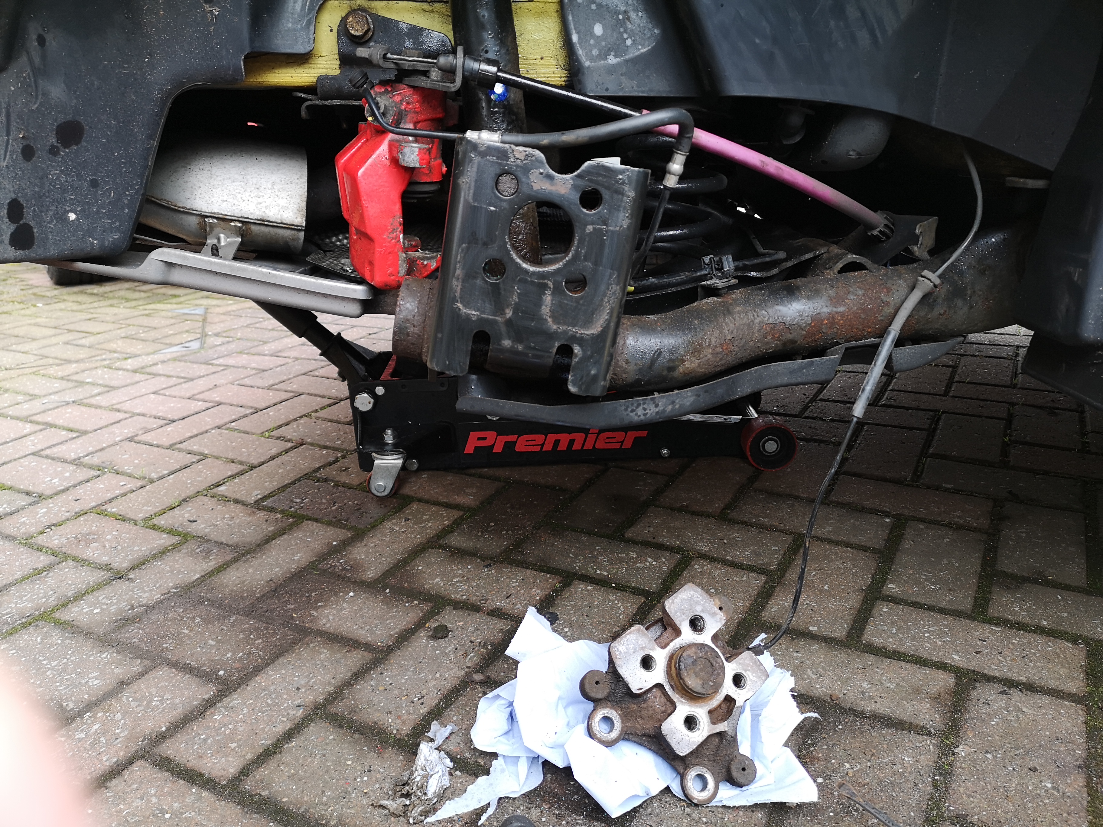

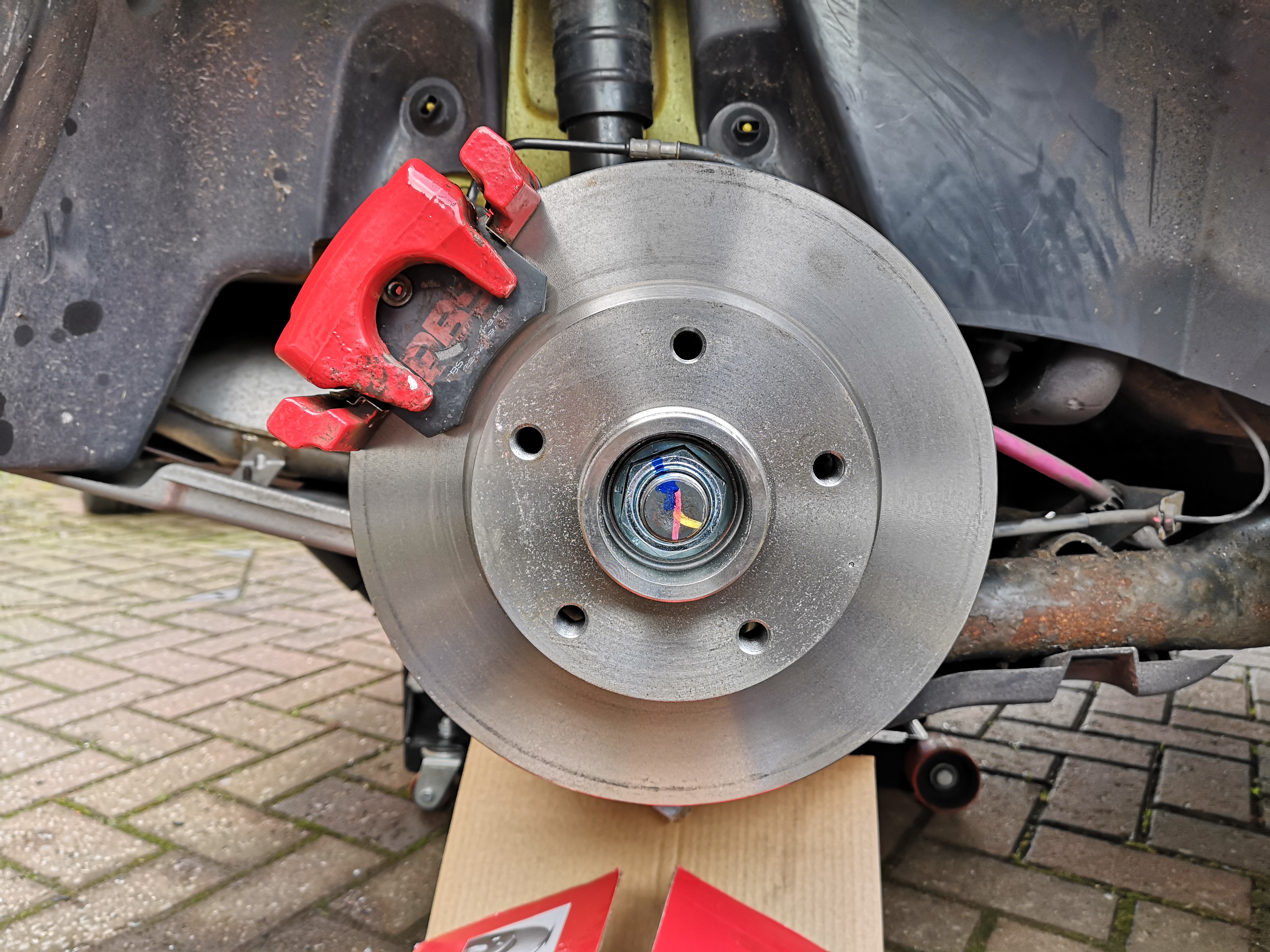

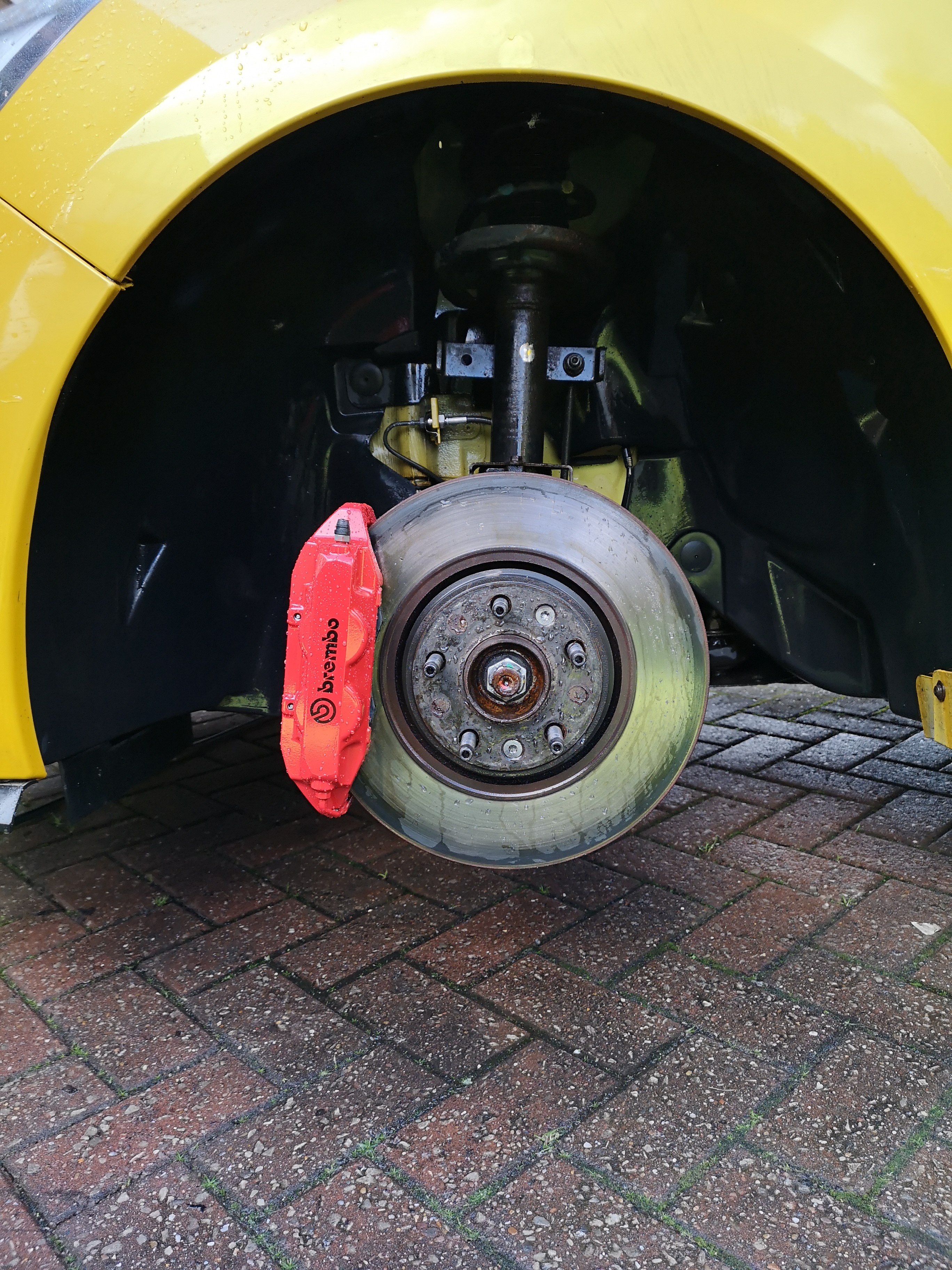

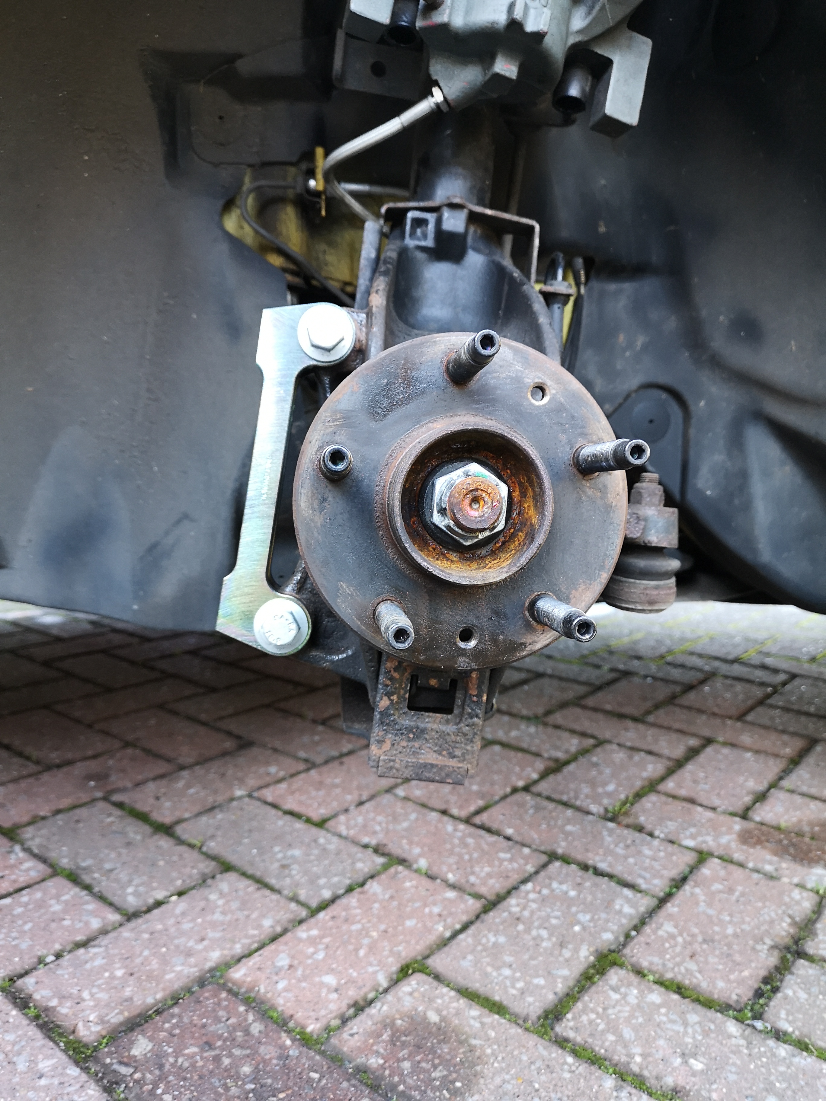

Braved the cold today to tidy up the brakes and get it (more) ready for Oulton on the 21st.

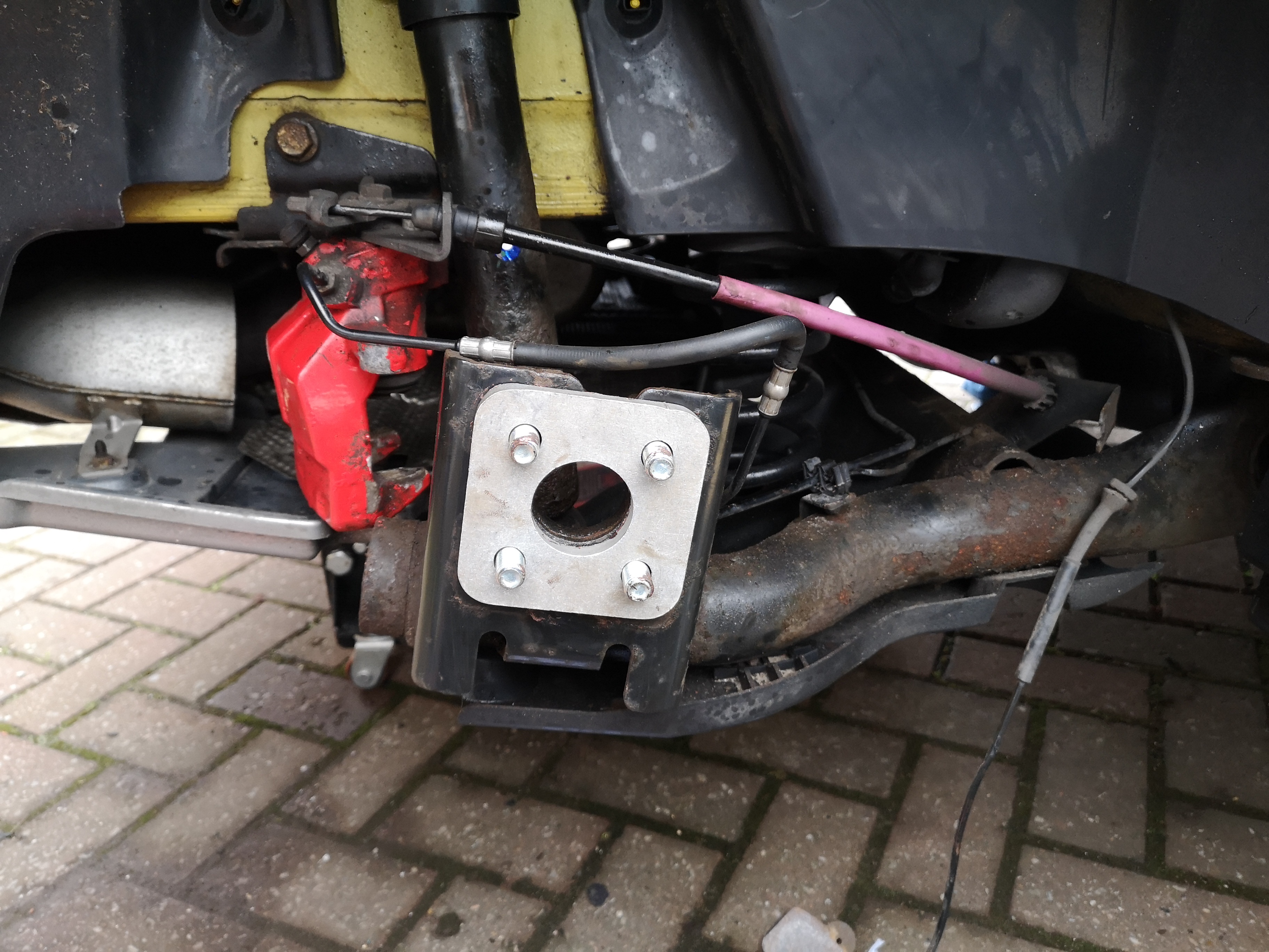

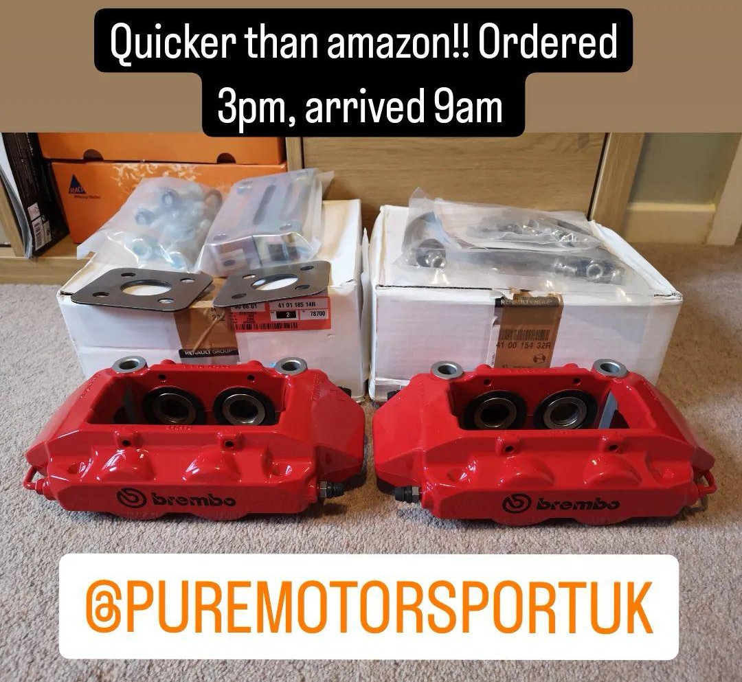

I will have to renew the rear calipers (got a rebuilt pair in the garage) and fit the braided lines another time, didn't fancy getting brake fluid all over me today.

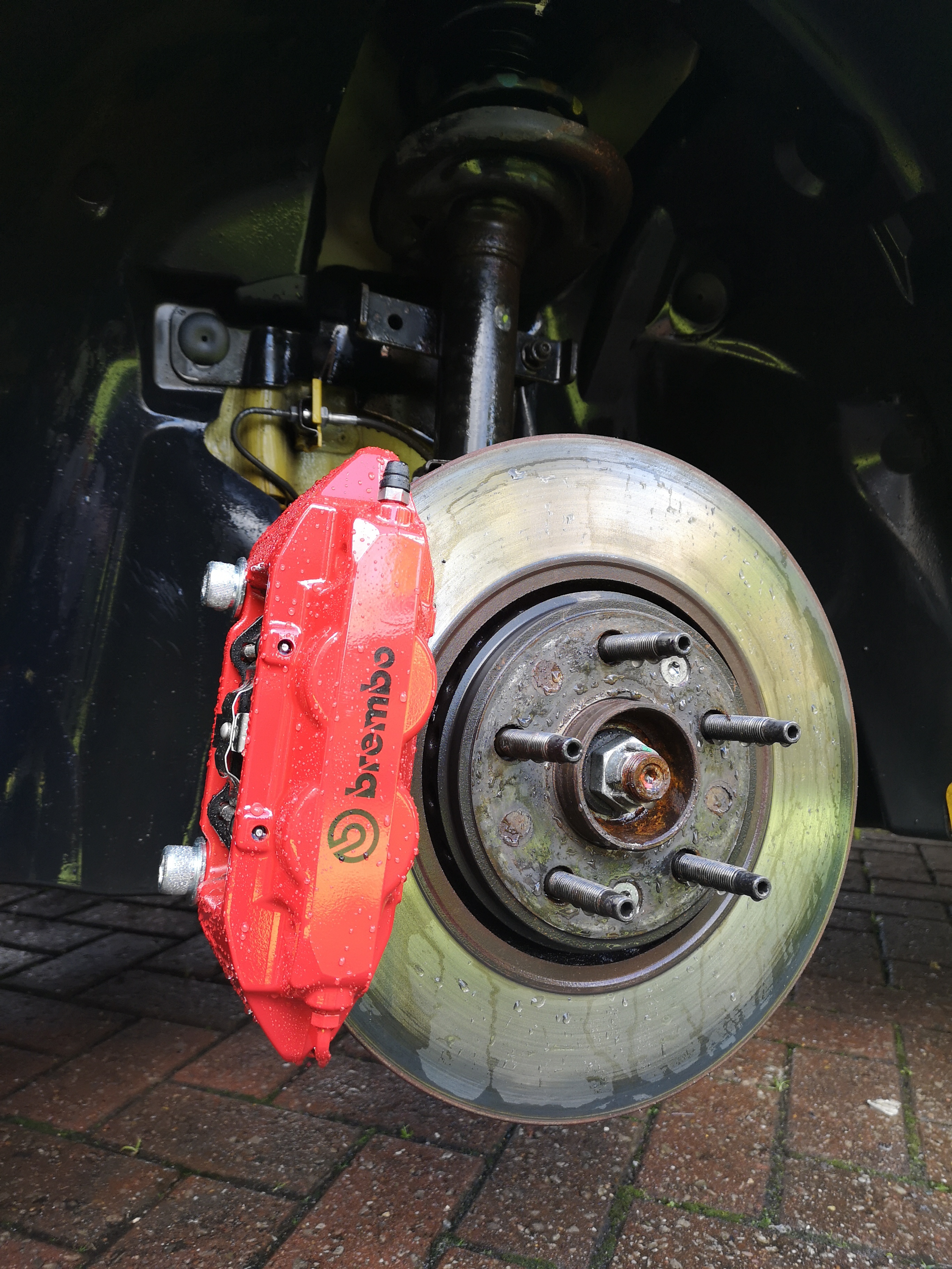

New brembo rear discs, pbs pro race rear pads to match the fronts, pure motorsport rear stub axle 10mm spacers, stud and nut conversion kit with 16mm front eibach hubcentric spacers.
Not too bad a job. Getting the old oem stub axle bolts was the biggest ballache. Looks a lot better now, only issue is that I now need to get some camber shim(s) as the driver's side has a tiny bit of negative camber but the passenger side has a good degree or so, eyeballing it. Will get it measured and order a/some shims from pure.

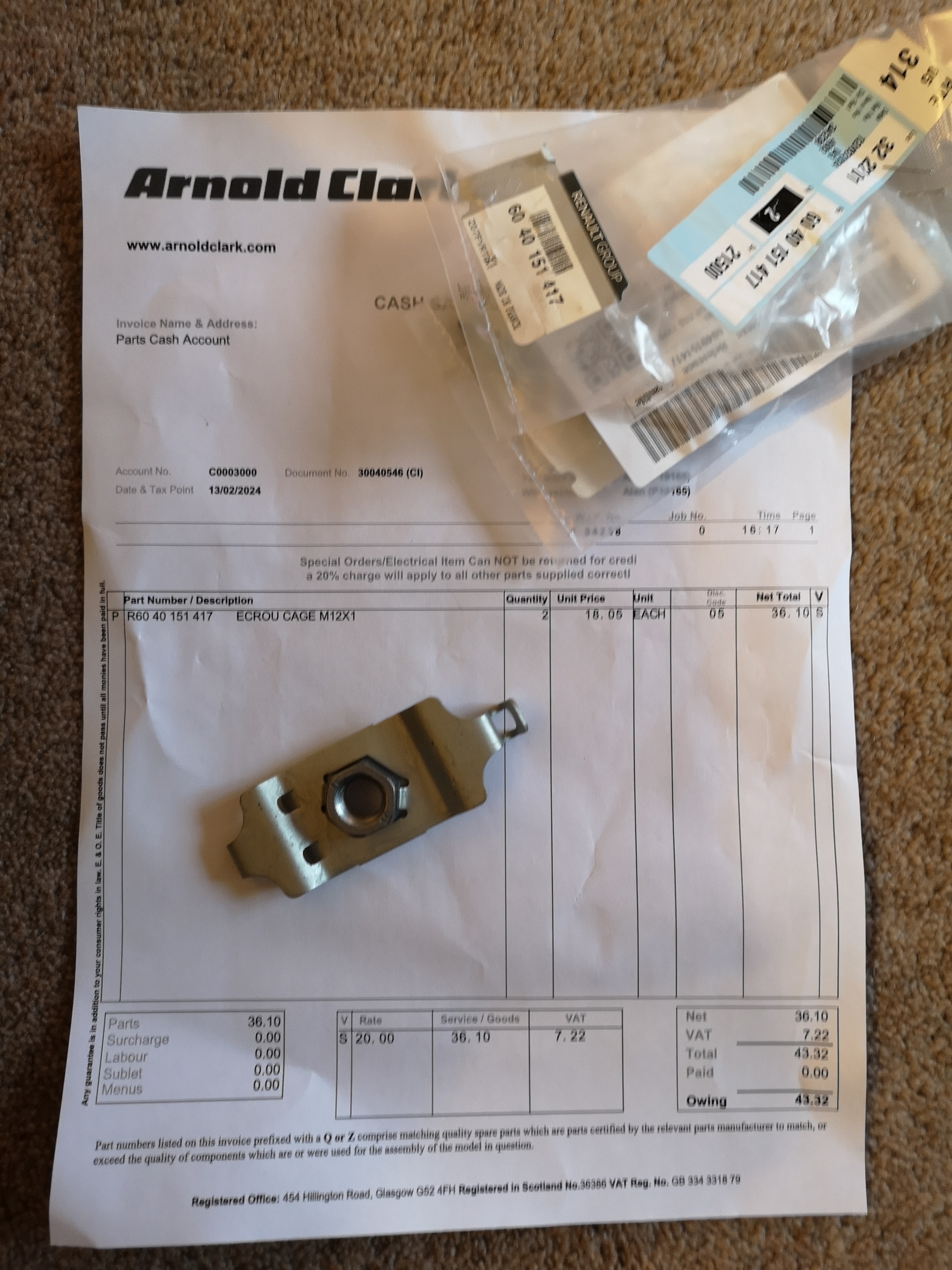

Also, had a horrible clicking noise since I was last at Oulton in November, that I could feel when turning the wheel on the spot (was fine when on the move). No where near as bad after Mick fitted a new ball joint. But it'd still make a nasty click every now and again. Forums suggested it was a common issue of needing to tighten the 2 steering rack subframe mounting bolts. Did them up - they definitely needed a nip - and all sorted. Buzzing. It was a horrible noise/feeling.

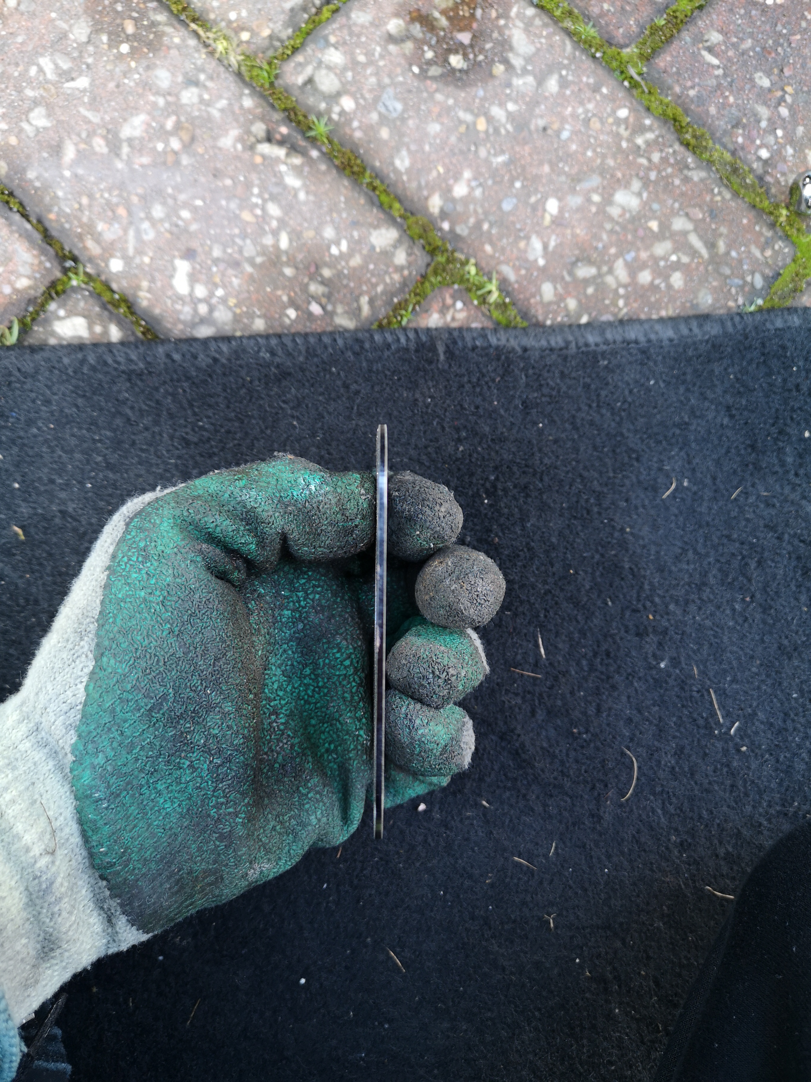

Another (and finally the last at the moment) annoying clunk sorted.
PBS pads up front are about 0.5mm smaller backing plates and were moving in the caliper when braking. Causing an irritating clack when pressing brakes.
Had it on other cars, pretty common for track and aftermarket pads. Guess it's to let them expand with heat.
However I can't deal with it, driving everyday. So caked the ends in copper grease and all sorted.

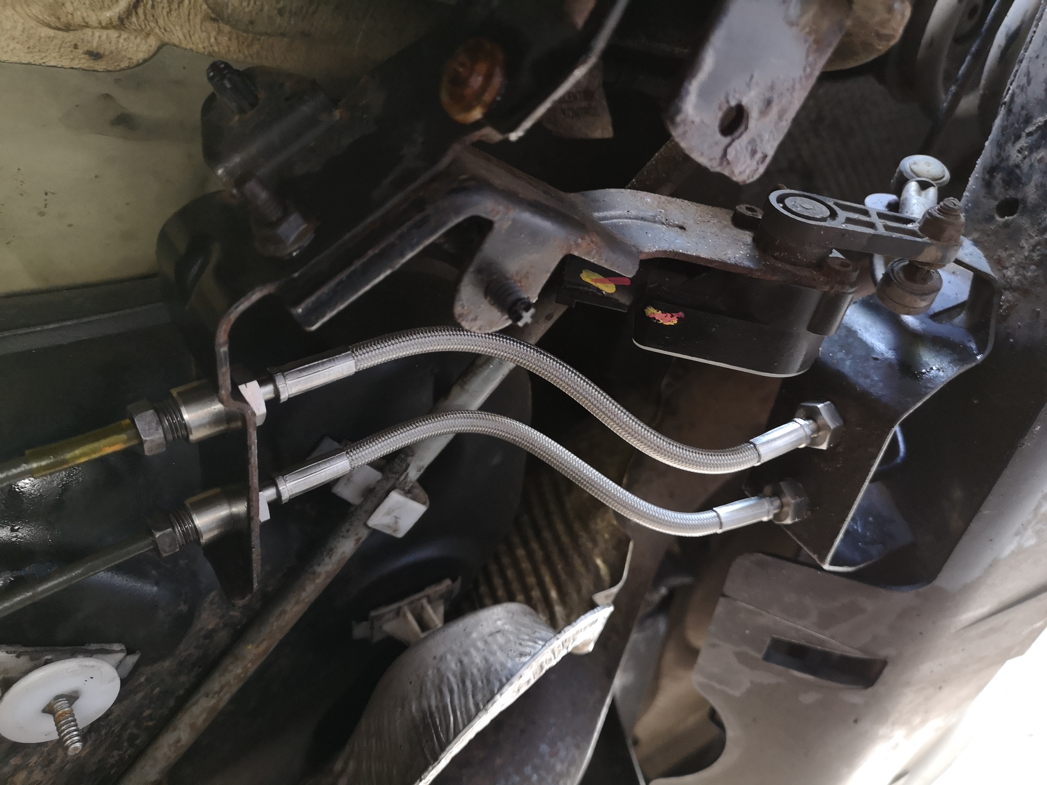

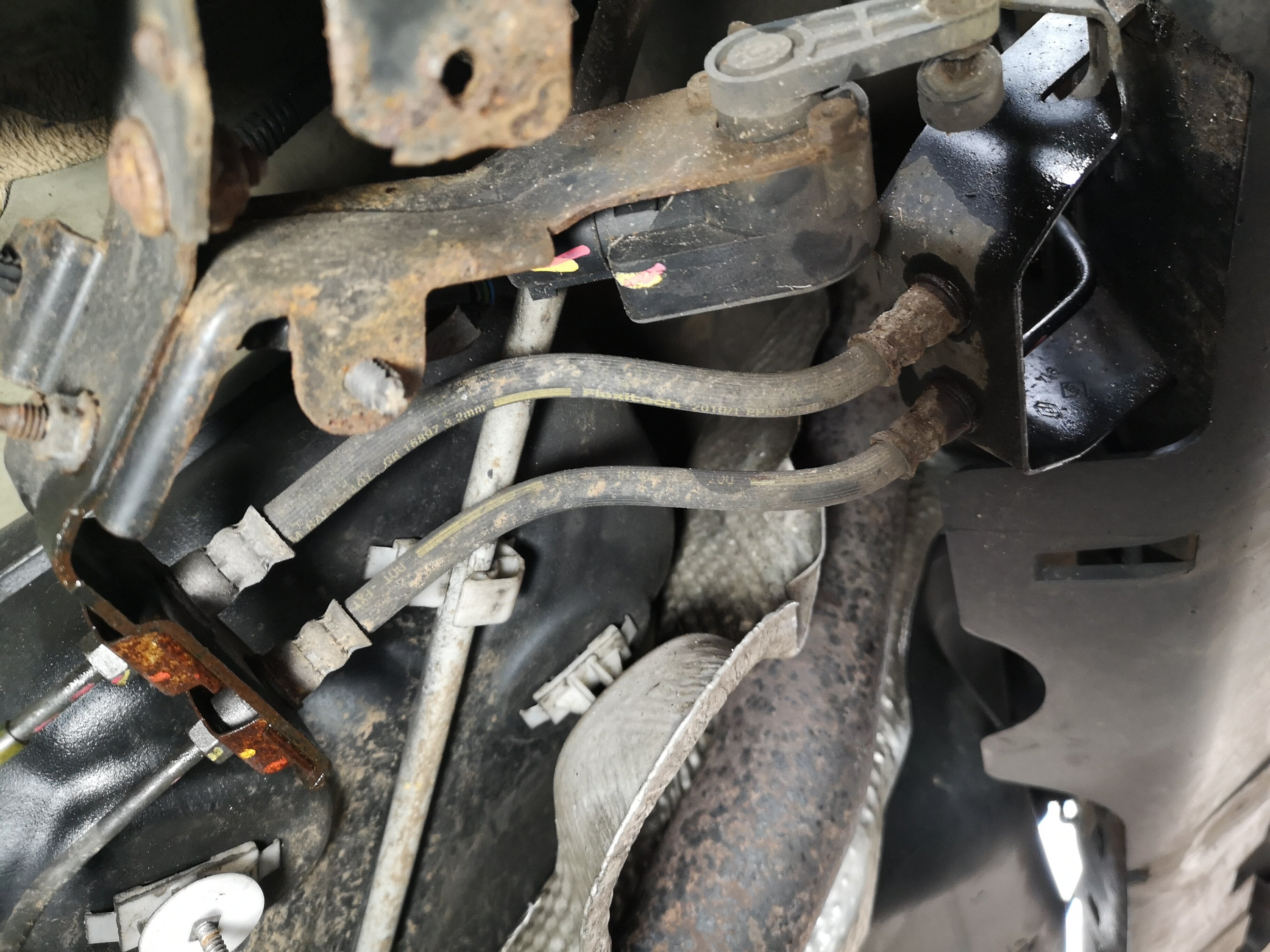

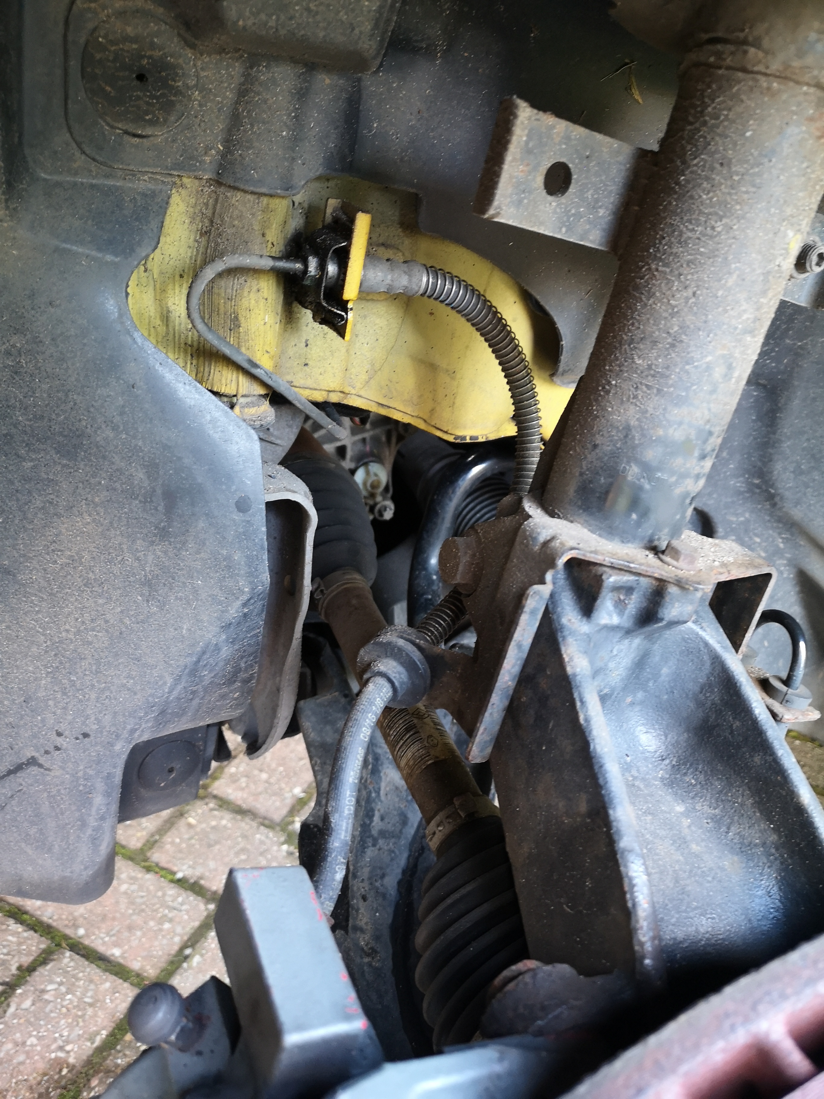

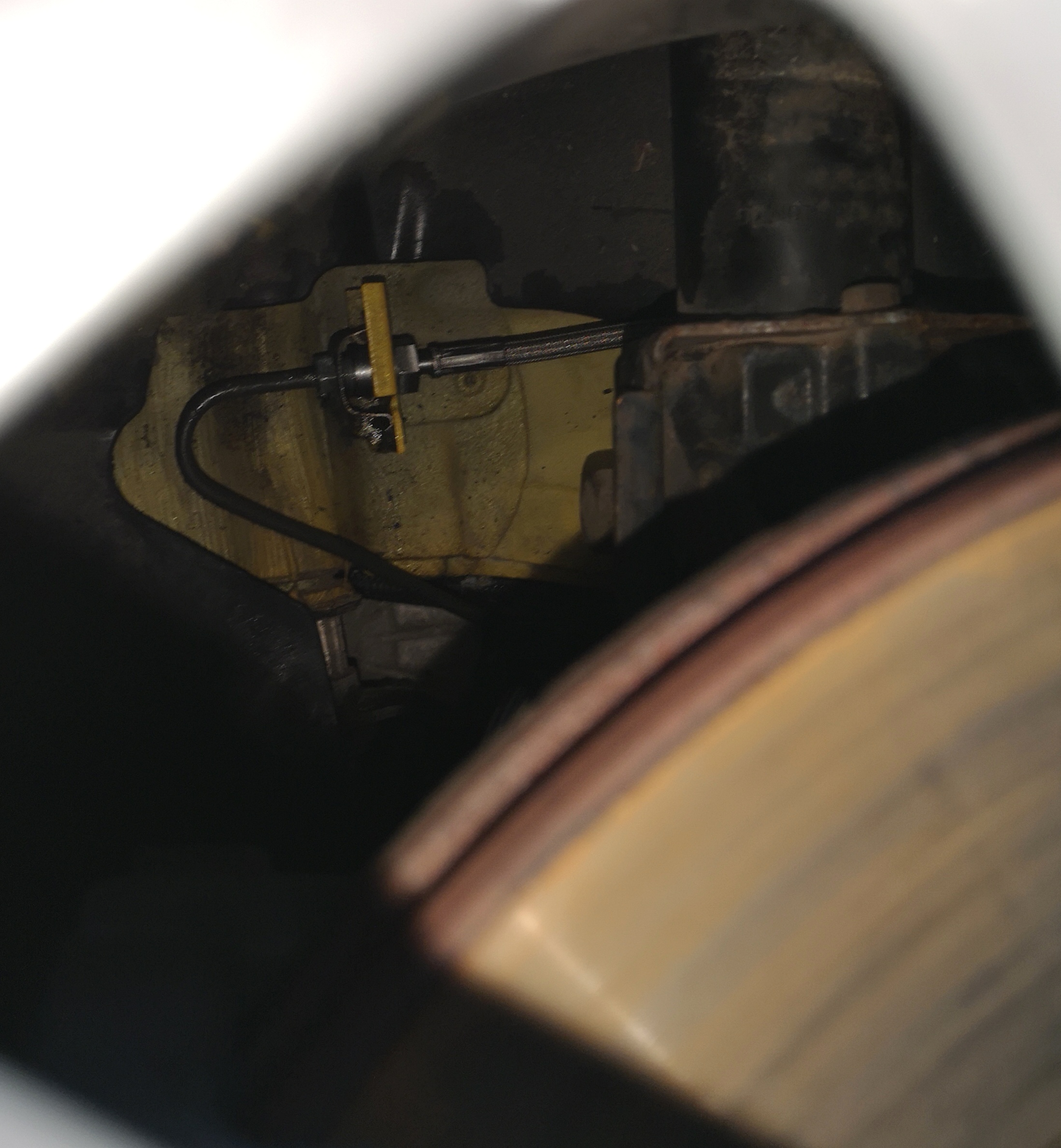

Proline braided lines on, thanks again to @JamesBryan for coming over to fit them.
Didn't realise it was the ones under the car on the rear, what a ballache.
Fronts a bit easier but such a messy job. Might have to do it all over again if I get some front brembos.

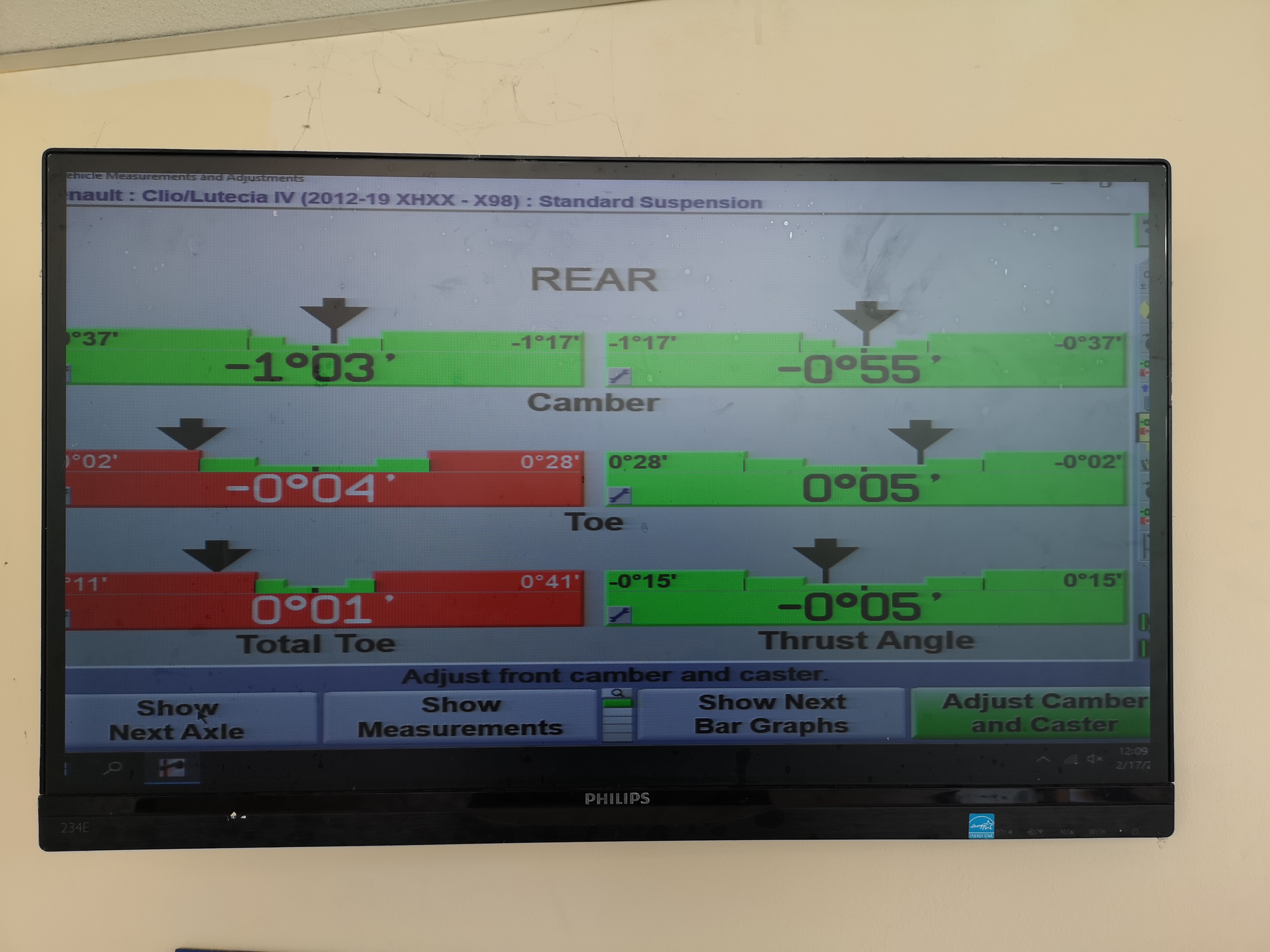

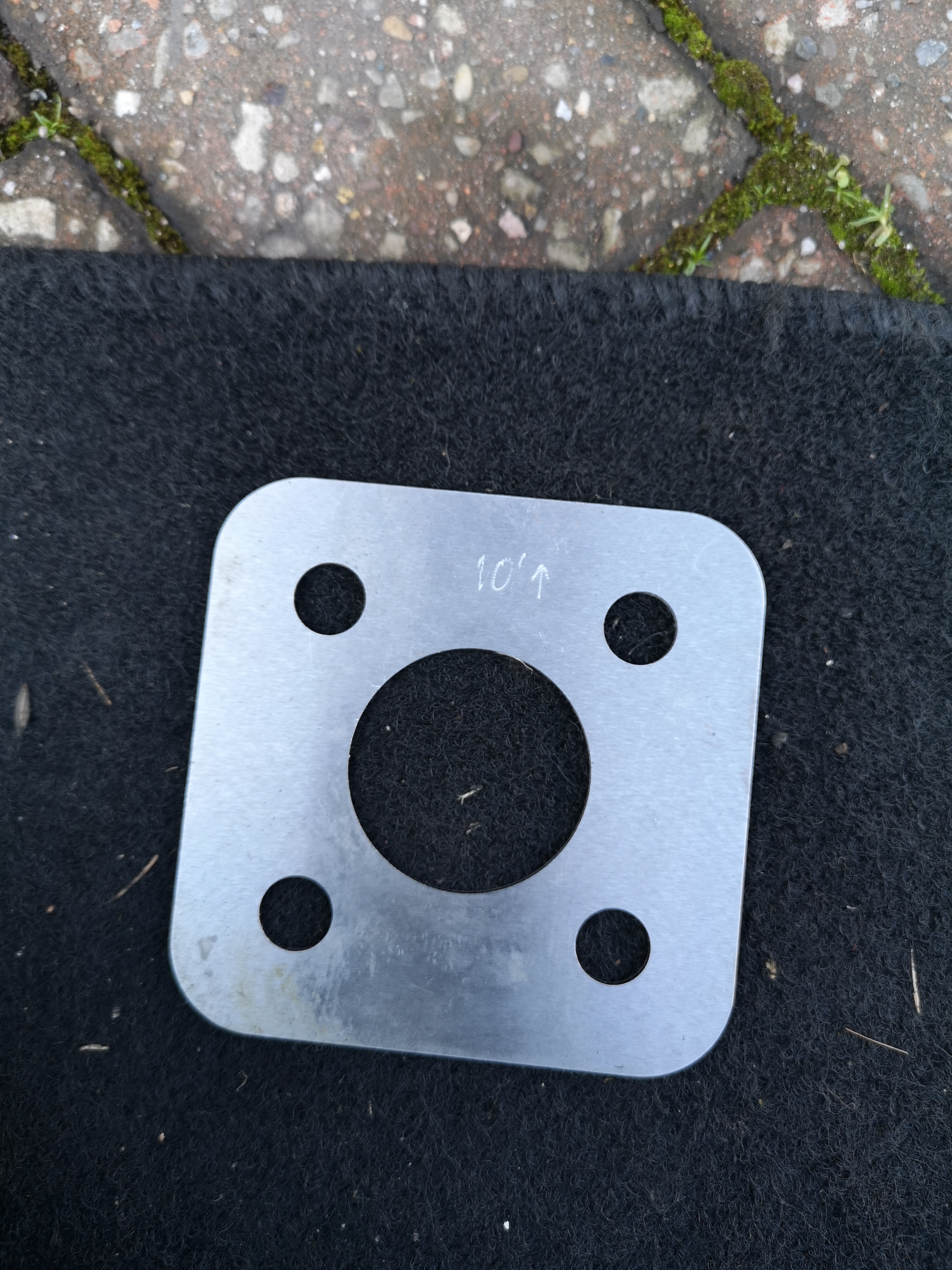

10 minute camber/toe shims for the rear too, to get it all square, well as much as you can on these.
I’ve got this same issue. I took the car to Alex at AW Motorworks and low and behold I couldn’t get it to make the noise while I was there.
Mine generally makes the noise while on full lock and pulling away off my drive.
This steering rack mount bolt does make sense because he thoroughly checked just about everything else.
Danith
  GTi 7.5 pp/Mx5 nd2
It's awful isn't it. Mine did it one in 10 times or so, seemed to unsettle it if going up or down a drive or similar.
Honestly give it a bash, takes 5 mins on the ramp. Remove the 2 10mm nuts holding the engine cover and you can pull it down enough to get to them. Remove the nut cages and tighten them up.
I guess folk over look them as they assume that the cages will have held the nuts in place, but mine definitely needed a turn or 2 despite the cages still being on. Weird.
@Sash says hers doesn't have those cages, probably rusted out.
Best to do it sooner rather than later so as not to damage the threads on the rack I believe.

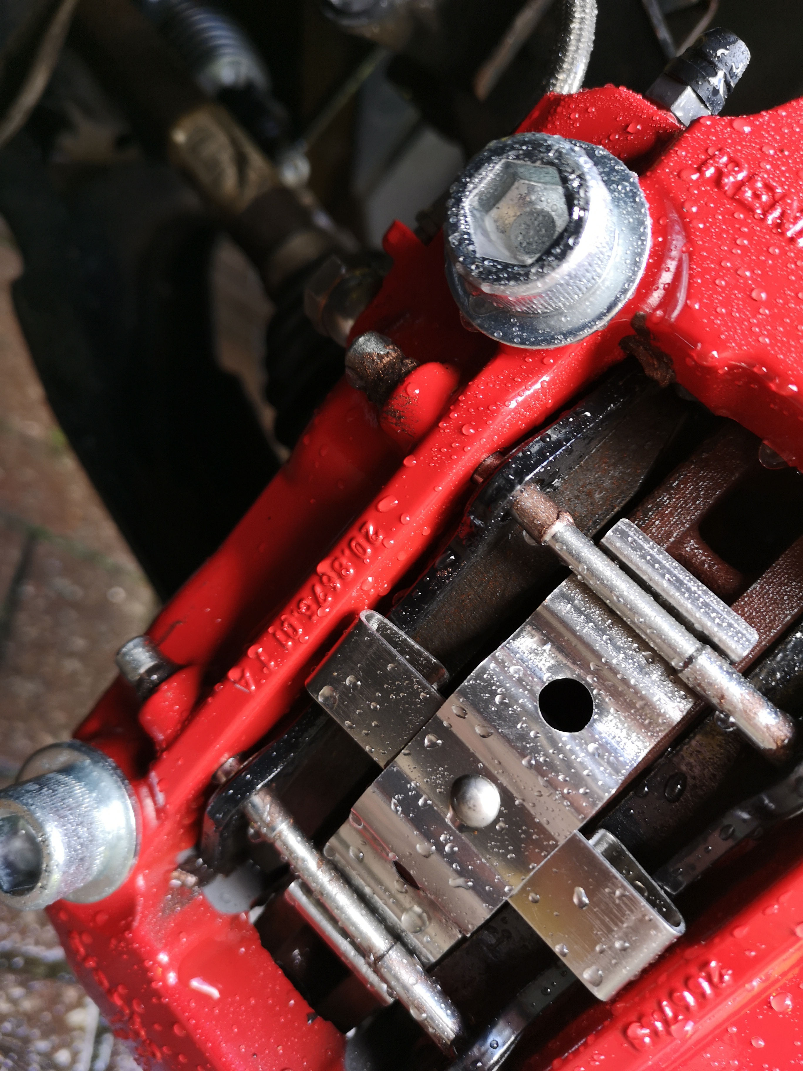

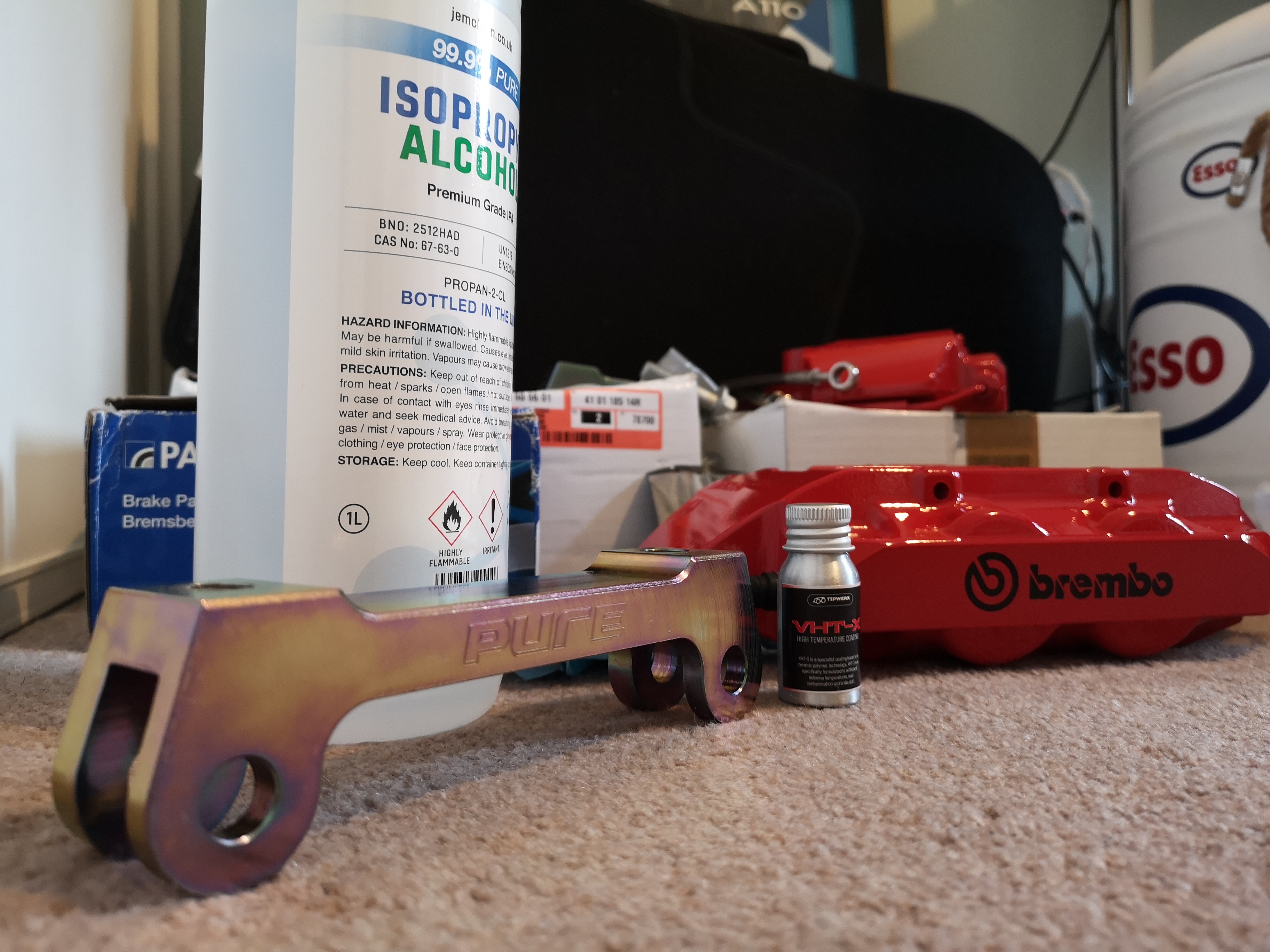

Prep. Hopefully stick these on over the weekend if stays dry and get time.
Ran out of c5 sealant, still have some carbon collective glass ceramic but not sure it'd work?
So gave this stuff a try off ebay, tipwerx vht ceramic caliper sealant.
Supposedly these pure brackets like to rust, but I'm not keen on painting them if I can avoid it. Will see how this coating holds up. Will put some acf50 on too.
Danith
  GTi 7.5 pp/Mx5 nd2
And on. Only issue being that the pins I was sent absolutely refuse to go in so I've asked the question to pure. May have to get some Mr pinks.
Cheers again to @JamesBryan for turning up, just as I started to bleed the brakes.
10 min camber shim rear driver's and 10 min toe in rear shim on rear passenger.
Wheels are going back to get redone in the week so on track wheels and parked up for now.

You need to get the hot side pipe replaced with a metal one too. The original ones are prone to breaking.
Danith
  GTi 7.5 pp/Mx5 nd2
That's the one I have. The airtec, but not sure I can be arsed fitting it as it rubs the front slam panel.
@Adey. Has donated me his unwanted oem one in case my oem pops cos he's a very nice man.
  2014 Clio 200t edc
I don’t recall mine rubbing the slam panel, it was a tight fit but didn’t cause any problems in my time with it.
Good that you have a spare though

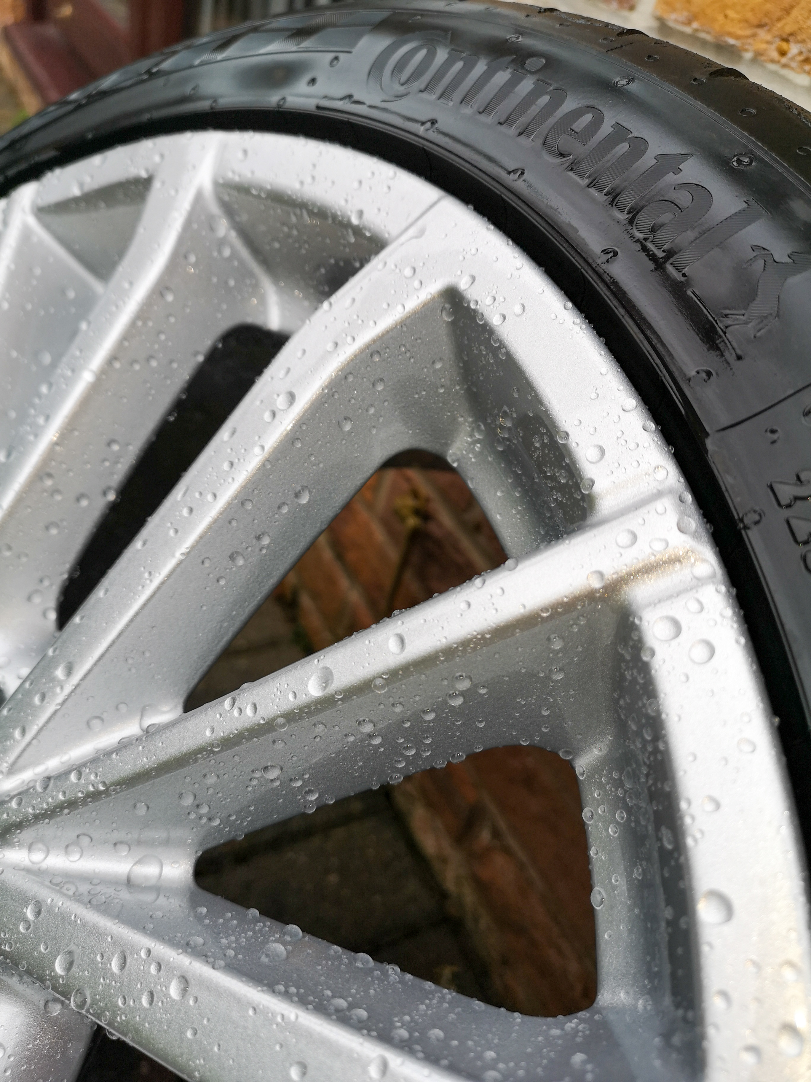

Miles better finish this time and the correct metallic sports silver I'd asked for. Previously it was a very flat boring silver and the finish was terrible.
