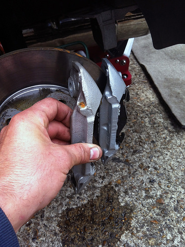

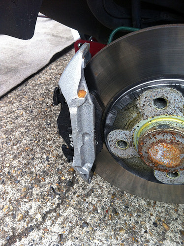

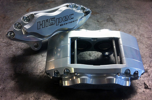

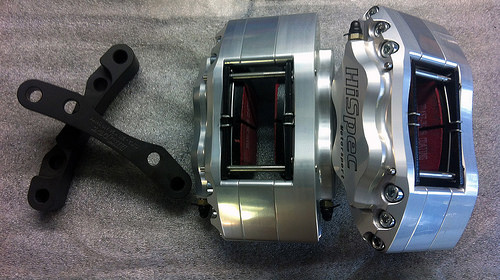

I picked up the HiSpec brakes up friday direct from there unit. There were nice guys and it was nice to speak to the chap who i'd been dealing with. Excuse the poor quality iPhone pics.

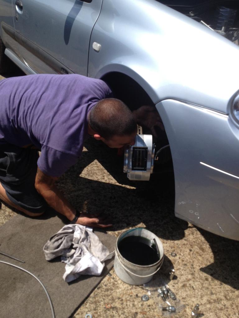

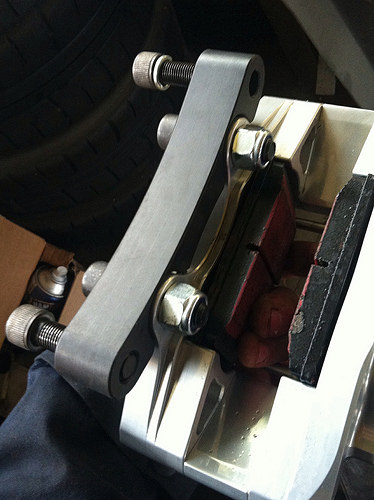

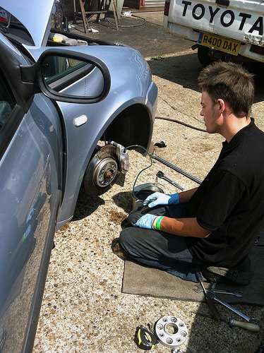

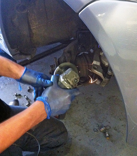

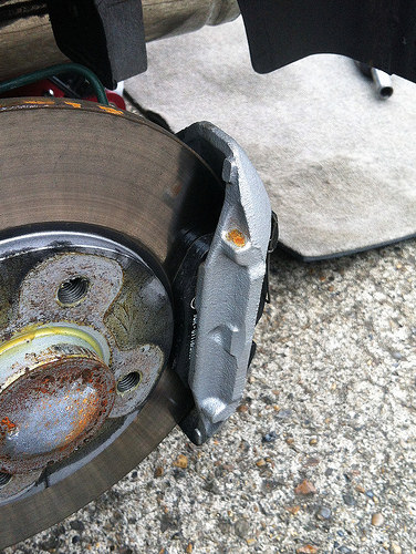

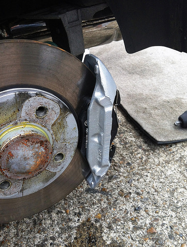

@AlexW came down as he wanted to bleed @RyG brakes and use some of my fluid and i needed to sandblast a few things for @ventura car that Alex is doing a few last bits on so all was good. After a quick McDonald's and the bleeding of Ryan's brakes, we set to work on mine. First problem was that the nylocs that hold the caliper onto the mounting bracket was slightly catching on the hub so we improvised with a disc sander:
And then they fitted

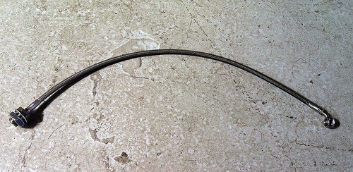

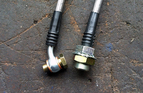

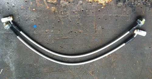

However we came across another problem, well 2, naturally. Firstly the current braided hoses on the front were a little tight once extended due to the different shape on the HiSpec's and that the hole in which the hose feeds into is in the center of the rear of the caliper, whereas on standard calipers it's at the top. It also turns out that we are leaking fluid on the connection, due to the caliper being a little too far drilled for the current banjo. Sadly a copper washer wasn't enough to solve the issue. There was some light though. Luckily we had a cobra rolling chassis at my work and it turns out that the braided hoses that it uses on the rear brakes can be fitted with the correct ends and banjo bolts. The downside was it was too long. My work get the braided hoses made at Pirtek so i took the hose down there and have ordered the same as below, only shorter :)

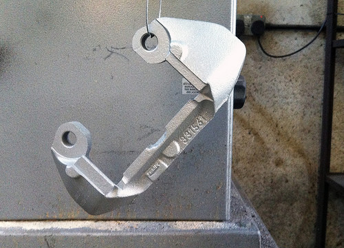

Lastly i've resprayed the rear caliper carriers to match the new front calipers. Once the hoses have been made i shall pick them up and we will tackle it again!

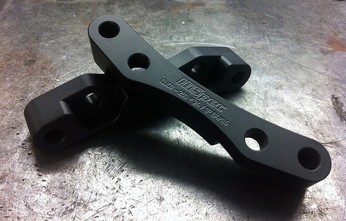

The mounting brackets are different and the caliper seems slimmer, from looking at pics of my old BG's Wilwoods. The Wilwoods had the lug holes built into the caliper for the brackets, where as the HiSpec's bolt separately on as you can see. The HiSpec's do look better quality i think.

Mark ive been scratching my head and for the life of me I don't remember any Nyloc nuts, where are they??
Why did the need to be ground down?
Shouldn't the kit be made to fit or does your car have the wrong fixings and that's why there was a problem?
How comes the kit doesn't come with longer brake hoses, bit silly if you need to fit then use the car.

The Nylocs are what hold the mounting bracket to the caliper itself. Once all bolted up the nyloc are a little proud for the mounting points on the hub, so we just shaved a bit off the hub so it all lined up correctly.
They do a full kit or seperate parts and seen as I already had discs and braided hoses I thought I wouldn't need them. I didn't think I'd have an issue with my current lines tbh. The current hoses have the thread built in on the ends, like a 1 piece hose and was a tad too short once fitted under full lock. The new ones have a seperate banjo bolt which feeds through the braided hose end, which I think is a better design.

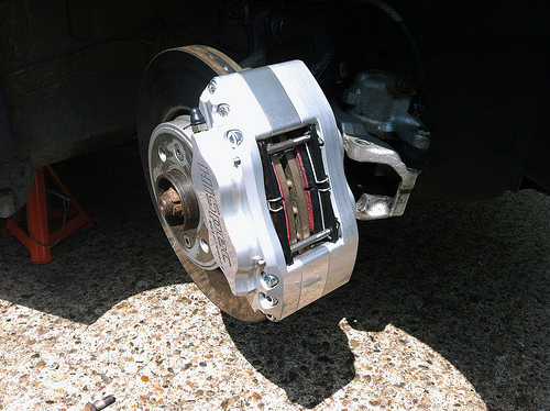

Heres a pic of the underside of the caliper:
  Many.
Kissing.
They're pretty good Scott, Having to grind the hubs is annoying, as is f**king about with the brake pipes, but that TBH is more down to the design of the original Renault tat.
They fit well, look good and Mark is never going to find the limit of them, nor would I expect you too.
Quality is very good, which is the bit you want to hear.

Picked up my braided hoses from Pirtek this week. Not the best pics but you get the idea

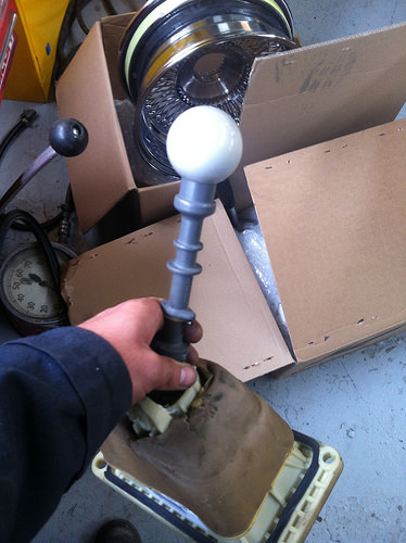

I also bought these off @Gaz85 which arrived promptly:

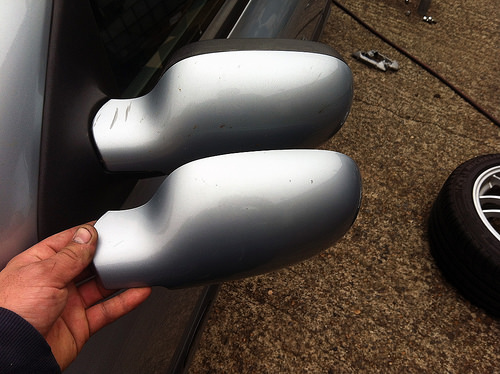

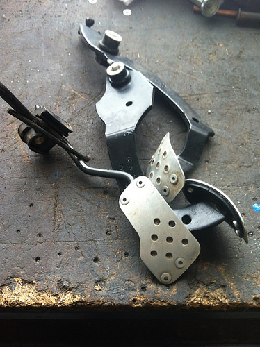

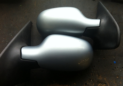

All for the grand some of £15 posted! I wanted the mirror caps to replace mine as one of my current ones had a few deep scratches in them and i plan to smooth and respray the ph1 gear knob as mine is scratched also. The pedals i bought as a spur decision, which turns out i dont need but cant complain at getting the lot for that price!

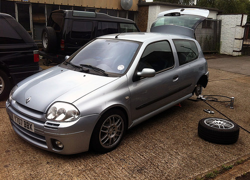

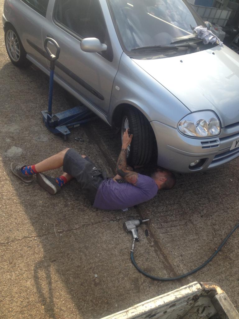

Yesterday i started to have a play with the brakes and @AlexW popped down to give me a hand also. Swapped over my rear caliper carriers to the newly sprayed ones
I then raised the rear coilovers up 2 full turns and swapped over the mirror caps

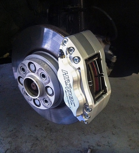

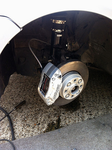

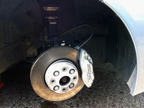

Then we moved onto fitting the HiSpec fronts. Thankfully no dramas!
I also turned down the front coilovers 1 full turn before we bled them. I may do another full turn down yet.
And then it was complete so Alex left and i gave it a quick wash.
Will probably give it another bleeding after a few miles of driving and as said earlier i may drop down the front a tad more.

Tbh Scott ive yet to drive it really since they was fitted. I literally left work and was in saturday afternoon shopping traffic and drove it home and its not moved since! Quality looks very good, prettier than the Wilwoods. Basically Alex hit the nail in he's earlier post.

The current issue is the lines are too long and rub on the wheel at full lock.

As Alex said, they work fine but could do with another final bleed. Lines have been cut down now and are all good. The response is good just a tad too much pedal feel so that will hopefully shorten after another bleed. These have been on my car for a while now and all seems good though. The look cool too :cool:
With my discount I got the brake kit for £384 and I did a few favours for my boss which instead of paying me for, we agreed to take the price off so the total I paid was £255. Can't knock that! :D
