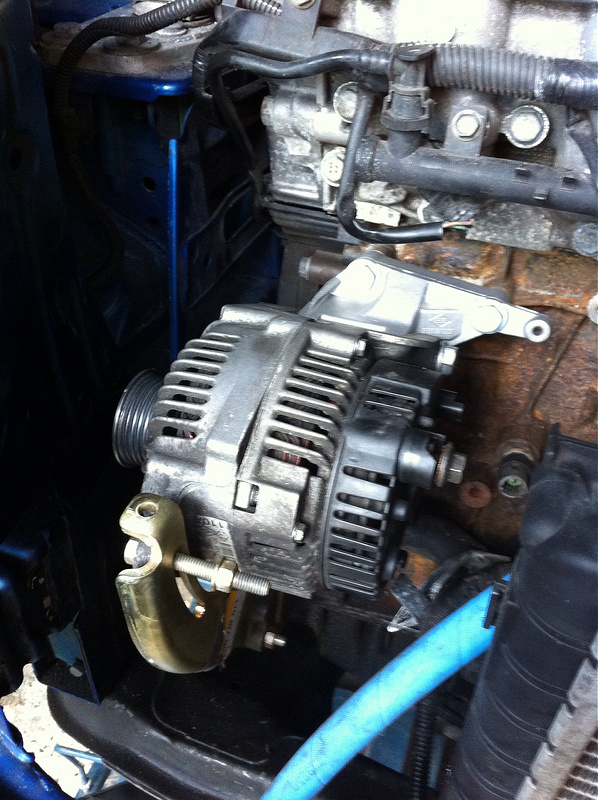

I will let you know on Monday. There is enough contact I'm certain. Got an 5pk825 belt which should be tight enough.
Just wanted to see if any of the early runners had noticed any issues.
Is anyone else running the renault 5 set up. I've got a 5pk825 as I measured (twice) and its very tight. Just wondering what other people are running with this.

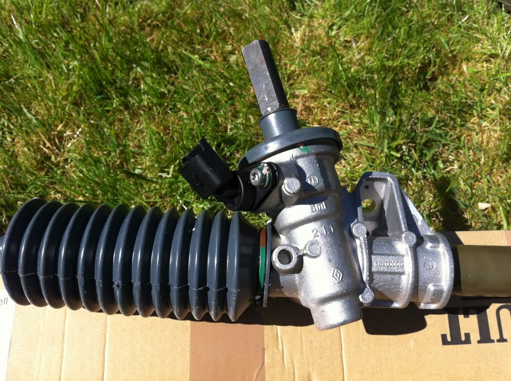

Fitting the control dial today. Cut the stalk down yes? It's rather long at the moment.
Also measured up a new belt using a brand new belt (cut, wah) 5pk838, if that doesn't fit I WILL cry.

Should be fine I run the 847mm one but the tensioner bolt is wound up quite high to tighten it up - would have thought 9mm shorter will be spot on

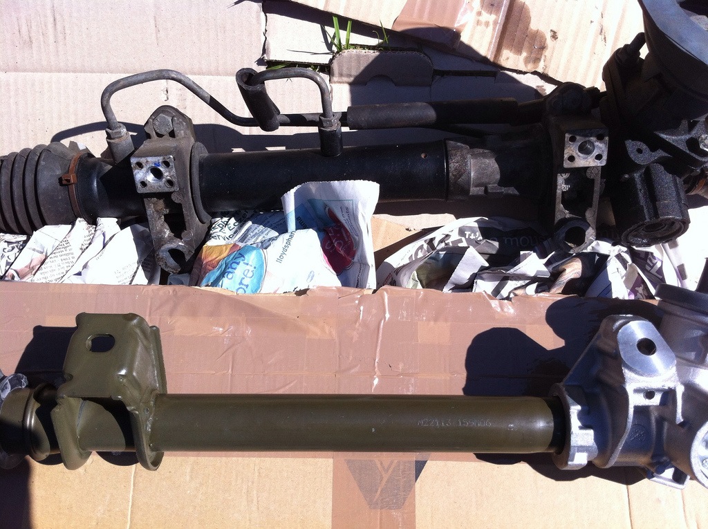

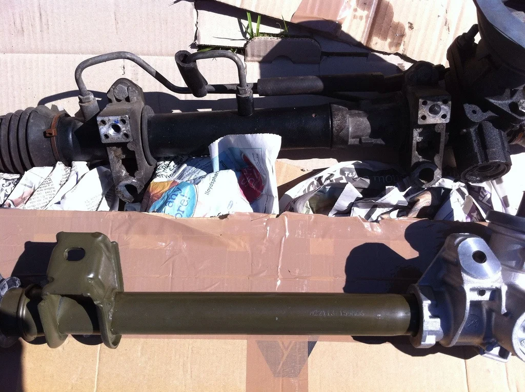

It literally feels like a new car again, the steering is so quick and precise. Clearly the old inner tie rods were well past it
The EPAS is interesting though - anything less than 70% on the road at 30mph speeds is a bit of a struggle lol.

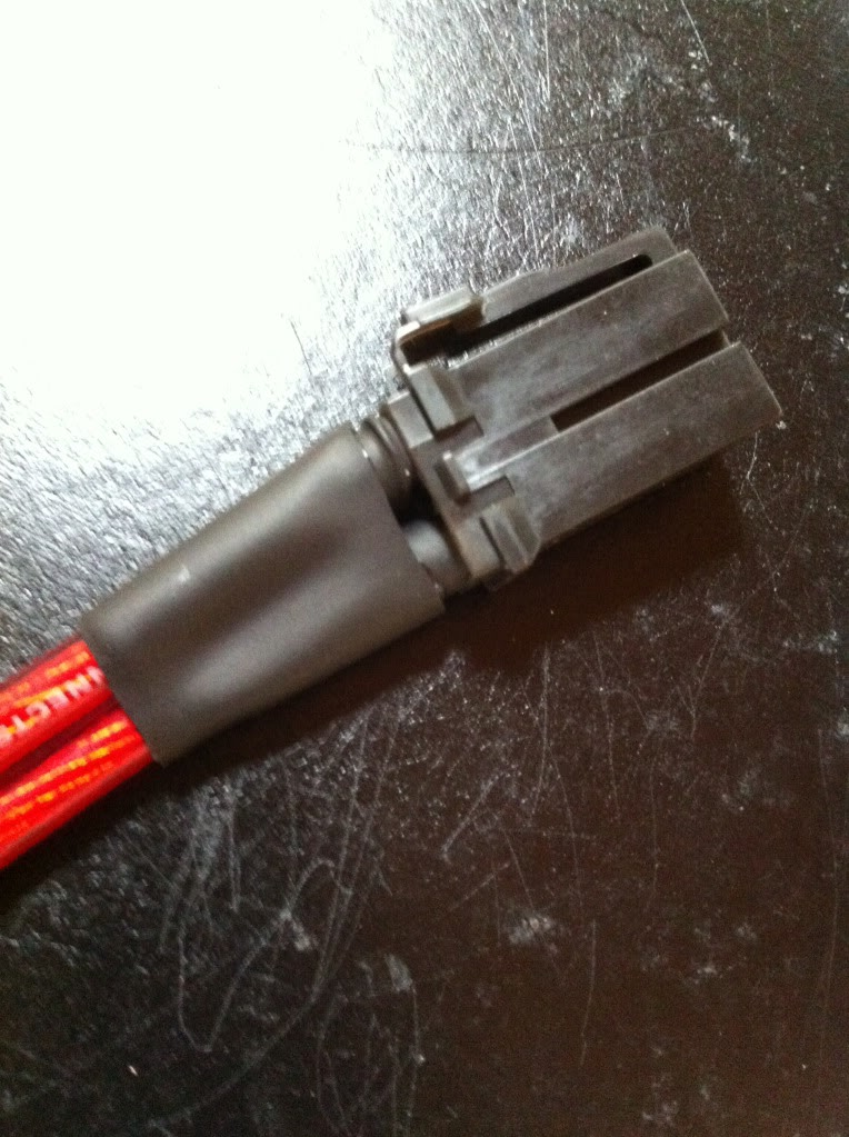

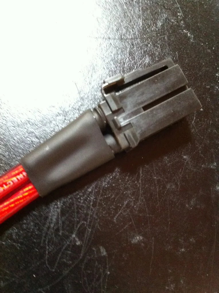

scrappys, renault (will be a b**ch) or connectors to suit the pins until you find correct plug.
