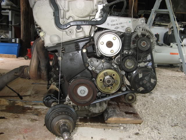

Just had a quick look and found this
7700718613 Plated tensioner bracket available £22.31 +vat
8200031832 Top bracket available £44.88 +vat
7703101094 Tensioner long bolt changes number to 7703002869 available £6.68 +vat
7703101073 Block bolts x 3 changes number to 7703002847 available £3.32 +vat
And fits like this
Might be worth PM'ing wests renault to see if they're still available but they should be as they're used on R5's apparently
Lol I worried the same thing when you first look at it - but you have to realise the belt that's touching it (return to crank ) is running right to left in that pic so the water pump is running anti-clockwise
If you look at the standard setup
It also will run anti clockwise as the top belt goes under it
  182/RS2/ Turbo/Mk1
Is it me or is that water pump going to run backwards??
No cause you are just swapping between an under and over for an over and under.
Ie it will still turn the opposite direction to the crank, as per normal.
And the alternator will still run the same direction as the crank as per normal.
If there is any "issue" with it at all its merely that it will be a lot easier for the water pump to not turn (ie the belt slip) due to a greatly reduced contact patch, but I cant see that mattering personally.
