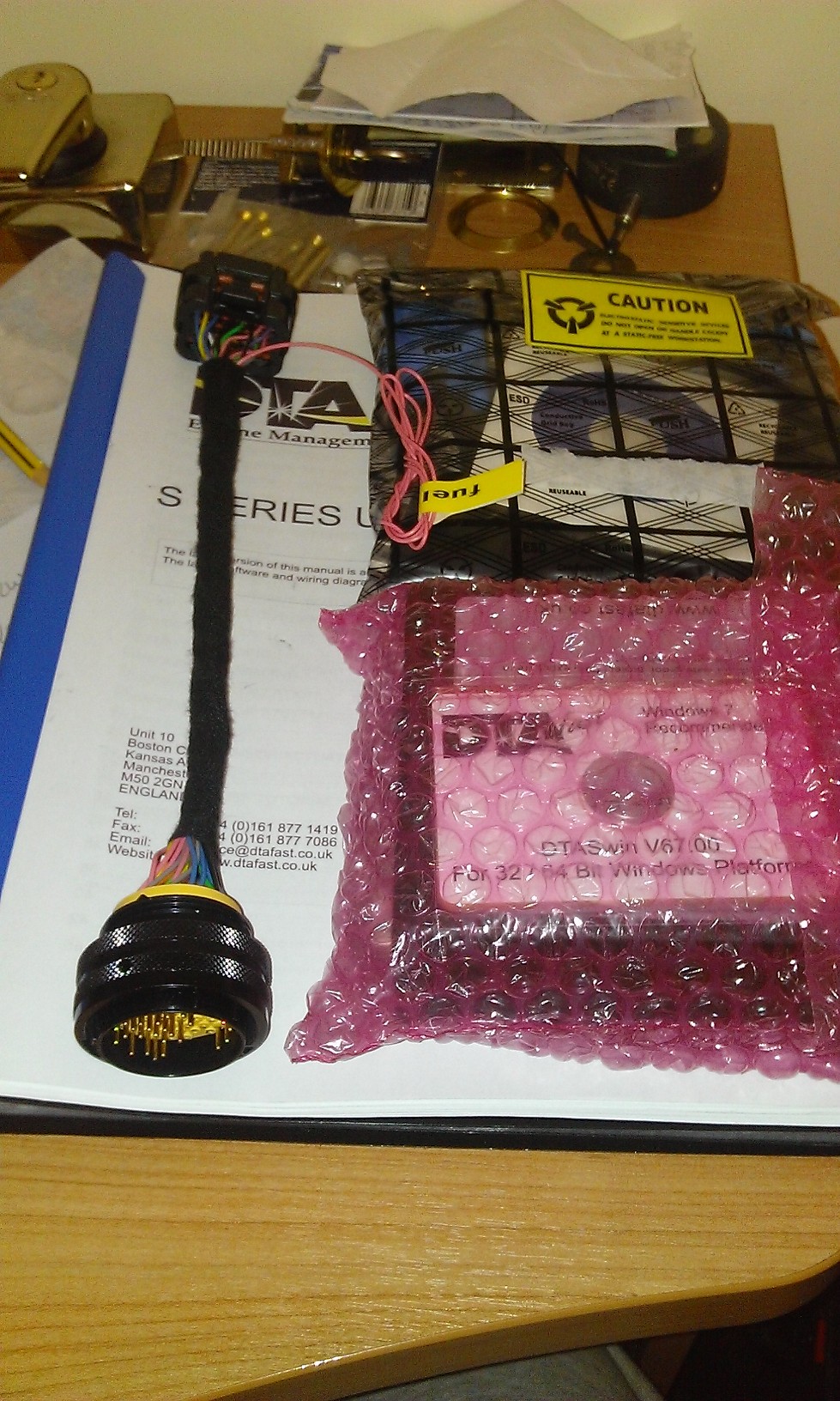

To change the ECU has ment you have to rip out all the very expensive Reanultsport loom. Only option was to buy a K-Tec ECU and patch loom and software licence and cable for nearly 2k.!!!
Well im working with doing this plug and play with a DTA and it being half the price of the above solution.!!!!
Anyone interested??

All i need to get sorted is the same CAN data stream as the MF4 ECU. May not have all the diagnostics but if the basics work then happy days.

with this route you use all existing wiring plug and play for leases than half the price and can upgrade to x dash at a later date.
just need to get it to work lol !

LoL no diagnostics but can view all the inputs etc. its one benifit for working for one the the biggest controls company in the world. They said it wasnt very difficult matching the CAM datastream of the MM.

Next month (prob March) i will work on some packages after i get the rallycar sorted. Will be less than half the price of the K-Tech solution with a better ECU and no tie in (extra cost and inconvienience) with mapping etc.
