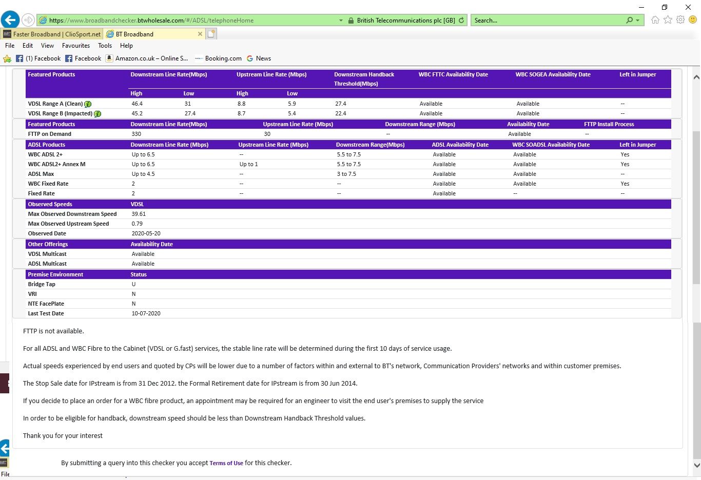

Lob your number in the above and see what sync speed and services you’re able to get via openreach. I assume there isn’t any Virgin in your area? Worth checking if you’re not sure.
Also worth plugging a device directly onto your router and checking the speed your receive along with checking your sync speed on your router against what you ‘should’ be able to get using the above checker.
How slow is slow? You should be able to get a decent fibre connection at that postcode. Can you post results from Speedtest.net?

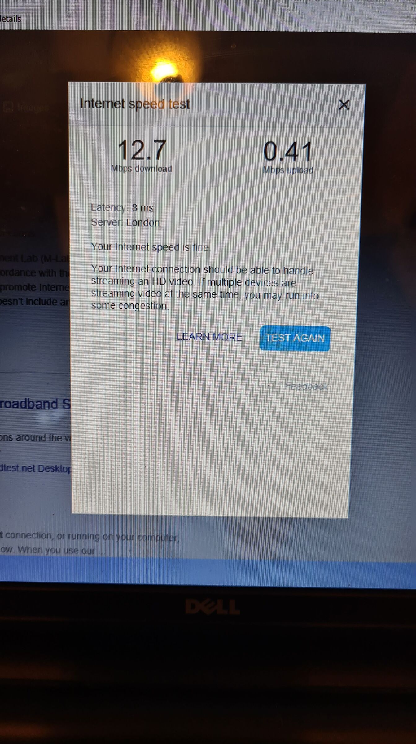

am not plugged into router, am just on my laptop wireless. but speed test came back as 28mbps and 0.58 upload

From this it looks as though your router is syncing at 39.61Mbps and the max you’re likely to get is 46.4Mbps, however your upload is very low compared with what your line can provide but that might be capped by your ISP but I assume those observed speeds are sync rates I’m not 100% sure. With your upload speed so slow it will effect general browsing especially with multiple phones etc connected so I would raise a fault with your ISP to have a look into it as a first port of call. The download speed difference between what you’ve just tested and the observed speed could just be a WiFi ‘issue’ as such, but sorting the upload will help for sure.

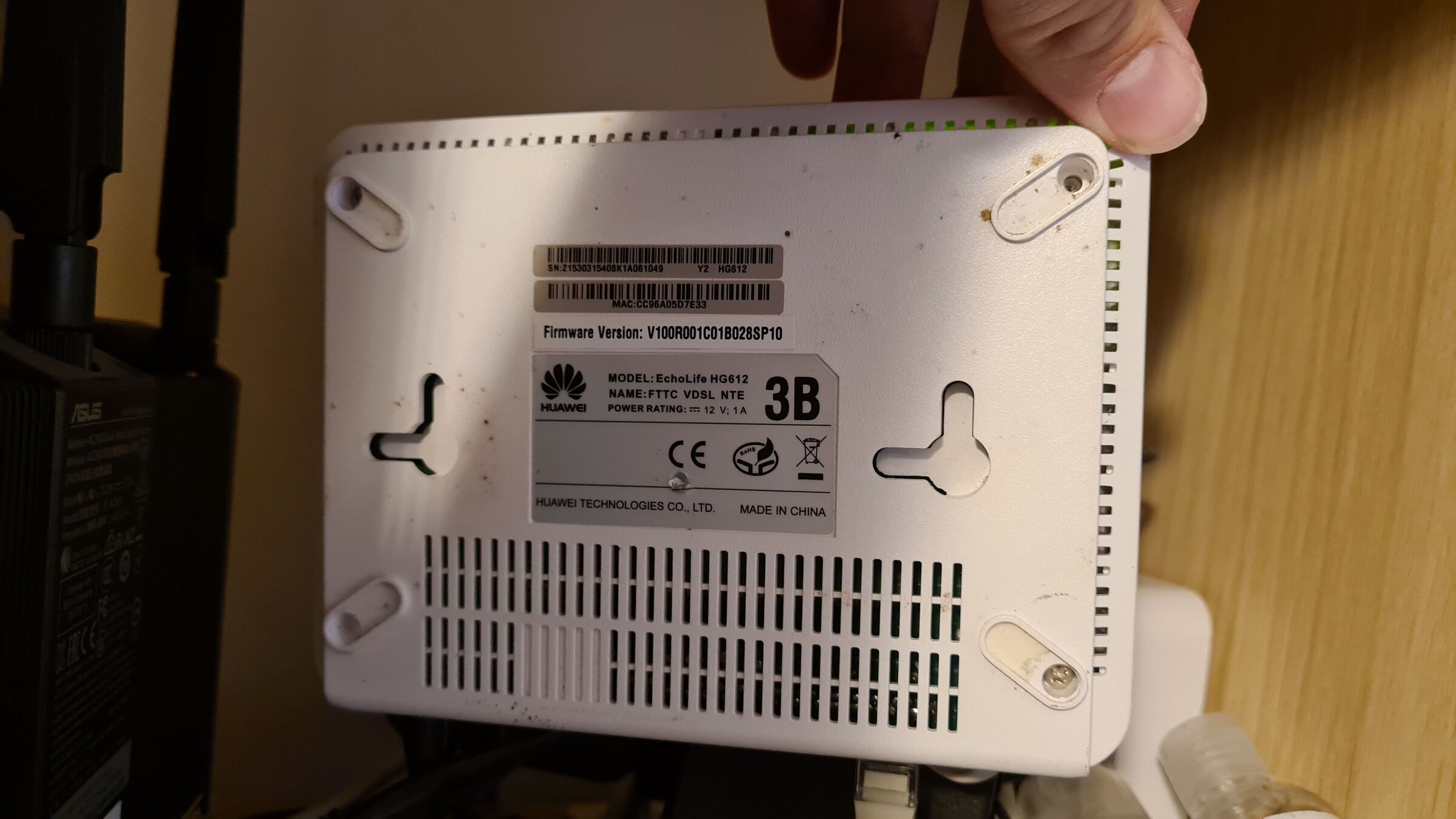

So I have a little white by modem plugged into the above Asus router

Lack of upload will not help with this at all, I was using 3Mbps upload on a Skype for Business call today and you have 0.8Mbps available for every device on your network.
Agree- your upload speed looks to be the issue. If it’s still that low when plugged directly in to the router I’d raise a fault with BT. It’s probably the first thing they’ll ask you to do anyway.

I got the phone line coming in, going into one of these BT white boxes, then going into my asus router.
I thought I could plug my laptop straight into the bt white box, but I don't get internet.
I could just plug the new BT HH in, but sadly then ive got a spare £150 router :(
I think you need to ditch the white box. Plug the HH in, and then plug the router into that.
