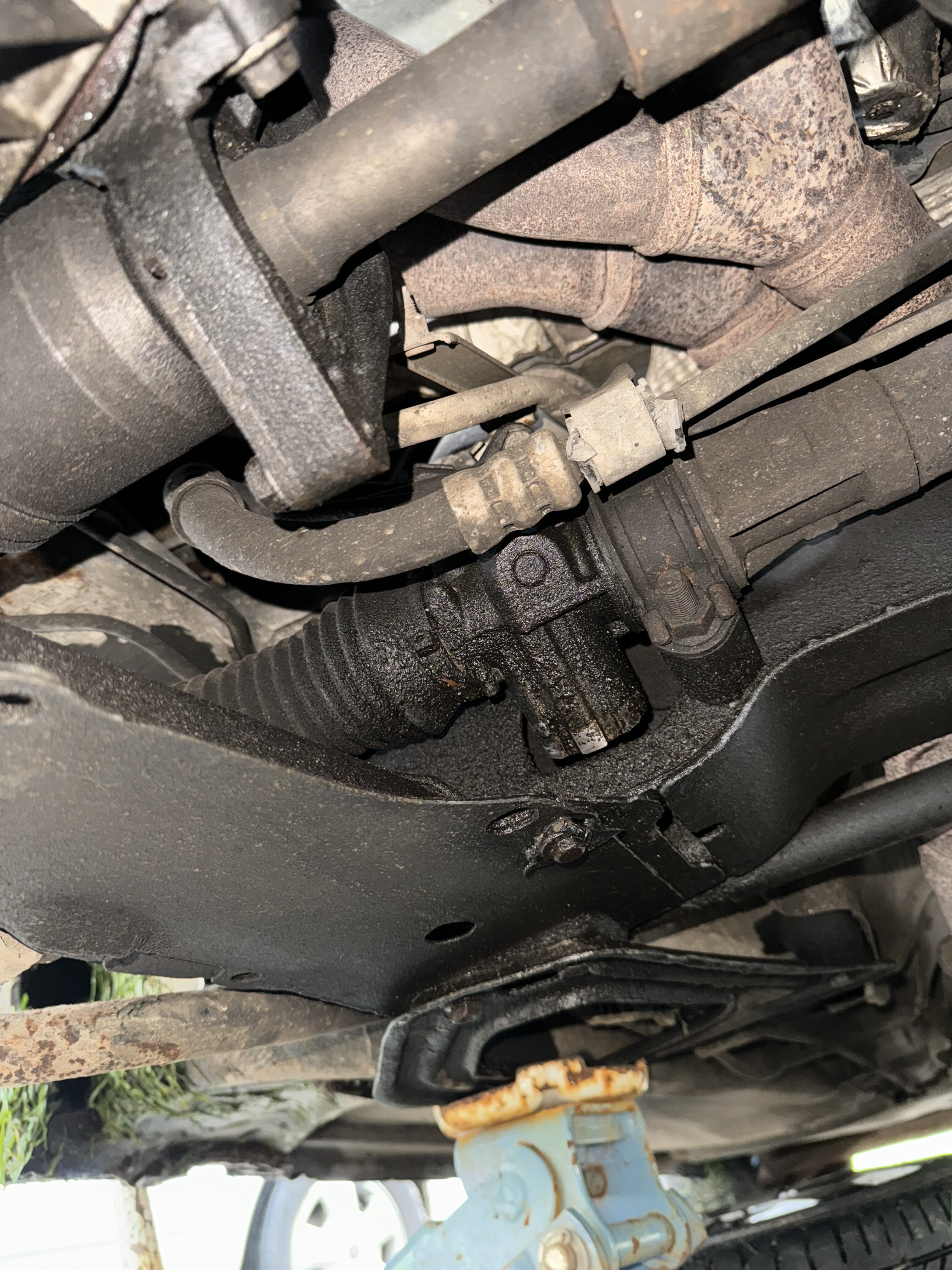

Number 1
Suspected power steering fluid from rack

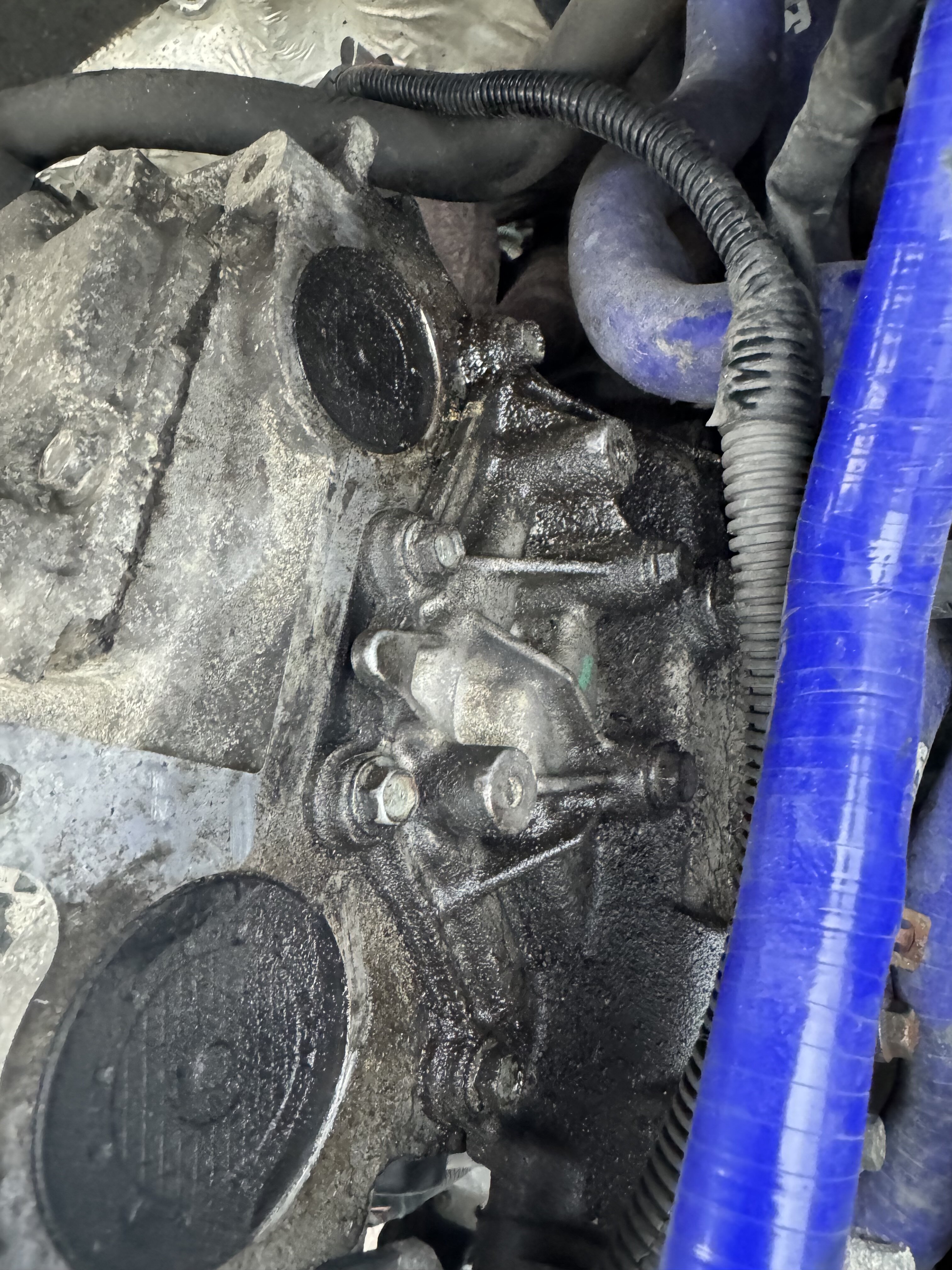

Number 4
God knows

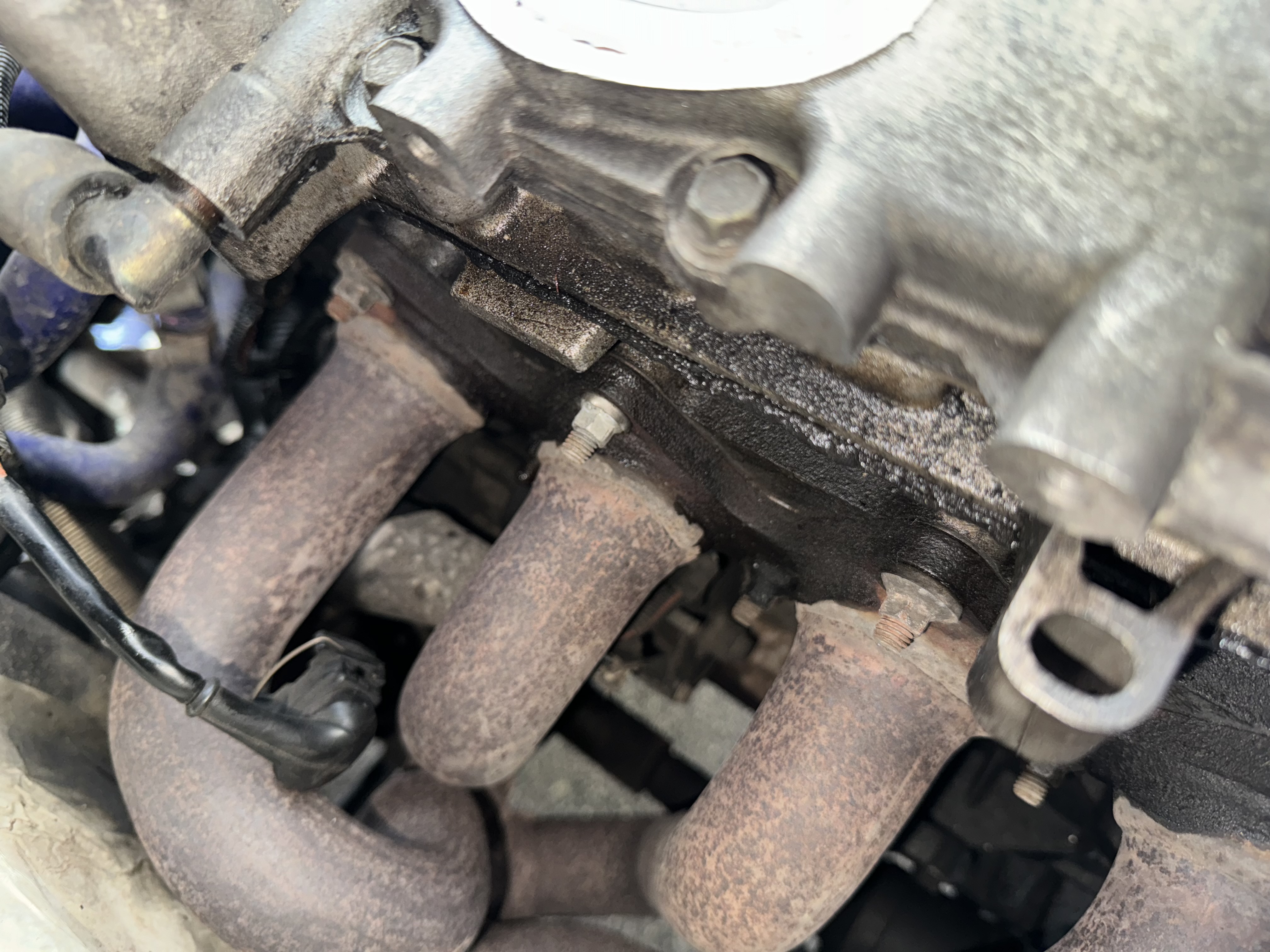

Inlet manifold?

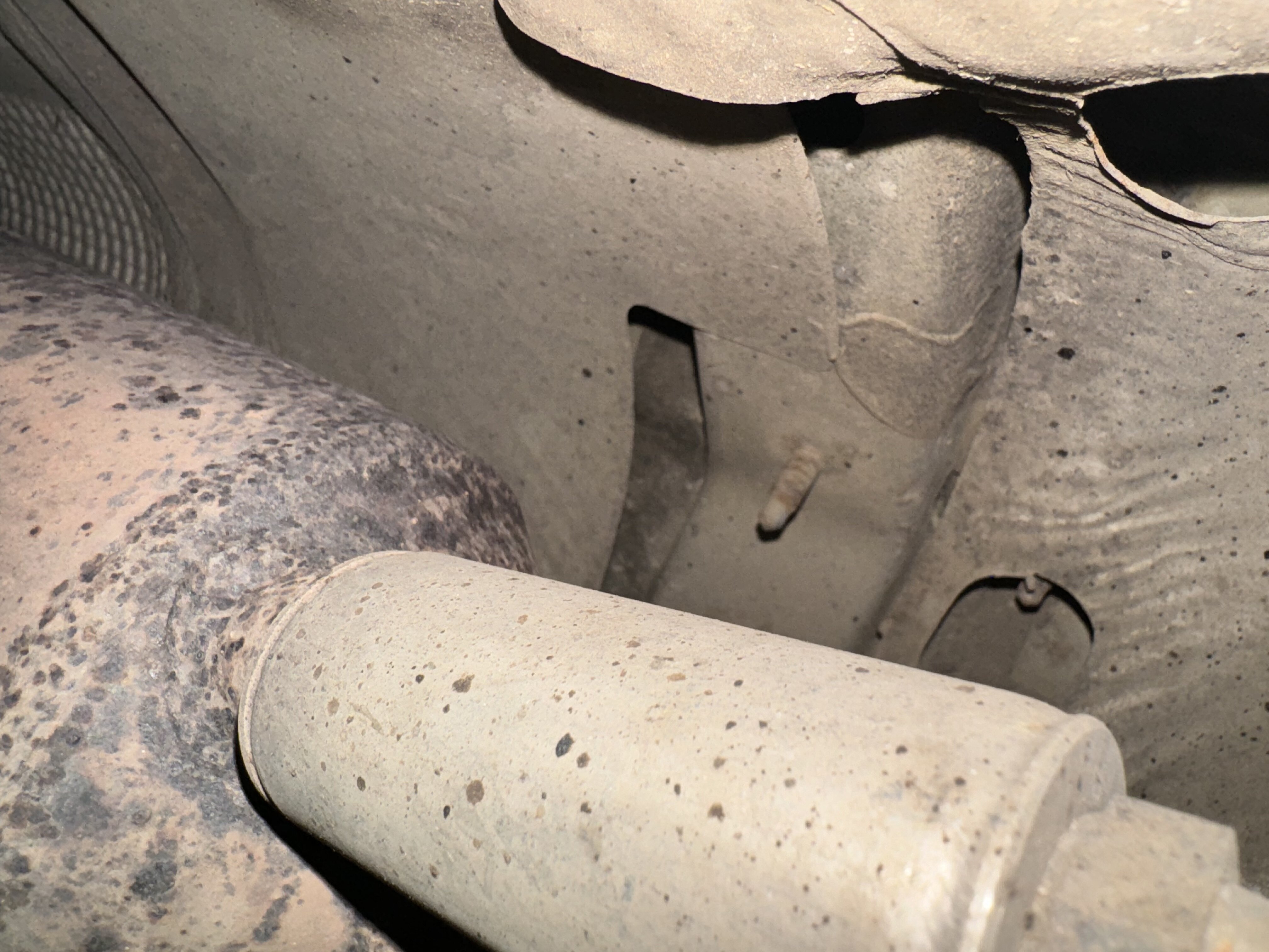

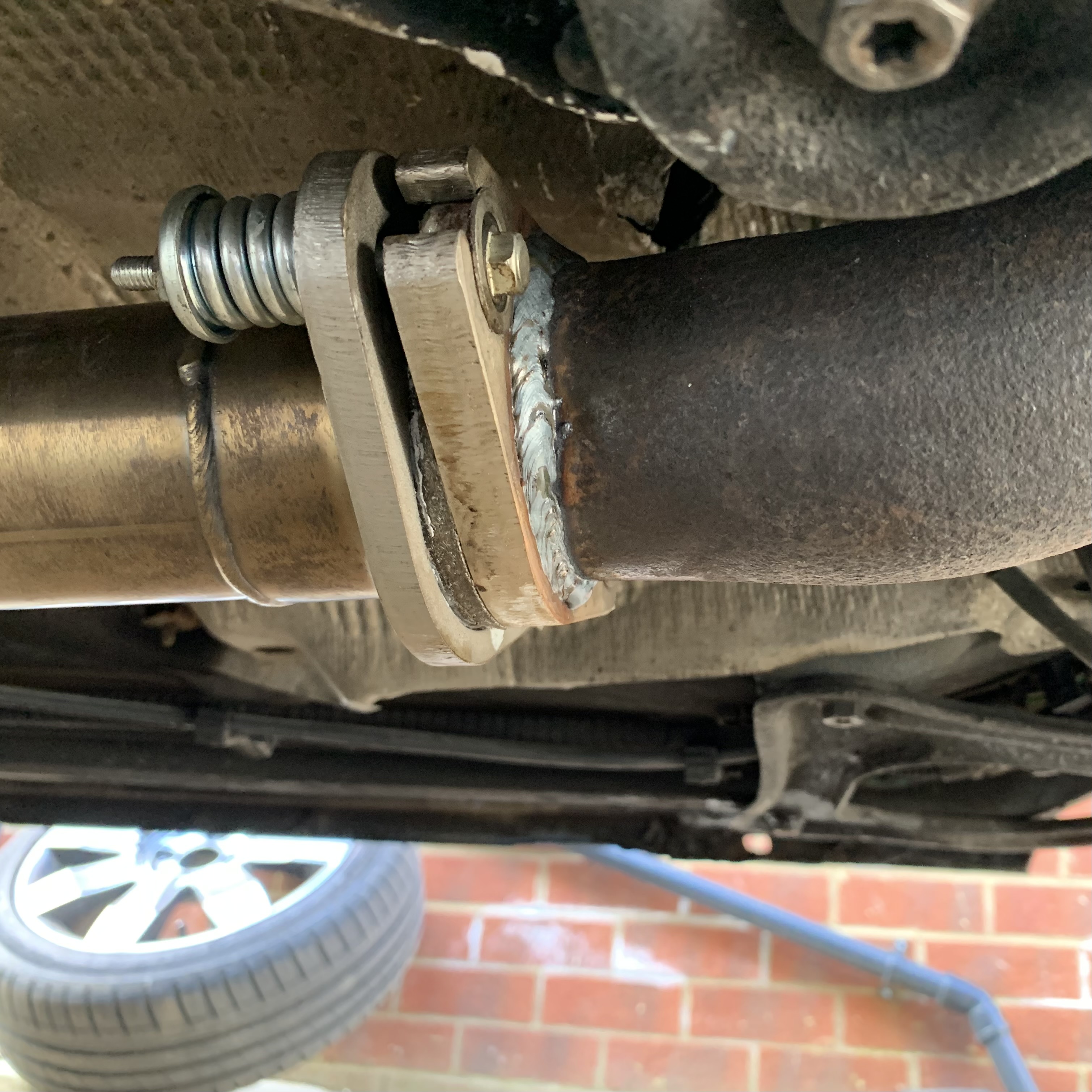

Exhaust coupler loose i believe this should have a think flange/rubber gasket in there?
Last but not least should this have a bracket attached to it for the middle section of the exhust

I can’t help with number 1. Whilst I’ve replaced tie rods, covers, rod ends, I’ve never had to deal with a leaking seal on the rack itself, which I suspect this is what it is.
Incorrect fluid or overheating due to track use I suspect. Not sure how successful replacing seals are, so likely a reconditioned one is the best approach. Or if you’re only going to hammer it around a track, go non power steering or EPAS. Lots of info in the guides section and various threads available on here. You’d need to be a member to view those.

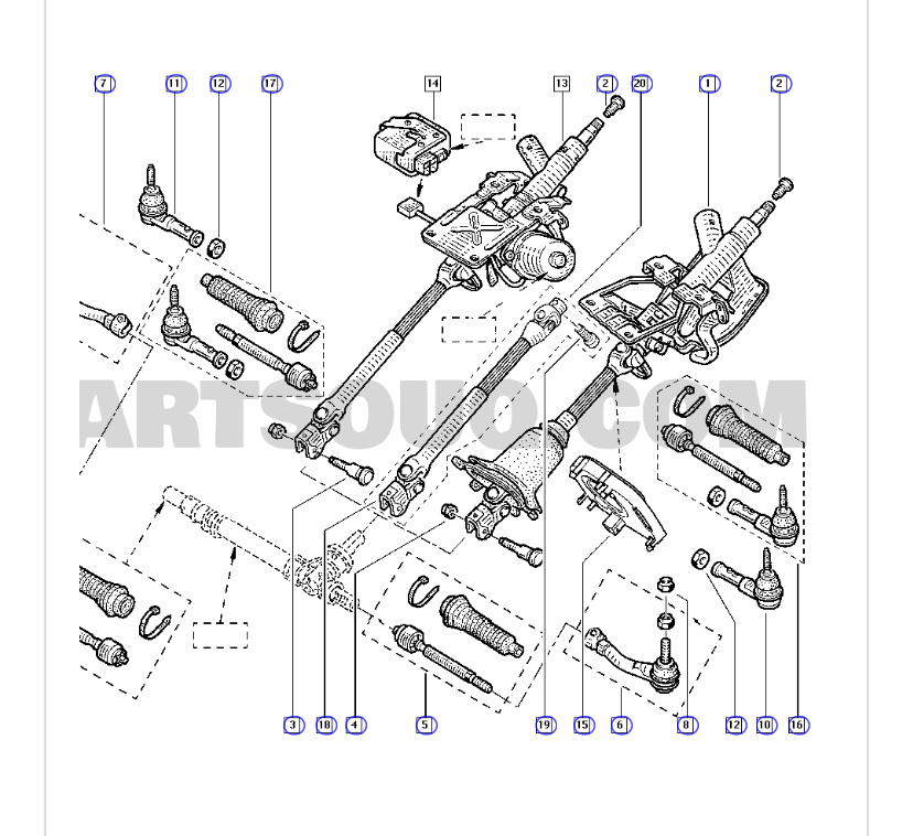

Here’s an exploded diagram of the rack itself.
The 2nd, 3rd and 4th pictures could all be related to leaking oil from the rocker cover. It’s common to see oil around the first spark plug hole as that’s where the oil filler is and people are clumsy when doing oil top ups. But also if the cover has been off and not sealed properly, it’ll naturally leak in those areas. I’ve seen an engine where oil is coming out of the head studs before, which invariably goes everywhere. Again, due to poor application or wrong use of sealant when refitting the cover.

The Exhaust flange is typical of an old poorly maintained and rusty old Clio. It should look like this.
You can buy the flanges which can be welded in situ by any decent exhaust centre. There’s a recent post on this and a name of the chap who supplies the flanges. If I have time and you don’t find it, I’ll add it on here. The sealing gaskets are a weak point and other than V banding, which I’ve never done, K Tec Racing sell the only seal worth buying.

There is a supporting bracket and rubber for a factory exhaust, but this is an old Clio and chances are it’s got a lot of aftermarket parts fitted to it now.

Degrease the cam cover and run it to pinpoint the oil leak.
If its cam cover gasket its a pretty big job as its cambelt off to remove it, which needs specialist tools to do properly.

Number 4 could very well be the solenoid seal.
