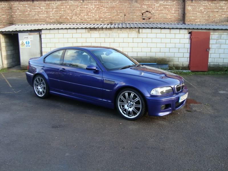

So undecided on the colour of it..?
I feel as though its probably more appreciated in the flesh?
To be honest, its actually impossible to capture the colour with my iPhone!! I'll take some proper pictures of it over xmas, maybe then the real colour will come across a little better .... at which point, everyone will hate it lol :eek:
I would post some pics of other ones, but they are uber rare in M3 flavour, a few Clubsports/Sports come in Velvet though ...

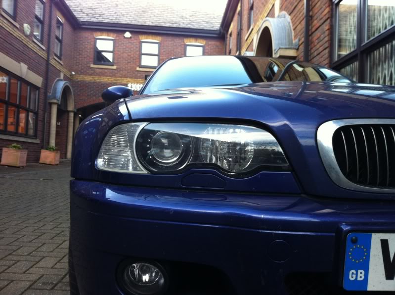

I've no idea what depos are, but if i'm honest, they look bloody awful. I expected more from you!

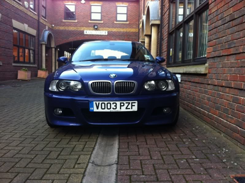

Ha ha, i thought the same if im honest, expected them to look totally different, so ended up taking them off at lunchtime!!
Sold them already, so not the end of the world ...
Think this looks much better!!
:D

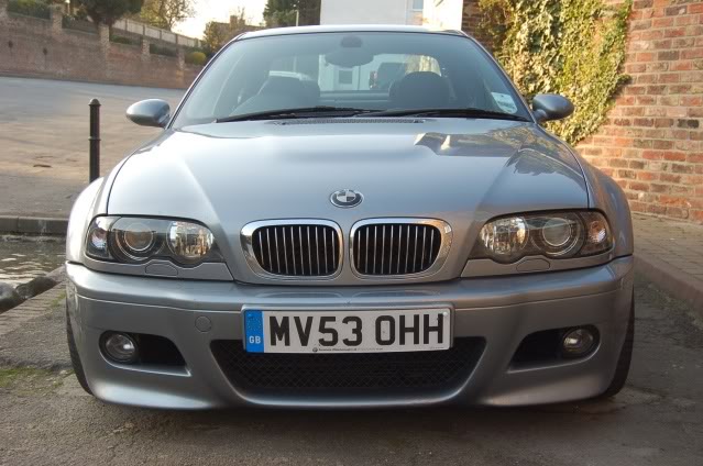

Example of good OEM style depos.... (clear lenses, black backing, round silver reflector)
They're much better!!! No mention of them anywhere on M3cutters FFS. Where did you get them?
Although, im still unsure whether they would look right on purple ...

Looks better with just the silvervisions, as you say OEM+ :)
I'd prefer the ones Waitey has posted as they look more like the headlights.

Dave mine were called 'projector' have a look on ebay.
The ones with tinted lenses are really really rank.

Way better with the silver visions on the oems mate, everyone harps on about depos but I've never liked them!
I remember fitting mine, makes a big difference for such a small mod.

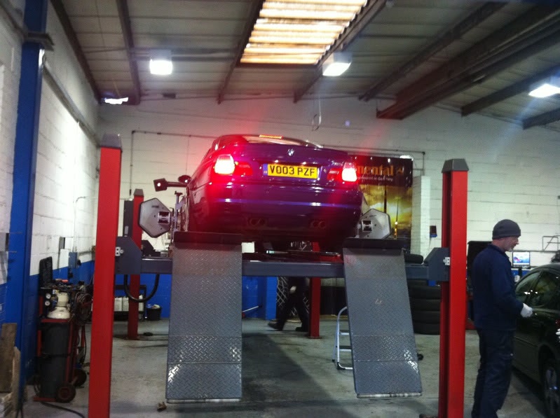

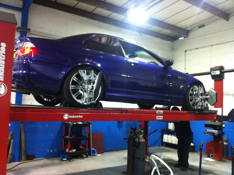

After that, we popped down to Guildford tyres to get the wheels swopped over, & get the tracking sorted - unfortunately this involved fire, as the tracking/camber had obviously never been setup properly before. To be honest, its still isnt, but nevermind, it'll need doing again soon anyways it would seem ...

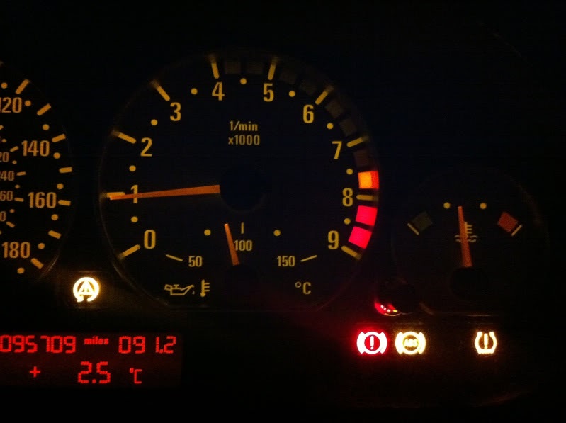

Finally, for the past 2 weeks i have rolling without traction control or abs, not i might add as i fancied being a hero in the winter weather, because my dashboard that looked something like a xmas tree:
Yet again, my investment in a BMW diagnostic lead & software (INPA) quickly led me to the cause of the problem - a right rear abs sensor that had been failing intermittently. A quick call to Euro Car Parts on Tuesday morning and £60 later a new sensor was on my desk yesterday afternoon. After swopping it over last night (took 30 mins), the dashboard is back to normal and everything is working again properly, just in time for me to drive down to Cornwall for Christmas :D

Looking good mate. What's the issue with the tracking then?
Sir_Dave
ClioSport Trader
Actually better than the 197... running costs.. not so much! ;)
Basically, they couldn't get the rear camber quite right & the steering wheel is still off centre - the reason for me wanting it done in the 1st place lol. Running costs, well im just glad that i have a toolkit and dont have to pay BMW prices :eek:

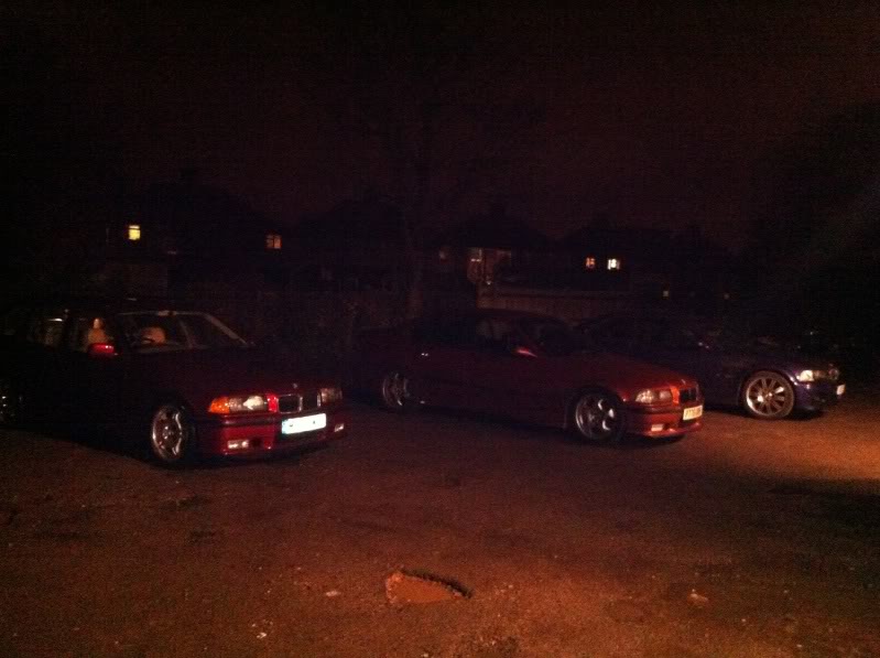

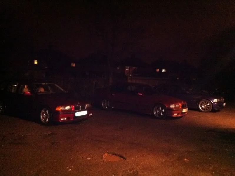

Forgot, took a picture of the fleet on Tuesday night as well.
Budgie - e36 328i Touring
Nick - e36 M3 Evo
Me - e46 M3
Just need to get Ollie a BMW now ... :butt:

My ABS light and orange exclamation mark are on my dash now! Something for me to look in to after Xmas!

my steering wheel was slightly of centre on my e46 m3 , a load of lights came on the dash the other week when driving down motorway , lit up like a christmas tree , was down to the tracking being out my local bmw specialist told me , ever since the tracking was done ansd steering wheek ligned up the dash is fine now , rear springs snapping are common as well , my old m3 ans my one i have now both had snapped rear springs , car looks lovely as well , nice colour you got t in
