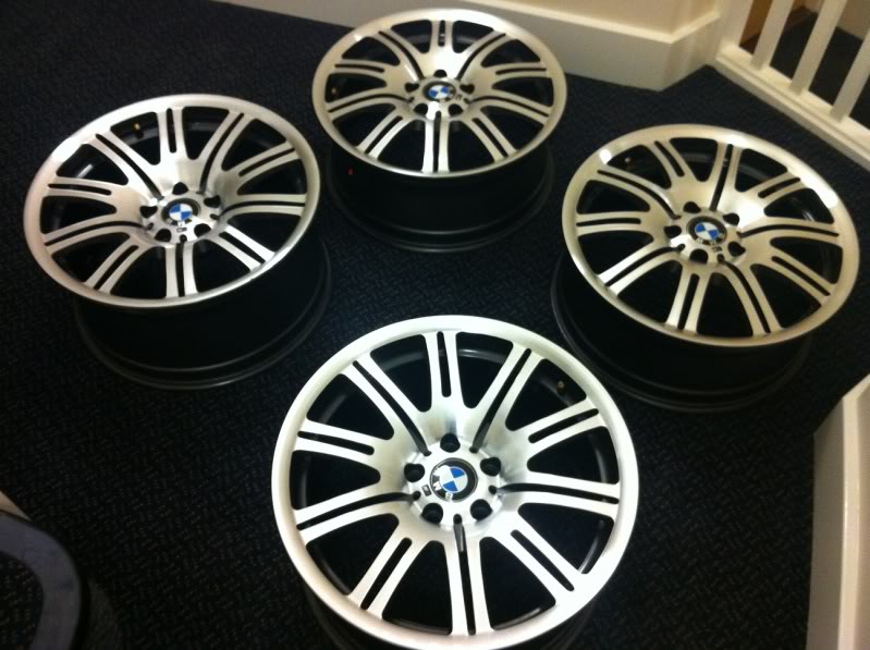

Collected these s3xy things last night as well, seller was a lover of detailing, so its safe to say that they are quite clean :eek:
Cant wait to get these on, & the tints off. Will be perfect then. Well bar maybe some Eibachs ...

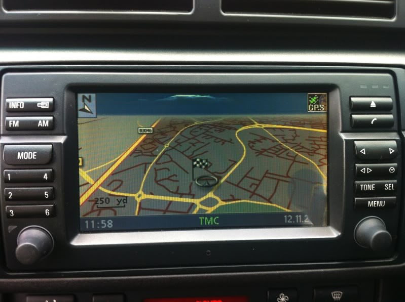

First things first, the EML light had been coming on sporadically over the past 2 weeks, so after a quick diagnosis with INPA (like VAG-COM, but for BMW's) during the week, it seemed that there was an occasional misfire on cylinder 5. Having had the headgasket changed recently, my initial thought that was one of the contacts on the coilpacks was probably a bit loose, but after checking they all seemed fine - new sparks plugs x 6 as well, so that left the coils themselves. Upon inspection, it still has the original Bremi ones, which are known for problems, so £30 later & a new Bosch one was fitted in its place. Seems to have cured the problem, so fingers crossed ...

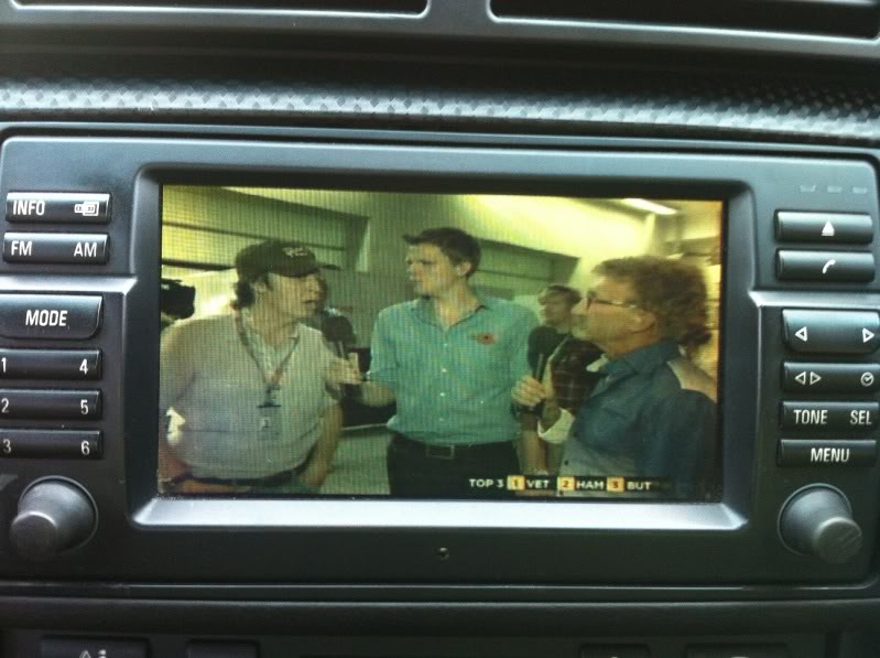

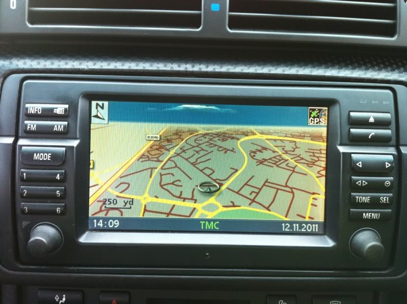

Once that was done, it was time to install a new satnav monitor. I basically bought the car knowing that the screen had a mark in the corner, & had purchased another one the day i collected the car, just hadnt got round to fitting it - wanted to wait & fit my Parrot MKi9200 at the same time anyways. Bit of a pain to get everything out (inc. the dash vents), but not so bad once you know where all the hidden tabs are!! All fitted & the screen is perfect, although i do need a 5m extension cable to complete the Parrot install - i completed forgot that the ISO connectors for the steroo are in the boot when you have nav :eek:
Before (not the dead pixels in the bottom right hand corner):
After (TV function came in useful ;)):

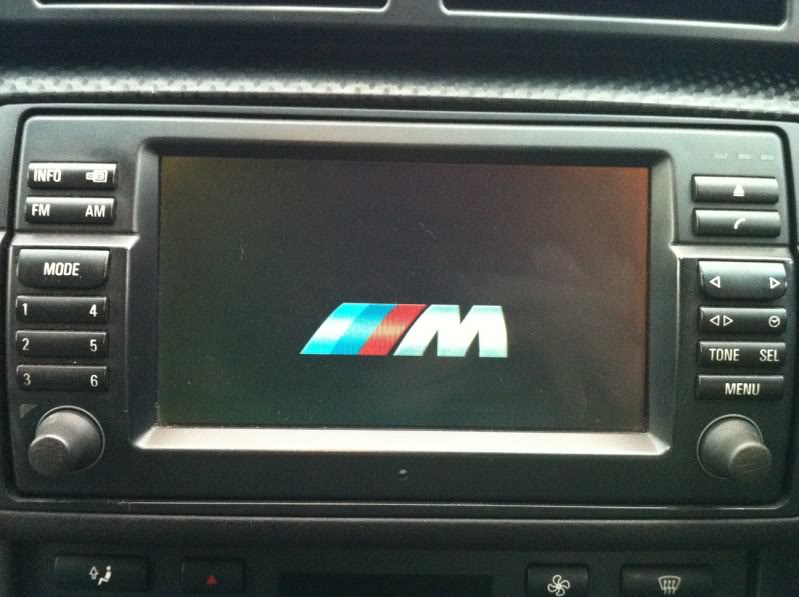

Also bought the latest 2012 maps recently, along with the latest operating system, so now have speed camera function, night/day map colours & a special ///M splashscreen. Geeky, but meh :cool:

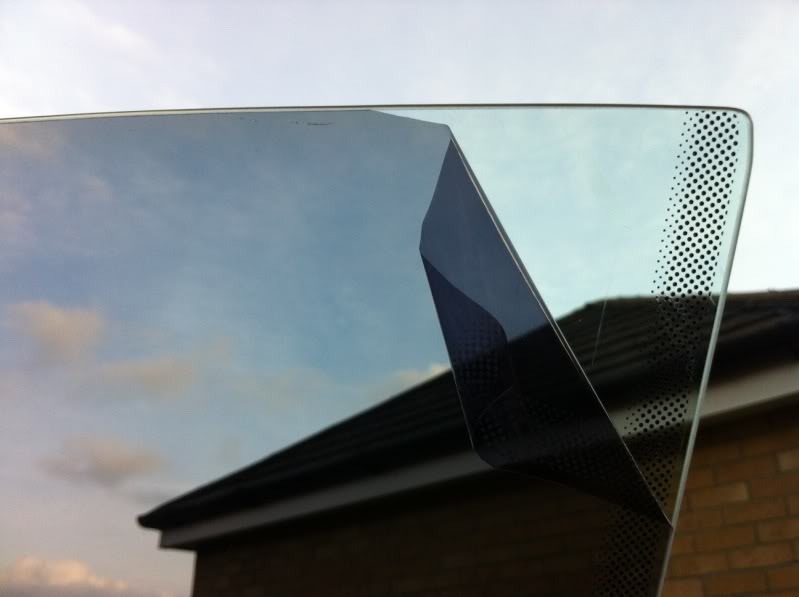

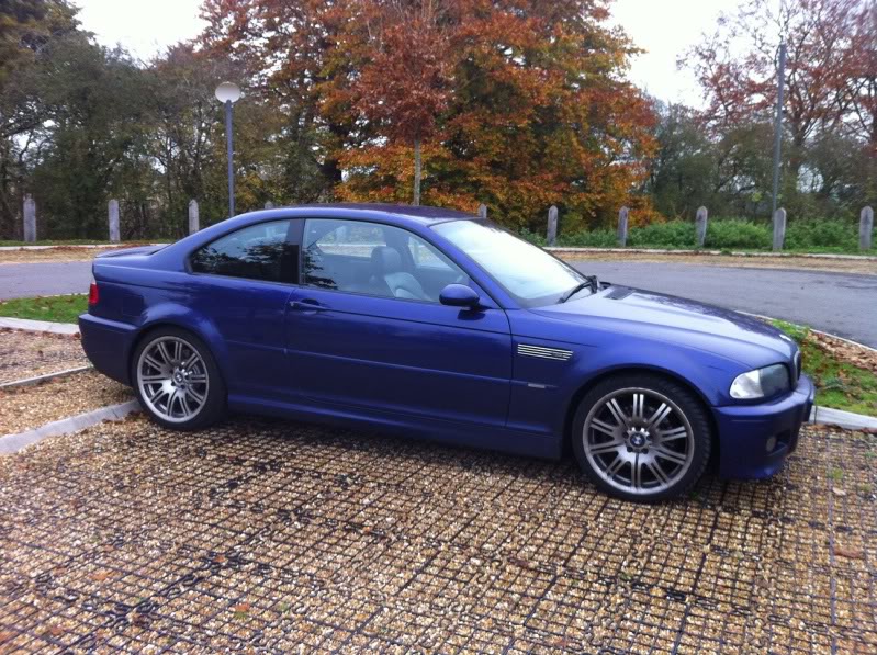

On Sunday, it was time to attack the gangsta tints. Which to be honest, were really ruining the car for me!!! After everyone said they were going to be such a pain to remove, i had set the entire day aside, but after 2 hours it was all done, & that involved getting distracted by the F1 constantly as well lol!! Worst bit was the rear window, purely as it was difficult to get to all of it, but the rest? Easy peasy. I guess decent planning, ie getting on Detailingworld & doing some searching, then subsequently buying the correct tools for the job made things a bit easier ;)
In case its of any use to anybody else, i used the following method:
1. Peel off film (no hairdryer)
2. Clean window using 0000 wire wool & pure acetone to get the majority of the glue off
3. Finish window with 0000 wire wool & Tardis to get rid of any left over residue
4. Polish using Windowlene & a kitchen towel
5. Admire clean/non tinted windows.
50/50 - Detailing world clearly rubbed off on me, FFS i was only on there for 5 minutes!! Tints were ruddy dark though, god knows what % ...
And the final product. As you can see, much better :approve:
Next job, ordering two more Kumho KU31's for the front (hate not having matching tyres all round) & going back to the standard OEM tyre size of 225/40/19 as well. Current ones are not only budgets (Primewell's) but are the upsized CSL width, ie 235/35/19 - which would be fine if the rears were upsized to 265/30/19 (instead of 255/35/19) but they're not, & i dont want to change all four !!
Once the tyres arrive, ill then get to put the new wheels on. Once they're done, its just the following to do & ill be happy :D

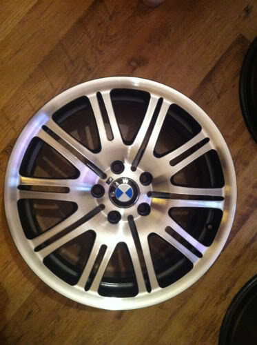

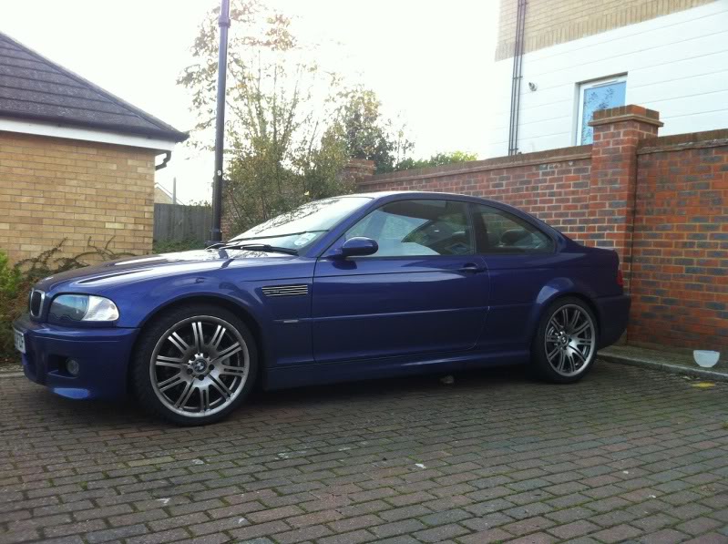

Funny you should mention that .... after much umming and ahhing as of late, i've finally gone & bought some new wheels.
I couldnt bring myself to buy reps, even if they were sexy CSL ones, so four minty fresh OEM 19's are being collected on Wednesday :cool:
Just need a couple of tyres for the front now, the Primewells are really putting me off drively quickly lol ...
I think you've made the right move. Whilst i love CSL's, the OEM wheels look just right and i love the silver colour as opposed to the shadow chrome.
Mod's are looking good, interesting Re. 2012 maps and the night time maps!!! - I've always moaned about that on mine, it's so bright at night with day time maps! - I end up turning it off!

Looking so much better now Dave. I even like the colour, seen similar somewhere before.. :eek:

Really good news on the tints. I need to do mine and i've been dreading it!
Not too bad at all tbh, didnt even use the scraper i bought !! Stuff cost naff all from eBay as well. Winner.
I agree, silver looks much better than the shadow chrome. Think that with them changed & the tints removed, the colour of the car will really come alive, just need to give it a good machine polish then!! Pm'd you re: the maps as well btw :)
Wider arches, bigger wheels, special engine? Its a 300% 3 series, in the 300% fiesta colour scheme ...

Looking good :D I will admit that it does look better without the tints :rolleyes: wheels are looking good too and its got a nice stance about it with the lowering.
BUt i havent fitted the new wheels yet, or lowered it lol :S
Stunning. Are you going to fit the new wheels during winter?
Yup, they have about 15 layers of poorboys stuff on them at the moment (previous owner), so they should be fine. Probably.
