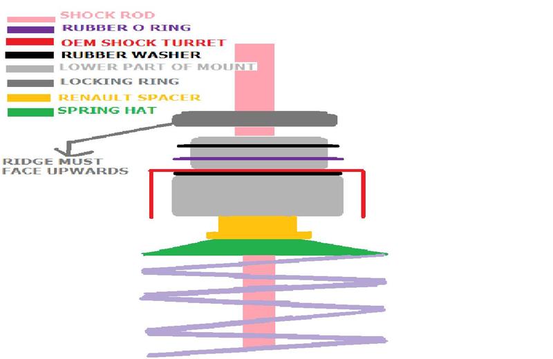

I bought the solid top mounts 2nd hand off here so didn't come with any instructions. the parts I have:
- the main top mount with its lock ring
- the top nut
- a sleeve/ collar approx 10mm tall
- a stepped washer/ collar
The washer and the sleeve I have no idea where they are supposed to go on the suspension strut and what order.
With the original top mount, is it just the big rubber bit on top I have to remove or anything else? I haven't taken these apart yet.
Anyone with their instuctions from the group buy still? I need your help
Unless they come off the original strut, I don't have the rubber O rings or rubber washers?
Should I get them with the top mount or will they be on the strut already?
Having trouble trying to buy a set of rubber O-rings and washers, and trying to find out the correct size.
Does anyone know the thinkness and diameters of these so I can start searching autofactors?
erm just measure the size of the threaded bit of the mount, and there about 1mm bigger, nice and snug fit, similar with the o-ring.

So the internal diameter is approx 1mm bigger than the actual strut, but does it matter what size outside diameter?

For those that would like to know......
rubber washers: x2 per top mount
Internal Dia = 45mm
External dia = 55mm
thickness = 2mm
Rubber O-Ring: x1 per top mount
Internal dia = 45mm
Thickness = 2mm
All fitted now?
Got them fitted over the weekend, and what a bl**dy nightmare! Couldn't get the top nuts of the struts and had to crank up the pressure on my compressor, then had to grind down a socket to fit the new top nut once the mounts were on. And where does the 10/15mm sleeve go? I couldn't see where it went and it didn't seem to fit anywhere so I left it off.
