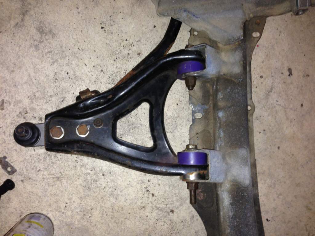

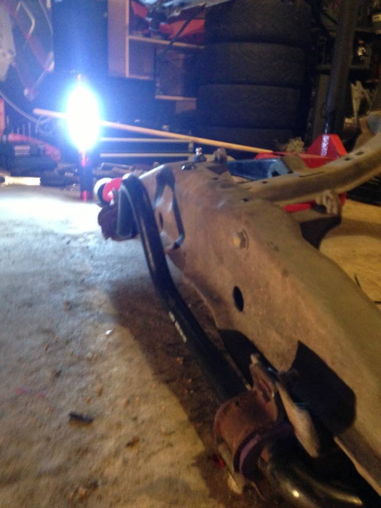

172 cup subframe for extra width
172 cup wishbones for extra castor
Arb polybushes
Wishbones polybushes
Wishbones also had new ball joints

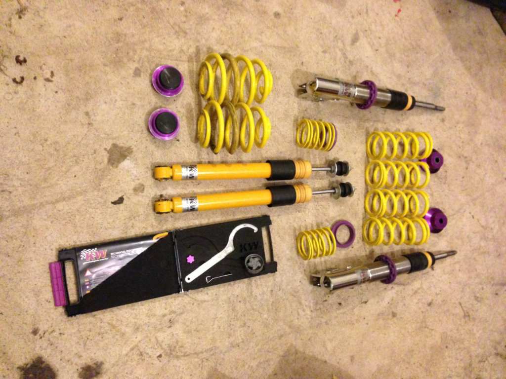

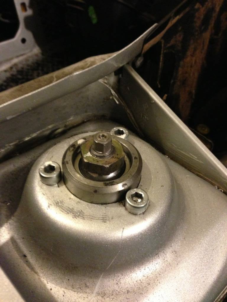

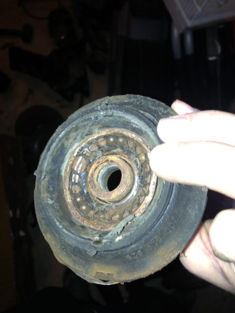

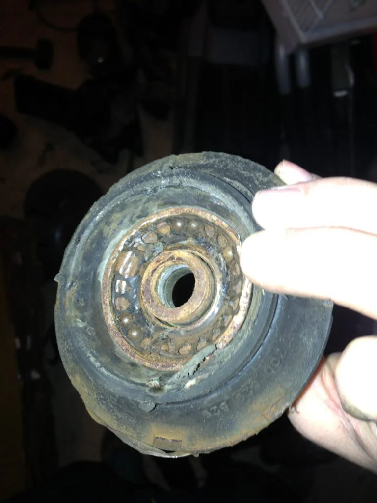

Got some PMS top mounts to go with the KWs
Definitely needed...

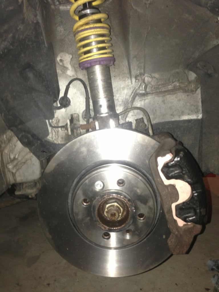

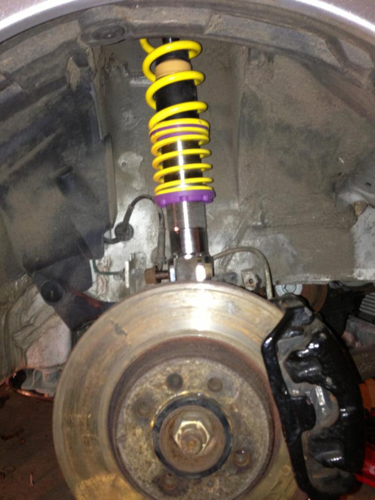

Some pics of the KWs fitted

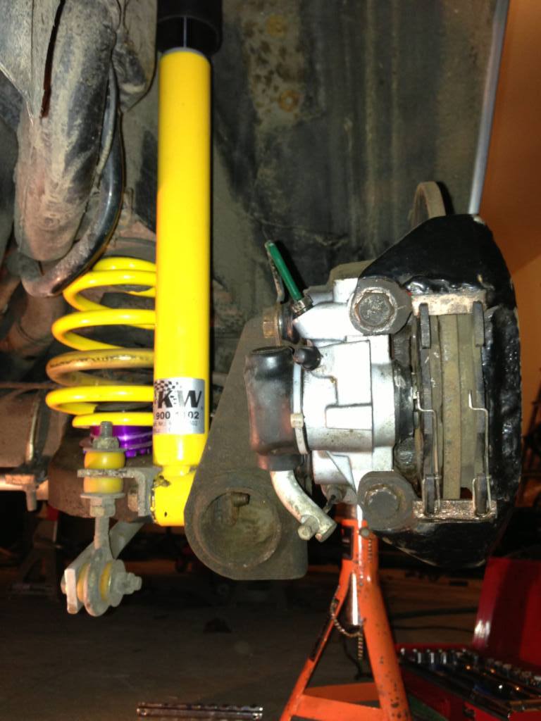

New brakes on the rear as well, calipers came of a cup that I broke

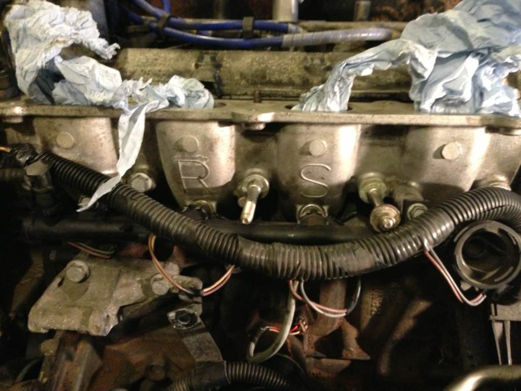

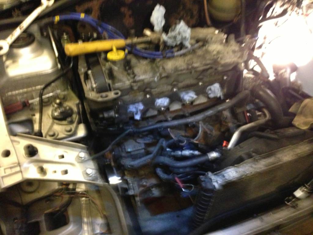

In the engine bay I removed the AC and fitted some lower RS stamped inlets, again came off the cup

Is the way your bolts to top mounts not correct there then as that's the way mine are fitted too bolt straight through body into top mount?
Looking good btw exactly what I'm planing with the powerflex freshen up tell any difference?
There only a tenner John, and on there website to buy separately I'm just a lazy bam!!
It feels a lot firmer and more responsive, but with pretty much every component in this area being changed its hard to tell how much of a difference they made!

Out of interest how much bigger was the cup subframe compared to your ph1 from wishbone to wishbone hole?
Some of the washers?? Would be ideal if you do!
I never actually measured, forgot to and by the time I remember I had it fitted, I think it's about 5mm a side though! Purely the position of the wishbones holes

So off came the DS2500 and brembo HC.
I ran these all last year, covering 8k and 5 track days! And both still have plenty life, there on the shelf for spares!!
