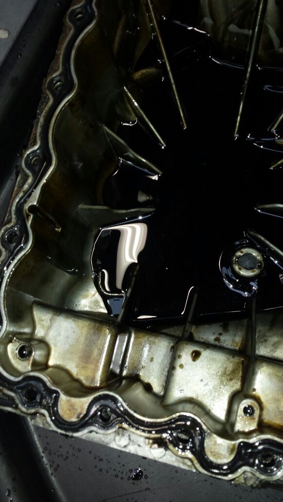

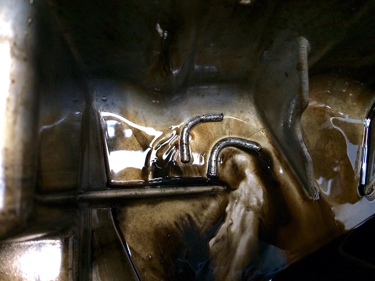

However, I took it up to clitoturbo.co.uk for a couple of minor issues I wanted andy to look at and some fluid changes (you can never have too many fluid changes). Engine out, sump off and Andy found these..
My oil squirters decided that they didn't like their original home.
It looks like I have gotten away with any permanent expensive damage and it'll just be a case of a cheeky rebuild. I am just pleased we found out now and not later on when it could have resulted in an engine failure.
It was me who built the engine.
When the block was bored the engineering company removed the oil squirt jets to allow it to be bored. They then refitted the new jets after the work was carried out. I collected the block, and the various other bits they had done and assembled the engine.
I stupidly didn't check they clearance of the jets as the company I used for the work have done many many Clio engines so just took them to be correctly fitted- clearly an error.
Since seeing this thread I have contacted Andy RG off my own back and the repair to George's engine will be done by Andy to no extra cost to George. I will be covering the cost.
I would again like to apologise to George and hope the car isn't off the road too long while this gets sorted for him.
