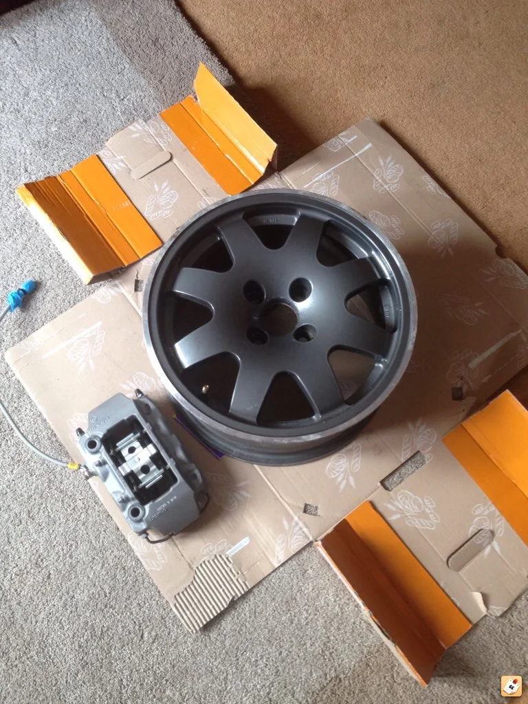

I have been undecided on brakes for a little while and these 197 Brembo's popped up for a reasonable price.
These should be an improvement on the standard callipers and depending on how well they take abuse I might stick with them!

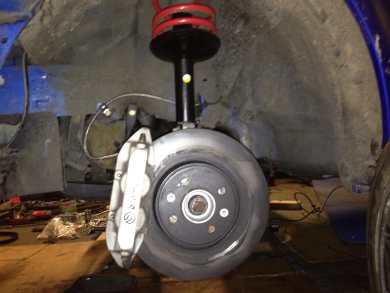

Fitted the brembo's today and it went seamlessly![]()
They will fit under the williams wheels with 20mm spacers which is excellent news.
Obviously I can't judge the performance yet as the discs and pads are new.
Initial impressions are that the top of the pedal is softer than before (due to the increased size of calliper I assume) but better pedal feel after the initial softness.
They look epic under the williams wheels and fill the standard cup wheels nicely.

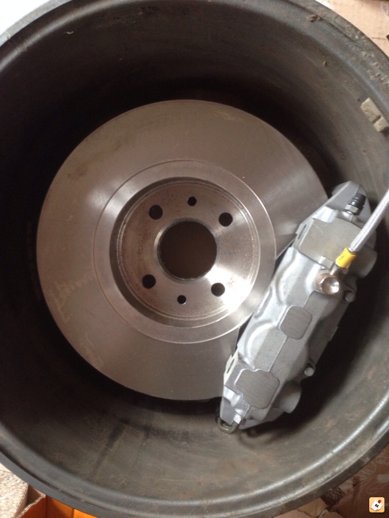

Does anyone have a picture of a standard 197/200/r26 brembo of the mounting surface? I wanted to see if mine have been machined - I had some 300mm discs lying round that I tried, with no luck.
George you will see n the bottom of the picture the mounting face is essentially flat to fit the 280mm disks where as 300mm are raised. The mounts also need to be 5mm bigger as Wayne says (hi) which gives another 10mm diameter change.
If you really want then large 5mm penny washers and non machined callipers will get you there. I will say though you will never get the 300mm scenic disks or a disk with that offset under a set of 16" wheels without stupid width spacers.
Edit: Can you post a picture of your brackets too please for ref as they look to have bolts which is physically impossible done right.

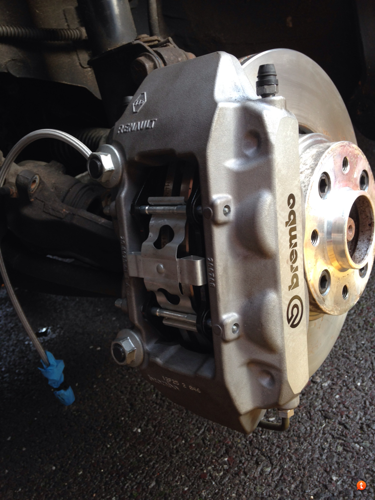

Yeah they are fine George, they are stud and nuts which is a must for 280mm disks. I'm guessing you have a hole machined through the bracket too?
Sure am.
That last post was worded a bit strong, quite a few 16" wheels would fit but spacers are almost a given. My 16" et40 pro race 1.2's needed 10mm to work with 280mm disks which isn't too bad I suppose.

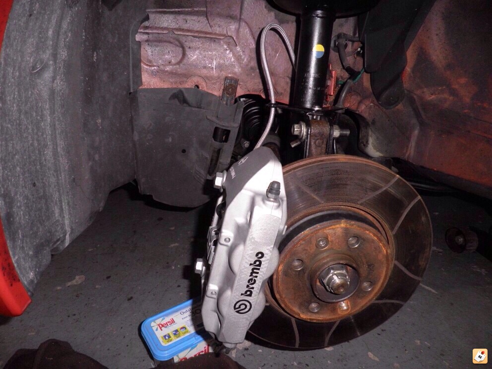

And also you might want to route the brake hose different to what you have in the first pic or it will rub through.
I'll go get a pic.
Should do the trick for now![]()
