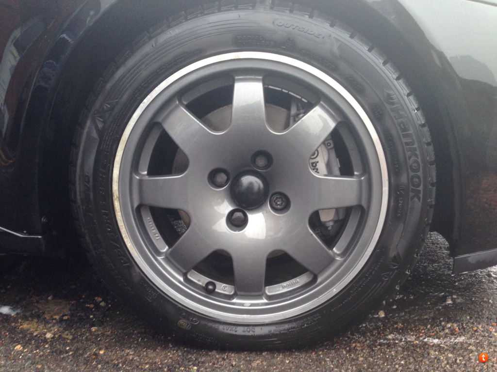

Awesome 182 mate & I'm not a fan of black cars, good choice on the brakes mine are spot on.

I fukcing love that, why no caps at the mo, get them on thereor is the trial shot the one black one so you need to find some paint
Also the Brembo 4 pots look well behind them George![]()

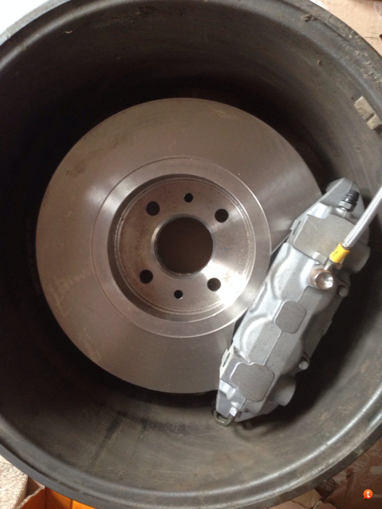

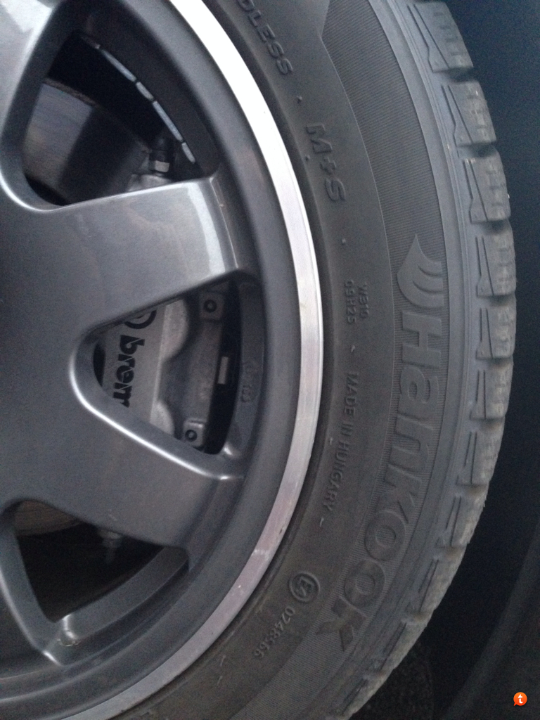

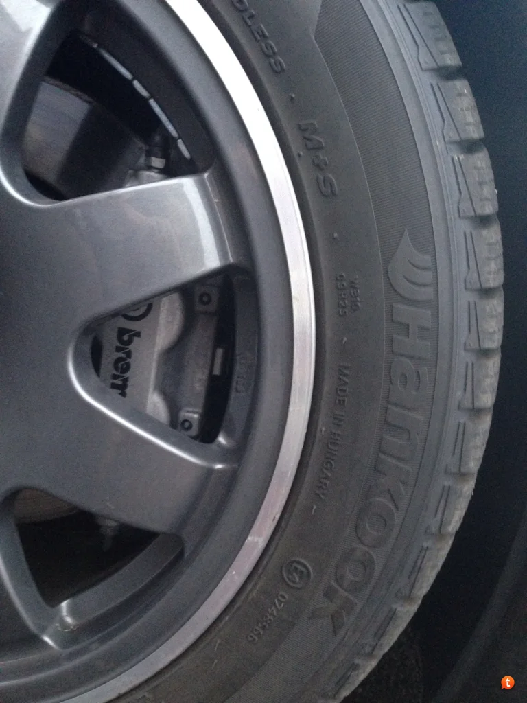

What spacers did you end up with George and any pics of the calliper mods? They look to have loads on meat on them to machine away for clearance but I was too scared to try lol.
Quote of the thread! Car looks great mate. A lot of clios getting boosted lately![]()
You'll get there, it does look like it would scrub bad front and back though when its lowered a bit.
No that's fine George I misunderstood you the other day as saying you had done some machining on the outside of the caliper to clear the spokes, not the inside that's needed to fit 280mm disks.
I am using 20mm spacers at the front which give plenty of clearance.
10mm spacers on the rear, but it's rubbing when the car is loaded up, so I need to swap down to 5mm, or 10mm with camber..
This picture shows the rear of the calliper and inside mounting holes from a distance.
I need to have the wheels off again in a few days, so I can get some better ones if you need?
197 calipers under 15" wheels???

The callipers have to be slightly modified to use the standard 280mm disc combined with some spacers = job done
