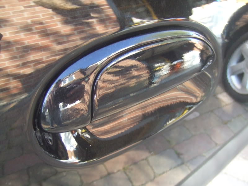

Got a pair of 2nd hand exterior handles and had a go at colour coding them.
Took a while to prep and get ready for primering and painting, but the final outcome is worth it i think.
The handles have a slight orange peel look in the pics where ive oversprayed abit too much. I learnt a lot about spraying whilst doing these and i cant wait to crack on with the side moudlings.

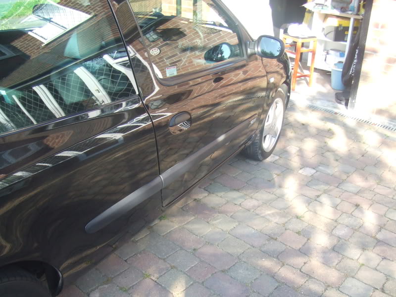

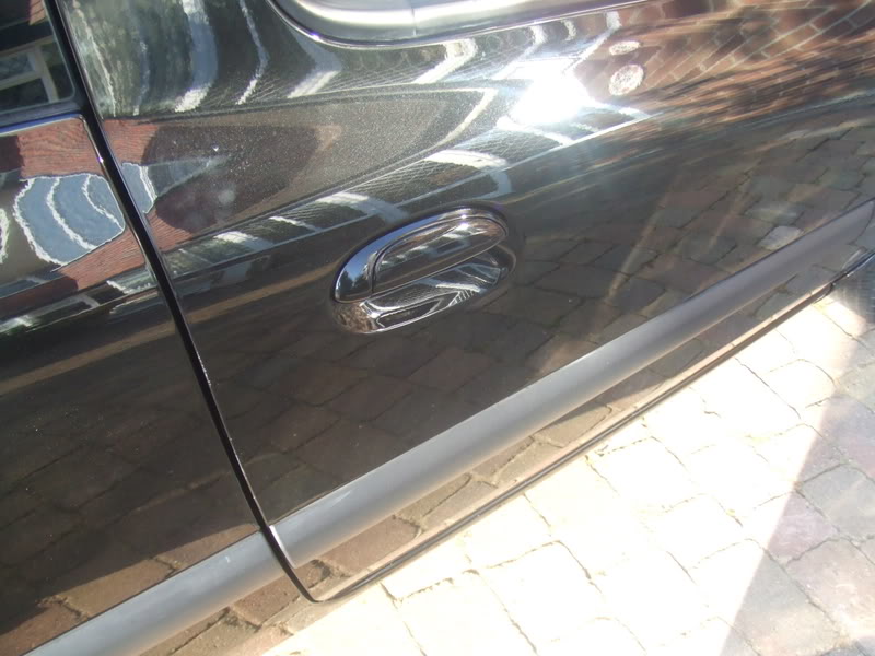

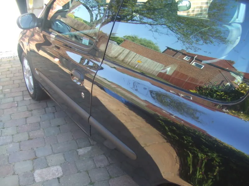

Before:
After:
Once the clear coat is dry in a week or two i will scratch X them and i think it will polish them up a lot more.
:) Comments welcome
