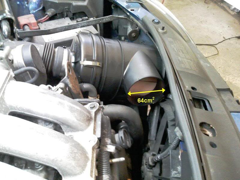

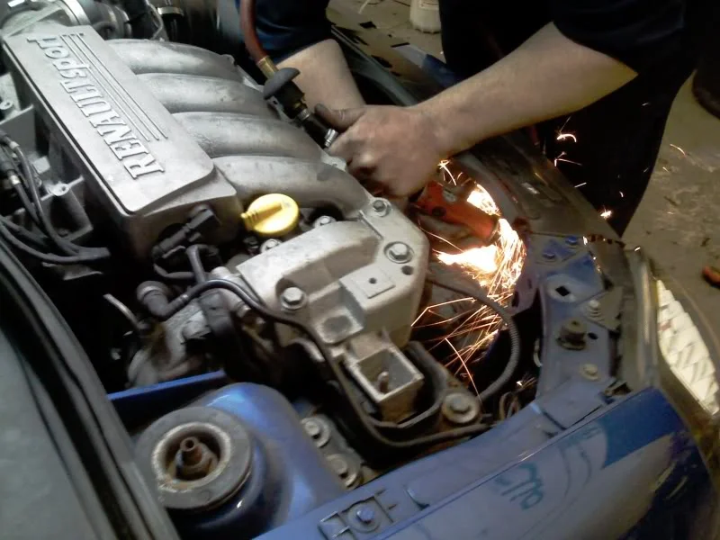

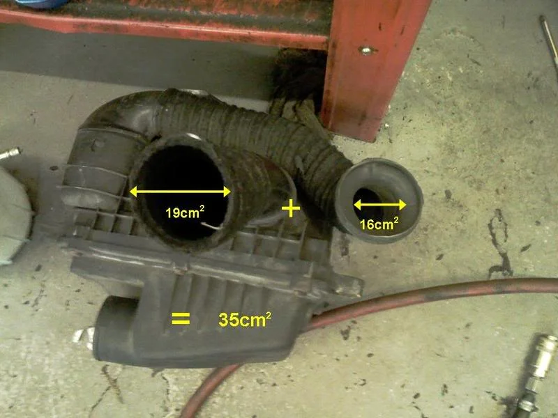

So, the afternoon started with Mike ripping this out...

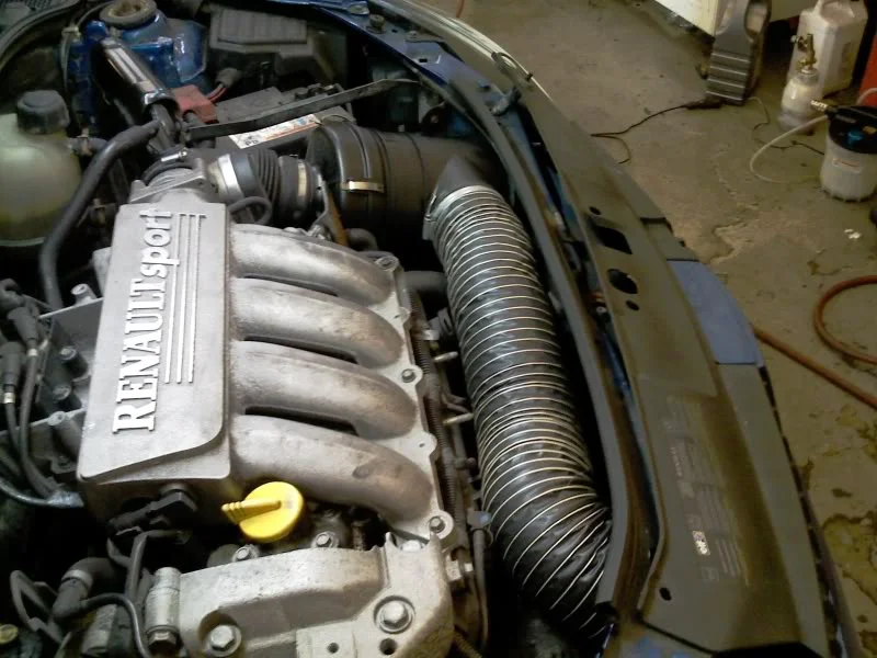

Then after a little jiggling about, this replaced it...
Then after a flurry of activity...
...and a little head scratching, I had this...
...which ends up here...

What did you have to grind out then?

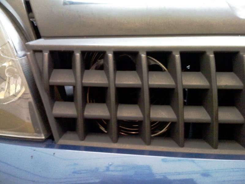

Surely thats going to encounter water issues? I know its not a daily drive but your going to get caught out somewhere along the line.
ForceIndia
  Gentlemans spec 200
How? It's level with the headlights, not the lower grill (which a lot of people use)? No more likely to get water problems than with standard.

could the box not be twisted to have the air intake on offisde headlight side where the std setup takes its feeds from?
although thinking about it there isnt much room down behind the headlight so maybe the 64mm pipe wouldnt go down there.

Air feed after the filter into the bend is 39cm2 in area, but the standard airbox only has a feed in before the filter of 35cm2.
Routing it this way means I've got a full 64cm2 to suck through and feed the filter...so theoretically, the engine can/will make more use of the 39cm2 available through the bend.
Ram air effect? I've no idea...it might give turbulence in the bend causing negative pressure? Anyone in the know able to comment?
Well surely water will enter and run down the pipe and also the alternator rain guard has obviously been removed so the alternator is open to water now.
ForceIndia
  Gentlemans spec 200
Do you not think water could enter the standard pipe? The only thing removed was a bolt which was cut down?
  ValverInBits
I think it'll be fine. If water does get as far as the filter box, which i can't see, it'll just sit in the bottom and evaporate out soon enough
As Point8 already said, I would expect any water to turn to vapour pretty quickly when running.

Can you not take out the paper filter and fit a cone filter? Will give you that bit of noise you're after too...
  M2 Competition
If you want more noise disconnect the end of the caf from the airbox, so its pointing at it, rather than attatched.
