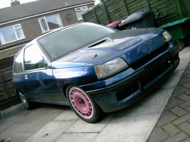

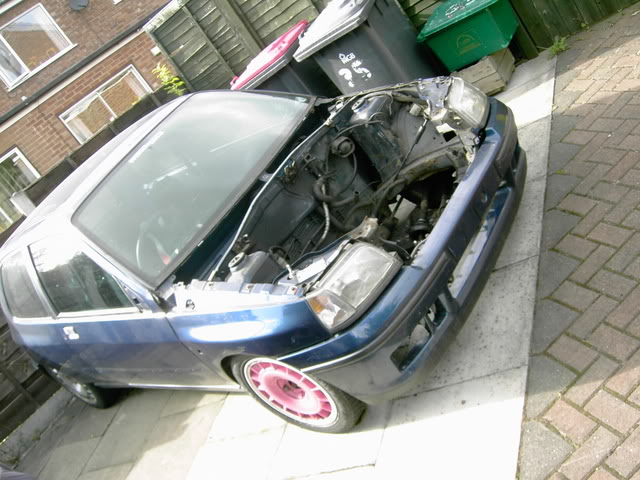

illy as he is now...after loosing his engine and gearbox
Plans!!!
Body wise.... Rid it of rust, carbon and fibre glass panels, polycarbs, cage - Respray

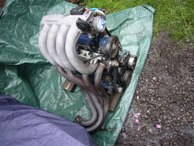

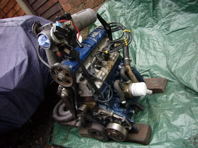

A 175bhp Formula Renault F3R 2.0L 8V :lol: ...Lucky for us Paul (ebay guy) was looking for a 172 engine for his Formula Renault... so we have come to a deal and go to Devon next weekend

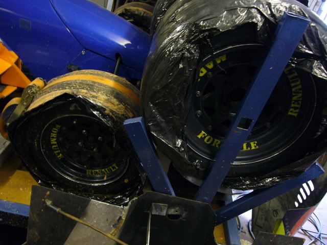

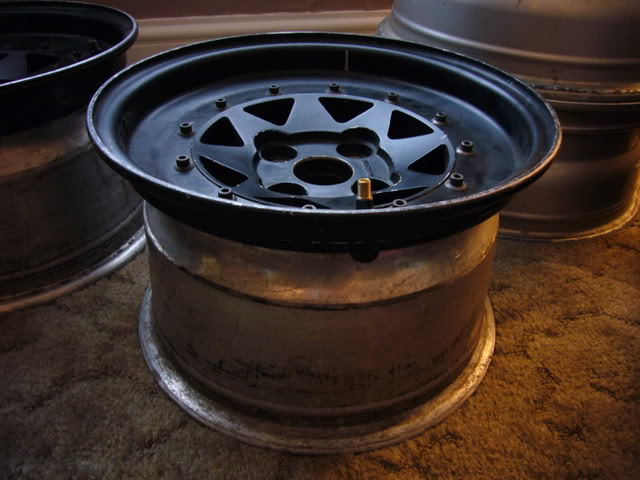

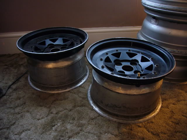

Paul has also got 2x Spare Formula Renault Mad'in 8x13 split rims for us.... 2 down... 2 to go lol

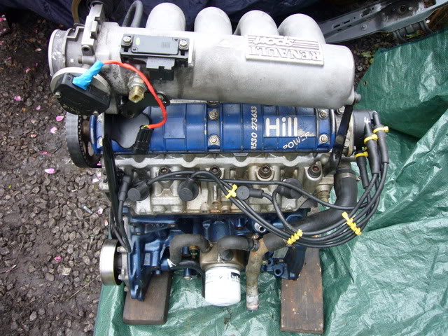

Results from yesterdays 650mile round trip :)

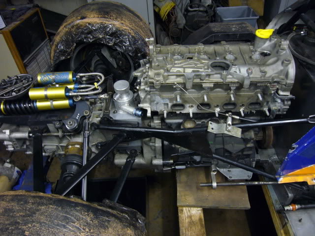

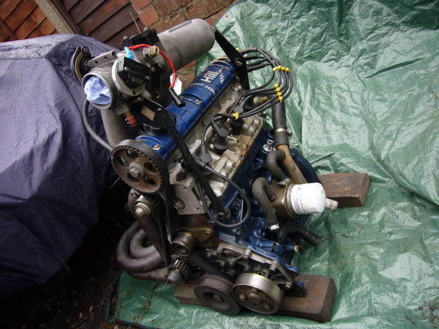

Engine
Rims

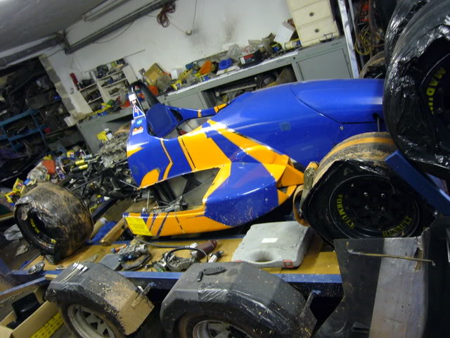

Donar car with new F4R in place

Whats the height of that engine with the inlet fitted?
On the f3 car its not an issue, but in the clio its going to clear the bonnet by a few inches surely? Very cool tho!

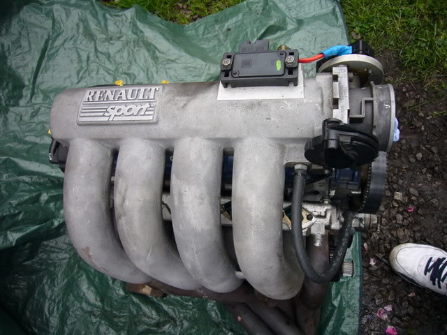

Massive inlet manifold, wil it fit under the bonnet? Block looks similar to the volvo 480 turbo. Will be good to see this when its done.

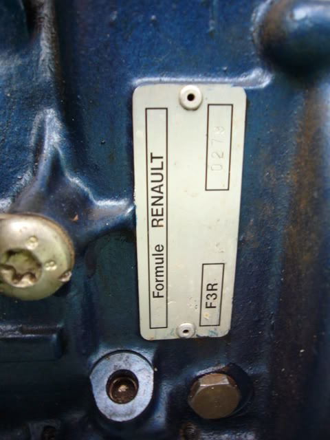

i never knew renaultsport did a 2L 8v !?
whats the rev range of the thing.
if you wanted to be different why didnt you source a Mivec or even a Vtec-i
Pass on rev limit

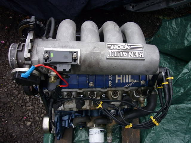

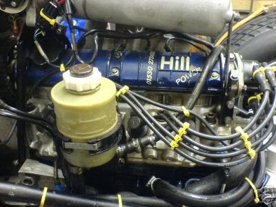

Engine

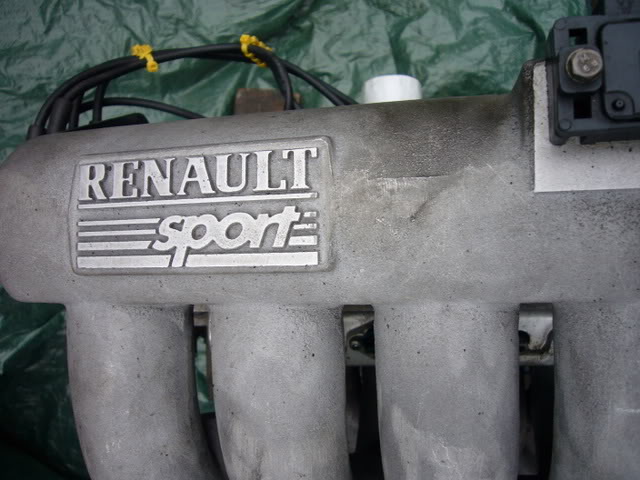

1998cc Renault F3R FRS engine. The engines have been modified to give around 175BHP via a remapped and sealed ECU and special Renault Sport camshaft/pistons etc.
:approve:
Superb! Nice to see N.D.Hill has his name on it... He just gets on with building race engines rather than talking about it.,,,
Can't wait to see what periscope arrangement you come up with for seeing over the inlet manifold. lol
