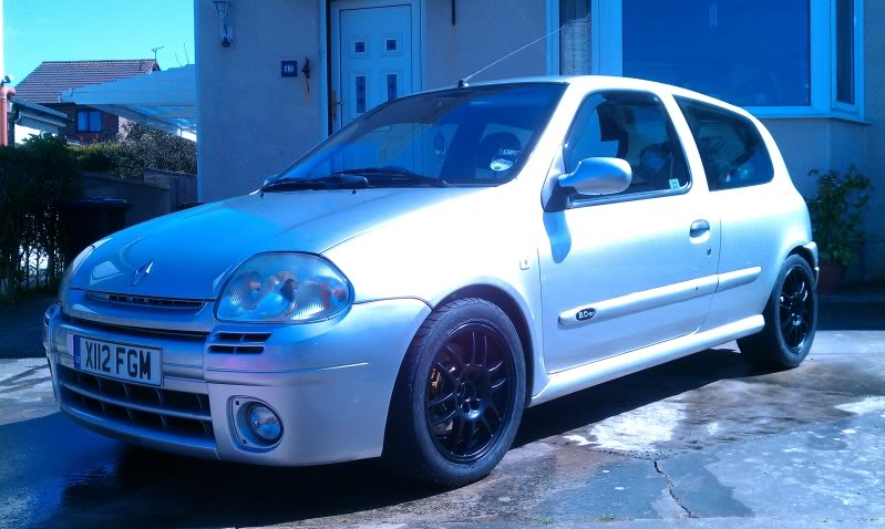

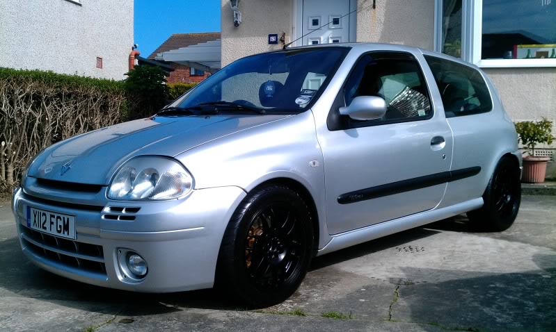

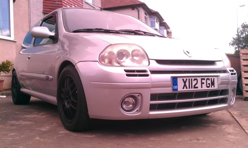

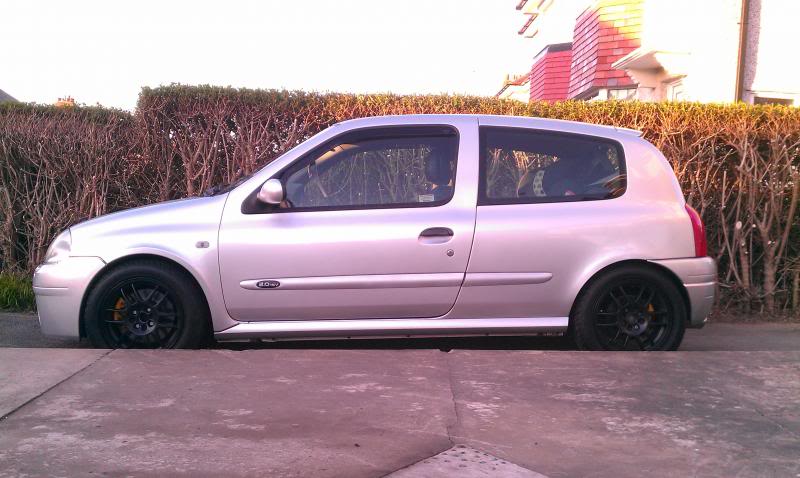

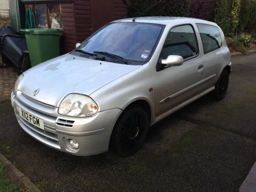

Well a couple of months later I've decided to get a few pictures up.
The daily Focarse is black with silver wheels and the Clio is silver with black wheels!

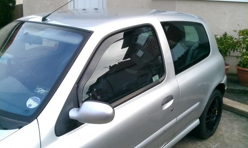

First mod I did was some wind deflectors.

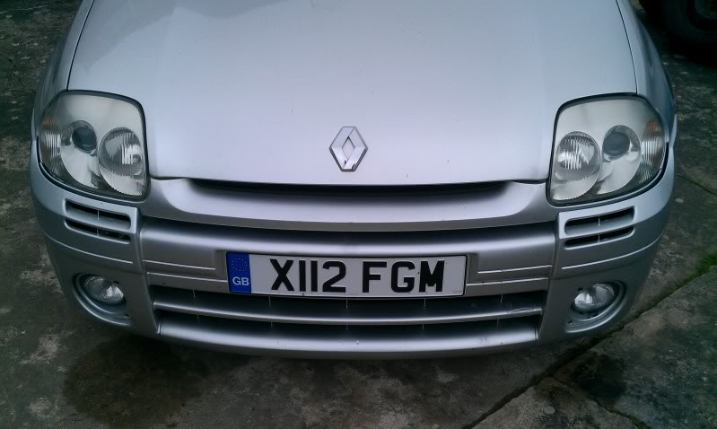

Gave it a quick wash and got some clear indicators and a set of pressed plates from Dubmeister.

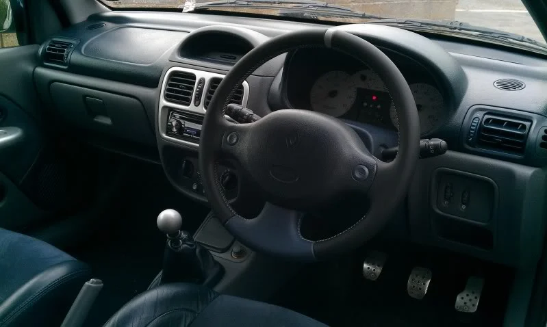

On the inside I'm going to leave it be unless in a couple of years it ends up a track ****. So for the time being I tidied it up with a retrimmed wheel from Snappy.
Then got a bargain from Halfords in the form of a Kenwood BT42U, does bluetooth, USB, aux etc.

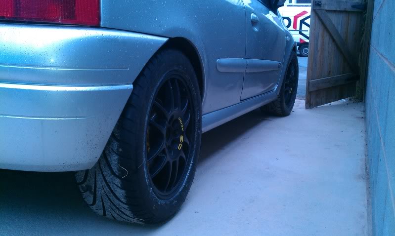

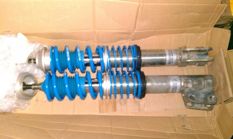

I was after some lows so I bought a low milage Bilstein B14 kit but after using it for a short while and reading about refurbs I thought about getting something more suitable. More on that later.

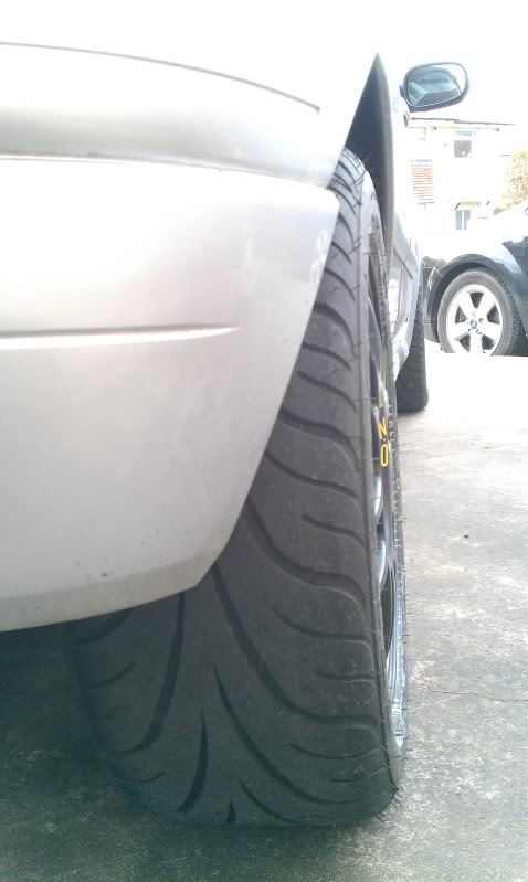

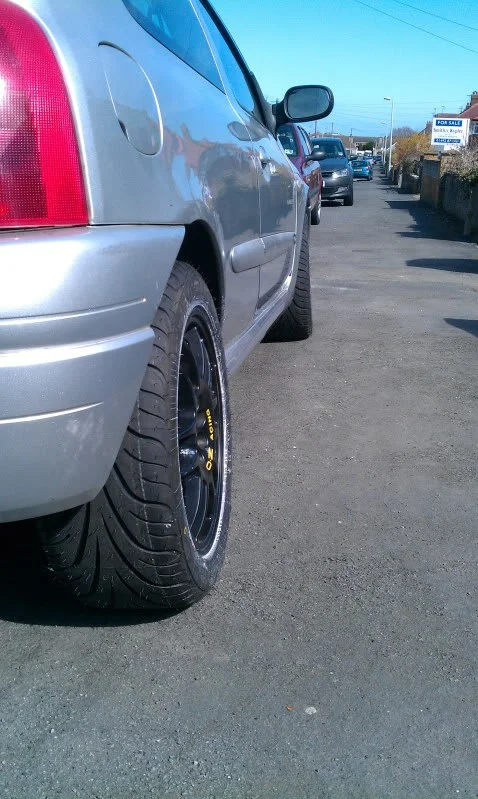

The car came with GT Radial Champiro tyres in 195/50-R15 which went in favour of some Federal 595 RS-R 205/50-R15

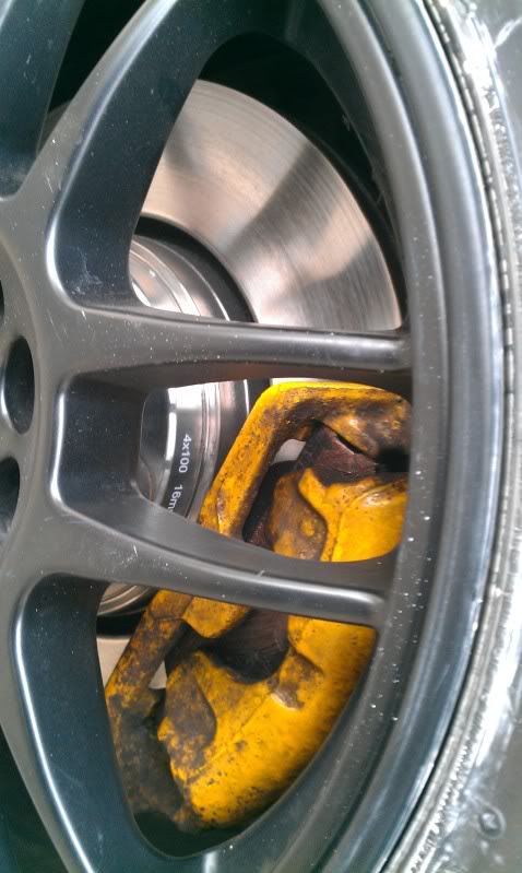

The brakes were changed for some Brembo HC discs with DS2500 565H pads, they didn't need any modifying to fit either :) whilst I did these I added some 16mm front spacers and 5mm rear spacers to get the wheels filling the arches a bit better without scrubbing issues.

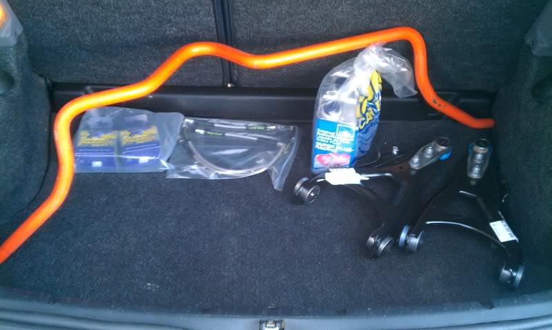

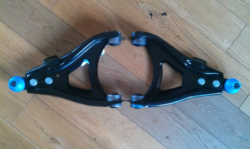

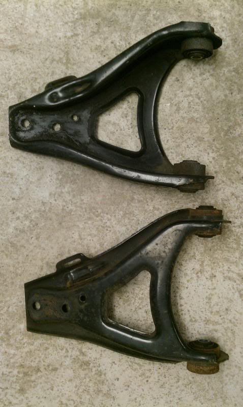

I ordered polybushes from Kam Racing but they sent 23mm outer bushes rather than 22mm. So I bought a complete front 182 Cup setup off ebay for cheap. ARB is going on but the wishbones were standard :( so I ordered a new pair of Cup wishbones from Renault which are the right ones.
So the wishbones are being fitted by a friend at a local garage along with braided lines, ATE blue fluid and some Cooksport springs with nearly new Cup shocks and top mounts.
I'll get the car back tomorrow and a couple of photos when its settled.

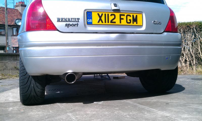

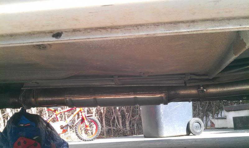

On the engine side of things the first jobs were to replace the knackered dogbone and exhaust hanger.
The standard exhaust sounded like it had died inside so I replaced it with a Ktec recessed system, I'm undecided on cutting the bumper yet as I fancy a smaller tailpipe or even weld a 90 deg. bend on there.

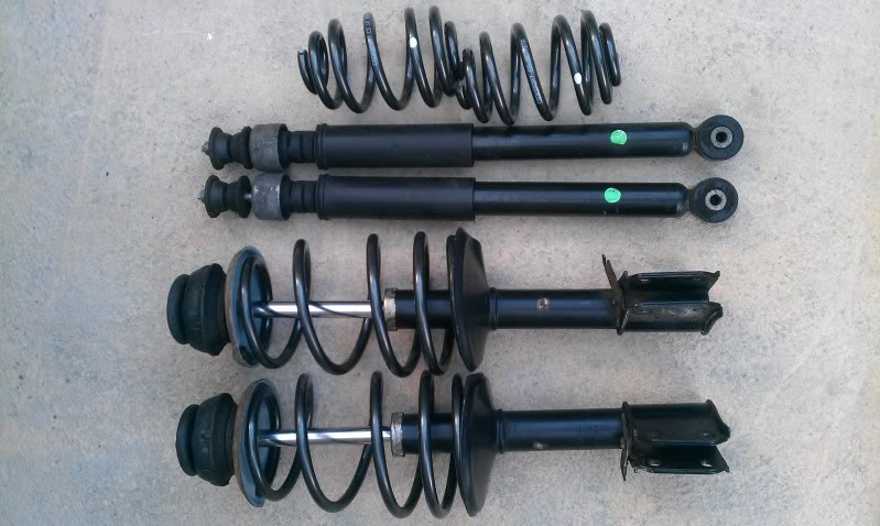

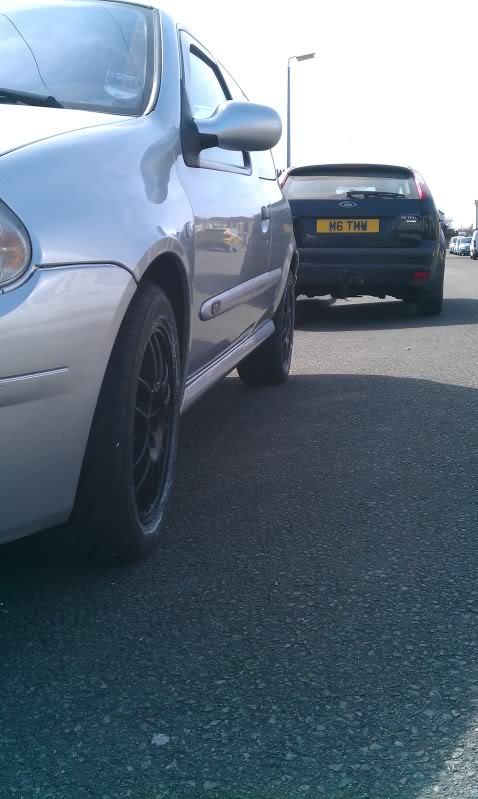

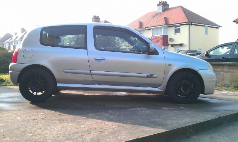

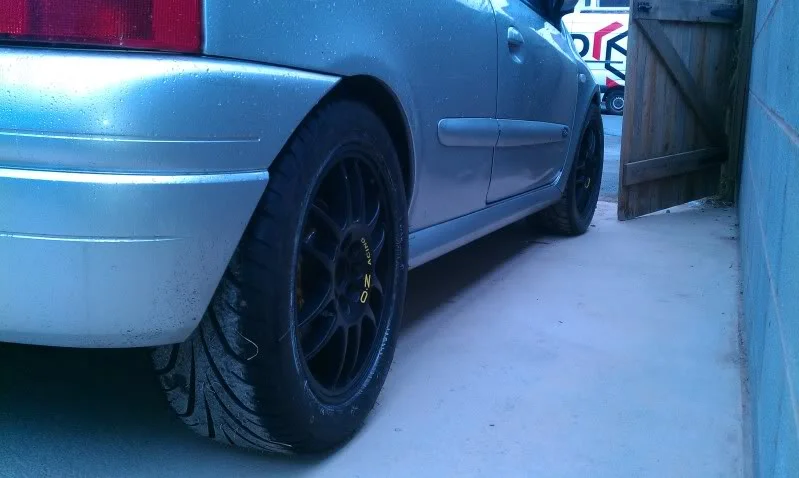

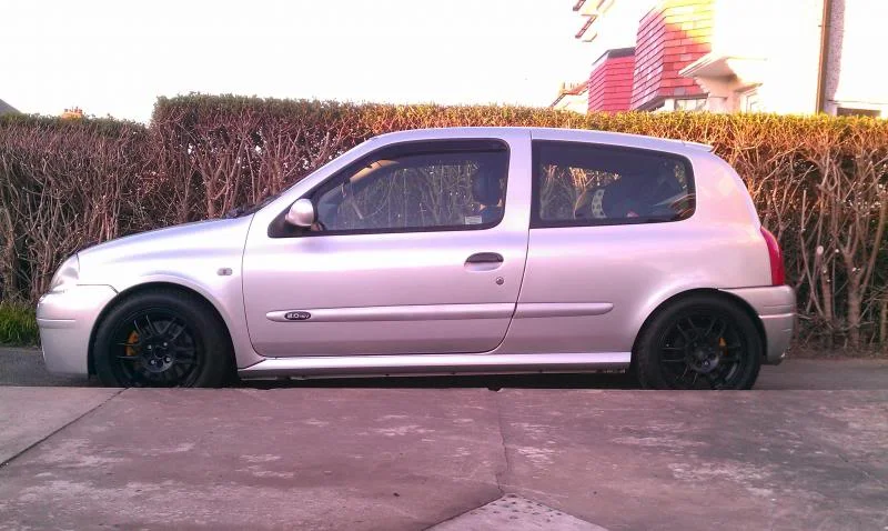

I'll take a couple of better photos of the car on its new suspension this weekend but you can see the arch gaps. Spot on IMO.

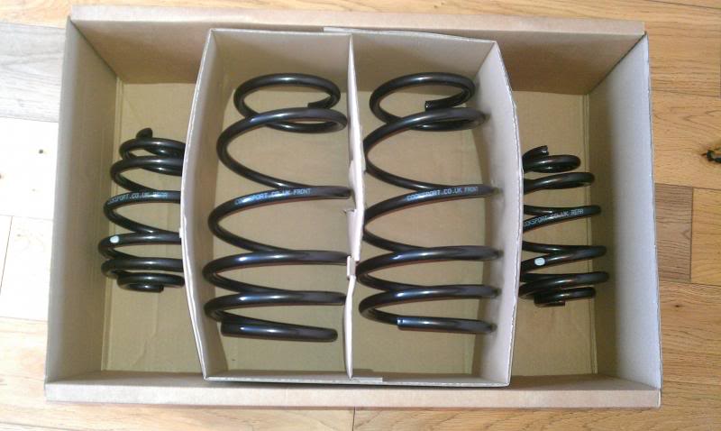

The springs are a credit to Josh at Cooksport. They ride really well and feel great. They are fitted along with Cup shocks and Cup wishbones so whether that makes much difference I don't know but it feels a different car now.

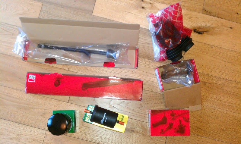

Also bought a load of parts to freshen up the steering, still need to order the rack bushes from Renault. Going to do the filters too and order some 5w50 oil for tracking it this year.

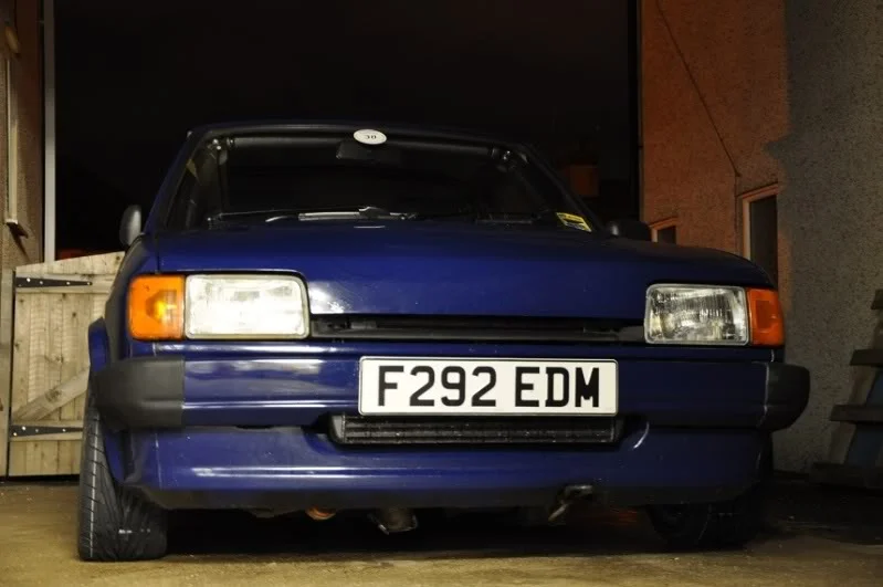

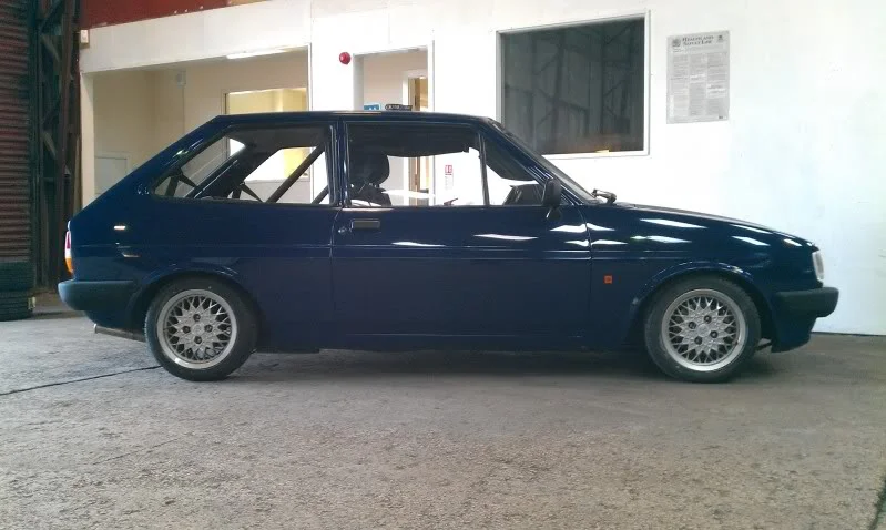

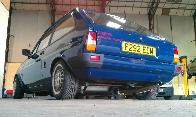

Yeah the Fiesta was a bit of a head turner!
This was it at Oulton last year, its the 2nd one going past.

Took it out for a good drive on Saturday, still very impressed with the cooksport springs on the cup shocks and wishbones. Only issue is the tyres catching the arch liners on full lock.
Then gave it a polish and wax. The springs have settled a bit more now too.

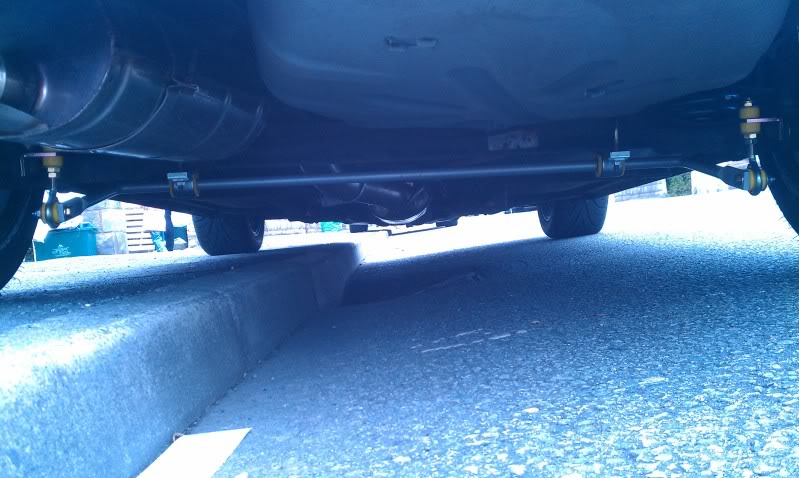

Did a remap on it about 10 days ago. Definitely noticing the difference, a little more torque down low so it feels smoother all the way to the much higher redline.
Got the Whiteline RARB on today. Back end feels a bit more planted. Its set to soft right now but I might set it to hard on track days.

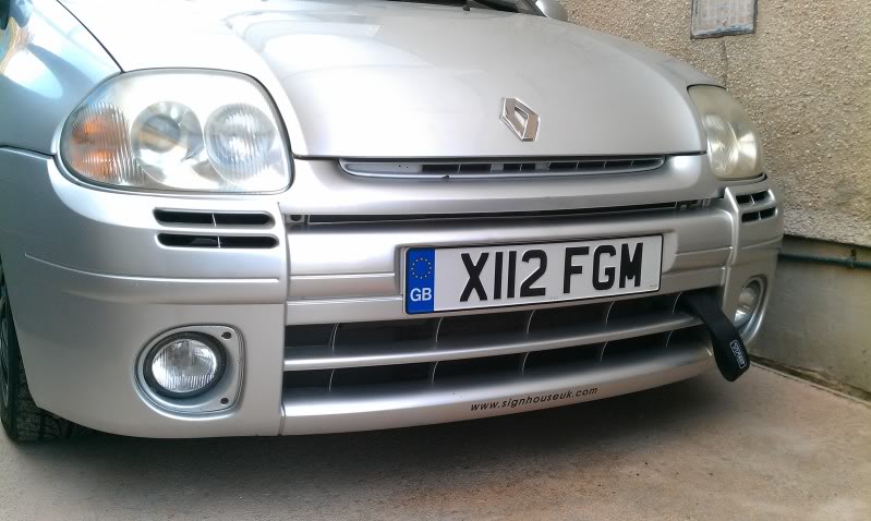

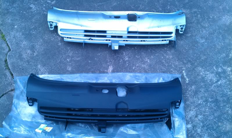

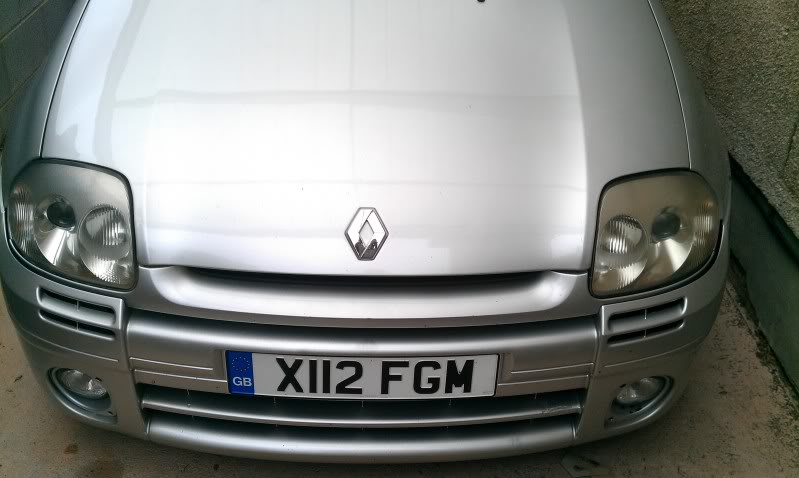

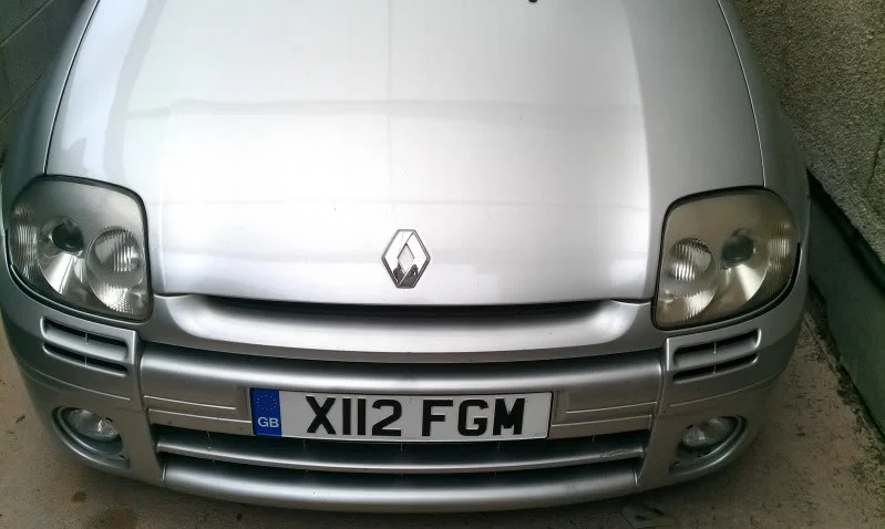

Got rid of the horrible grille today and removed an old sticker off the bumper.
yeecup
  mk8Fiesta ST,172 cup
Re: Ph1 172
Nice! Black side strips suit it with the black wheels. Also I'm envious of the lows, cooksports seem to drop them bit more than the eibachs iv got on mine

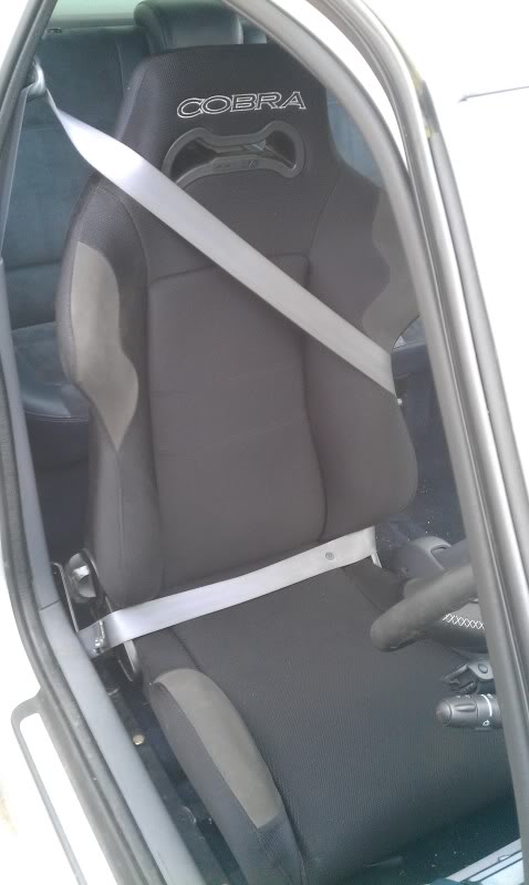

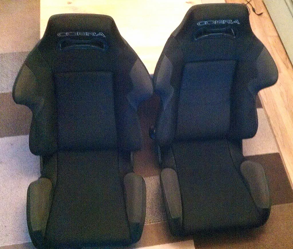

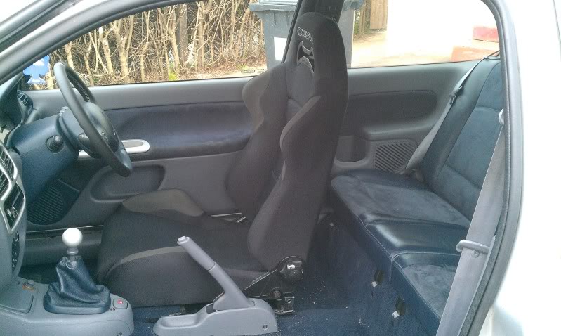

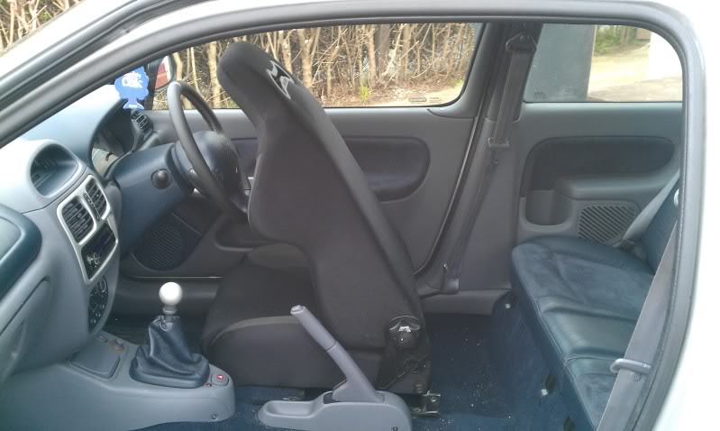

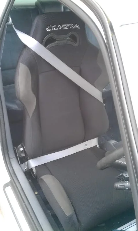

I picked up a mint pair of Cobra Daytonas today :) hoping to have the frames by the end of the week.
Grandpa Joe
Re: Ph1 172
I tried one of the Cobras but it sat further back than the standard seats which is no good with the little ones in the car so they got picked up yesterday. Shame really as they gave a great driving position and are very comfy. Put the drivers seat back in without the spacers though and it feels much better than it did before.

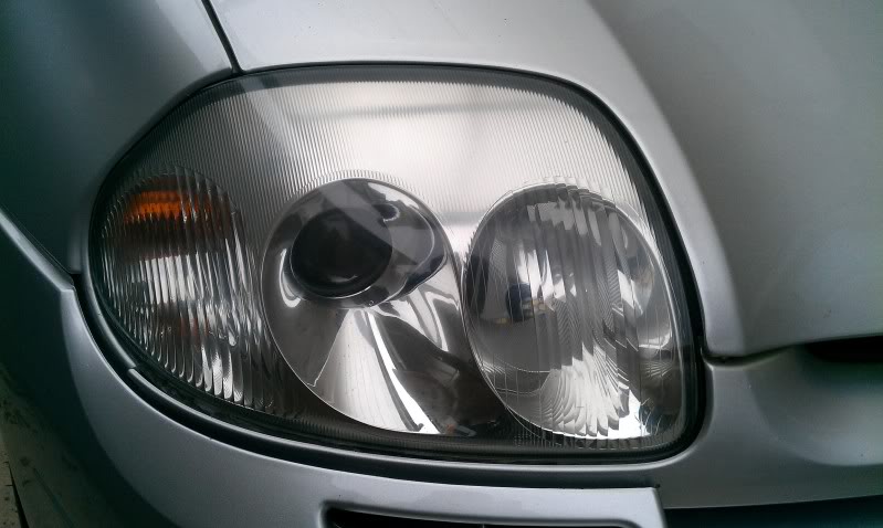

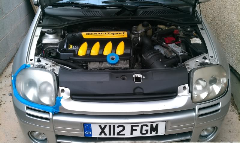

The headlights were looking a bit yellow and crazed so I decided to have a quick go on them. I had some 2500 wet&dry lying around and I bought a Megs headlight kit.
Taped up and OS light sanded
After polishing you can see the difference between OS and NS.
Both done
Close up :)
Refurbed the side strips in black and then gave it a good clean and a wax. I tried some Demon Shine spray on cleaner stuff, then cleaned it off with a Karcher. Very impressed!

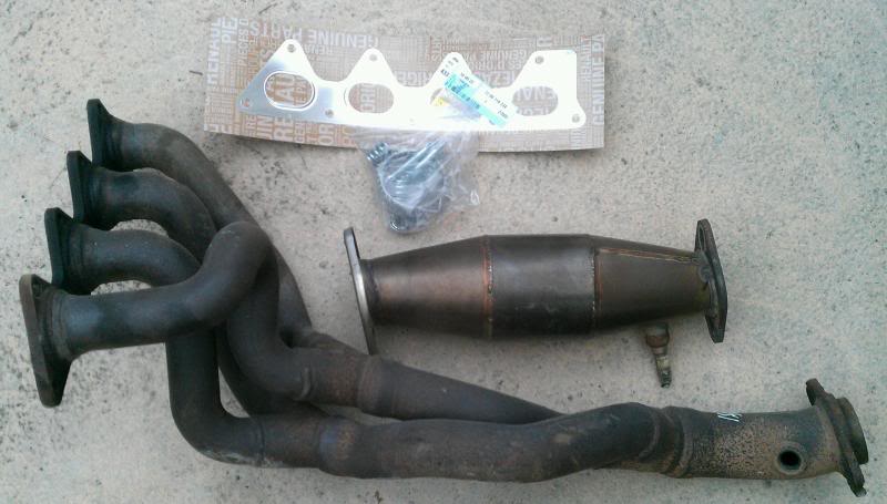

First is a 182 manifold and a Ktec link sports cat.

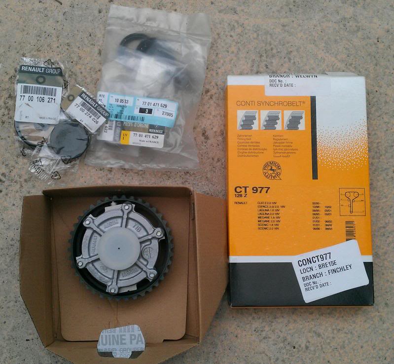

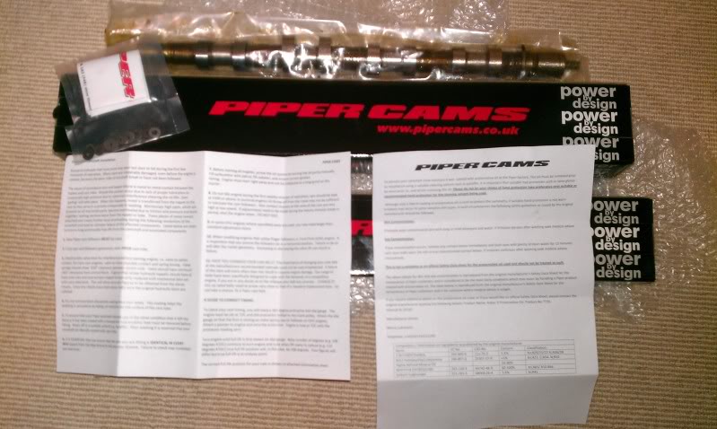

The Piper cams are going in along with a new belt, seals and dephaser. The rest of the belt kit was done 5k ago so just changing the belt.
All the tie rods etc. on page 1 are being done at the same time as some new rack bushes.

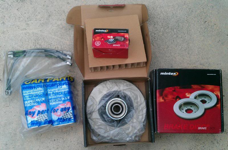

The rear brakes need doing so got the ones with bearings and ABS rings, the braided hoses and ATE blue fluid are being done too.

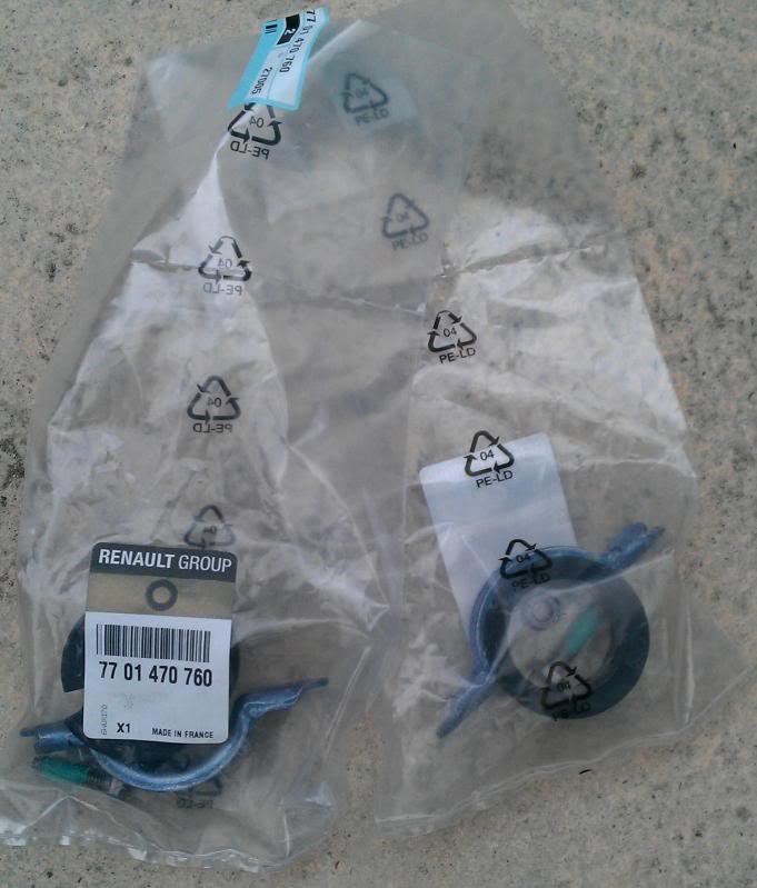

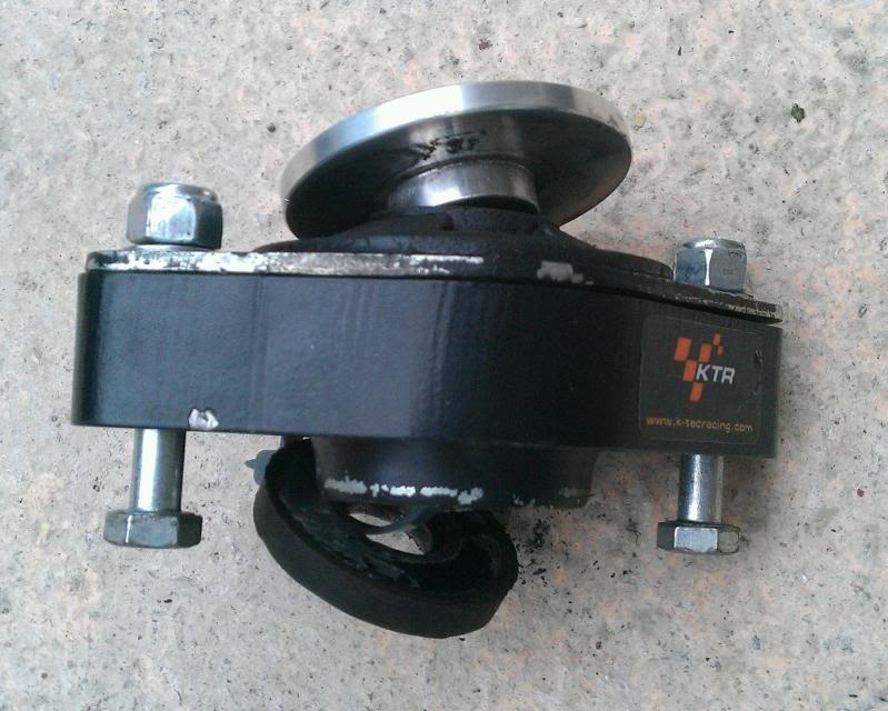

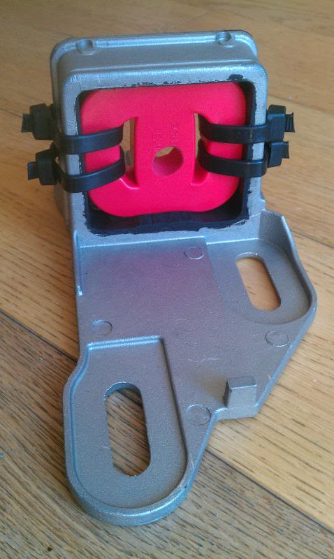

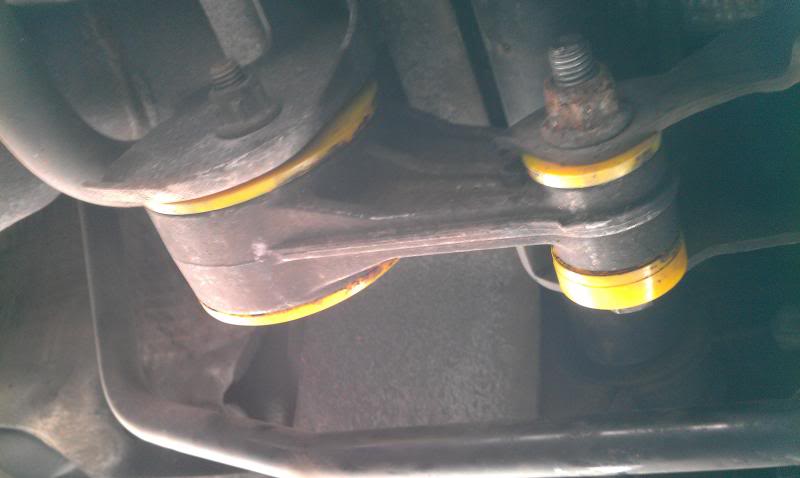

I think the gearbox mount has had it so fitting a Ktec/Vibratechnics mount. I got the engine mount too but I'm going to leave that for now as its not long had a new genuine Renault one fitted.

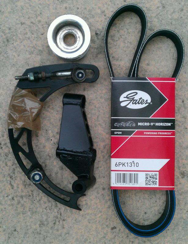

The AC is being removed, not sure if I'll regret this or not. It's being replaced with a Pure Motorsport kit.

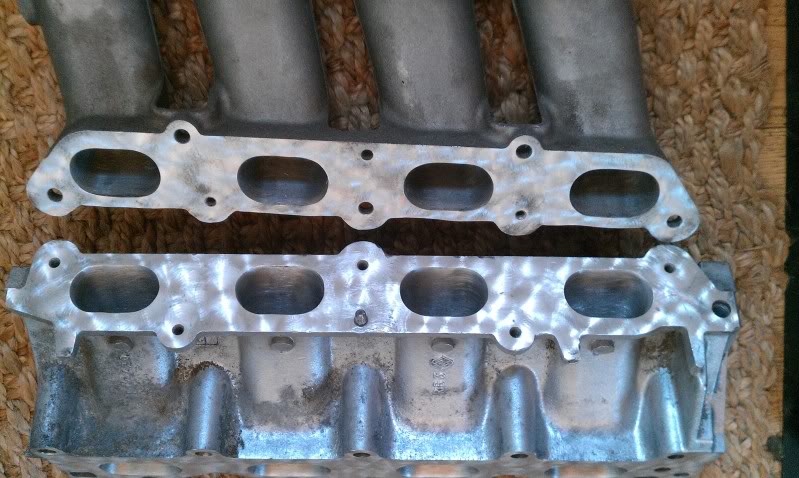

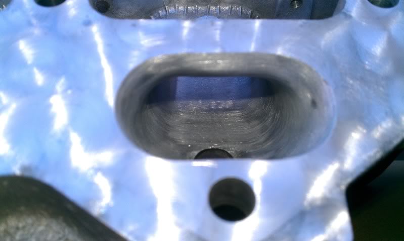

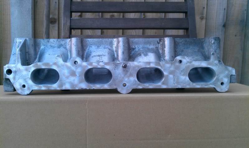

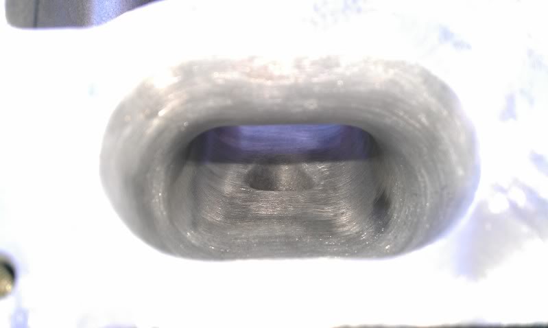

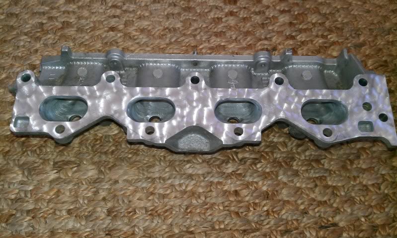

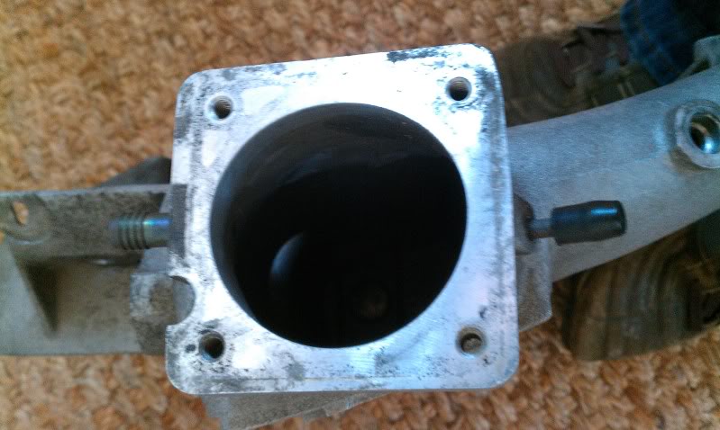

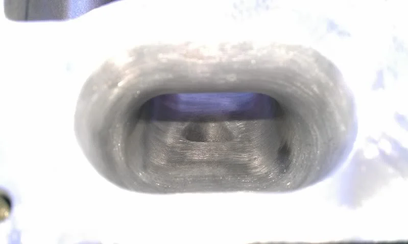

Got my inlet today from ALDevelopments. Pictures hardly do it any justice. Ports matched to Renault gaskets, throttle body area smoothed and mating faces machined.
Price is £150 including delivery for those interested.[
