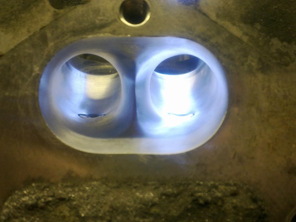

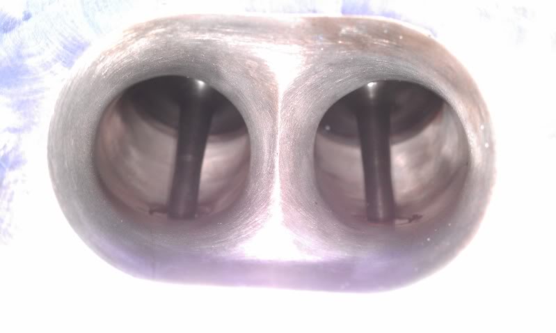

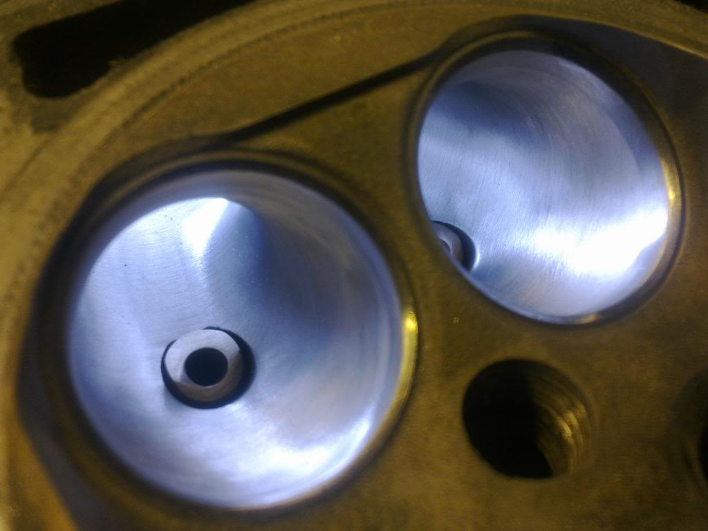

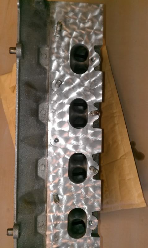

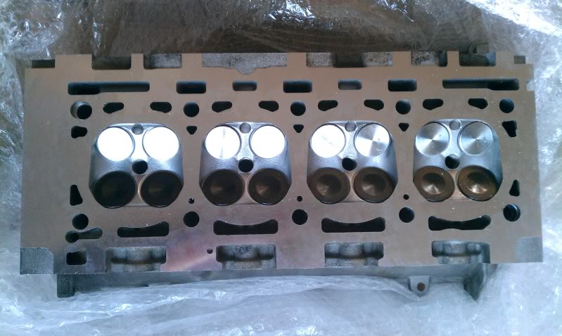

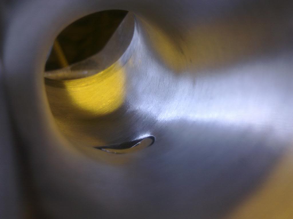

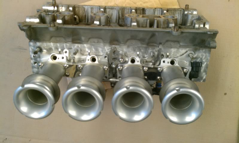

Some of the headwork in progress :)

  A special one.
Re: Ph1 172
Ohhhhh, some money being put into this mate.
Great work so far and im glade your keeping it. :)

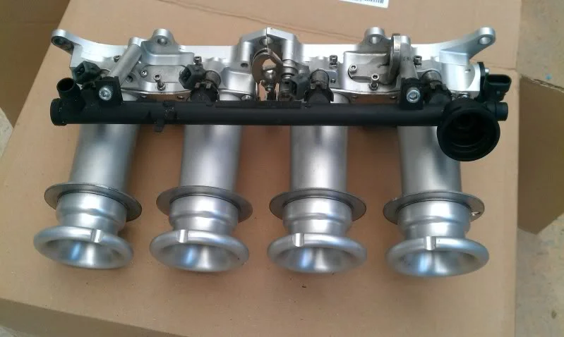

Bring on the trumpets :) Given them a clean and now they are going into storage for a while

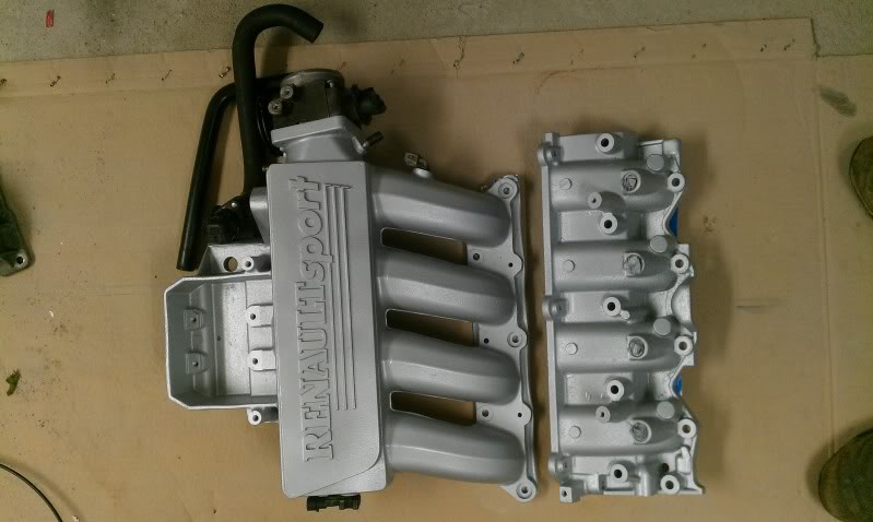

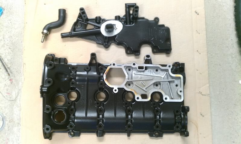

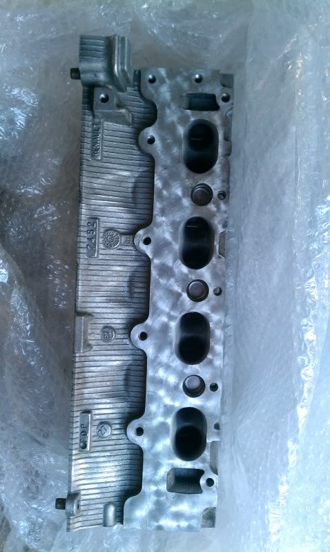

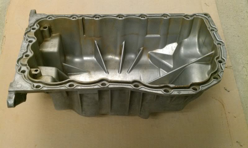

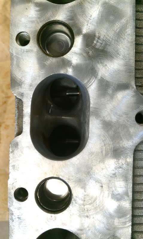

Head should be here tomorrow :) so in preparation for the engine going back together I painted the rocker cover, breather and matched inlets. Also cleaned the sump.

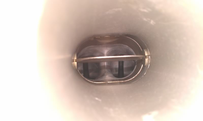

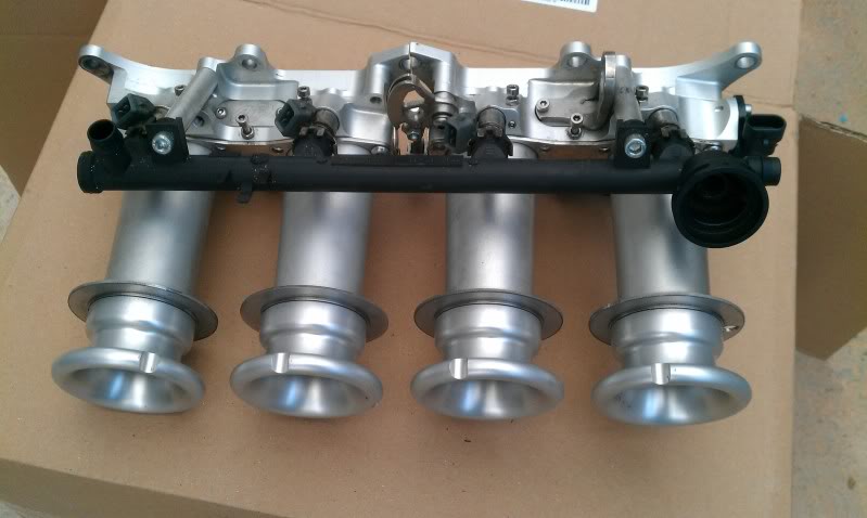

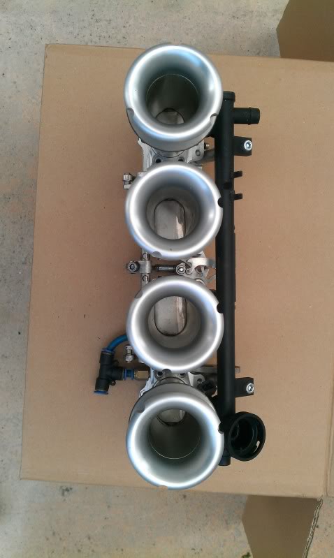

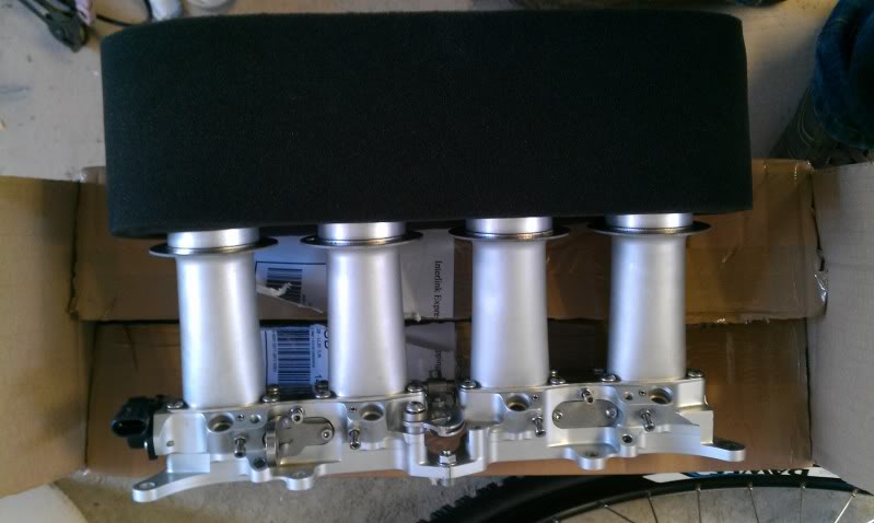

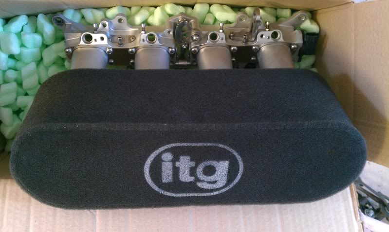

I got my ITBs back from AT Power. They've had a full service, balance and new throttle plates and layshaft assembly :D Cleaned and oiled the ITG filter for the ITBs but I'm worried that it's a bit deep for a Ph1, I guess I'll have to try it first.

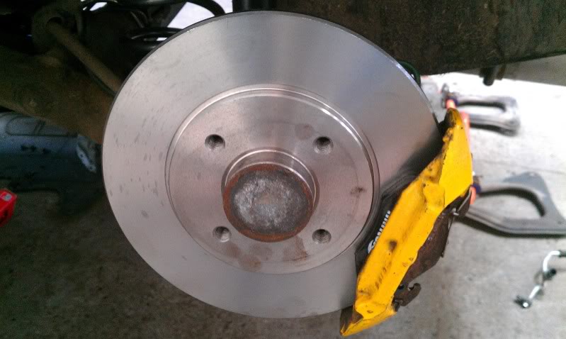

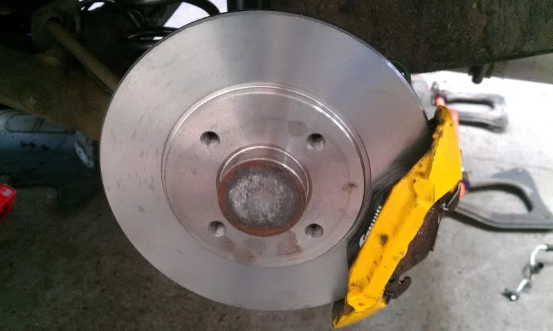

Went down to the garage on Saturday. Rear discs, pads and bearings are done, along with the braided lines and ATE Super Blue fluid.

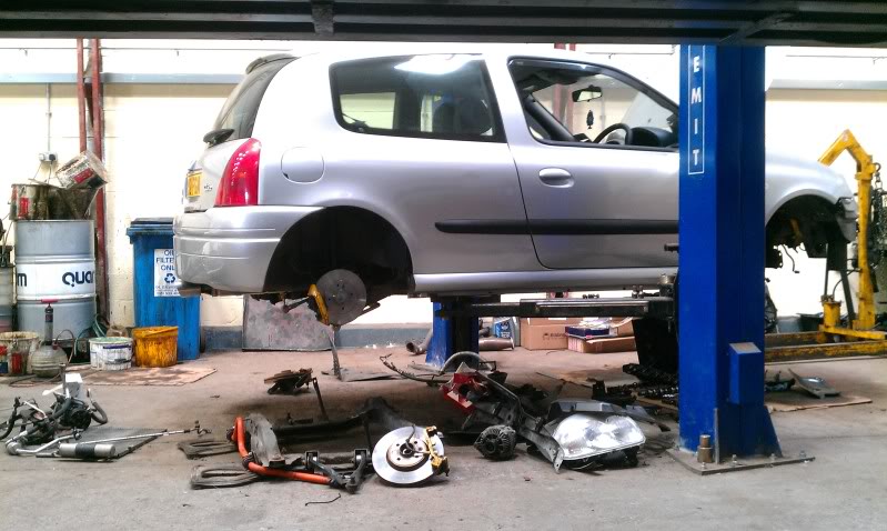

Car is looking like this at the moment :(

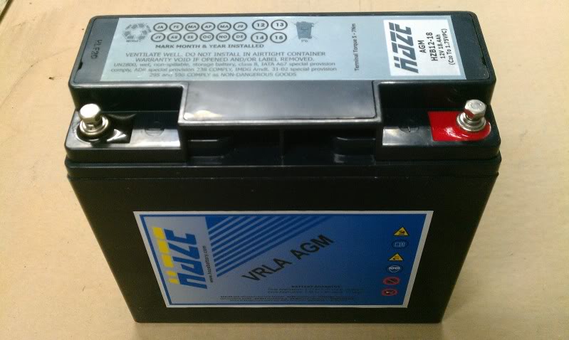

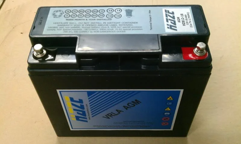

And my battery turned up, nothing of it! Going to go to Maplin sometime to get a solar trickle charger to keep in the car. I ordered a cage and wiring to put it under the passenger seat so before I get the ITBs fitted I might relocate the air filter.

Not the best pictures, could have done with better lighting.
And with the ITBs :D

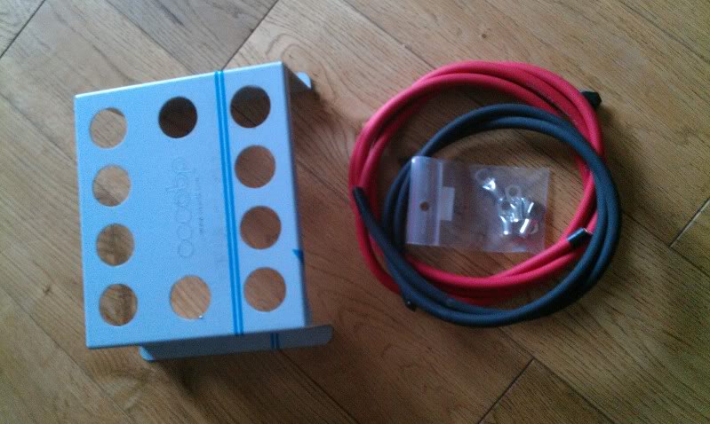

Got the bits to put the battery under the passenger seat.

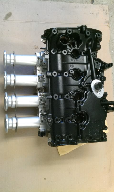

Engine is back together, forgot to get a picture of it whilst I was at the garage. I'll get one soon.

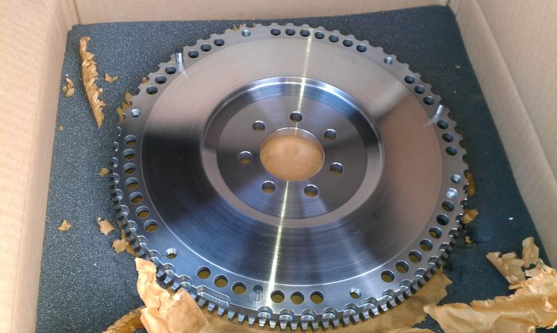

Engine is ready to drop in more or less. New crank seal, billet flywheel, clutch and box to bolt on then it can go in with the 182 manifold :)
