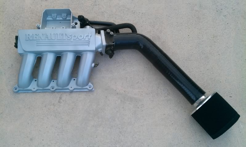

Bought an ITG filter and some hose. I'll trim it to suit to get it as long as possible behind the headlight.

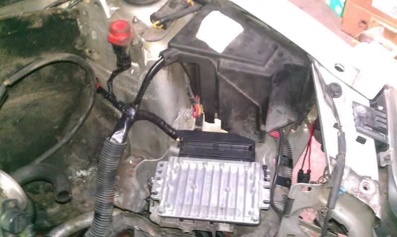

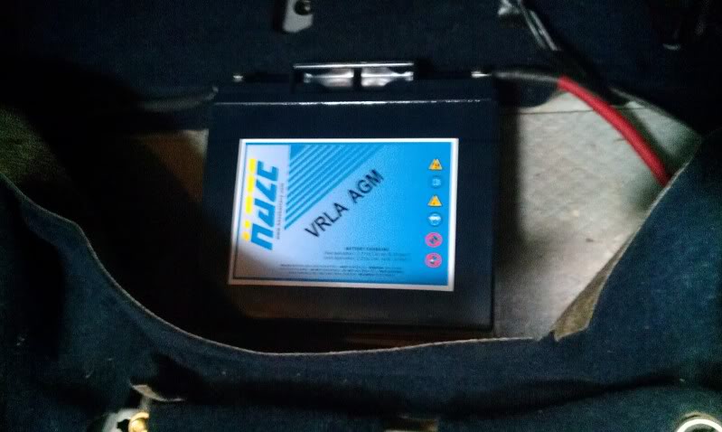

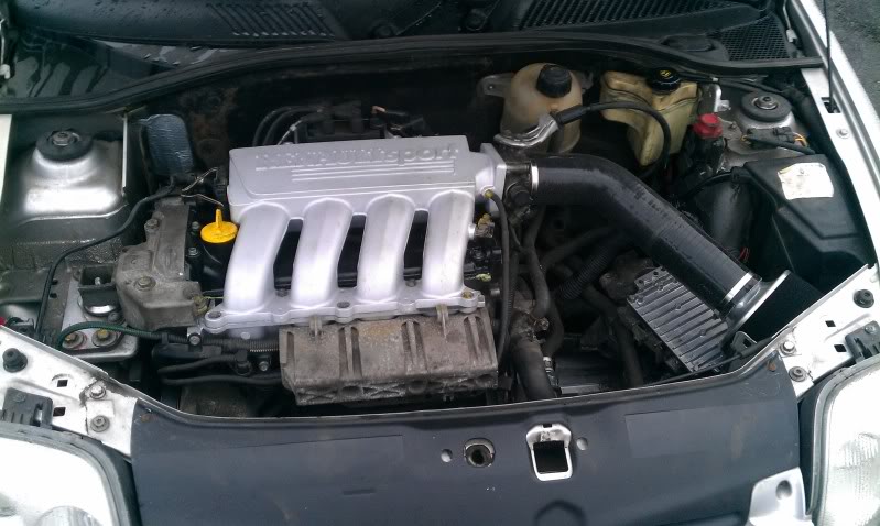

It runs again! All it needs is the subframe bolting back on and the radiator, hoses and front end reattaching. Very happy it runs ok though!Moved the ECU and tidied up the wiring for the new battery
New battery

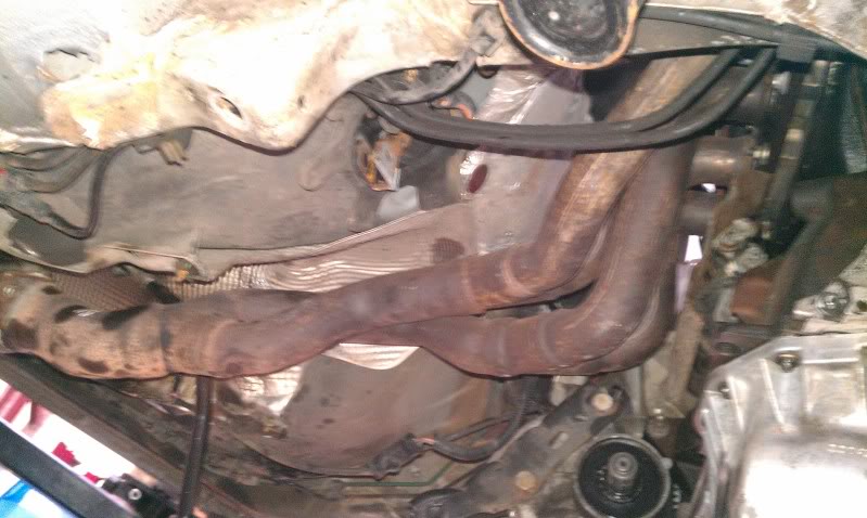

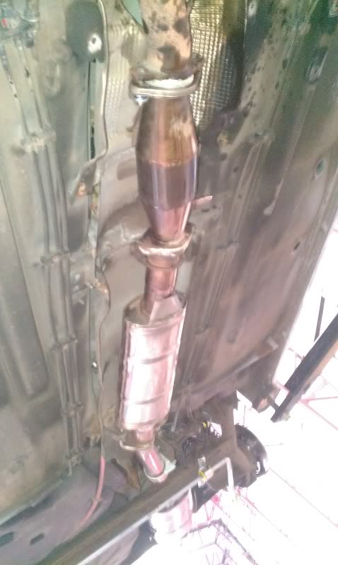

182 manifold and ktec sports cat, fits nicely.
More photos tomorrow hopefully!

Here's the new filter setup. I'm going to remove the fuel rail guard rather than paint it. Need to paint the belt cover sometime.

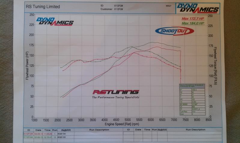

No, fueling with the fastchip map was fine. Paul has increased the ignition advance and sorted the fueling to suit.

not massive figures for a lot of ££££ is it? as long as it drives well though.
Re: Ph1 172
No, but the figures are more realistic than most ;)
And my only real expense on modifications are the ported inlets, cams, 4-2-1 and sports cat, so £600 for them isn't too bad. The head is so well priced and has been reconditioned with supertech valves and new seals and the engine is nice and fresh I wouldn't really call that expensive.

I guess a standard PH1 would only be around the 165 mark, I bet its so much better to drive though?
And if you fit body's then the ground work is already done.
Re: Ph1 172
Yeah I'd have expected about 160-165 as standard. So about 20bhp for the mods I've done is bang on the money IMO.
Say 5bhp for the inlets and filter, 10bhp for the cams, 5bhp for the exhaust and sports cat. The headwork won't have increased the power output but it will have helped the torque figure.

What was the torque figure tom, as you expected/hoped for?
Re: Ph1 172
Yes it has :) well, safer than the standard valves anyway!
173lb/ft, can't grumble at that. I was hoping for 160lb/ft and it does over 160 from 4500-6000 so very happy with that. I can't tell you how it goes though :( I haven't taken it over 3500!

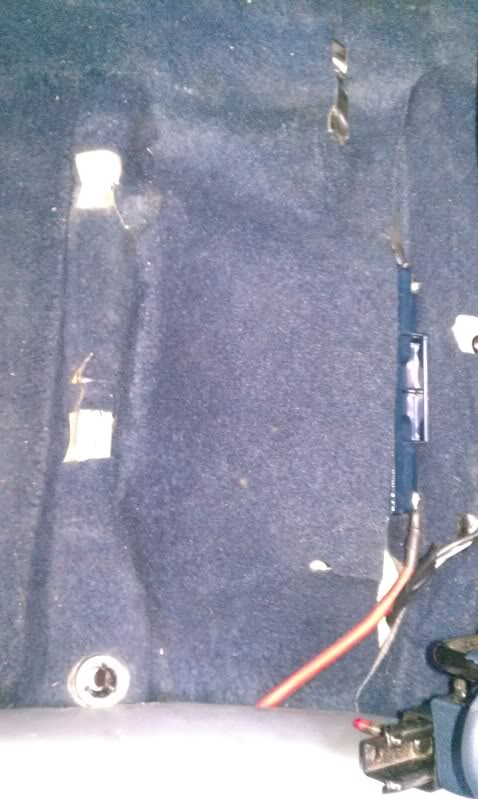

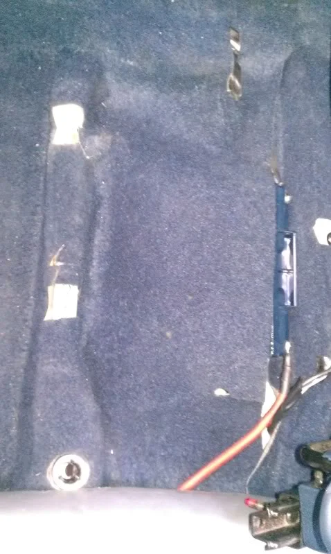

Making a start on getting the track seats in. Bought a pair of OMP subframes and I marked them off after a long day, needless to say I drilled the holes in the wrong place... should have double checked!
Anyway the seats are fitted to them now so hopefully by the end of this week I'll have them fitted and the harnesses in for the trackday on the 23rd.
Re: Ph1 172
Not had a chance to fit the seats, and nowhere to do it either at the moment :|

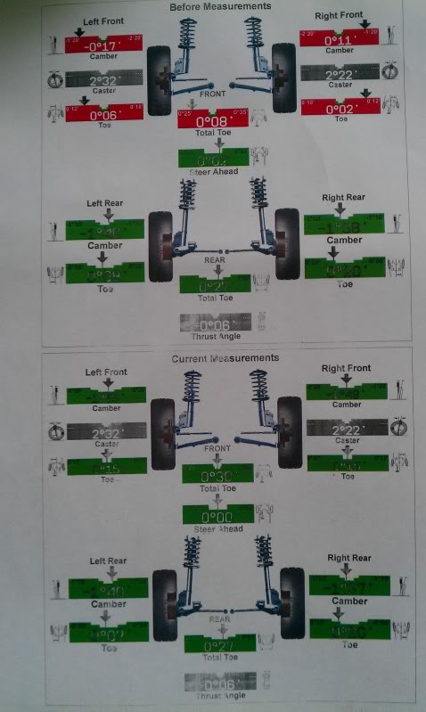

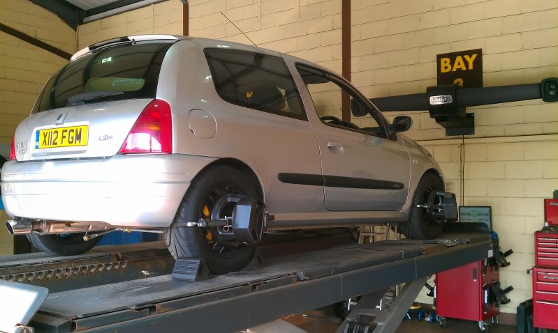

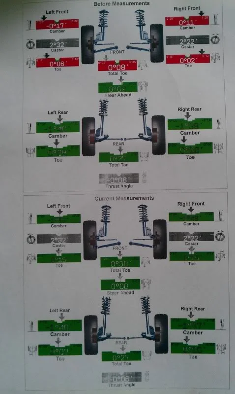

I did get a chance to swing by Buckley tyres and have the camber bolts set up though.
The most I could get on the drivers side was 1 degree 50 minutes (1.83 deg. decimal) so the passenger side was set to that too with a bit of toe in.
I was also expecting more than 2.5 degrees of caster with the standard ph1 subframe and the cup wishbones (yes they are definitely cup wishbones). Although the guy did say the wheels were very close to the front arch liner/bumper and could get a proper measurement, so maybe it is more than 2.5.
Anyway it drives much better now its all setup. Long term I'll get some adjustable top mounts for more adjustment.
