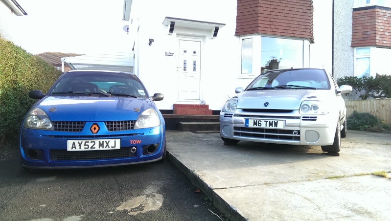

At home together
  RenaultSport 172
I have checked my ph1 and it's really bad! What do I do? Drive it til it falls apart then break it?
I assume the cost of fixing is way more than the car with worth?
Nice to see you have a blue and silver clio sat together. Lol.

Grandpa Joe
