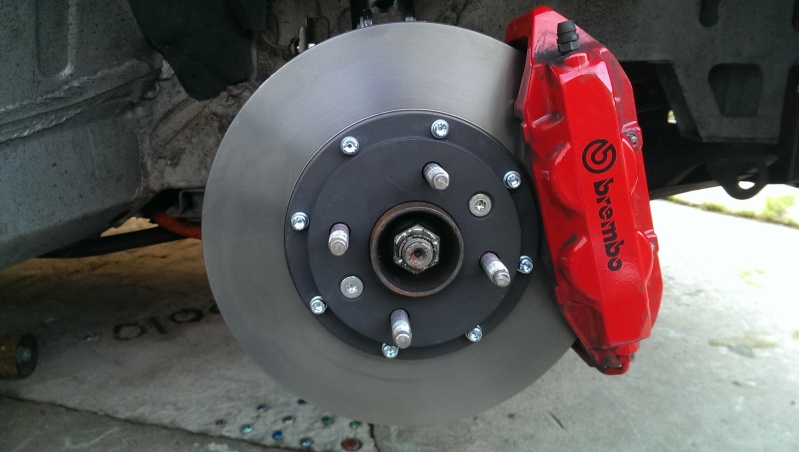

Finally, the brakes got finished so I now have 2 piece discs all fitted :) Can't tell the difference on the road really, the proof will be brake temperatures on the track. They look good though!
Those brakes do look awesome mate. Be good to hear your comments when you've had a proper test on track.

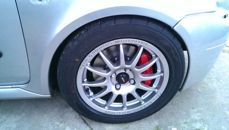

You seem a lot wider than me and I'm trying to understand how you're not rubbing like a fat girls thighs.
He's on the roll centre hubs, et35 wheels and potentially a 5mm spacer mate. All adds up
How much wider are you Mark?
Track width on mine is 10mm wider overall as my roll centre kit moves each wheel out 10mm, but the ones we do in the group buy is only (which you have) is only 5mm per wheel.
My wheels are the same offset as yours so I'd say about 5-10mm. Dependant on what size spacers your running though of course

No they're not that light. Lighter than standard yes but compared with others they're a middle of the road wheel really.
