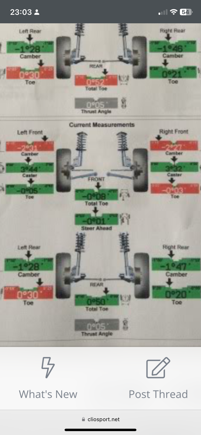

I saved this from another post does this look good for track? And can this be achieved only with camber bolts on the front?
@JamesBryan ?
imprezaworks
  Mk5 Golf GTI :)
Tbh not sure what mine are.
Also can’t remember the decent set up for track, -1.5 rings a bell.
Can be done with bolts.

I still need a camber / toe setup. I’ve got it booked in for this Saturday but not a clue what to tell him to do 😂

Is the alignment guy just a kwik fit type or a bit more motorsport?
Just tell him -2.5 degree camber on the front if he can and 1mm total toe out (12mins if he works in degrees/seconds).
He’s meant to be a bit of a legend around here and I’ve had him do my previous clio so he’s pretty nifty.
I don’t think I have any adjustment on the rear so am I looking at 0 toe and camber on the rear and just mess with the front?

Yeah can't do anything with the rear unless you start playing around using shims from Pure Motorsport, so the rear will be what it is.
