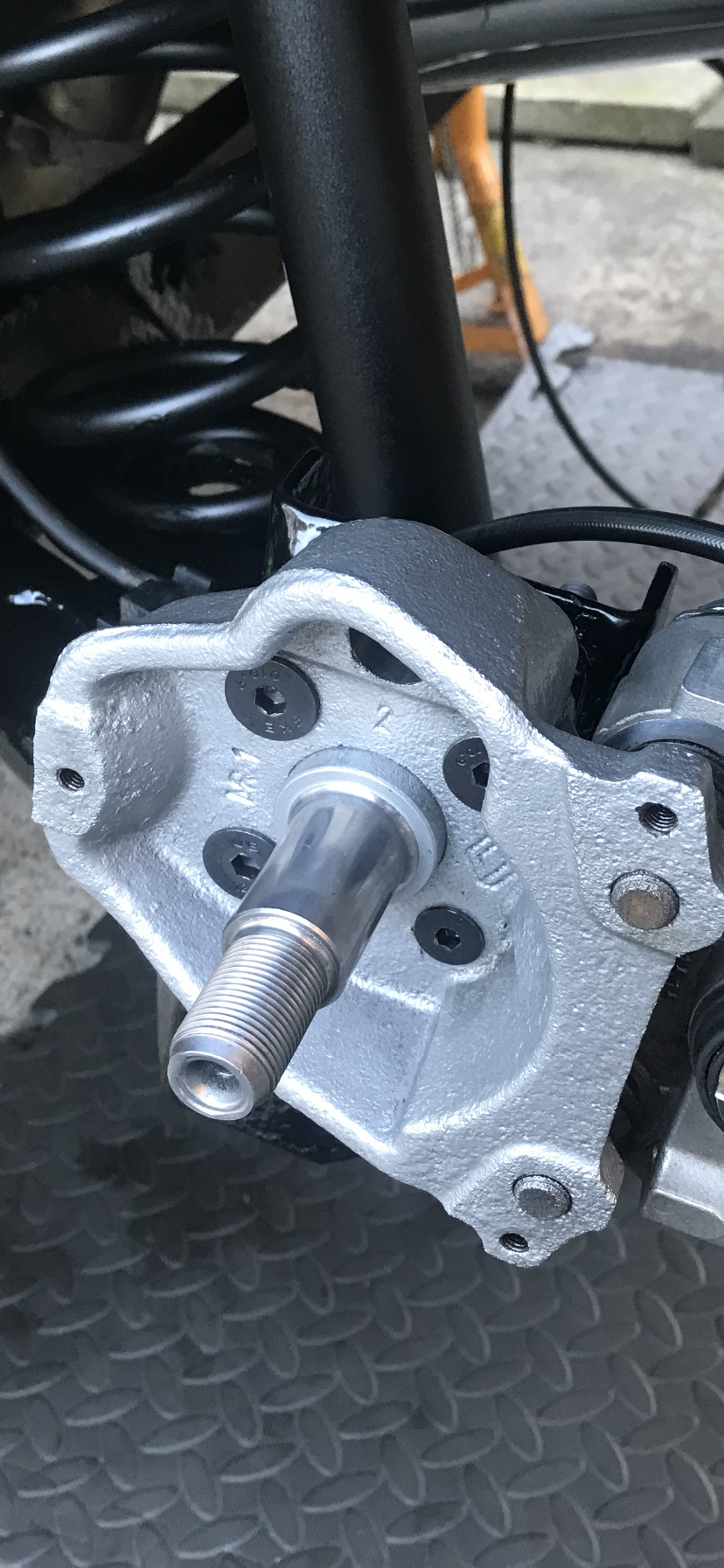

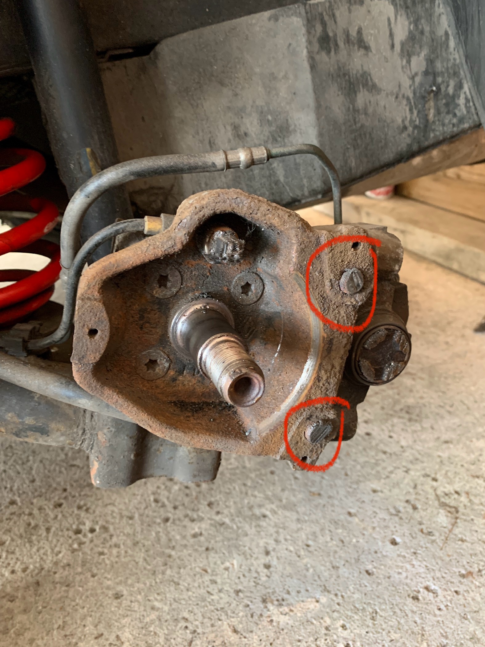

I’ll inspect a bit further tomorrow and get the hub nut off so I can get behind and see what’s going on.

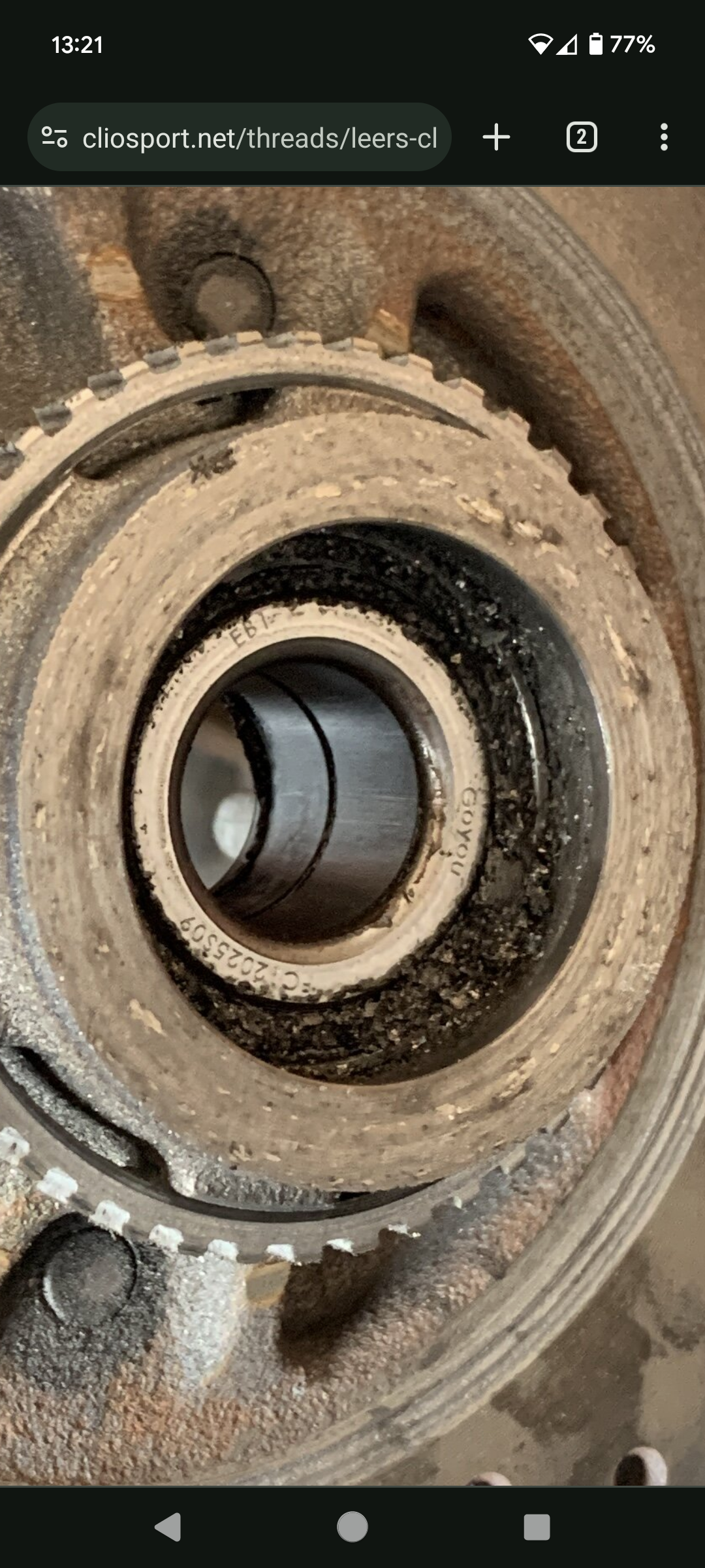

It’s definitely something to do with the first picture as there was a lot of swarf about.

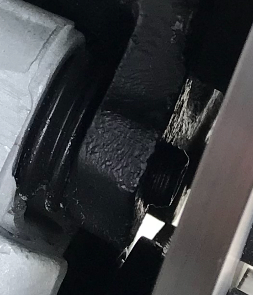

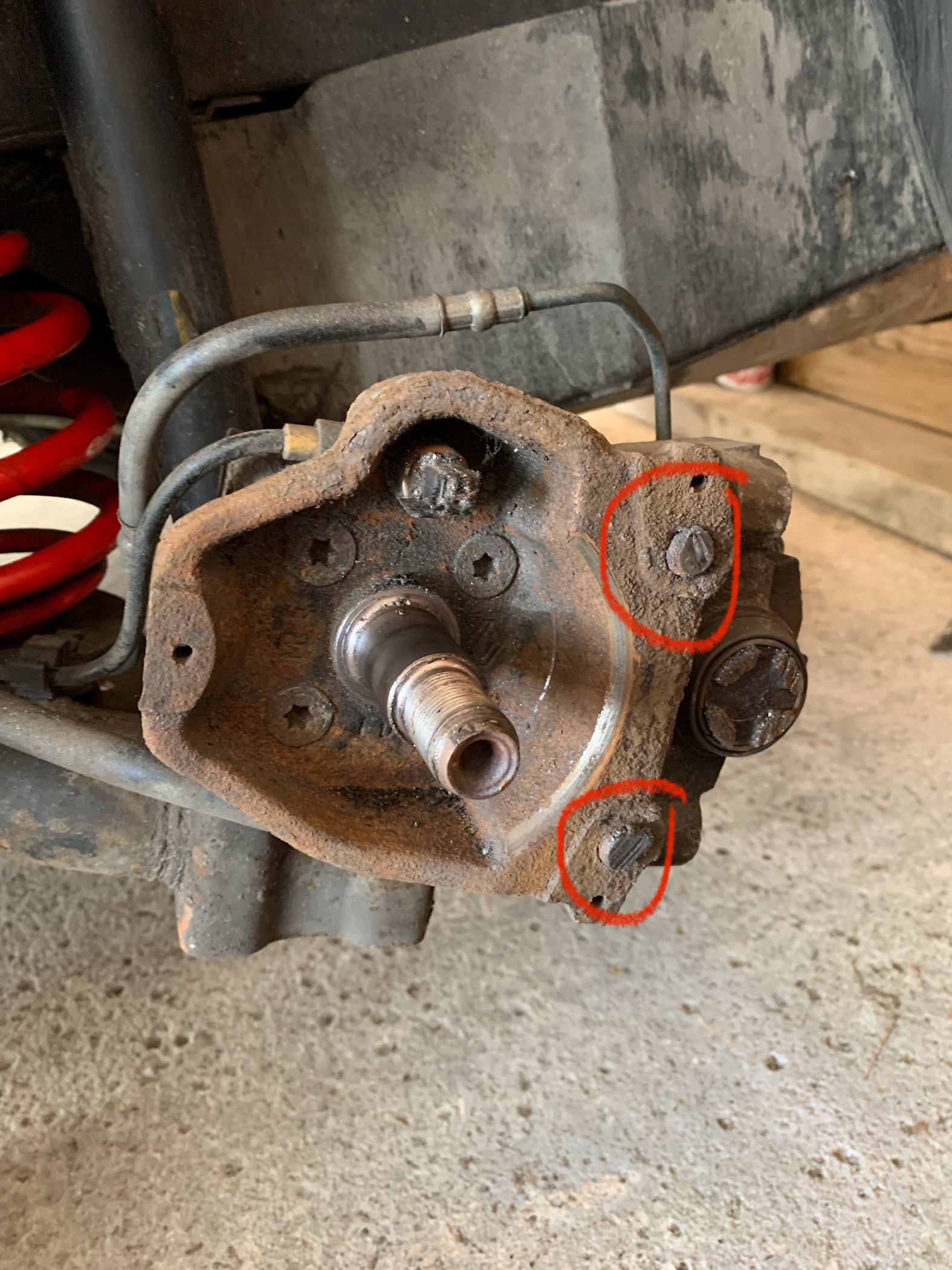

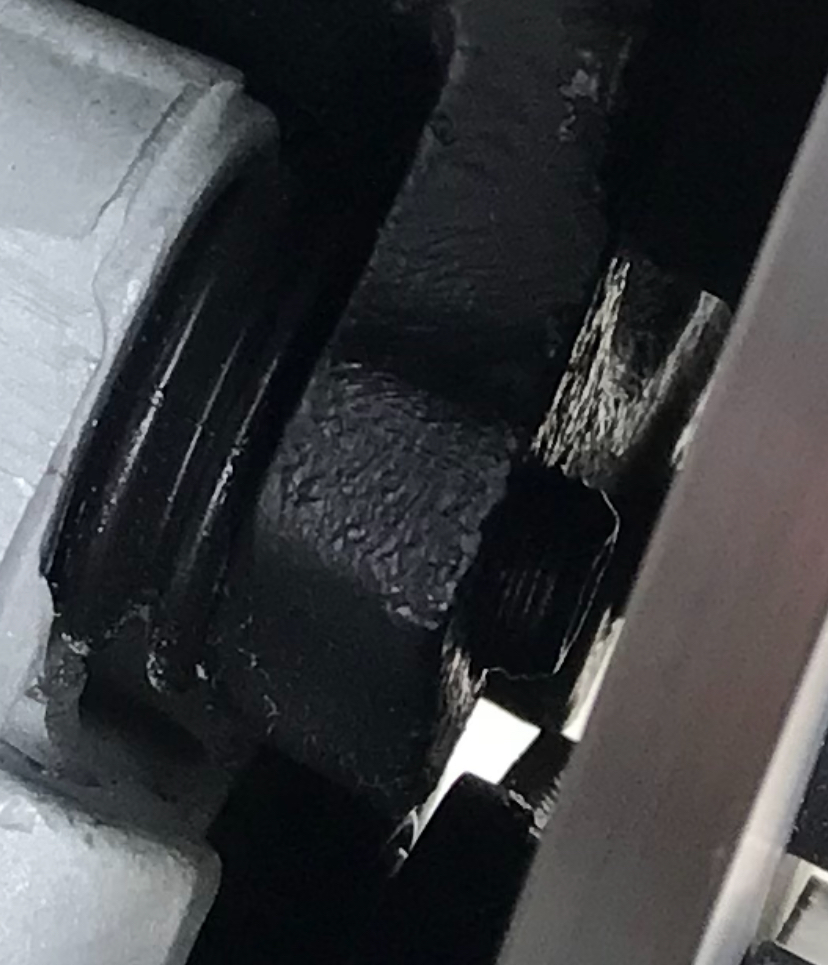

Is that the head of a bolt what I have circled?
Brand new discs so I hope not.Rear wheel bearing failed?

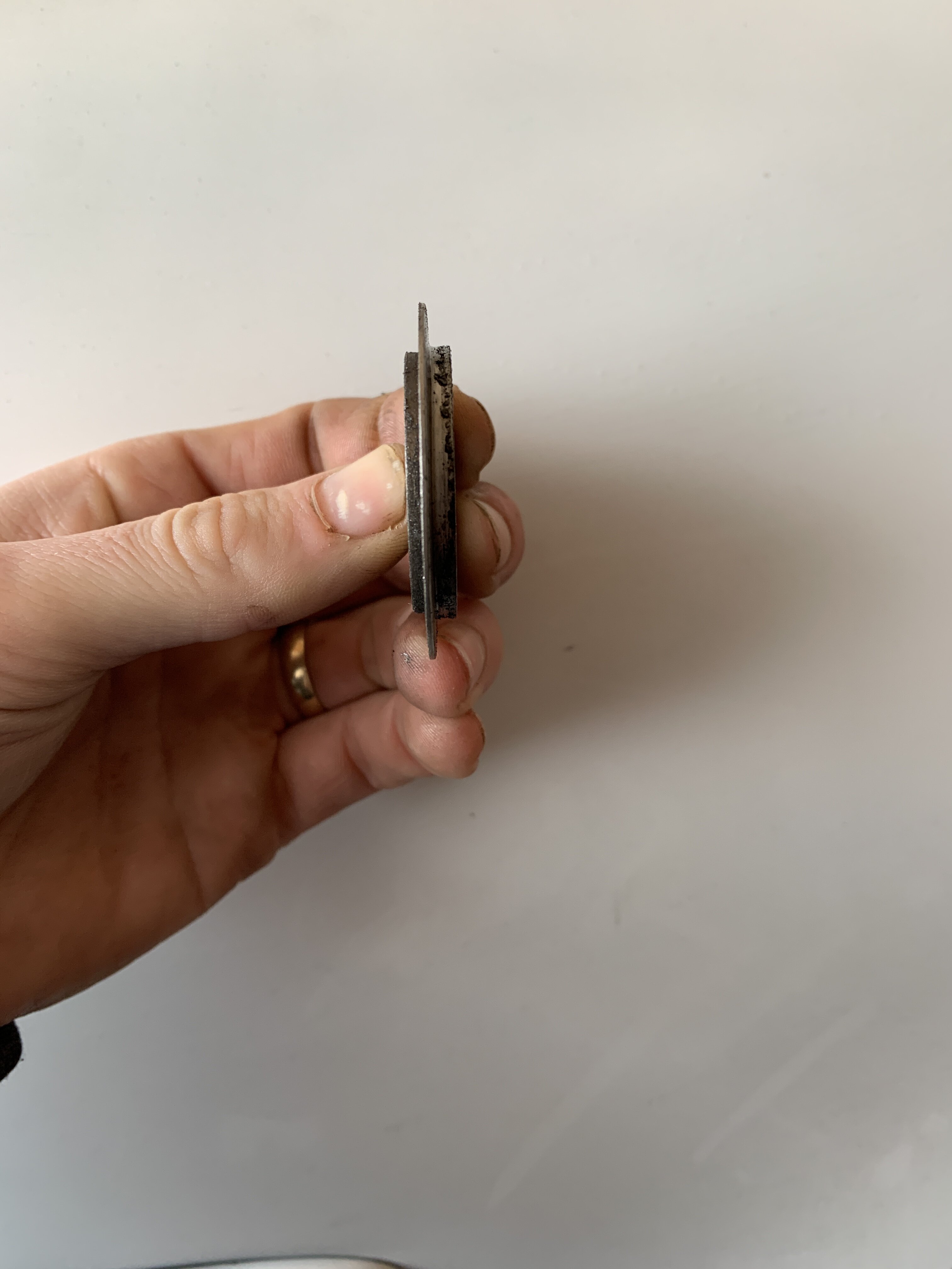

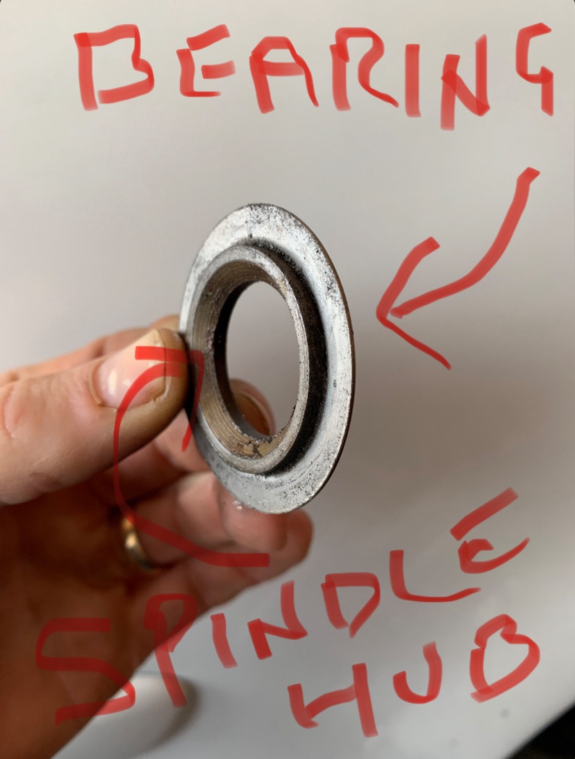

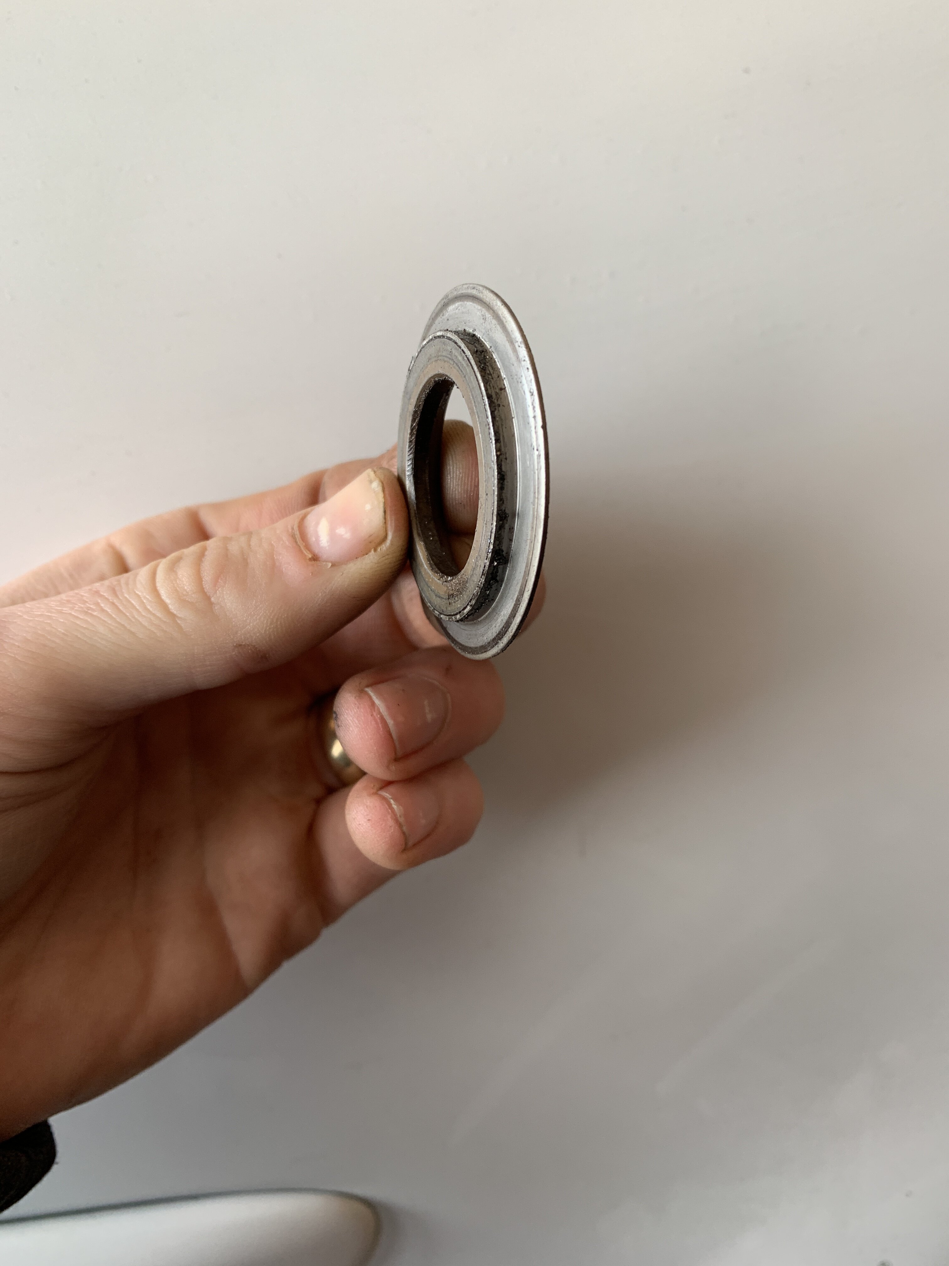

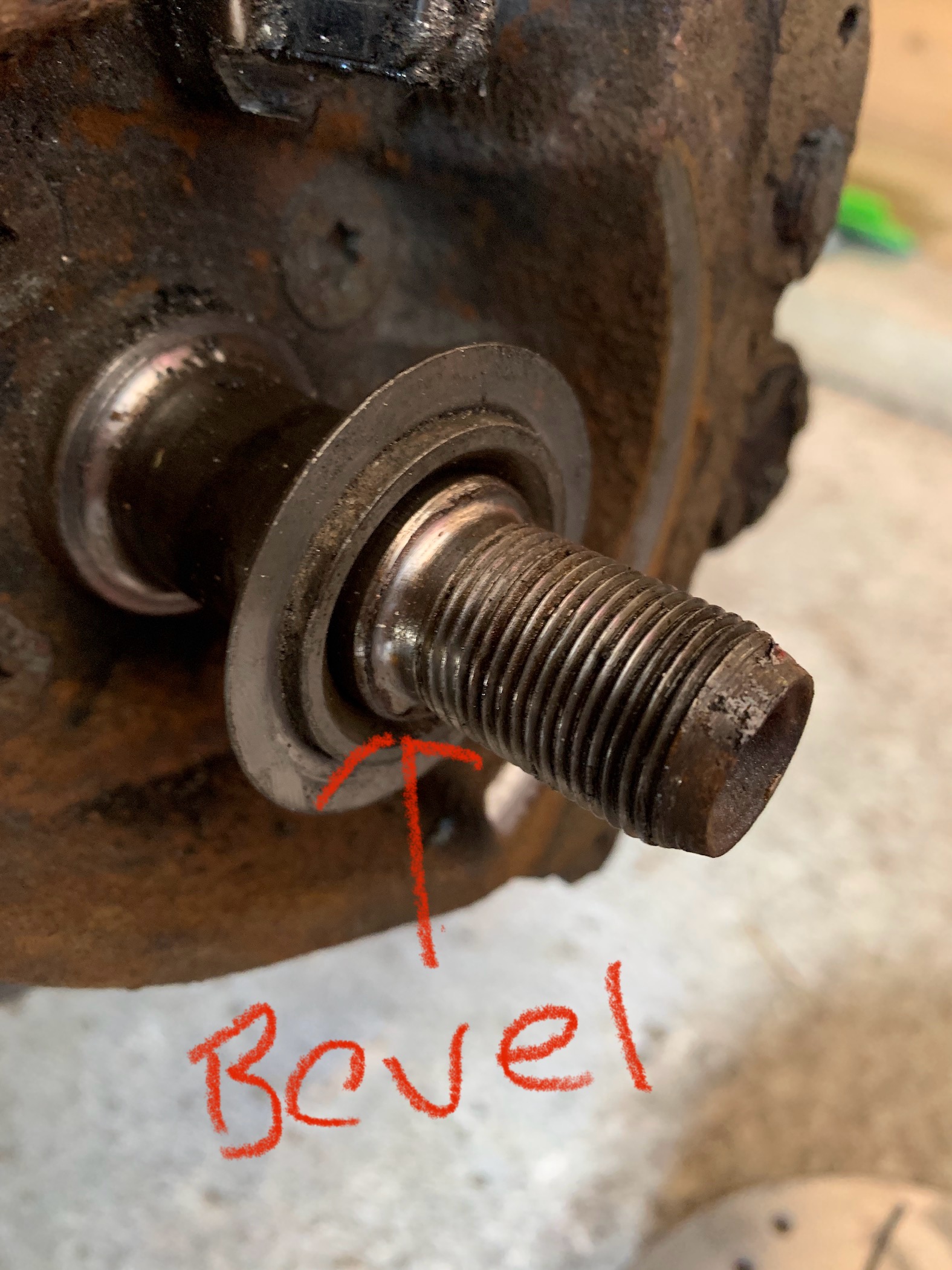

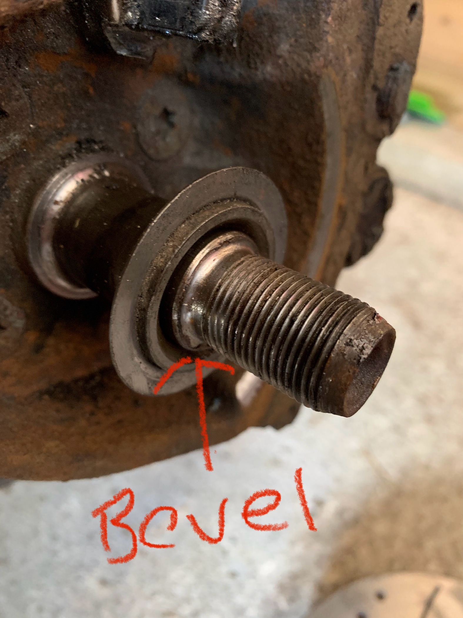

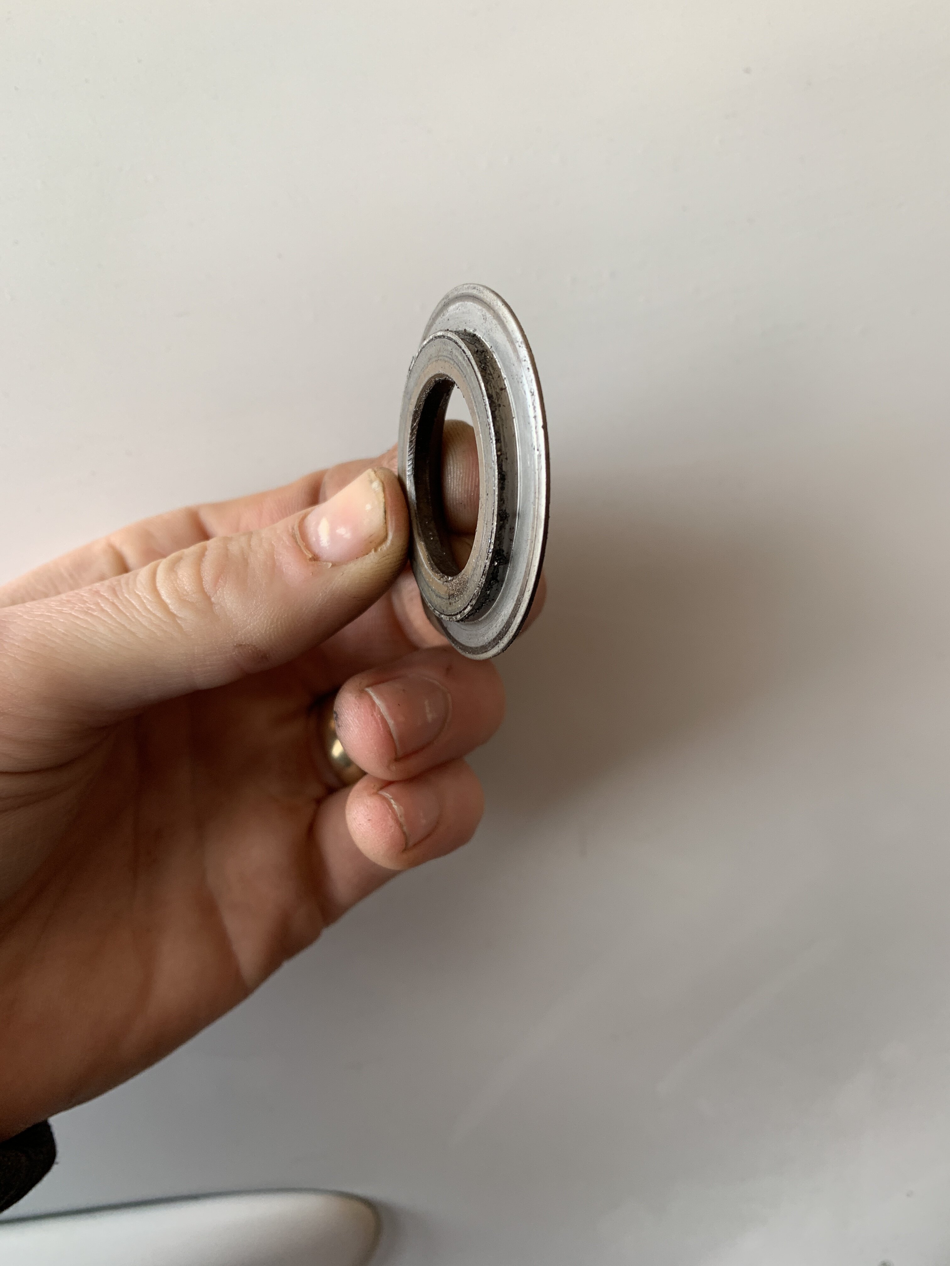

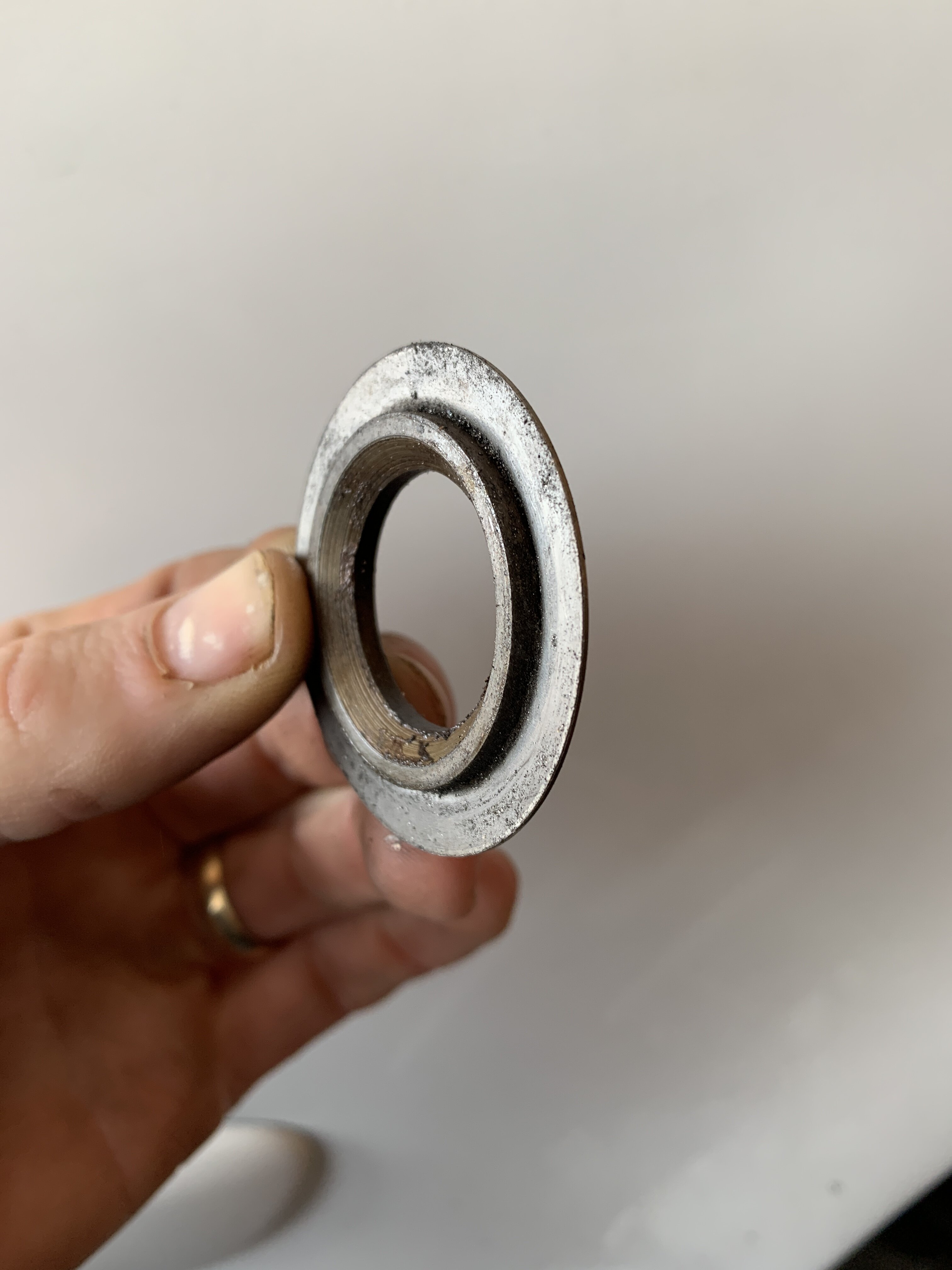

The last photo shows the flat face of the spacer. This goes against the bearing. The first picture of the spacer is bevelled and sits against the spindle. So that goes on first.Right, I’m down with the clio now.

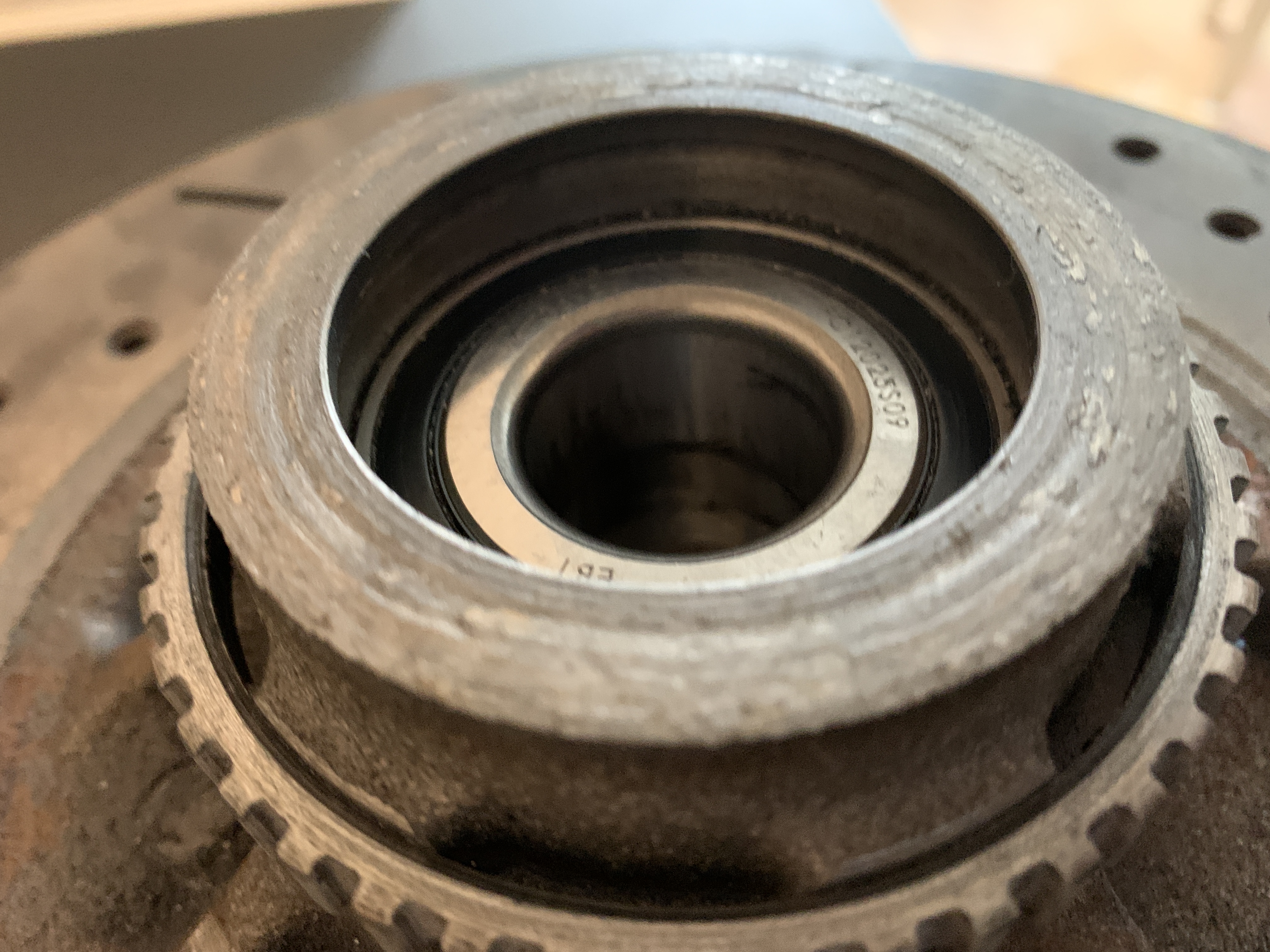

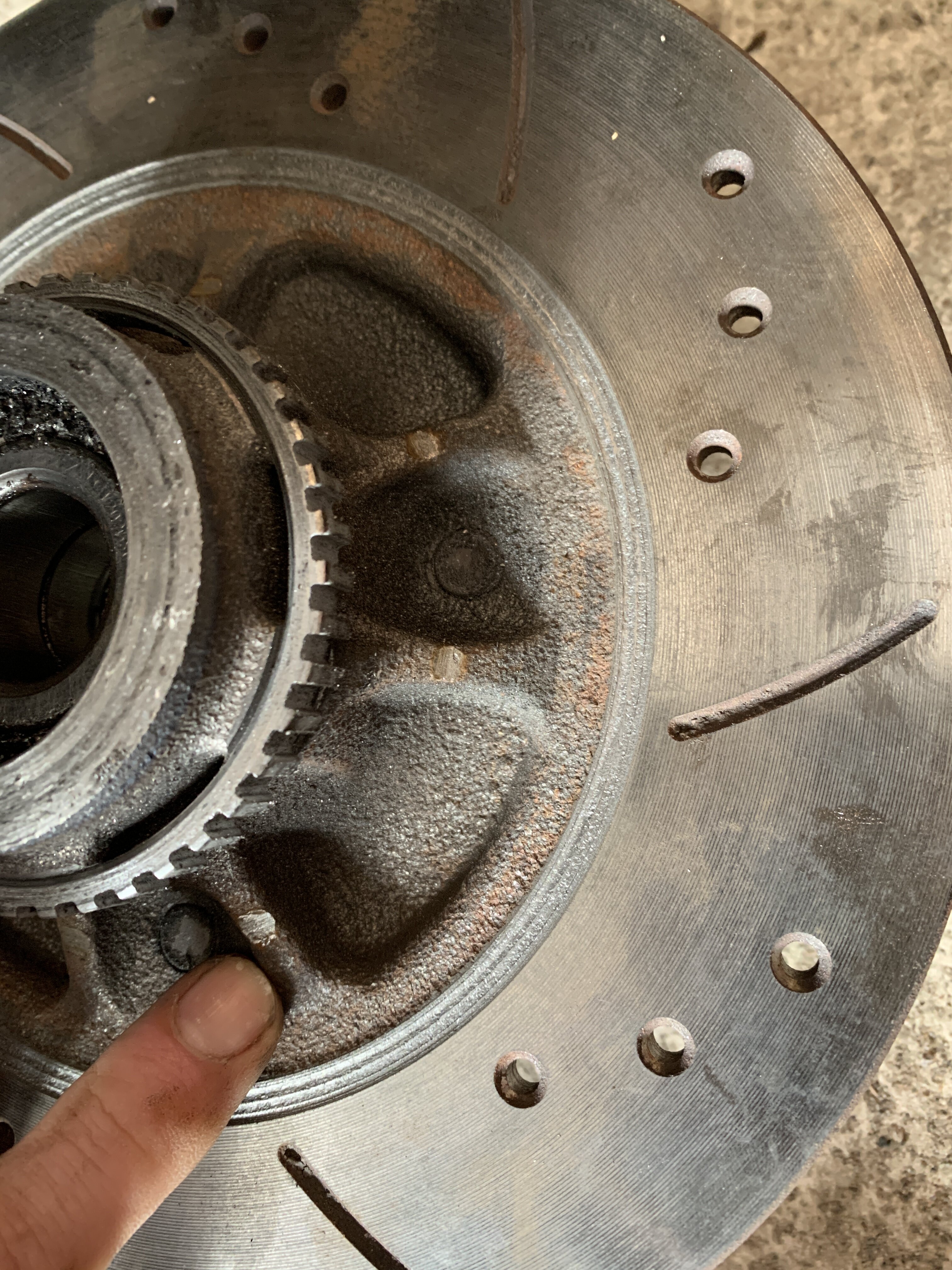

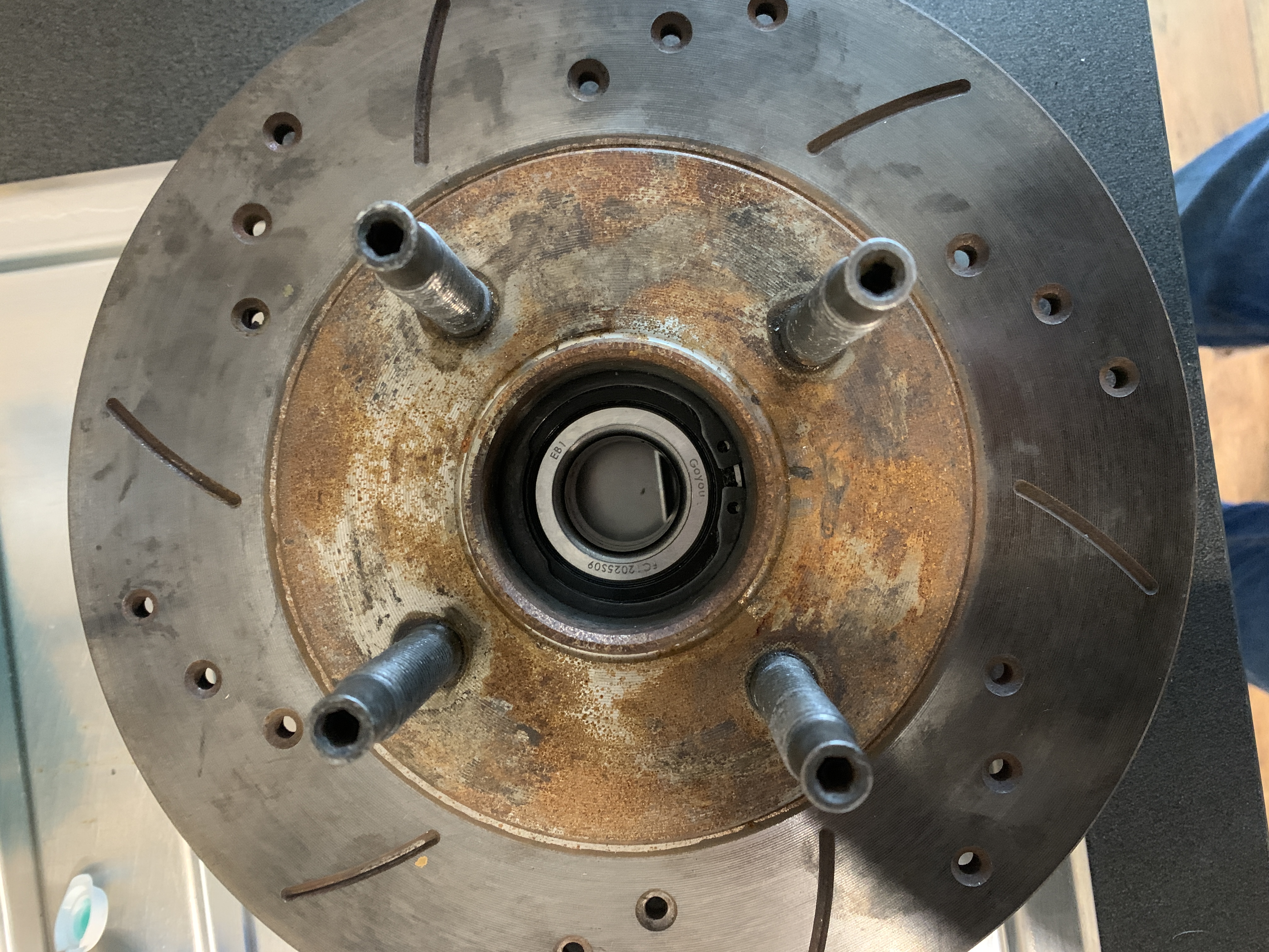

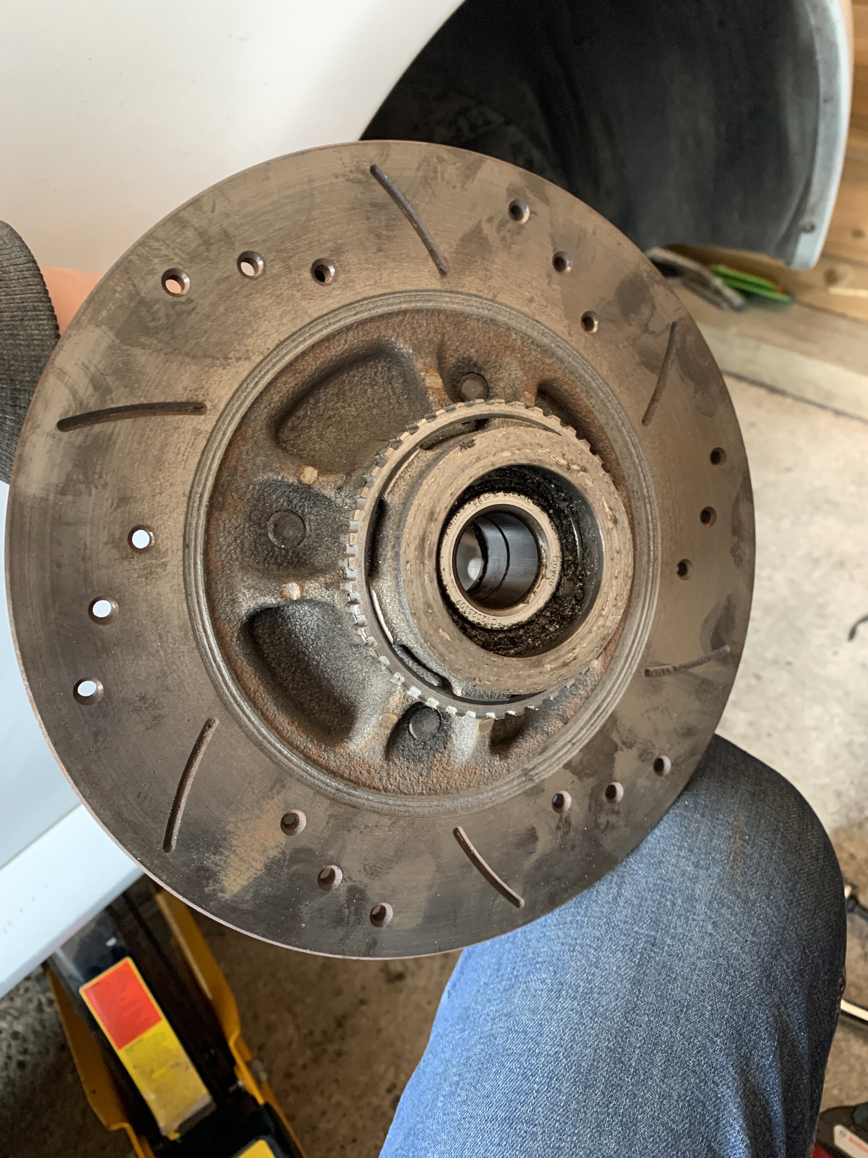

Disc off I can see a lot more what is going on as below images.

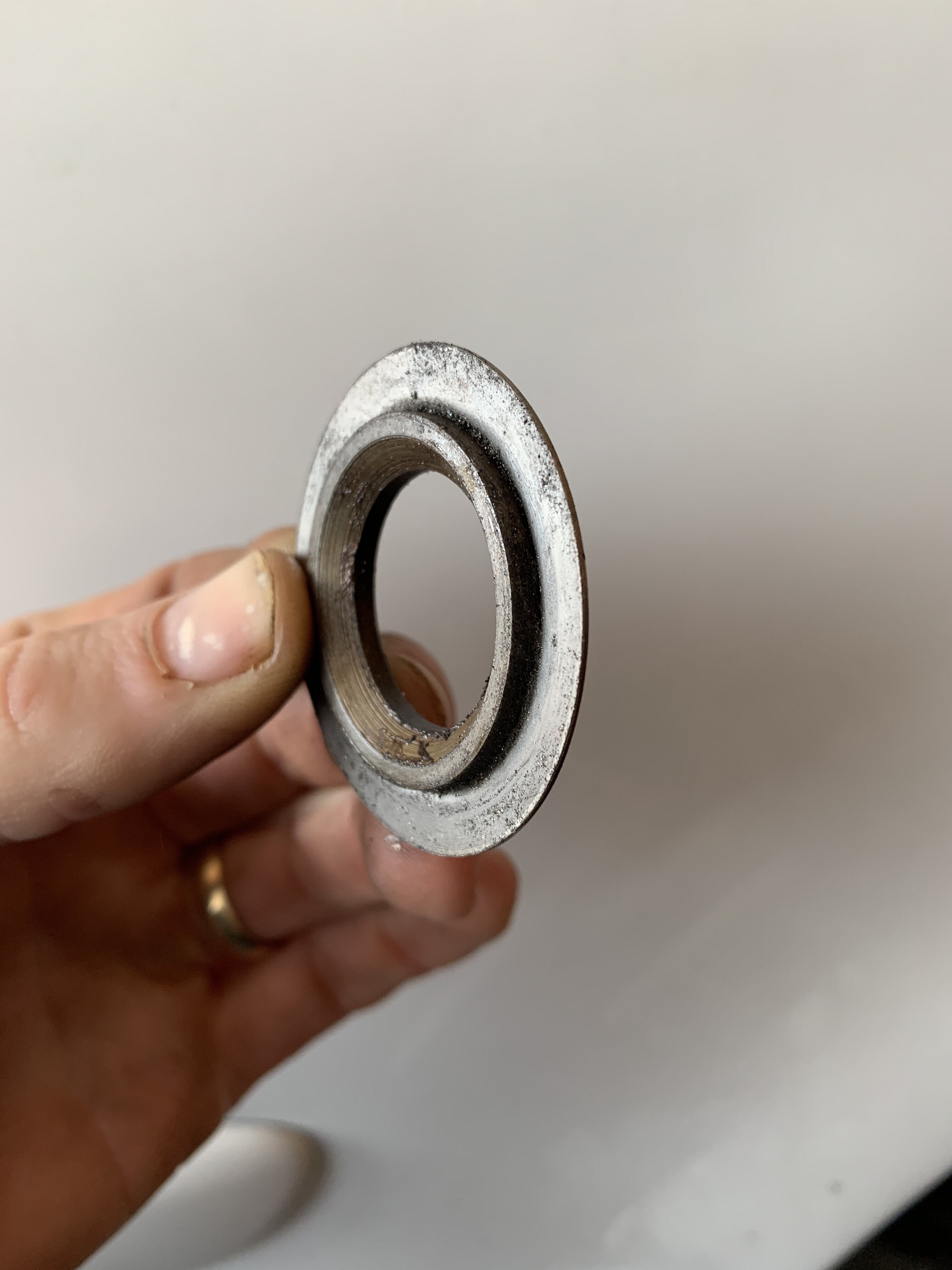

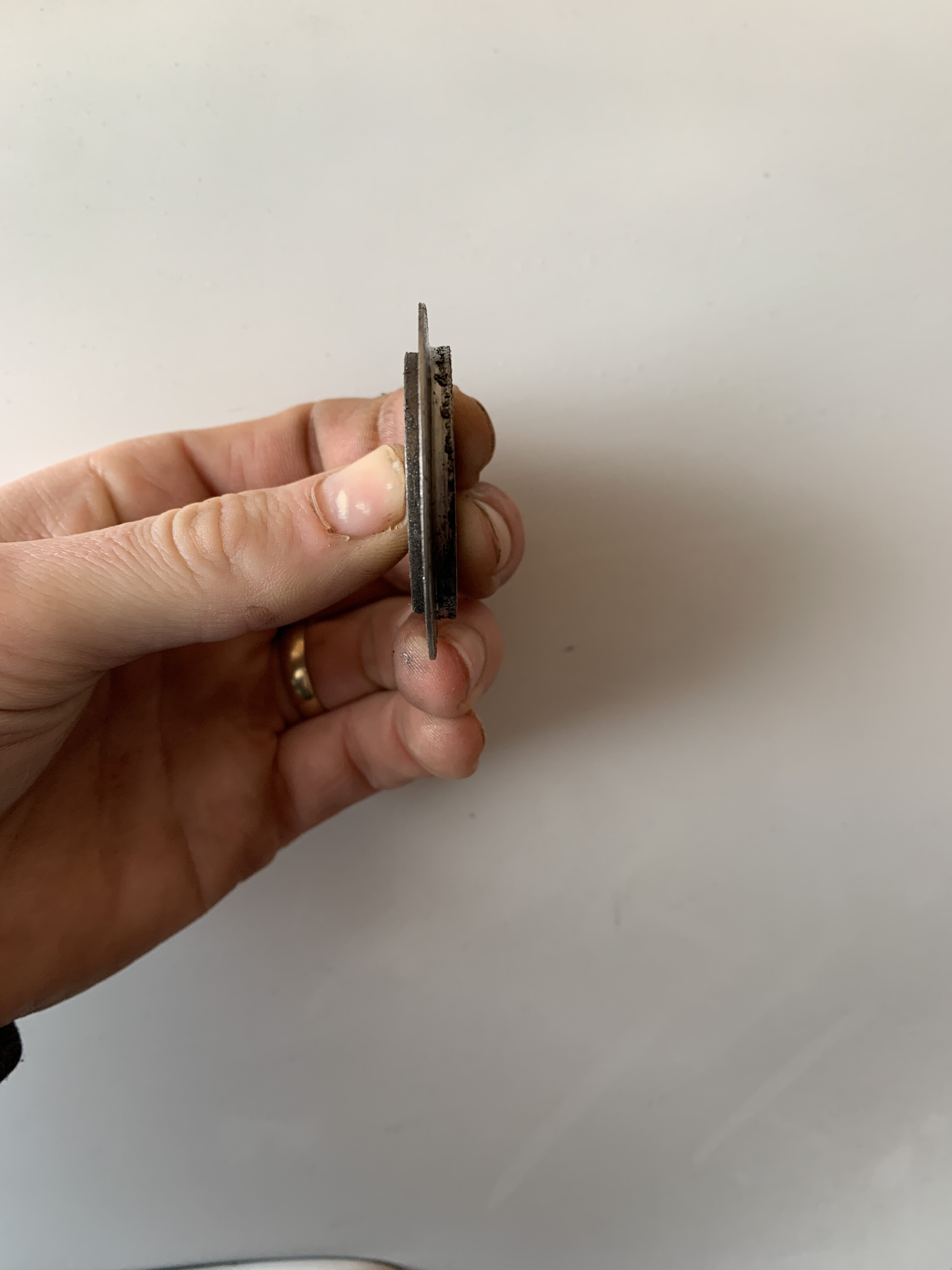

The disc spacer has a concave and flat side to it.
I had it in with the concave edge against the hub. This is allowing the disc to sit closer to the top of the nut which has then scored the back of the disc. Hence the grinding metallic noise.
Am I right in thinking I have just had the spacer on the wrong way around?
So this is meant to be flat face against the hub and concave fave against back of disc?
Turning it by hand it clears the disc a lot more having the flat face against hub so sort of makes sense I had it the wrong way around.
Circled in red is what it has been scrubbing on.
No 😂So in simple terms - as below?View attachment 1687380
Ok. Well that is the way I had it on originally as it is catching on the back of the disc.No 😂
I’ve only ever used original discs and always fit it that way. Never had an issue.Ok. Well that is the way I had it on originally as it is catching on the back of the disc.
When I turn it round the other way it clears 😂
There looks like some scouring on the inside of that hub carrier mind. Where you’ve drawn red circles around the bolts.
Other way round.

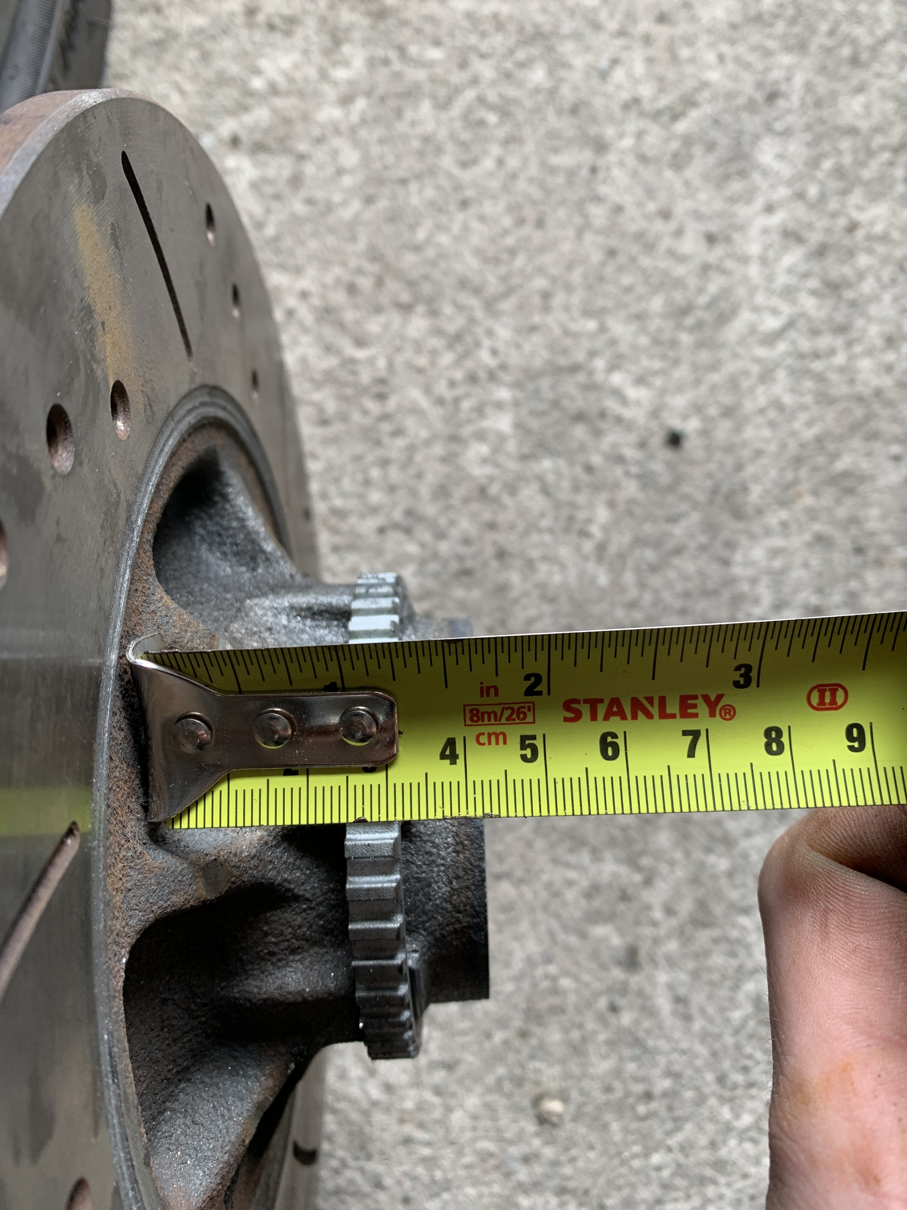

Bolts do look to stick out a bit further than normal.
Even still, with it catching the bolts and also the hub itself, surely the disc is to close to the hub to be catching?

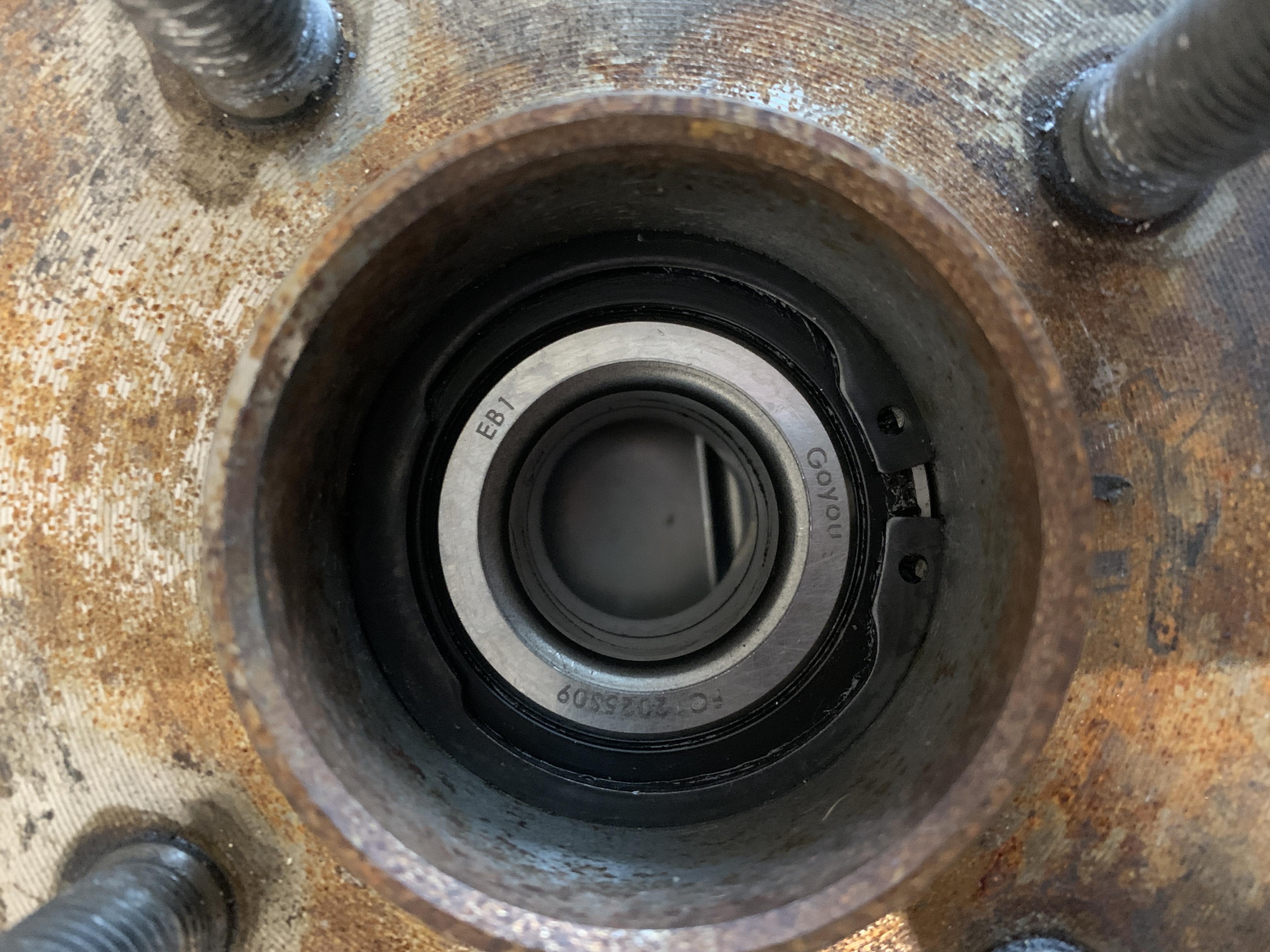

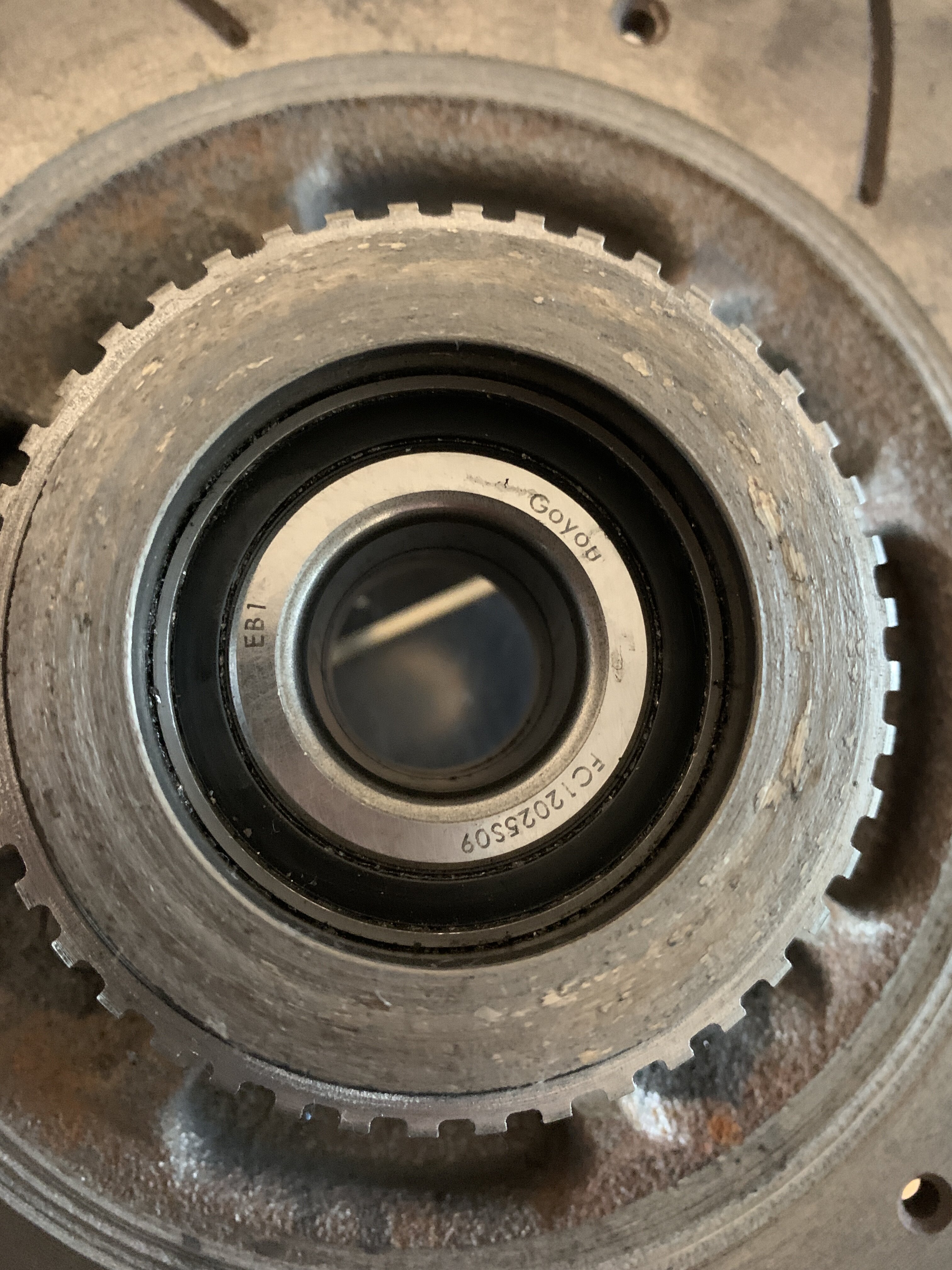

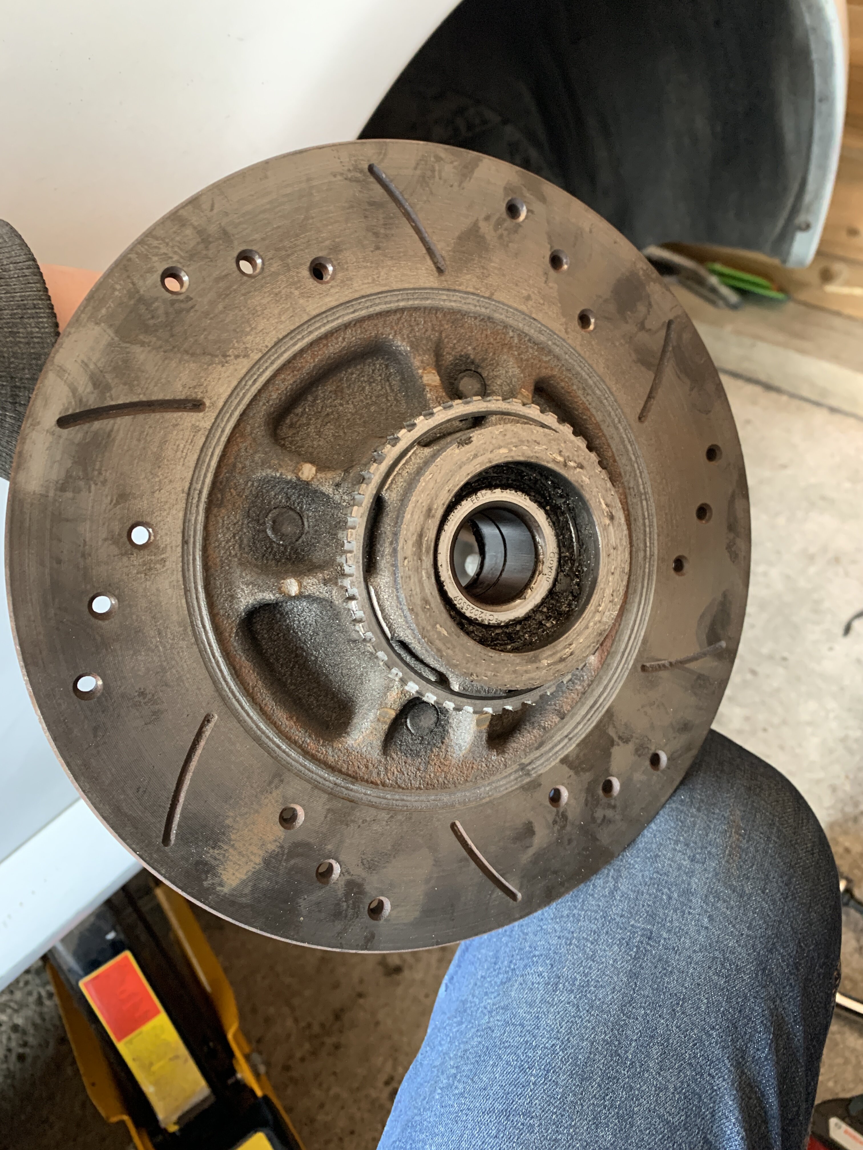

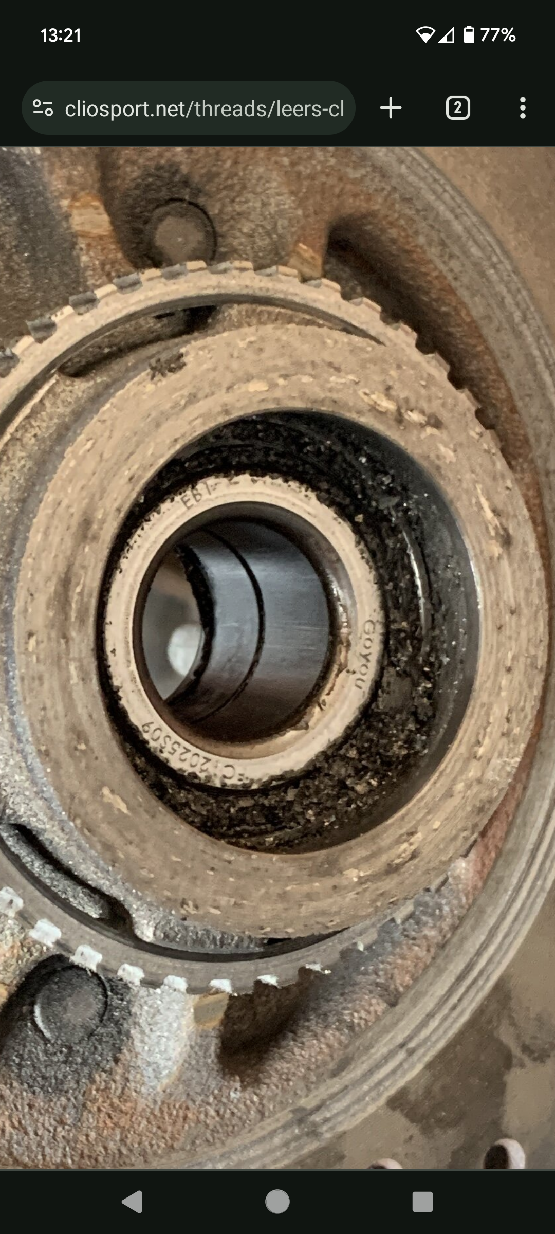

If it's contacting now but wasn't when fitted then it can only be that the bearing has moved or failed inside surely?
There isn’t a circlip on the side you have shown, only one on the other side.Bearing does look further inside there... Could just be the angle.
But I can see what looks like a circlip that's not in place properly 🧐
Can you move the bearing at all?
Nope, not any play.Hmm that seems alright.
Guessing there's no play in it?
Nope, not any play.
It doesn’t look like the circlip is in any type of recess?
Looking on frogjam at the OE Brembo discs, the bearing seems to sit a lot closer to the hub face than these MTEC ones.
