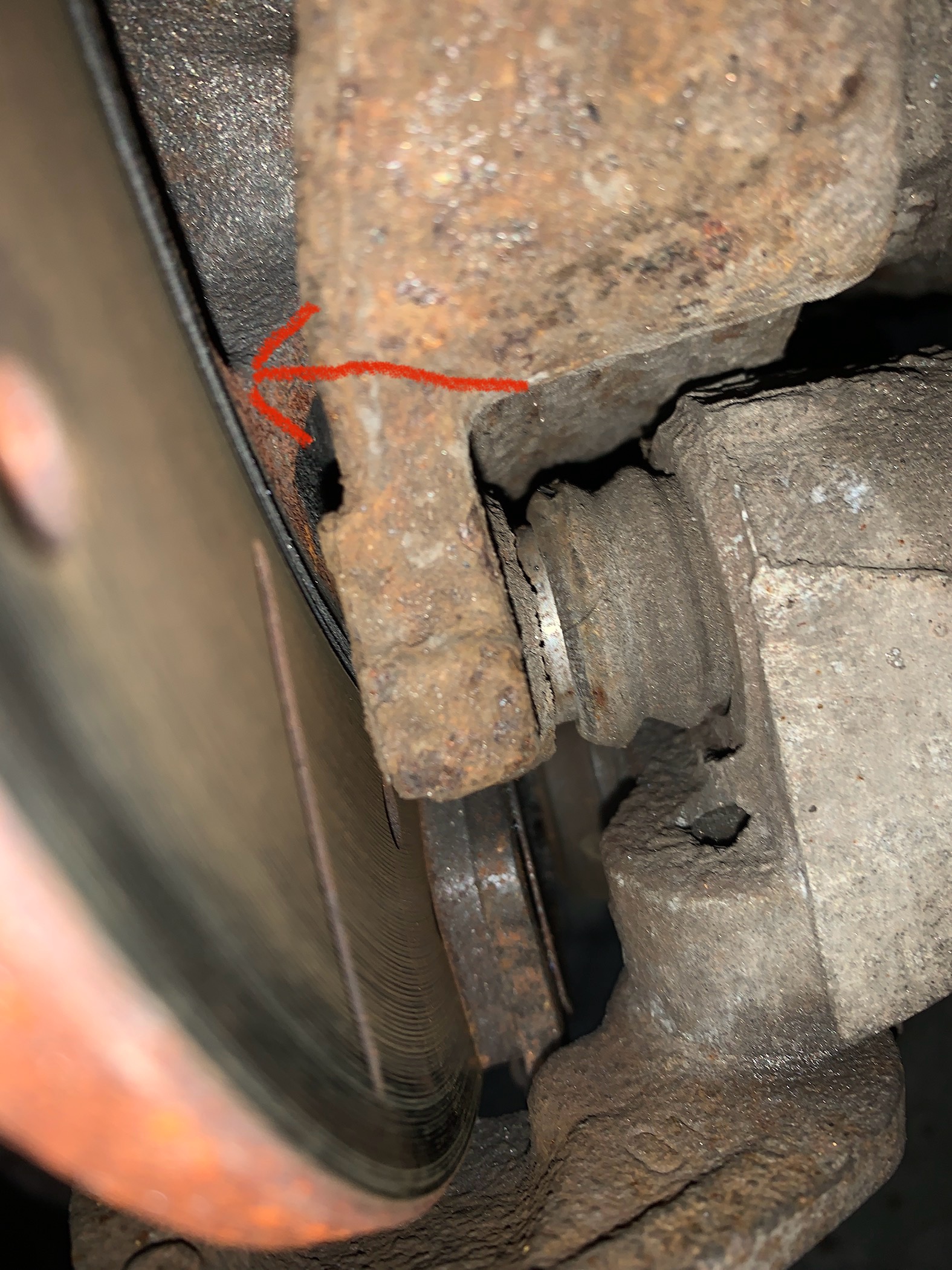

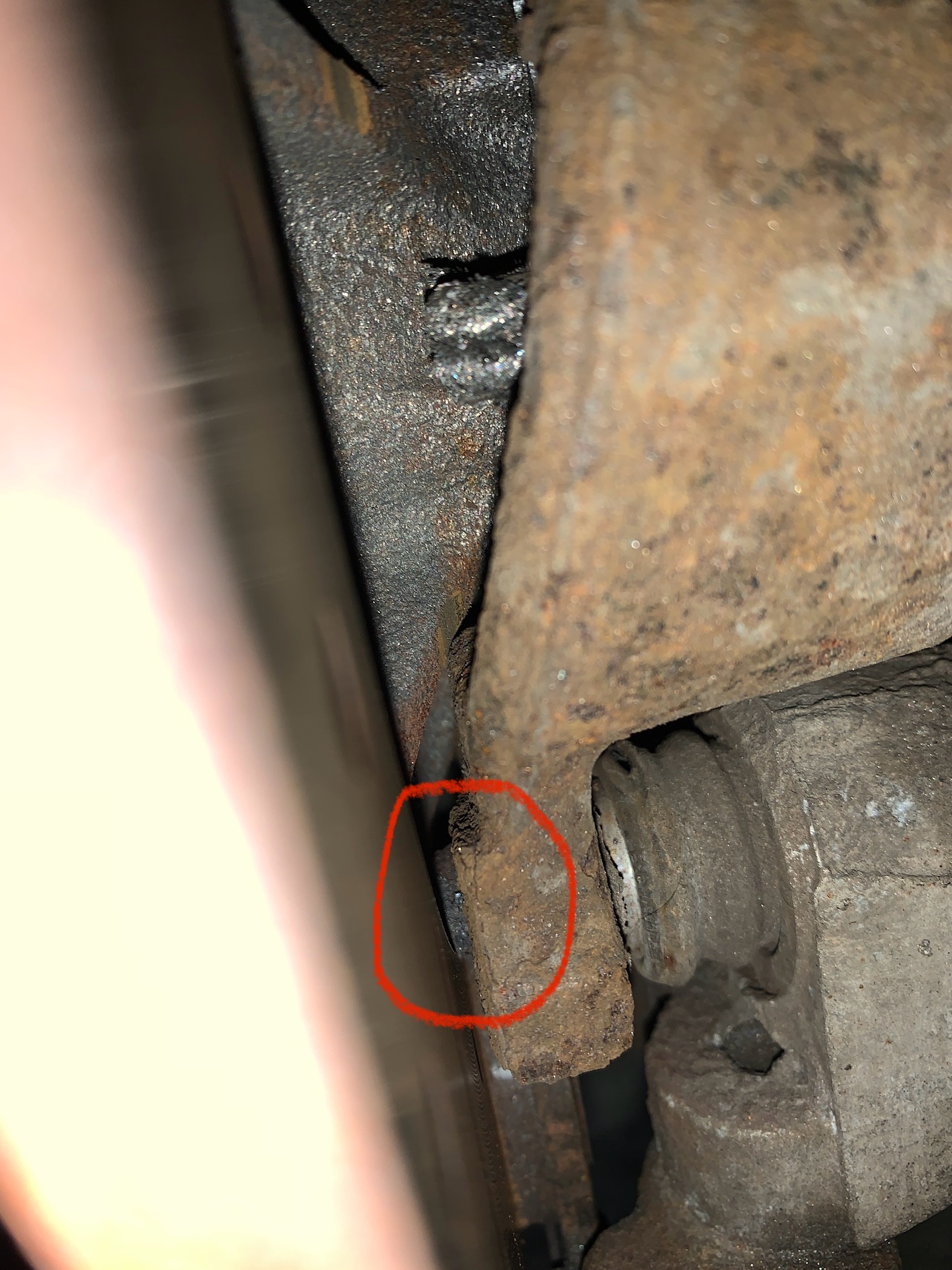

So I previously mentioned about ending the day early at Blyton due to an grinding noise from the rear.
Just taken wheel off on rear left to inspect.
I could see a lot of swarf at the rear of the disc and noticed the bit circled in the first pic has scored a line in the rear of the disc (second pic)
Is this my grinding noise issue and if so, what has / could have caused this?
LeeRS
Did you have the spacers behind the discs mate?
I did put them back on but they weren’t new ones.
You reckon that’s the issue? It would make sense.
Just out of interest, what is the bit I have circled in the first pic that is rubbing on the disc and why would the spacer make it do this?
I have very little mechanical knowledge so I apologise in advance, I just drive 😂
