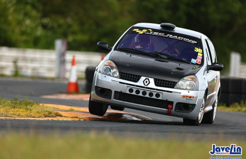

Have a couple of photos from the photographer from the day but this one was my favourite.
As the tyres were crap I noticed the cameraman on the wiggler so went full send for a few laps to get some air time.

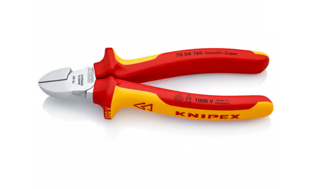

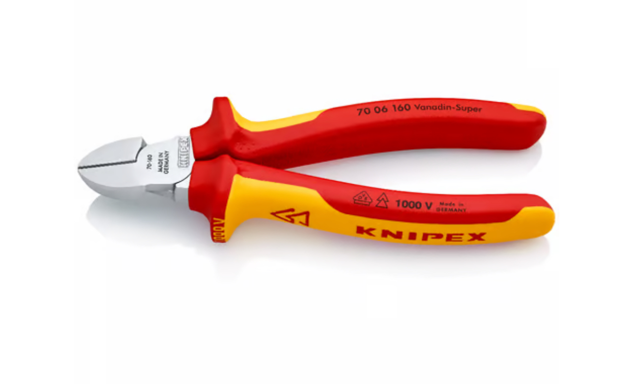

These were in my hand at one point.
I remember my bro cutting his entire loom on the rear quarter to tuck some wires then realising there was a connection block he could have just undone instead, he spent the rest of the day resoldering the wires 🤦‍♂️

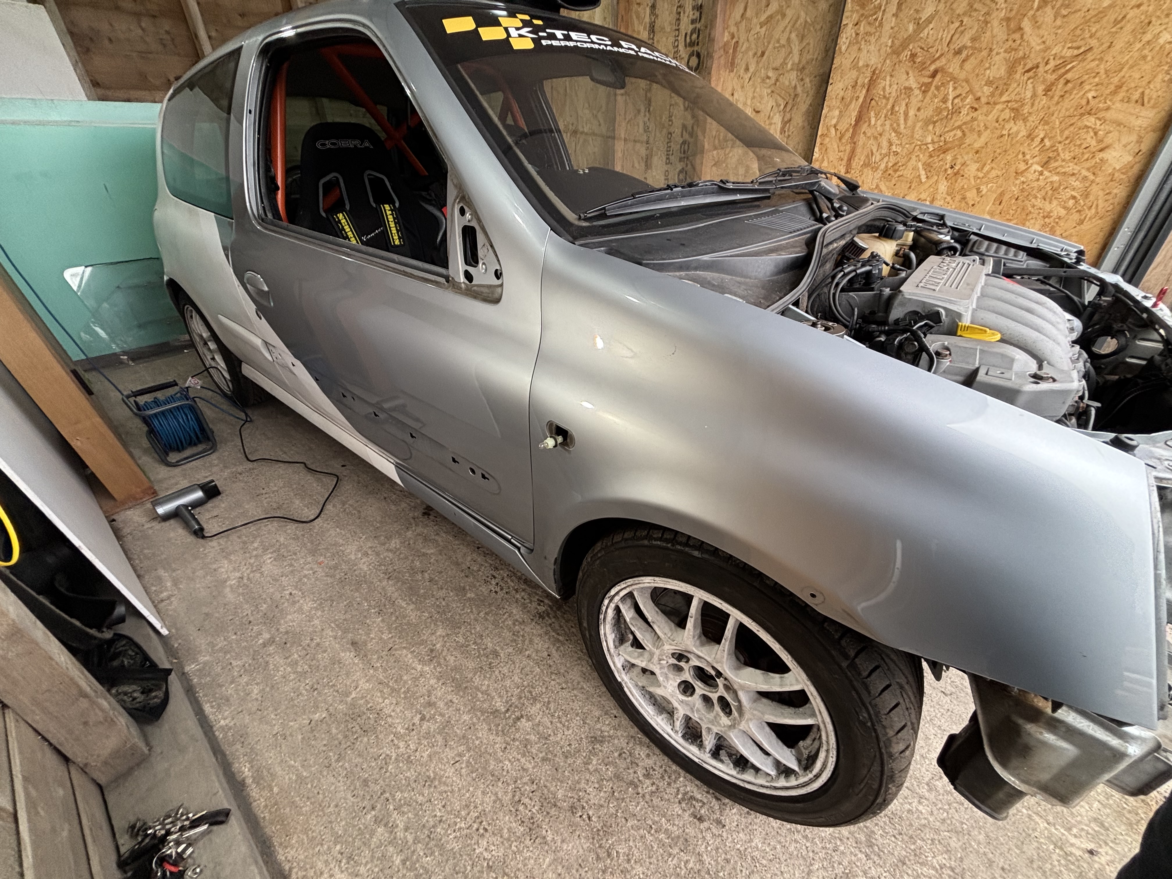

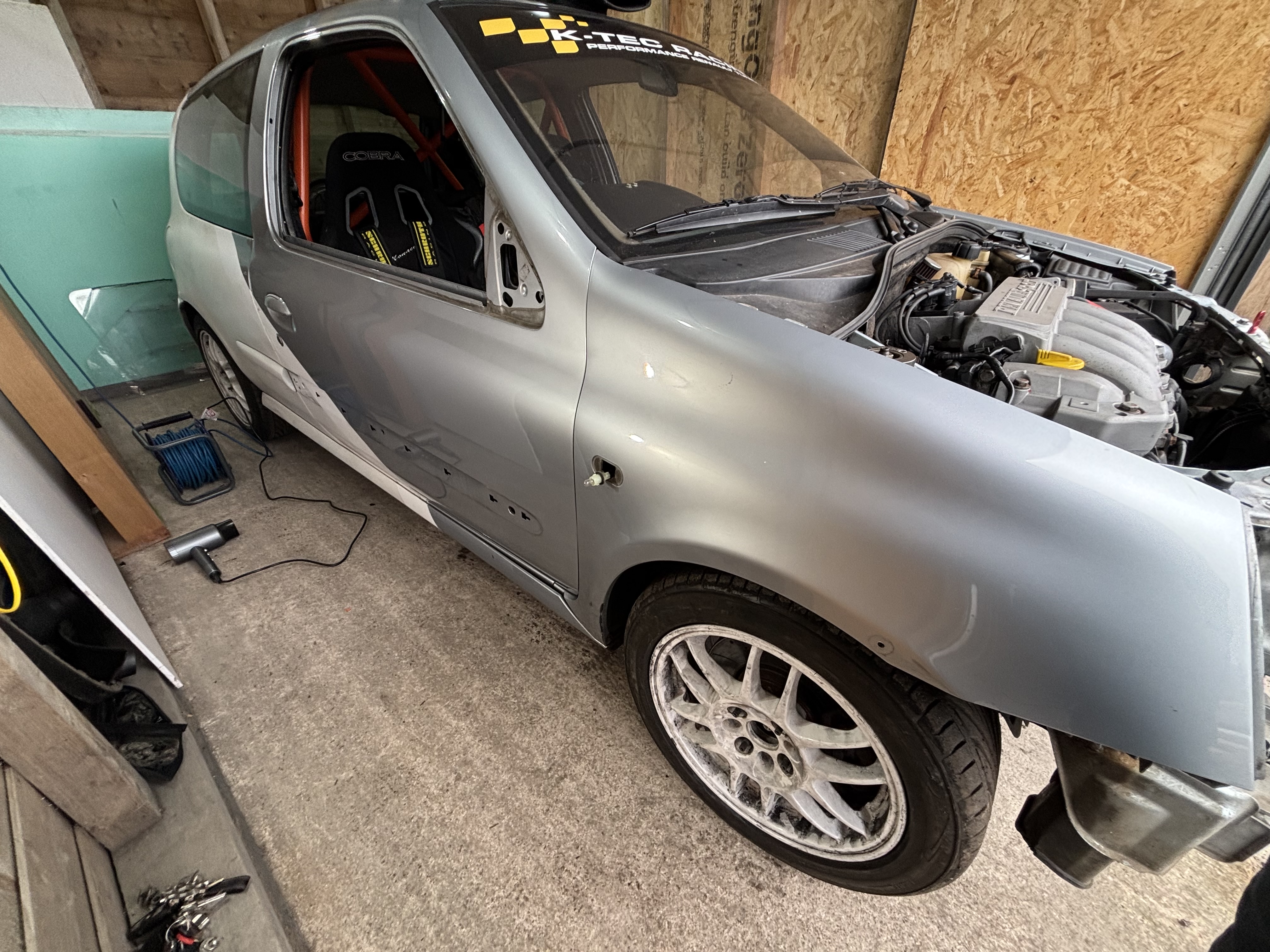

Clio is now fully stripped to where I need it to be for the spray which will be in about 3 weeks time.
It’s been good to get everything off and check everything over.
As this has been a track car for around 17 years it has never been kept outside or suffered from salty roads and you can definitely tell.
Bar the jacking points being fucked from years of jacking up to work on it is in great condition underneath.
Granted nuts and bolts are ratty but everything is nice and free to undo.
just needs a good clean down now and all of the little parts like side strips, bumpers and side skirts jet washing out.
