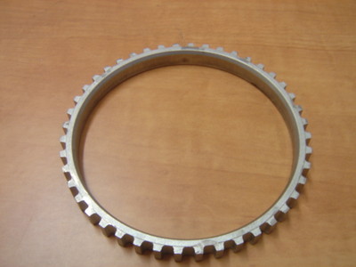

Edit - they're the wrong ones actually, 26 tooth abs rings instead of 44.... Although you could fit new rings to them.

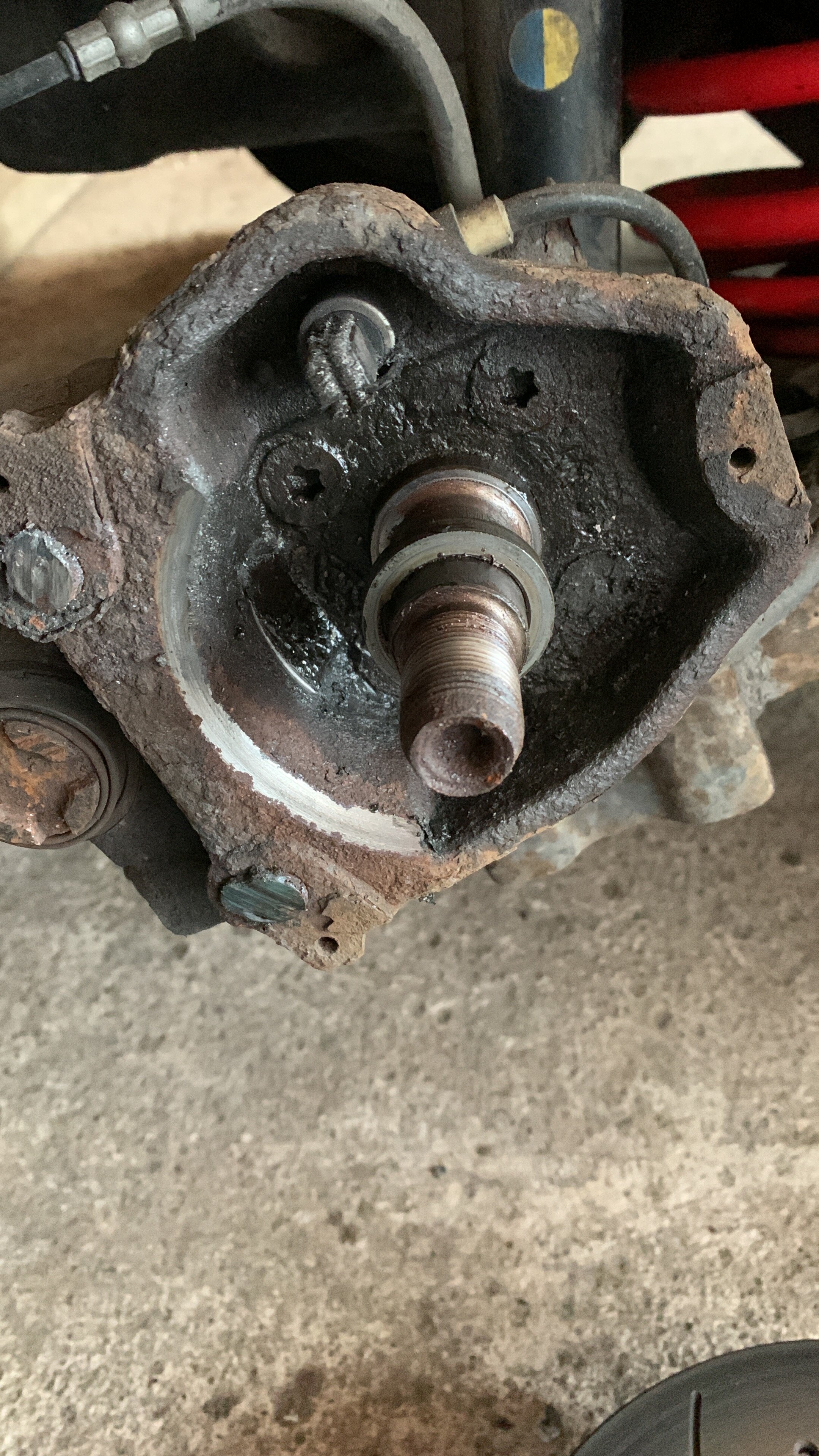

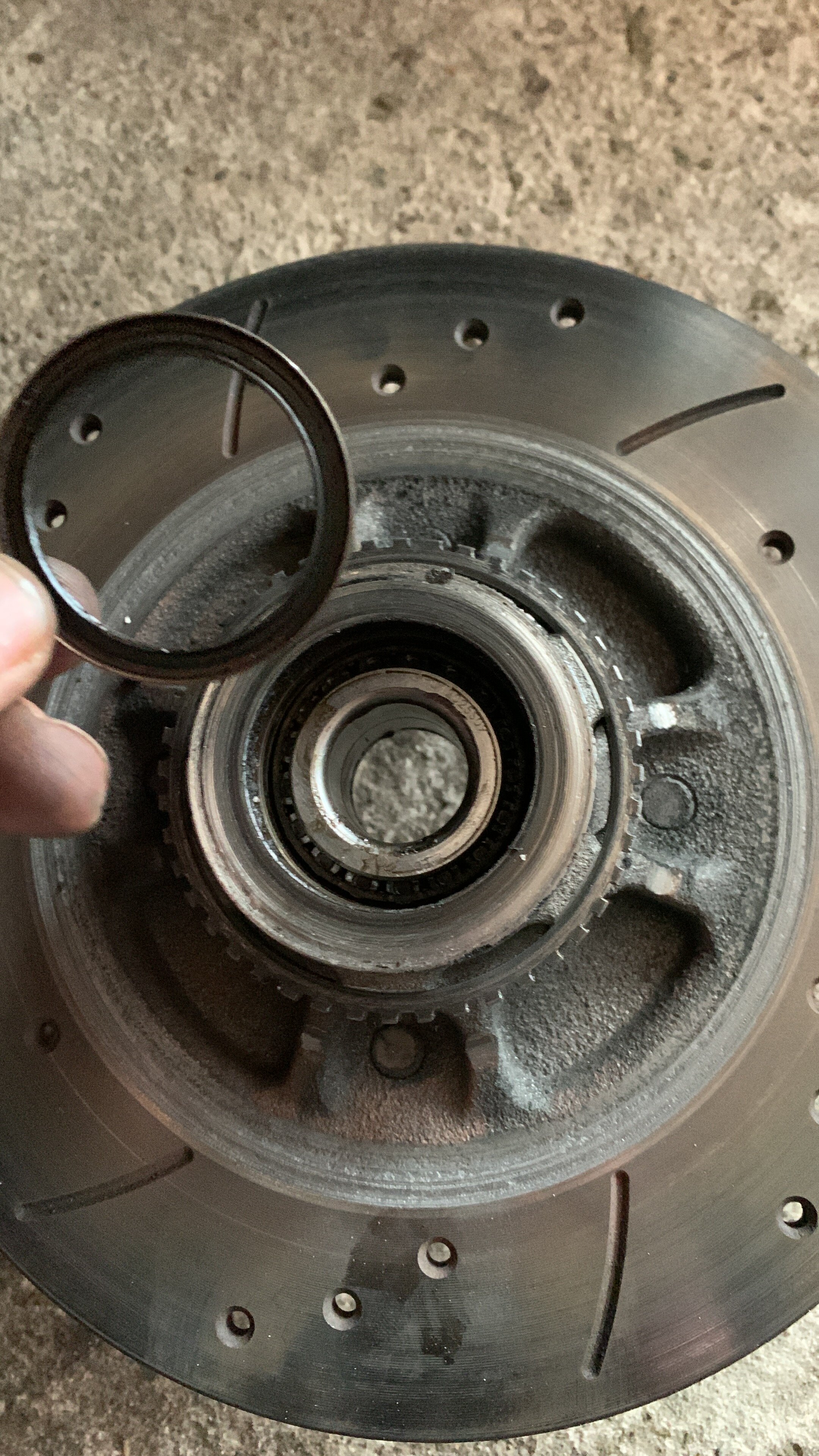

So further investigation has proven a massive failure with the bearings.
Either not sent out correctly from factory or very poor quality in manufacture.
Basically, the circlip had come out from its housing (unless it was never in there from the start) which allowed the bearings to slide toward the outer face.
This meant that the disc was allowed to move closer to the hub, taking out everything it rubbed against.
These discs were brand new and have only done ~50 laps at Blyton before having to call it a day as I was unsure what the noise was.
I can’t believe something marketed as a “performance” brake can fail so quickly and easily.
To test the theory, I did press back in the bearing and fixed the circlip into its original place.
The circlip - if it was even in place correctly to begin with was also upside down.
Following this mornings findings I went back down to the car to check the drivers side.
Again, this hd also failed however much worse as the bearing cover had come out which has leaked grease all over my pads.
It’s pretty much destroyed both carriers and also the majority of the bolt heads or threads attached to it.
Absolute nightmare so I will be contacting them tomorrow to see what the crack is.

As we suspected then mate.
Rear hubs should be fine, even though it has scored them. Structurally they'll be fine.

The bearings, bar the seal on the drivers side were actually tight as hell and smooth. I think the circlip was the issue and what has lead to the failure. The groove it sat in just doesn’t look well machined at all.
