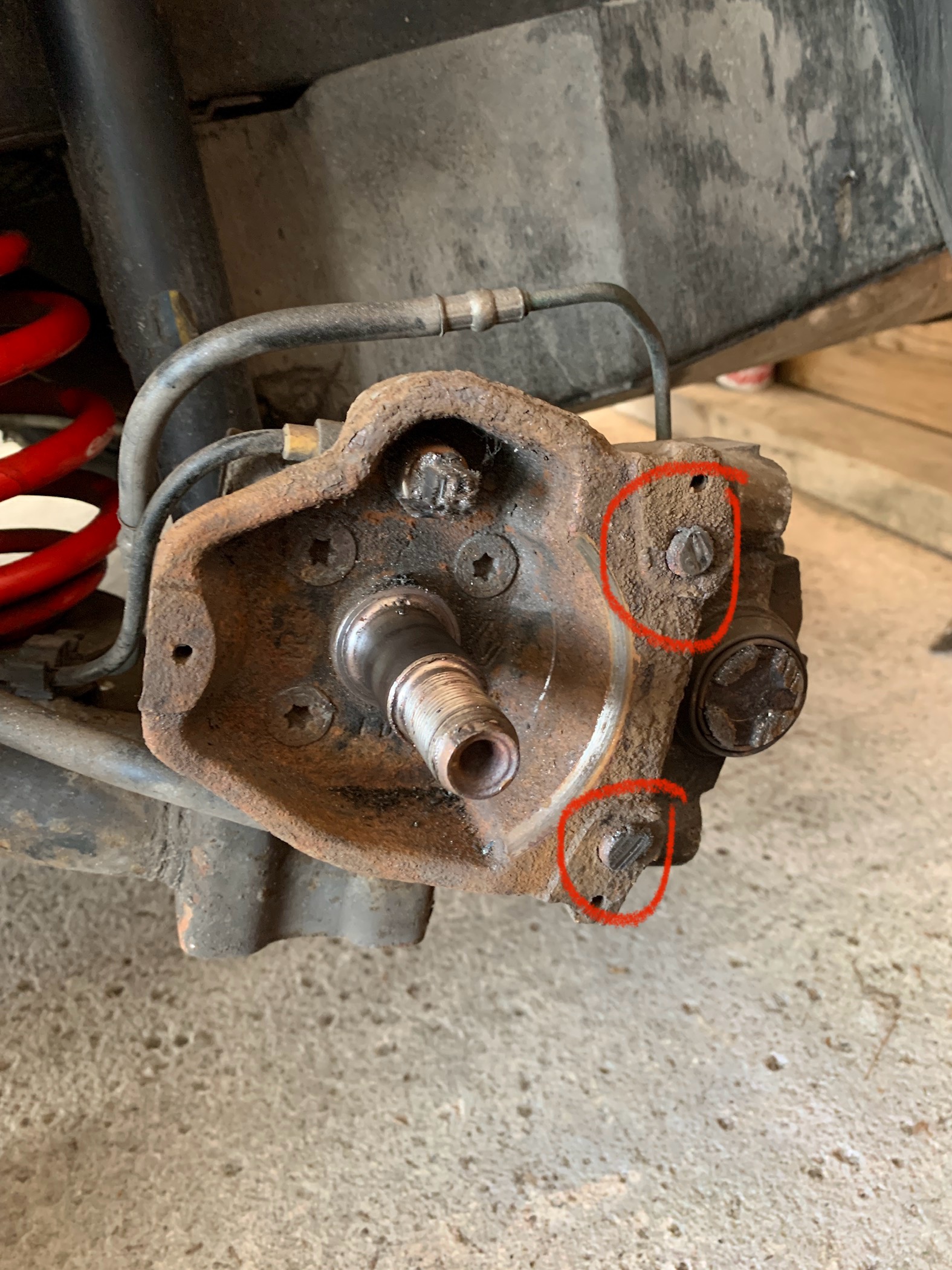

What are my options here then…
Either run a die set on the originals or try and source some. I bought all the bolts in Scotts list when I did my first rear beam, but the bolts were slightly different, so just tidied up the originals. I still have them but with something like that where there’s movement from the slider, I didn’t want to mess about with it.
RPD have a link to the bolts here - https://renaultpartsdirect.co.uk/7700656379/
Fill the form in or give them a ring, you might get lucky.

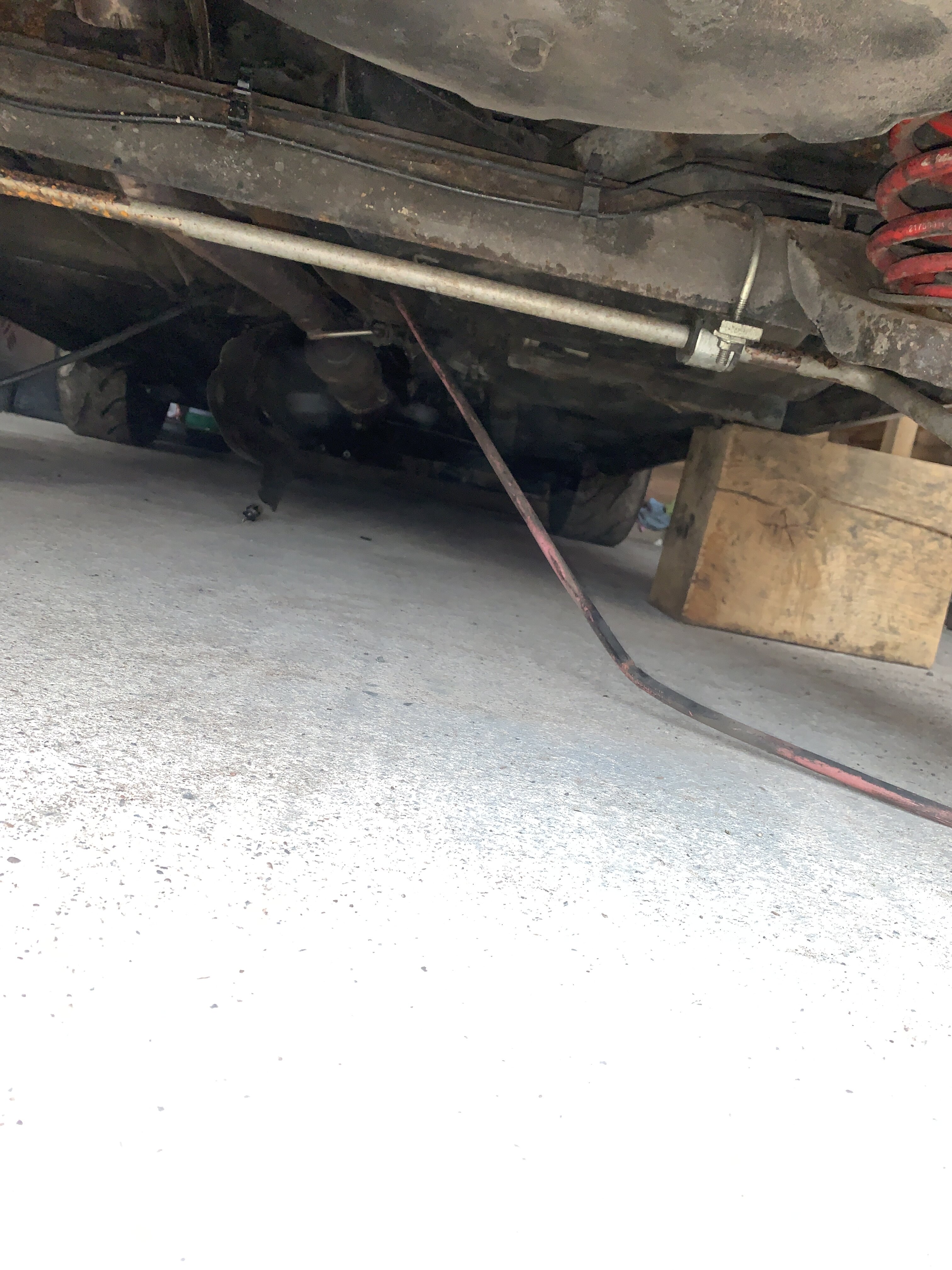

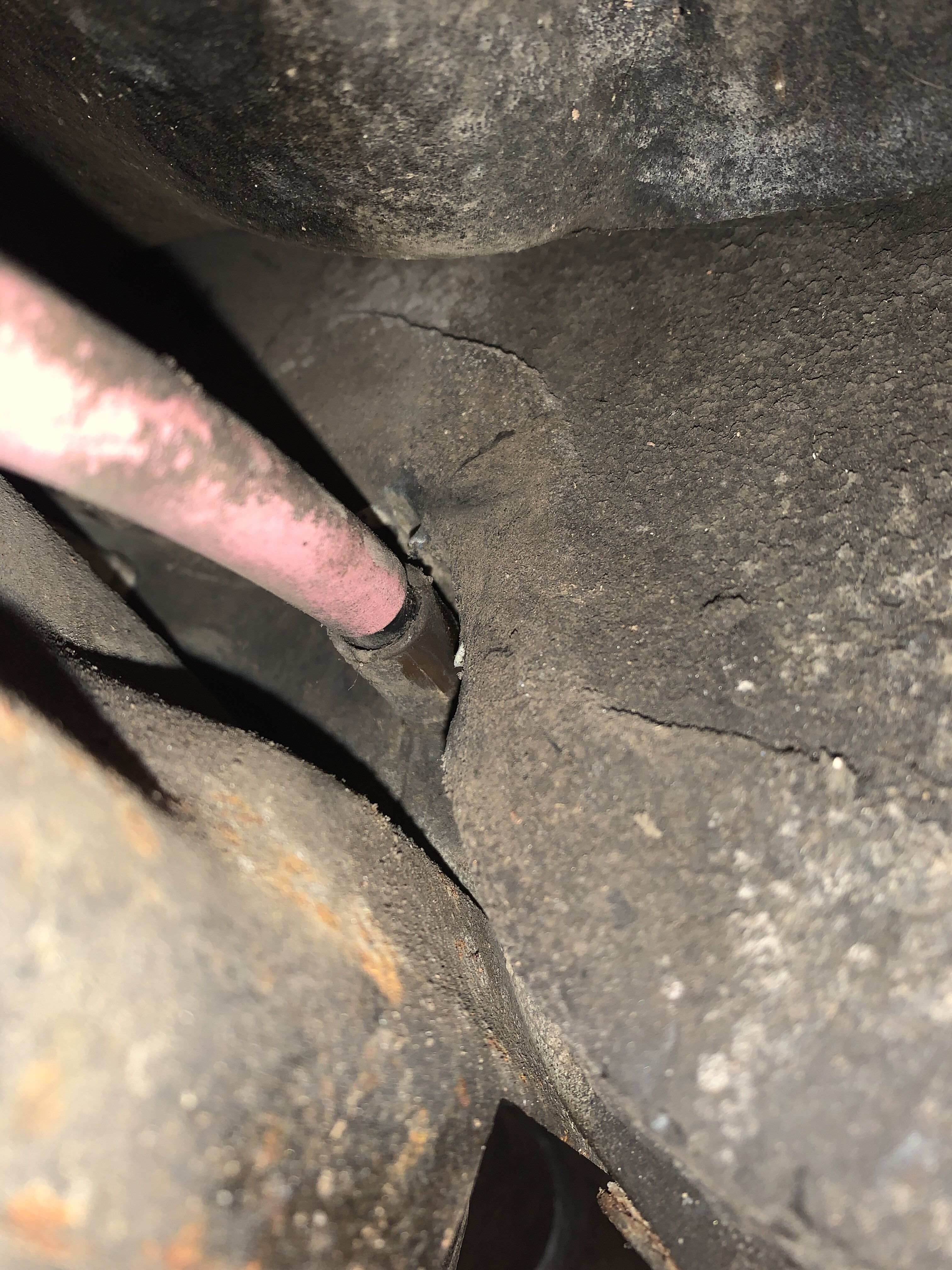

Removing the handbrake completely as the cables were shot when I did the rear Calipers.
How the hell do I remove the cable where it tunnels through? It’s pissing me off.
I cut the metal end off at the caliper end, disconnected from the adjuster end and pulled the inner cable through towards the front of the car.
I thought I would then be able to pull everything out towards the rear of the car but the outer cable is tight in there where it passed through some sort of grommet.
Why is everything such a ball ache.
How do I get it out? 😂

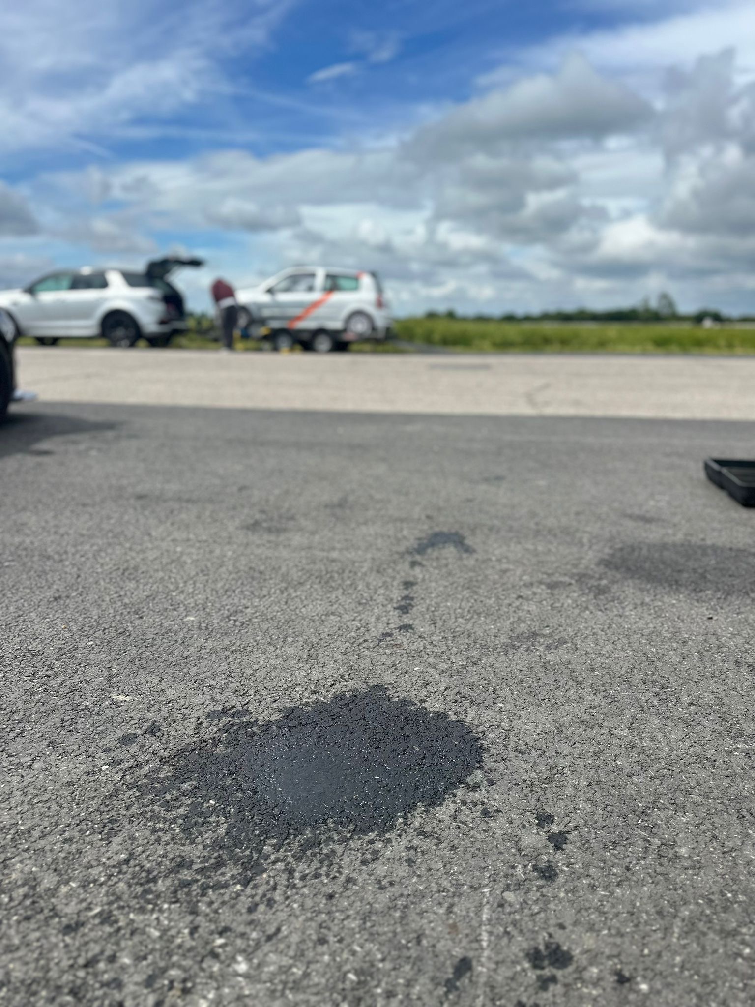

I decided to swap over to my AR1 but luckily noticed a heavy brake fluid leak from the rear beam area so unfortunately had to call it a day there.
