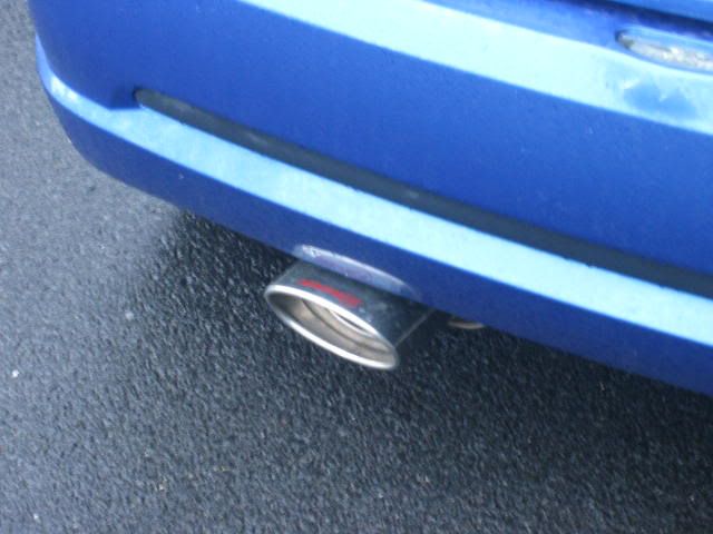

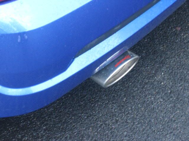

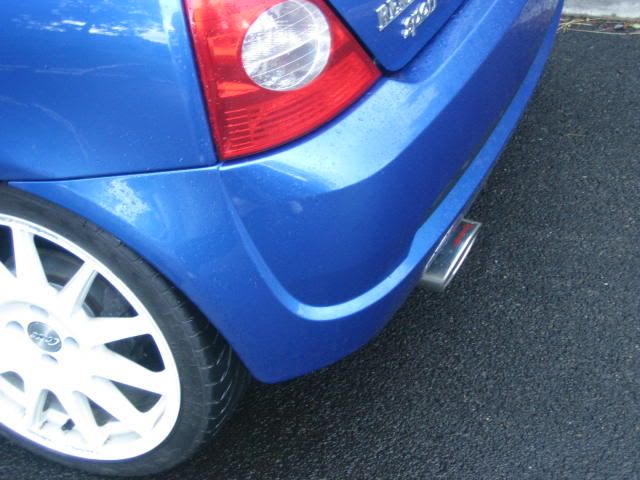

Magnex System - is it ok
  GDI ???BHP Cliosport172
You will probably find it will stick out more once its run it.
It looks about right, u would soon know if it was sitting on the p*ss.
But looks nice fella
What does it sound like? Is it loud?
[Edited by jph172 on 7/6/2005 8:13:41 PM]
  Clio 172 Cup
^^^^ lol i know :)
phoenixy: i didnt fit it - got someone else to do it
jph172 - it isnt loud, its just nice - it puuuuurrs :)
Ali
  V6, Trackhawk, GTS
Its sitting fine, i jus dont thing the oval looks rite on the 172...Matter of opinion tho! White 17s! Drooooollll!

exhaust looks nice iv always liked the look of the oval. but has anyone every cut the Oval magnex into the bumper a bit? i think it would look better IMO??
  Clio 172 Cup
^^^Yeah i think you are right - but i think it would cause problems fitting the back box, as the pipe from the backbox to the midsection rises upwards and there wouldnt be any room for it if you raised the backbox up that much
