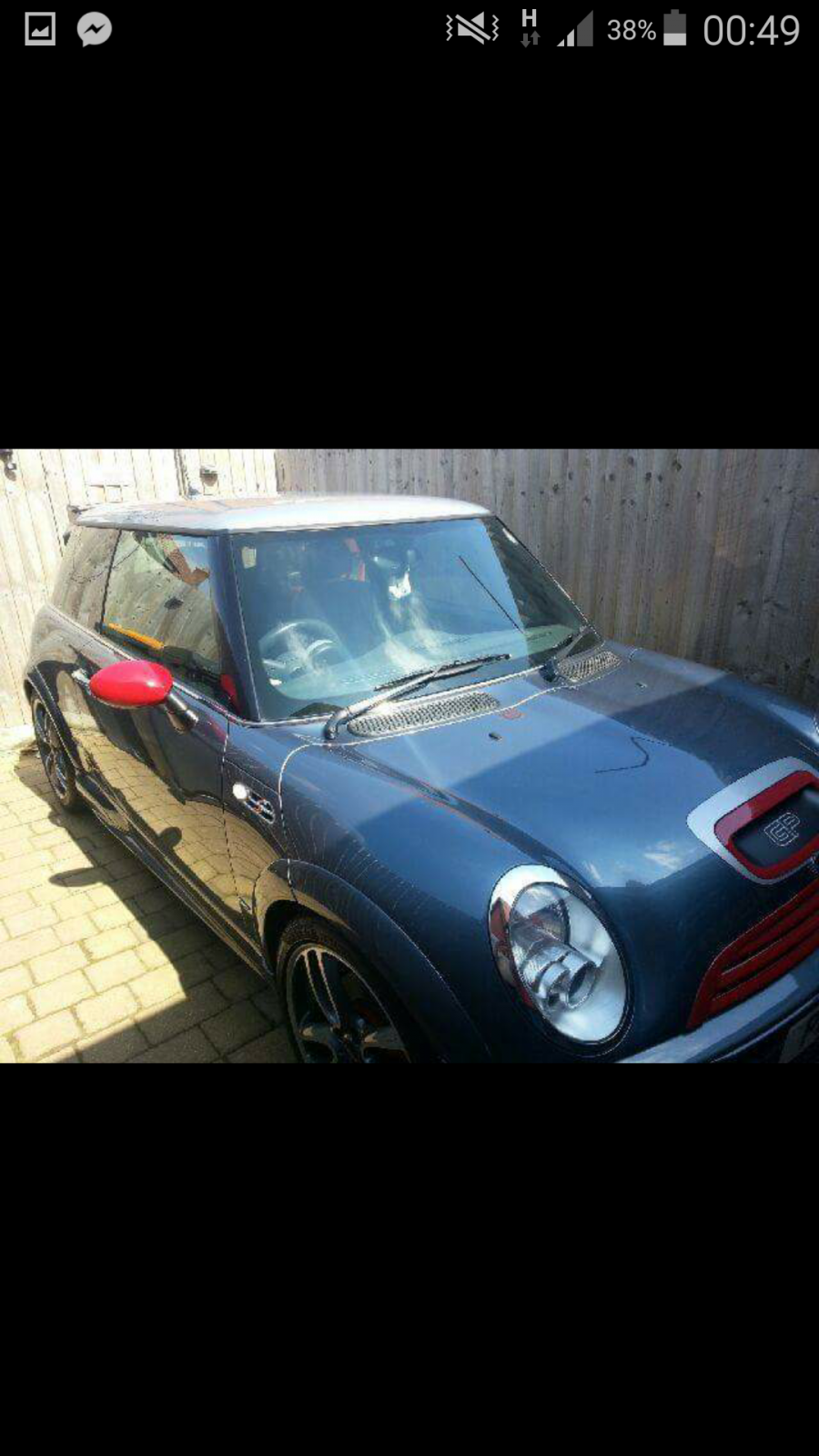

Whilst i waited for the insurance to pay out i popped down to Bedford to borrow the step fathers JCW GP to get to and from work as it sits not being used majority of the year.Loved every minute of using it, great handling car especially with the Michelin Pilot Super Sports, got offered the car for a VERYYY good price if i wanted it.. However i couldnt bring myself to dailying it so declined the offer
Kept my eyes open for a nice tidy 1*2 which is when i saw the owner mention this one going up for sale soon so i popped her a PM asking to let me know when it was available, 2 weeks later and i got the message and i confirmed i wanted the car and would drive down that weekend to collect it.

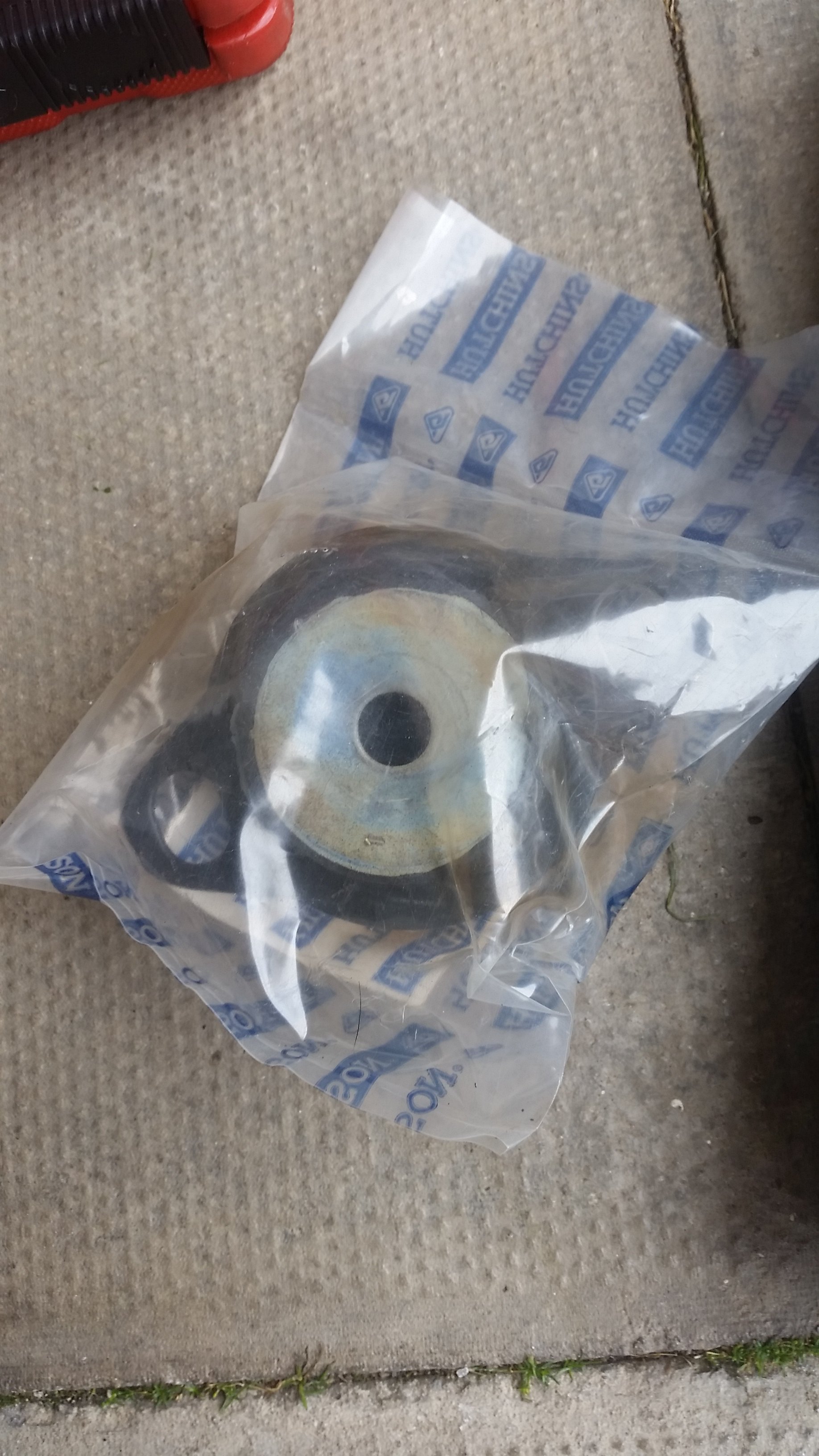

Then came Brand New Cup shocks & Eibach sportlines with New Genuine top mounts (ran them on the Cup)

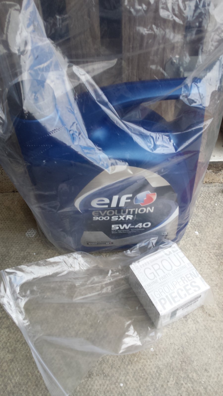

Oil & filter change using genuine renault items

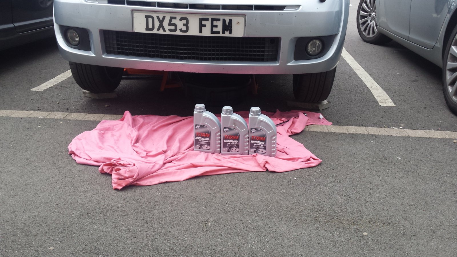

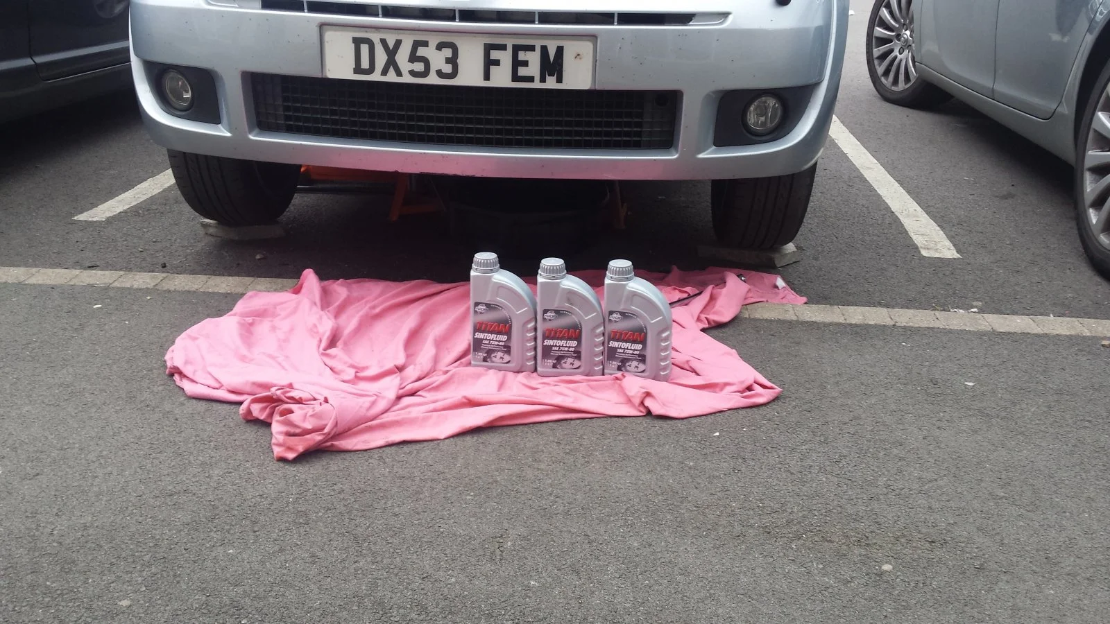

Gearbox oil change

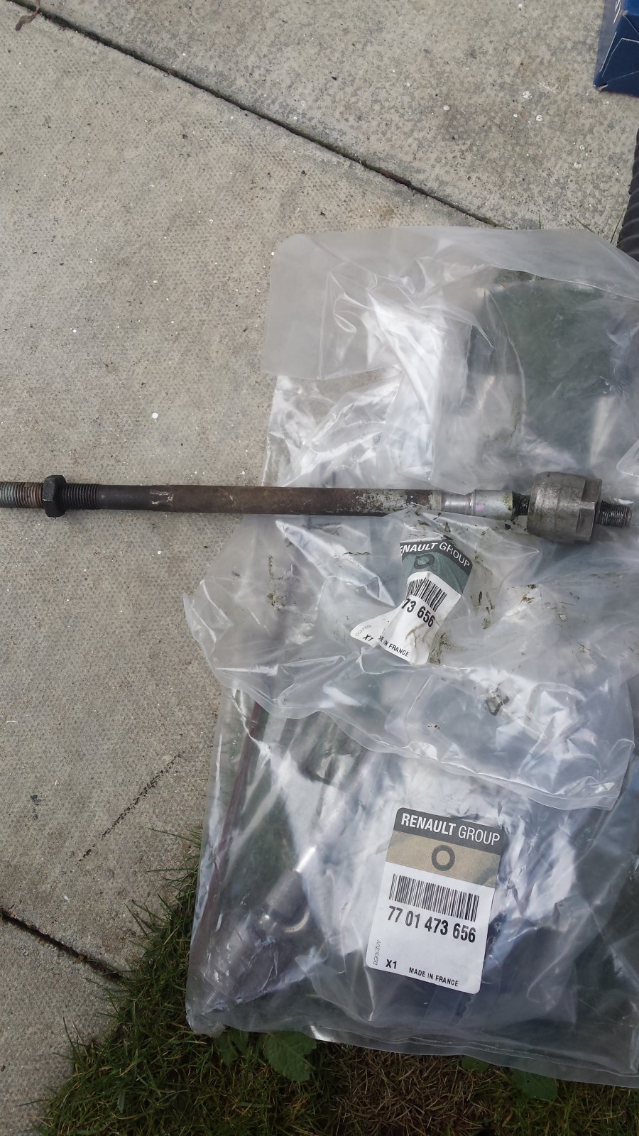

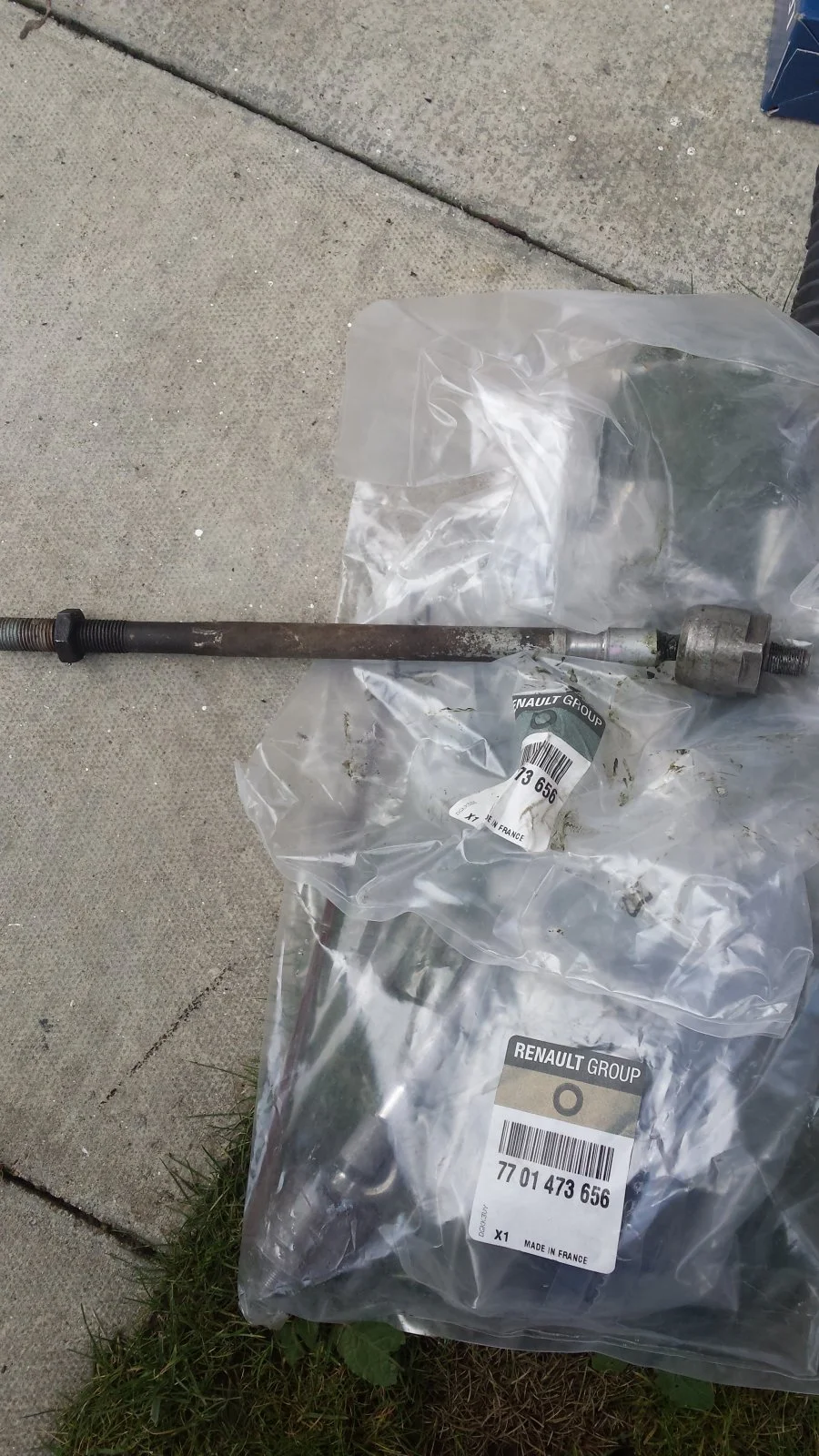

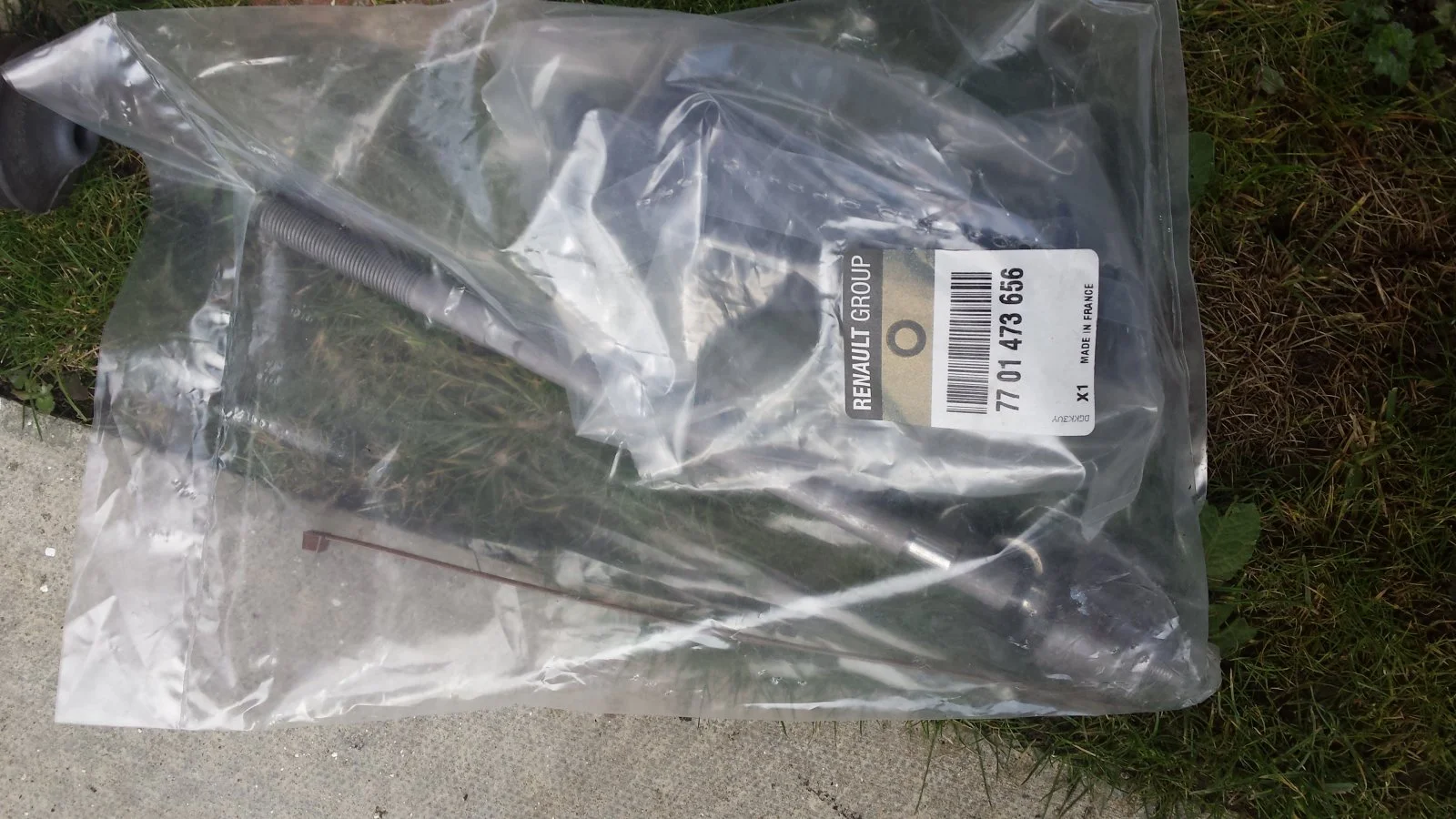

New Genuine Tie rods & Lemforder ends

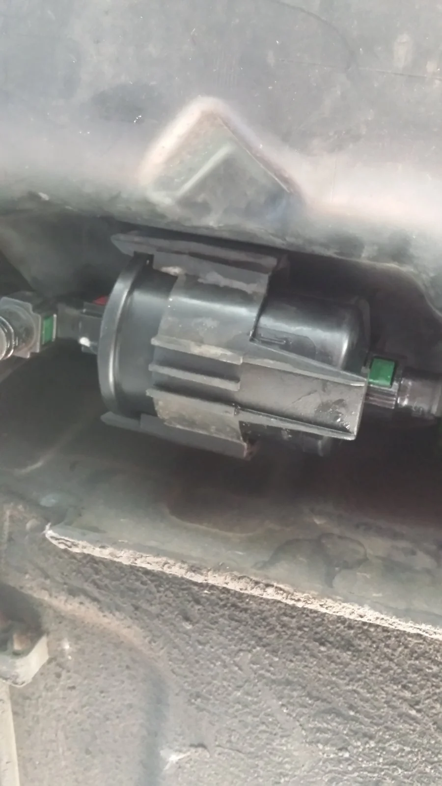

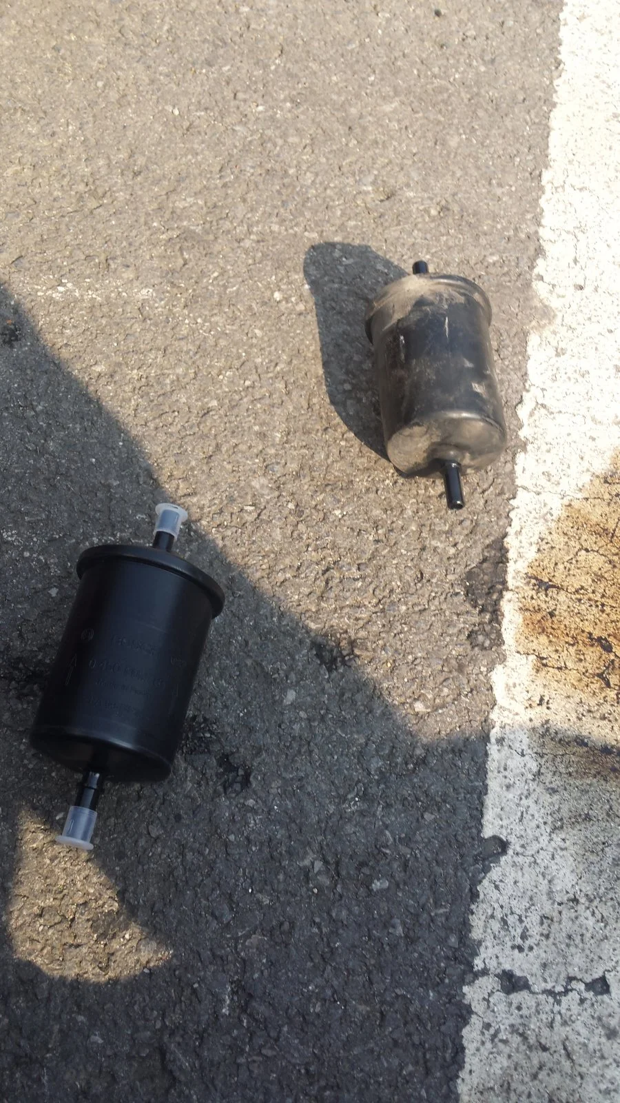

Furl filter change

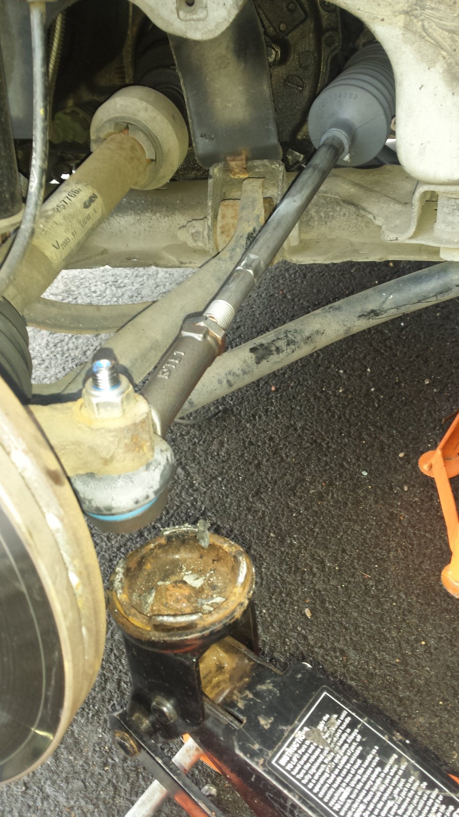

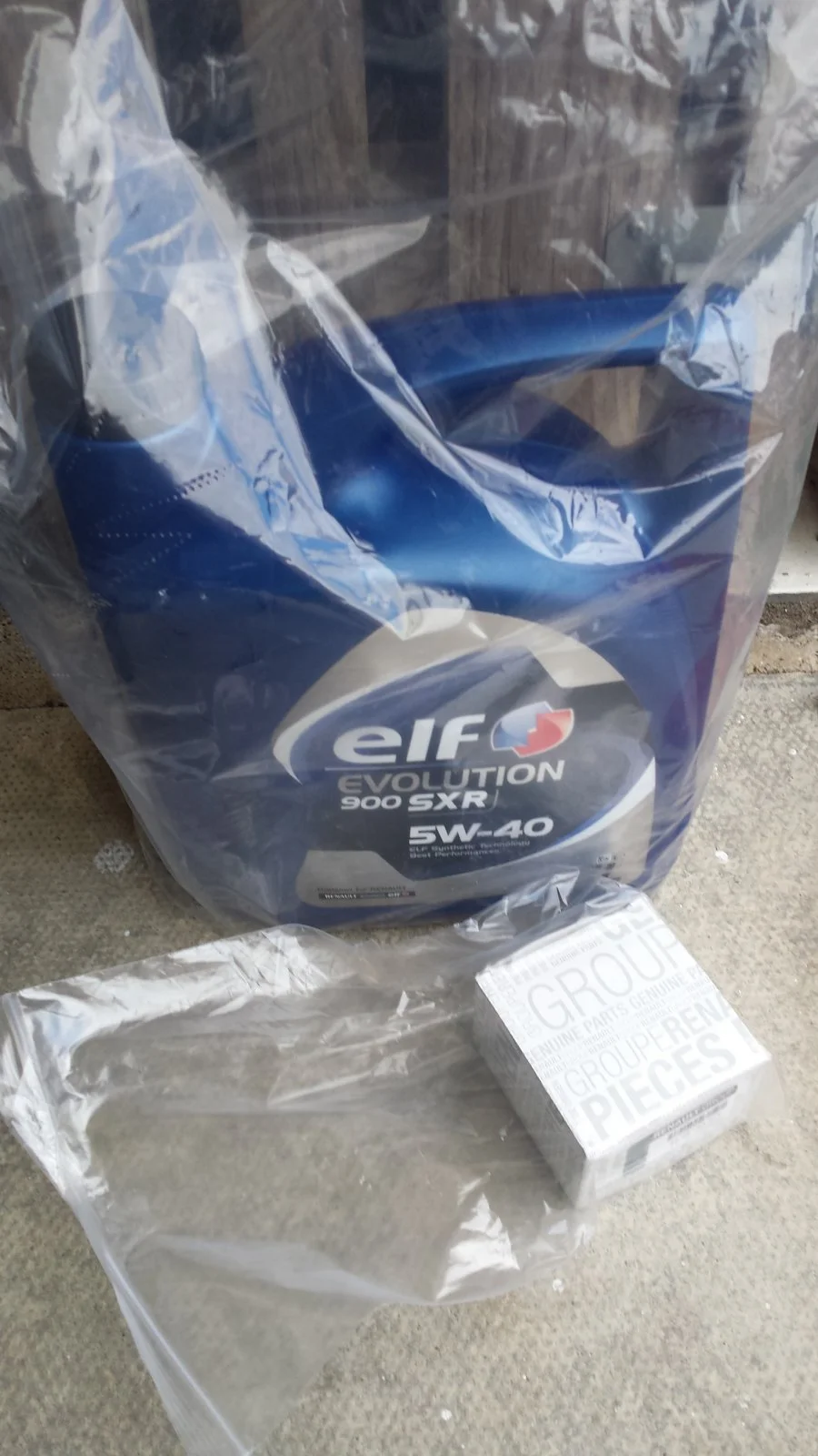

Just had the usual 6k oil & filter change earlier in the week, hopefully fitting a pair of new lemforder ball joints tomorrow after iv been into work for a few hours overtime.

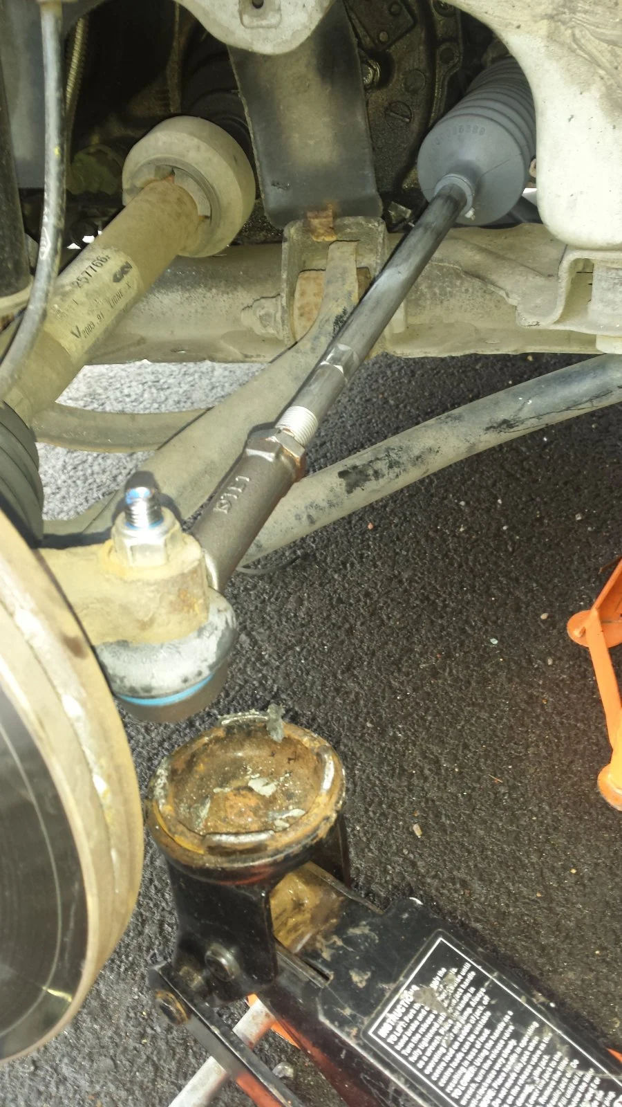

Well done the balljoints y.day and what a pain in the ass it was getting the pinch bolt out but nothing my lump hammer didnt sort.

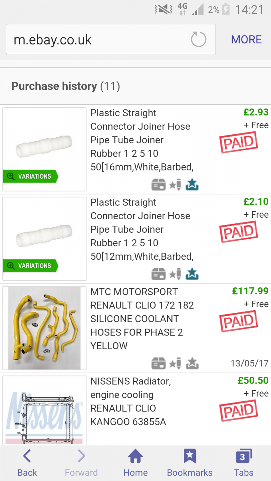

Ordered this little lot last night along with Mikalor clamps ready to change with the rad over the bank holiday weekend
  172

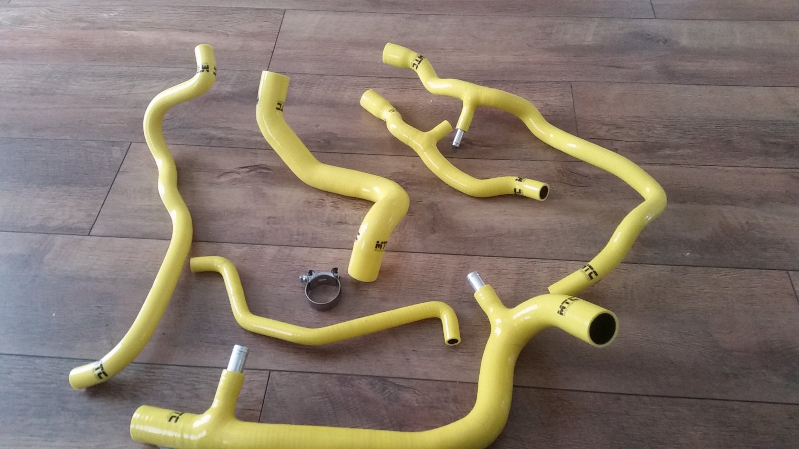

Well hoses have just arrived from MTC and i have to say they seem very good quality for the price, Mikalor clamps also came on Monday from Ramair so now all i have to do is fit them over the weekend (weather and work dependant)

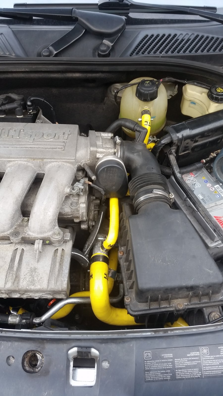

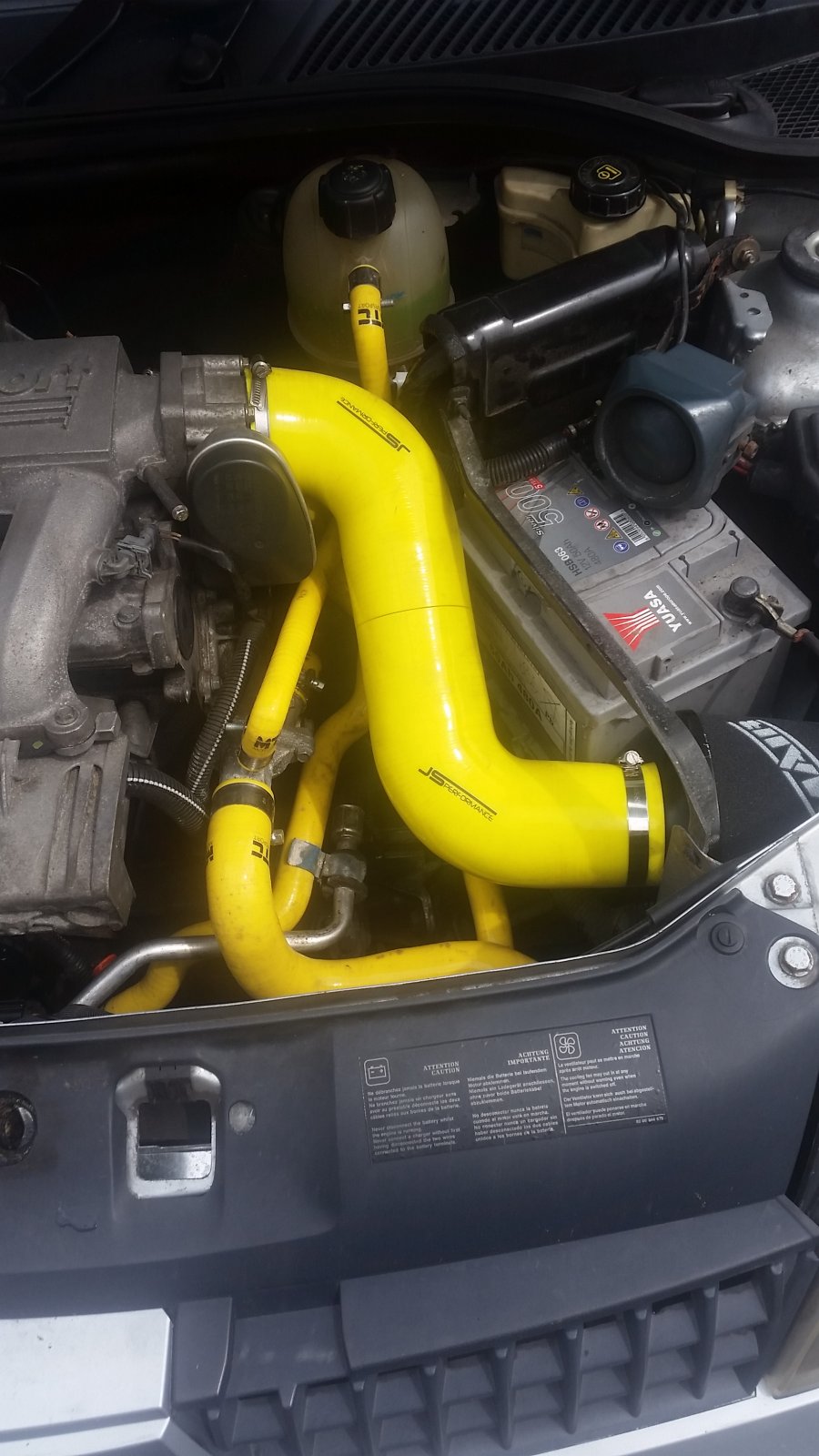

Small update, today i set about changing the rad and coolant hoses due to having a leak, didn't take any pics in the process as tbh i just wanted to get it done so i could chill.
Hoses are MTC off ebay which seem decent quality for the money and the rad is Nissens also purchased from ebay

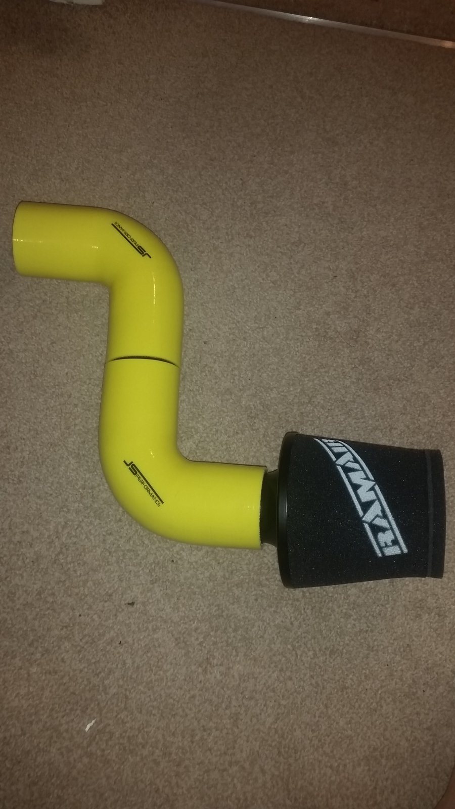

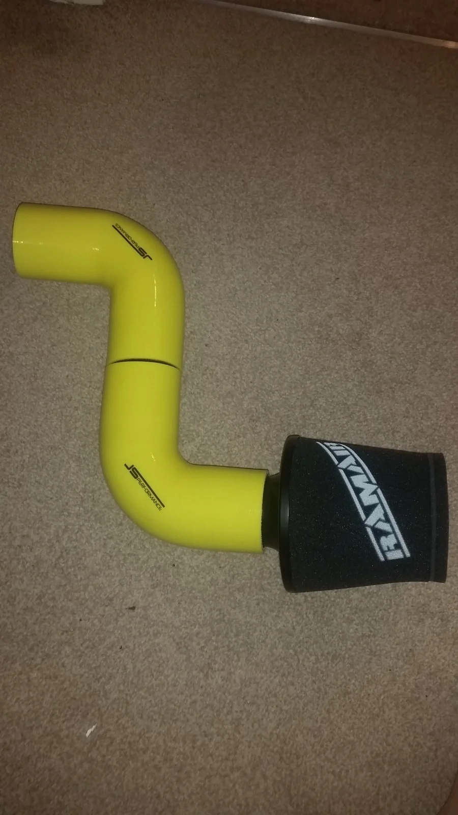

Very minor update as i havn't really done anything due to work and other things. Iv got a new gearbox mount sat waiting to be fitted but iv also decided im going to ditch the Ramair panel filter and go for K-tec nock off set up.
Parts started to arrive for the intake, just waiting for the coupler and a small filter for the breather however i may drill the silicone pipe and plumb it back into the intake (undecided as yet)

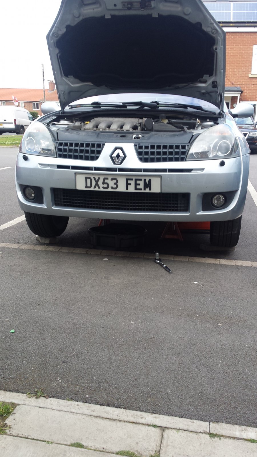

Small update, as iv got the day off work i thought id set about sorting the fatty IK.
Just need to see about securing the filter down as it moves about and is scratching the sh*t out the paint, needing to figure where im going to route my breather filter 2 also (thinking longer bit of pipe and located on the top right corner inbetween the coolant & Pas bottles

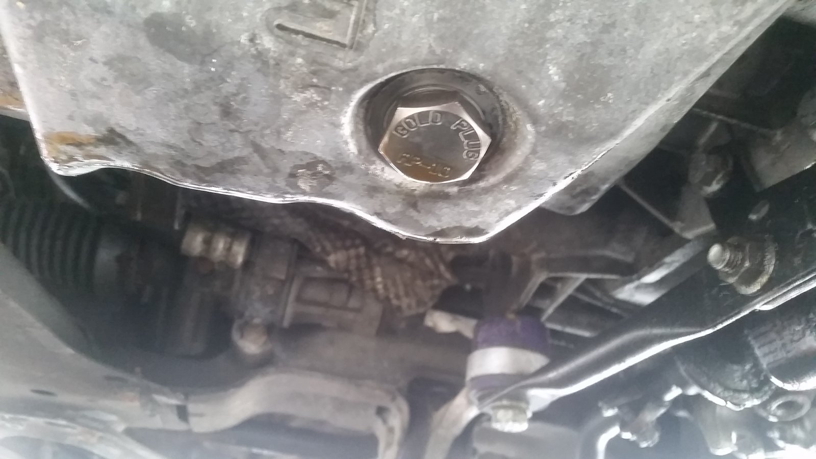

Also fitted a Gold Plug magnetic sump plug when i last changed the oil & filter

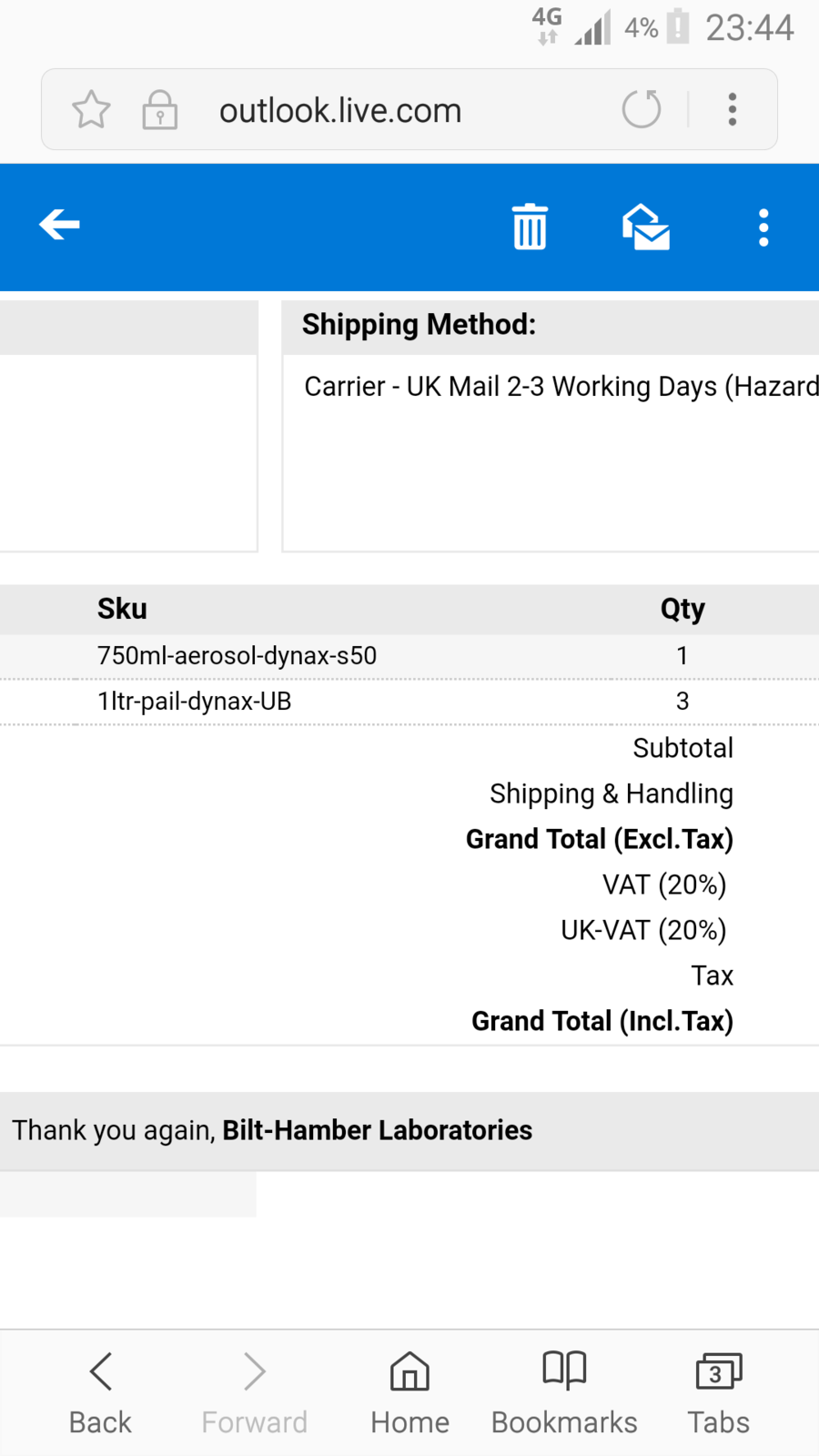

Made a little order today from Bilt Hamber for some Underseal products as i noticed the car does'nt seem to have much on as its flaking off and the silver floor pan is on show.

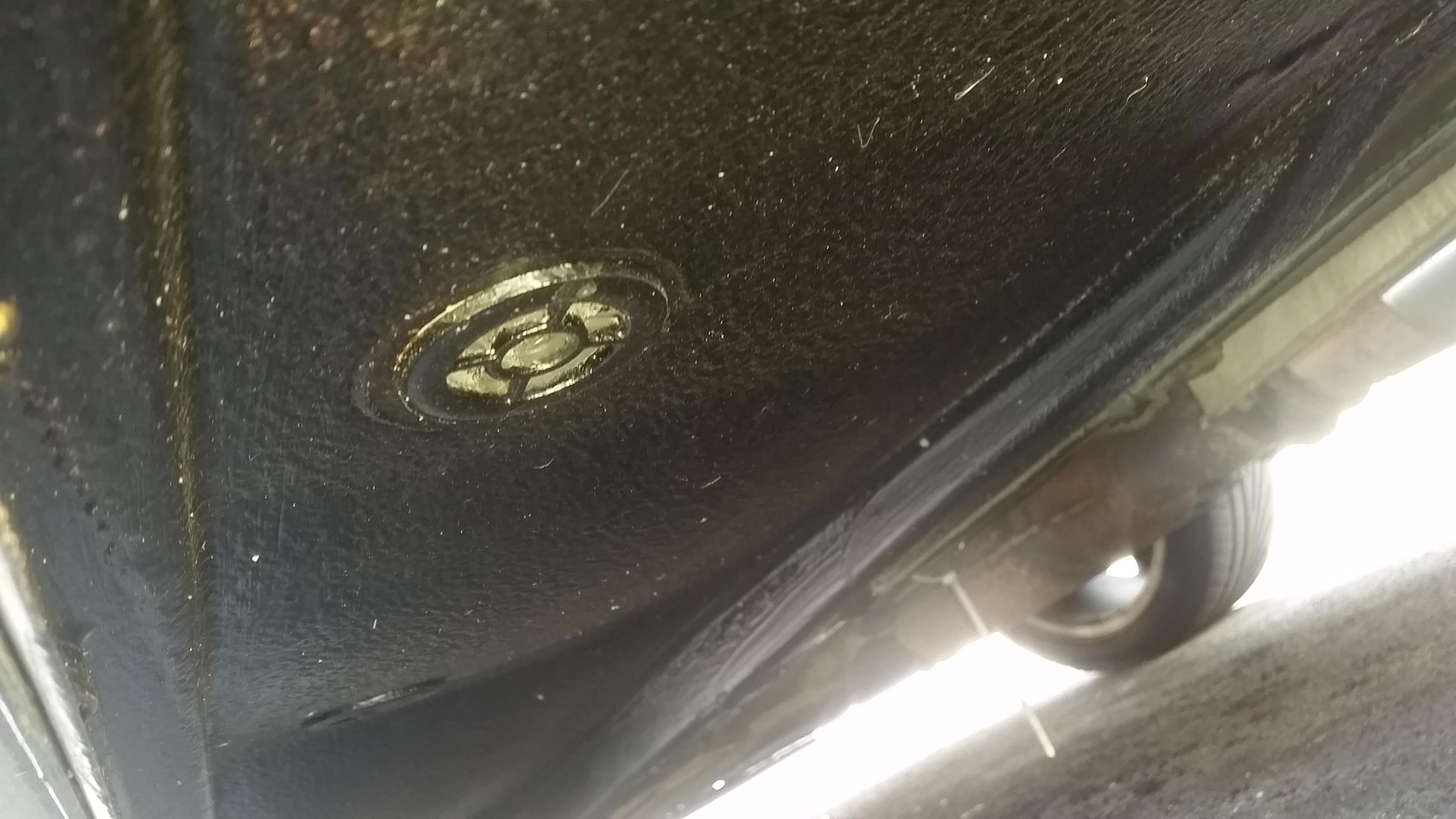

Well i decided to do the underseal this week whilst im off work so on Saturday i got the car up and gave the floor pan a good scrub with HDD Road Rage and a stiff brush and then blasted it off with the pressure washer. BiltHamber Dynax UB suggested to clean the surface with white spirit so i also done this.
Well Monday came and i decided to get under the car and give it its first coat of paint and inject the chassic etc with Dynax S50, didnt take long as i used a roller for the floor and then a brush for around the edge/ tight spots. Left 24Hrs to dry and went out this morning and gave it it's 2nd coat which should be more than ample.
Id originally bought 3LTR of Dynax UB but iv used less than 1ltr up to now so at somepoint this week im going to pull the wheels off and give the arches a good coating and also fit the gearbox mount that i have sat in the shed

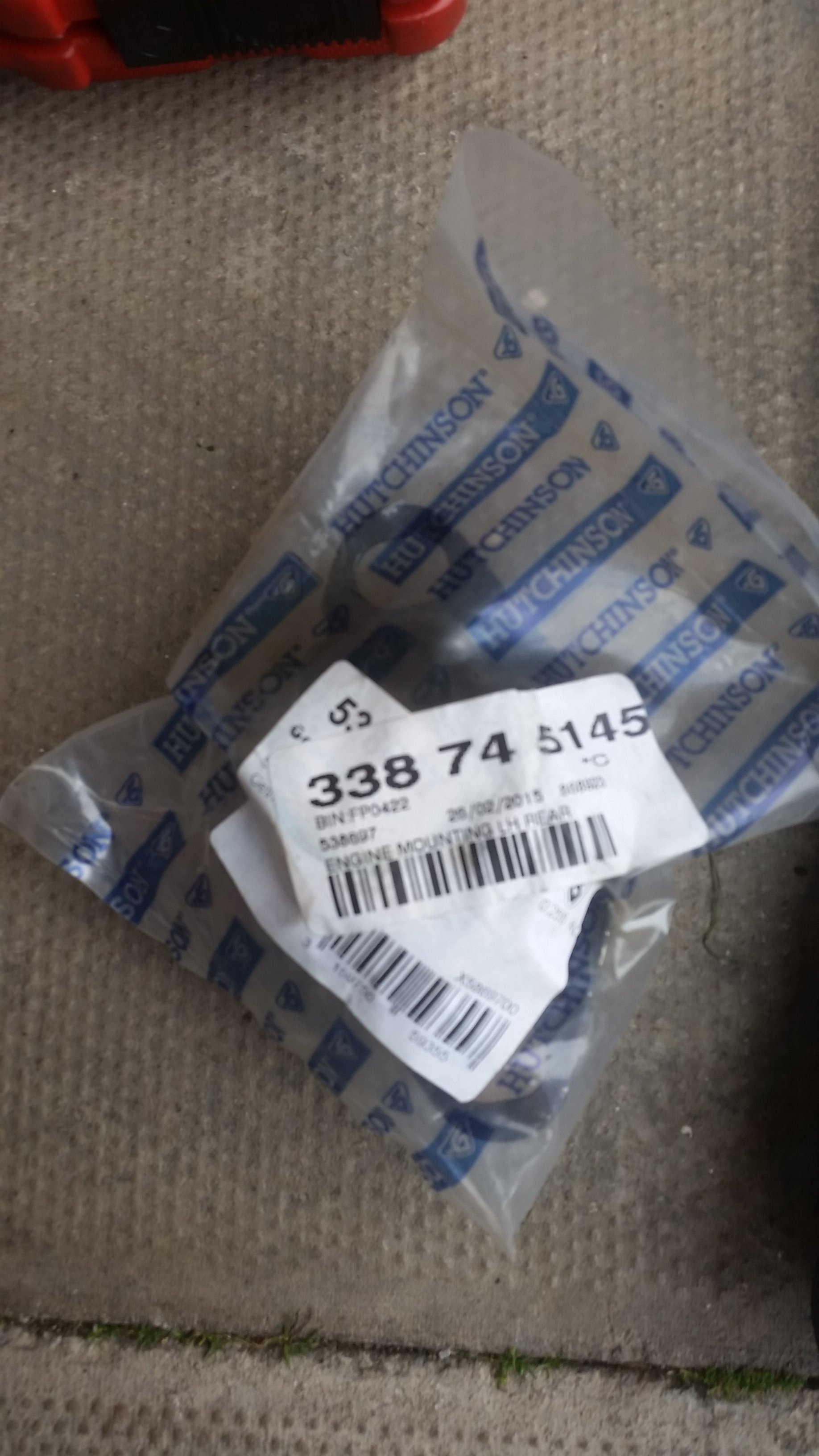

Finally got round to fitting the upper gearbox mount that iv had sat for a while, piss easy and don't really understand how some ppl struggle. The old one didn't look in to bad of condition so iv kept it in the shed incase for some reason it comes in handy.

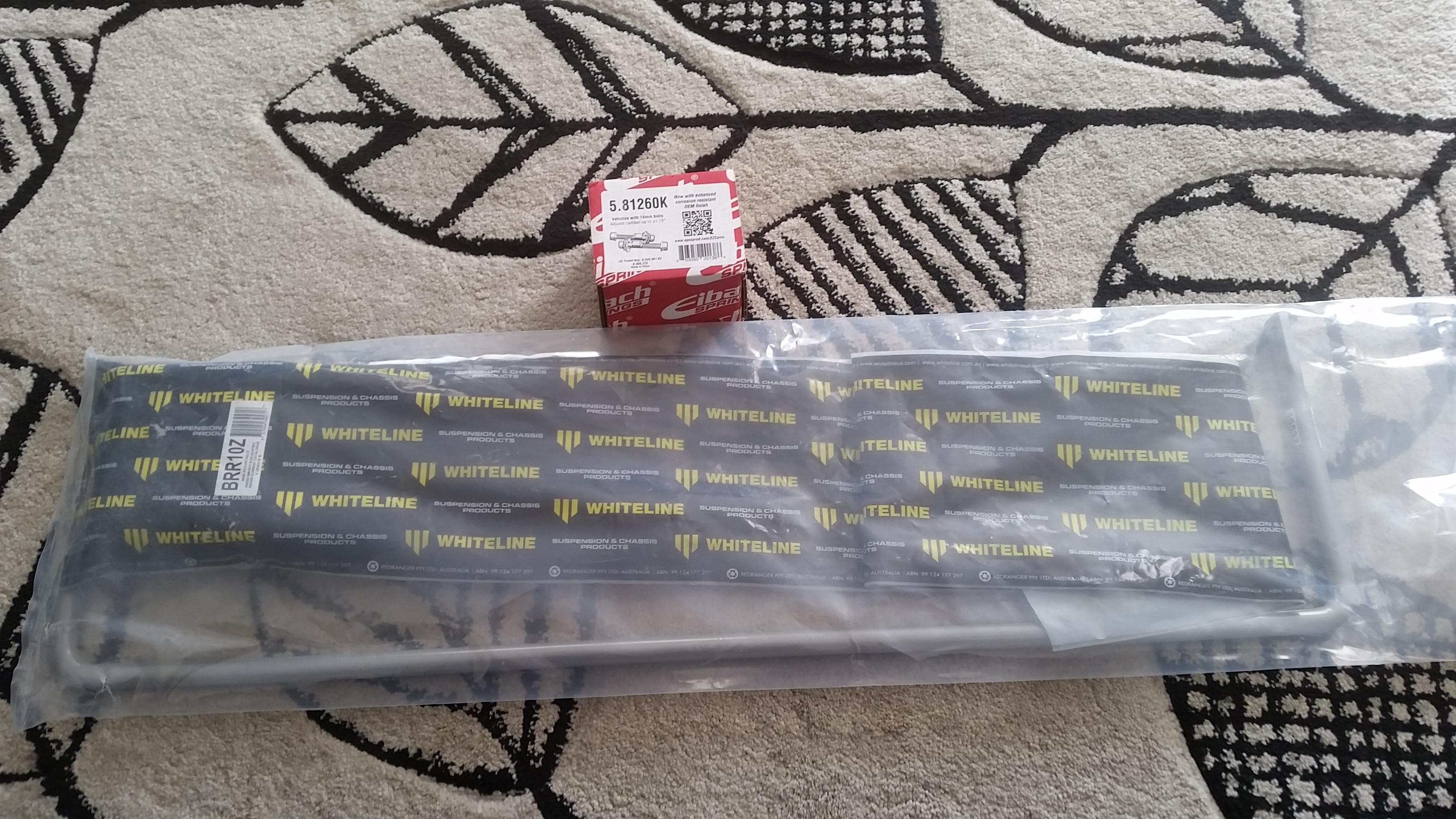

Well just put a order in with KamRacing for a Whiteline Arb and Eibach camber bolts.. Once they arrive il get them fitted straight away, going to buy a Gunson camber gauge so i can set it best i can till i have time to get it set up properly
  172
Camber gauge arrived today, arb & camber bolts will be here monday so aslong as its dry i'll set about getting them fitted.

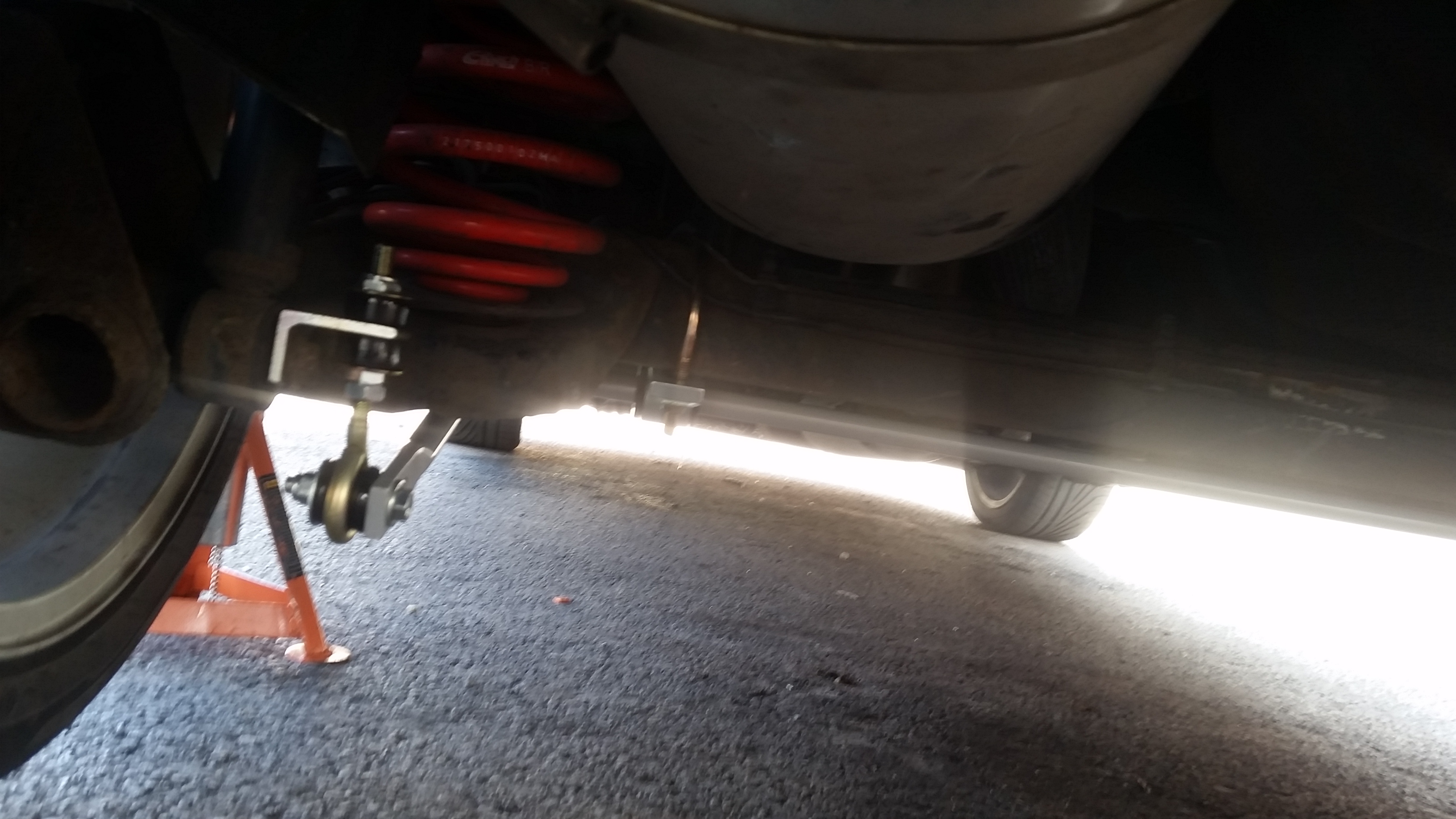

Ended up fitting the ARB and discovered Another genuine rear shock to be goosed, thats 2 now in the space of 14months. Just a slight misting of oil so il be replacing these with Koni adjustables this time around
Also a quick pic of the underseal now its dry (crappy pic)

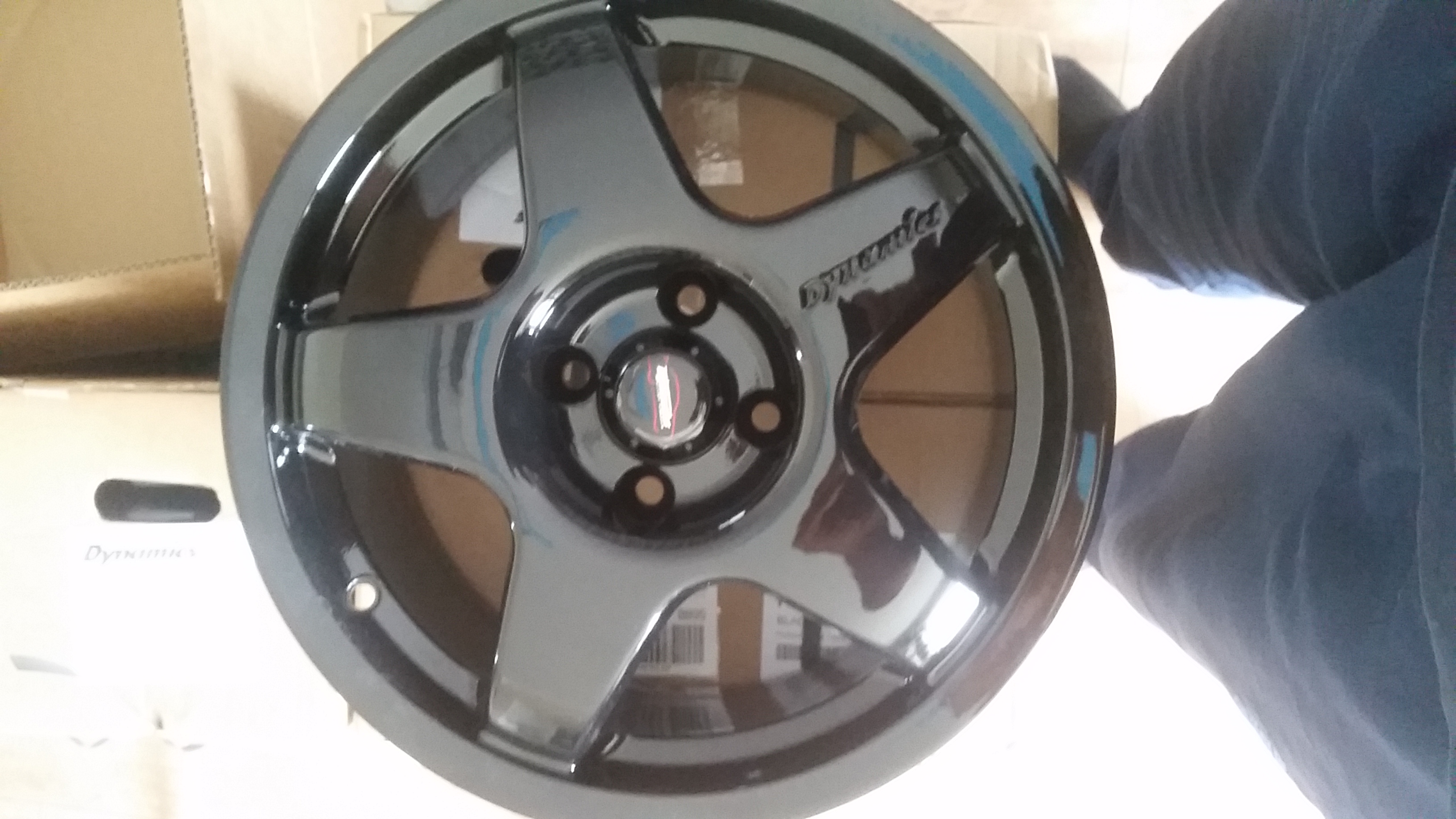

Well after a quick phone call on Wednesday i was told they had NO white Pro Race 3 in stock and that it was a website error, could have them made for me in around 3weeks or he could do me Gloss Block for the same price (Bearing in mind GB were listed @ a higher price) so i said yes to the GB.
Just awaiting delivery as i type this within the next hour, still havn't decided on tyres yet so still need to get them ordered before i can even think about fitting the wheels. Will be ordering a new set of wheel bolts & lockers for when i do fit them
  172
Well after waiting all week they finally arrived, didn't realise they'd come with wheel bolts aswel so just need to buy a set of lock bolts.
