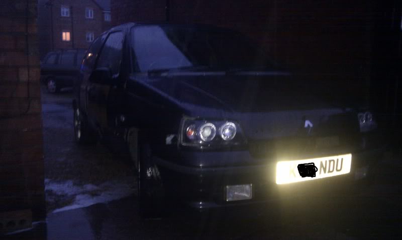

After 5 years with no car, ive finally bought a new one to restore ready for spring time.
ATM it aint very pretty to look at, filler/primer all over the place, bumpers hanging off and the interior ( or lack of) needs some serious TLC.
Its been sitting in my cousins garage for a few years now just been messed with every now and again, but he couldnt really be bothered with it, so i made him an offer and he took it, it now sits in my back garden ready for me to attack the bodywork and make it mint. Currently it sports 2 bucket seats, a dashboard and thats it.

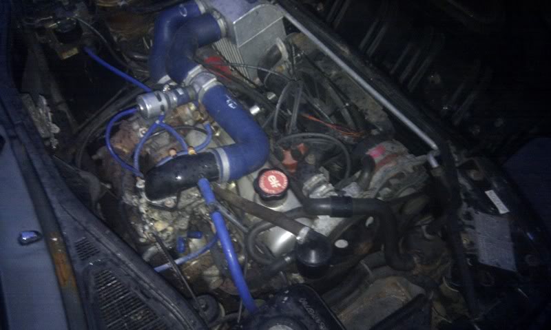

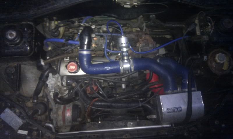

So, spec;
Its a K plate 1.4RT shell, very minimal rust which is good
its running a R5GTT engine (phase 2 120bhp)
KTR camshaft and rebuilt bottom end
Brand new R5GTT intercooler
dumpvalve
PAS removed for weight saving
janspeed (?) straight through exhaust with decat
Corbeau Forza Sport bucket seats
Aluminium custom plates for doors/rear quarters/foot wells
Black Angel Eye Headlights
Battery mounted in the boot

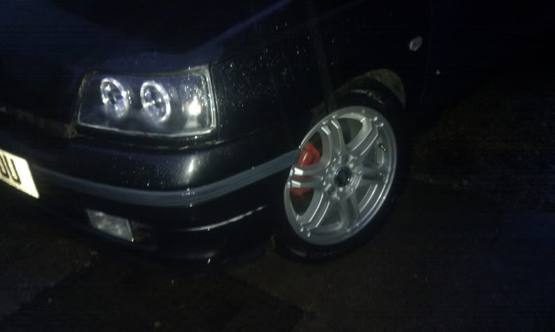

195/50 15" alloys with new tyres all round
samco(?) hoses
lowered 55mml+ front/80mm rear
it has an induction kit and uprated brakes but i aint had chance to look at them yet to find out what they are
sorry for the s**tty phone pictures, it was raining and dark, ill try get better ones up if its dry tomorrow
