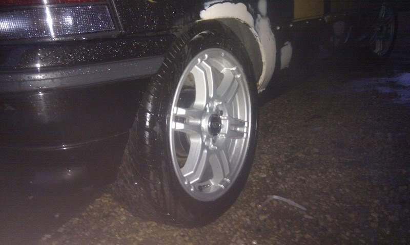

195/50 15" alloys with new tyres all round

sorry for the s**tty phone pictures, it was raining and dark, ill try get better ones up if its dry tomorrow

back wheels finally back on and off axle stands! wheels are gonna be powdercoated gloss black eventually

Coming on real well mate.
(Those wheels are utter pony!! Get some standard ph2 valver wheels on there)
  Punto/Clio GTT
i agree mate, but they came with the car, brand new, brand new tyres all round too, done about 5 miles on em
i think when theyve been powdercoated black you wont really see em tbh, thats what im hoping anyway lol
