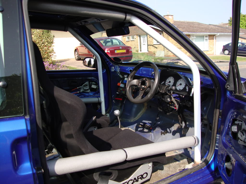

Going to get a new throttle body to see if that cures the fault. On a plus side I got a big weight saving :)
I shed 31.9 kg's :) by removing full dash setup and front door cards etc.
Car was weighed at bang on 960kg by Northampton Motorsport on intercomp corner weighting scales before the removal of the extra bits. Car now weighs 928.1 kg's
My previous power to weight ratio was 198.96 per tonne
Now it's 205.82 per tonne which is a gain of 6.86 bhp for free :) fiberglass panels to come next to help get it too the magic 8** number.

The passenger airbag unit weighed 3.5 kg. hefty thing weighing as much as the dash metal brace. In just going to remove the bulb in mine :)

That looks quite tidy with all of the metal frame removed! From memory when the dash was taken out of my track car, you had all sorts of wires and bits being reflected off the window, it got a bit annoying when driving. Might be worth spraying the metal work black and cover over the wires with black tape or a small cup racer style dash?
  182 Cup/Mk5 Gti
Re: My 172 Cup (T5MY G) 191.2 Bhp & 173.4 Torque
Thanks mate. Will be going through the loom once it's running again. Going to wrap the whole lot like I did in my Saxo.

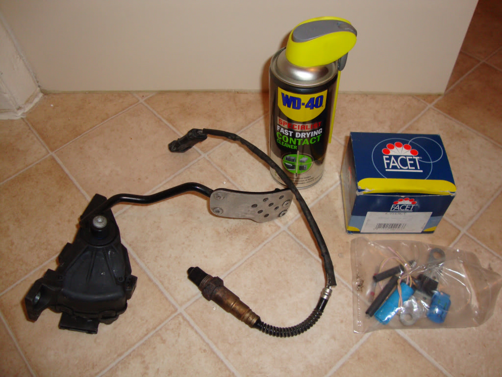

Well still having trouble after fitting the tb. It now wont even register the throttle pedal ;( it also dosent register any revs on the speedo. when turning it over now its a b**ch to start. getting soooo fed up with it atm. Ordered an upstream lamba sensor and pedal from kat @ renparts. Really helpful and great price :) also ordered a febi crank sensor and will be pulling all of the fuses/relays out to check/clean. All will be tried this weekend and hopefully will get it running properly again!!!

Got some contact cleaner aswell for the fuse box/fuses. Going to go over everything!!!!!

Today I fit the new crank sensor/loom, pedal and checked every relay and fuse and cleaned all of the them. Would resetting the codes make it start and idle properley?
