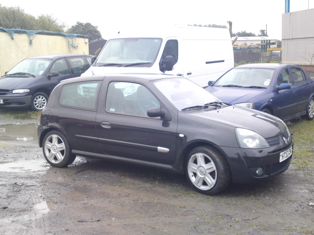

When i first bought it
coiles, Plate and detangoed
And the Turinis

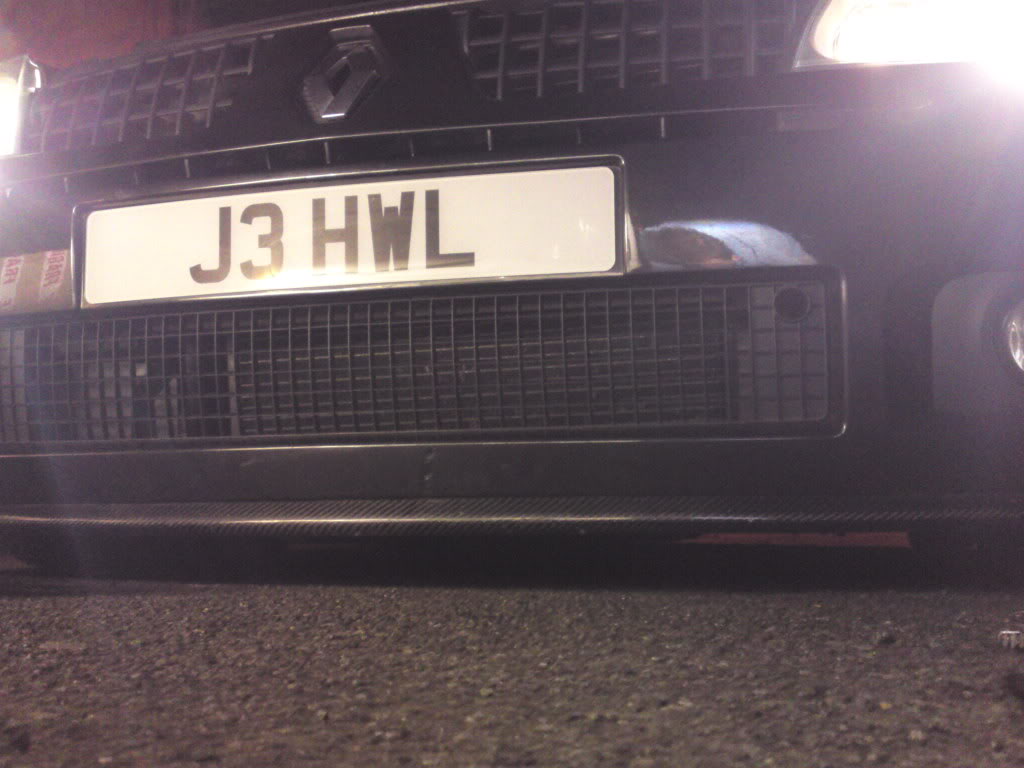

Carbon Splitter

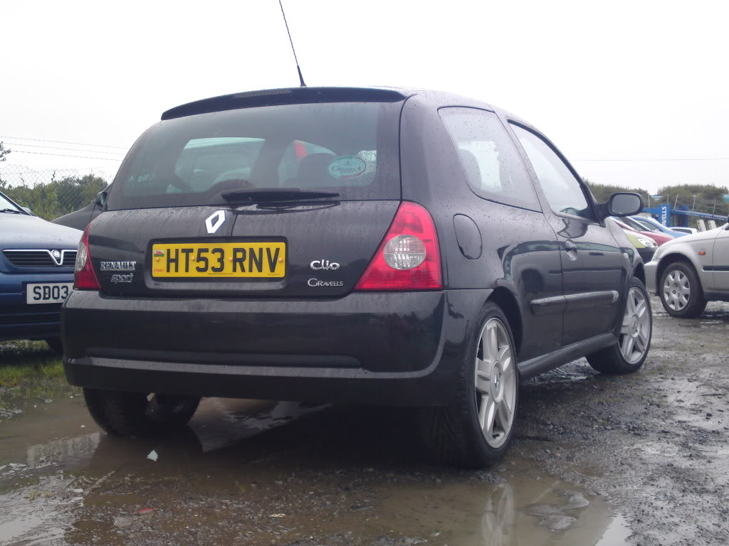

the badge it just says 'gravells' where i bought the car from
next plans are to remove that badge now ha

Mine was originally at Gravells in Kidwelly. I bought it off a guy in Gorseinon (sp?).
The Gravells badge is horrible mate, do what I did and hair-dryer it off.

Gravells Kidwelly? ;)
Thats them mate, the cowboys themselves! You local?

Yeah mate up the road in Swansea ;) and use a hairdryer to heat the glue up and glently slide a credit/debit card behind the badge.any remainig glue should wipe off with some Autoglym tar remover.
Howell
  172, Crafter, A3
i'll have to keep an eye out for you then, saying that one passed me on the motorway this morning and got off at the neath junction, wernt you was it? lol
ah cheers buddy, i'll do that this weekend

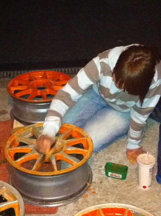

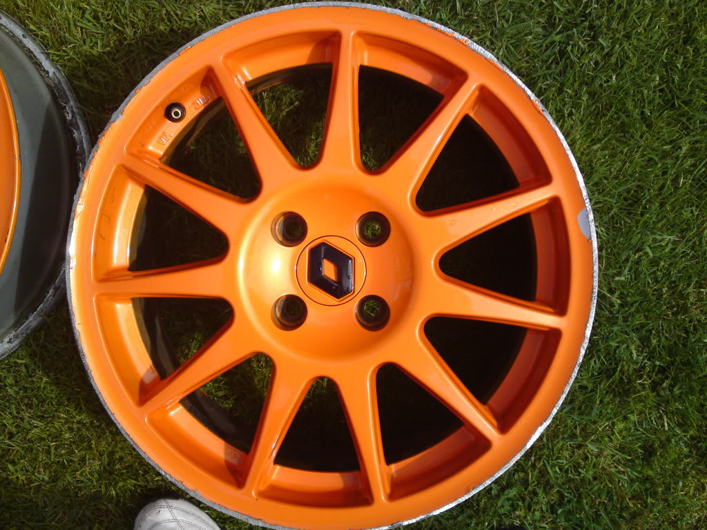

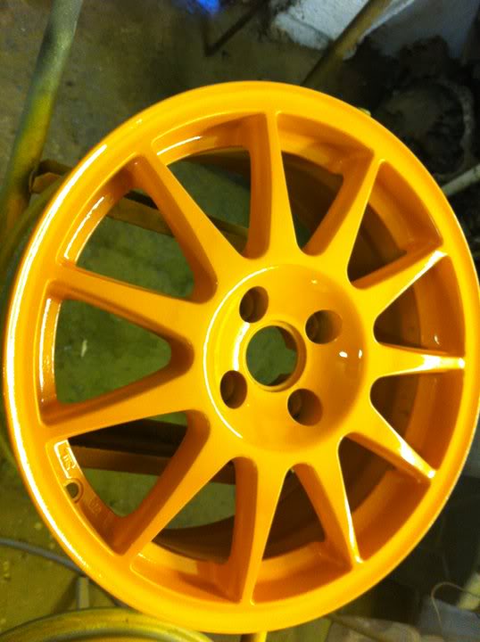

thought i'd post up some photo's of the wheel from start to beginning
when i first bought the car i decided orange wheels were what i wanted
due to being skint at saving at the same time i found some orange turinis on ebay 8 months later.
picked these up in june, lovely drive upto london to pick them up
as you can see they were kurbed, pretty pretty badly.
so i started stripping the original paint with nitromorse
even the mrs helped out!
after a week of trying i give up and started looking for easier ways of doing it. ended up filling a container with thinners and putting the wheel in and brushing the paint off, simple!
so we started off with a yellow basecoat, did consider keeping them this colour
and here's the final finish

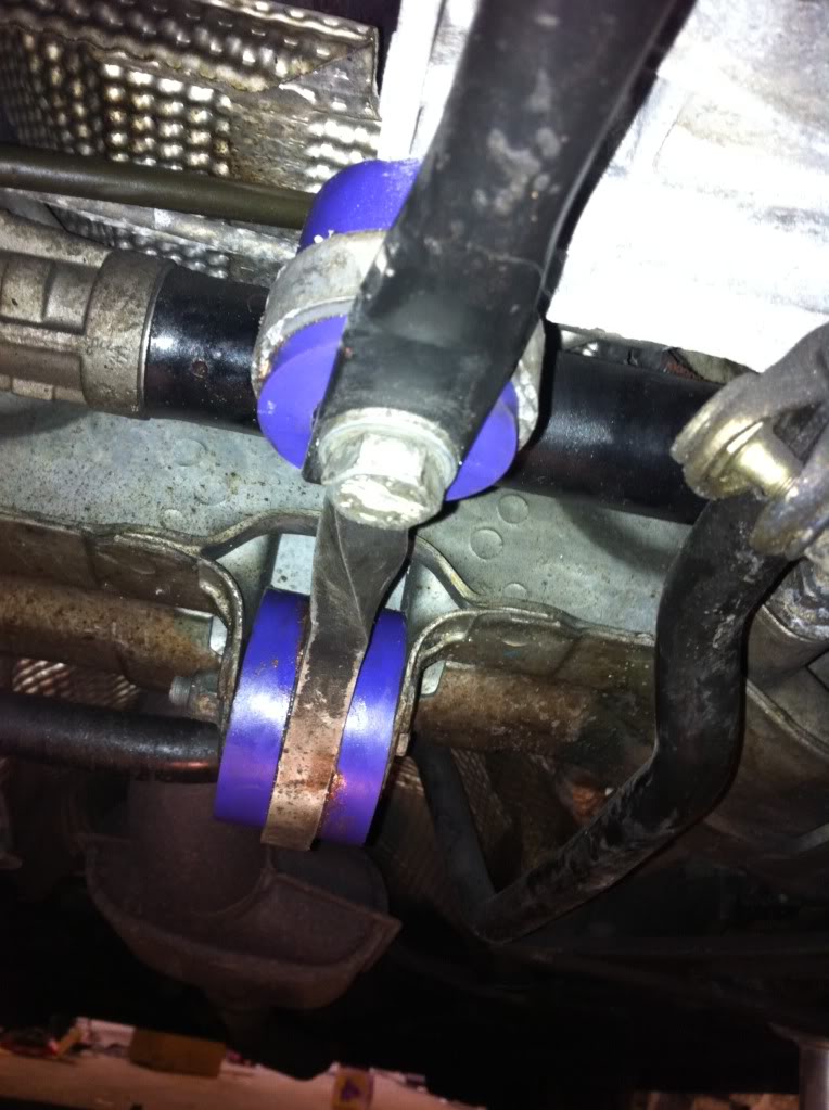

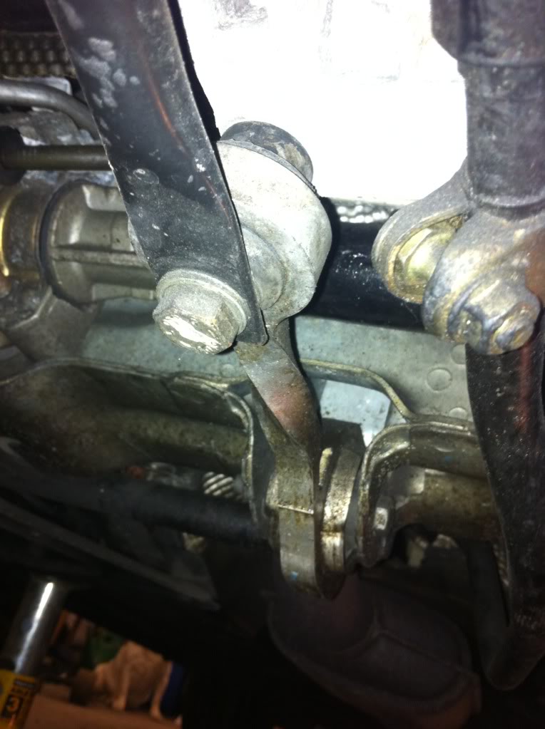

well not much has changed since i last updated but i fitted the dog bone bushes the other day
Before
After
and as it stands now

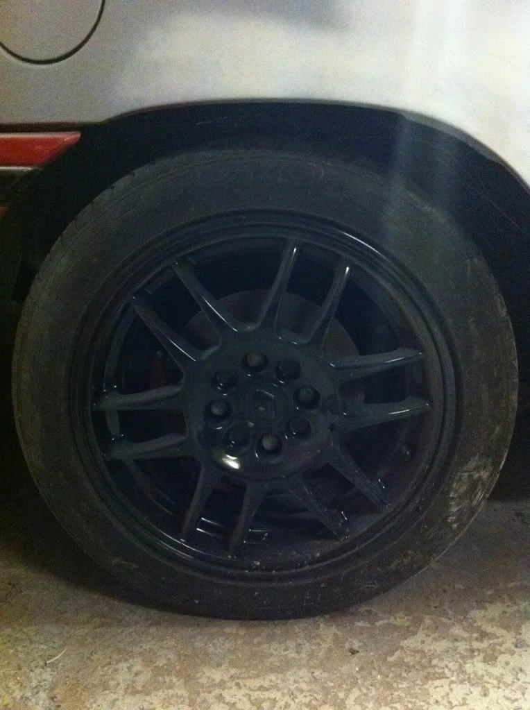

oh and i bought these yesterday, track wheels! not sure what colour to go though?
