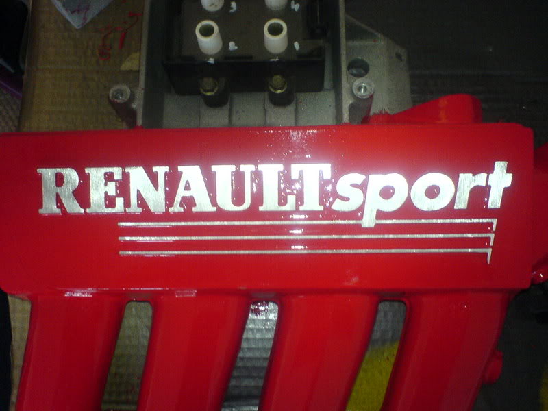

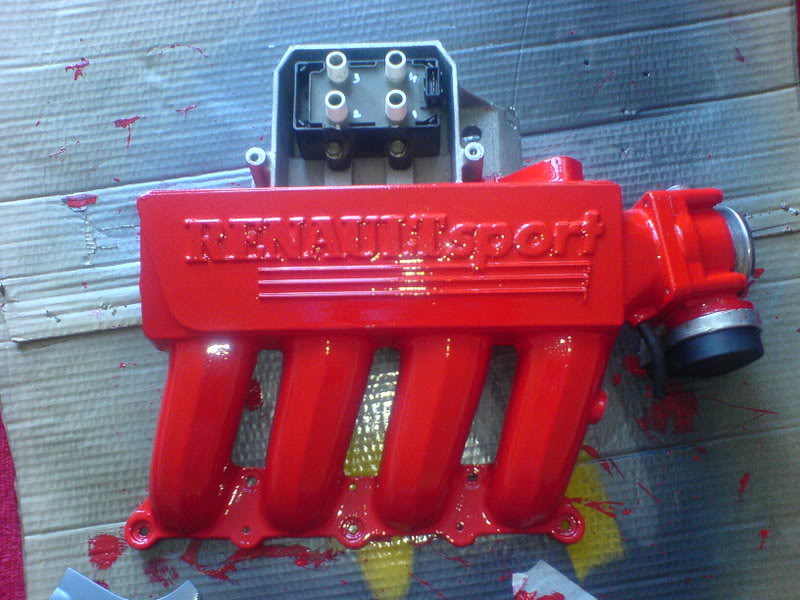

I've taken the coil pack off...seems ok to me, no moisture or anything, like that. How easy is the inlet to remove??

Its easy to take the inlet off... just a couple of bolts and some sensors that need unplugging.
the manifold is easy mate, check ur leads as well they can rub on the back of the inlet manifold and arc out. manifold from the elbow from the throttle body, remove the coil pack there 2/4 10mm bolts under it or around there, remove the plug and breather from the thottle body dont think you need to disconnect from the inlet but if so it 4 10mm bolts and then the bolts along the front of the inlet disconnect the pressure sensor and anything else attached manifold off.

Right...got me mani off, checked the leads and the spark plug chamber/holes, nothing out of the ordinary. Gonna leave the mani and coil pack inside over night and see if it makes any difference??? :S
being an impatient sod, i decided to put my car back together...as all looked well and dry...still the same, so i'm guessing the coil pack is fcuked??
