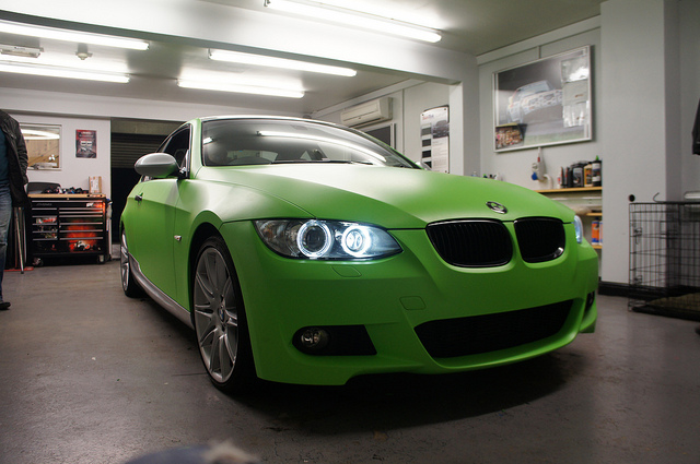

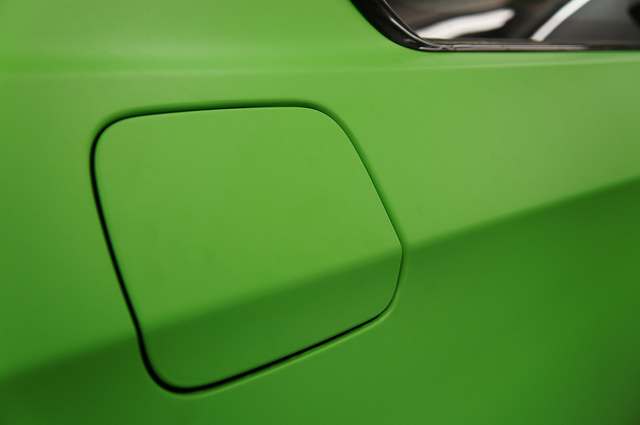

My first attempt at wrapping - LIME GREEN BMW 335D!
  Megane R26

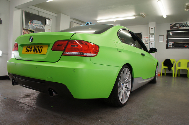

Excuse the silver wing mirrors, skirts and roof - wheels are being painted too!
DSC05056 by RussZS, on Flickr
DSC05062 by RussZS, on Flickr
DSC05072 by RussZS, on Flickr
DSC05070 by RussZS, on Flickr
DSC05077 by RussZS, on Flickr
Russ.
  Megane R26

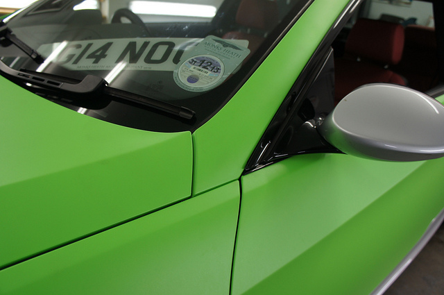

Thank you :) We did it under tuition from one of the best in the country at his place in Mansfield.

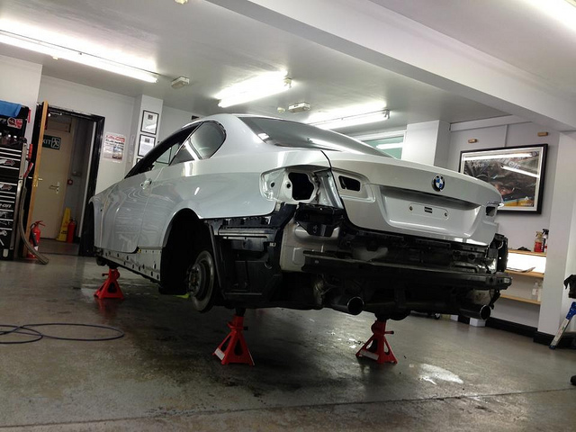

It was a full strip first - this is the result of 3 days worth of work!!

It was three of us working on this with two tutors so pretty intensive for 3 days.
Taking it apart was about 3 hours - not as difficult as I'd assumed it would be, but this will obviously vary from car to car. We then spent some time on other films and colours practicing before starting to work on this as its over £20 per metre!

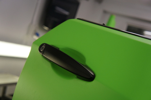

Doing it properly really does take time, as does cutting away from panel edges properly leaving enough film to wrap around the edge and critically doing so in a very straight and uniformed way. Then there's the smaller intricate bits which were all done perfectly such as the washer jet covers, tow bar covers, door handles (2 pieces), door shuts etc.
Sure, you can do a bonnet in under an hour, but they are extremely straight forward. Bits like the rear plate number recess were done in two parts - upper piece first (around the lighting for the plate) then the other piece covering the rest of that panel - you can't stretch it enough and keep it looking consistent to wrap into the entire recess. To then cut that overlap line over the underlying film (and of course paint) takes real precision and skill and can't be rushed.
Paul who trained us said he'd quote 2.5 days for this car normally and he's been doing it for 4 years.

The Hexis film which we're pretty much exclusively going to be using is for 10 years - this is against film failure and colour degradation.
In terms of the install itself, this is largely down to the company doing it. I've seen some real bodged jobs in my time, with cuts being made into panels/clearcoat, cuts too short so that you can see the underlying colours on panel edges from where a company hasn't removed bumpers, wing mirrors etc and all sorts of other gremlins. There was a wrapped car on a famous tuning companies' stand at a big car show last year and you could SEE the tar of the lower half of the doors which hadn't been removed - anything we touch will have a FULL 'detailing decon' first - so IronX, Tardis, Clay then the relevant film makers prep product - without entirely clean paint, the film won't last long, especially around those critical panel edges and corners. The other key is cleanliness as the adhesive is built into the rear of the film and is statically charged, so ANYTHING between the peeled film and panel will get stuck to the film and can't easily be removed. Some people claim to wrap outdoors…!!

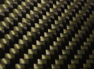

I seen a Gold Ed30 bonnet wrap in CF, it was amazing mate, it was shiny and had that kinda green weave through it. I honestly thought it was real. Amazing graphic they used.

Was this the Hexis 30000 range Russ, Satin Kiwi?
Yep that's the one matey
Real thick material though so a difficult one to work with for our first attempt - the thinner stuff is much much easier to cut.
Any pics please bud? It's difficult to find a nice carbon fibre material - the 3M one looks horrible and resembles poor uncoated CF. It's hard to find a reputable glossy CF which resembles clearcoated CF - it would look much, much better on most installs.
Gally
I'll try and dig out the guys number mate, it was honestly like proper bare weave that had been lacquered. I was actually going to image it and fire it up here just to show folk and forgot.
It was in for a wheel refurb and a few other bits and it really stood out against the Grey.
It was similar to this...
More than normal black carbon fibre.

One part that isn't possible to wrap is the door hinged area so that's still silver, but the rest of the sill area is now green
