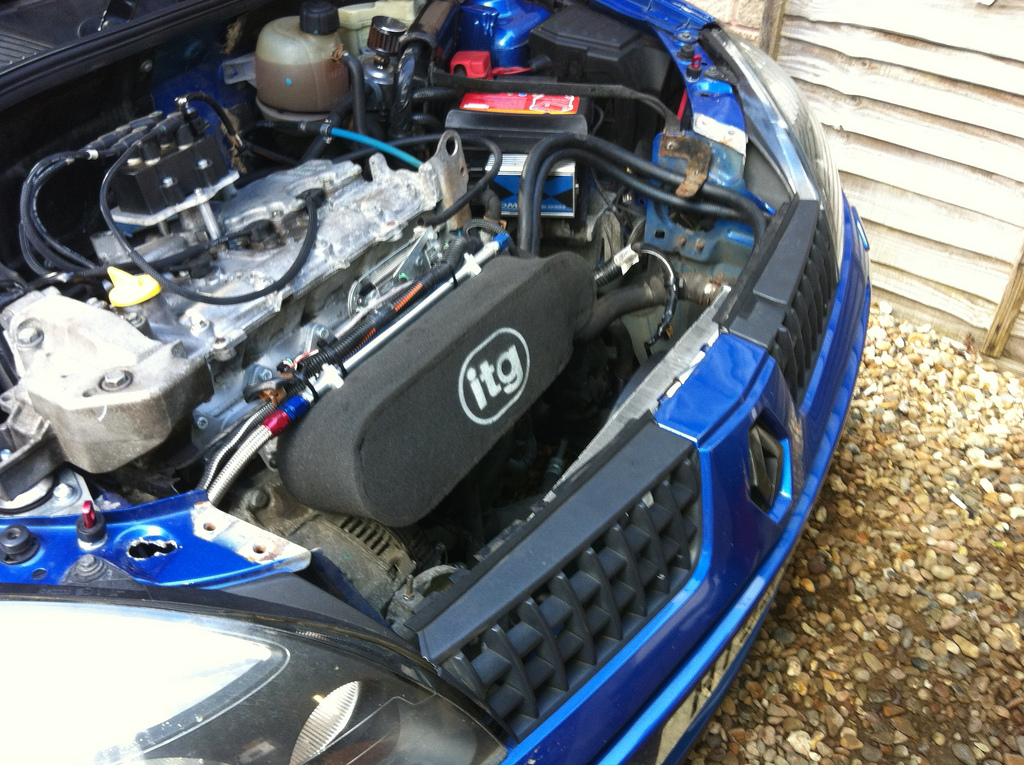

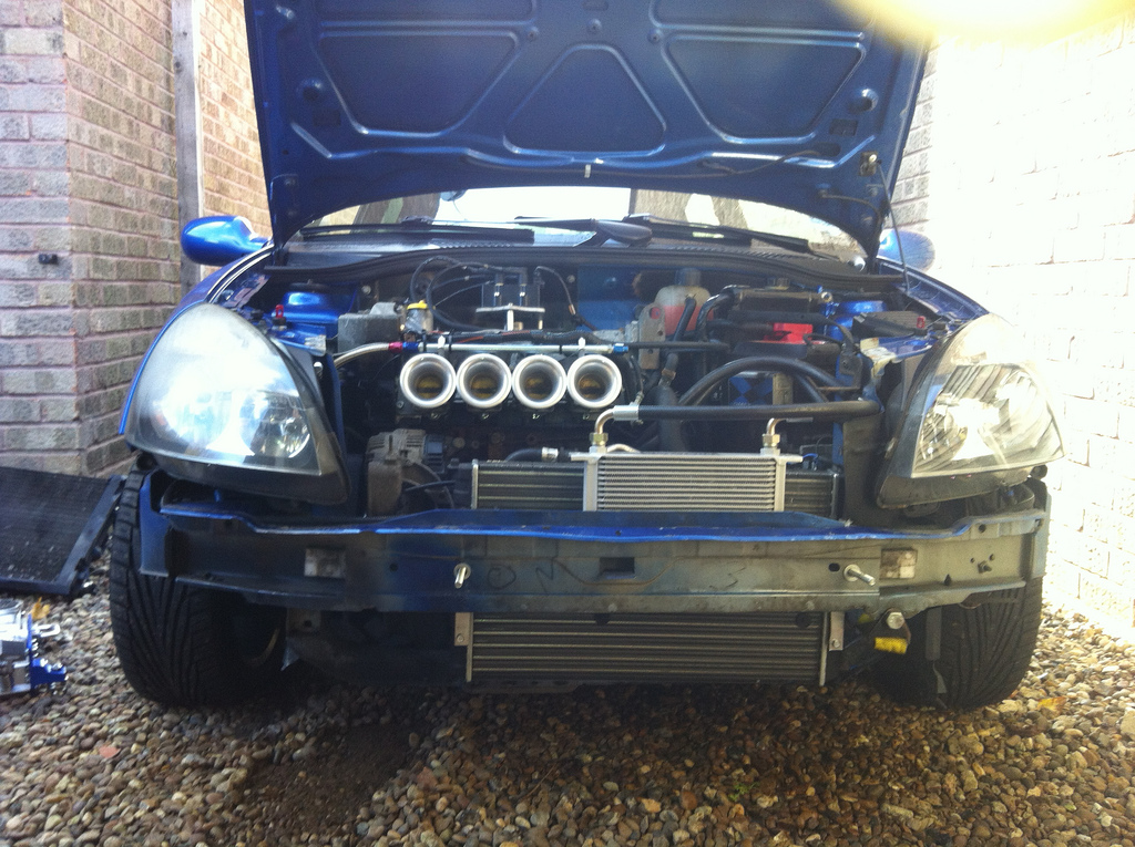

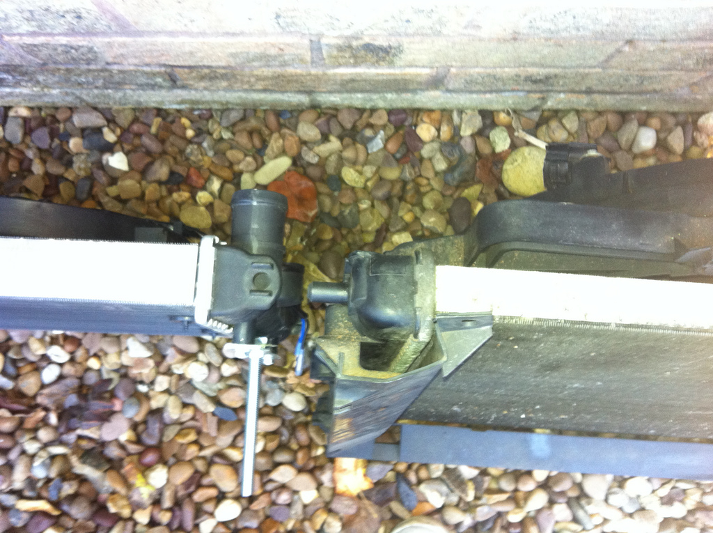

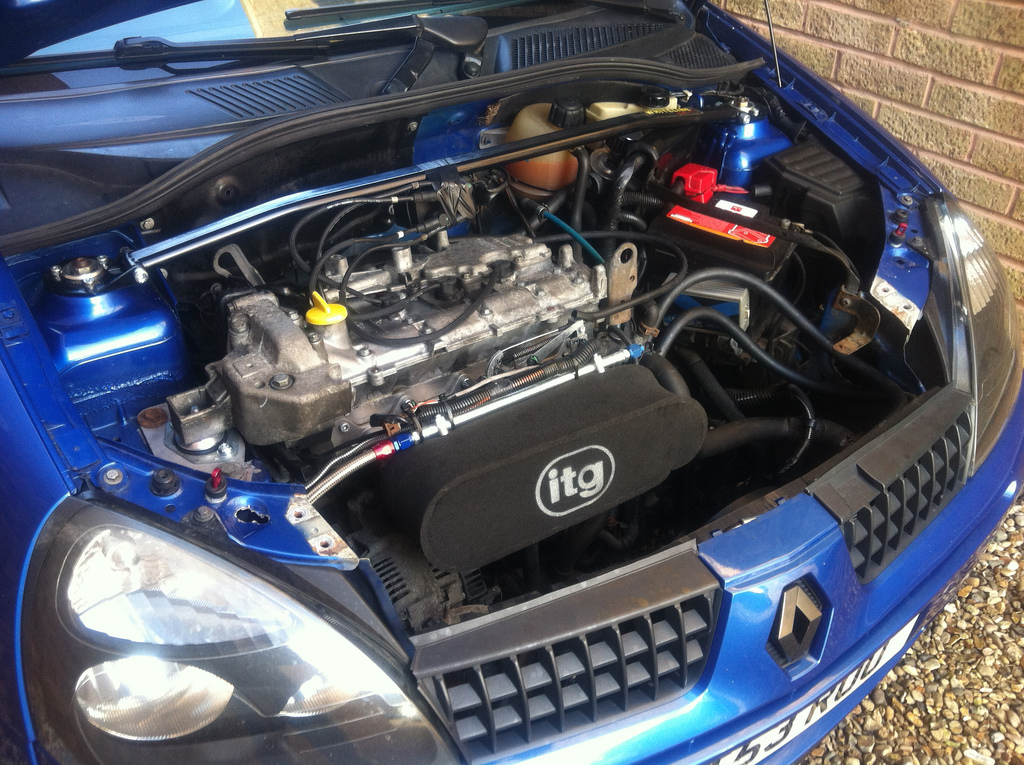

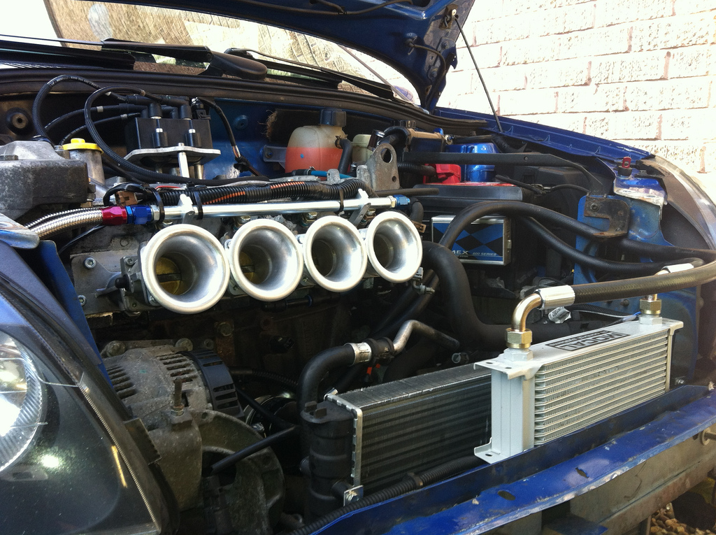

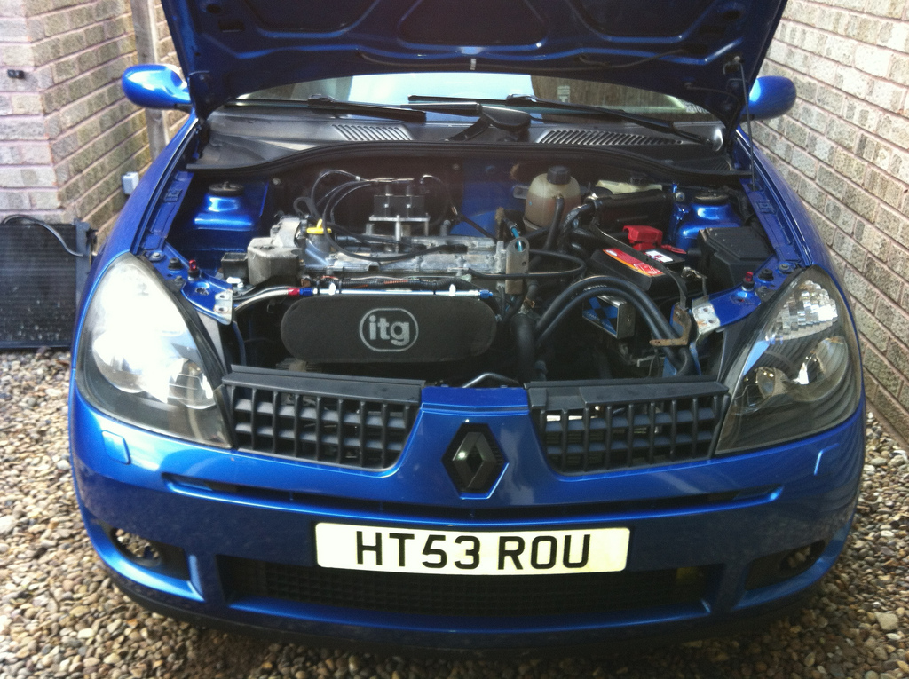

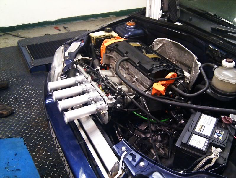

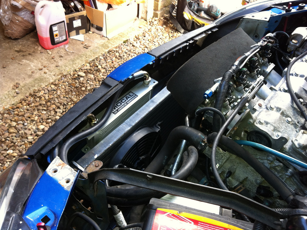

was bored today so decided to 'bodge' a coil pack mount so that i could test the new handling parts i fitted yesterday
all i can say is i'm absolutly amazed by it, car isn't much worse than standard for casual driving was hard to notice the difference, but when i nailed it through the corners, the steering felt so much more direct and accurate, the whole car felt absolutly solid and handled like it was on rail's.
FAO chri5, as said before i'd already fitted the b14 rear suspension, but fitted the whiteline yesterday, and that made a hell of alot of difference.
i'm so pleased with my car really need to get it on a track day now
here are the pictures, sorry about quality, poor light & iphone.

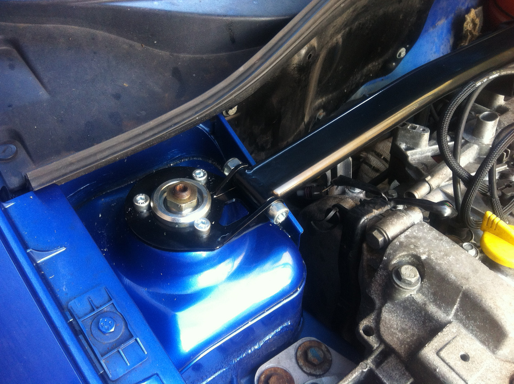

Bodged coil pack mount, puremotorsport strut brace & solid top mounts

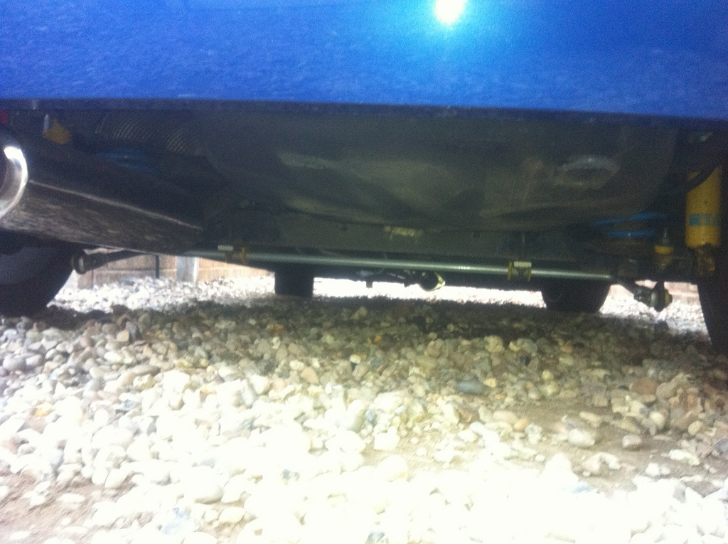

Whiteline arb & b14 rear's

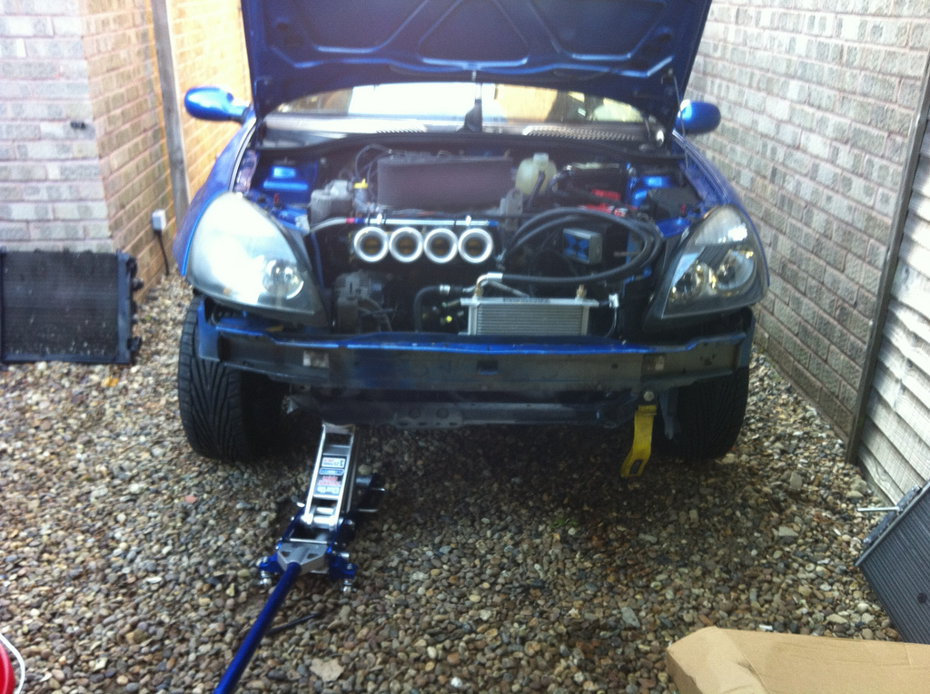

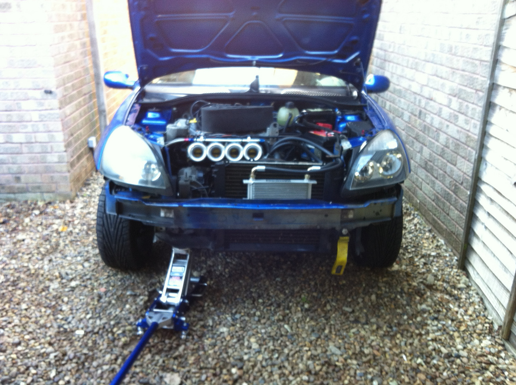

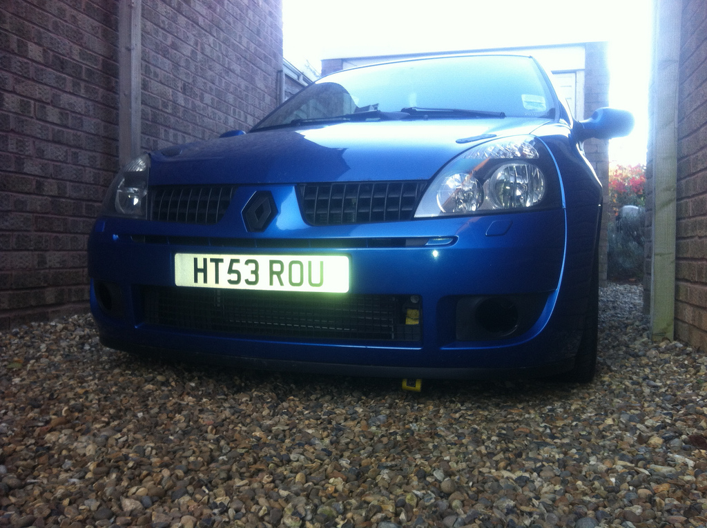

New low's, would go lower, but already catching front bumper on my drive lol

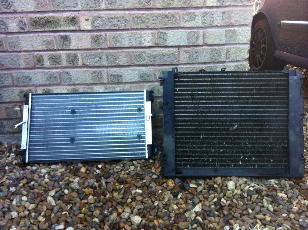

-Polo rad and slim fan
