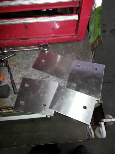

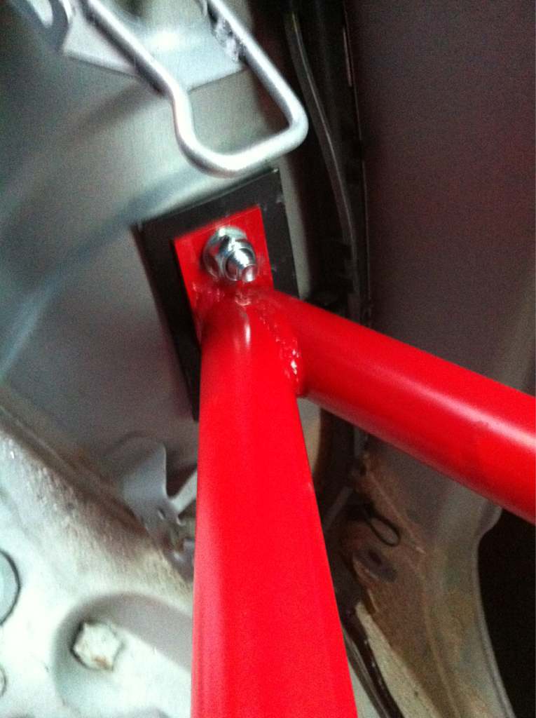

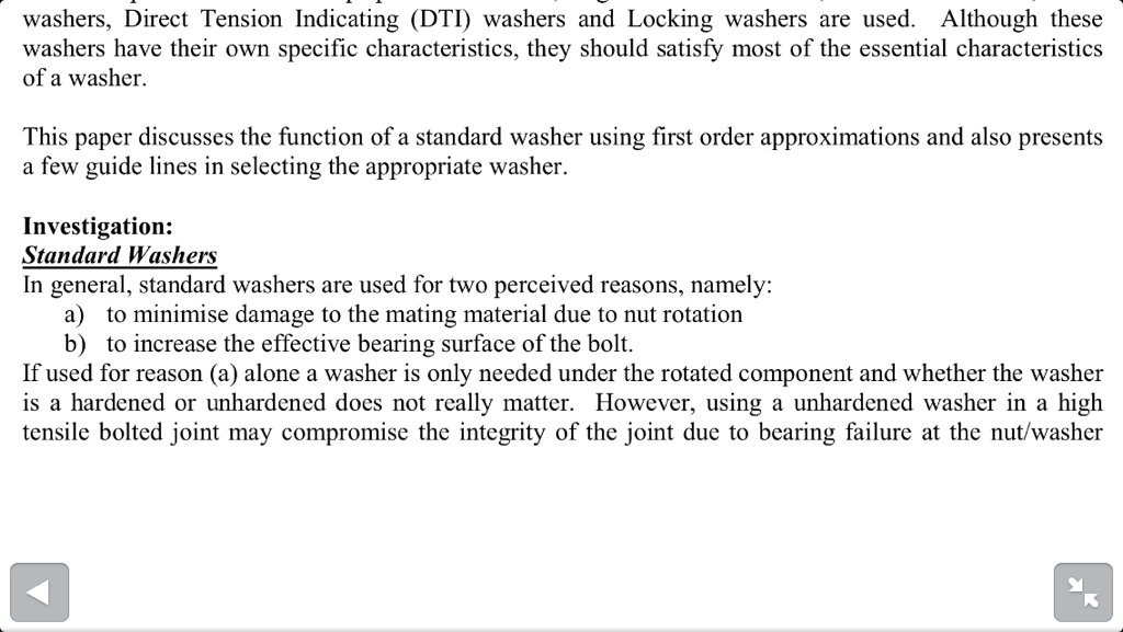

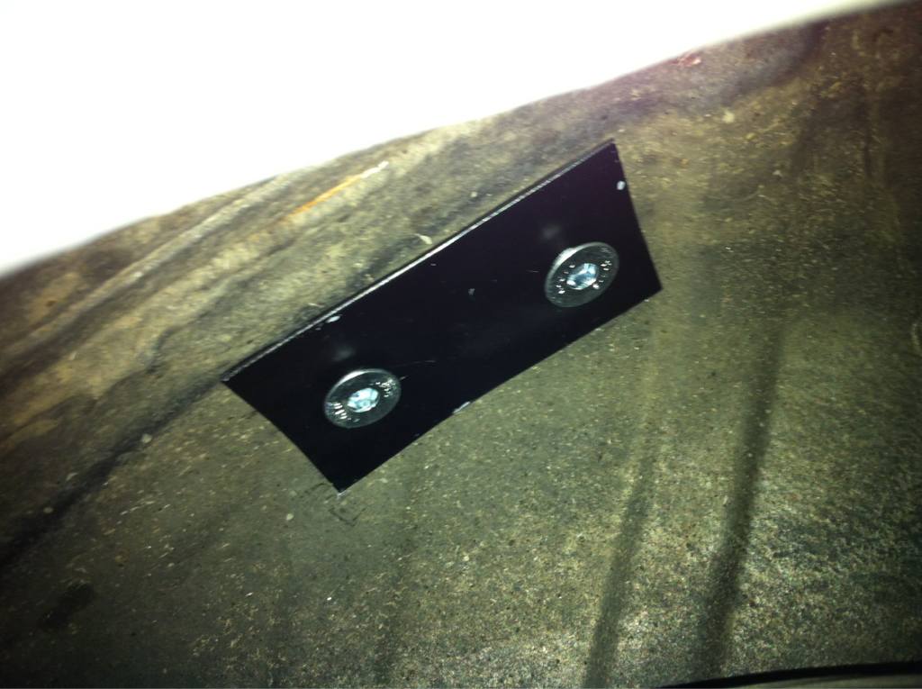

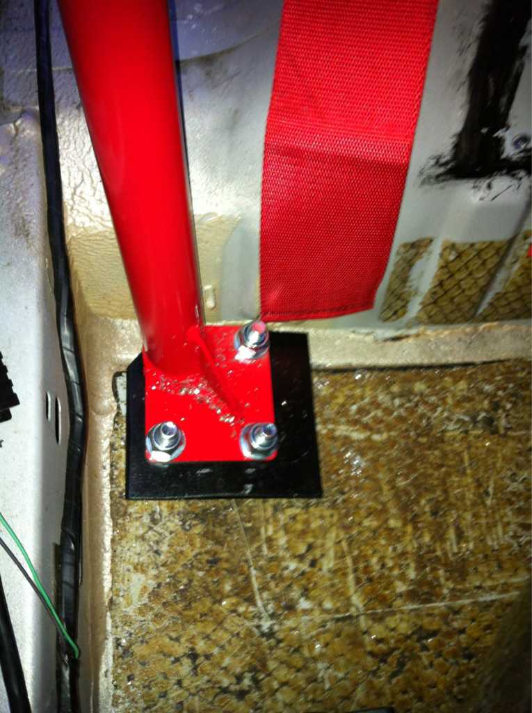

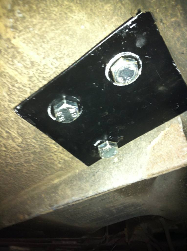

No washers on the underside? Shocking!!
The 3mm plates will do for now IMO!
I'm also using stainless HT bolts rather than the weaker steel items.
Gaz you remember I put up steel buildings for a living using bolts? I know what's needed ;) a washer on the otherwise is not necasery especially since there's a a second plate.
We went up a bolt size, drilled the base plates, and they don't act in shear as such so more than enough.

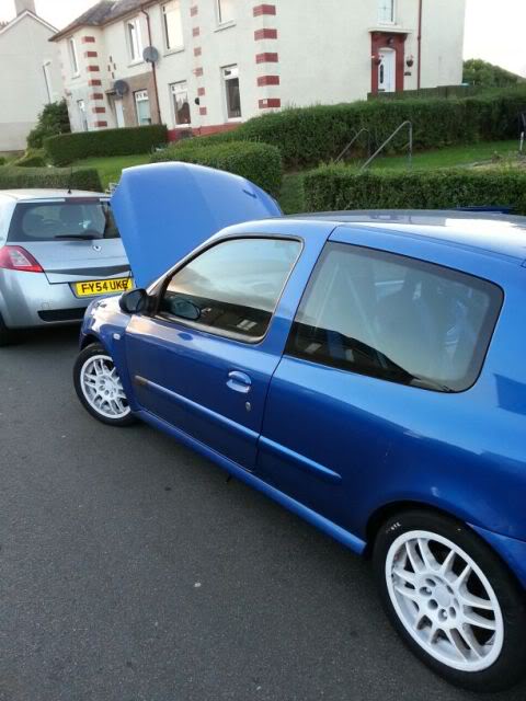

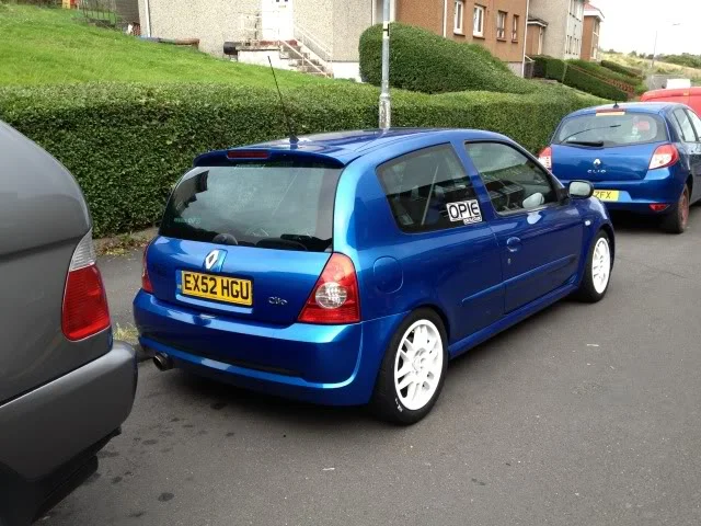

Anyway.. That's the car ready! :D

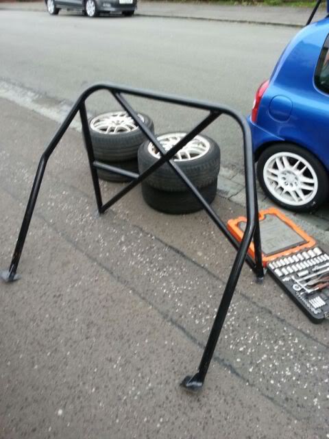

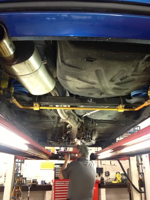

Polybushed dogbone mount, decat and coolant done.

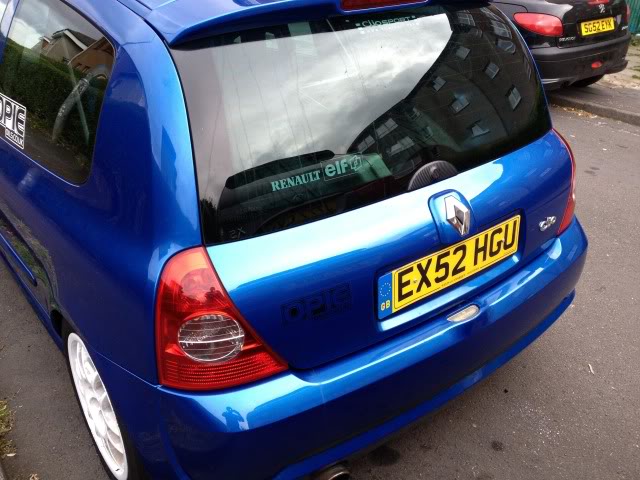

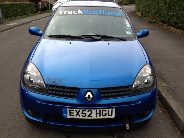

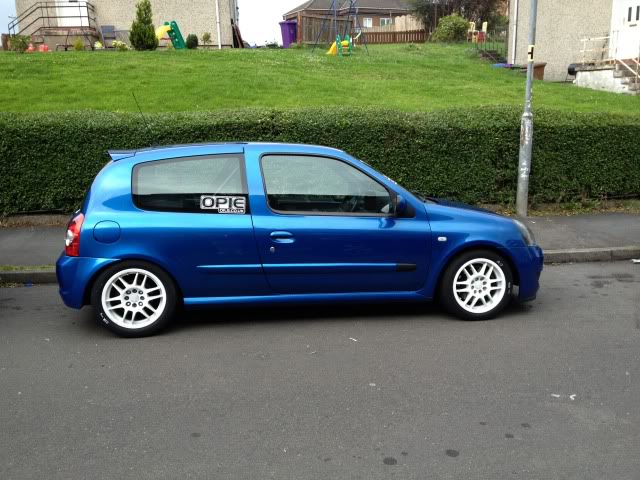

I've put some Opie and BTM stickers on it, but I'm unsure about leaving them on.
As said, I'm a bit unsure on the stickers.

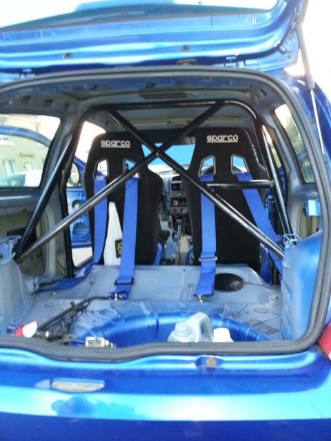

​Built up quite a spec on the car over the the last few weeks. Hope she goes well tomorrow!

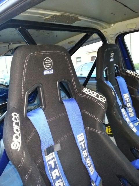

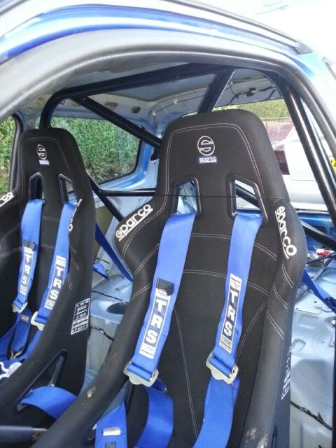

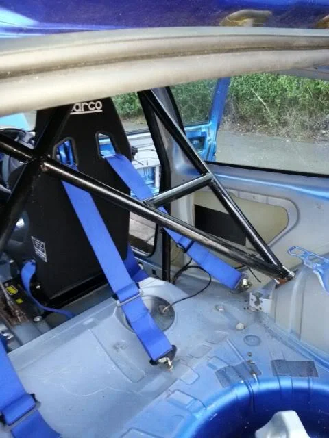

Really don't like them stickers... and as for a bad cage being the first thing to kill you LMFAO.
I've seen some "for show" cages bend and stab people in an accident - but that cage won't kill you.

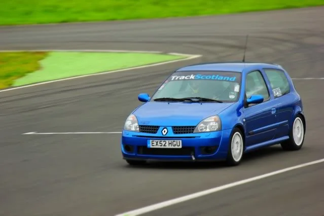

Absolutely flawless all day! Once I get some pics, I'll fire them up.
Brake pads and full geo set-up and it's ready for the next trackday.
Stickers will be removed ASAP!
