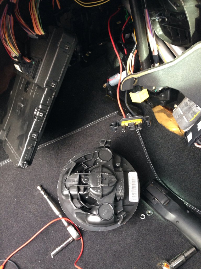

Put a new heater resistor pack in today, still hasn't solved my problem. Fan does nothing. My next step will be to check the connection to the fan, and also theres a relay in the circuit that could potentially stop it working or so I'm told. It did come on randomly the other day for a few seconds then went off again which leads me to believe there is a dodgy connection somewhere.
  LY R26 #288
Managed to get to be bottom of this today. New resistor pack was working, I was getting twelve volts at the fan. So removed the fan expecting it to be seized. Nope it was fine. Turns out the fan terminals were slightly corroded. Cleaned them up. Plugged it all back in and now it's beautiful again. No more steaming up and freezing my b****cks off in the mornings.

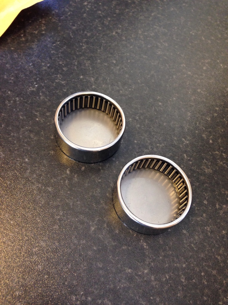

A new tool turned up today :) a blind bearing puller. So I can refurb my hub bearings as the swivel hub bearings seem to be a common problem and cause play in the wheels, stiff steering and knocking.
Just waiting for the bearings to turn up now. Managed to source them from Mark Black on the megane sport forum.

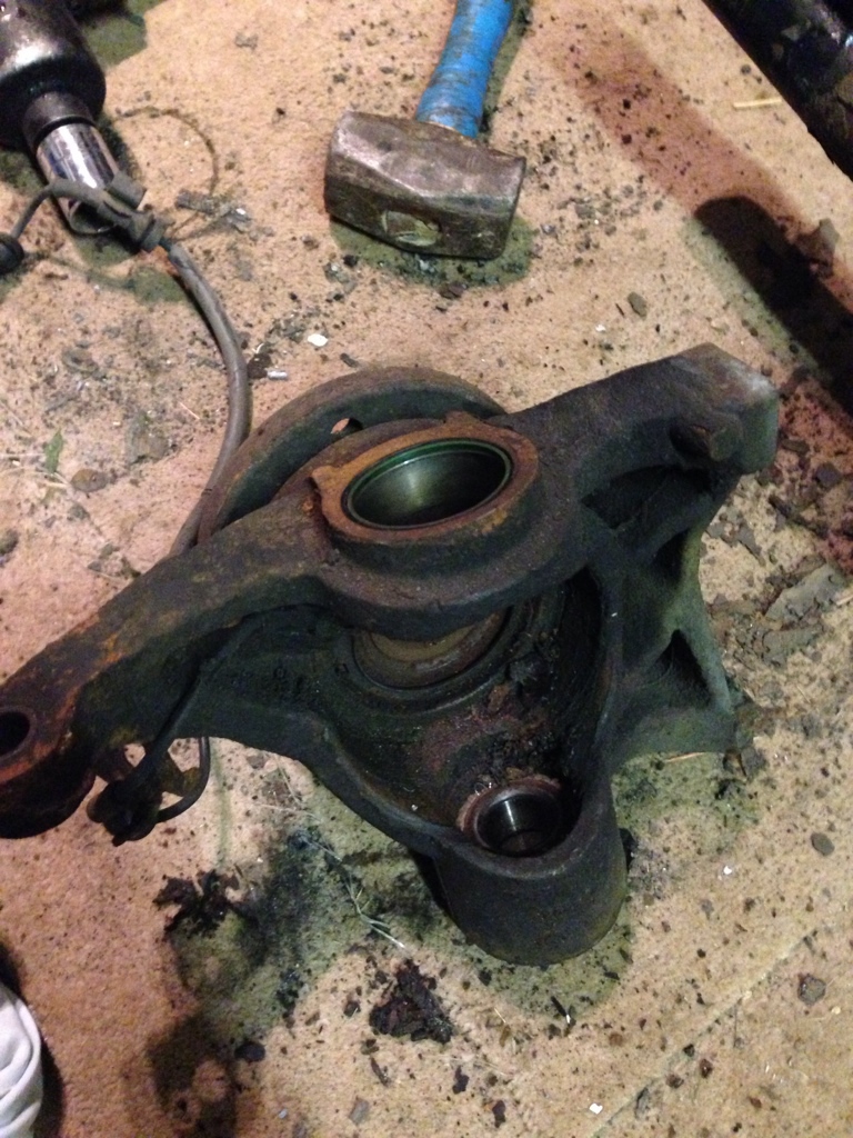

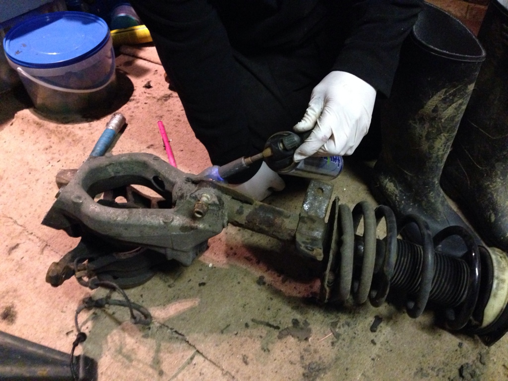

Only half way through doing these bearings as the car really wasn't playing ball. Everything was going well until we went to get the driveshaft out the hub. Numerous bearings with a sledge hammer finally released it. But yeah I've got to crack on tomorrow to do the other side. Bit gutted as I wanted to run it but can't be helped.
Doing the swivel hub bearings isn't an easy task unfortunately.
  LY R26 #288
Finally finished changing my swivel hub bearings.
Turns out the near side one wasn't too bad but the offside was knackered. Car drives completely different now.

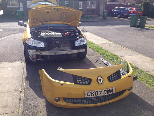

So there haven't been many updates recently and the car looked like a tip. Had about 3 inches of salt on it off the roads lol. So yesterday I set out to sort a few things out..

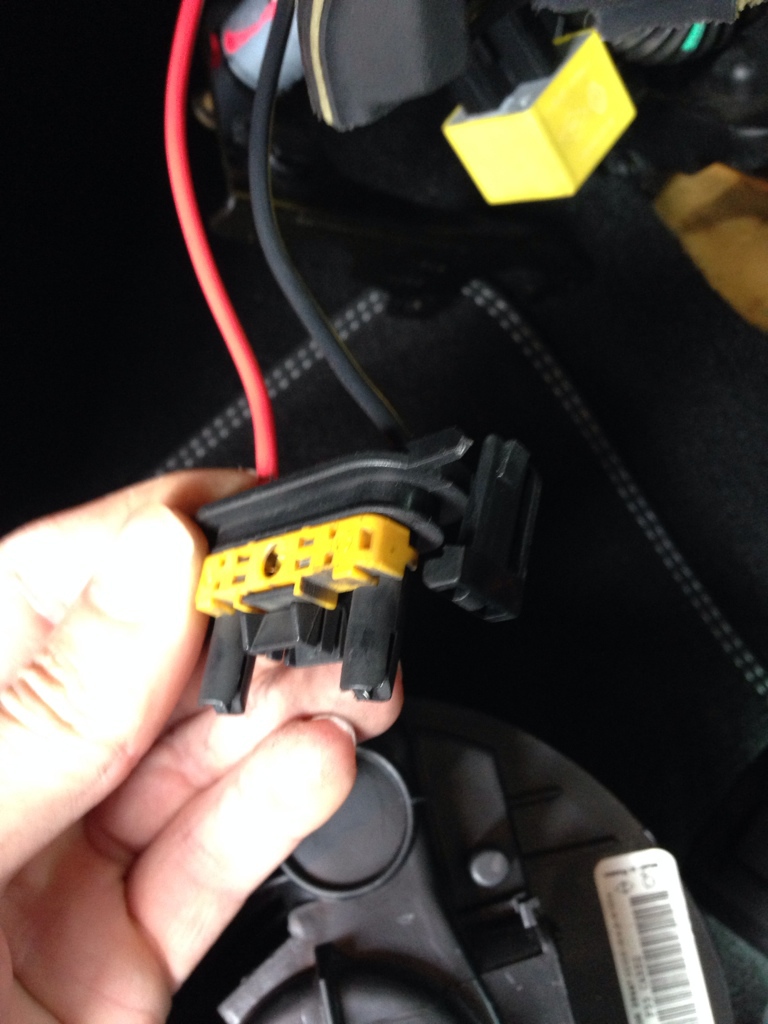

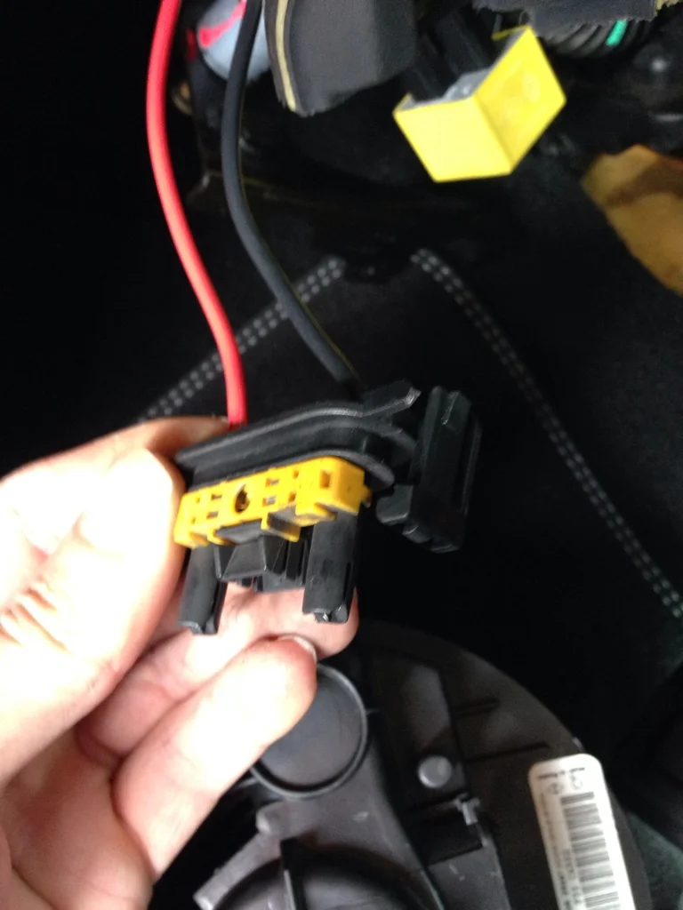

Investigate why the headlight washer jets didn't appear to be working. Upon removing the bumper the connector to the washer pump was not pushed all the way in? strange, so that was an easy fix they now work perfectly.
Fit my LED side light bulbs as since fitting HIDS the side lights looked ridiculous in yellow.
Re-align the front bumper as it wasn't quiet sitting right from when I took it off to do the belts.
Tried the little dash rattle fix that everyone speaks about on the meg forums, which is to spray the foam strip between the dash and windscreen with DW40 as this rattles like a mother and its doing my head in, although it appears it needs more as it hasn't quiet stopped it yet!.
Gave it good old clean inside and out as well. I was chuffed to bits after as I'd forgotten what a lovely colour the car actually was under the s**t lol.
Bumper off again... becoming a regular occurrence.

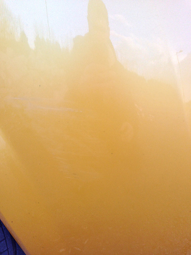

I was dreading cleaning it and seeing the full extent of the damage from when that tosser hit my car a few weeks ago, but actually when I'd finished you could barely see any damage, and what there is I think will polish out.
IMG_0922 by JoeRS182, on Flickr
Hardly noticeable!. :)

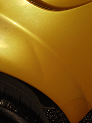

Also there's a small crease on the rear arch that was on the car when I got it, I will be getting this taken out very shortly
