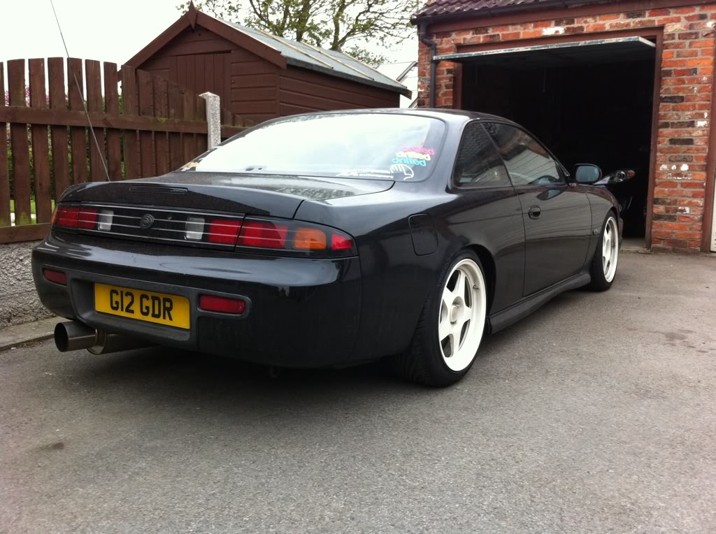

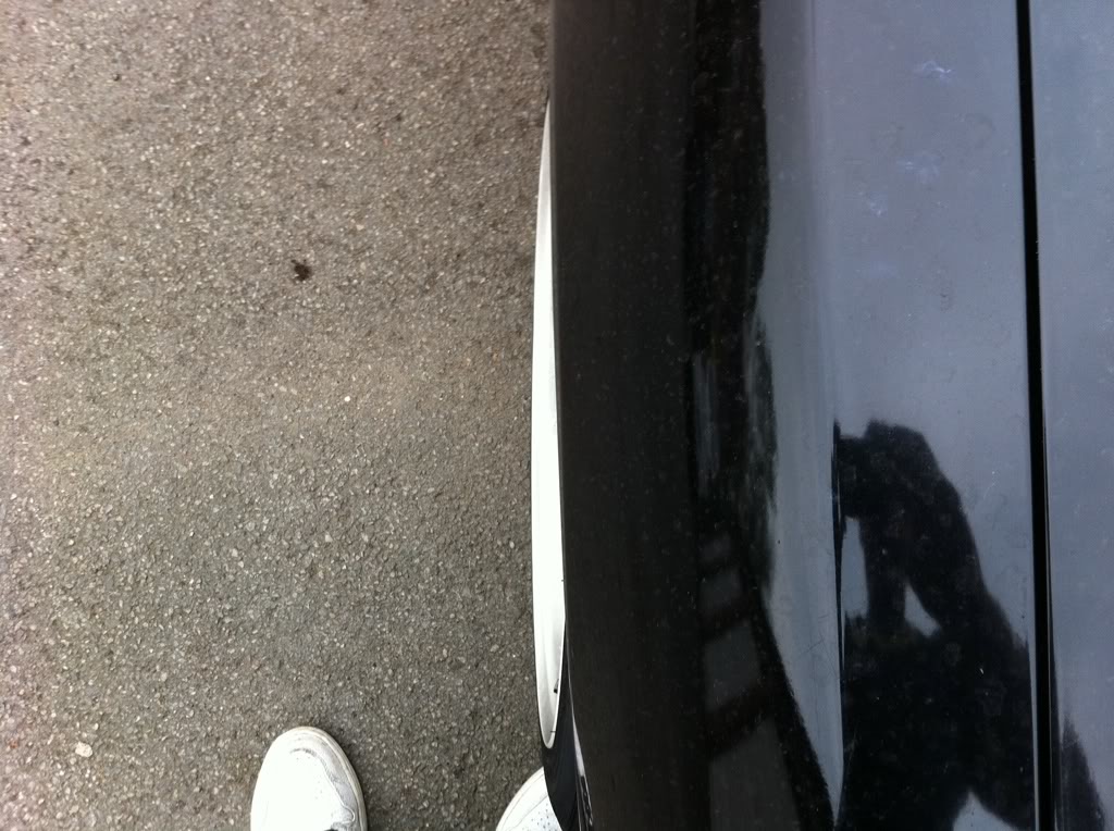

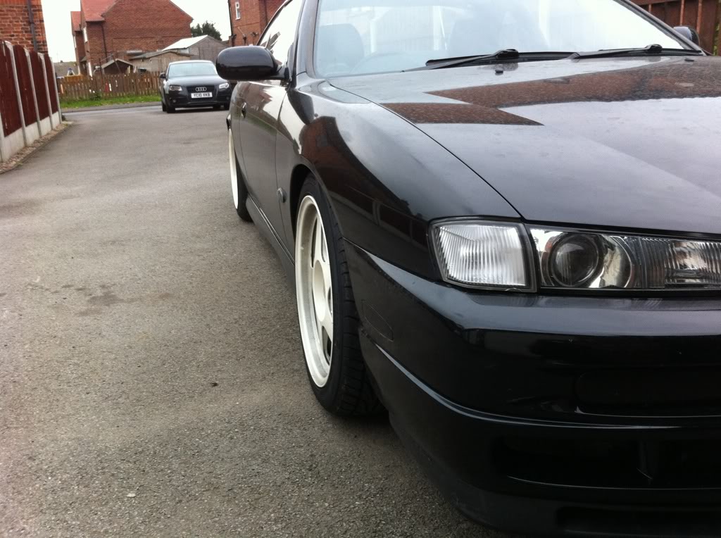

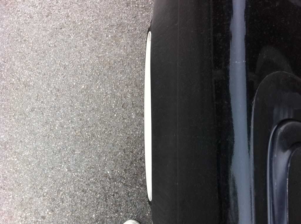

Anyway, due to a lack of reply to my issue, I decided to relower the car and try the spacers. 25mm up front, 20mm rear. This makes an effective 17x8 ET10 front, 17x9 ET18 rear.
And the results, kinda-flush. I think my original 30mm and 25mm would have been pretty much spot on :( Anyway, the images...
Rear
Front

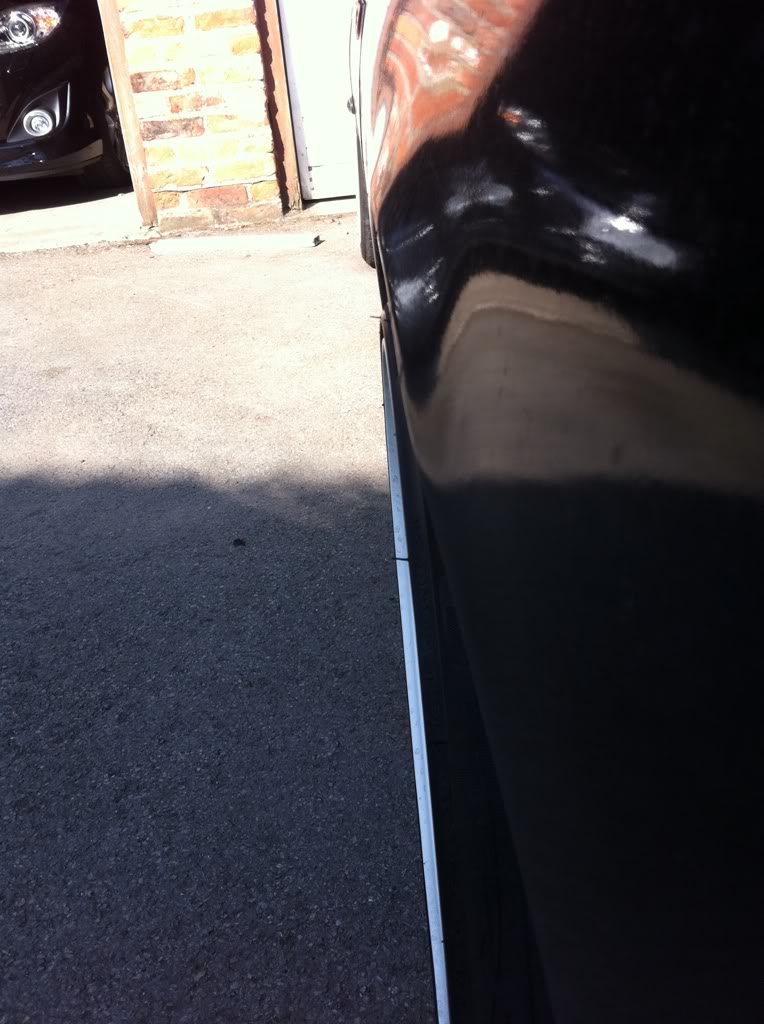

Been having another look at this, as something isn't right. The passenger side is where I want it if I add 5mm. The driver's side isn't.

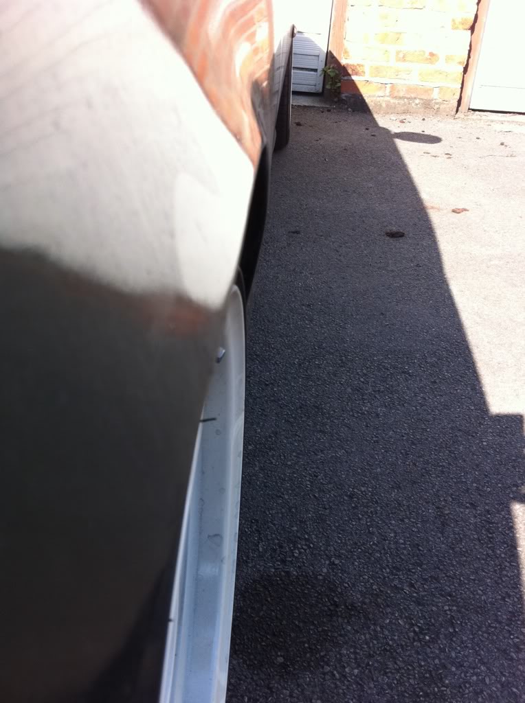

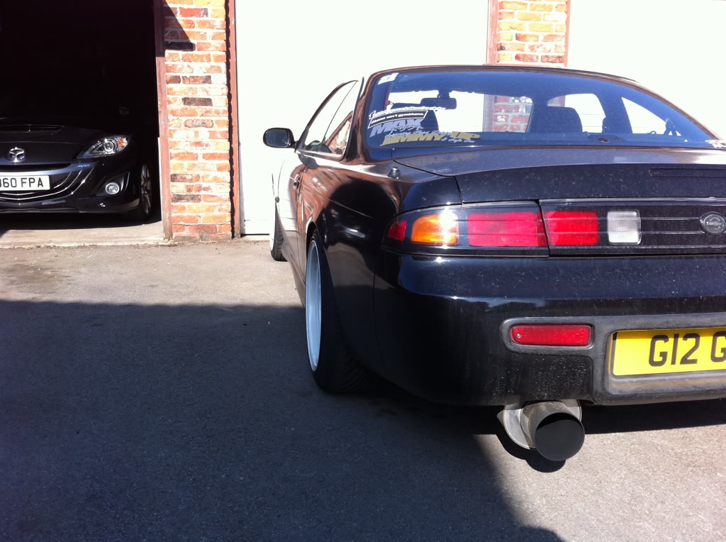

Pics to illustrate...
Then a close up of each side. Tried to get in the same position...
Passenger side
Driver side
So, either the flares are different, or the geometry is out.
Now, the flares are clearly hand done. However, the driver's side is the side that took the most damage in my kerb incident. Camber is the same according to my bubble gauge, but the rest may be different. I do know the subframe is out of line a bit on that side so that could be the cause.
Also I'm now thinking 35mm up front.

Will it just be a case of loosening the subframe and centralising it, or is it bent?
I know for sure the subframe is bent. I can make up the geometry differences in the adjustable arms, but I can't make up this difference. Good excuse to refurbish a subframe and polybush it though.
