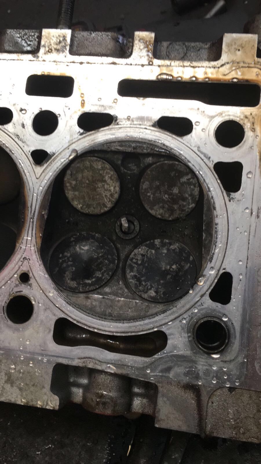

Might be daft but can anyone tell if they are supertech valves from this pic......

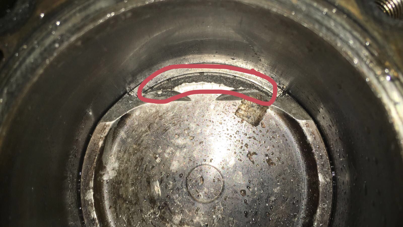

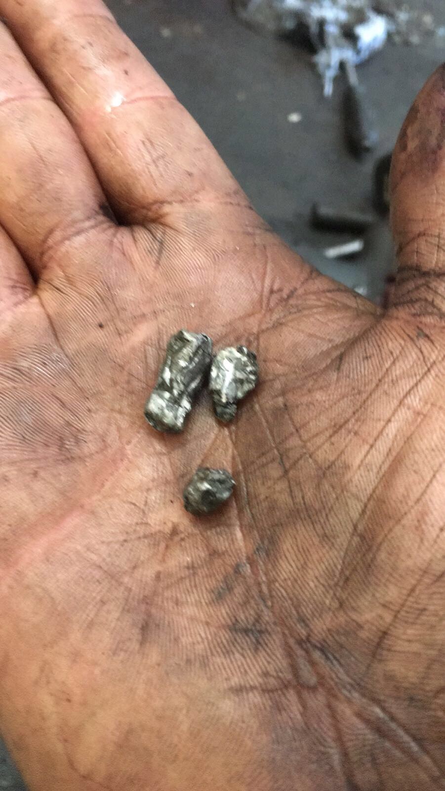

Ringland failure that. They do look like supertech valves mate yes. The inlets have a black coating on them, but the exhausts are polished. They still look to have the coating/polished appearance.
My car is currently in at a specialist, and he has advised me that if i am keeping the car in the long run, to remove the engine and start again as the build is basically w**k.
