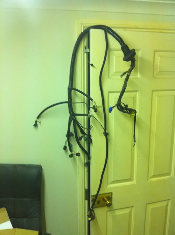

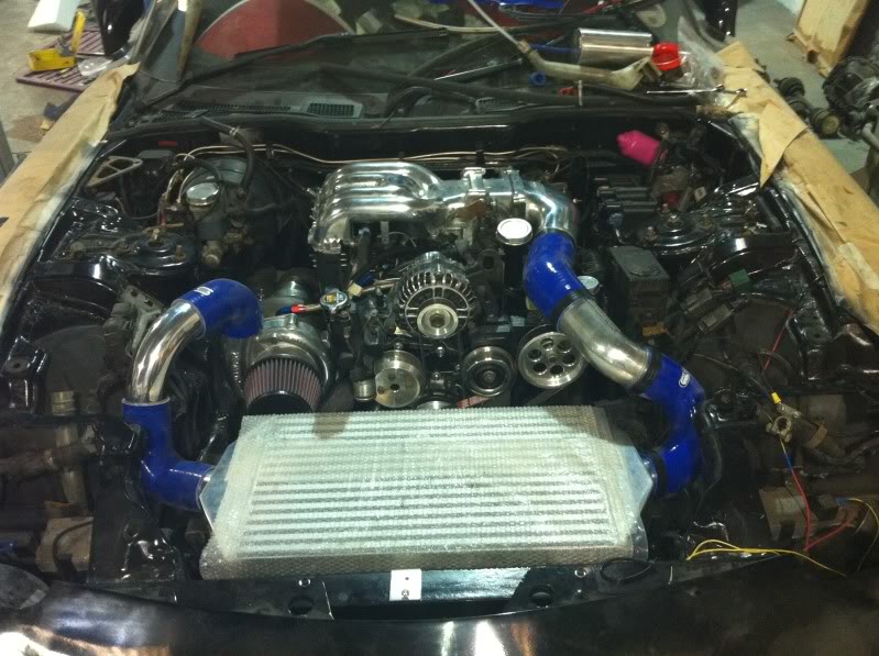

just finished chopping and wrapping the loom :) will be back on the engine tomorrow :) gotta sort fuel lines, oil drain for turbo and a couple water lines and we have power :D

doubt it will be tomorrow, or if it is, it will be a brief turn on turn off lol! i need to get the alloy rad bottom hose altered slightly and have a new stub welded on it before i can fill it with coolant, plus there is a complete c**t of a fuel hose im trying to undo!
i removed the fuel filter as its in a STUPID place! its at the back of the car on top of the diff wedged between the diff and the tank... u actually cant see it! to remove you either do it by feel only or remove the rear subframe! i got the filter off after about an hour of pissing round but i need to remove one fuel hose to i can loop a new hose on to remove the filter, then im going to run a billet fuel filter in the engine bay! plus i need to make up all the braided fuel lines which tbh is a pain in the arse to do lol! everything needs to be the perfect length then putting the alloy fuel fittings on is a complete pain and hurts lol!

na fuel stuff is a couple hours, rad will be sorted tomorrow prob too... and the coolant hoses are a 10 min job.

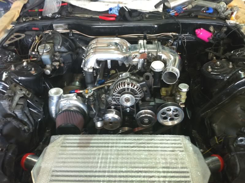

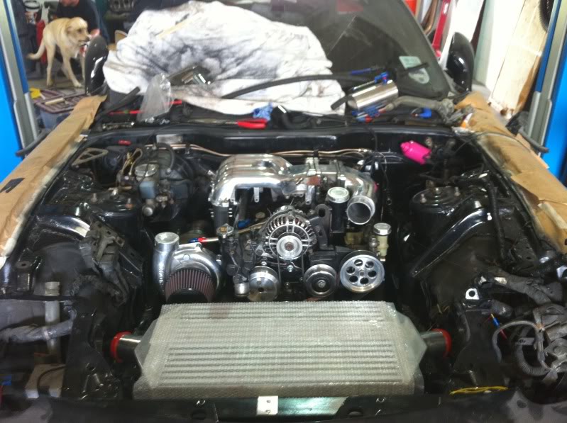

updates :D

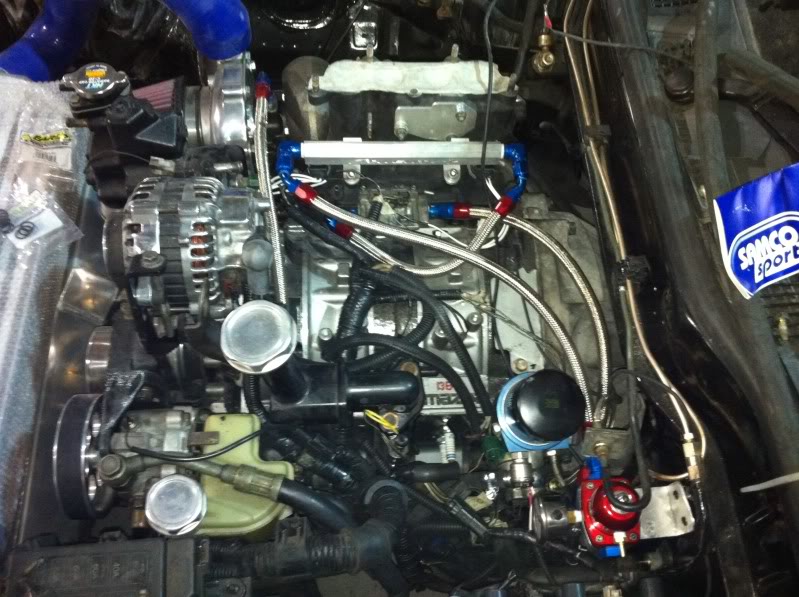

fueling completed (engine side... still need to work out where im gonna put the fuel filter :(
also did the intercooler piping today (COMPLETE ball ache!!) i have spent far to much on frigging hoses!!
just got to get a couple parts ali welded... and it SHOULD start!

google it or go back a couple of pages... basically the intercooler is flat on top like mine and the rad sits at a 45 degree angle to it... the sides then get ducted in so the air gets rammed through the front of the car and the only way it can go is through the rad and the intercooler...

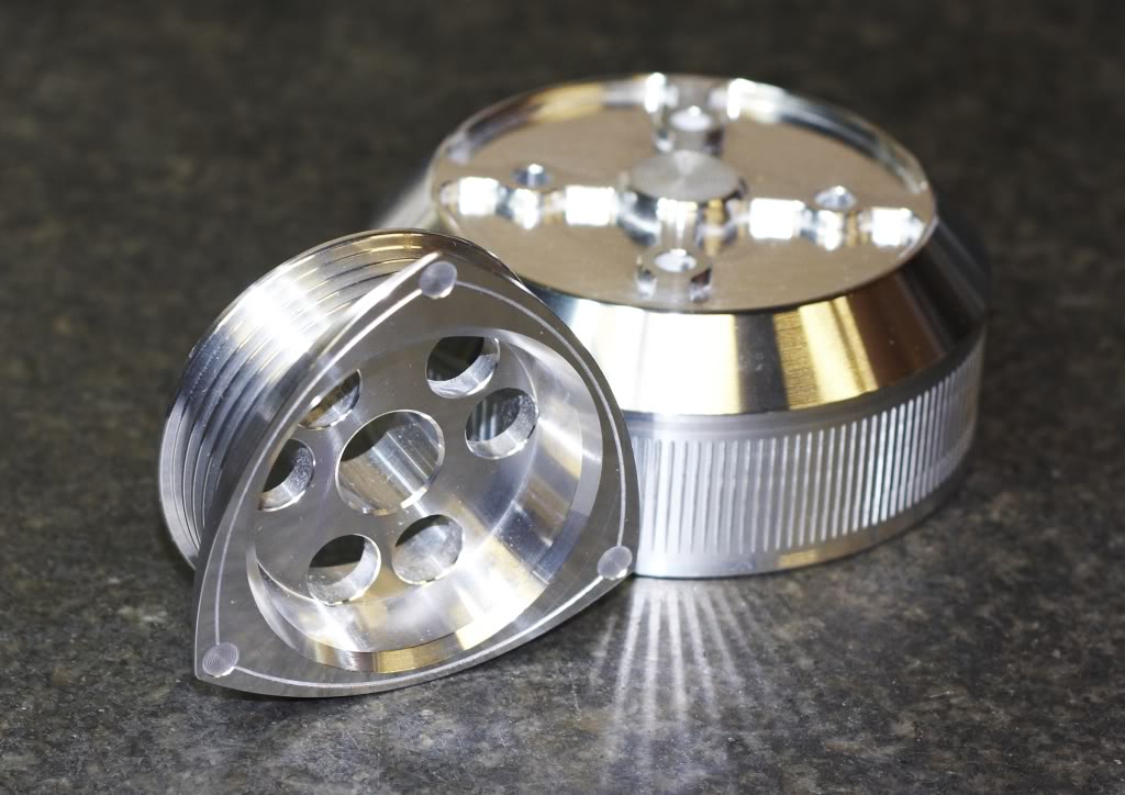

already running draggon pulleys...

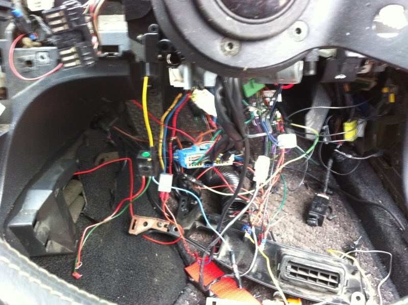

anyway its all together but i had alarm issues which when i investigated realised the people who had installed it... instead of splicing and soldering wires... they just twisted and wrapped tape around the joins!!
alarm has been taken out... but somewhere along the line there is something wrong, car wont power the ecu and its just bugging me... i had the car put on a low loader today and it came home... this week im going to strip the interior... seats and dash everything out... im going to check all the loom and remove yet another alarm i have found in the car!!

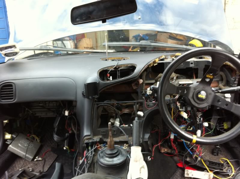

this is the state of the interior atm!
this was what the alarm "installer" did under the dash!!!
im fuming!! im taking the entire dash out to sort it all! also they left another old alarm still connected in the car!
