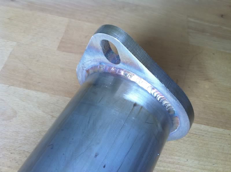

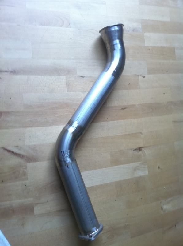

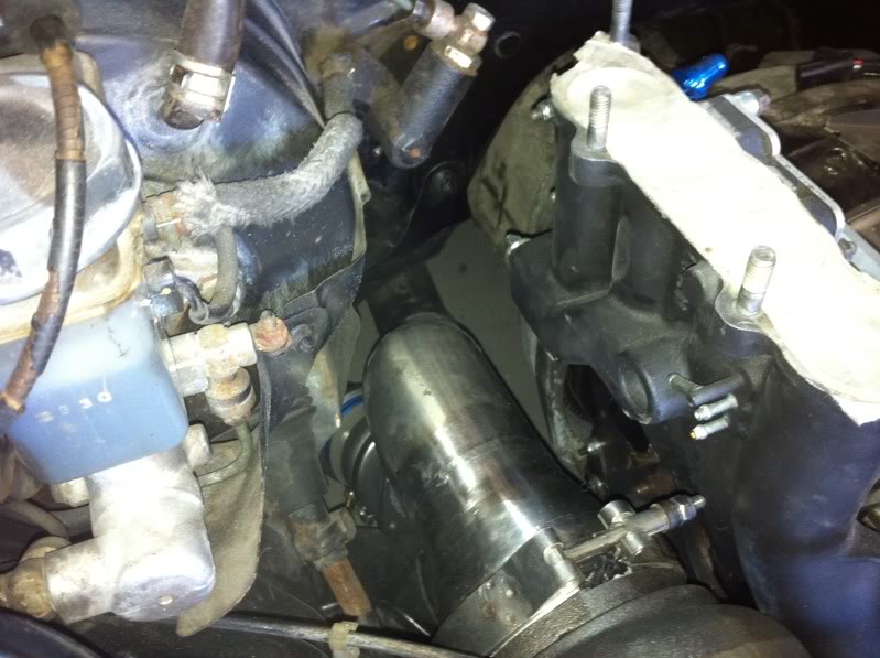

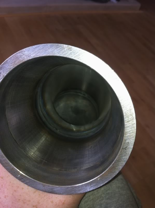

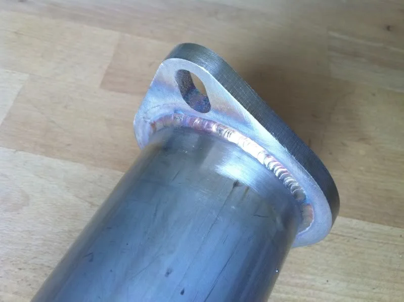

lol i cant weld the other day i had my first attempt ever... it went ok lol well i can tack thats pretty much all i tried, though i did weld some scrap together and got some nice straight lines that didnt make holes lol... however compared to whats been done on the downpipe im s**t lol! i need to wrap the downpipe but need to get my egt probe boss put on first and stupidly i left it at the garage![]()
martin from speedline imports??
Realise that Andrew but there isn't really any space and being a twin scroll I would really need 2... So I'm sticking it as close to the exhaust housing as possibleyou the same Andrew Cooke from chipping norton??

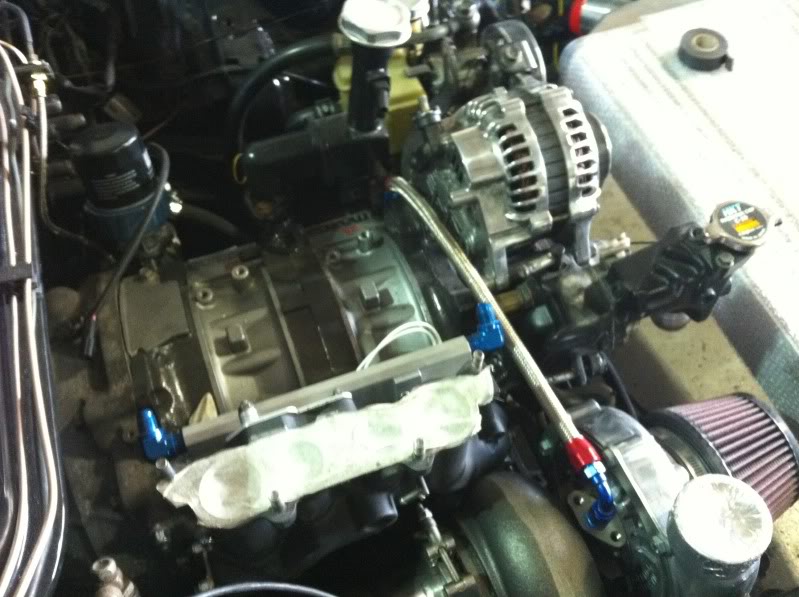

eh? its not like nitrous lol! you have 1 jet... some people run 2 smaller ones but its not used to increase power... the further away from the throttle body the better, it atomises in to the air and mixes and makes it more dense so the longer it has the better it works, its used as a detonation prevention to begin with i will be running just water, when i take it up the strip i might run a 50:50 water methanol settup...

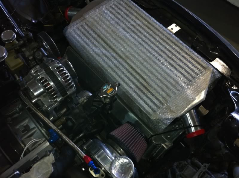

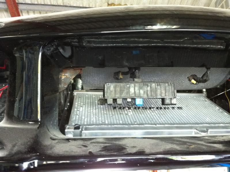

its a v mount settup so the rad will be below it and im just ordering an alloy rad to replace my stock one![]()
When we did WI we ran direct port in the MX-5. If we did it the way your describing cylinder 3 and 4 got next to no water. We ran a wideband off each cylinder, 1 & 2 = 13 at WOT, and 3-4 were nearly at 15.
That was a 50/50 mix of methanol. It was giving the same results of running 104ron fuel.
We ran it to destruction on one lump. We were putting as much water meth mix in as we were fuel! It take some setting up though and if you get a blocked jet the job is f**ked.

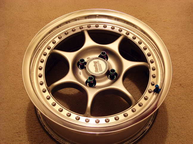

Ah ok cool, they are quite nice indeed, those with the right profile tyre, and you'll be sorted![]()
