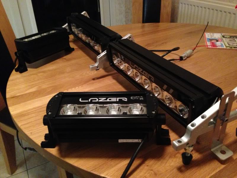

Although I bought a new lamp pod last year , along with some good lights with HID bulbs , thought i'd actually get to use them this year after not taking the clio to Jersey last year , but I went to the rallycar show in Castle Coombe last week and seen some new LED spot lights on show , and after doing a bit of digging last week finding out about them decided I needed a set lol
Very lightweight , very easy to fit , and are very very bright , so should be able to see a bit more through the dark Jersey lanes on the friday night stages lol
Hasnt the MSA just outlawed these in a Blue book update? Was thinking of these myself. Big thing about LED vs origional fitment, carnt remeber the detail.
fvcking hope not after spending £1500 on them lol !
There are a couple of threads on the rally forum about them , and nothing has been said on there about banning them , and none of the outlets mentioned it after me telling them I want them for rallying ,

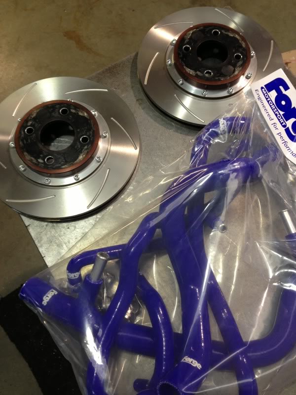

Done a bit to te car again tonight , found yesterday the bottom rad hose was leaking slightly , must have been damaged when the rod came out of the side of the block , so ordered a hose kit yesterday which turned up today so fitted them , stripped the modene off as it was leaking oil where it fits against the block , so that's sorted now .
can get the hose kits at a good price so if anyone wants one pm me
discs had some cracking on them so made up a new pair today , I'm using Ferodo UNO pads which are very good , but can generate a lot of heat , more so as I left foot brake a lot , so will be bedding them in tomorrow to heat cycle them ready.
going to strip the front hubs off tomorrow and check the joints as something doesn't quite feel right , take it for tracking tomorrow then.
