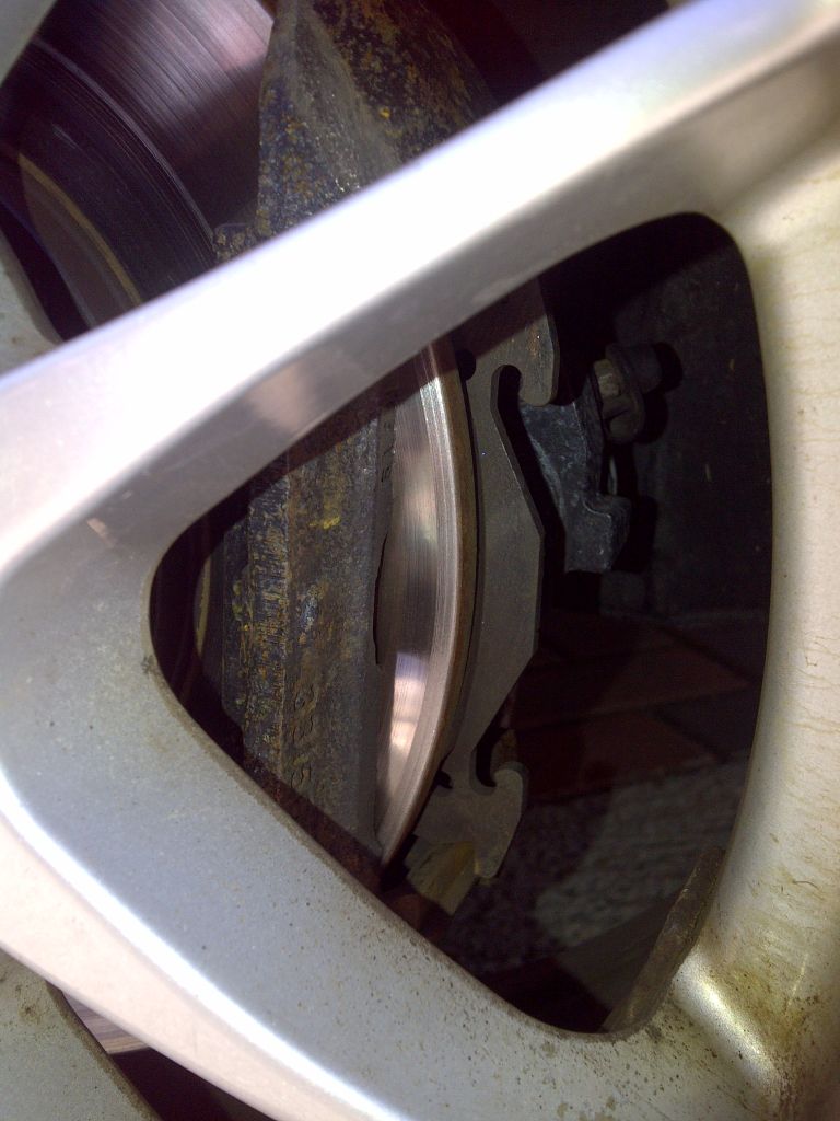

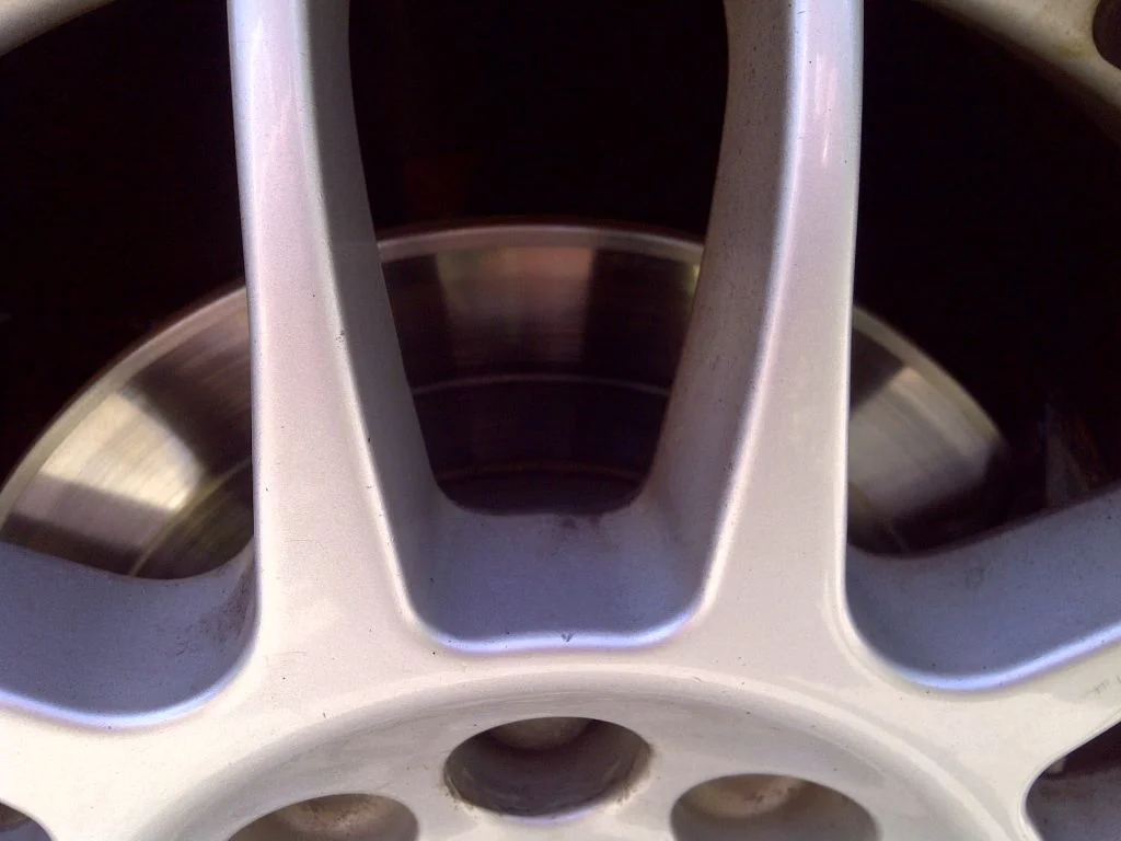

Today I had a bit of a fail in the Clio.
Was half way to dropping the girlfriend off at work, I applied the brakes as I was approaching a junction and there was a huge "BANG" at the rear of the car.. I came to a gentle stop at the side of the road as something didnt feel right.
Having pulled over and attempted to apply the handbrake, the lever came right up. Something had gone wrong with the rear brakes.
After closer inspection, I found this:
Notice anything missing?
I looked down the road to see where the missing pad had ended up.
I then looked under the rear of the car and it was sat inside of the wheel, chewed up..
How on earth can a caliper spit a pad out?

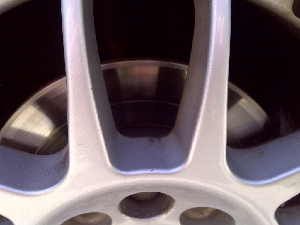

I managed to get the car home ok, but there was some horrible grinding noises on the way.
Fortunately the caliper has not grooved the disc, so I think I will be able to continue using it once the pad is refitted..
Scared the life out of me, and very confused as to what happened!
Will jack it up and get the wheel off tomorrow for a closer look and to refit the pad.

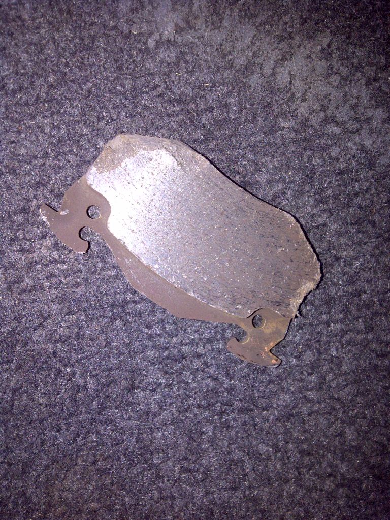

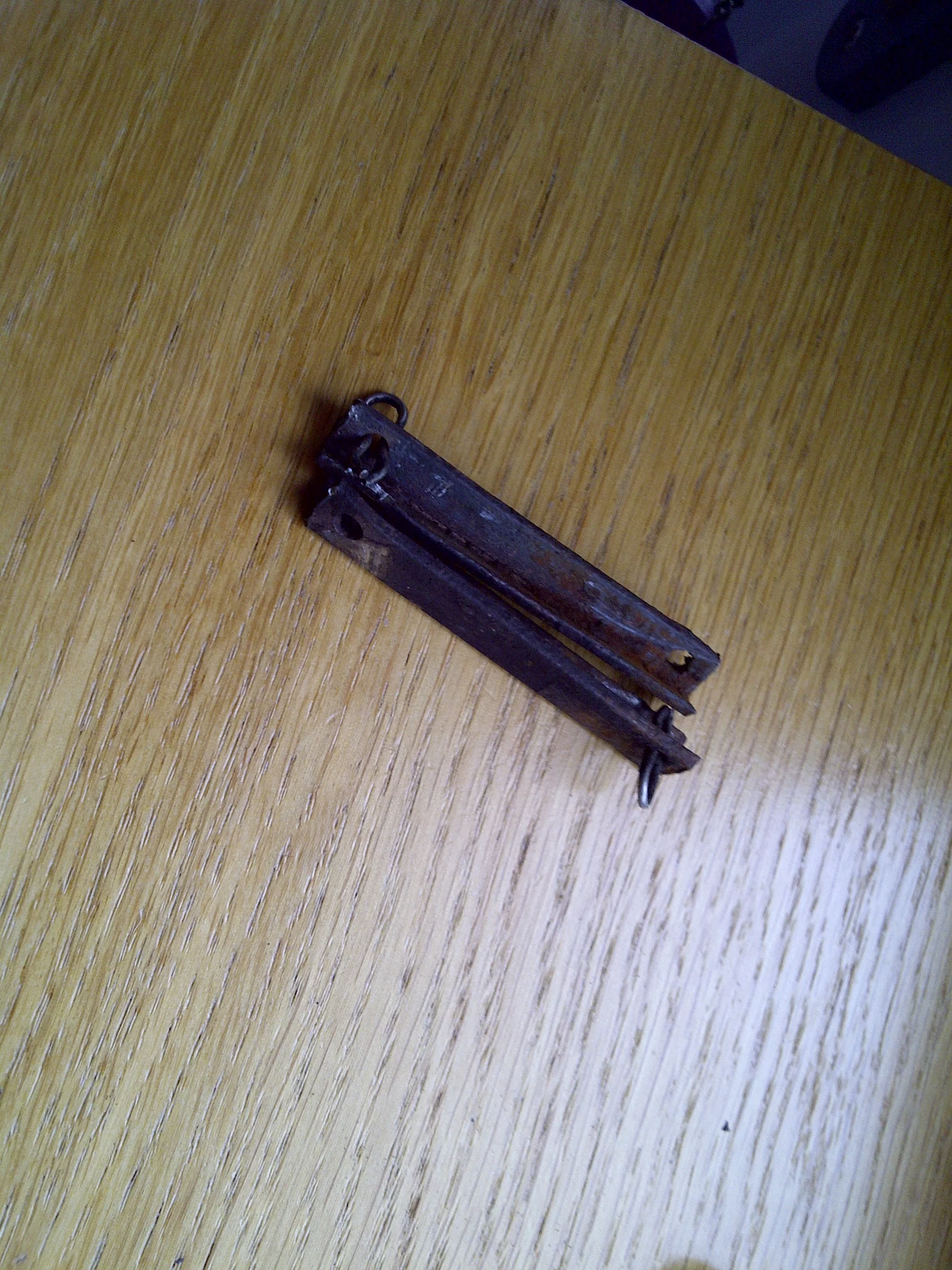

Picture of the pad in question.
Very strange!
  Defender 110
that happened to me before, did you put the metal pins in to stop the pads moving? cant see any in the pics, if not. that would be why.
Nickson
wow!
i've not heard of that happening before.
Nor me mate, very strange indeed.
Needless to say, I will be getting her back on the road ASAP!
The pins were there before this happened yes!
The silver spring clips we are on about yeah?
Both were present and fitted before this happened. Need to get some new pads now as the spring clips are now somewhere in the south of the country!

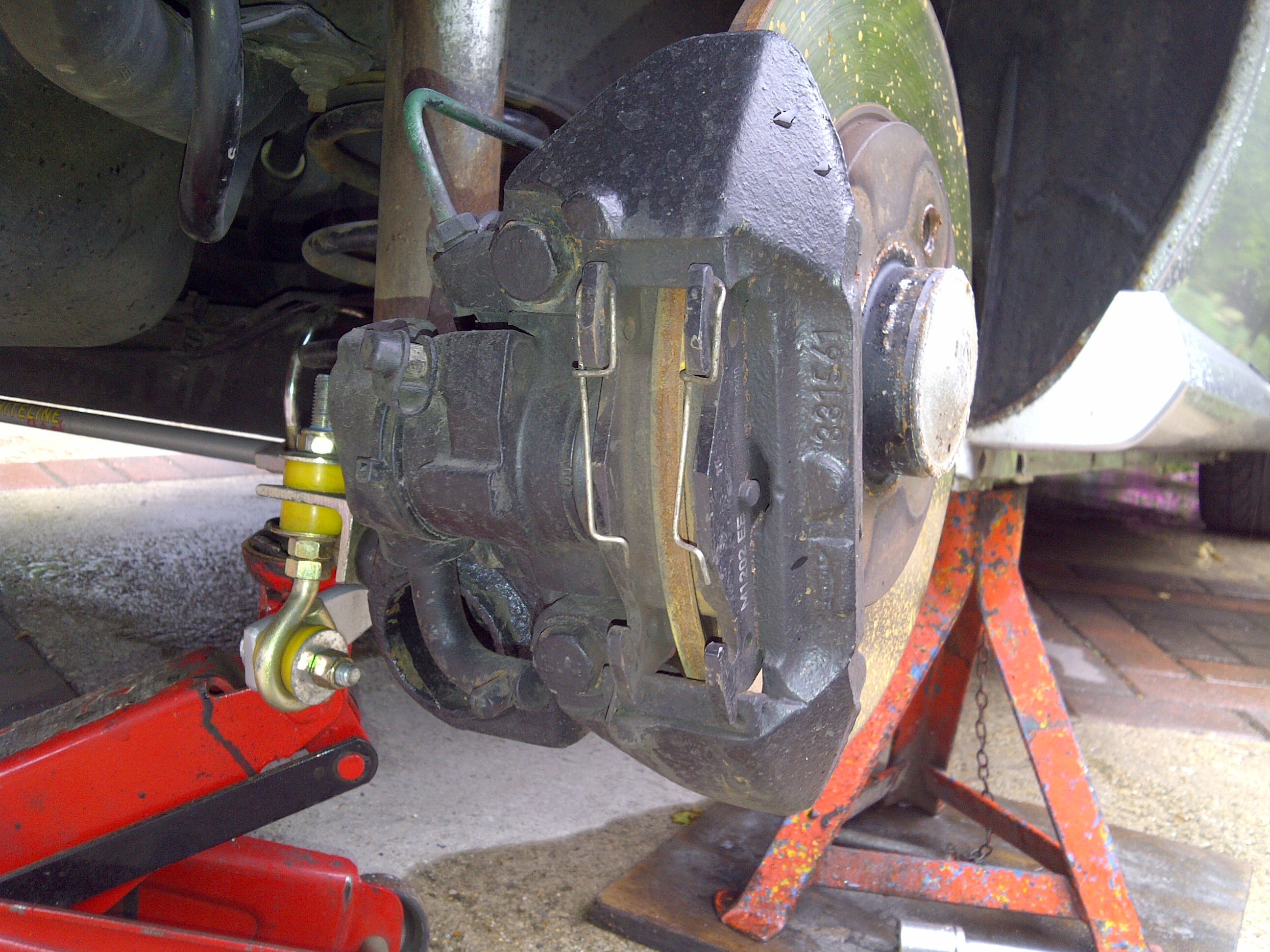

Made some progress with the car today!

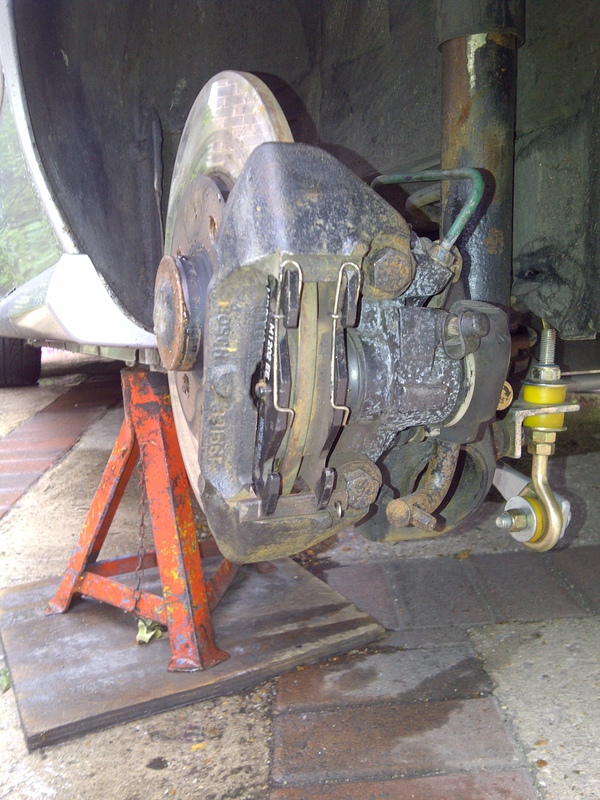

I jacked it up, and removed the rear wheel to be greeted with this:
Took the carrier off and wound the piston back into the caliper, refitted the pads and carrier and gave it a wire brush down.
From looking at the carrier and pads, there was no indication as to what might of caused this to happen!
Im guessing the "wedge" piece used to secure the pads has worked its way loose and fallen out, causing the pad to come out.

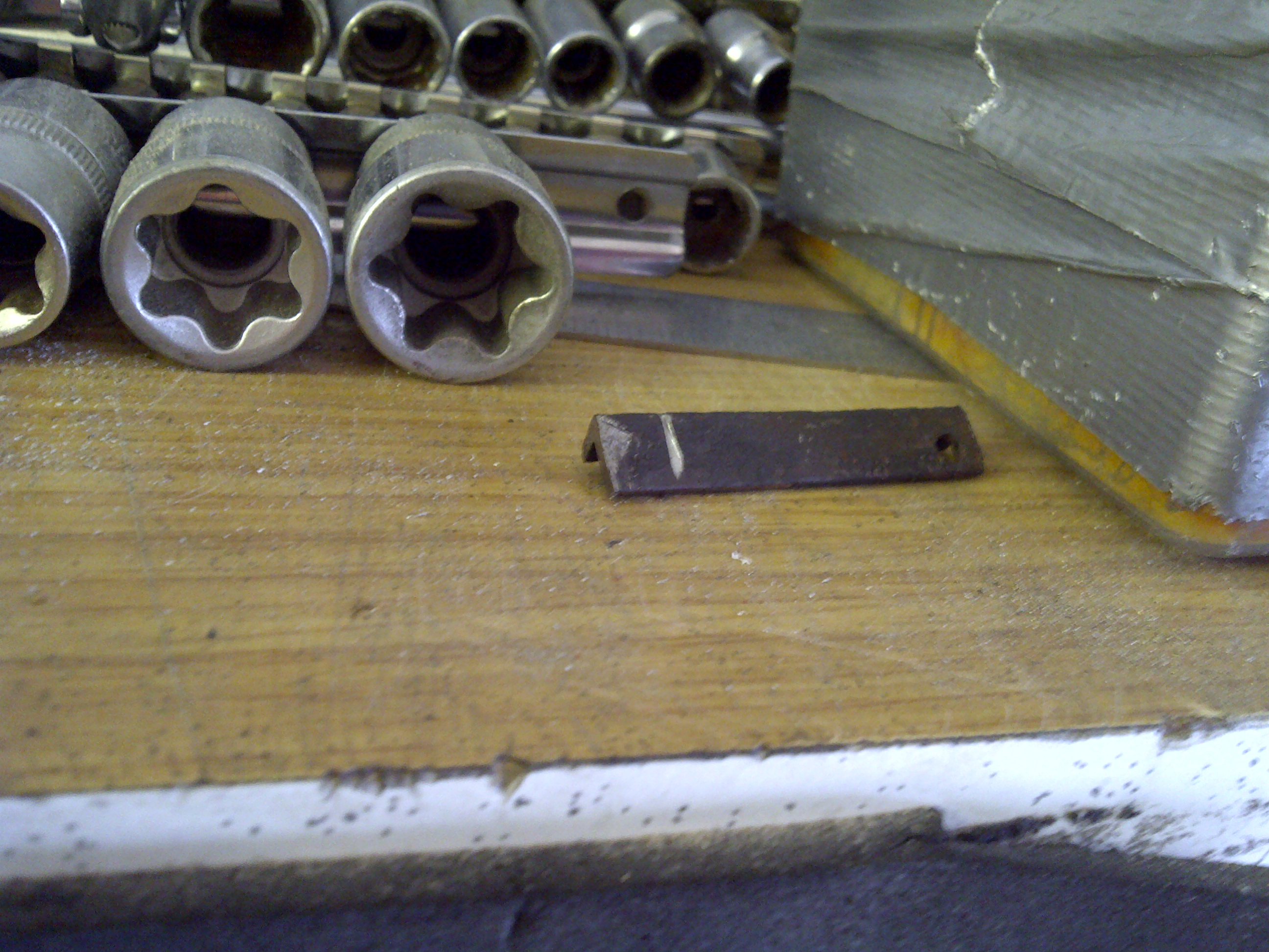

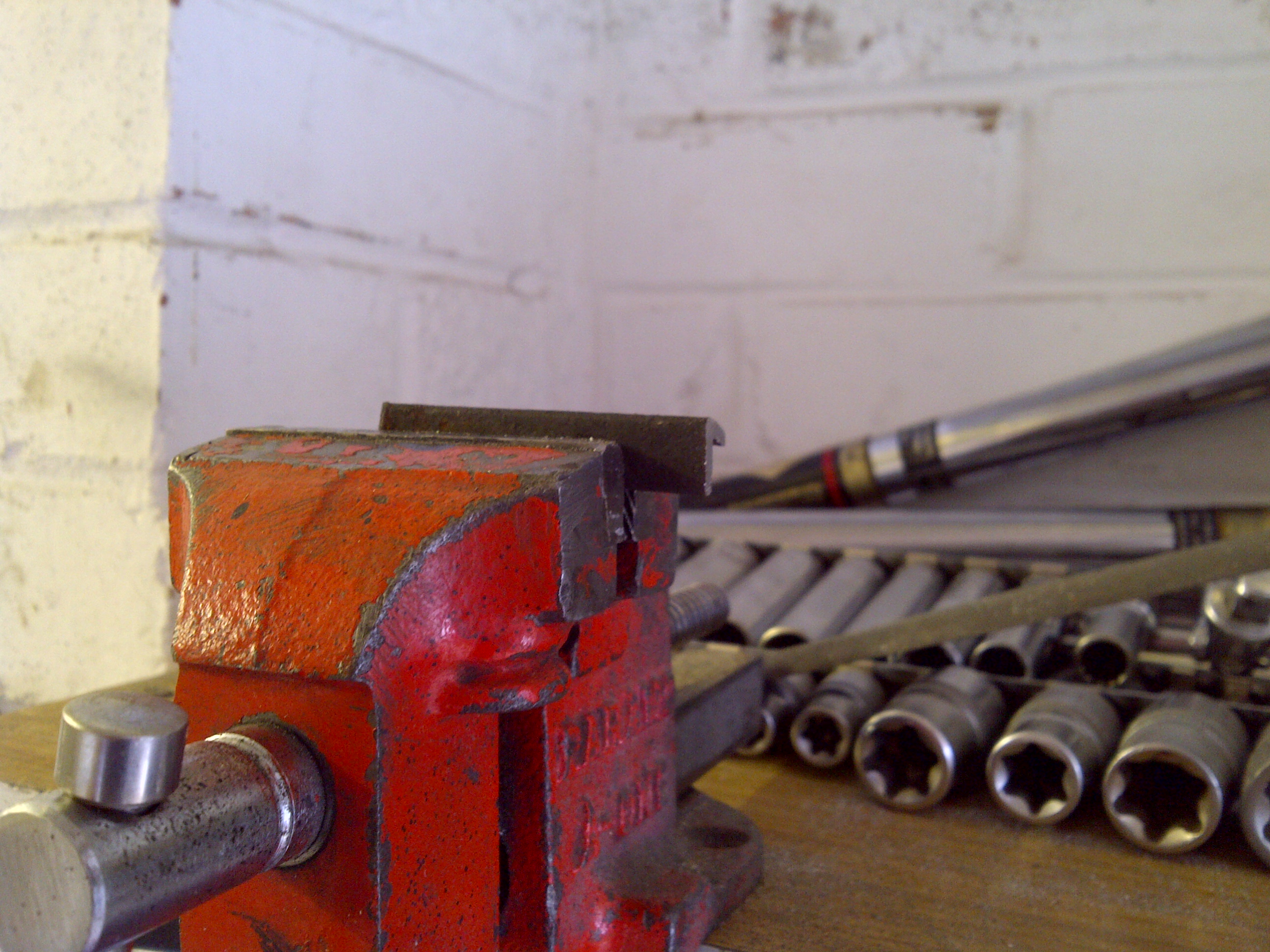

I compared them to the one on the drivers side of the Clio, and they appeared to be farrrrrr tooooooo long, so decided to give them a quick trim with the hacksaw, and file the burrs off:
Please ignore the hash of a first hacksaw cut, it was going to be slightly too short :eek:.

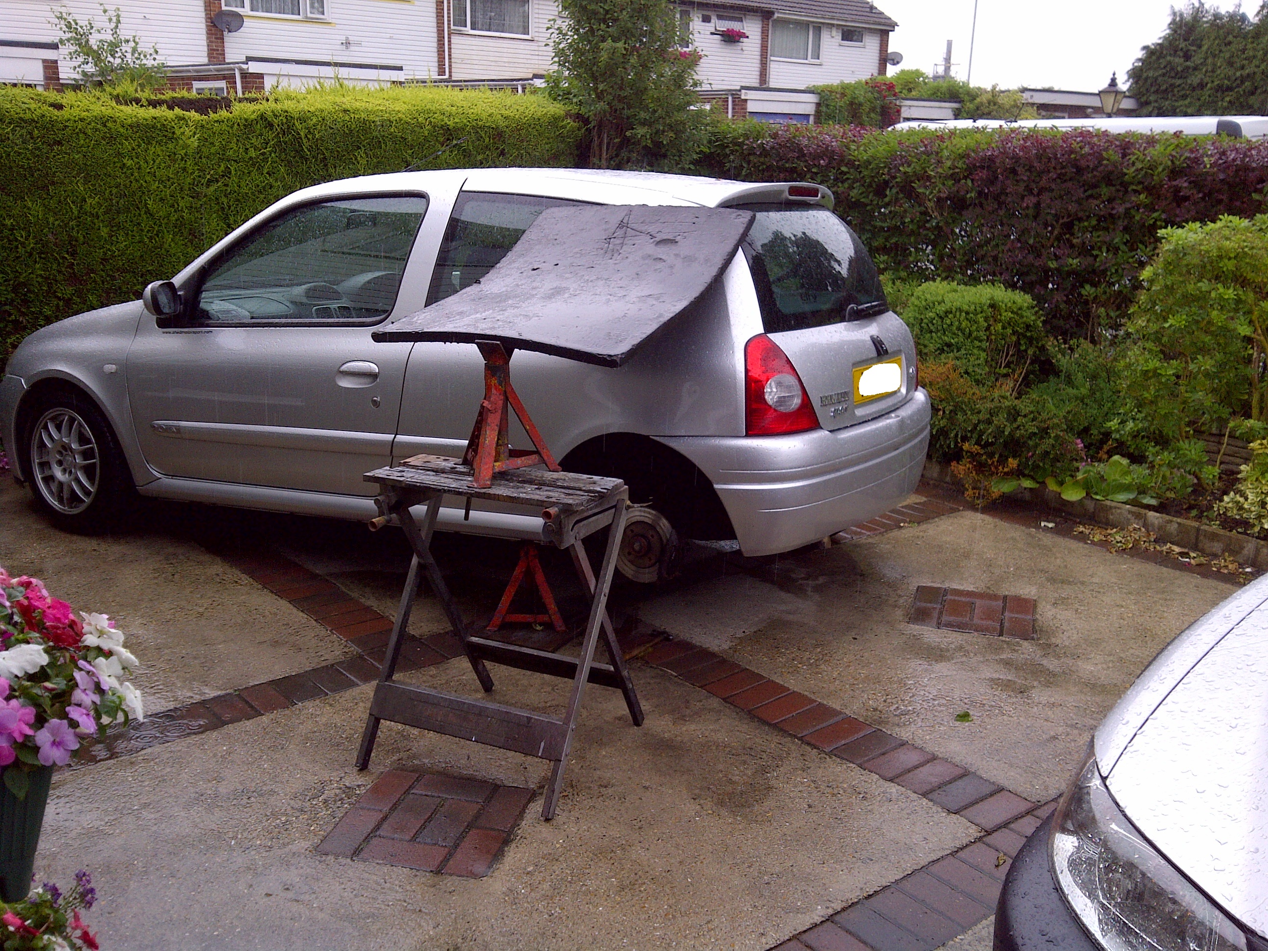

The rain had been pouring all afternoon, and getting me soaked whilst trying to fit the pads back into the carrier and get them all secured in with the new wedge piece, so I fashioned myself a shelter ;)
Looks rather shady, but worked a treat!

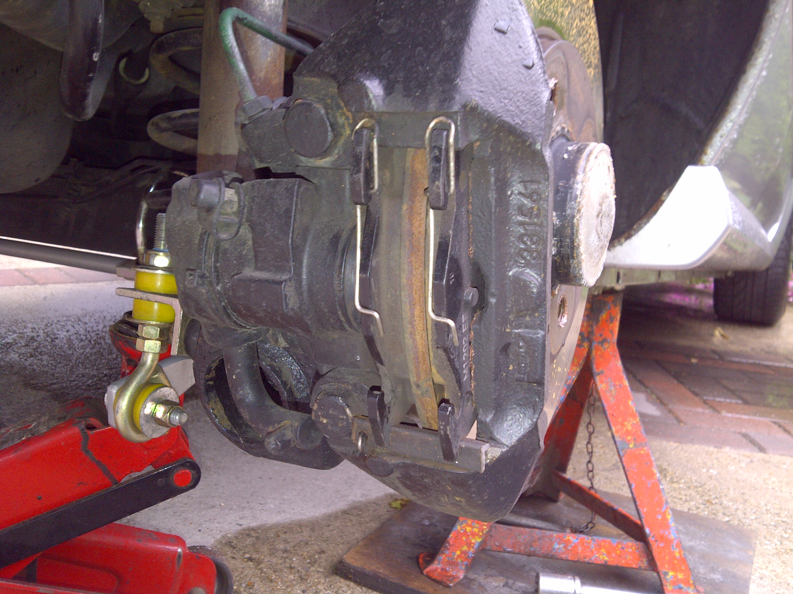

I decided to sort the drivers side out as well.
I didn't want any more pads being spat out at me, so decided it would be best if I had a look at my handywork on the drivers side caliper:
Doesn't quite look right?
Got the new wedge fitted, and fitted the pads correctly, and had everything looking fine and dandy within a few minutes:
Hopefully, fingers crossed I will not be getting any more problems with them!

Nooo!
The wedge was definitely there to begin with, but look at the springs! They are wrong.
Also, if you look closely on the drivers side, the wedge is there, its just veryyyy dirty ;)
