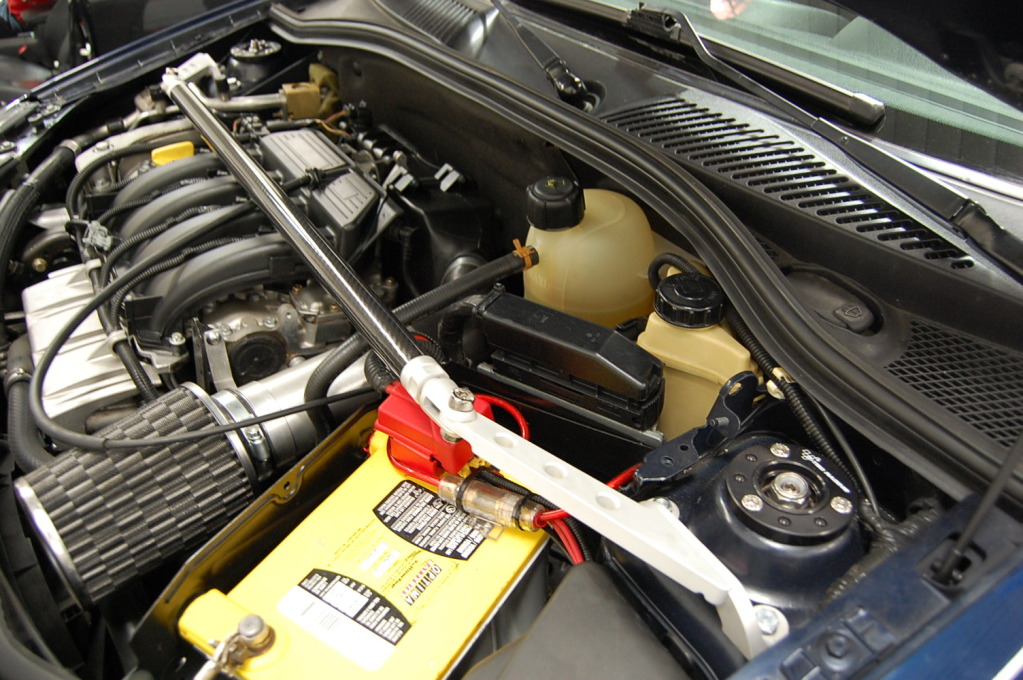

My car has actually the following mods:
17" wheels and tires

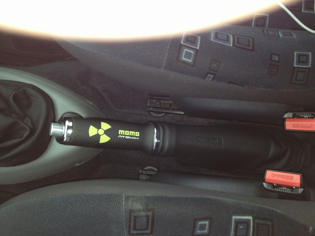

Momo Steering Wheel, shift knob, park brake handdle and Momo Leather Boots
Sony & JBL audio

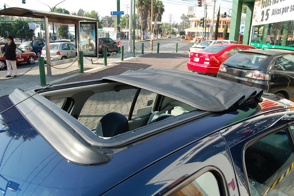

Webasto Sun Roof (soft,electric)

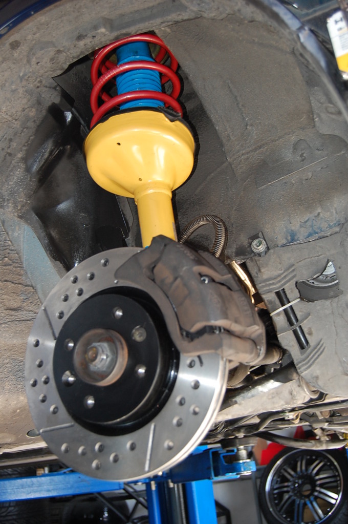

Brembo drilled front brakes with ferodo pads
Rear Clio Sport Disc Brakes with ferodo pads
Ktec Stainless Steel Brake hoses (in the works to install)
Ktec Engine mounts
Powerflex Poly Suspension Bushes

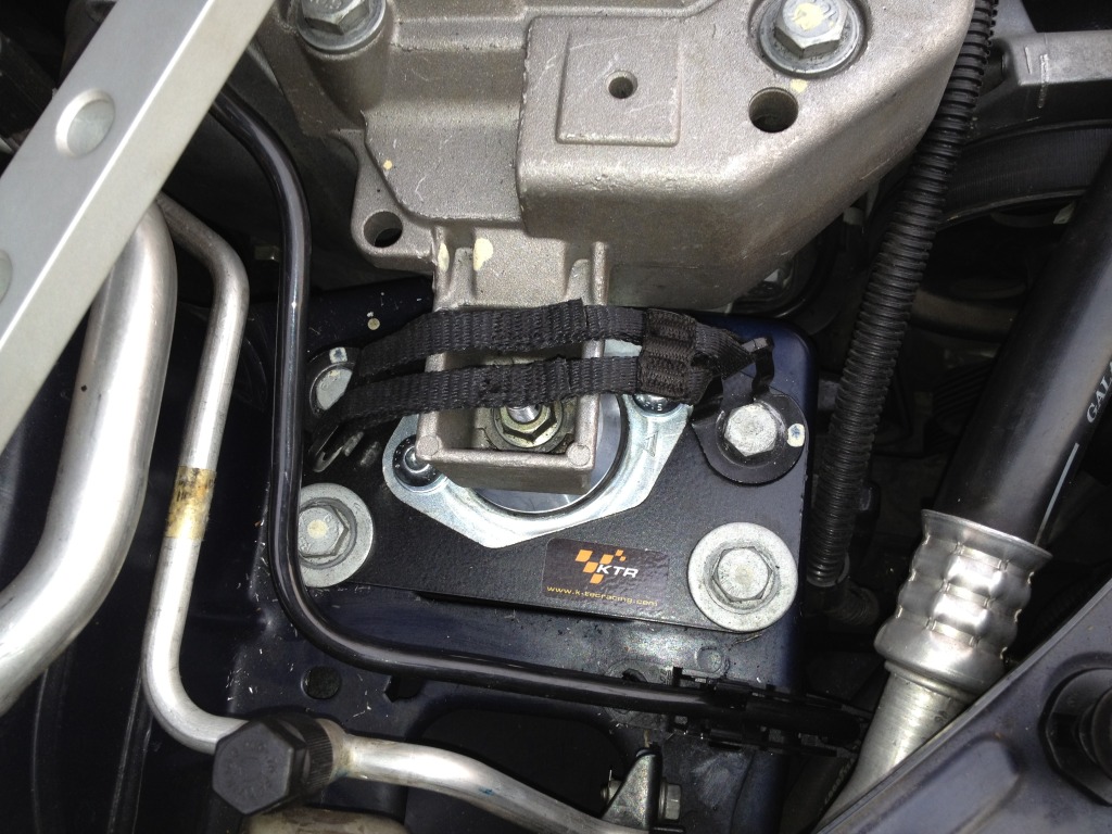

KTR Bolt In Alloy Suspension Top Mounts

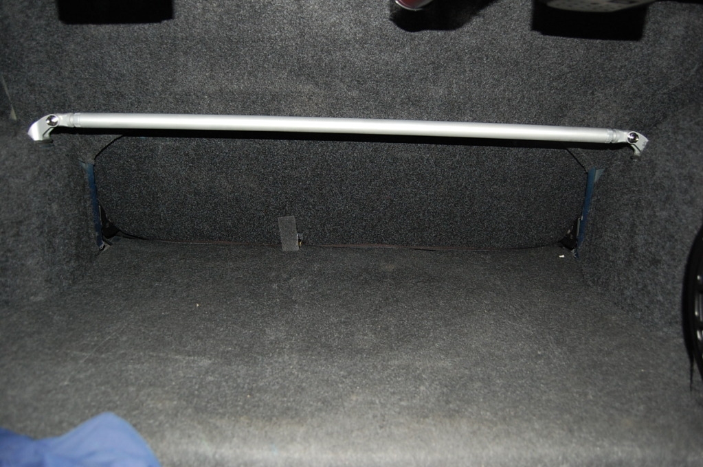

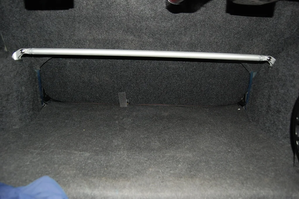

KTR Aluminium Rear Strut Brace
KTR Carbon Front Strut Brace
Whiteline Rear Anti Roll Bar Kit
Billstein B6 Struts and Shock Absorbers
Eibach coils
Eibach Camber Correcting Bolts
KTR 1° Rear Camber Shims
Full Custom Exhaust sistem, stainless steel with MagnaFlow tail pipe, no cathalitic converter
Mapped ECU
Full Flow CAI

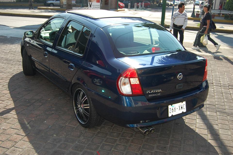

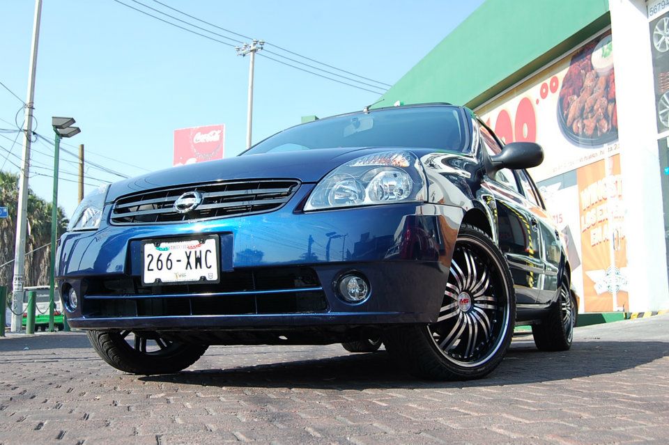

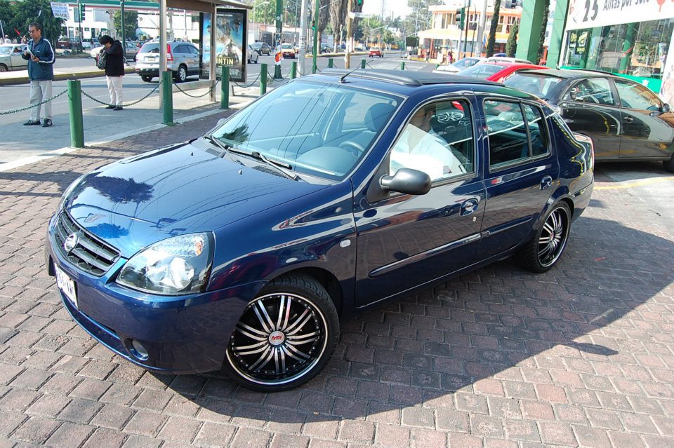

These are some pics from my car:
  Renault Symbol

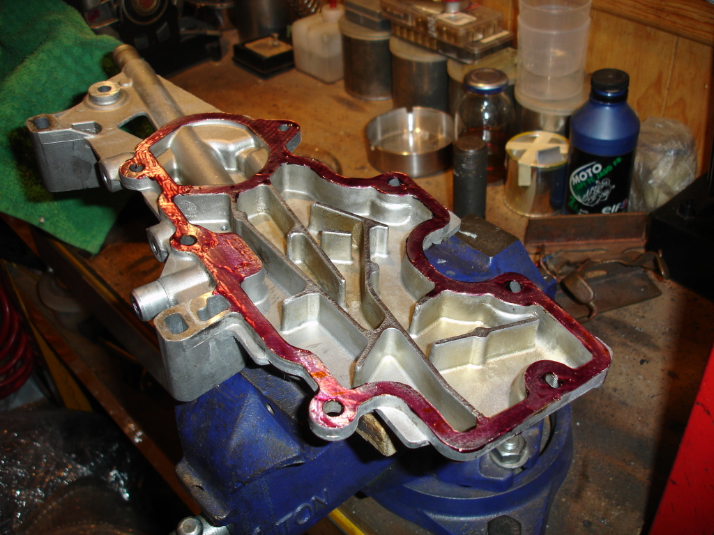

If I am going to install the FlowTek Manifold like this:

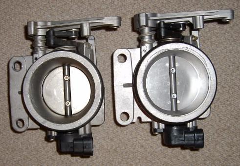

Is it a good idea to get a Bigger throttle body like this (and of course "bigger" injectors)?
Someone told me the BIG Throttle Body if from an Old Laguna, Do someone knows the model?, where to get it?

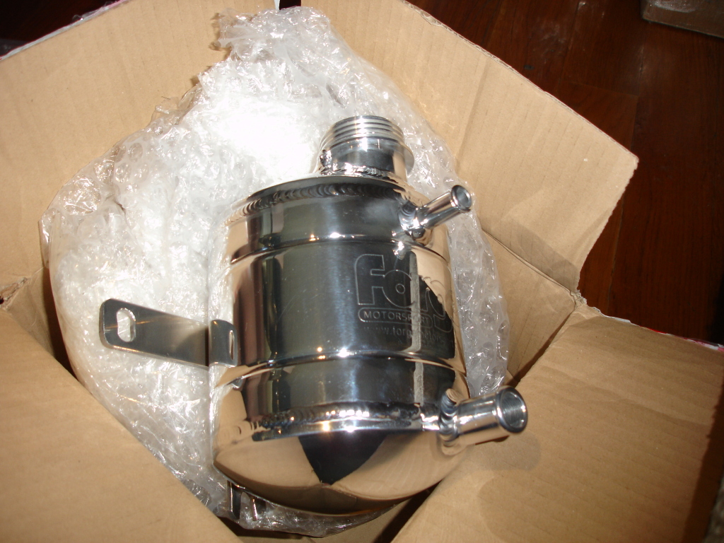

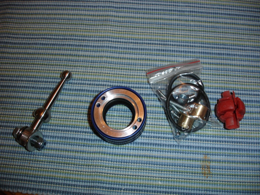

I just order this nice item:

Can someone help on the Throttle Body Issue?

LOL, Yes...This car(same as Renault Symbol or Renault Thalia) was sold in my country by Nissan, under the name of Platina, It has different headlights, I installed the Clio headlights because I like them much more.

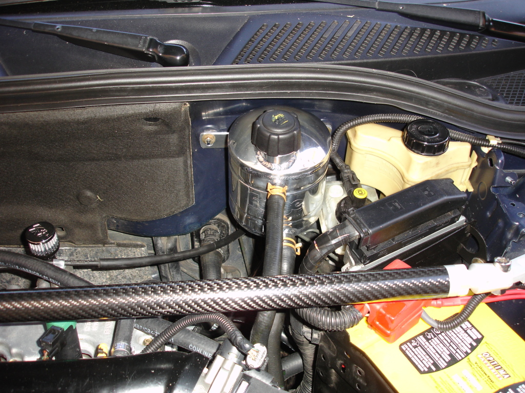

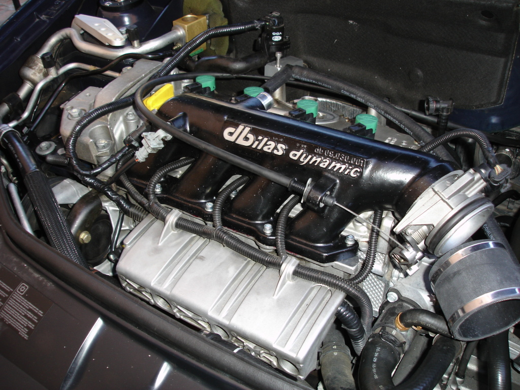

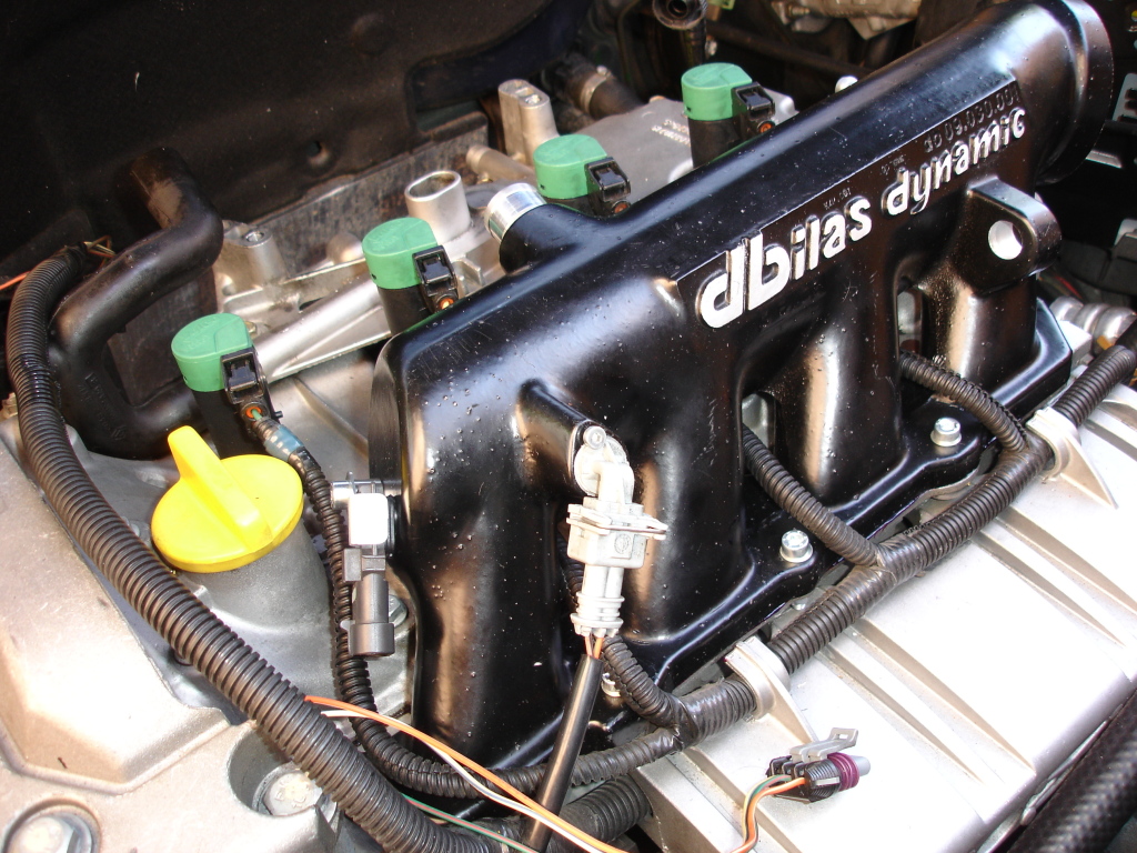

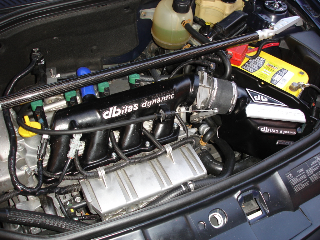

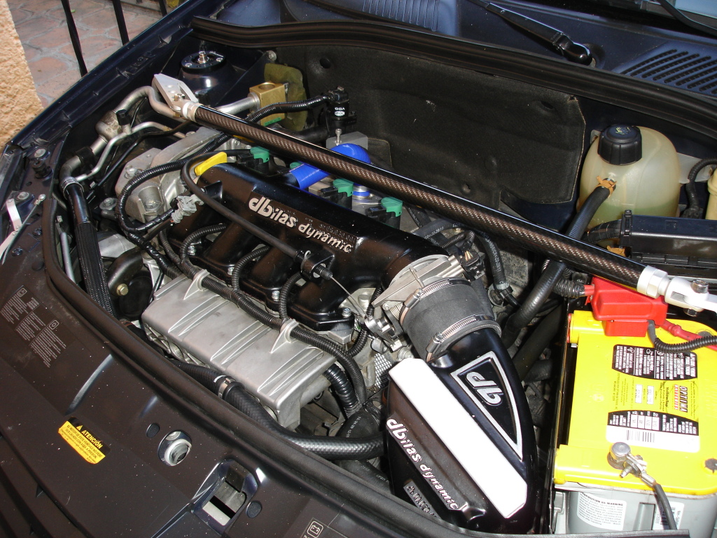

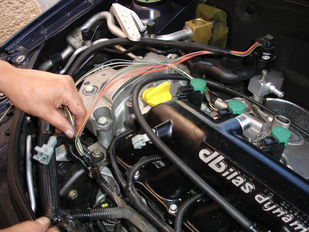

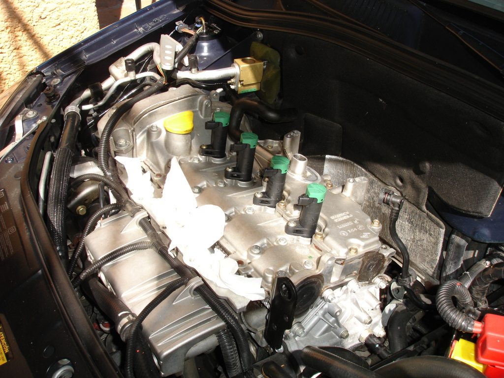

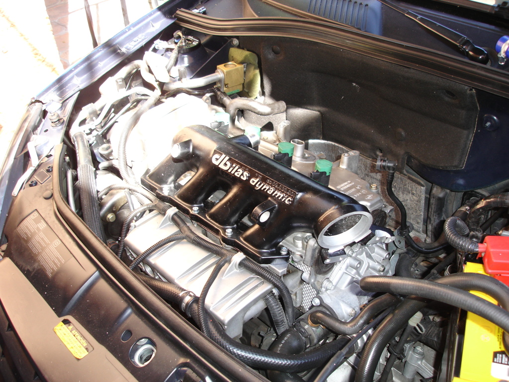

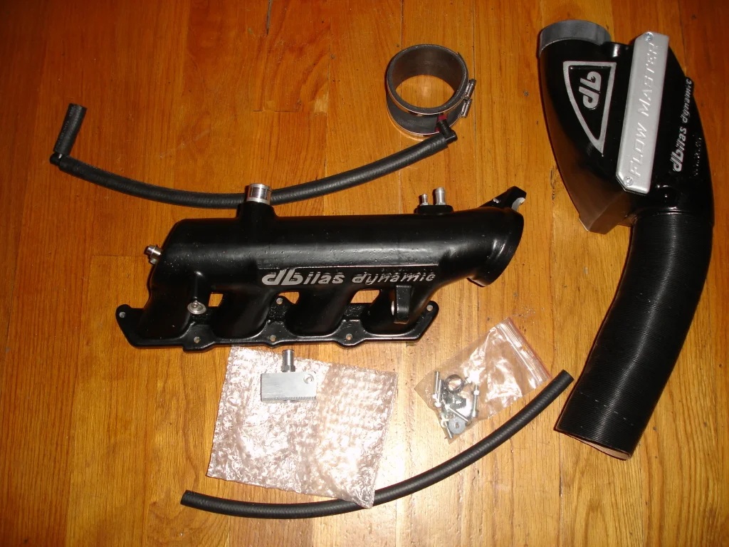

Finally, the dbilas dynamics intake arrived...
THE PARTS:
THE OEM INTAKE REMOVED:
THE NEW INTAKE INSTALLED:

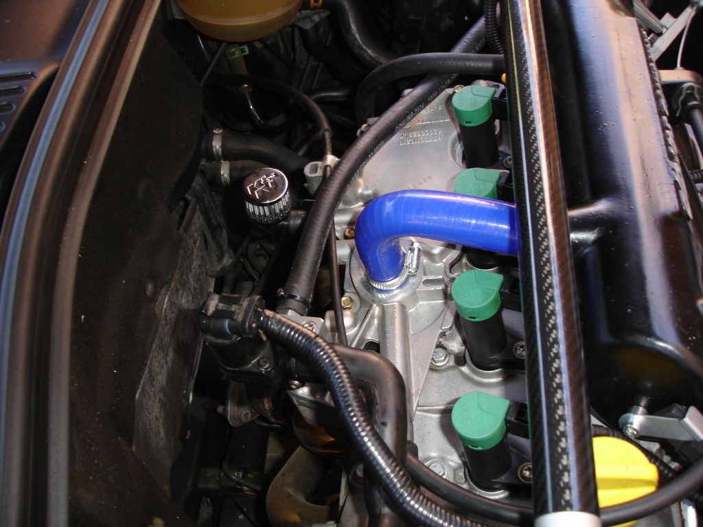

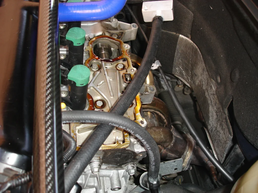

WORKING ON THE HARNESSES:
  Renault Symbol

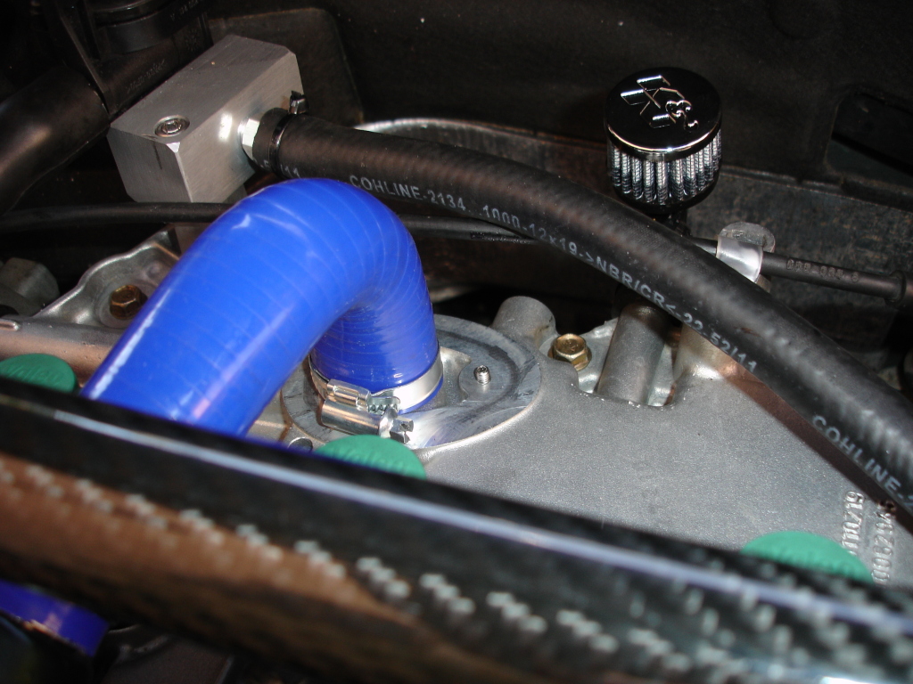

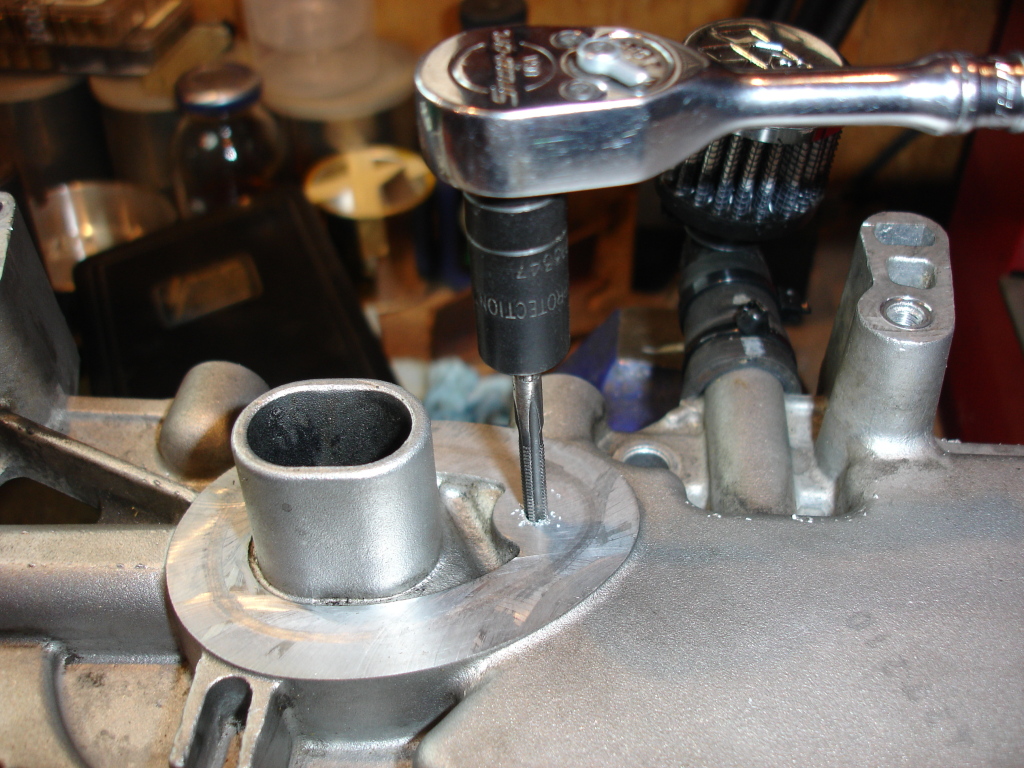

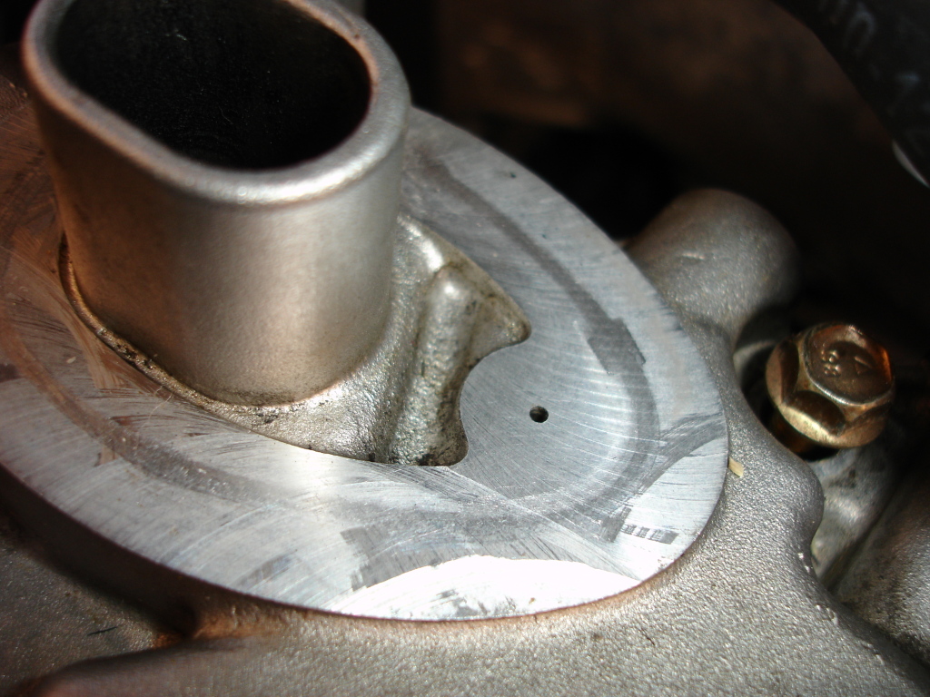

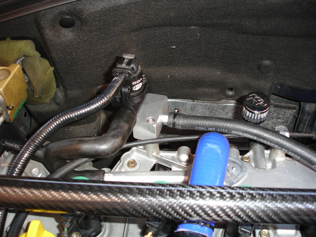

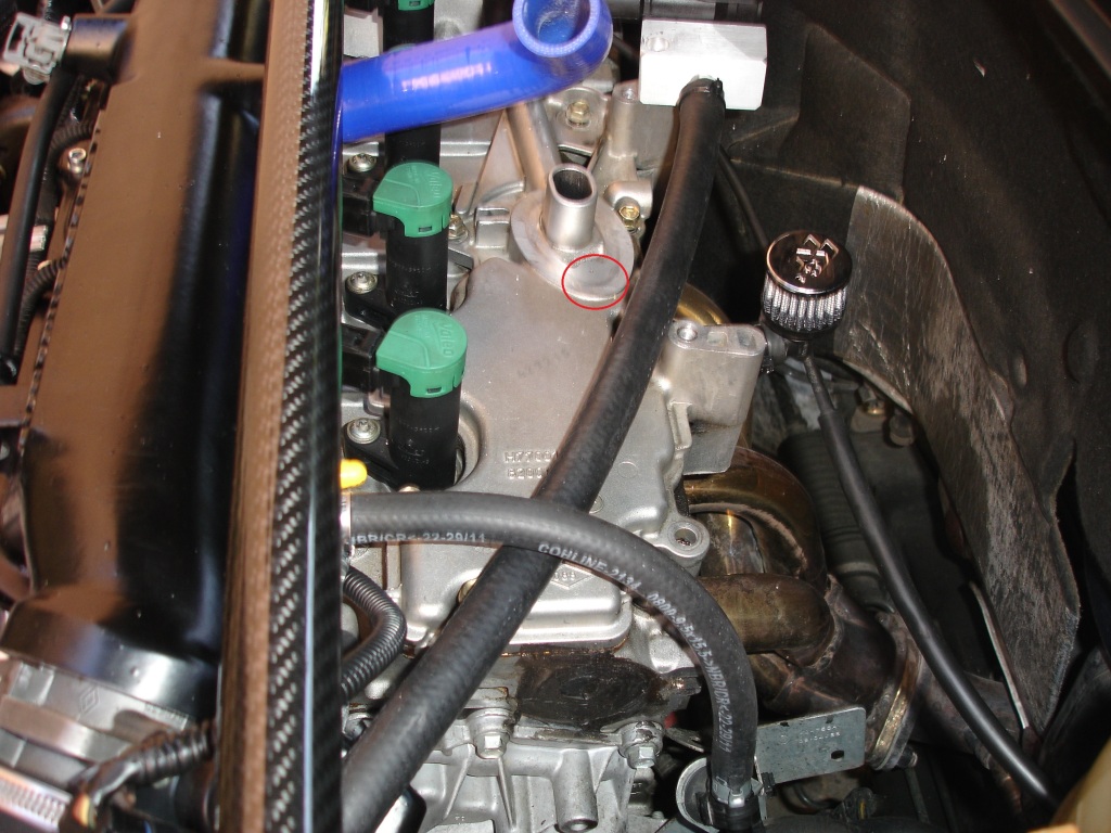

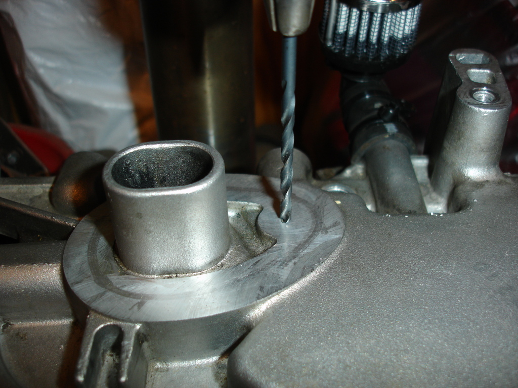

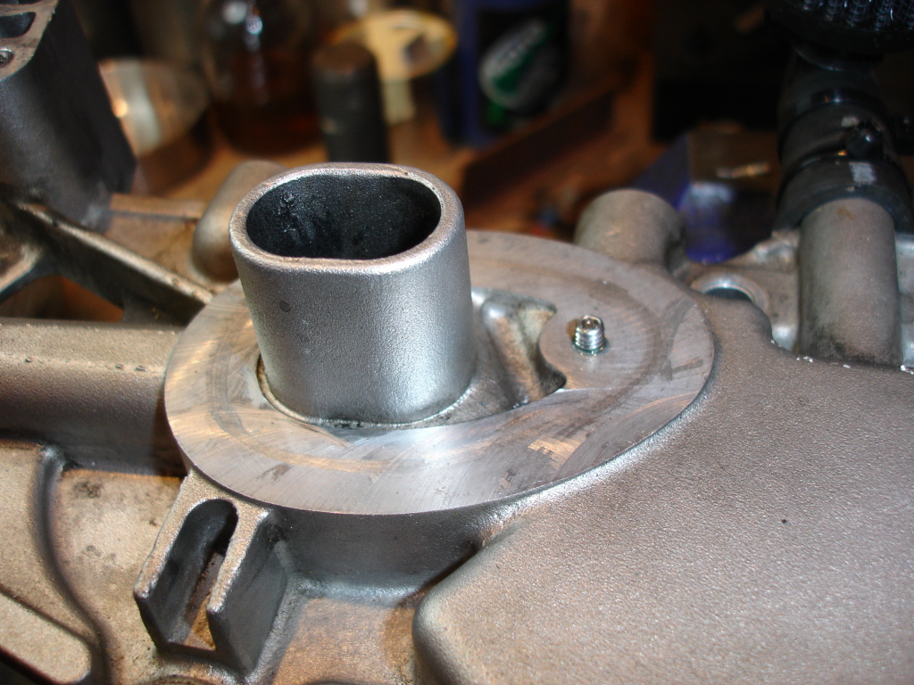

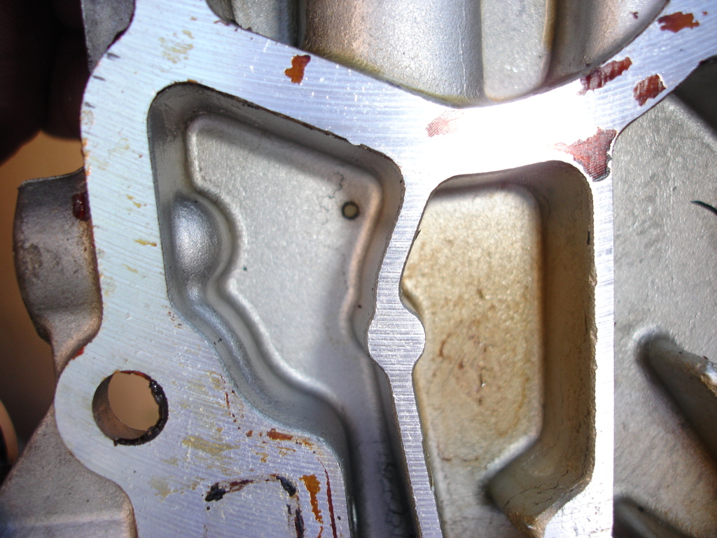

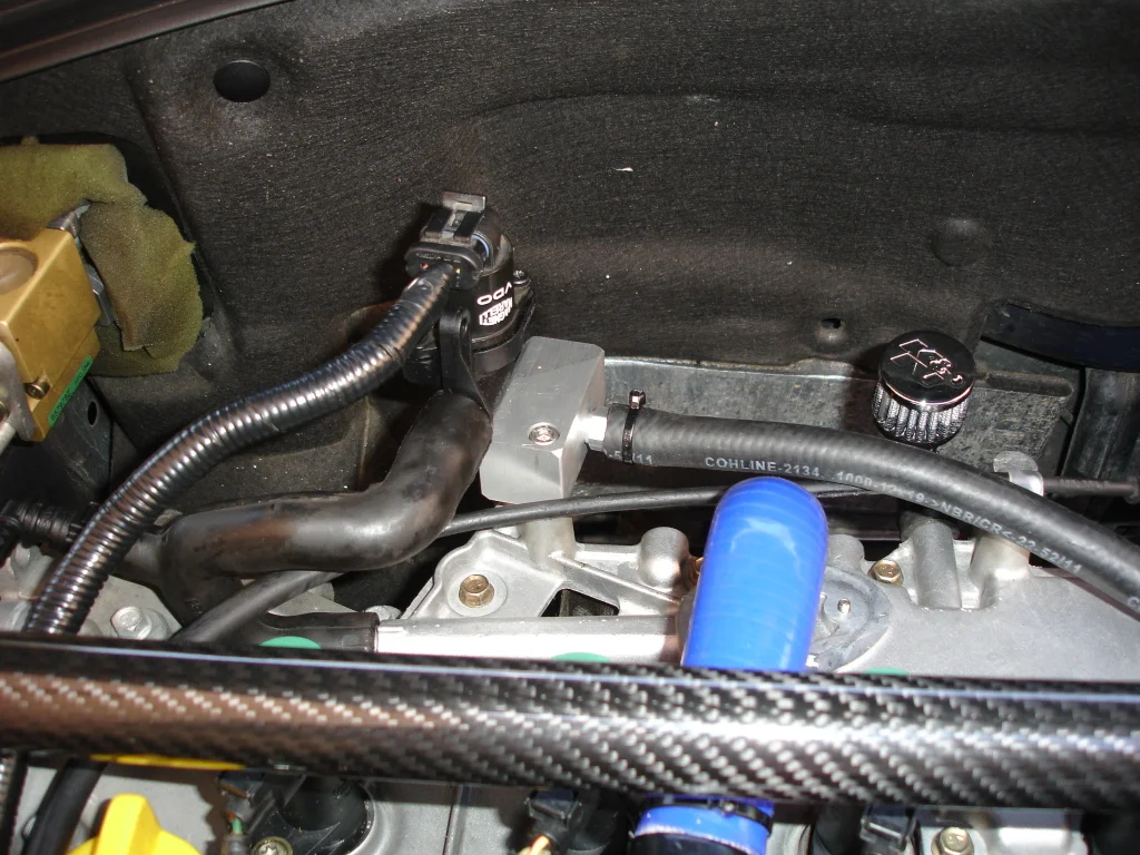

Today I was looking close to my intake installation and discovered a "pin hole", looks like it is to "breath" the case???.....It use to be inside the OEM airbox:
I decided to remove the cover and fix it:
Drill it and tap it:
Added an small bolt:
  Renault Symbol
Today I had the chance to drive my car with the new dbilas dynamics intake....all I can say is WOW!!!...It worths every single GBP I paid for it...the sound of the engine is just beautiful....

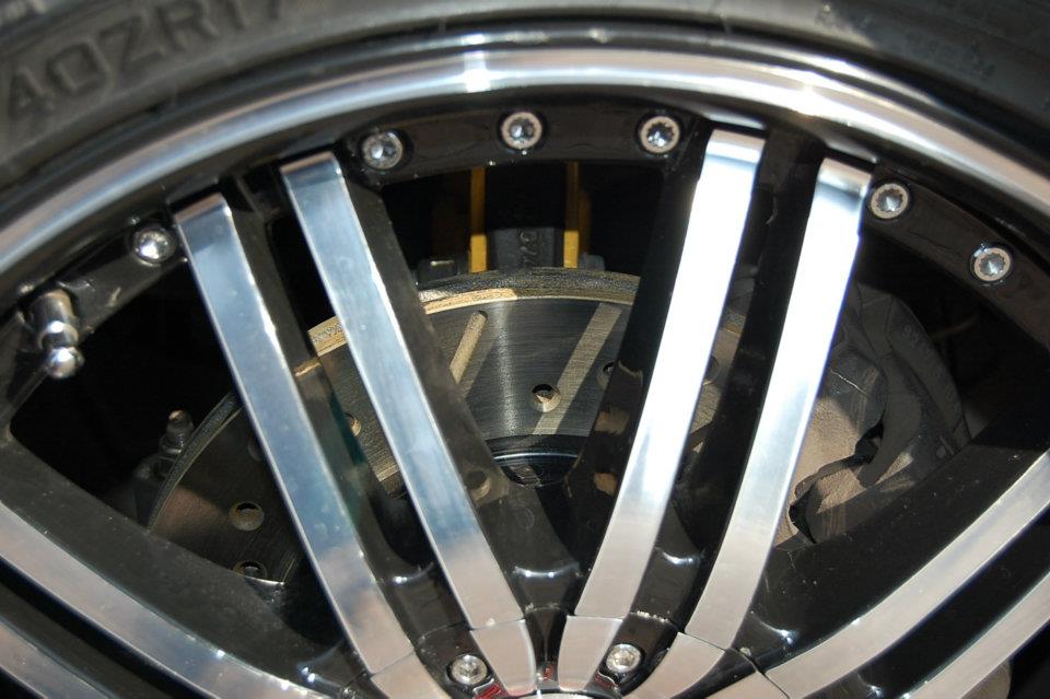

Mi rims and tires finally arrived....the rims are at the machine shop to fabricate some "spacers" for the center hole, the rims are 73m.m. bora and my car has 60 m.m. axles..I will post some pics once they are done
